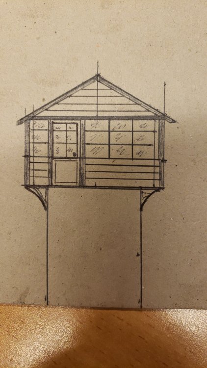

Darren.d Posted November 12, 2022 Author Posted November 12, 2022 On 9/11/2022 at 3:57 PM, leslie10646 said: Alas, Darren, I must disappoint you. The Amiens Street set which the IRRS has uncovered to date does not include the cabin. We can provide plans of Jim Meade's office in the building (well as it was in GN days), but not the cabin. If we find it ..... There are lots of photos........ Its an interesting building i didnt know existed until recently.theres an awful lot of glass to it.might have to scratch build the windows.something iv never attempted.thans for all the help much appreciated. Drawing just a vague idea as to how might look. Dar. 1 Quote
Galteemore Posted November 12, 2022 Posted November 12, 2022 (edited) Here’s one idea. Get hold of an Alphagraphix 4mm scale GN standard pattern box. That will provide templates for lots of the detail parts you will need, and possibly help scale up parts such as windows for that particular cabin. Great drawing btw. The link is for an O gauge one but you’ll get the idea.https://www.ebay.co.uk/itm/Alphagraphix-A125-Great-northern-Railway-of-Ireland-signal-box/273994114694?hash=item3fcb526686:g:Pn8AAOSw9yZdb9ng this Jim O’Dea image might also help if not seen https://catalogue.nli.ie/Record/vtls000304361 Edited November 12, 2022 by Galteemore Quote

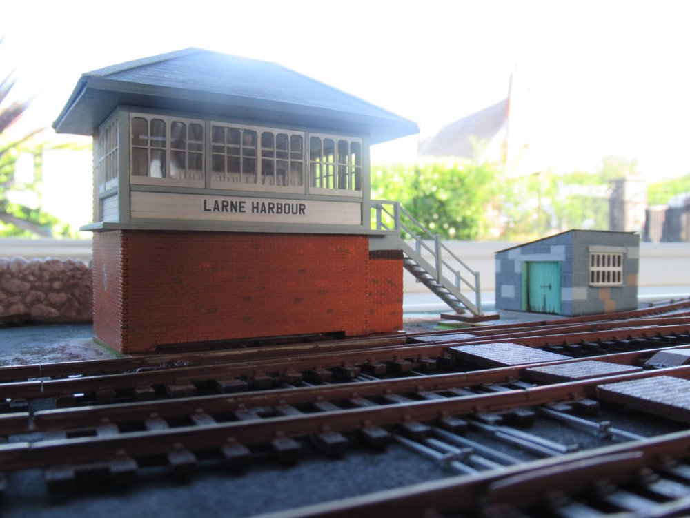

LARNE CABIN Posted November 12, 2022 Posted November 12, 2022 Hi Darren, Good advice there from Galteemore. Also, you will find a post on the Workbench Thread by Patrick Davey, 'Two GNR(I) Buildings', detailing how he built a basic GNR(I) cabin. This might give you some ideas. Also, there is a Galgorm thread detailing the building of the NCC Cabin at Ballymena, and I have scratch built Larne Harbour Cabin purely from a view photos and info from a few people on this forum. There is a company called LCUT Creative who provide various laser cut pieces to help scratch building. Going by your work on Connolly Loco Shed you would make a good job of a scratch build. It's very satisfying! You just need a few good photos! 1 Quote
Darren.d Posted November 12, 2022 Author Posted November 12, 2022 4 hours ago, Galteemore said: Here’s one idea. Get hold of an Alphagraphix 4mm scale GN standard pattern box. That will provide templates for lots of the detail parts you will need, and possibly help scale up parts such as windows for that particular cabin. Great drawing btw. The link is for an O gauge one but you’ll get the idea.https://www.ebay.co.uk/itm/Alphagraphix-A125-Great-northern-Railway-of-Ireland-signal-box/273994114694?hash=item3fcb526686:g:Pn8AAOSw9yZdb9ng this Jim O’Dea image might also help if not seen https://catalogue.nli.ie/Record/vtls000304361 Thats a fantastic view of the interior.and how its laid out.ill ģo look for the Alphagraphix one Cheers Dar 1 Quote
BSGSV Posted November 14, 2022 Posted November 14, 2022 Sorry to be a pain, but the Alphagraphix's kit is for the type of cabin put up by the GNRI in the 1890's, 1900's. The cabin design changed in the early 1910's to a new, (similar) design. Dublin Amien's St. was built in c1923 to replace Dublin Central , which was destroyed in the Civil War, to the later design. The interior photo was taken in 1959, and shows a lot of empty space at the far end of the operating room. Originally the locking frame was much longer, as the cabin also controlled the GSR lines, from the GSR Loop line platforms, towards North Strand Junction. However, when the GSR took over control themselves (on West Road opening), the GNRI frame was shortened. 1 1 Quote

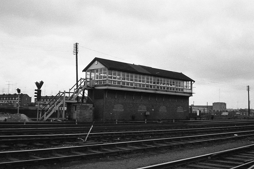

Kevin Sweeney Posted November 15, 2022 Posted November 15, 2022 This a screengrab from the OSI website, it shows the signal box in 1901. I find the OSI site invaluable as a resource for getting the dimensions of demolished buildings or buildings I can't get access to. This may or may not be helpful to answer your specific question, as BSGSV says the cabin was changed in the early 1910s and destroyed in the civil war. GeoHive Map Viewer 2 Quote

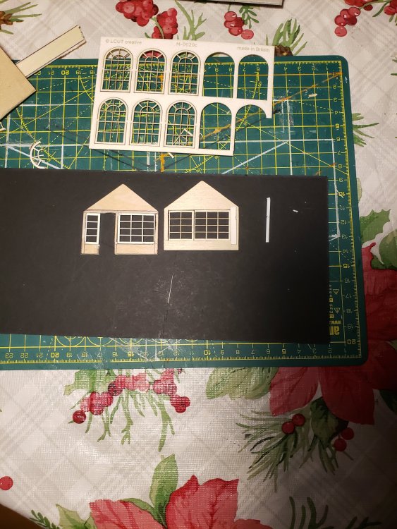

Darren.d Posted November 26, 2022 Author Posted November 26, 2022 Bought windows from lcut in the uk.just seeing roughly how things will look. 9 Quote

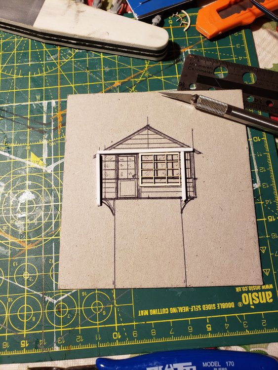

Darren.d Posted November 27, 2022 Author Posted November 27, 2022 Without equal the worst cardboard mock up in the history of model railways.but in saying that,gives me a 3d look at what I'm going to attempt to build.due to being unable to find a correct size of window cabin wont be to scale length by about 40 mm.i think. 10 Quote
Galteemore Posted November 27, 2022 Posted November 27, 2022 Don’t be so self critical - that’s instantly recognisable! Great work - captured the look of it nicely already. I can just about recall the real thing. 4 1 Quote
