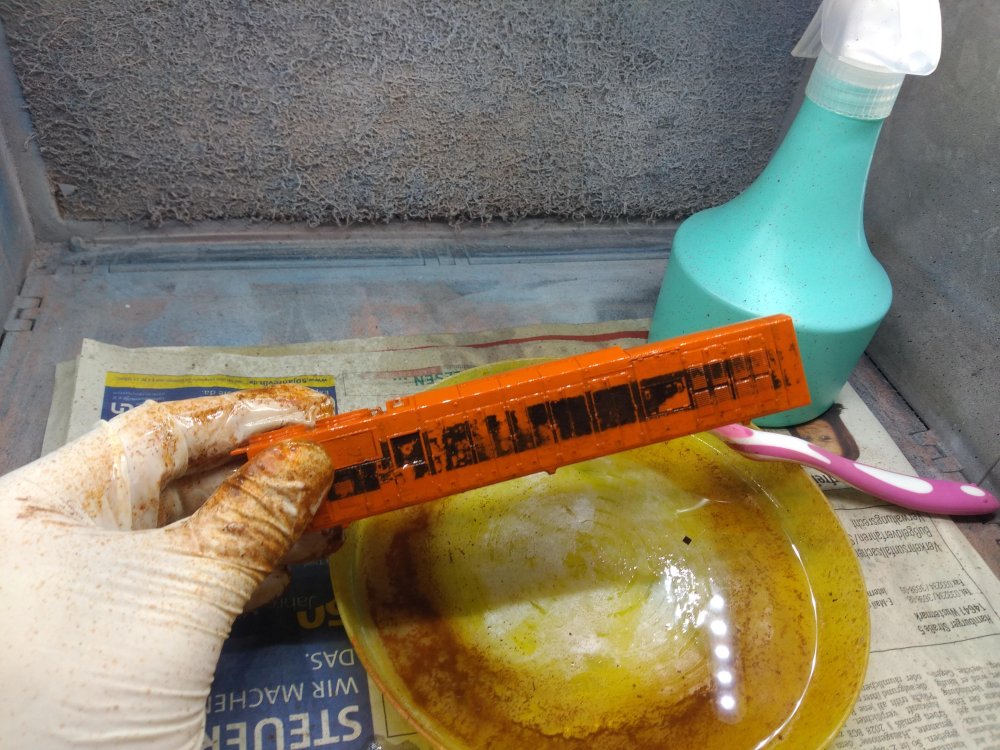

On 16/12/2022 at 11:55 PM, Sven-E said:
I have used break fluid to great effect. However some other people have reported that it affected the plastic. As mentioned above, different models need different treatment. Start with something weak to be on the safe side and if that doesn't work, go to stronger liquids. Sorry I don't have enough experience to rank the various liquids.
I can report that it affects plastic. I had a Bachmann DD40X which had far too much yellow paint on it filling all details. I am not sure if the plastic is PS or ABS. Soaked it in brake fluid once and removed 70% of the paint. So I soaked it a second time. With brushing off the paint I noticed the plastic shell became brittle and I "removed" some steps. I did the same with a Atlas and Kato shells without beeing able to remove the paint as well as the plastic (it is ABS) was not harmed. All I could remove from Kato shells was the printing. By this experience I decided the Bachmann was PS.
