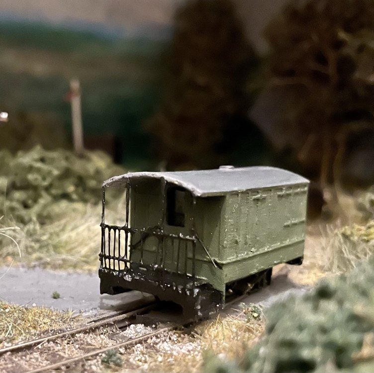

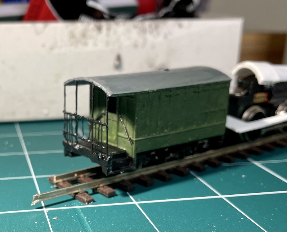

I made up one of his C and L brakes in 3mm. Very brittle axle box castings broke off and ended up adapting another chassis. I know some have found the printing rough. I won’t be making another balcony out of entomology pins in a hurry!  I think @KMCEhas experience here.

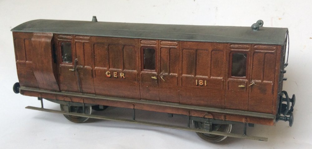

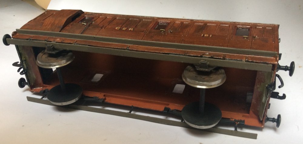

I think you have to be careful to put a date on the horror stories you get about Shapeways, David, Something like 10 - 12 years back I was looking round the yearly Gauge 0 do at Telford, and there was a 3D printer on display. It was busily building up something or other all on its own, and I was fascinated by it. Later on I was seeing the results, and it was a bit of a let down, they were looking like 50 ply cowpats. That was then, this is now, the machines have been improved, print materials are better, know how and techniques are better.
My own experience with Shapeways within the last two years has been a happy one. I bought one of the Rue d’Etropol’s range from them, he does a nice line in coaches for Colonel Stephens Lines, and I got a WCPR four wheel brake van, a GER cast off, in 7mm scale.(picture from the website)
It came as a greyish white, slightly translucent finish, and a dusty sort of look. Reading up on threads about these jobs, they say wash it in warm soapy water, and rub the surface where there’s any banding with emery paper. I did a little bit of this on the roof, but none on the sides where it was barely visible. The recesses at the back of the  axleguards were cleared out, and tophat bearings put in to take some Slaters wheelsets, and drawgear fitted. The lower footboards look vulnerable, and I took these off, and fitted brass strip replacements. The buffers were left, but this another thing which could become hors de combat. I wanted to put it back to GER condition, so I did new duckets in brass strip. Then undercoat, bodge a teak finish, and put some plastic sheet glazing. Here’s a couple of photos of the finished job, one taken from under which might give a good idea.
07372D9E-051C-4716-9148-B965D2D7569F.thumb.jpeg.598ffc55a5b9e92c1c680365f583188c.jpegBDAFFD65-9661-49FA-BAA8-A2FCF9733C97.thumb.jpeg.c19ce5fd4e60c8b5962b857fc75da7b8.jpeg
in the 7mm size, so you may think it’s dear, but then, look at the clock on the wall. How long would it take to make a fully assembled coach with such detailed moudings on the panels?
