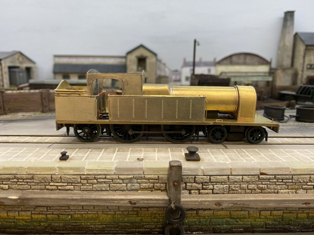

In the cold hard light of day this morning, I could see the boiler was too long (still!)
More butchery careful fettling dispensed with an unnecessary 6 scale inches of boiler. Still a bit long but then, so's the chassis but it looks better now, to my eye at least.

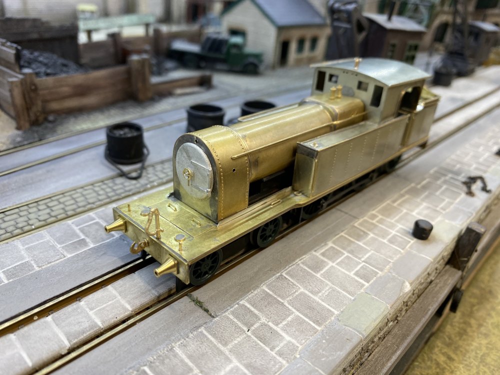

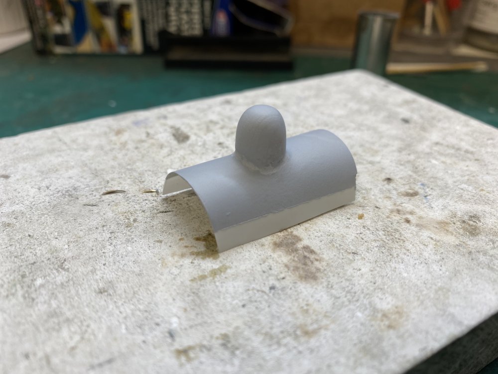

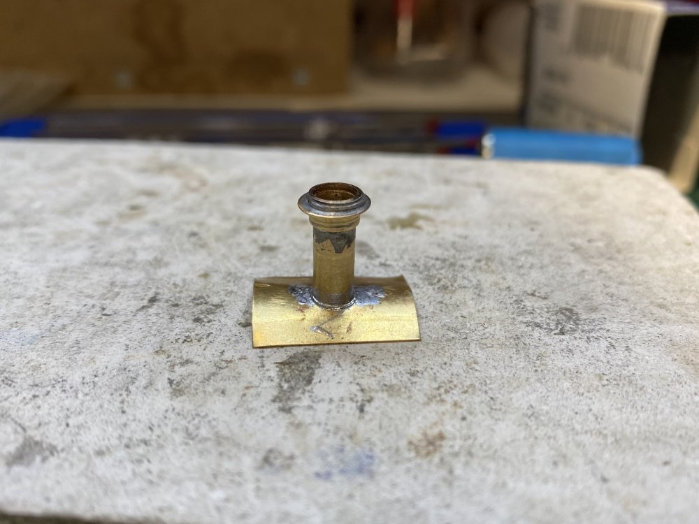

The majority of the fiddly bits are now done. Buffers, safety valves and vacuum pipes from Alan Gibson. The footplate steps are a Mainly Trains etch from Wizard Models. I made the chimney in the now traditional manner with brass tube, a washer and lots of solder. The dome is wooden dowel with a plasticard flange and filler to blend the two together. Still a bit of work to do on this before I cut away the surplus plastic and glue it on.

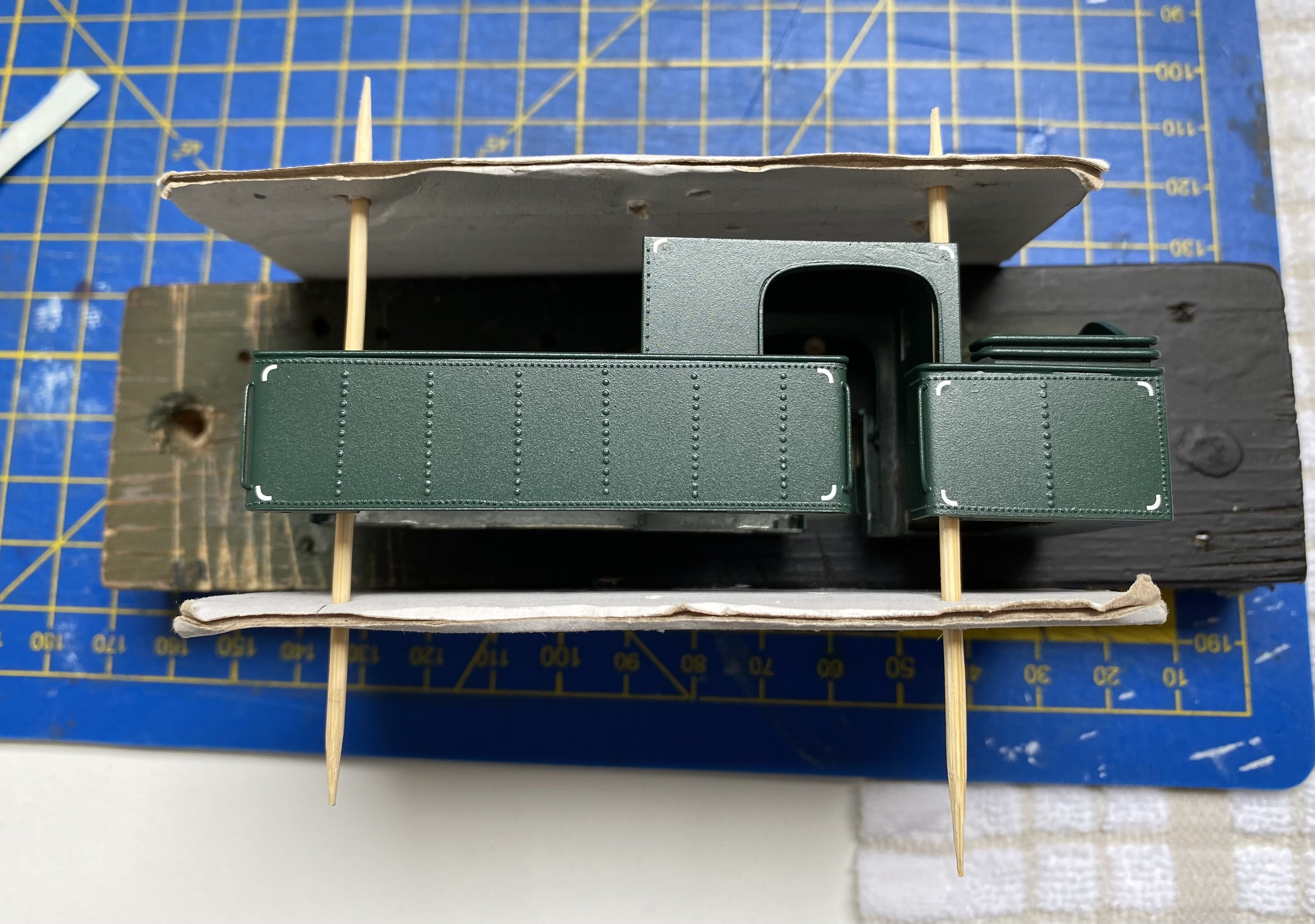

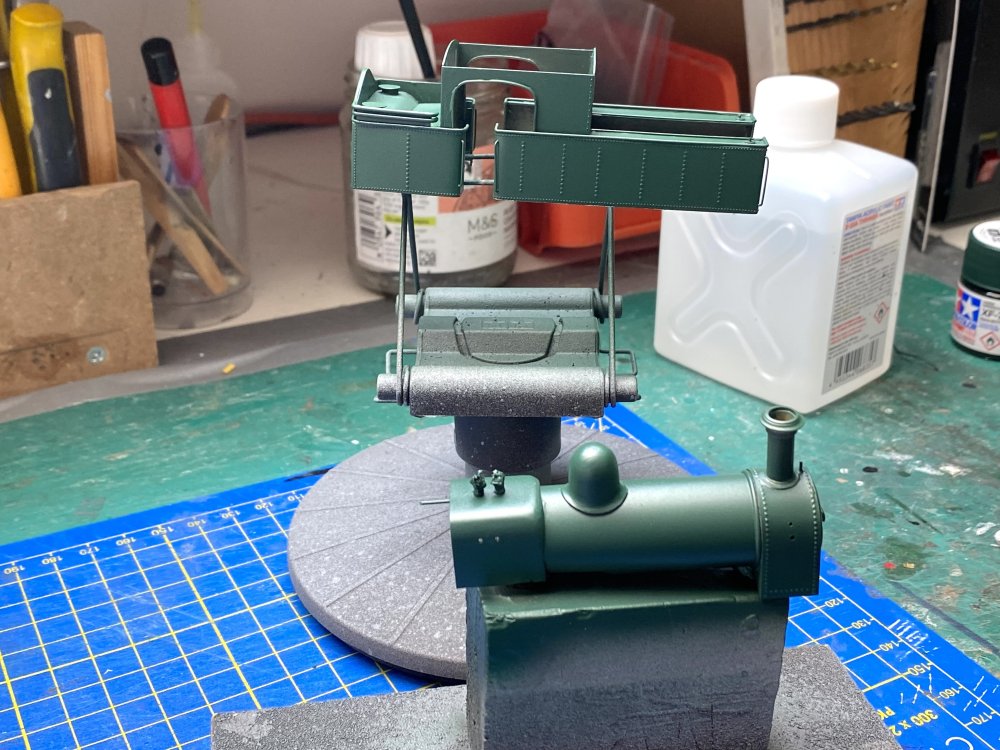

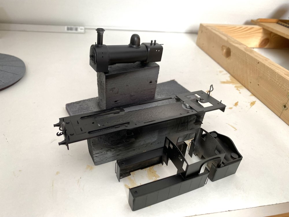

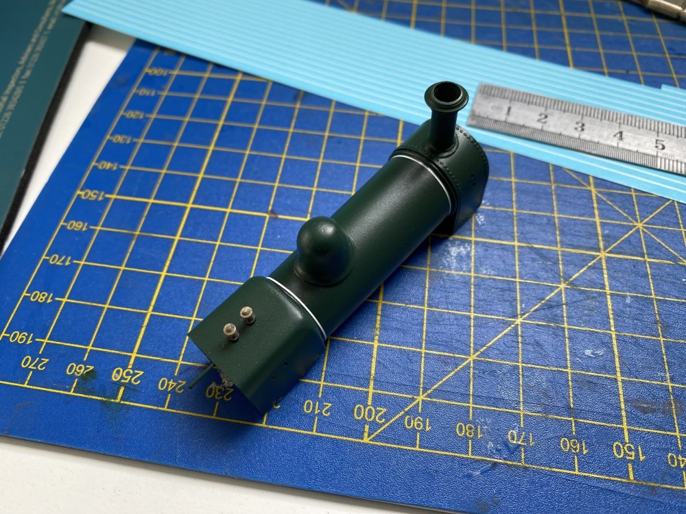

 A few progress pics of the BCDR bogie tank. Managed to get through the painting process without any major disasters. A first? I think I'm learning, albeit at a glacial pace.
Halfords grey etch primer from the rattle can then Tamiya acrylics. X18 semi-gloss black followed by XF70 dark green, both airbrushed.
I've started the line dancing now. Fox transfers. This bit always takes a while.

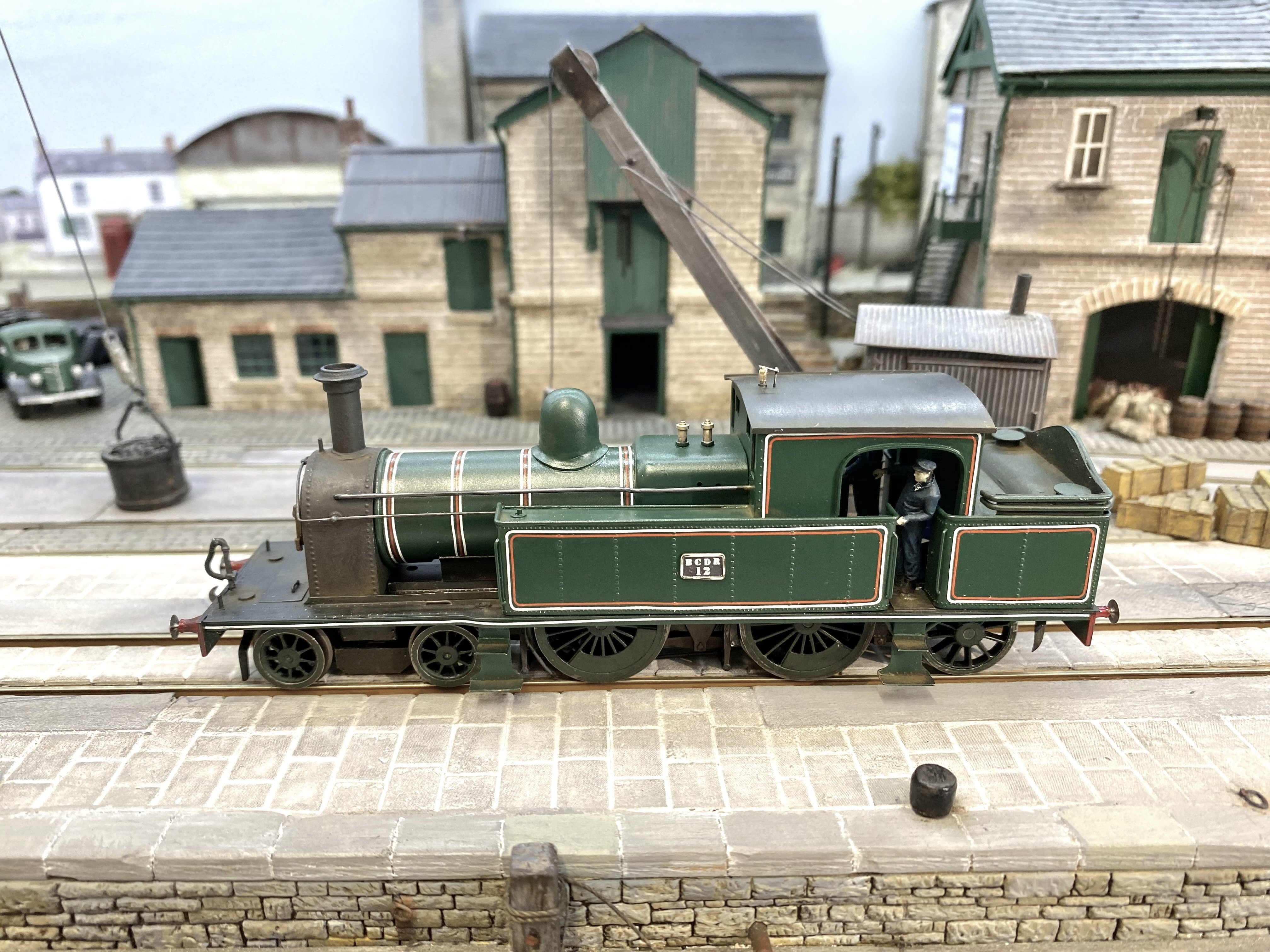

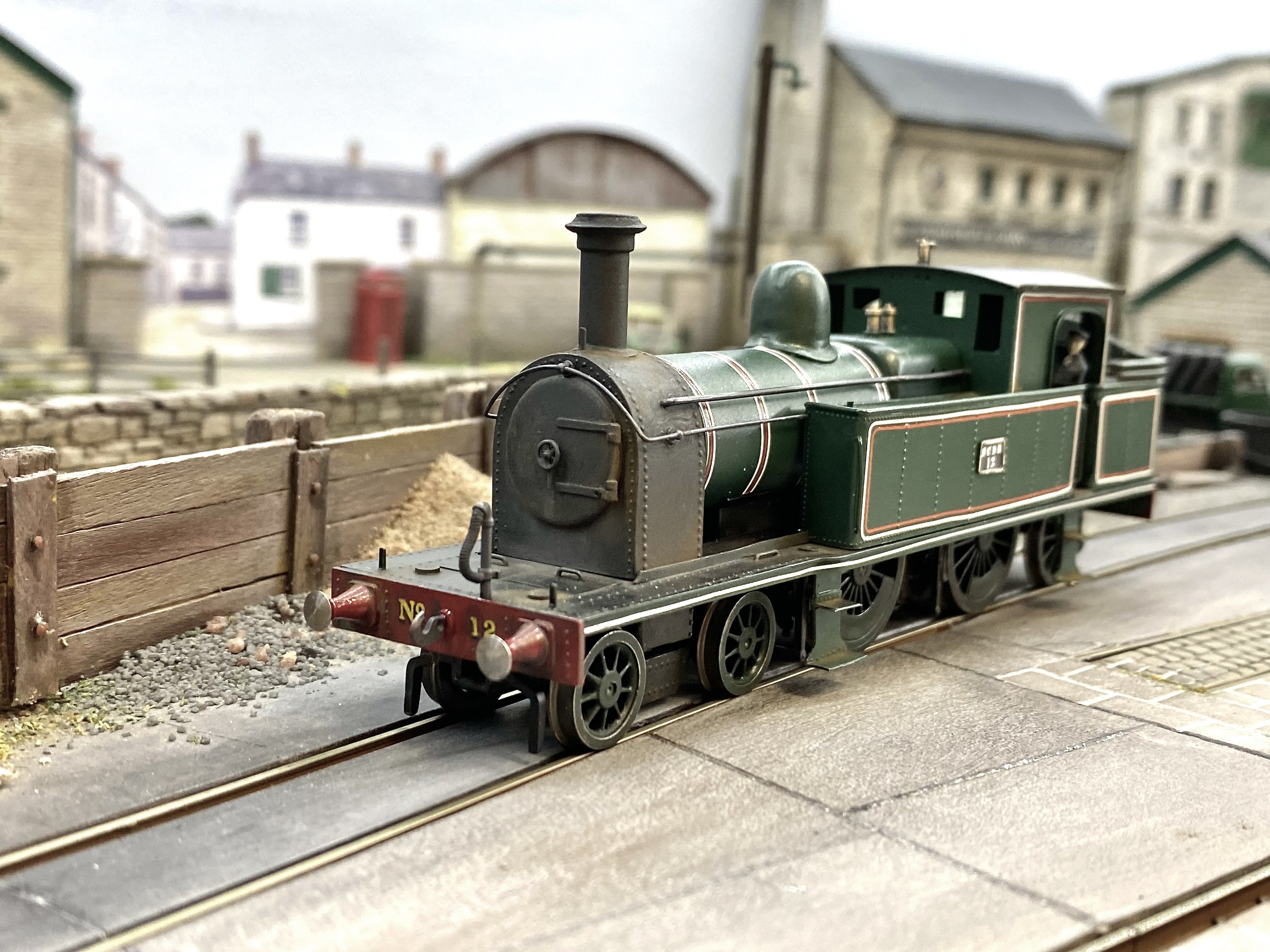

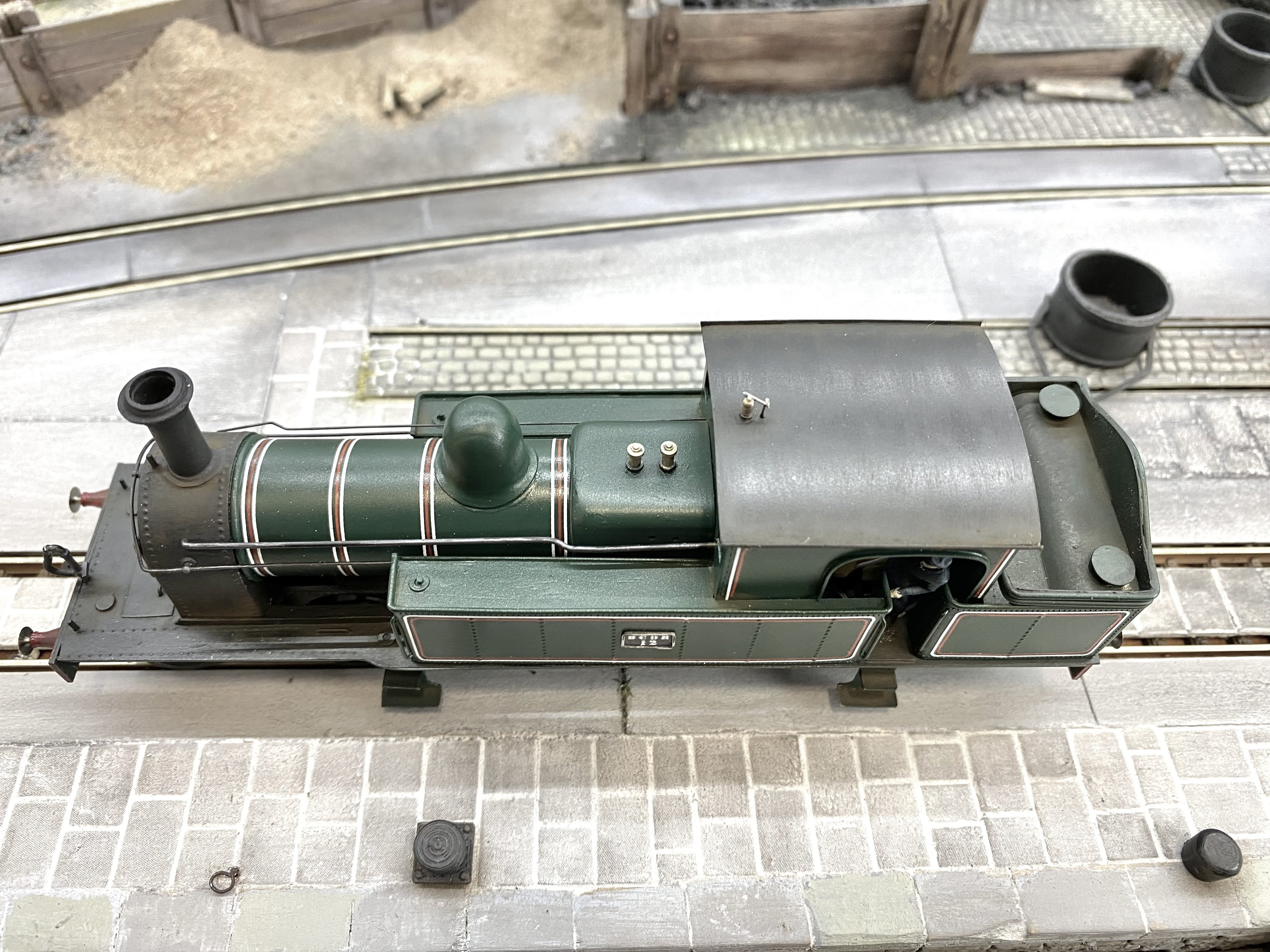

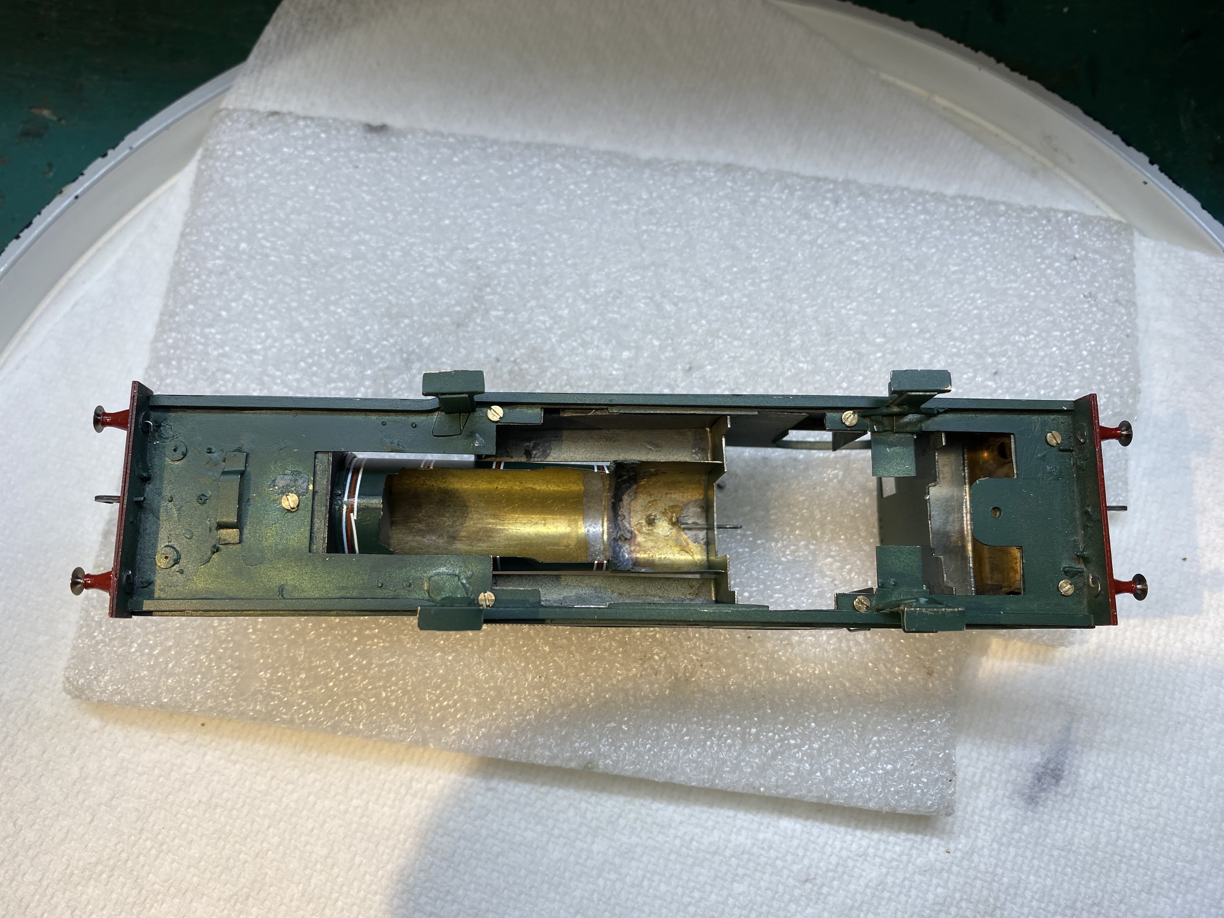

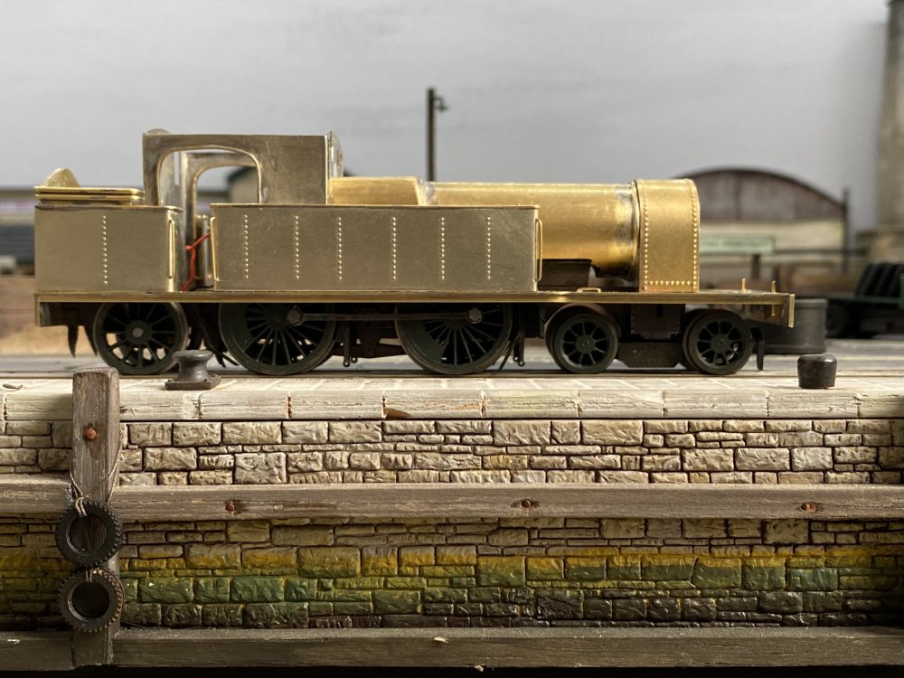

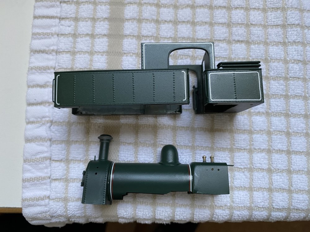

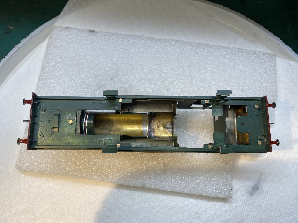

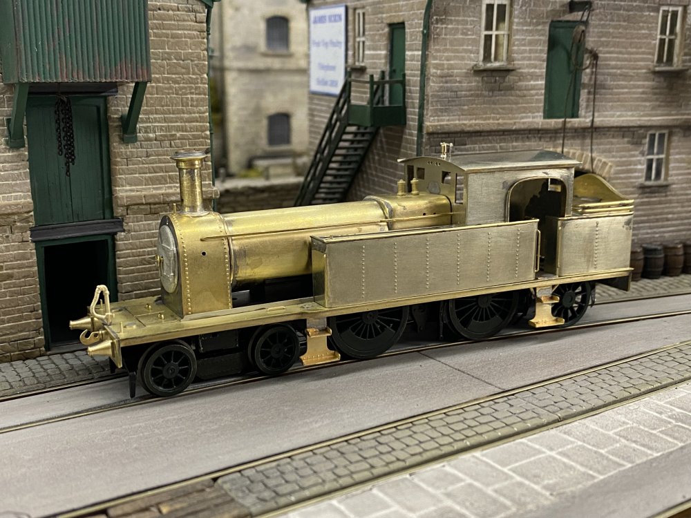

The BCDR bogie tank is almost done. At last. The bit that should’ve been no trouble, the ready-to-run chassis , fought me every inch (25.4mm) of the way. Part of that was my own fault for hacking and filing bits off without protecting the motor and gears from metal filings. It still makes odd noises going backwards. However there was also an intermittent short circuit which took days to track down and fix. The big hammer was close to deployment more than once. Seems ok now.
I settled in the end for Number 12. One of the of the first batch of 5 bogies tanks (“Series A”), it was built by Beyer Peacock in 1904.
Still needs a coal load and maybe some more weathering. After taking the pics I managed to destroy one of the tank side number plates so a new one is getting made.

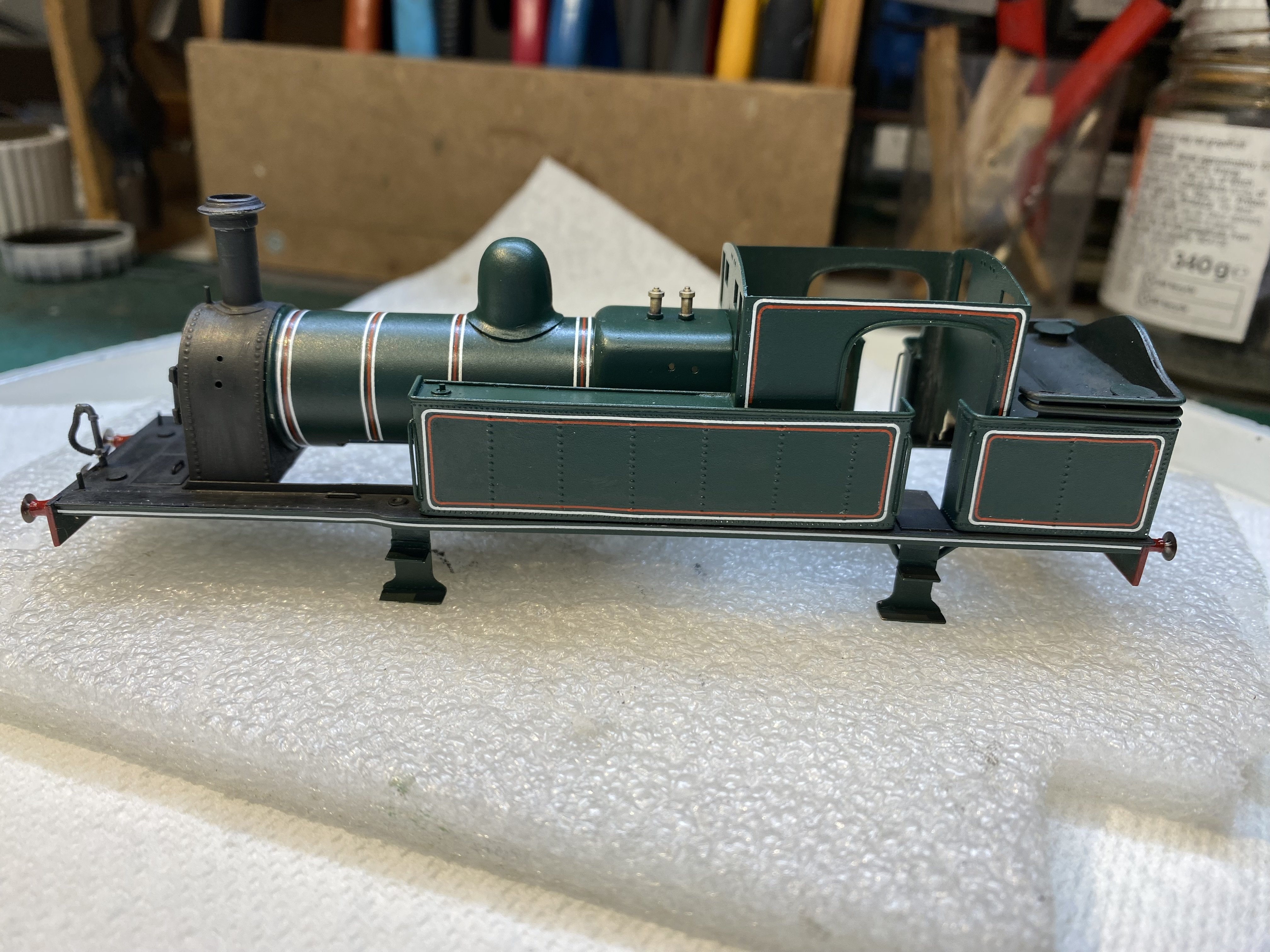

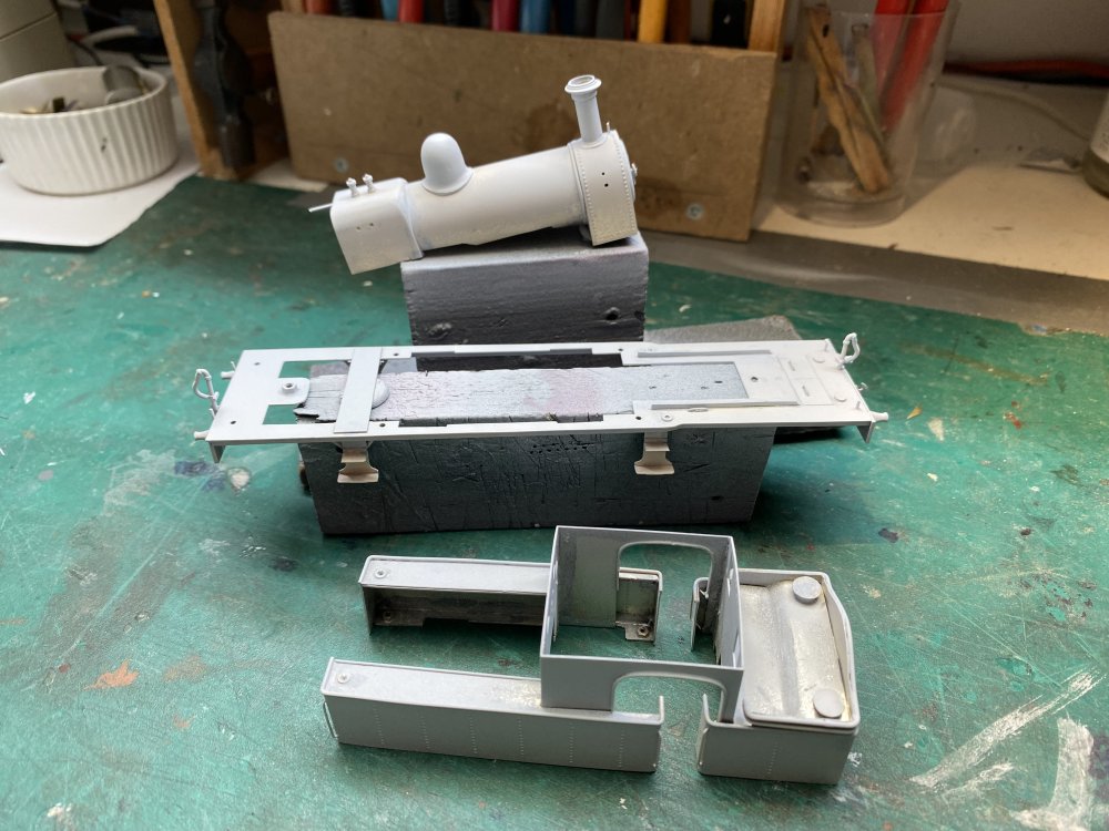

Body bits bolted together after painting and lining ...
... and chassis fitted. Crew hide the lack of inside cab detail, as usual.
Alan
  • Like 11
  • WOW! 4

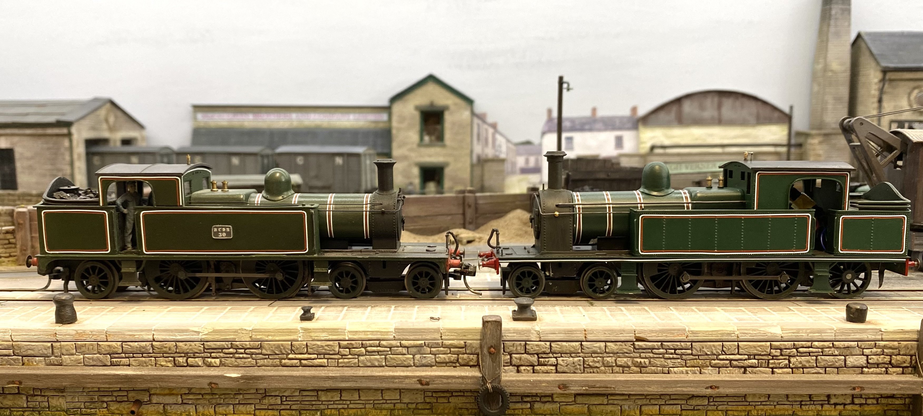

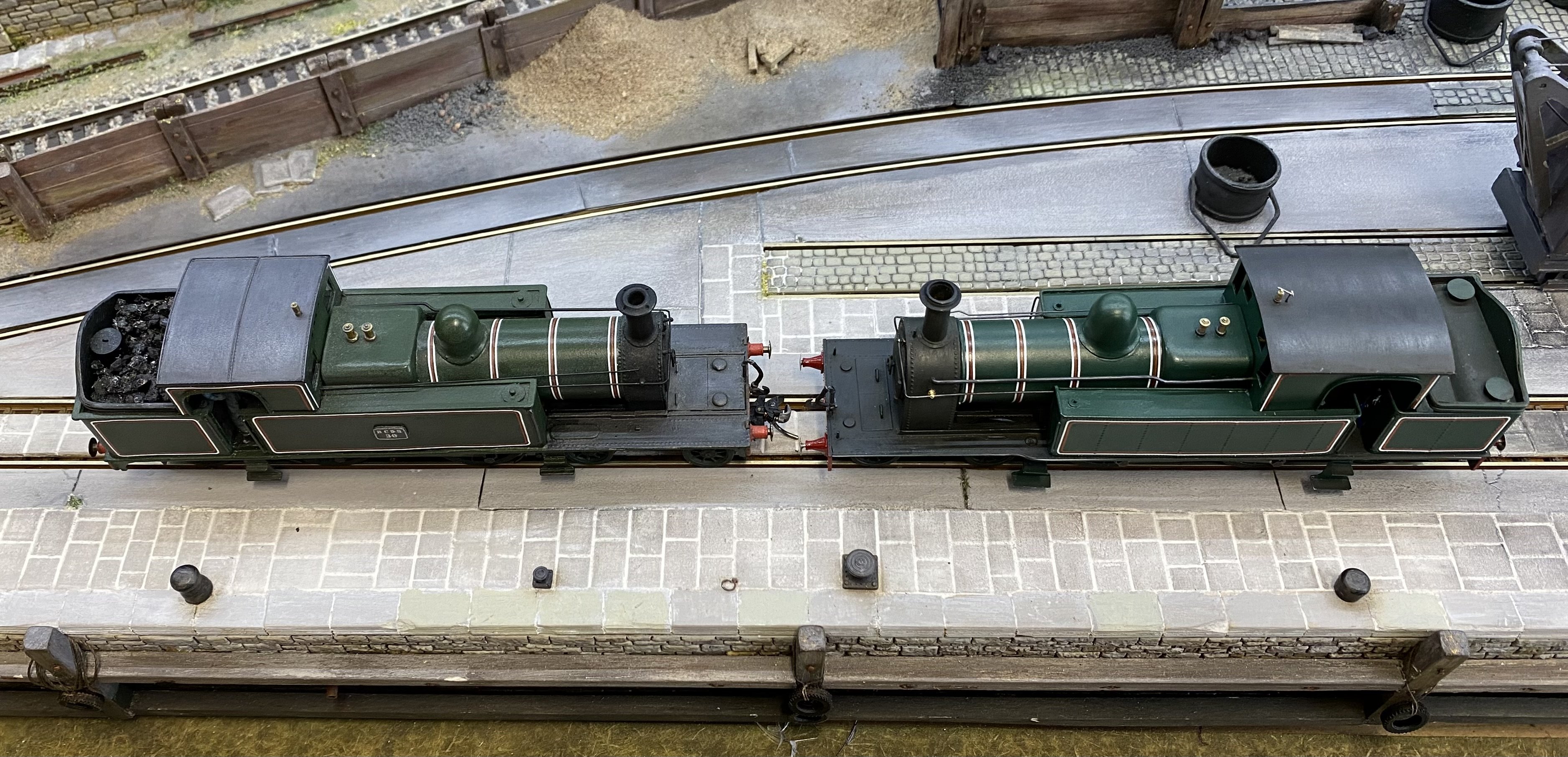

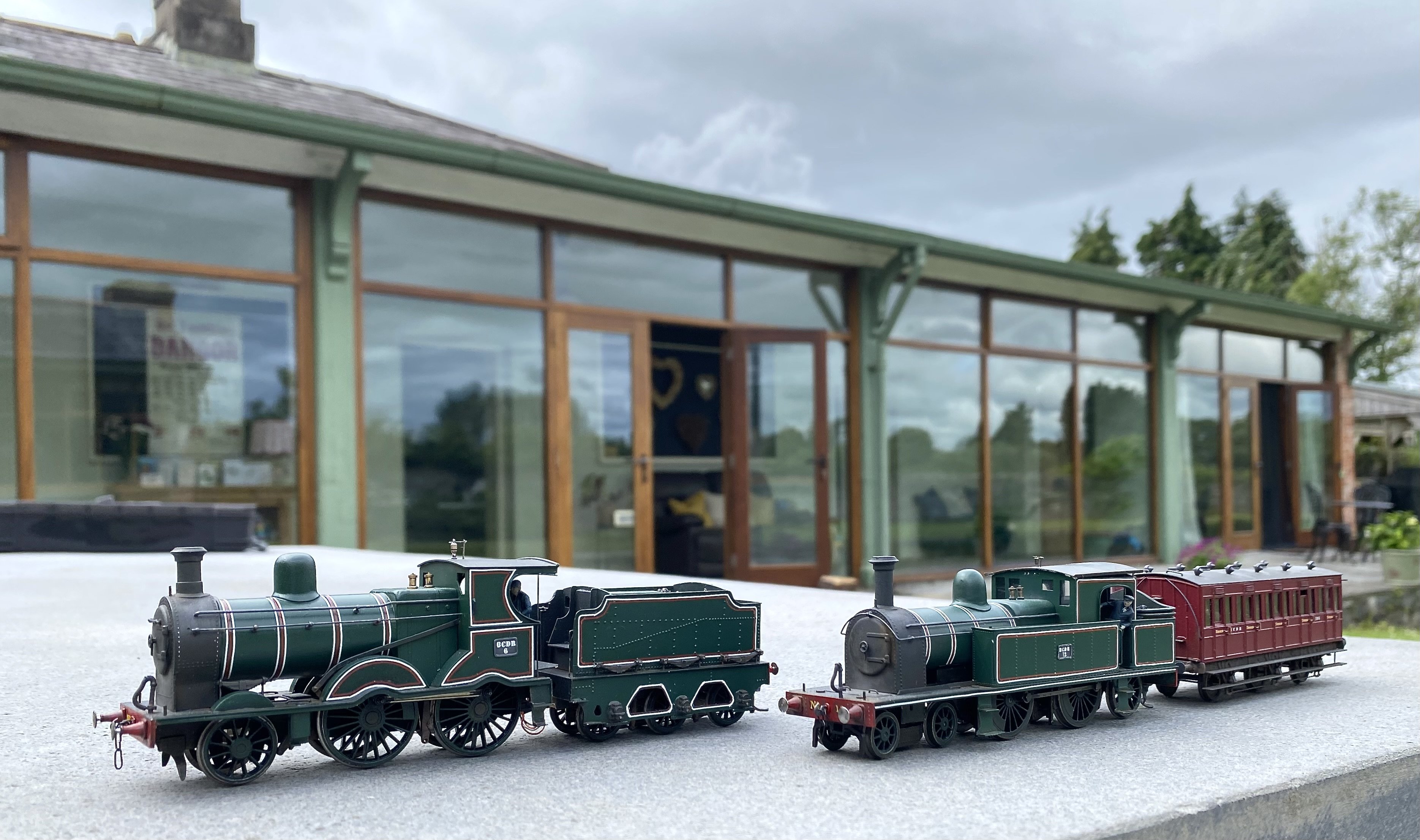

1 hour ago, Galteemore said:
Looks great Alan. Well worth the effort ! Any chance of posing it with version 1?
 Thanks David. Yes, I took these pics a couple days ago. Version 1 with adapted Adams Radial bodywork and unmodified chassis on the left
  • Like 7
The differences are fairly subtle but I think scratch building the body on version 2 got it a bit closer to the look of the prototype. I wish now I'd just scratch built a chassis while I was at it. Wouldn't have been that much more work in the end!😄

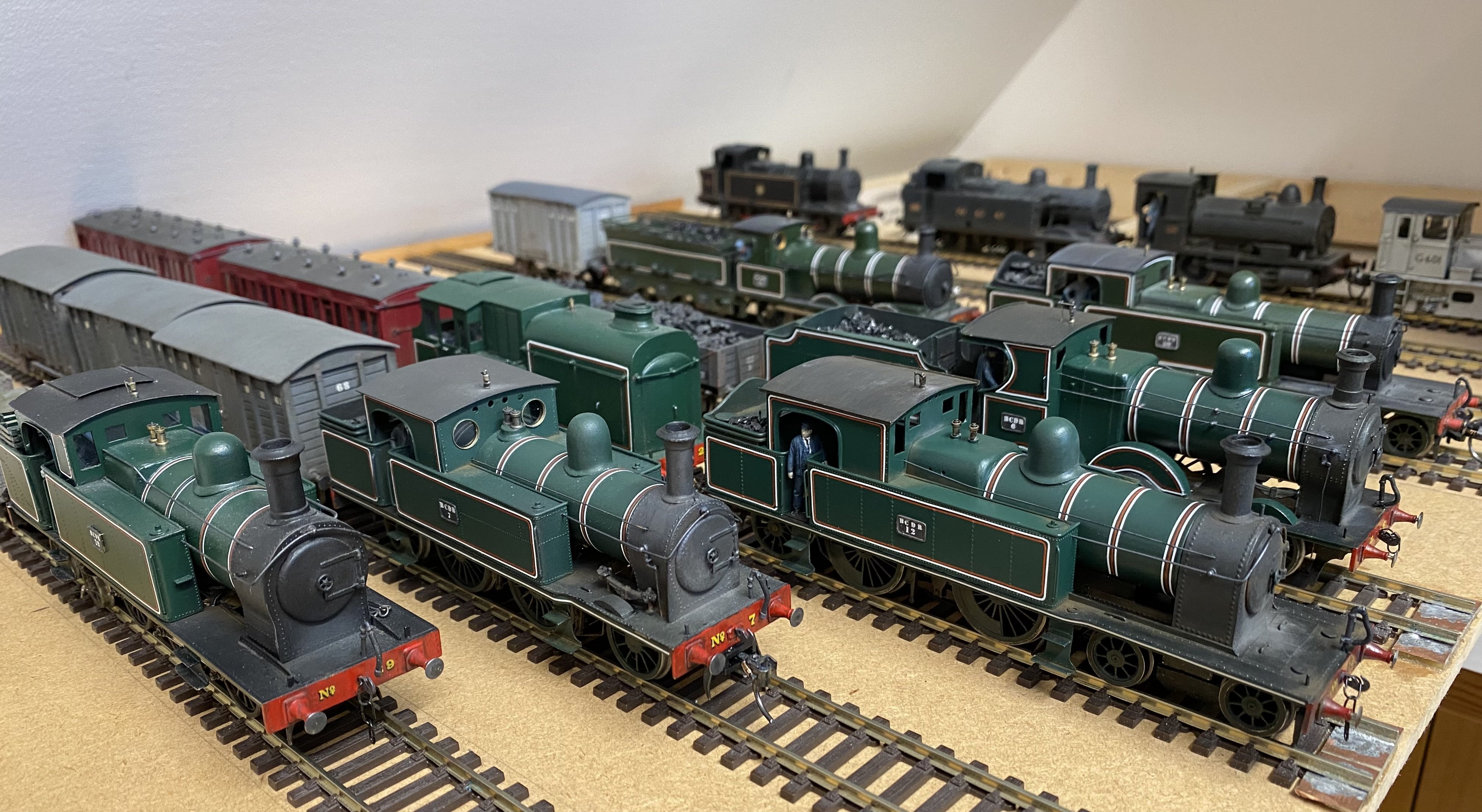

Thanks everyone. Number 12 brings the County Down roster to 7 locomotives. The fitters are saying they've lined out enough locos to do them for a while. Me too.
Back in September 2024 I started out to build a small exhibition layout for this lot to run on but got distracted. I probably should get back to that. In the meantime,  new arrival No.12 is stretching its legs.

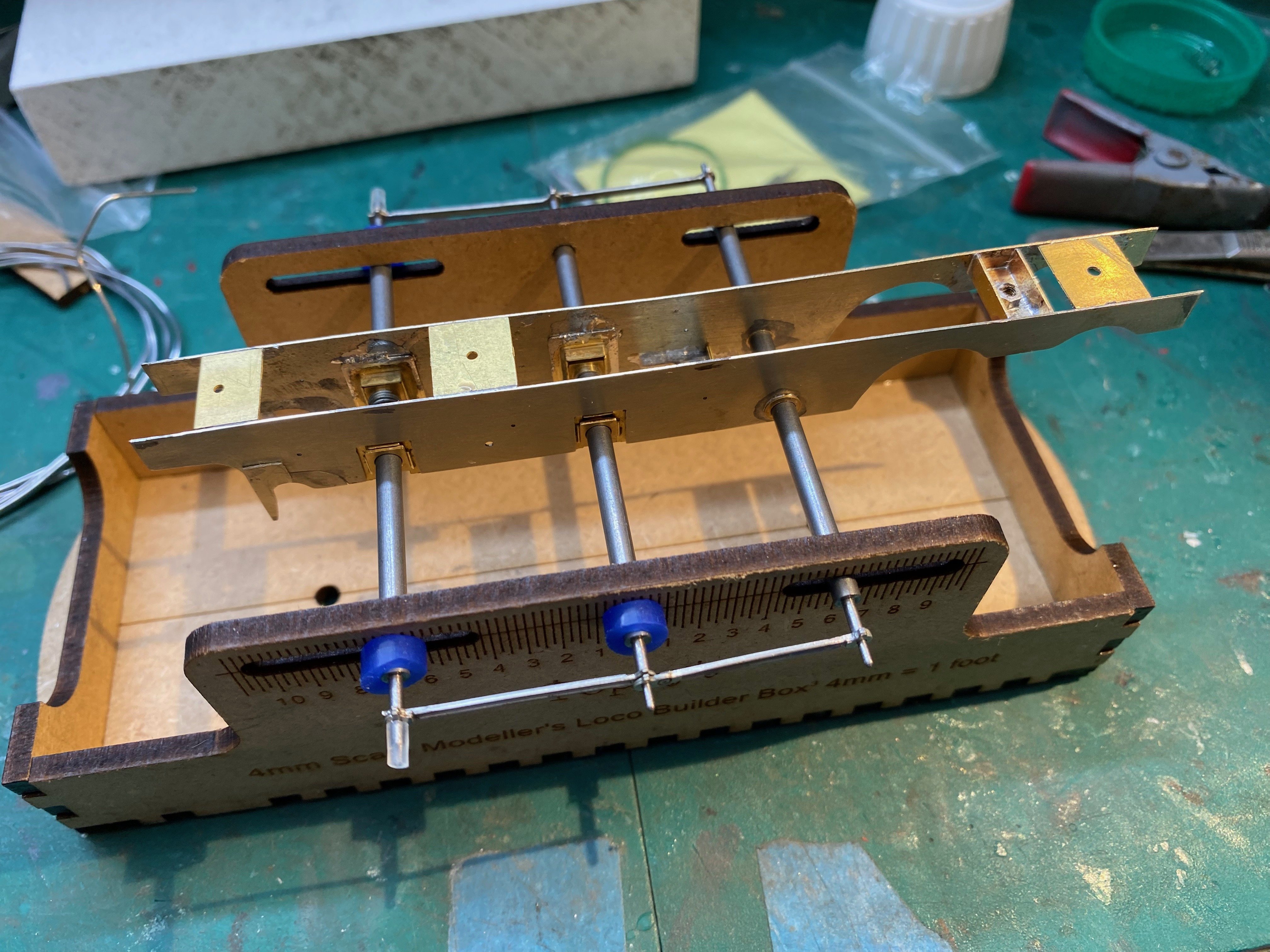

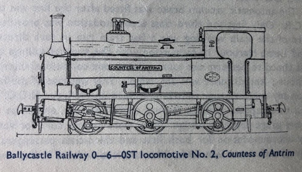

My contribution to the project is a chassis for a proposed model of 0-6-0ST ’Countess of Antrim’, one of three saddle tanks built by Black Hawthorne for the opening of the line in 1879. We have a drawing which we were able to scale using a few known dimensions - wheelbase and wheel diameter principally. We also have some useful photos of the Countess in action and since no-one alive has seen the original, we have a degree of artistic licence to hide behind😄

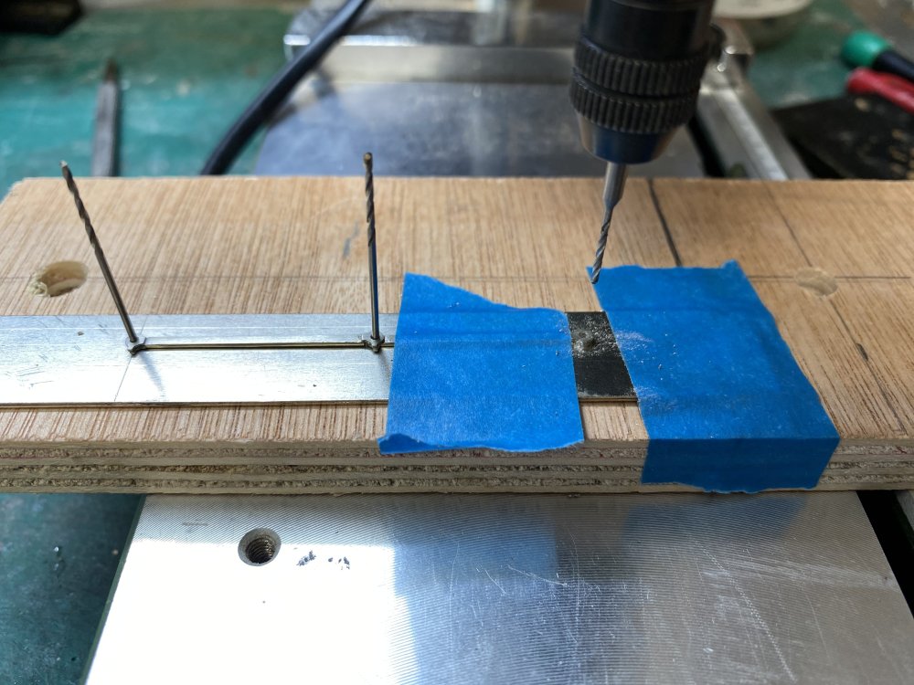

I'm building the chassis using 4mm/ft methods because it's what I know but the techniques should work well enough in the larger scale. The Countess was a fairly small engine. Likewise, 4mm parts fit the bill ok (as long as you're not a spoke counter).

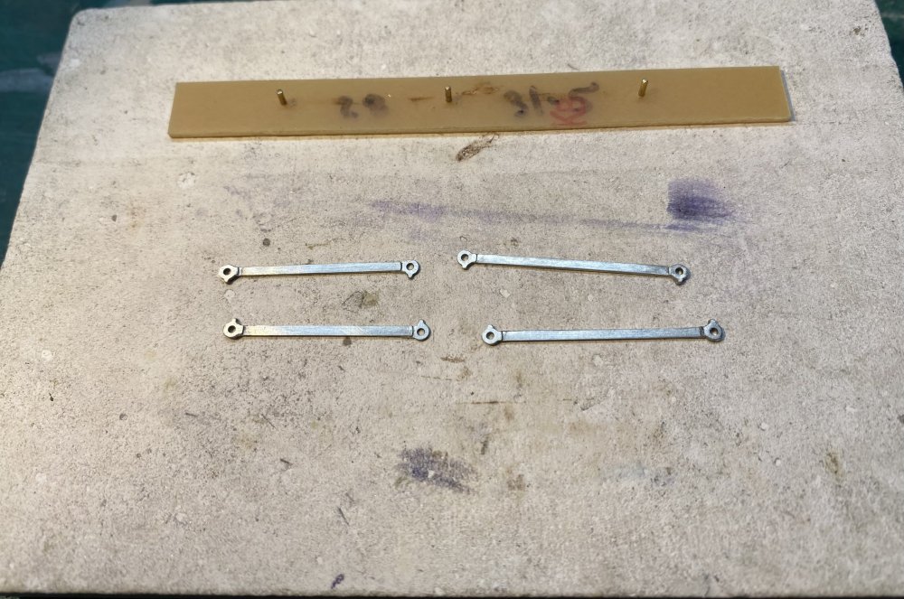

As usual, I started with the connecting rods and made these up from an Alan Gibson universal rods etch on a simple jig.

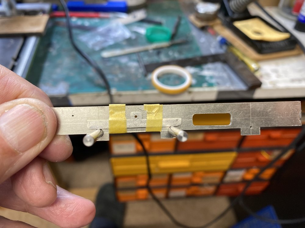

The rods themselves then do duty as jigs to mark and drill 1mm pilot holes for axles on a pair of chassis frame blanks (16 thou nickel silver)

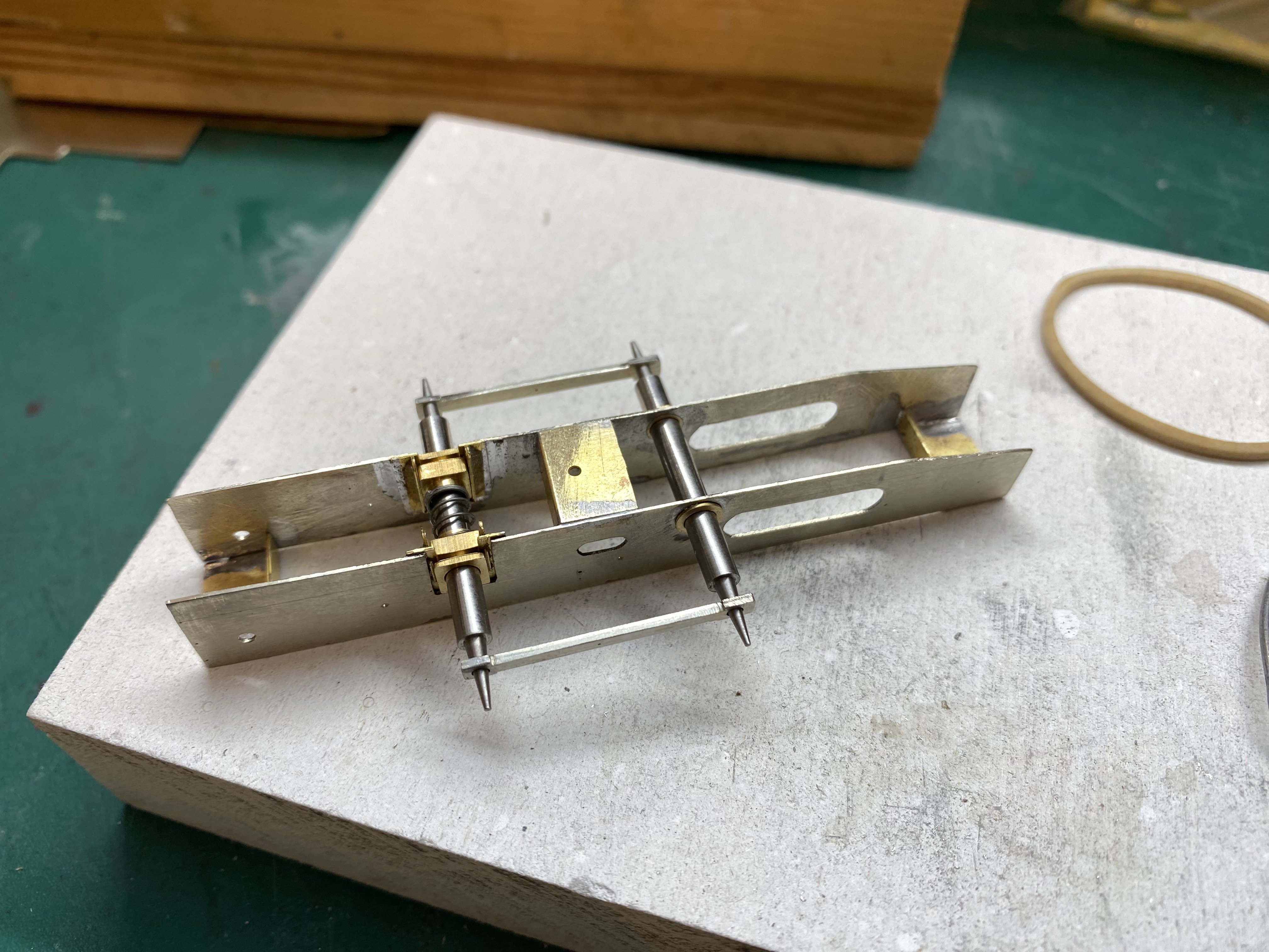

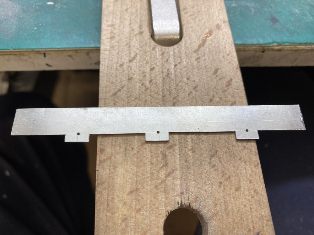

This chassis will be compensated so a compensation beam was next (2 thicknesses of 16 thou nickel silver), with the axle pilot holes opened up to accept a pair of axles so the beam could be positioned touching the axles and the pivot hole drilled through the frames in the right place.
A bit more cutting and filing to accept hornblocks (High Level SpaceSavers) and the frames are almost ready to be separated.

While you are at this stage, Alan, am interested to know about the square cut out in the chassis to take the hornblocks. Can't remember seeing the rationale behind these, but am assuming they don't have to be majorly accurate in terms of their width, because they only get soldered in place once wheels and rods are fitted? Height a different matter, because the top of the cut out is the limit of vertical movement of the compensation?

You're absolutely right David. The top of the hornblock cutout in the frame is the more critical one. The received wisdom is that it needs to be 4mm above the horizontal axle centre line. The width of the cutout is less critical. The High Level hornblocks I use are 5.5mm wide across the fences which guide the square bearing. I usually aim to make the cutout not less than 6mm wide, 3mm each side of the nominal centre point of the axle,  to give me some wriggle room when setting up the chassis
For setup, the connecting rods act as jigs to get the wheelbases right and the extra width in the cutouts allows each hornblock to be adjusted sideways as required. In this respect, it's a more forgiving process than building a rigid chassis. If you've drilled your axle bearing holes in the wrong place for a rigid chassis, it's difficult to correct it.
Latterly I've used a Poppy's Wood Tech jig for setting up but the London Road Models jig axles work just as well.
