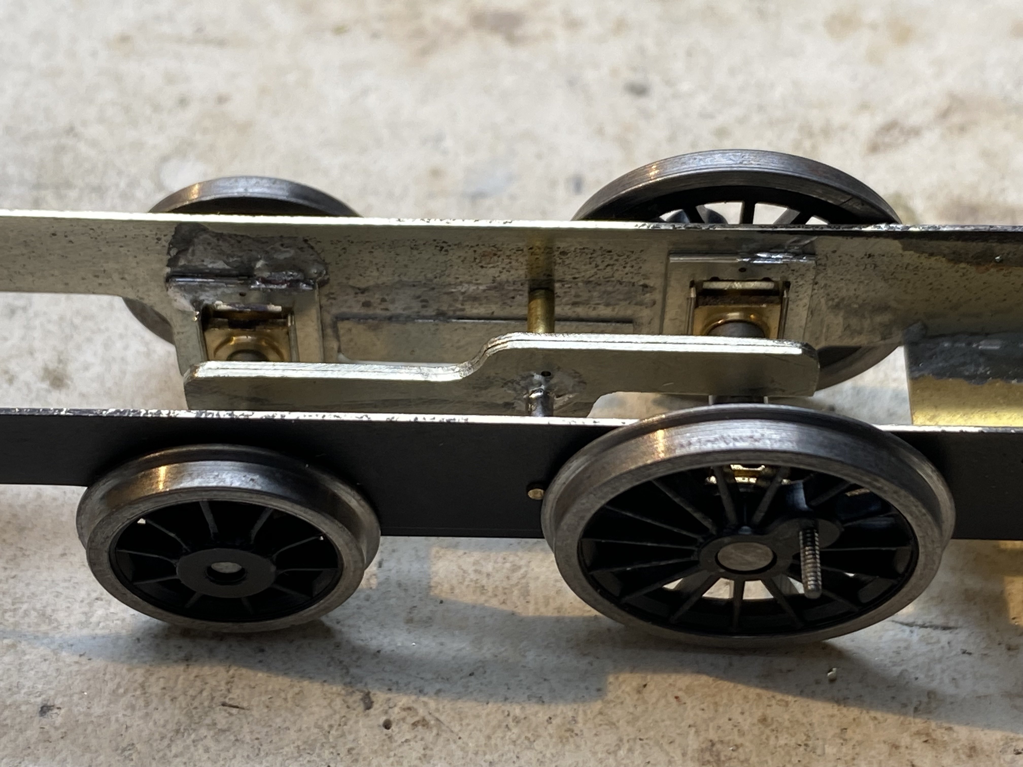

Horsetan Posted June 5 Posted June 5 17 minutes ago, Tullygrainey said: .... with the final drive grub screw loosened, it runs like a sewing machine in both directions.... Could it possibly be that tightening the grub screw knocks the axle slightly off-centre? If so, it may help to file a flat on the axle section where the grub screw makes contact or drill into the axle so that the grub screw can lock in without pushing the axle out of alignment 1
Tullygrainey Posted June 5 Author Posted June 5 4 minutes ago, Galteemore said: Silly question Alan but are all the wheels back in the same locations as before painting? That may lie at the root of this Not silly at all David. Yes they are. They were painted in situ though I've just now taken them off and re-fitted them. 2 minutes ago, Horsetan said: Could it possibly be that tightening the grub screw knocks the axle slightly off-centre? If so, it may help to file a flat on the axle section where the grub screw makes contact or drill into the axle so that the grub screw can lock in without pushing the axle out of alignment That's an interesting thought. Worth a try. I originally spacered the back axle so there was zero sideways movement. I've now taken the spacers out to allow it a bit more freedom. It seems to have improved things a bit.
Tullygrainey Posted June 5 Author Posted June 5 (edited) I think it’s been a catalogue of things, among them wheels out of true and a possible bent crankpin. Anyway it’s performing better now so I’m about to tiptoe quietly away for now. many thanks for the support lads Edited June 5 by Tullygrainey 4 1

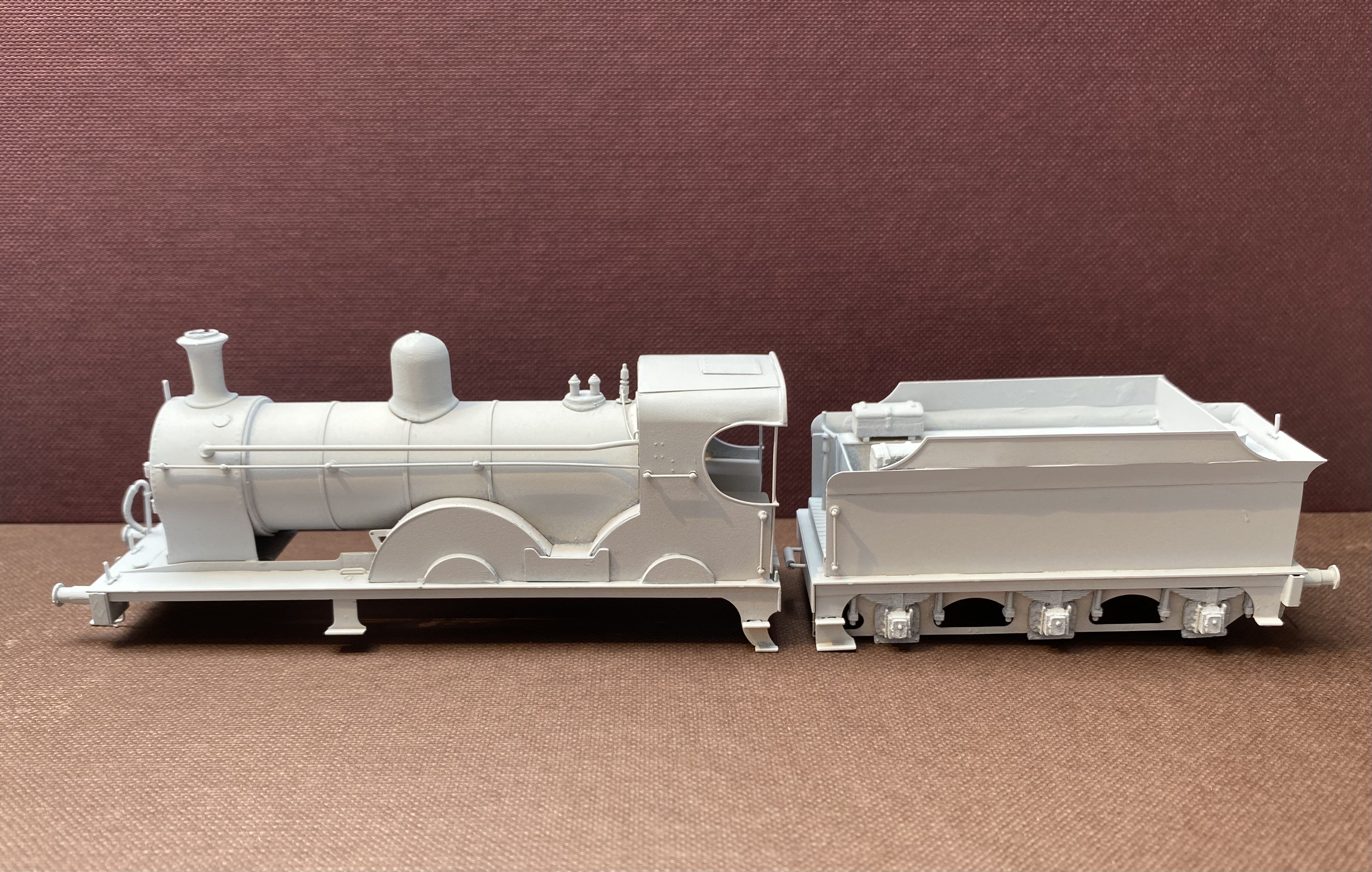

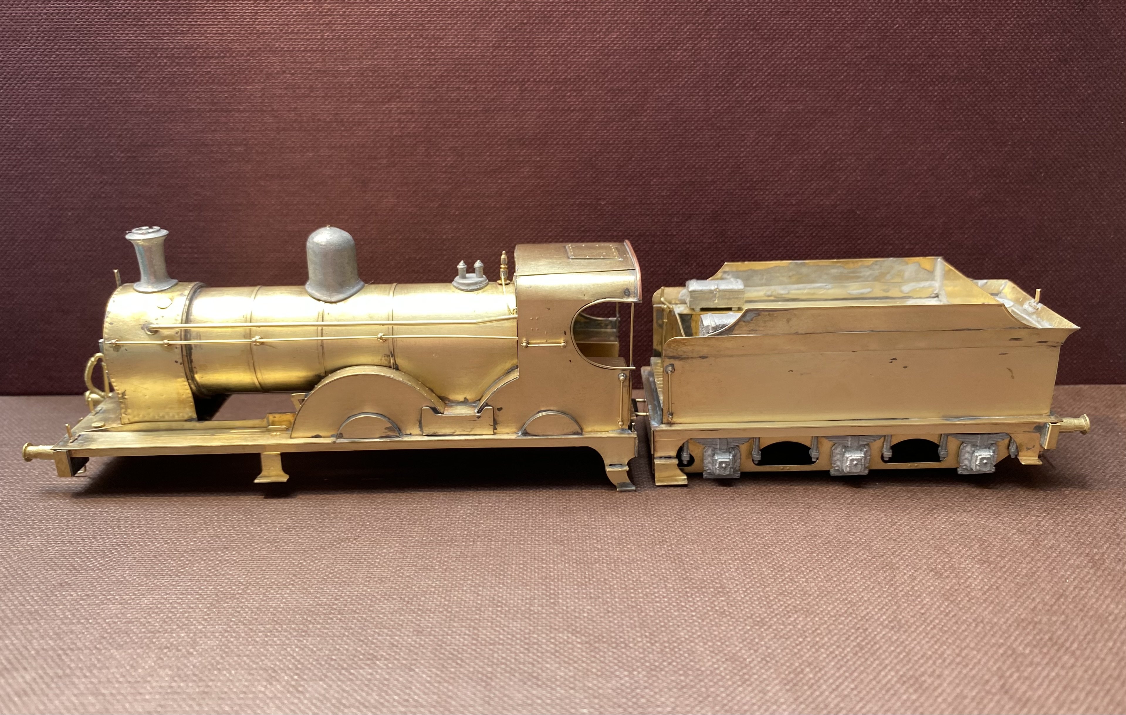

Tullygrainey Posted June 14 Author Posted June 14 Time for ThreePee to get a workout on the rails Clattering through some Peco three-way points without falling off... IMG_5205.mov ... and stretching its legs at Kirley Junction. Thanks Kieran. ThreePee at Kirley J.mov Scrubbed up and ready for primer.... .. et voilà! Nearly time to go to its owner Patrick @Patrick Davey for top coats. I'll refit the chassis after that's done. Alan 5 4

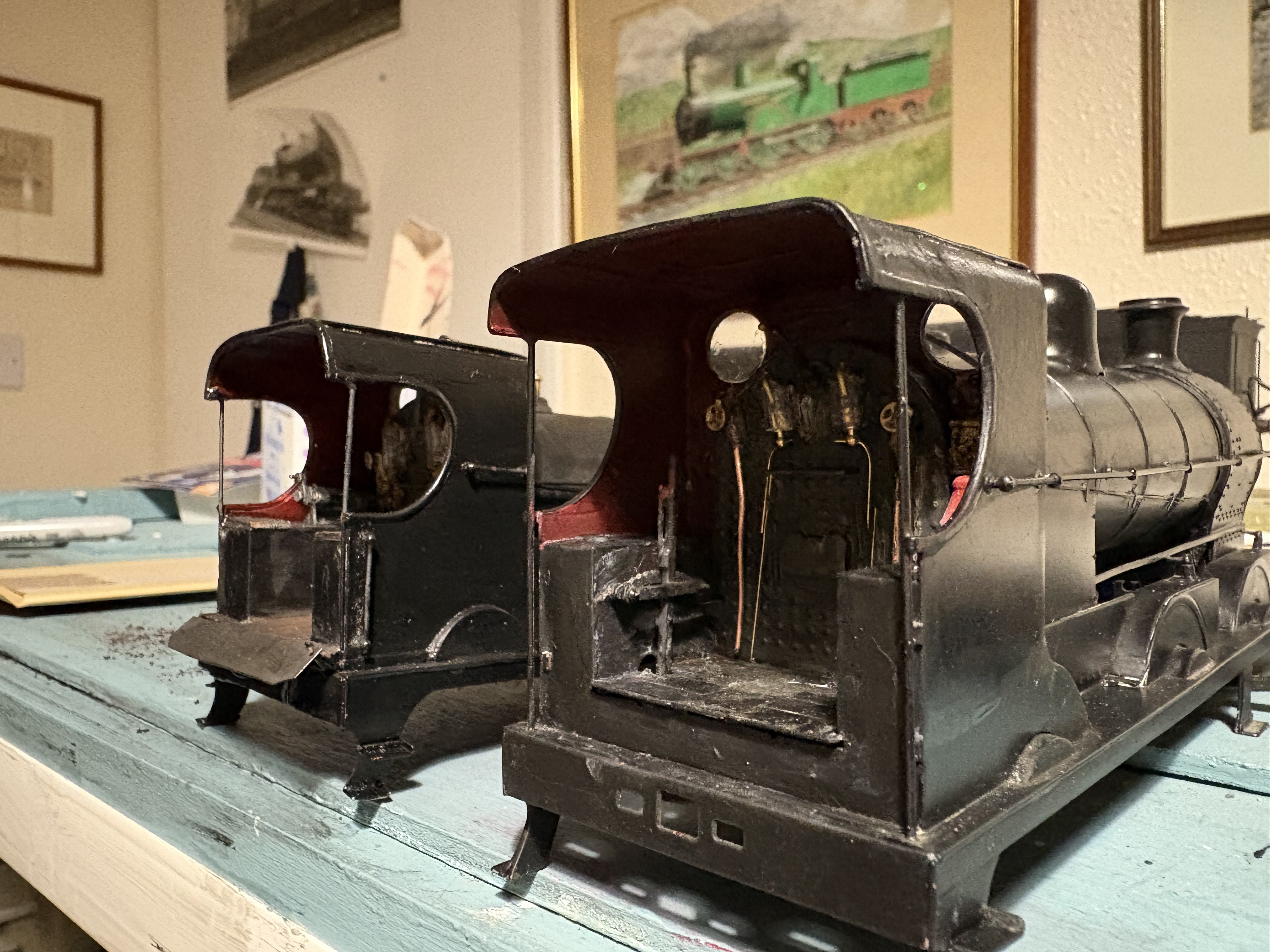

Patrick Davey Posted June 14 Posted June 14 Fabulous work Alan, am very grateful! Of course she will be finished in all-black livery but can anyone tell me what colour the inside of the cab walls should be? Ta
Galteemore Posted June 14 Posted June 14 (edited) Red or light brown. I went with red ! Edited June 14 by Galteemore 5 1
Patrick Davey Posted June 14 Posted June 14 The red looks the part! Cheers David And excellent inspiration for the cab interior - not as much room in the smaller scale but I'll have a go! 1

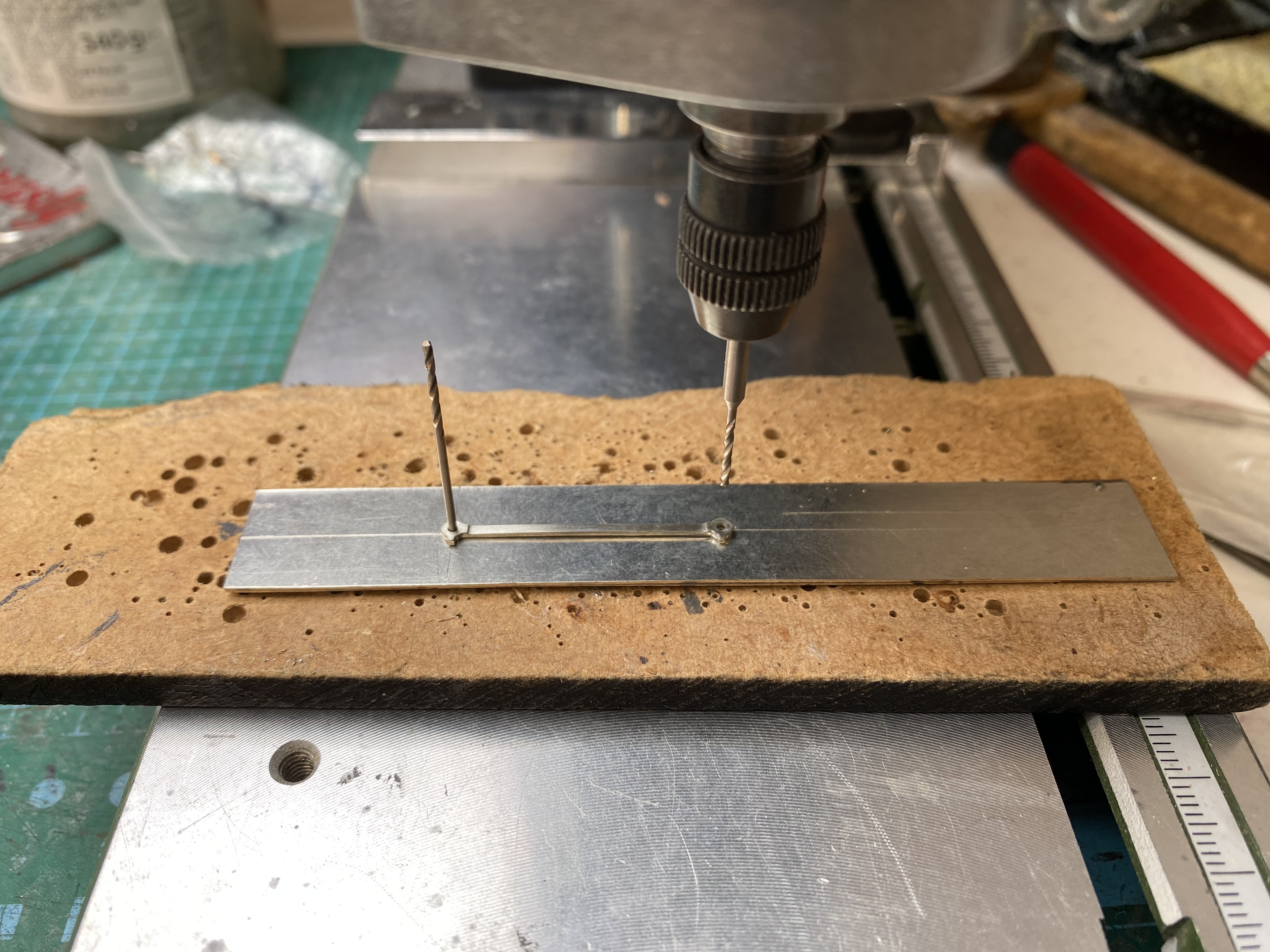

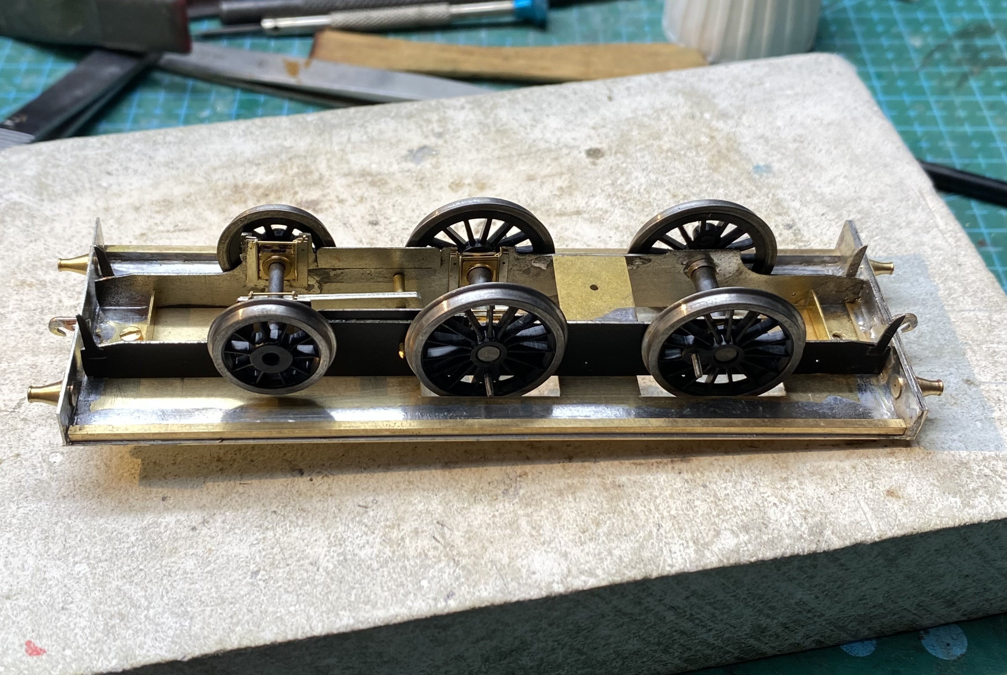

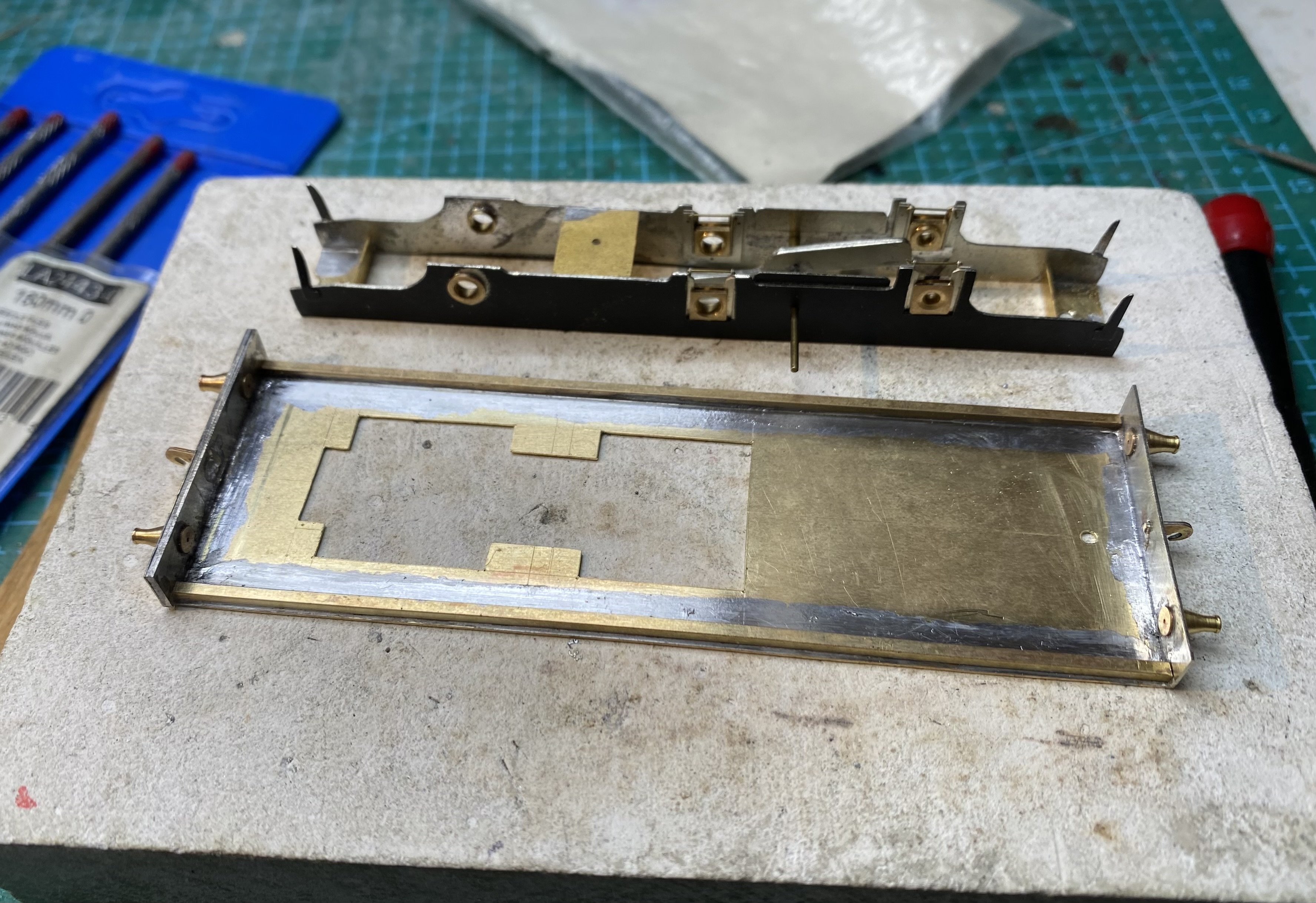

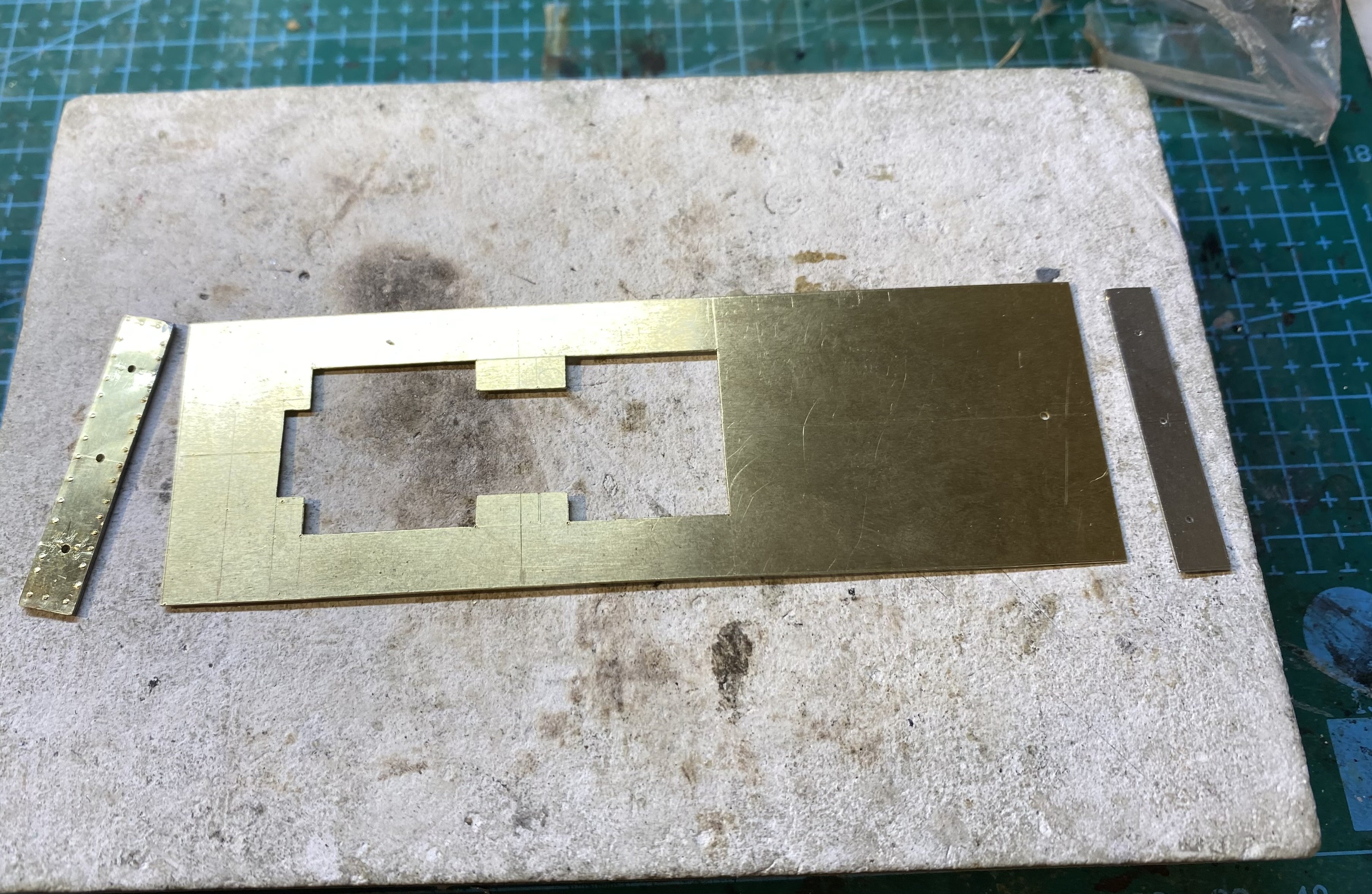

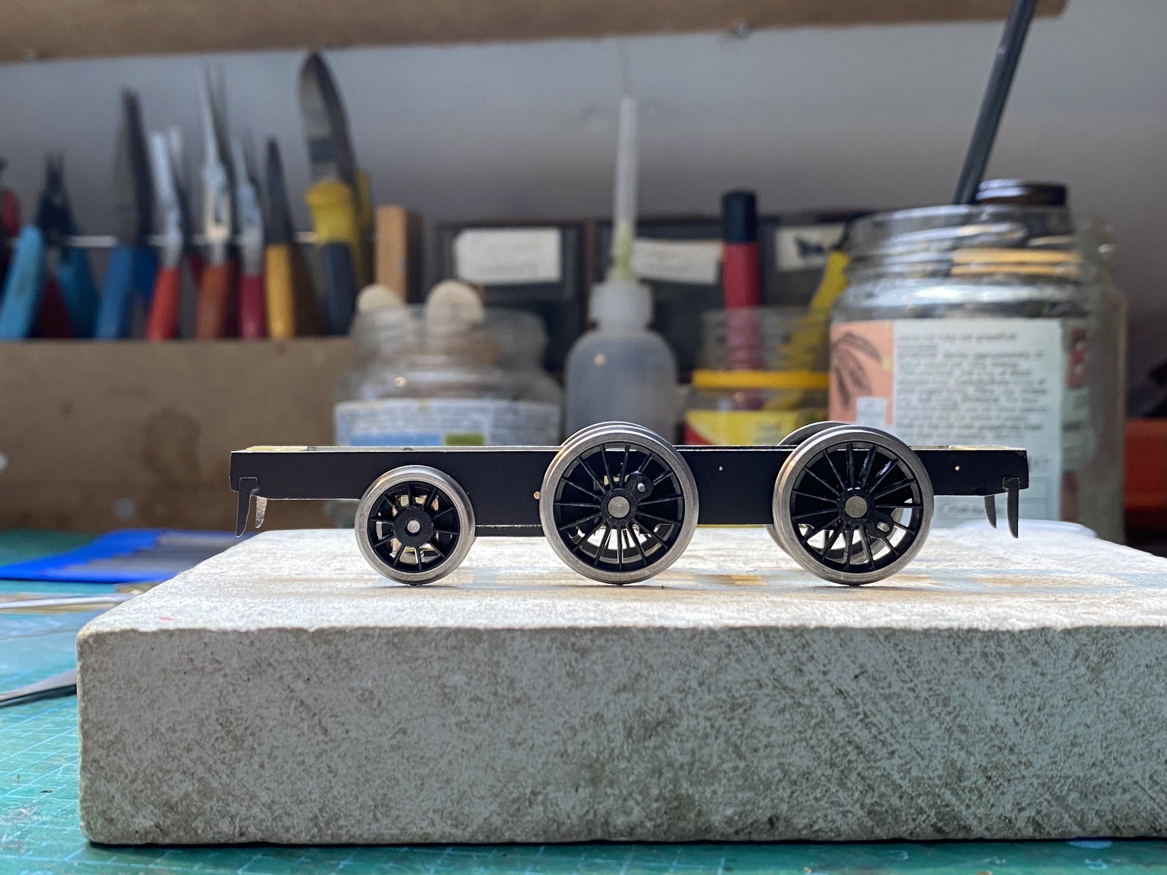

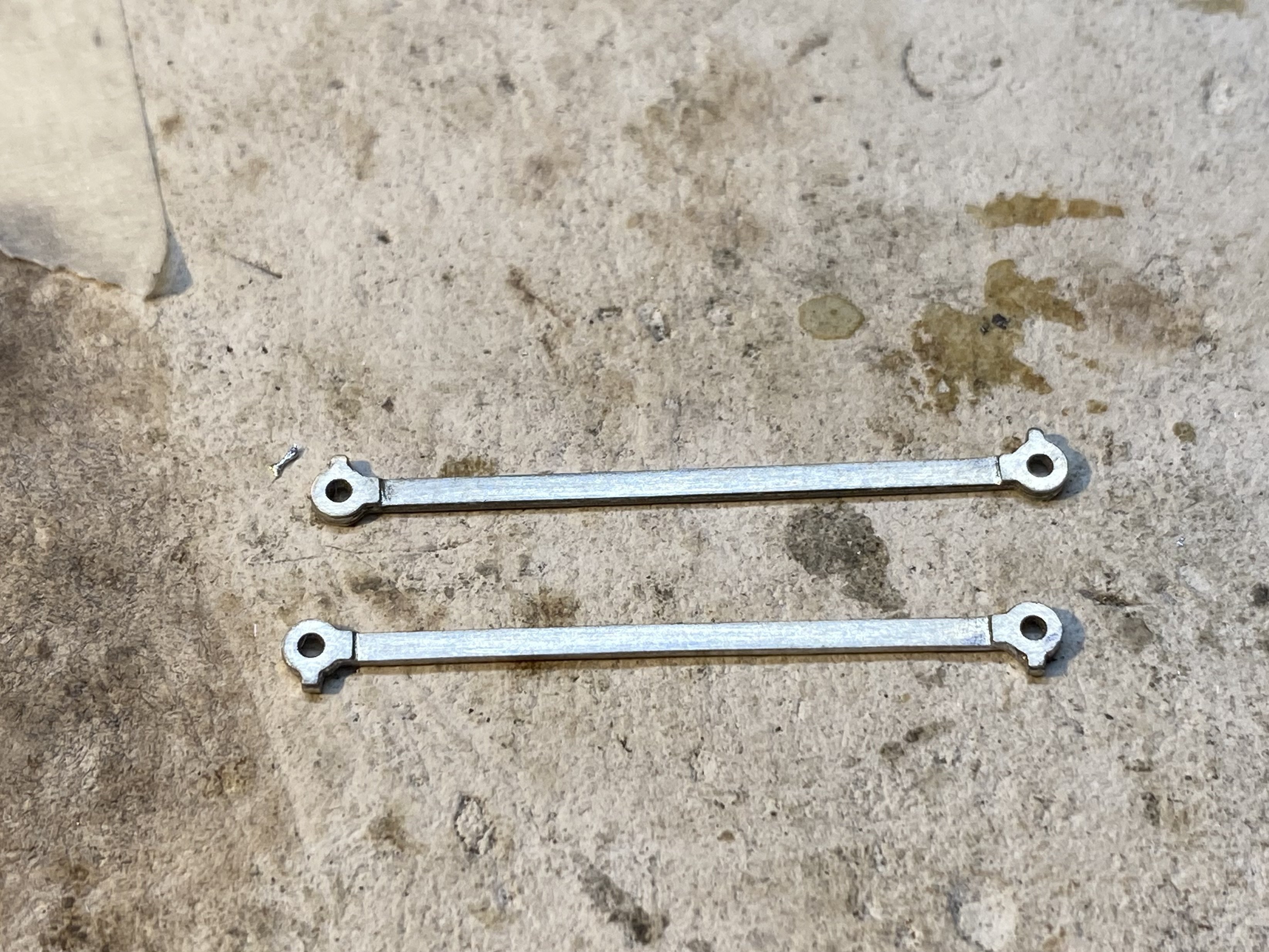

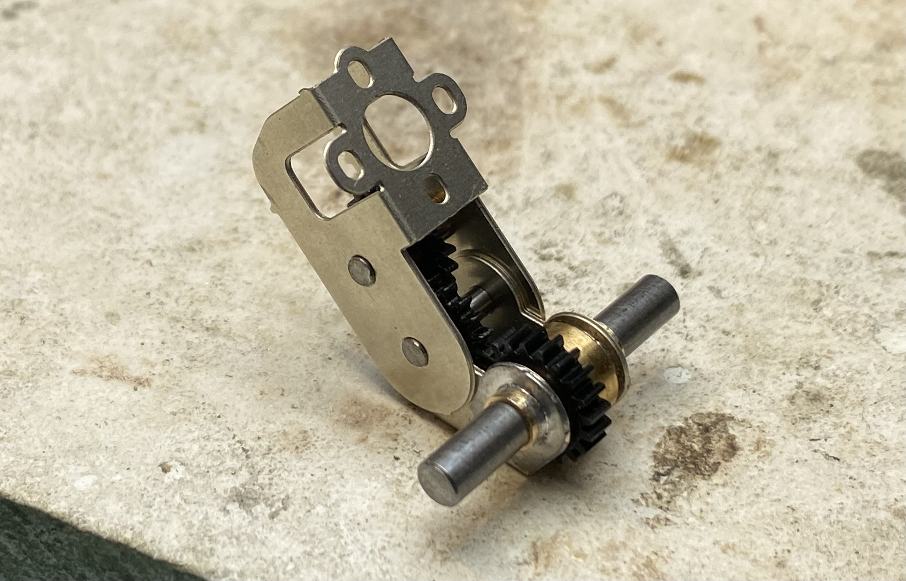

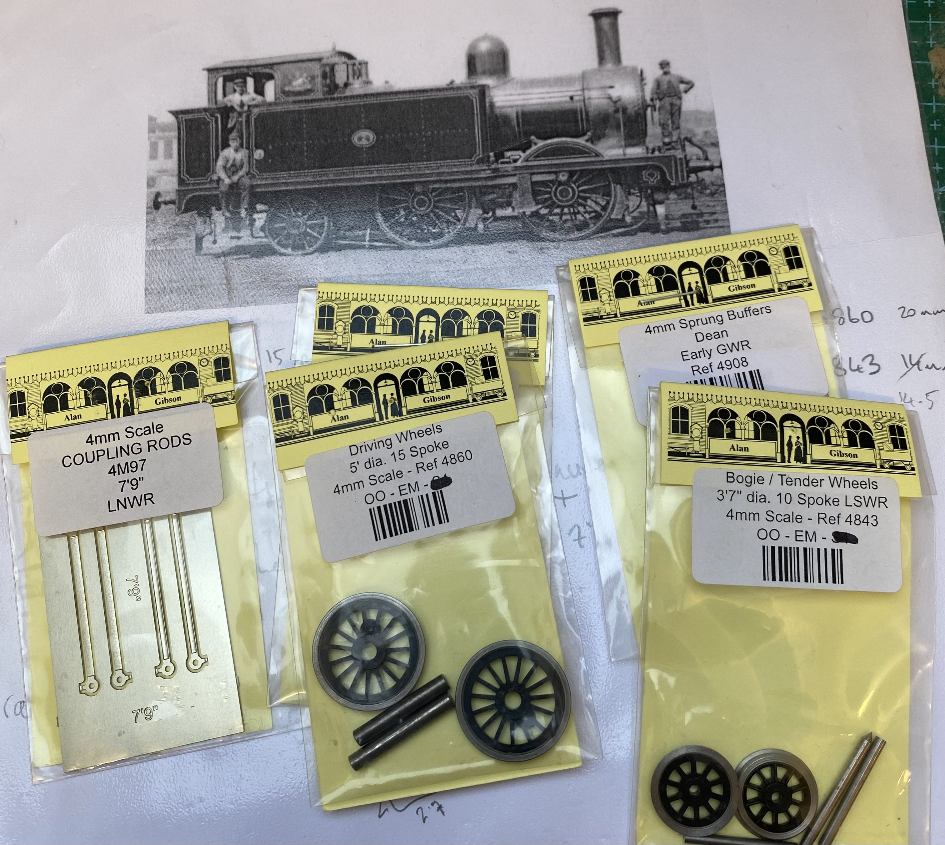

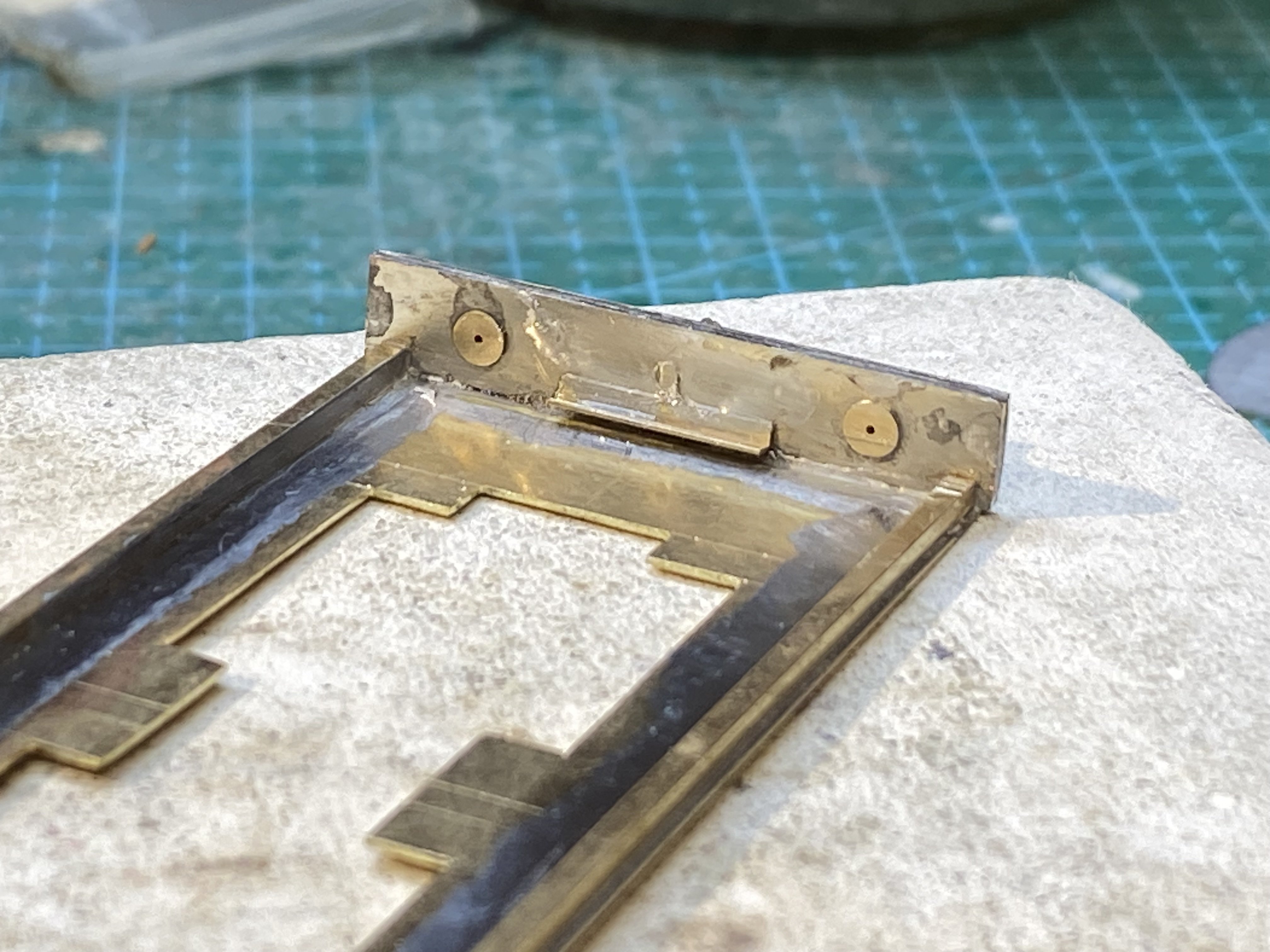

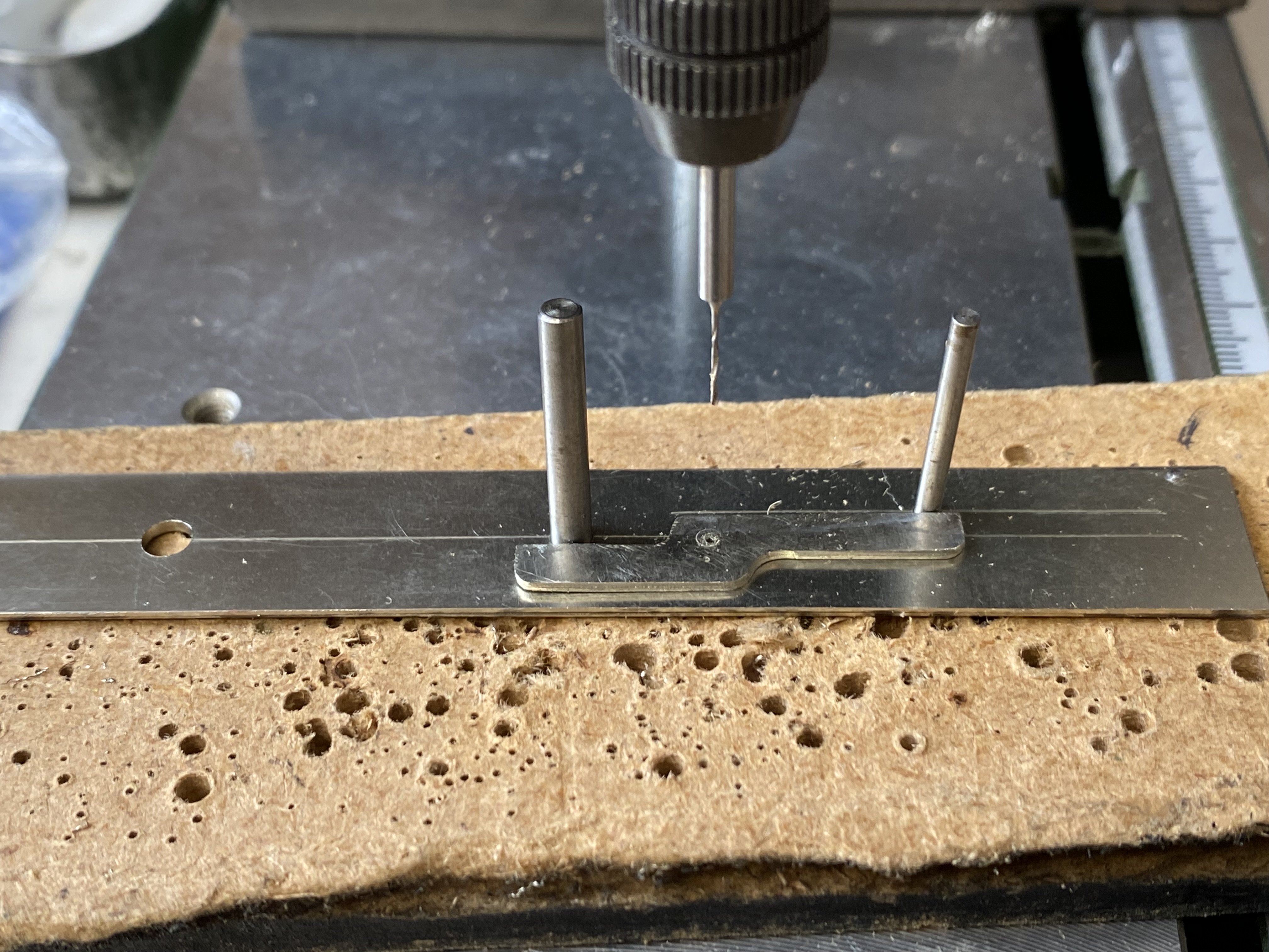

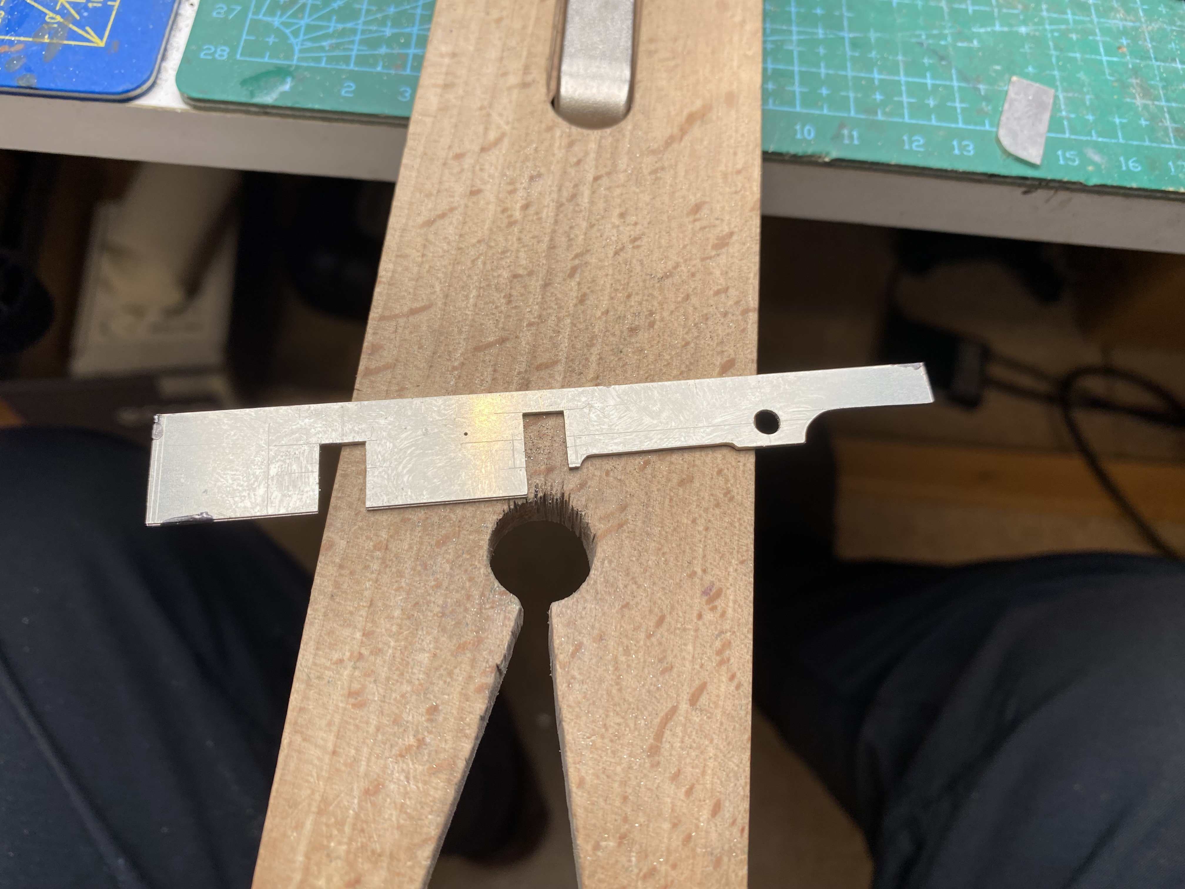

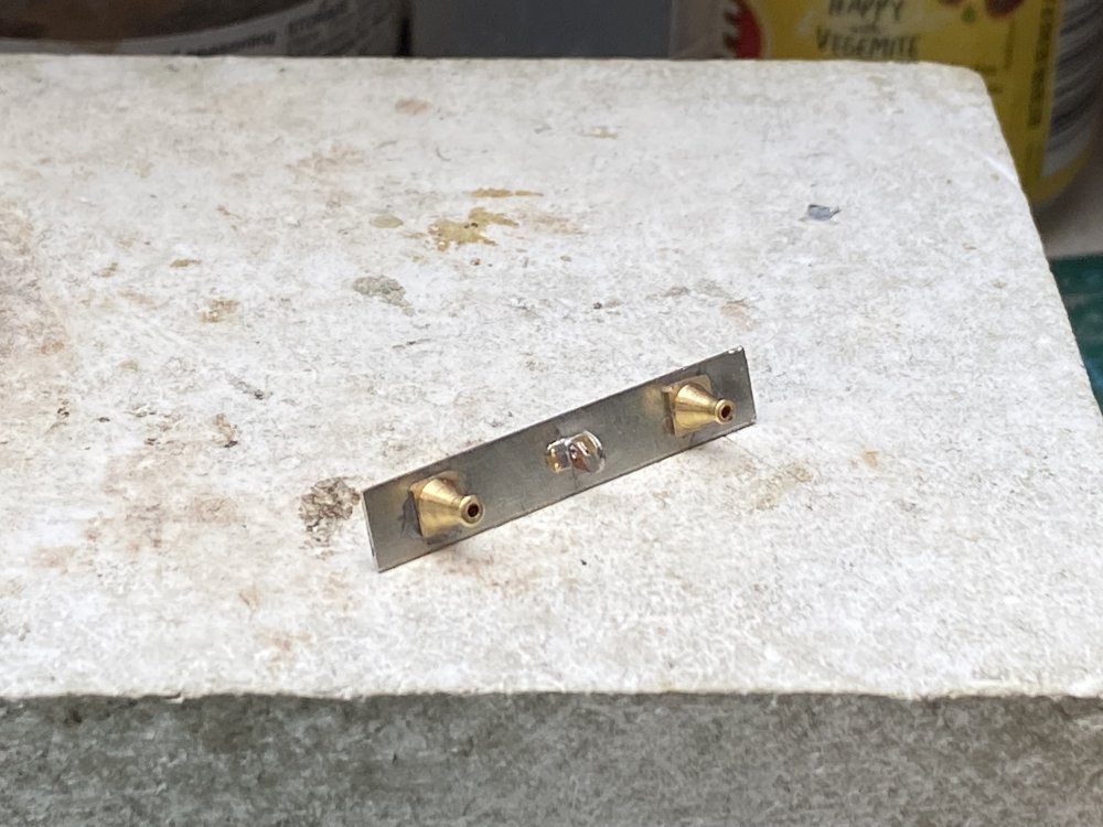

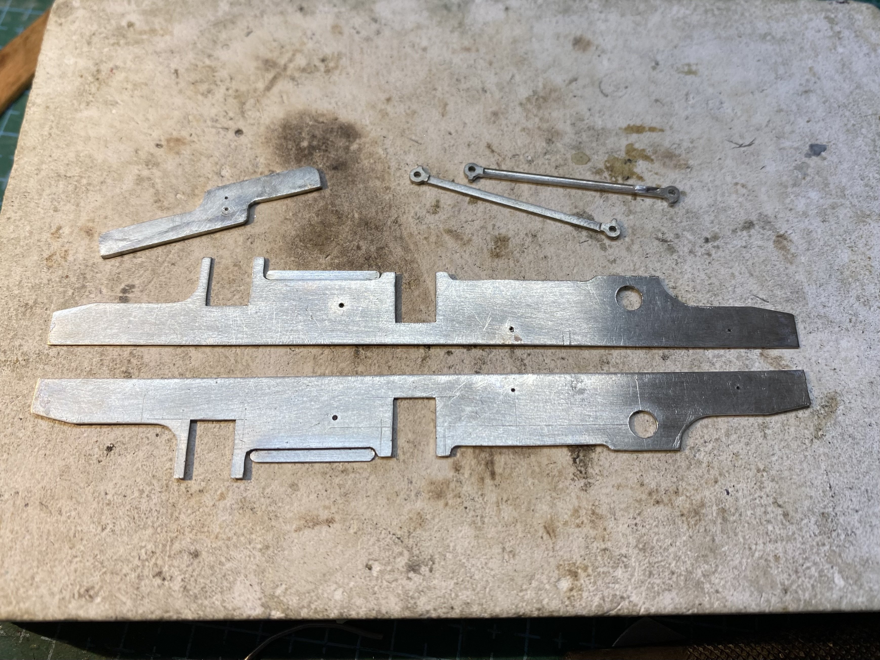

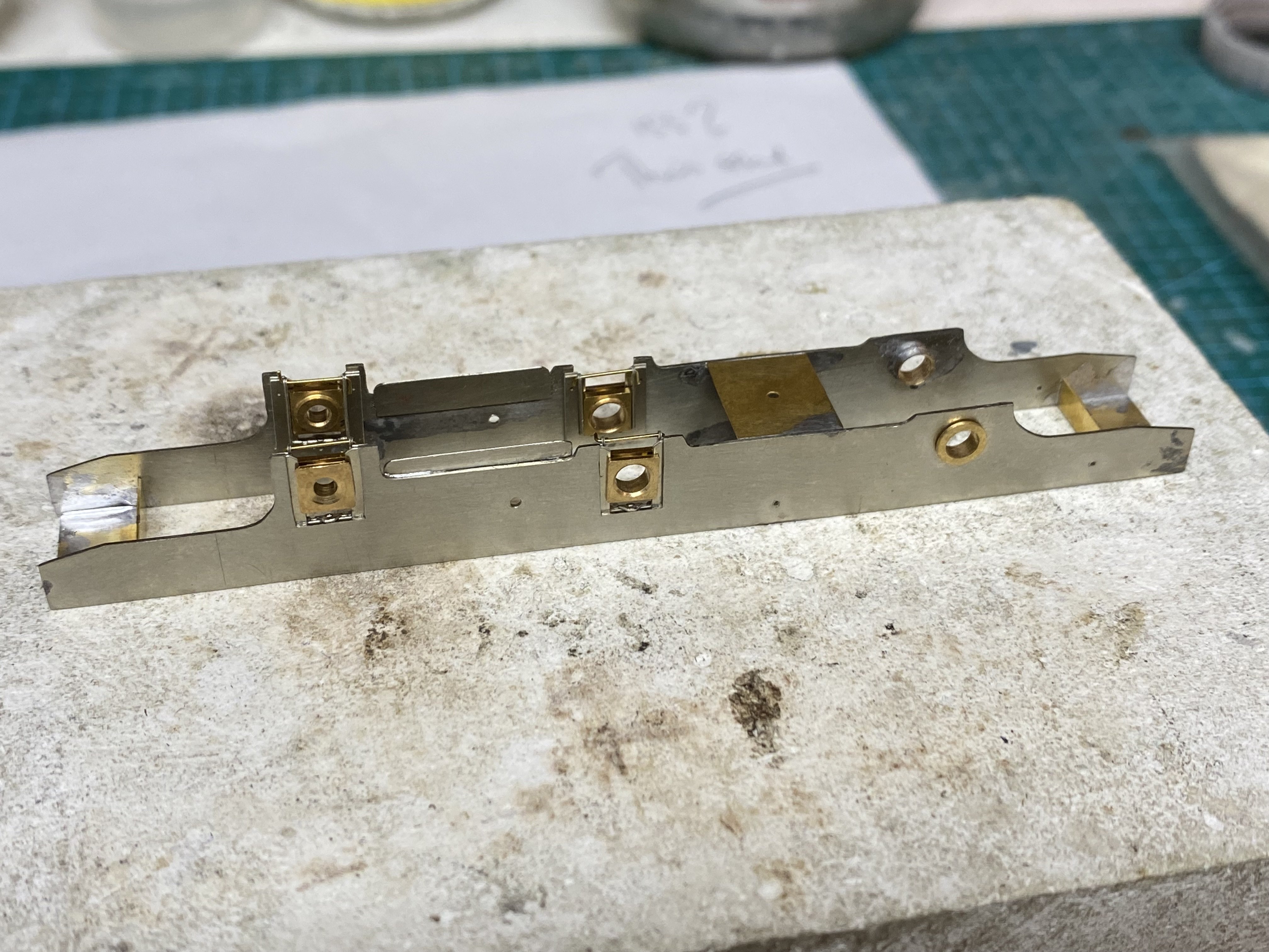

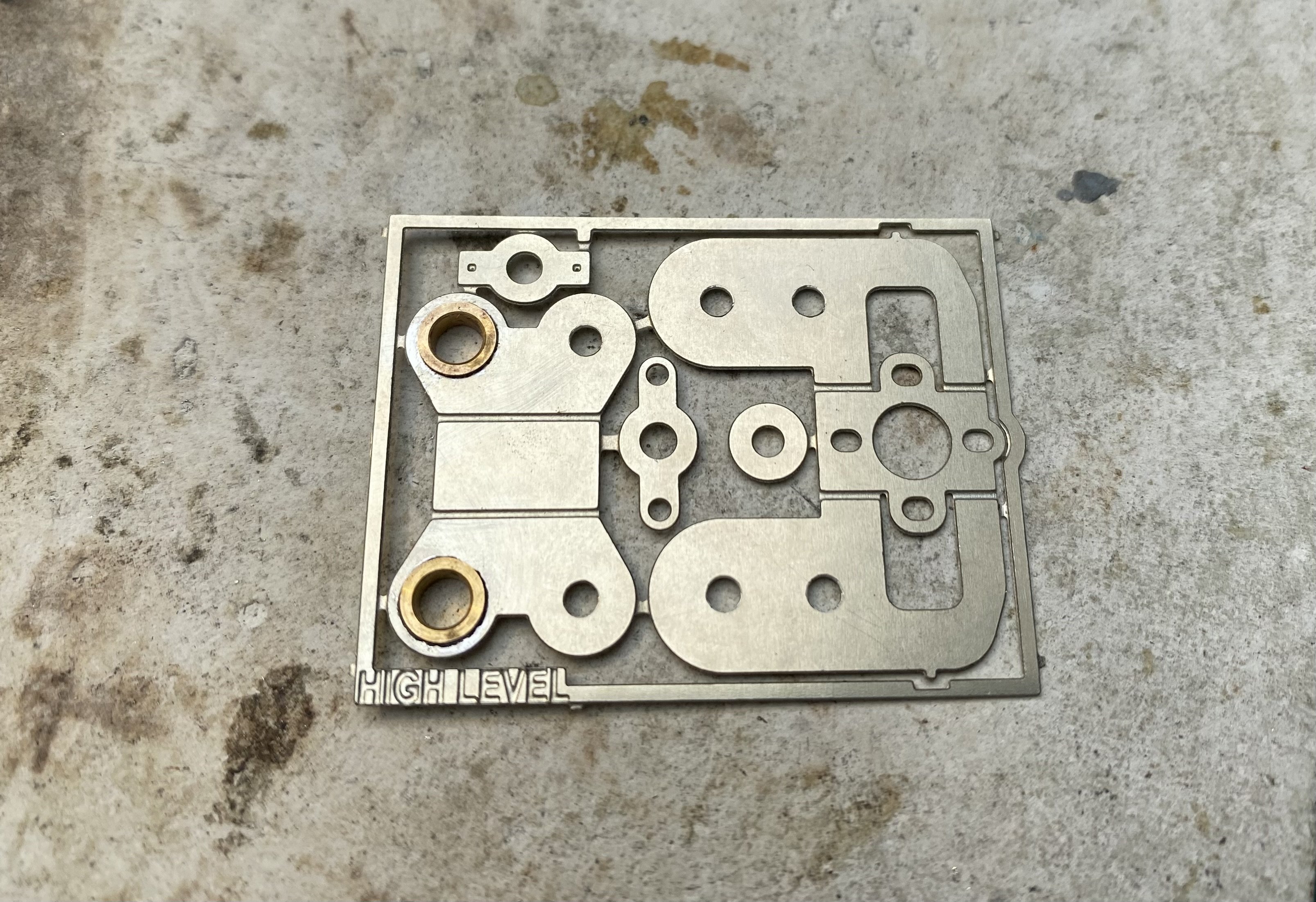

Tullygrainey Posted Sunday at 22:57 Author Posted Sunday at 22:57 I already have more BCDR locomotives than can fit on the traverser at Kilmore but that's no reason not to build another one This is old Number 9, built by Sharp, Stewart as a tender engine in 1887, rebuilt as a tank engine in 1900. It survived into UTA ownership. Coupling rods made first. A set of LNWR etches from Alan Gibson are the right length, saving a lot of cutting and drilling. Drilling pilot holes for the driving axles in a pair of chassis frame blanks... drilling a pivot hole for a compensation beam.... shaping the frames... and erecting the chassis. I'm planning to drive this one from the front coupled axle. High Level SlimLiner+ gearbox for this one. So far, so good Alan 9 5
