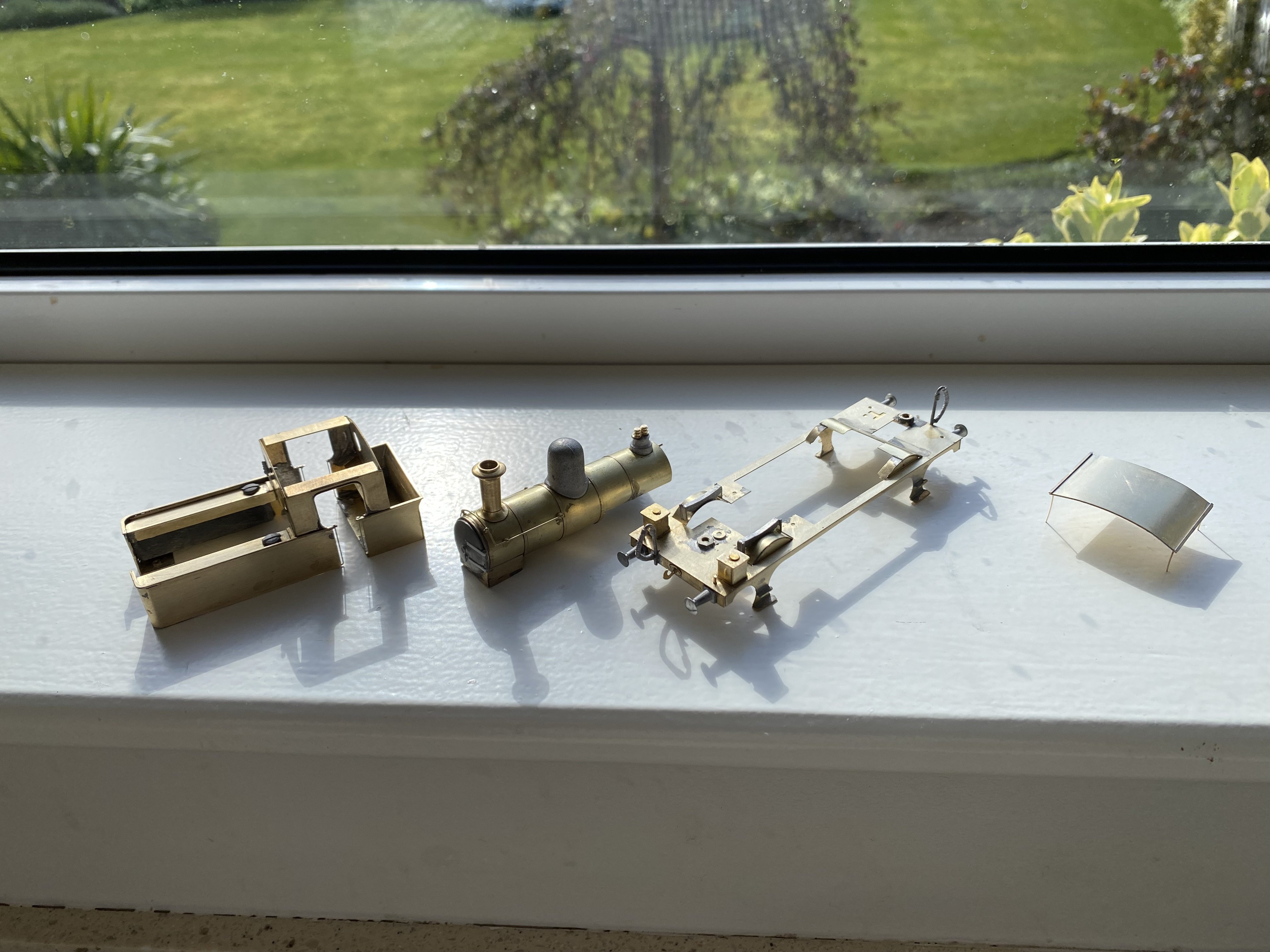

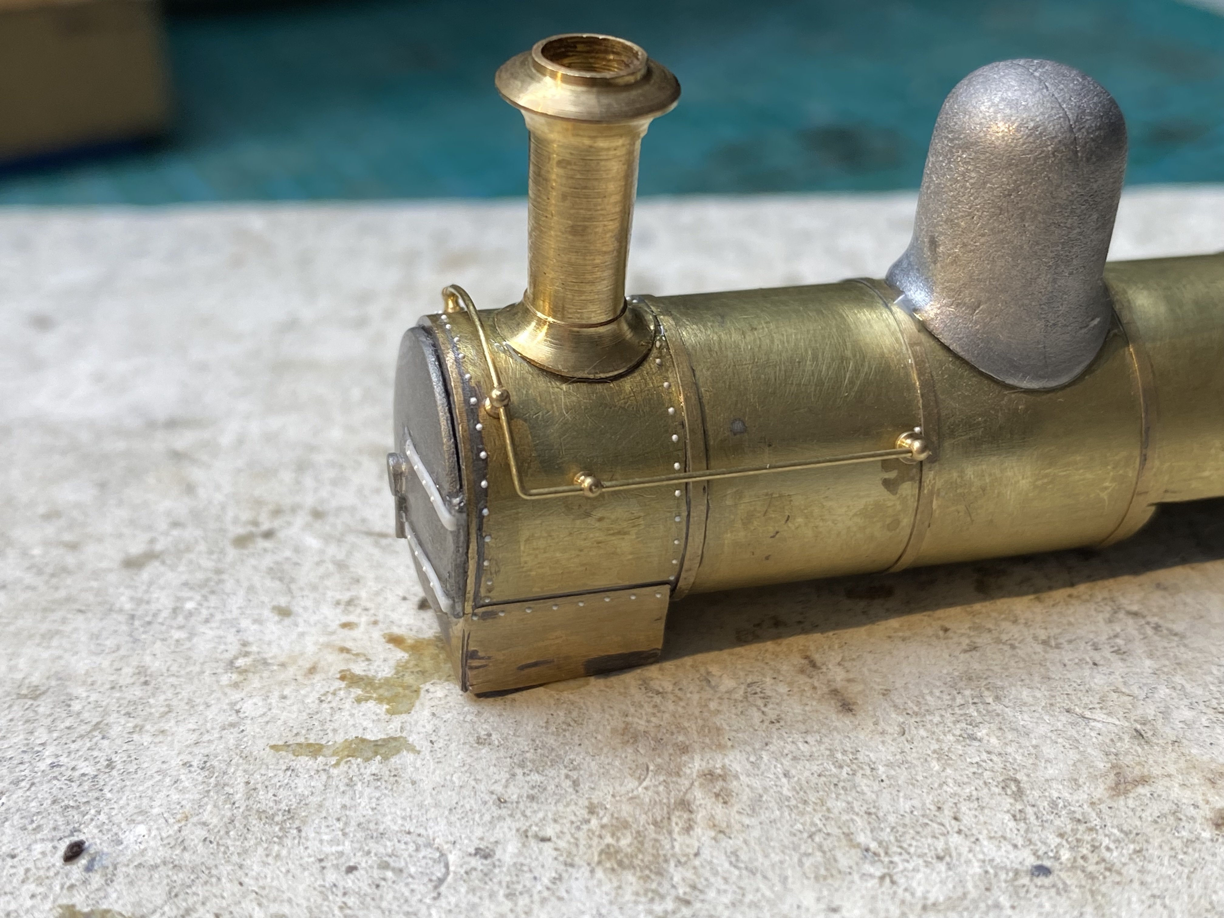

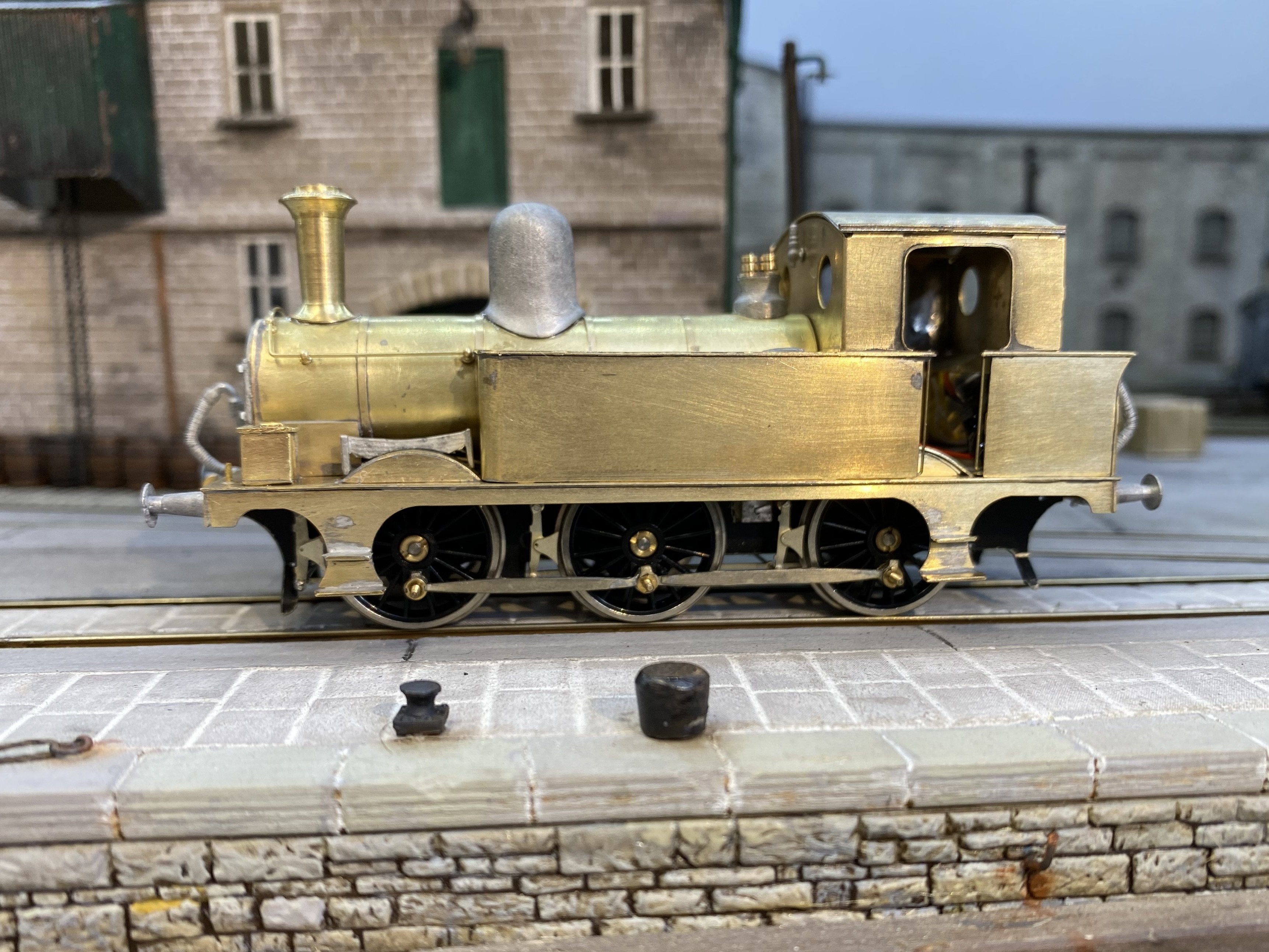

45 minutes ago, Galteemore said:
Alan - just admiring this again, but noticed one of the cab handrails is adrift? Makes it look as if rear bunker is askew….
You're right! Well spotted David. Didn't notice that. Because I made the various sections separable, I couldn't solder the bottom of the handrails into holes in the running plate. Instead they're bent at right angles near the bottom and soldered to the bunker floor. That one will need desoldered and moved in a bit at the bottom.
Edited by Tullygrainey
No worries Alan. Let’s just say it resonated with something I’ve done myself ;)
  • Funny 1
Sorted now David. Only took three quarters of an hour😄 First, while trying to adjust the bottom soldered joint the whole rail came adrift. Then predictably,  it pinged off the tweezers straight into the maw of the carpet monster. Actually I think I also have a bench monster. So I had to make a new one. Another member of the 'little things sent to try us club'
  • Like 5
  • Funny 2

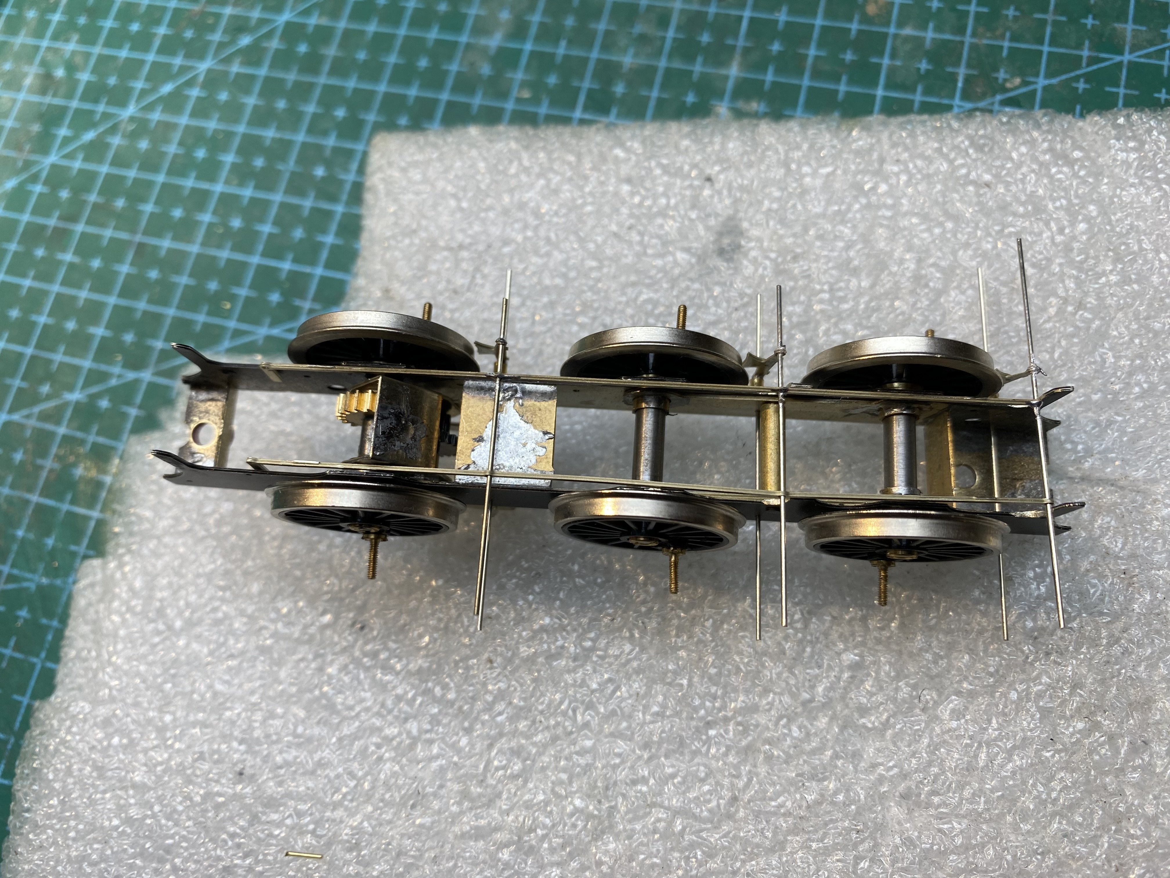

Back to the SSM J26.

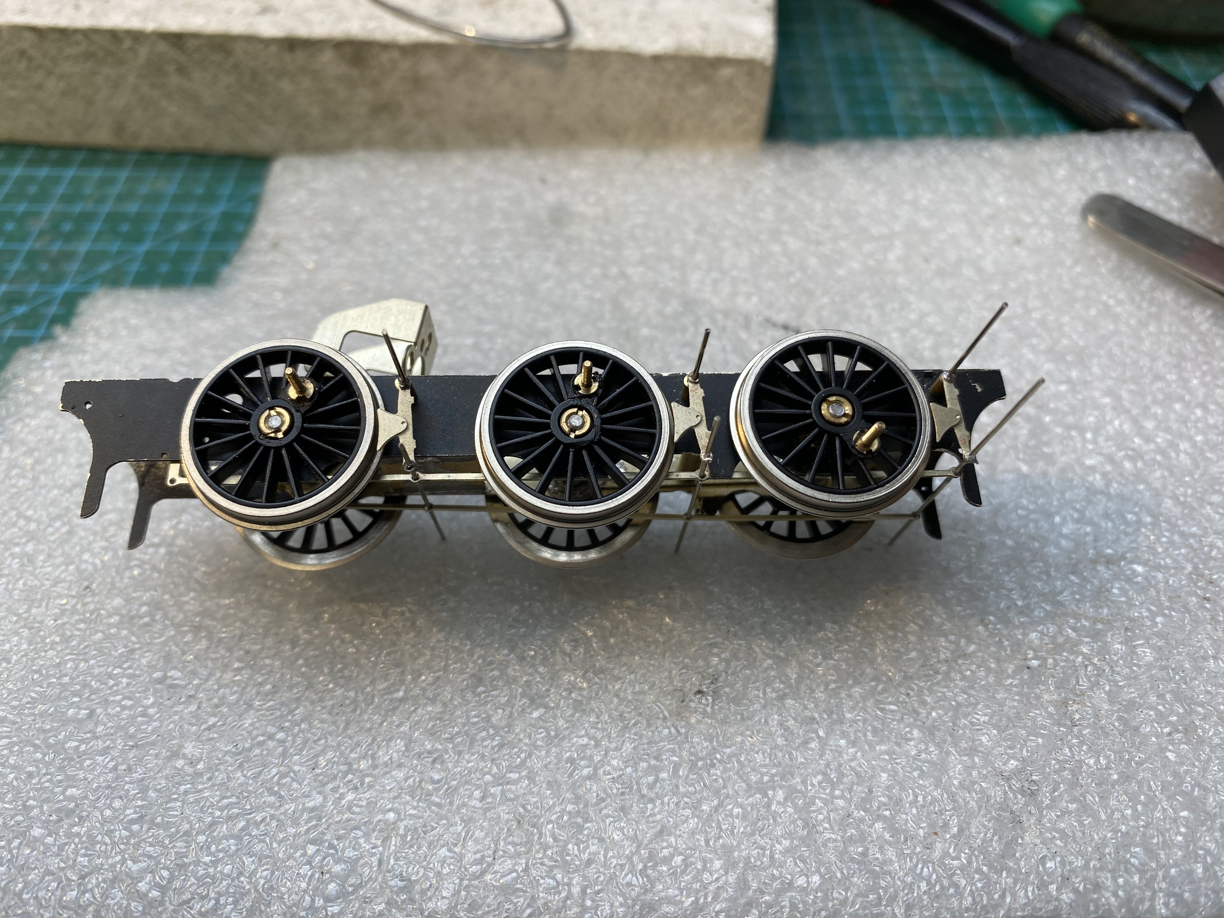

Brakes
7mm brass rod for the top brake cross members slotted through pre-etched holes in the frames and short brass tubing spacers slipped over each to help position the brake hangers. Nothing soldered. The sheet of foam plastic packaging helps keep everything roughly in place.
Brake hangers then added and more brass rods passed through the bottom of the hangers and through two brake pull rods. Moving the pull rod back and forward then allows all three brake hangers to move together and be positioned as close to the wheels as short circuit avoidance will allow. Each brake hanger is then soldered into place at the top. Once the first one is done, the whole arrangement begins to firm up. Then it's just a case of working round the various joints.
One side soldered up and the other ready for the same procedure.
All soldering done now.
Cross rods trimmed back and filed.
Pickups
Deciding how to arrange pickups took a bit of thinking about. Space is tight and it was a challenge to avoid contact with the bodywork and the brake rigging. Pickups are 31 swg phosphor bronze wire soldered to small pieces of printed circuit board superglued to the chassis frames. These bear on the wheel flanges and are hooked at their ends to help keep them in place.
I always find this job a trial and it usually takes a lot of fettling to get them working well. It's always a compromise between getting sufficient tension in the wires to maintain contact but not so much as to cause too much drag. First attempts with this one just about stalled the motor. It's still not quite right in the video below but getting there.
Another bit of pcb between the frames just ahead of the motor allows the pickup wiring to come together and these and the motor terminals were connected to a 6pin DCC harness.
Alan
  • Like 9
There are some very neat ideas there - I like the sheet of foam as well as the pickup location and shape. Excellent work, and I shall be inspired by those ideas when I get to that stage.
  • Agree 1
Thanks Paul. Pickups are a pain no matter how you approach them which is why I’m exploring a live chassis approach with the old K’s Kirtley. But you can’t really do that with a tank engine. At least I’m not sure how you would.
With my broad gauge version I'm not sure I'll have room under the splashers to hook a wire over the top of the flanges. Once I've trial assembled some more parts I'll give it some more thought. My CSB springy wires also potentially block your copperclad block locations.
Mine will be DCC and have a stay-alive fitted, but it still needs effective pickups!
I wonder if I can fit something lower down bearing on the back of the wheels.
You might get away with contacts hooked over the flanges - depends how much deflection your CSB allows - but it would be tight. It's only the front axle that's a problem. There's plenty of room above the other two. You could consider having the hooks make contact with the wheels a bit further down from the top. There's slightly more room there.
I considered going underneath with this one. You have the brake pull rods to contend with but it should be possible to work round them. As I said, a pain! 😬😄
  • Agree 1
Add brake rigging to the list of pains when chassis building! The use of fine tubing to set things up is definitely one I'll be using.
Me too !

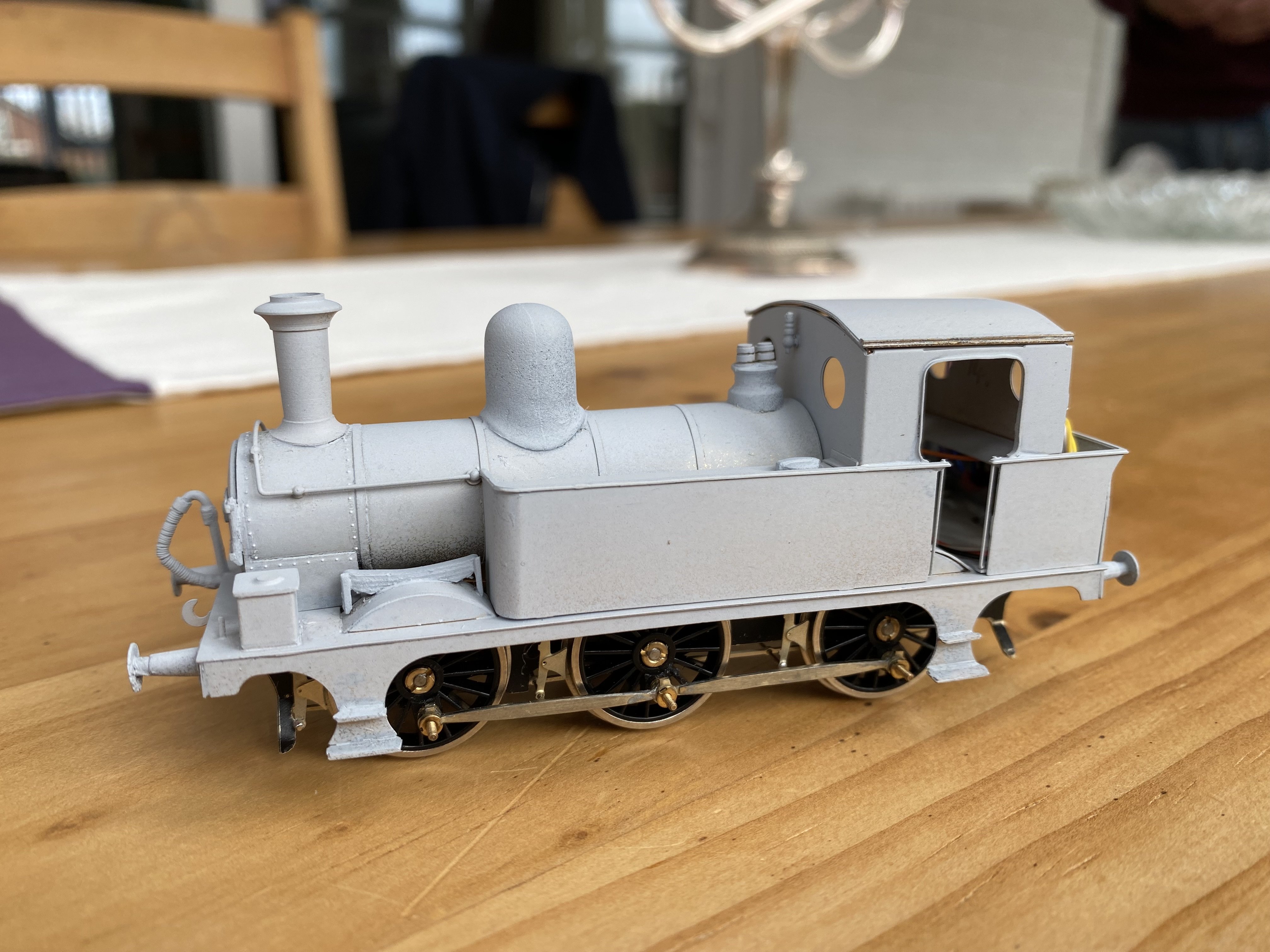

The J26 is getting there.
Basking in the sunshine after a good scrub....
... and together in all its brass brassiness.
Some Railtec rivets...
... and turned out in builder's photogenic grey. Roof will be fitted properly in due course.
First runs under DCC at Loughan Quay....
... and again on its home turf, Kirley Junction.
  • WOW! 8

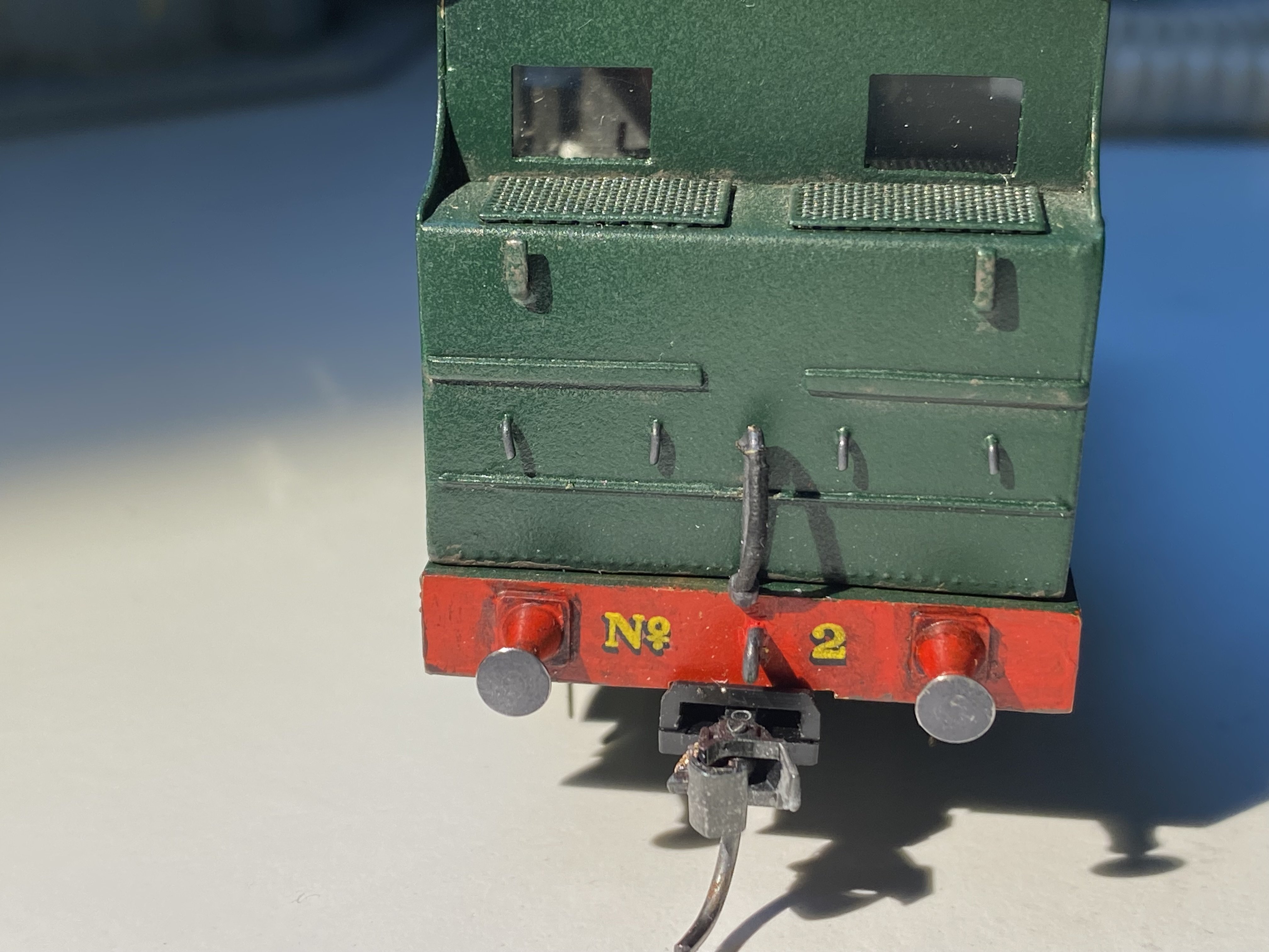

What are you planning to use for the bufferbeam numbers?
14 minutes ago, Mol_PMB said:
Excellent!
I have some catching up to do.
I should probably have done the same with the rivets.
I'd need to consult the owner about that. Kieran will take over from here to do the paint, transfers and finishing so the final decision will be his.
There are still a few things to sort before that, including cab detail and deciding on a home for the decoder. It's in the bunker at the moment but could conceivably fit in the boiler, though getting a stay-alive in there too might be a bit of a squeeze.
Don't rush your build! The detail you're putting into it is worth spending time on.
Thanks 👍🏻

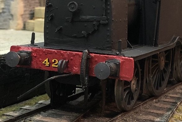

For the numbers on the tank the Railtec ones have the wrong font for my prototype.
I may use custom transfers but I am considering laser-cutting a stencil and spraying them. I think that may help me replicate the very worn and faded numbers that 559 had.
But the bufferbeam numbers are much more fancy with multicoloured shading. I was wondering if there’s something suitable commercially available, maybe intended for a GB railway?
I used LSWR/SR ones too on my BCDR locos. Not strictly accurate but I'm content with them and nobody's pointed out an error yet!😄 These are from HMRS Sheet 9.

14 hours ago, Galteemore said:
I’ve used LSWR\SR ones before
That's quite close, although I think the GSR/CIE script was wider and taller, with more of a shadow. In some photos, the number appears to take up almost the full height of the buffer beam.
I've just had a look through the transfer sheets I have accumulated over many years, and found a 7mm scale example of this one:
GNR & ECJS coach insignia (Special Vehicles need 1 sheet per vehicle side) transfer
In 7mm scale the smaller numbers are 3.5mm high and the larger numbers are 4.2mm high (both including the shading).
My J26 bufferbeam is 3.2mm high so they're a fraction too big, I might be better off with the 4mm scale equivalent. But the styling looks pretty good.
I wonder if these might also be suitable for @16miller's CDR stock?
They're not cheap...
  • Informative 2
