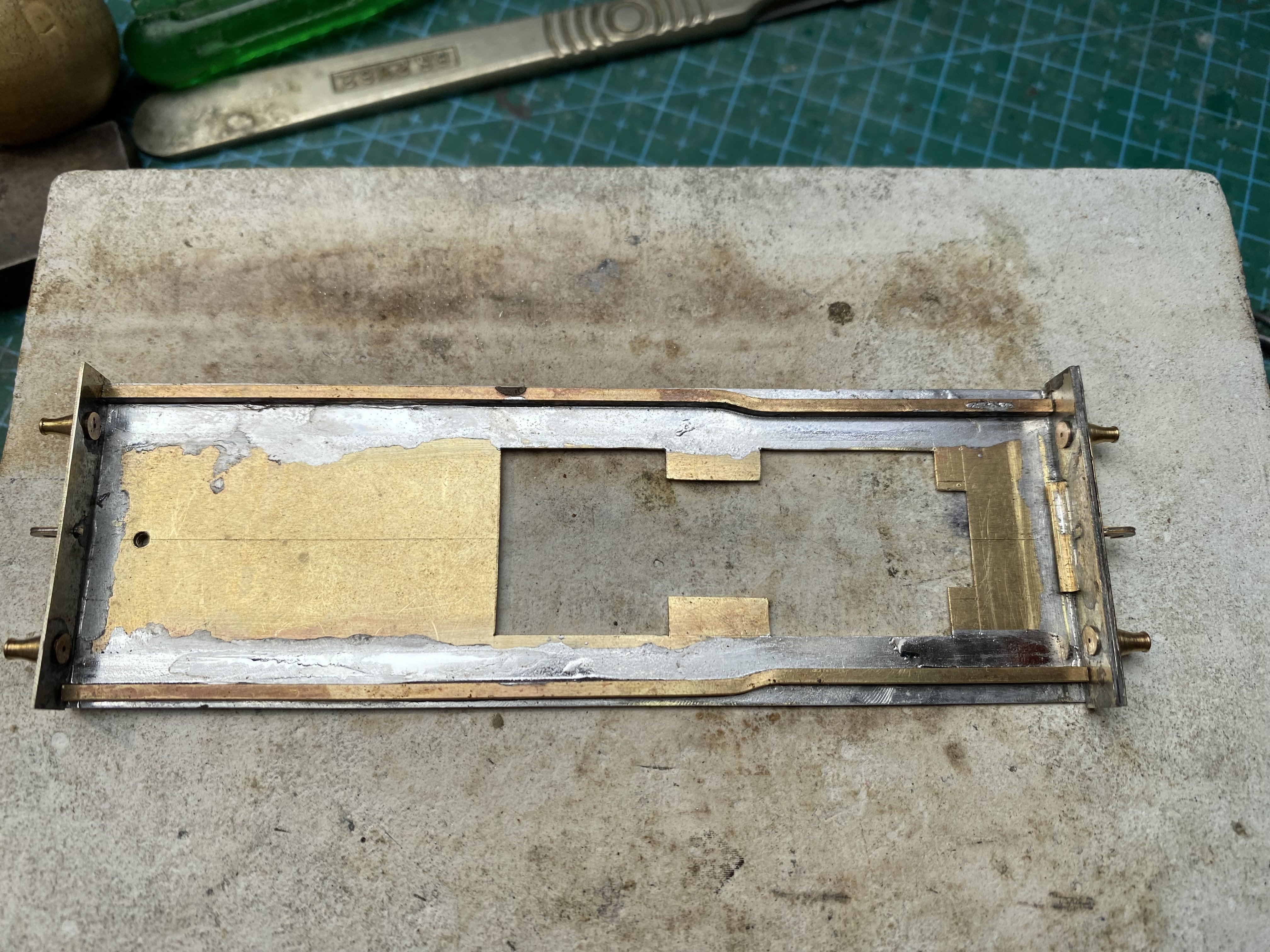

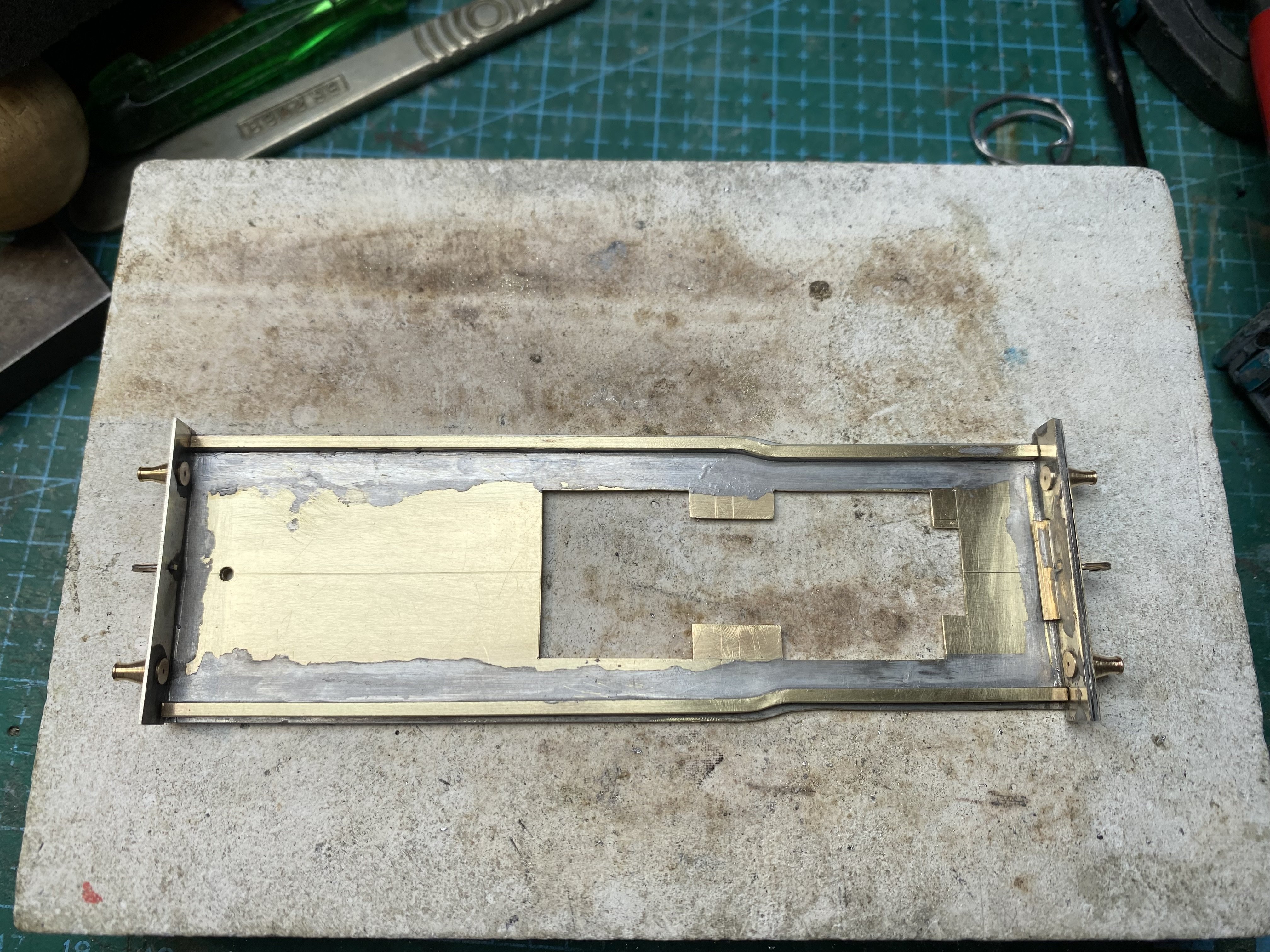

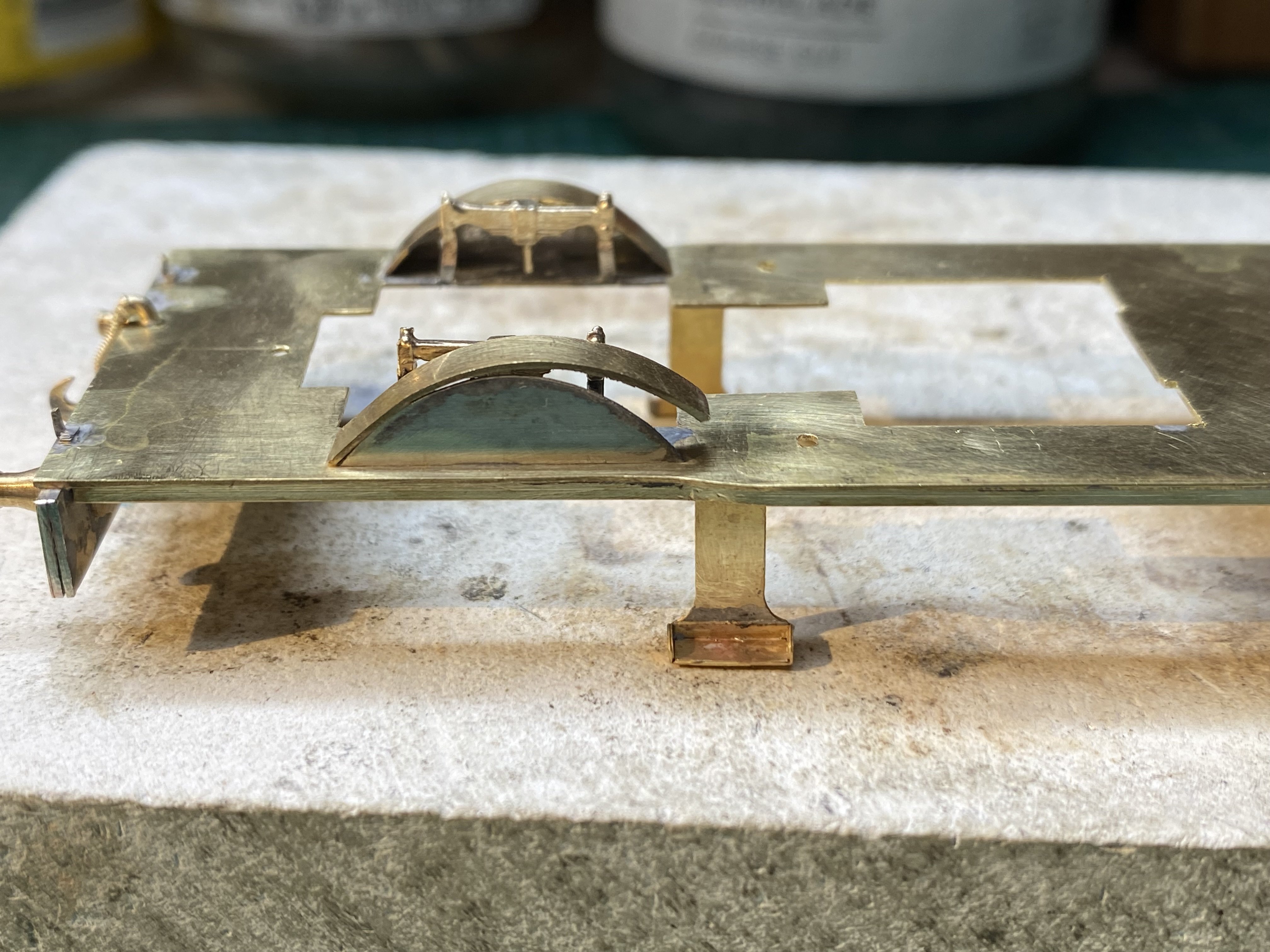

While waiting for replacement wheels, I've  made a start on No 9's running plate in 16 thou (0.4mm) brass. Buffer beams are 2 layers of 16 thou nickel silver plus an extra 5 thou brass layer on the front one - photos of the prototype suggest it might be made of wood with a metal facing.
Buffer shanks are from Alan Gibson (4908, Early GWR, Dean). Reggie the Soldering Unit made a neat job of soldering these on.
1.5mm square brass rod for the valances stiffens the whole thing nicely and gives it some much needed strength.
The front chassis spacer slides under a little bit of 1.5mm brass angle the same width soldered to the back of the buffer beam. This secures the chassis and keeps it centred. At the back there's a 10BA bolt into a captive nut on the running plate.
No disasters today.😃
Alan

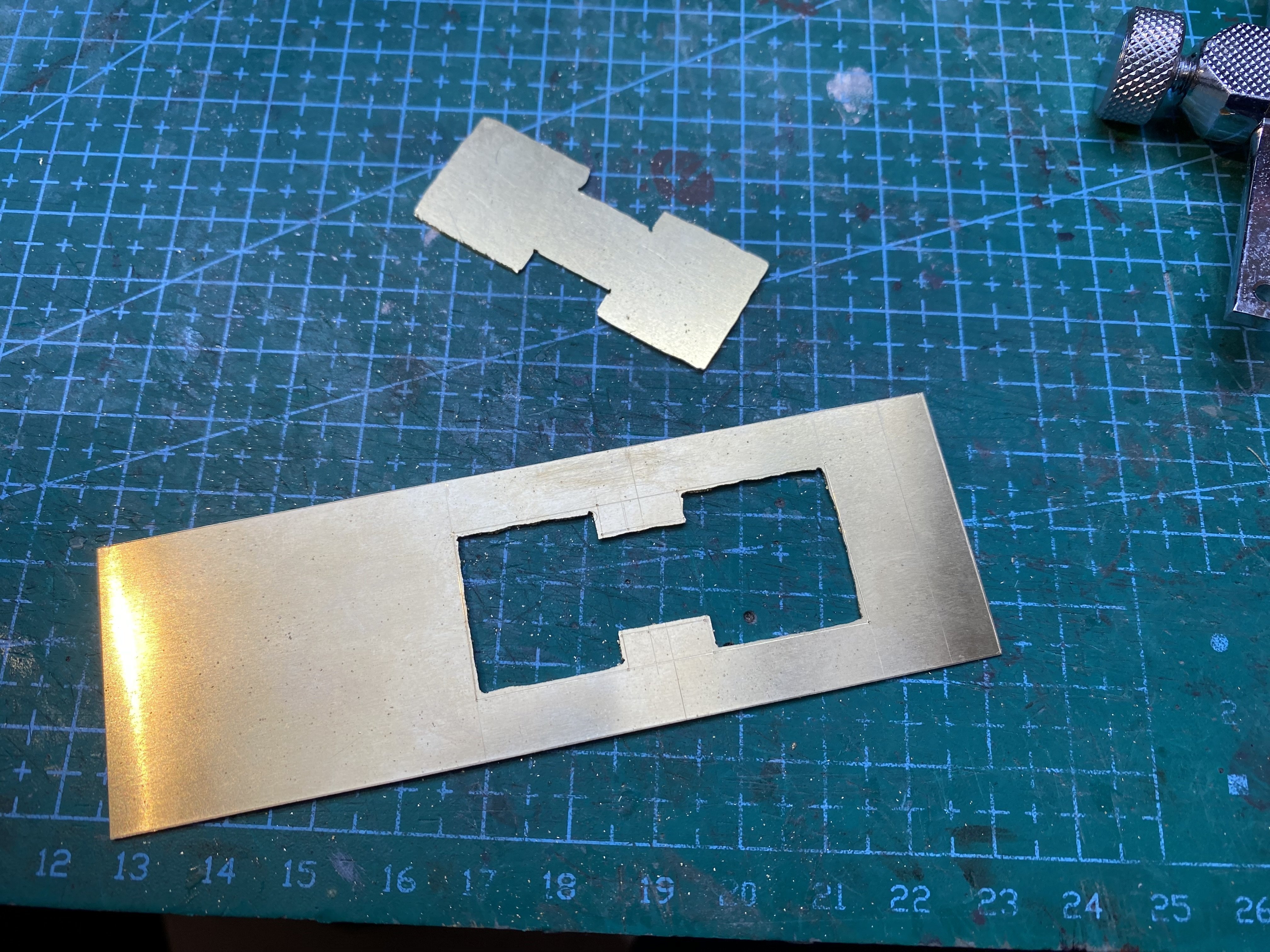

How do you cut brass/nickle silver so neatly?
  • Agree 1
7 hours ago, Mayner said:
Fair play Alan in building quite a fleet of BCDR locos, stock and Kilmore largely using traditional scratch building techniques.

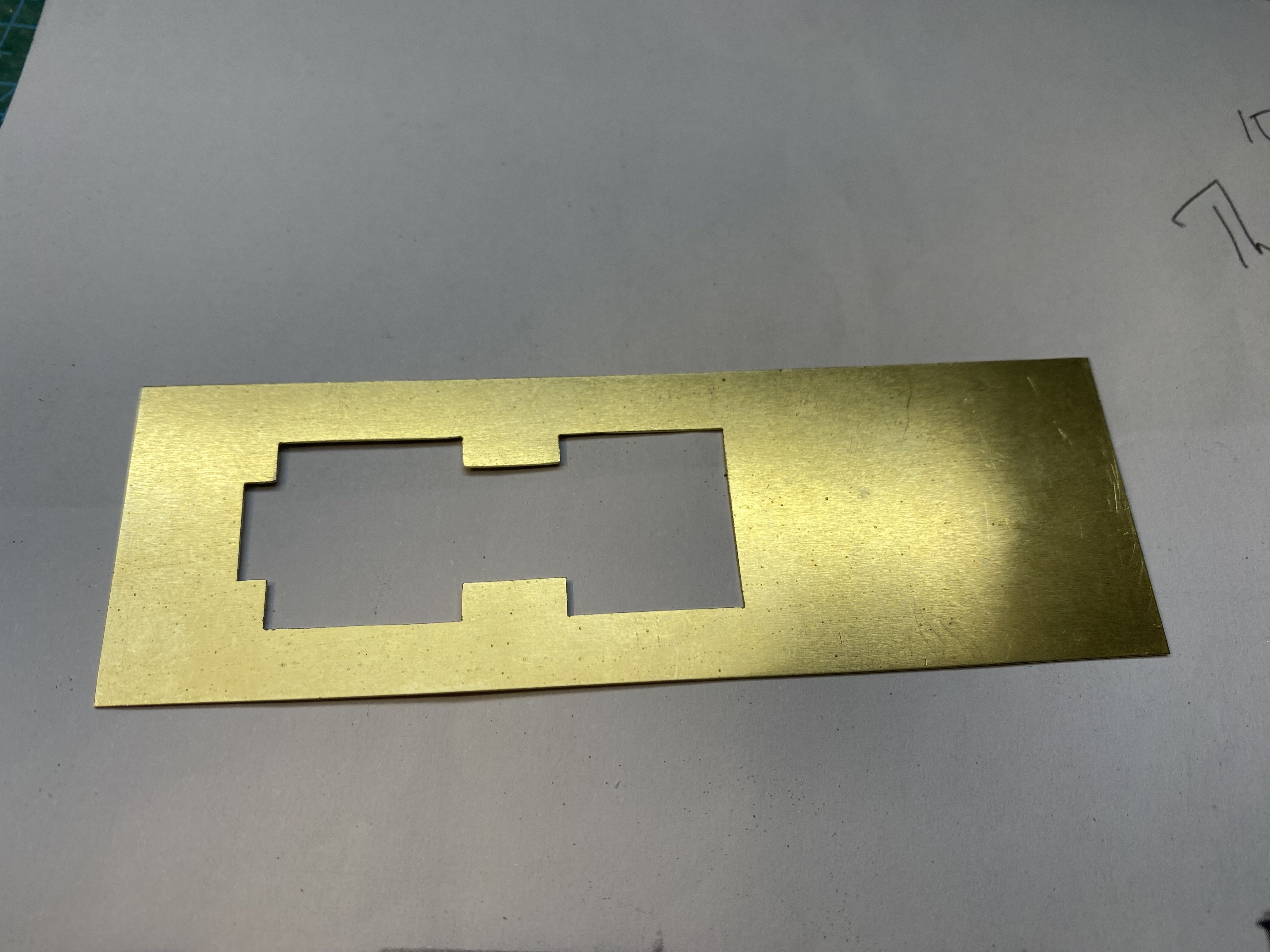

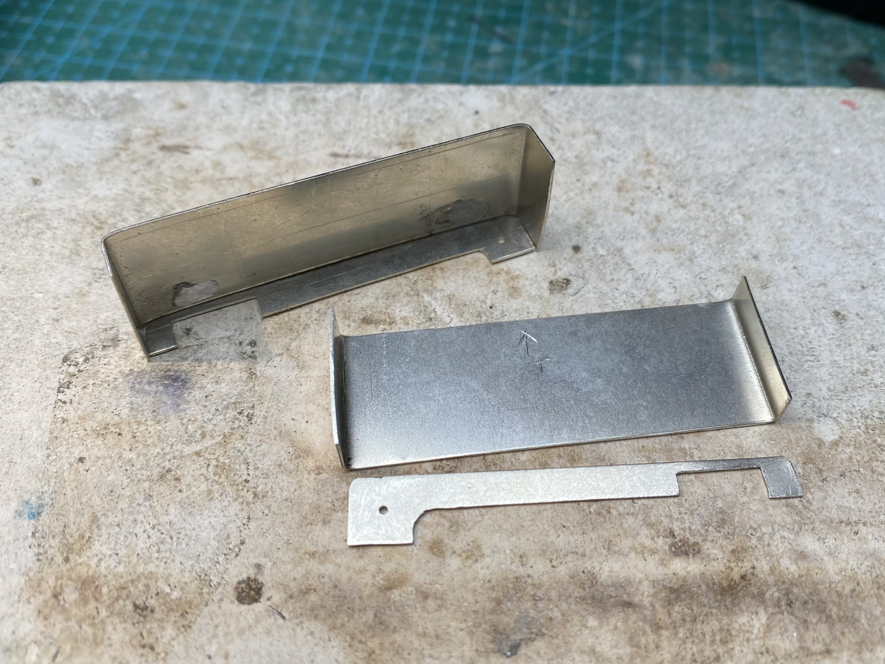

Ah John, I play safe. After scribing guide lines, I drill holes near each corner and cut inboard of the lines with the piercing saw. No need to be too precise (first photo). Then I file up to the lines using needle files (second photo).

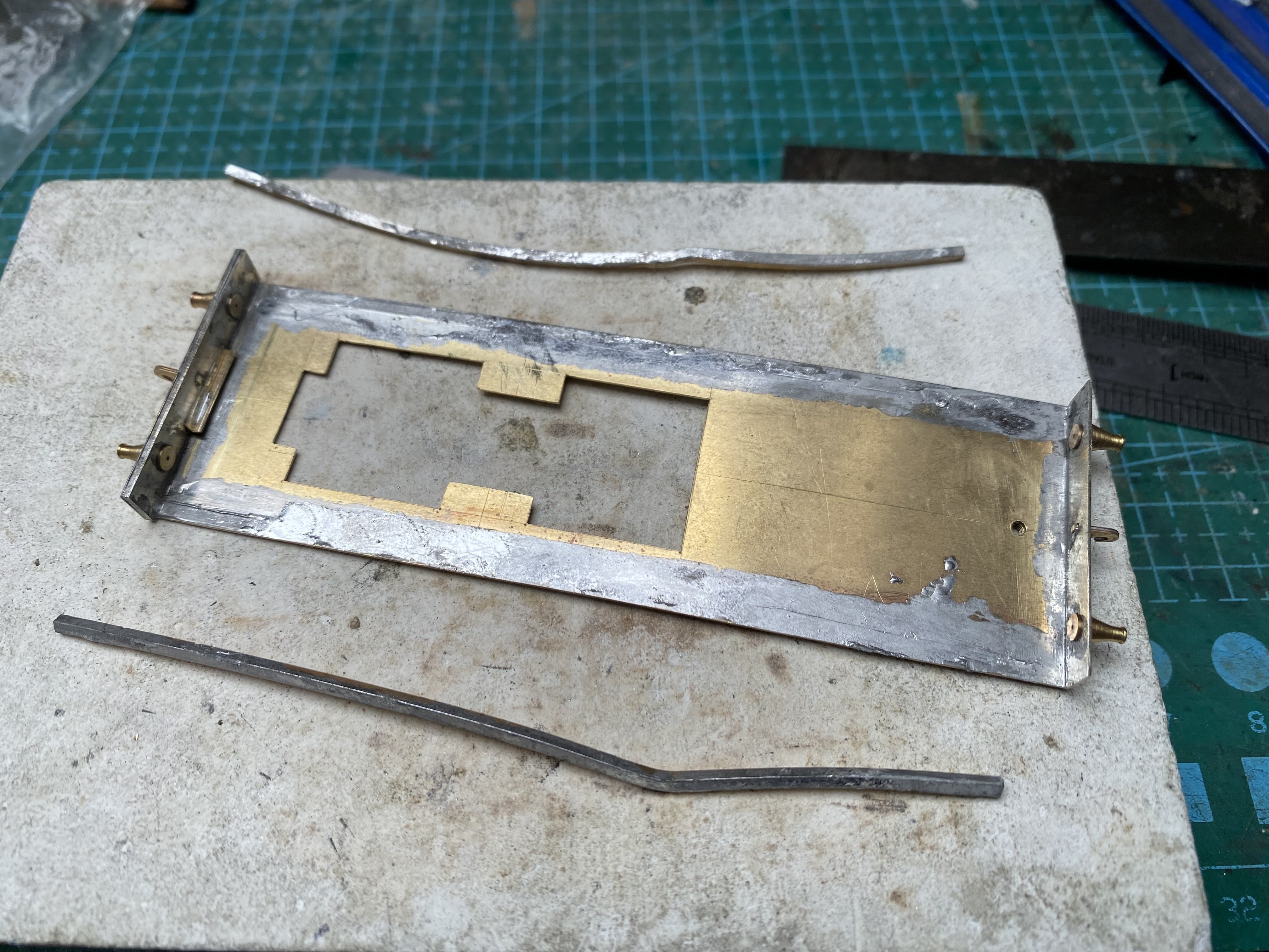

15 hours ago, Tullygrainey said:

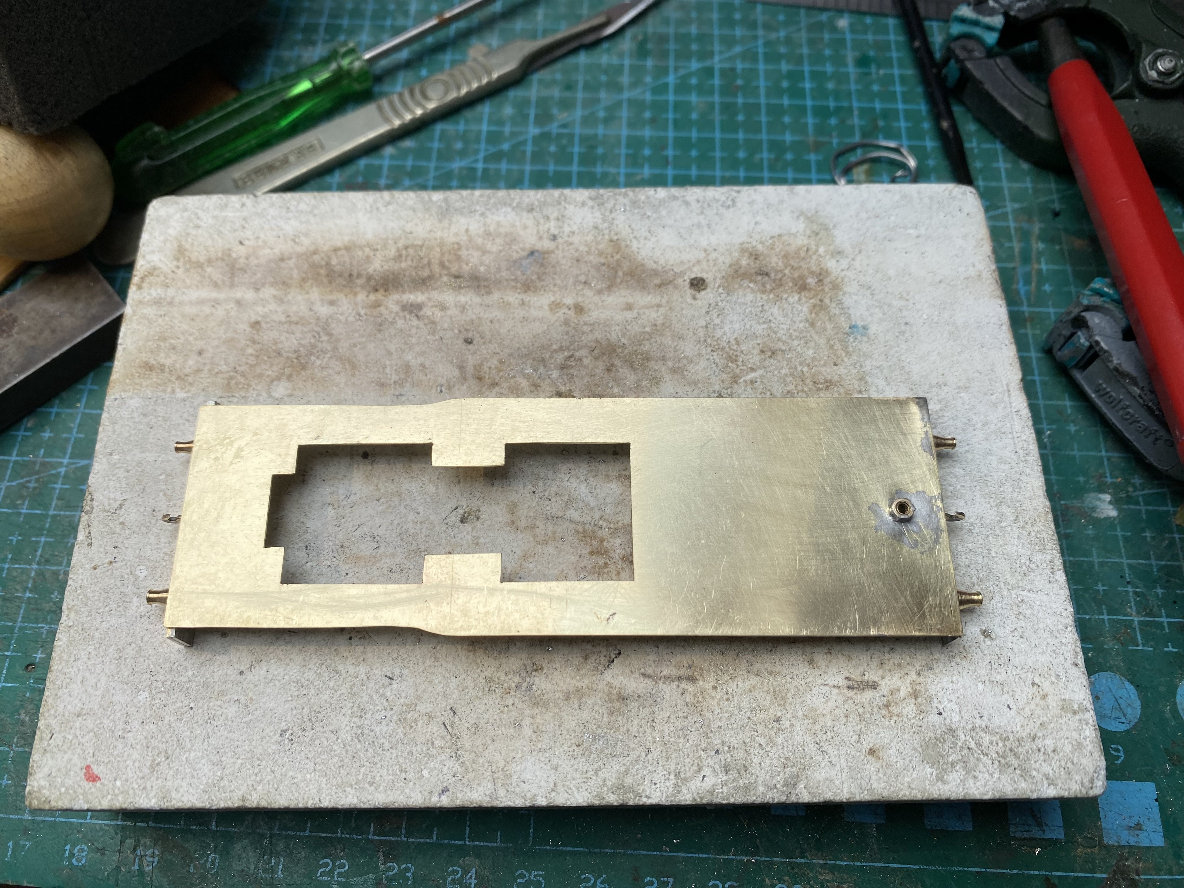

Spoke too soon!🙄
Looking again at the Casserley photo in Leslie's post above, the running plate narrows ahead of the tanks. Bu**er.
I could've left the running plate as it was - scratch building in 4mm is full of compromises, a track gauge of 16.5mm being not the least of those - but I knew it would bother me so, biting the bullet and ladling on the flux, the valances came off again. Not particularly neatly.
New shaped valances made up and soldered in. Bending that 1.5mm square brass rod is no joke, even after annealing it.IMG_5940.thumb.jpeg.6e4564113109b7c00722cc9ed8002371.jpeg
Running plate shaped to match and cleaned up.
Shuffling forward quietly and pretending it never happened🤭
Alan

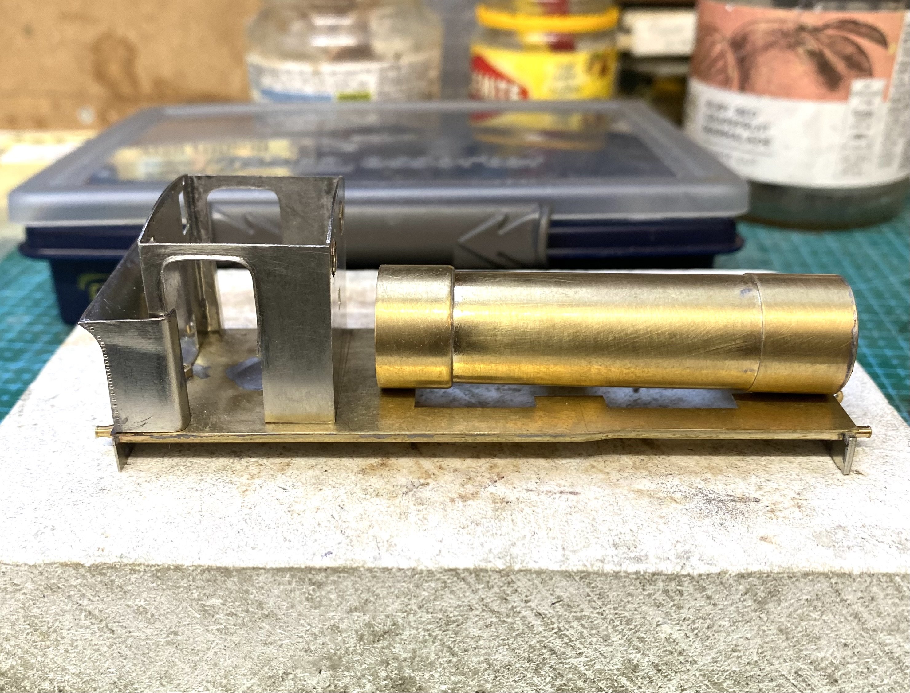

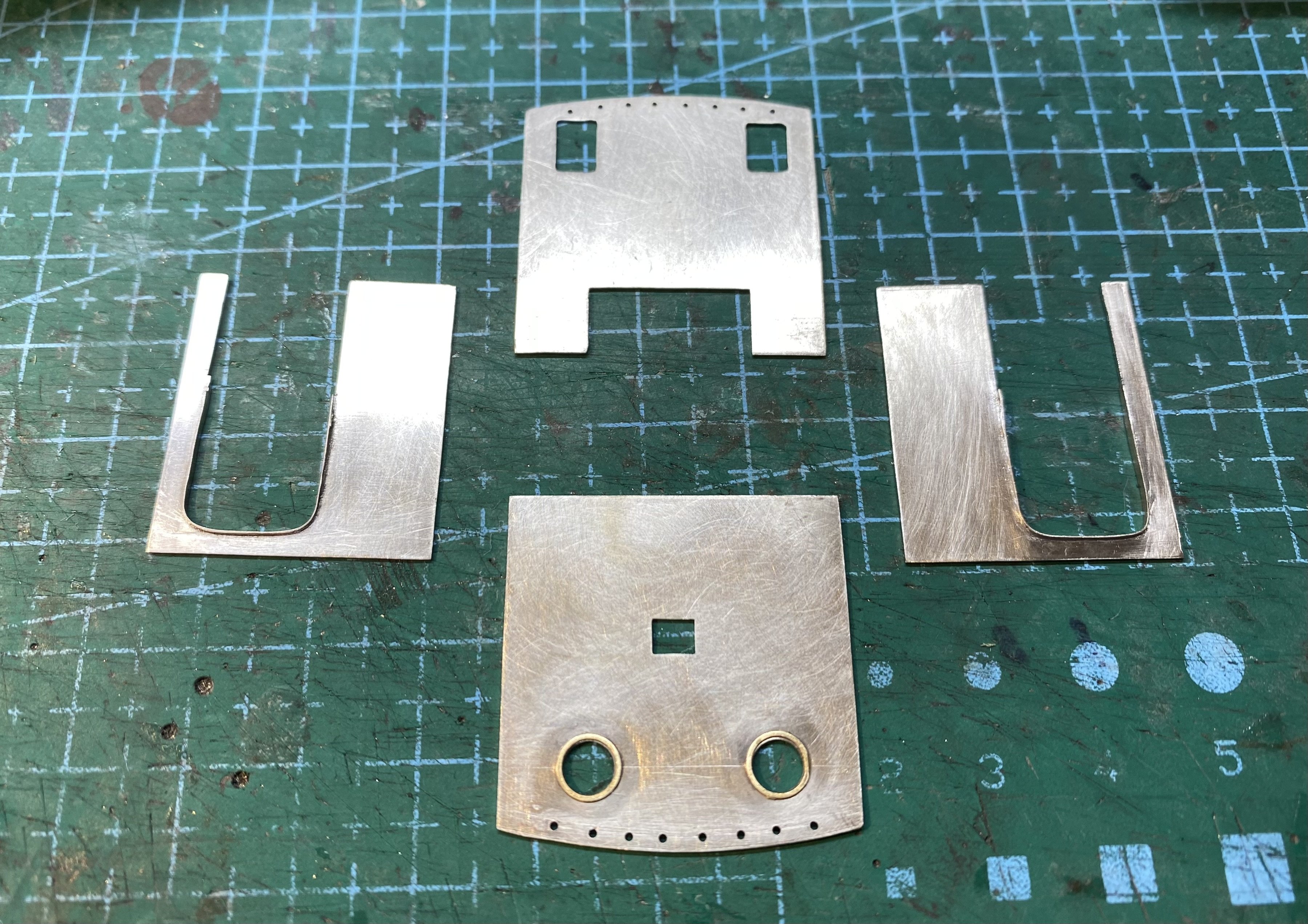

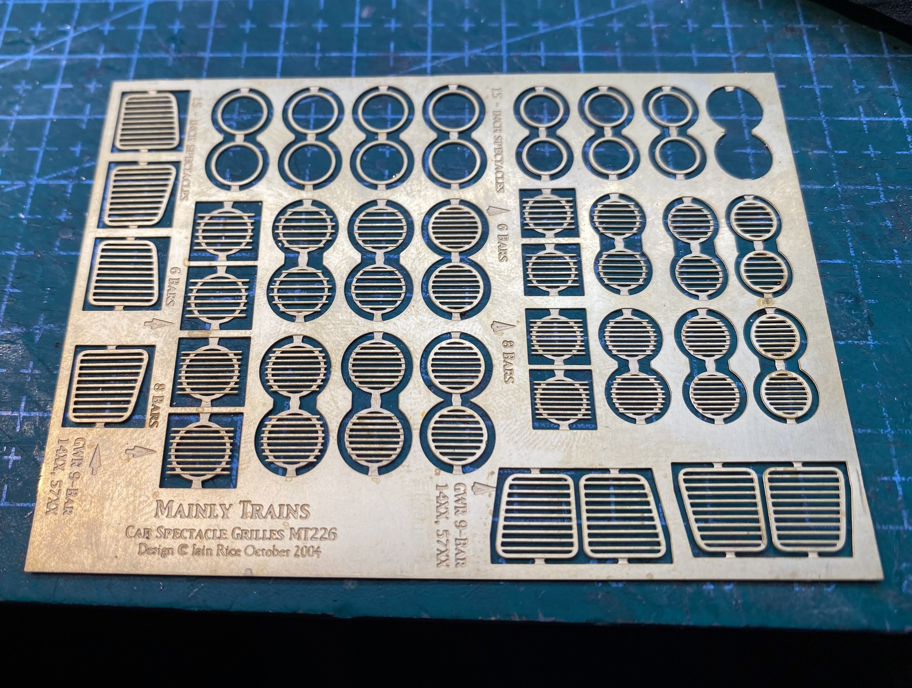

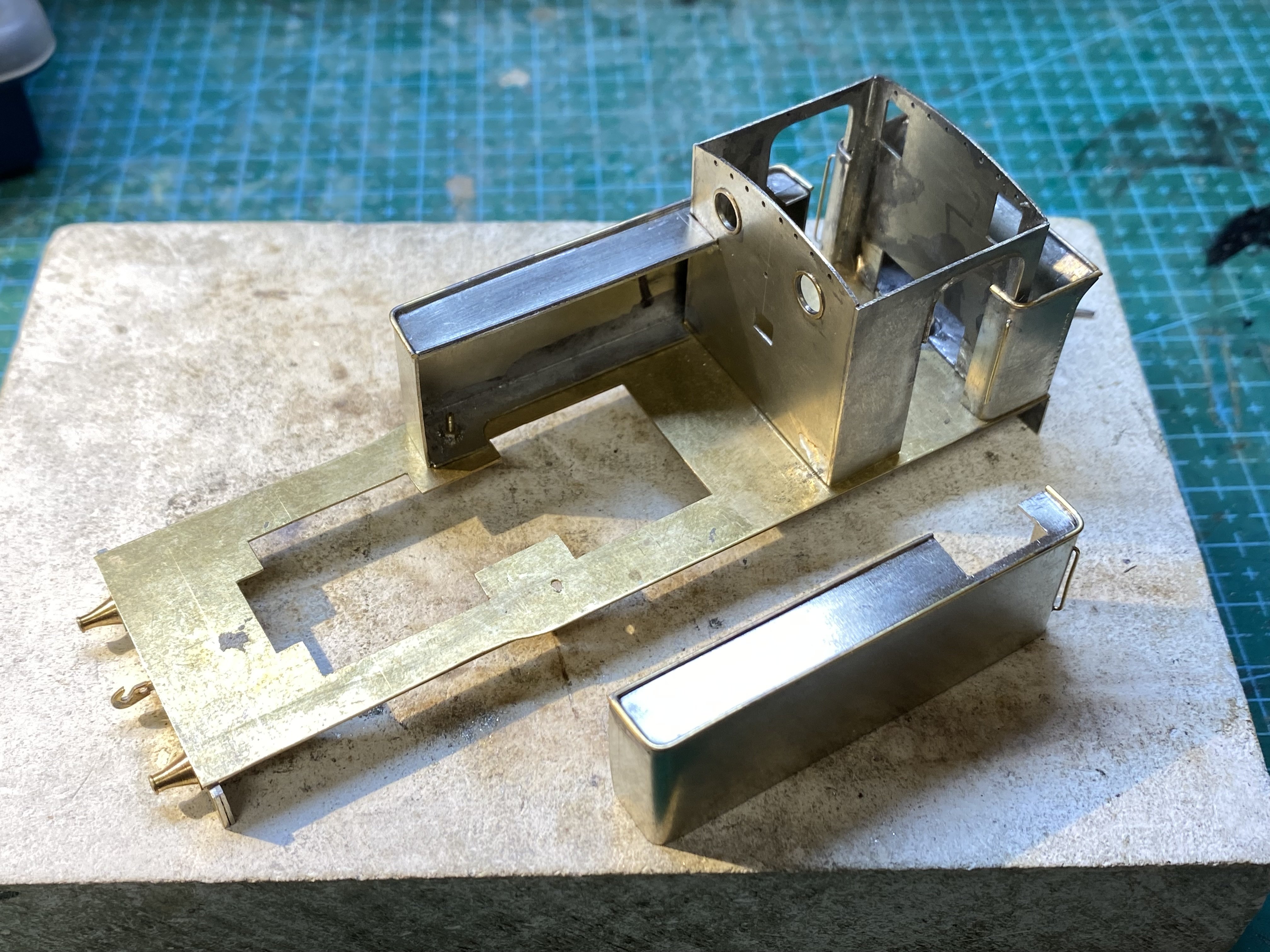

First, a cab flatpack in 16 thou nickel silver. A jolly afternoon spent with piercing saw and files, listening to the rain on the roof window.
The window surrounds on the cab front sheet came from this lovely Mainly Trains etch (MT226) designed by Iain Rice and available from Wizard Models.

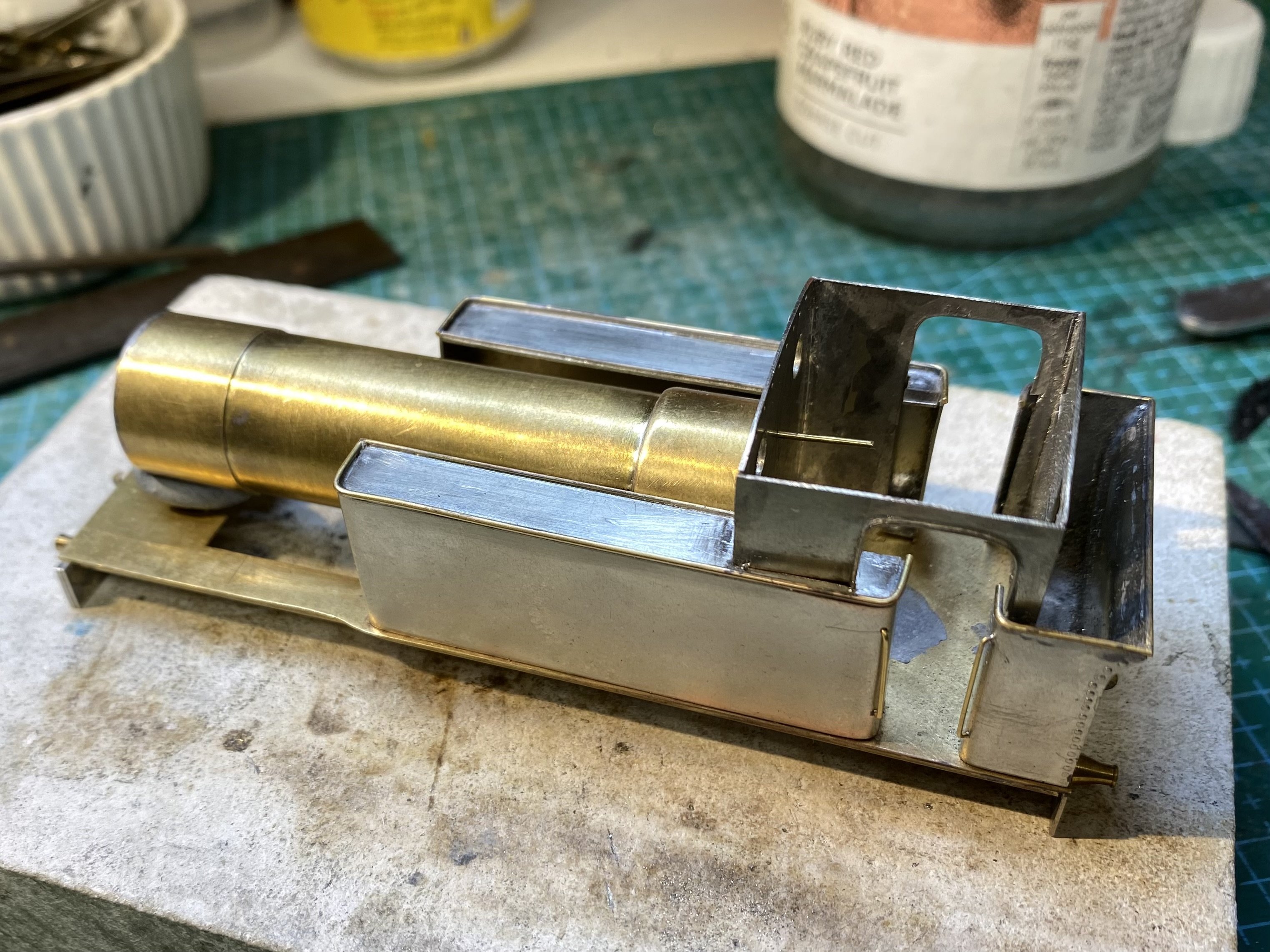

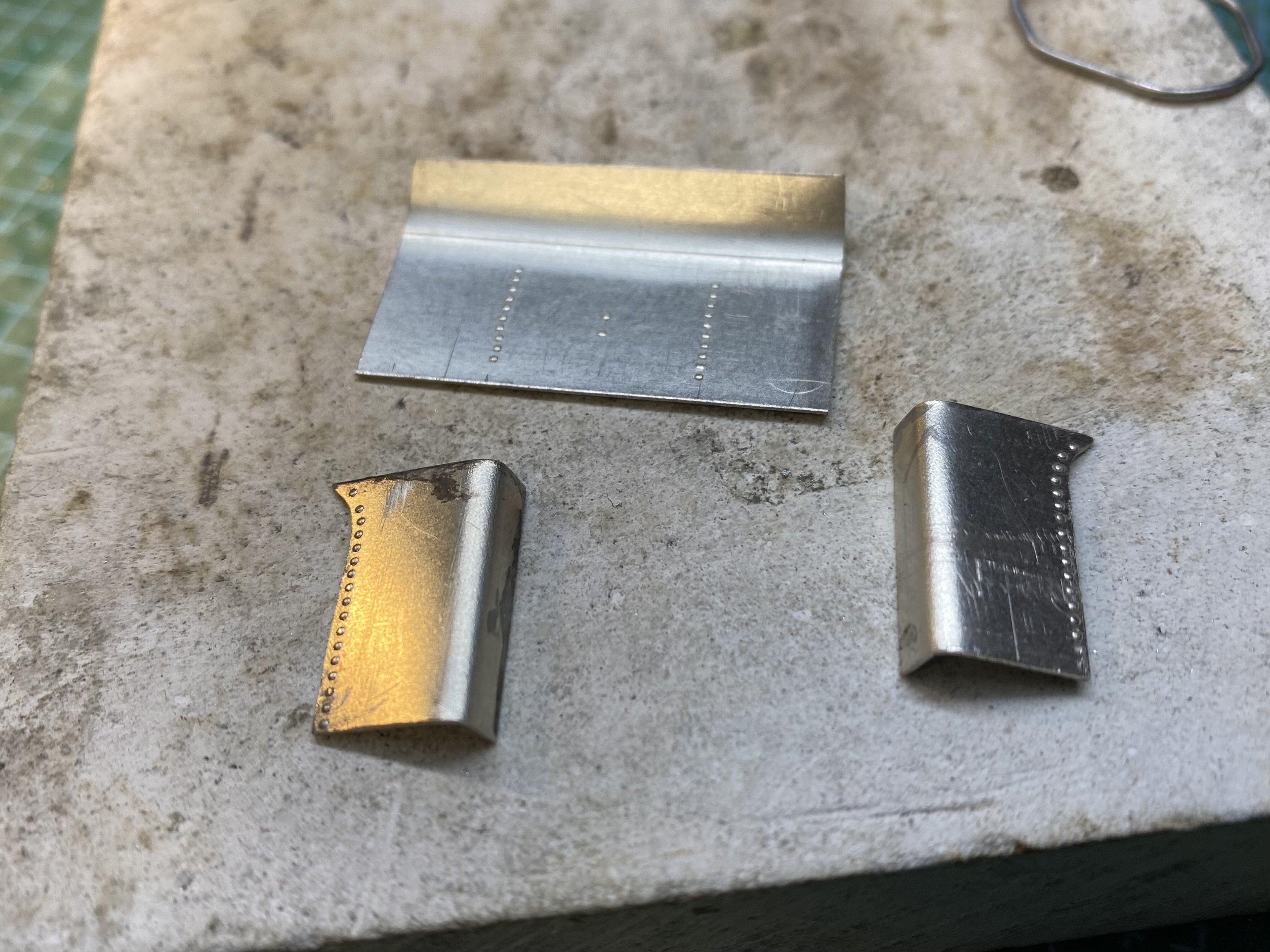

Bunker bits. More nickel silver and some embossed rivet detail.

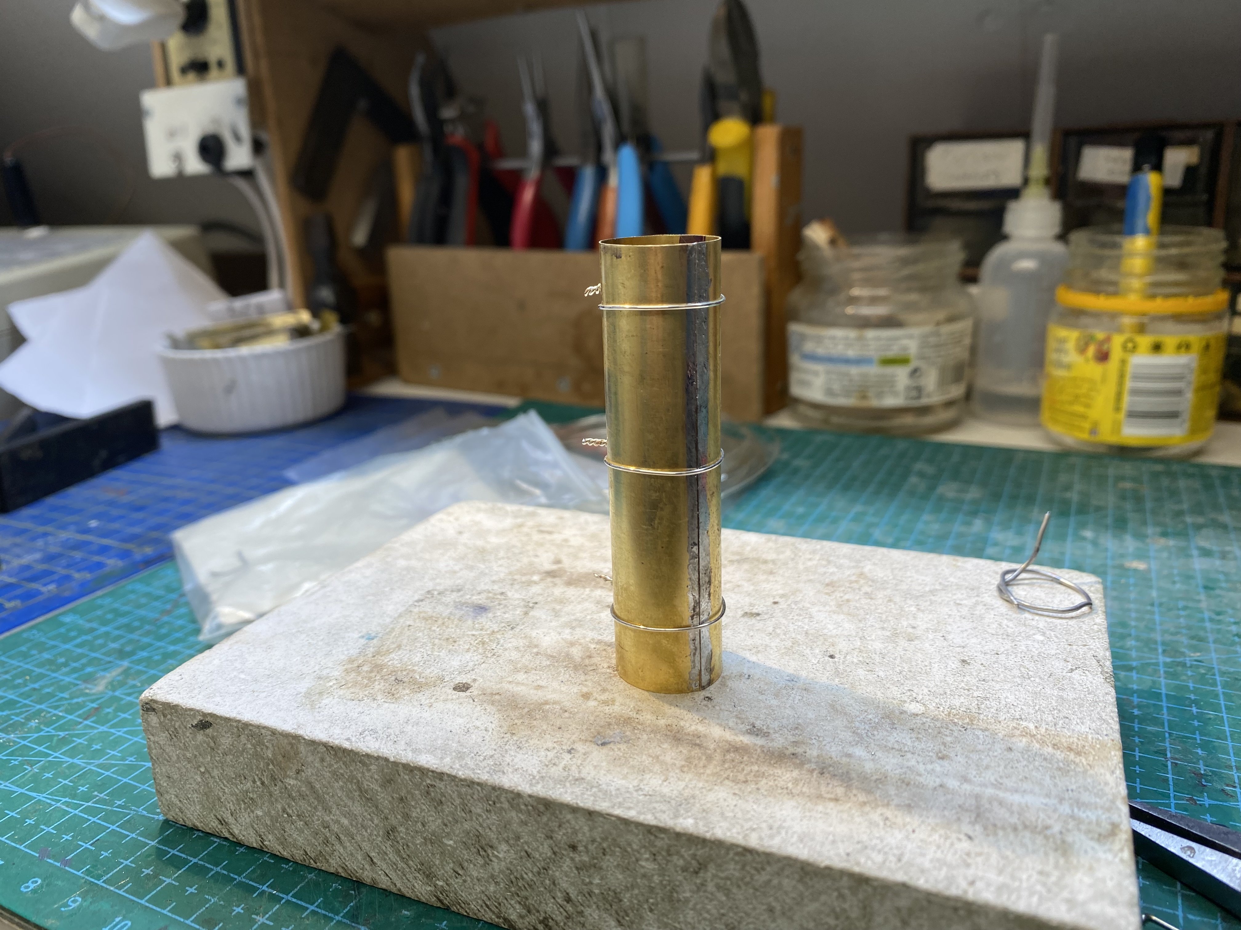

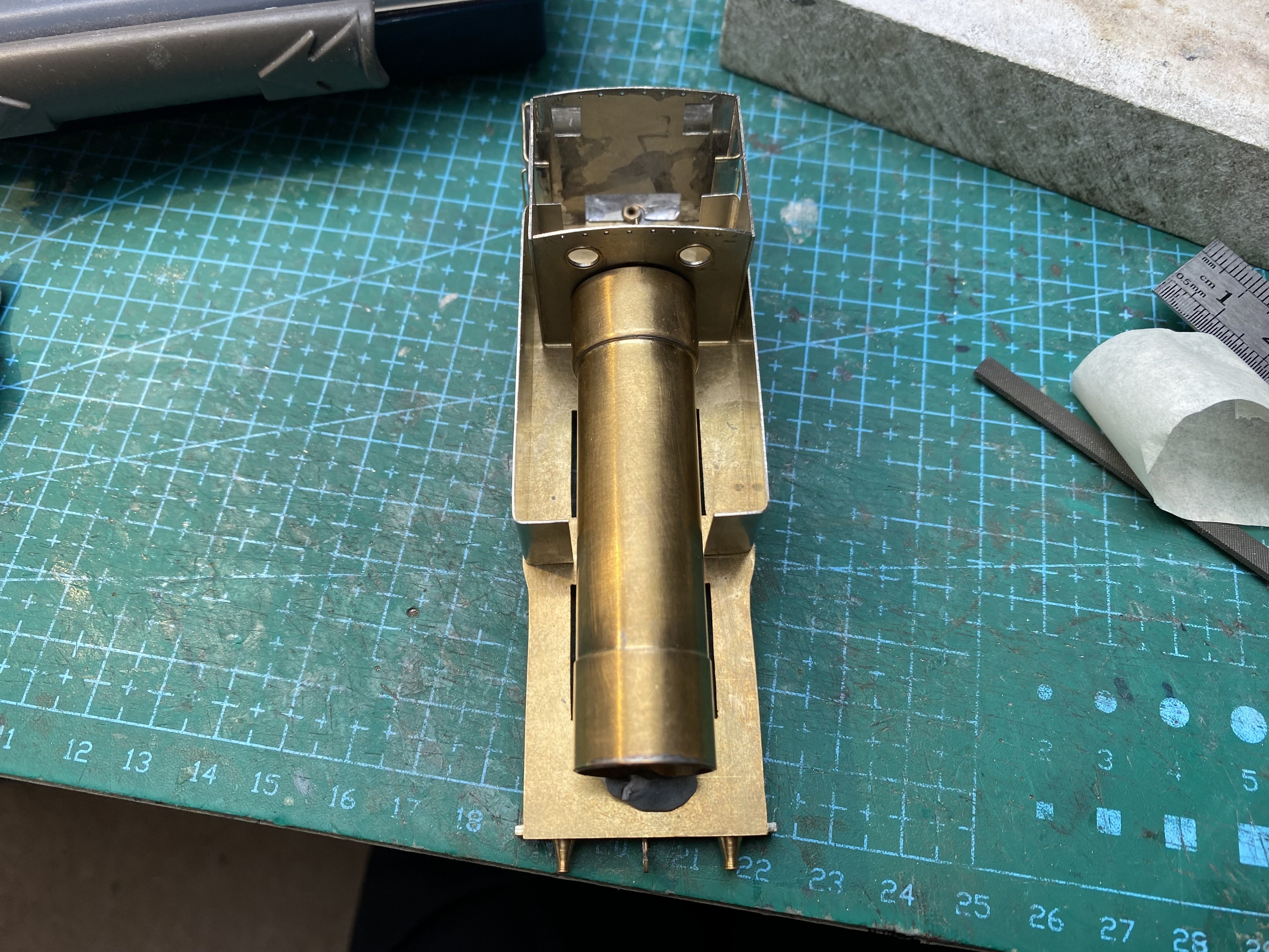

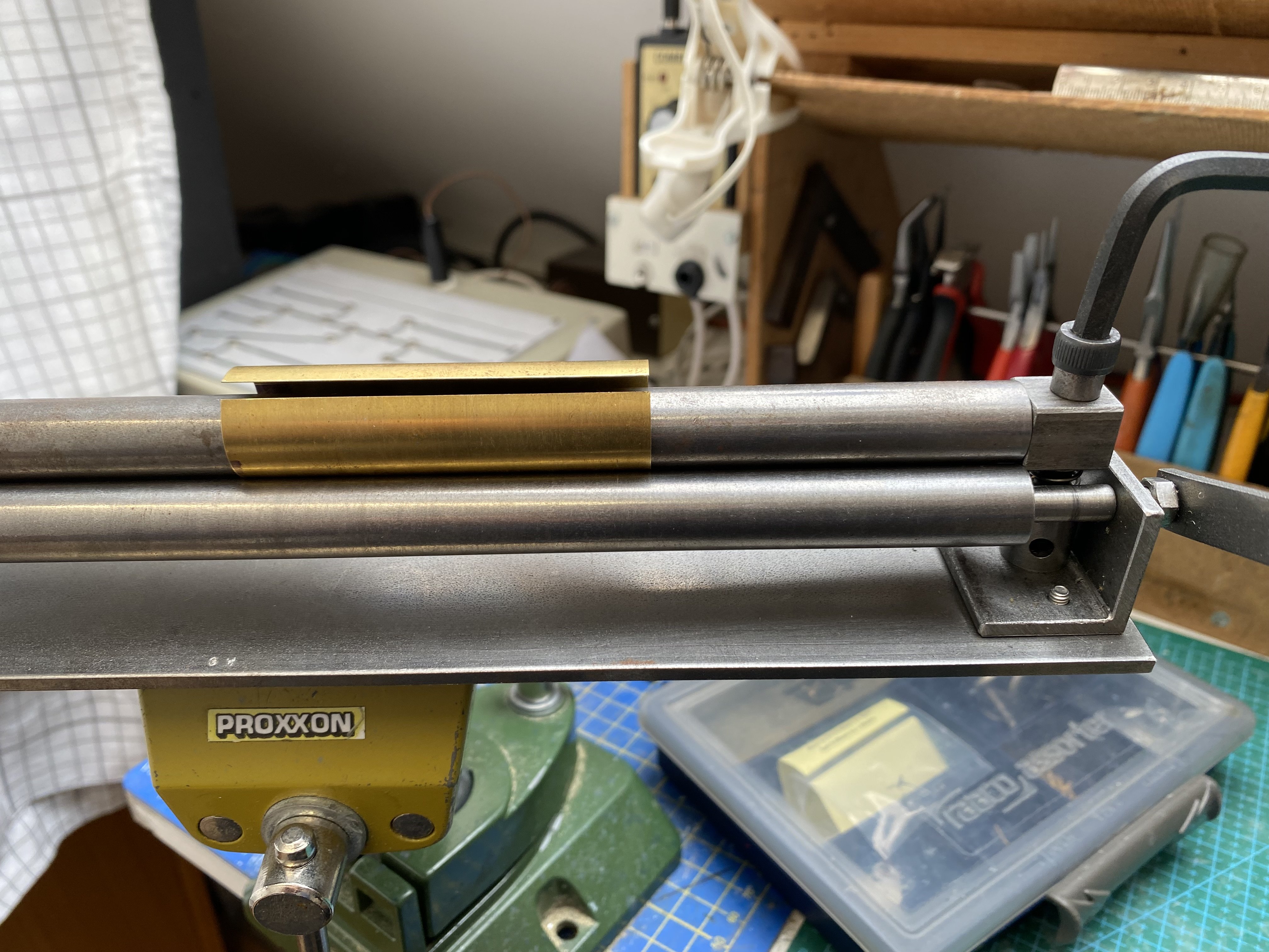

Boiler rolled from a rectangle of 10 thou brass...
Firebox end has 3 additional layers with the front edge contoured. The smokebox will get another layer to incorporate the smokebox saddle. Given that this one will be driven on the front axle, I'll need to keep clearance for the gearbox. Haven't quite sorted this yet.

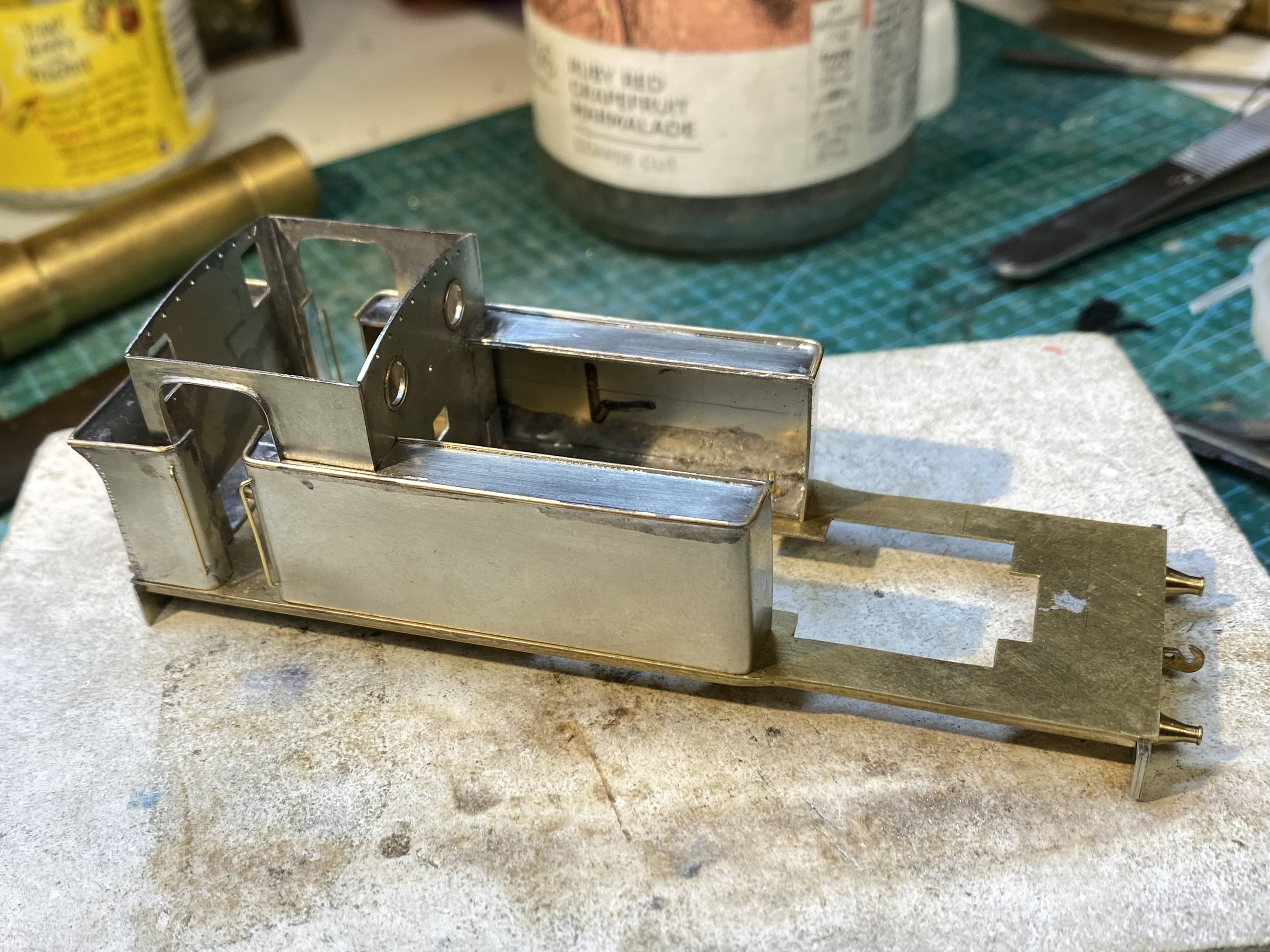

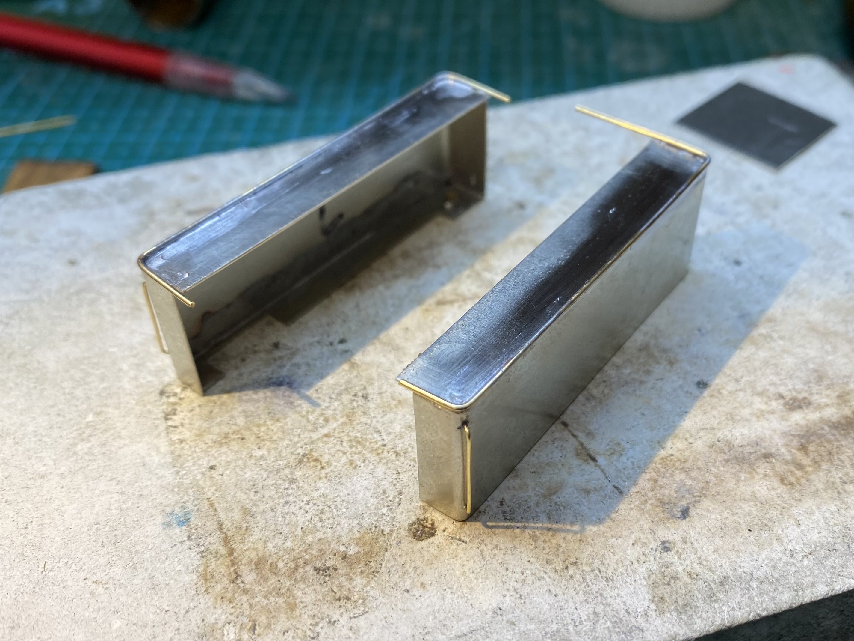

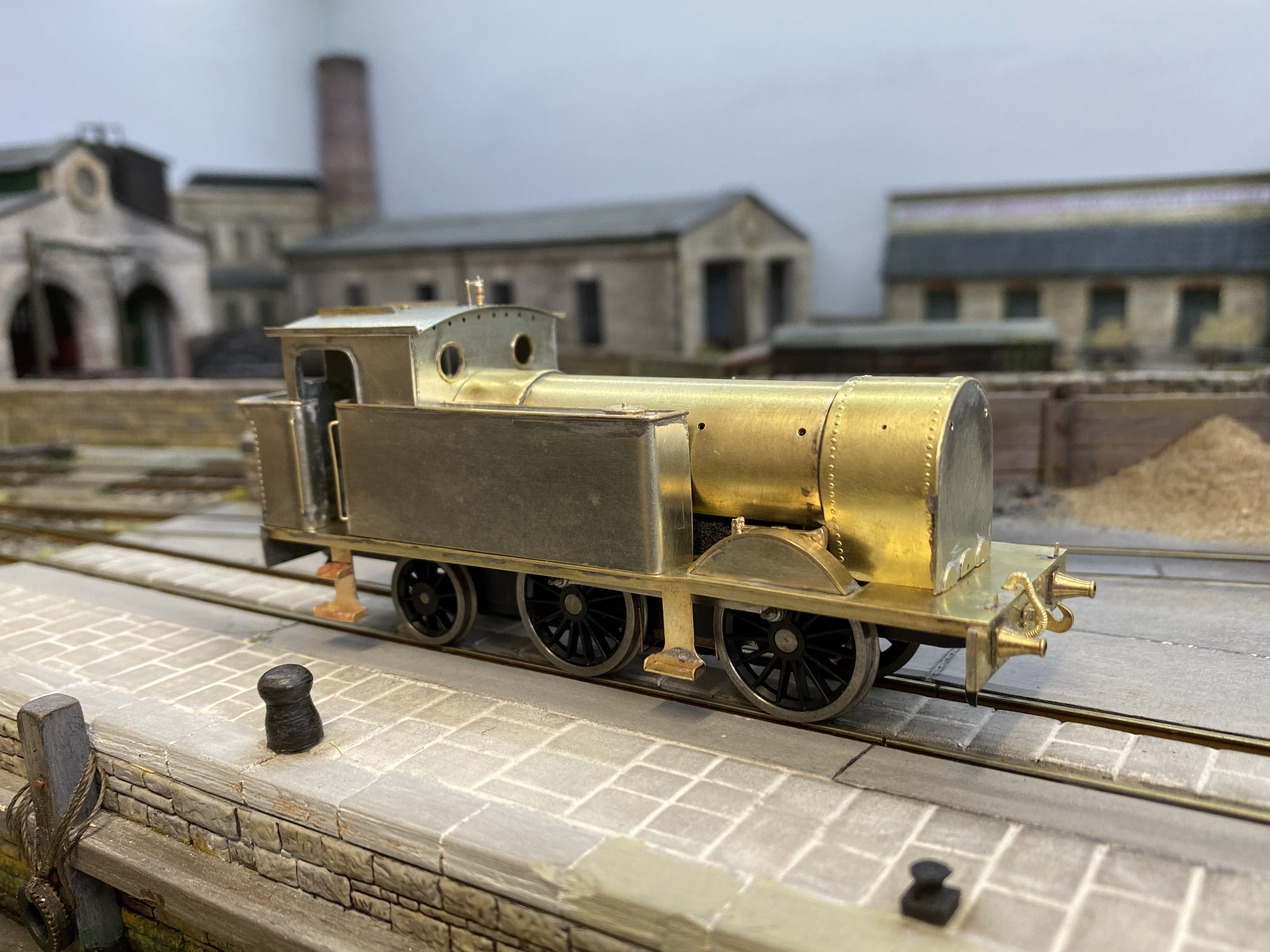

Tanks for No.9. Nickel silver with 0.7mm brass beading and 0.45mm brass handrails.
I think modelling Irish locos in OO 16.5mm gauge is finally about to jump up and bite me. The smokebox is due to get another wrapper, including the saddle linking it to the running plate and I suspect that the front wheels and the saddle both want to claim the same bit of real estate.
Pushing on regardless. I foresee terrible trouble but I stay here just the same, as someone once said. 😄
Alan
Edited by Tullygrainey
  • Like 11
  • WOW! 2

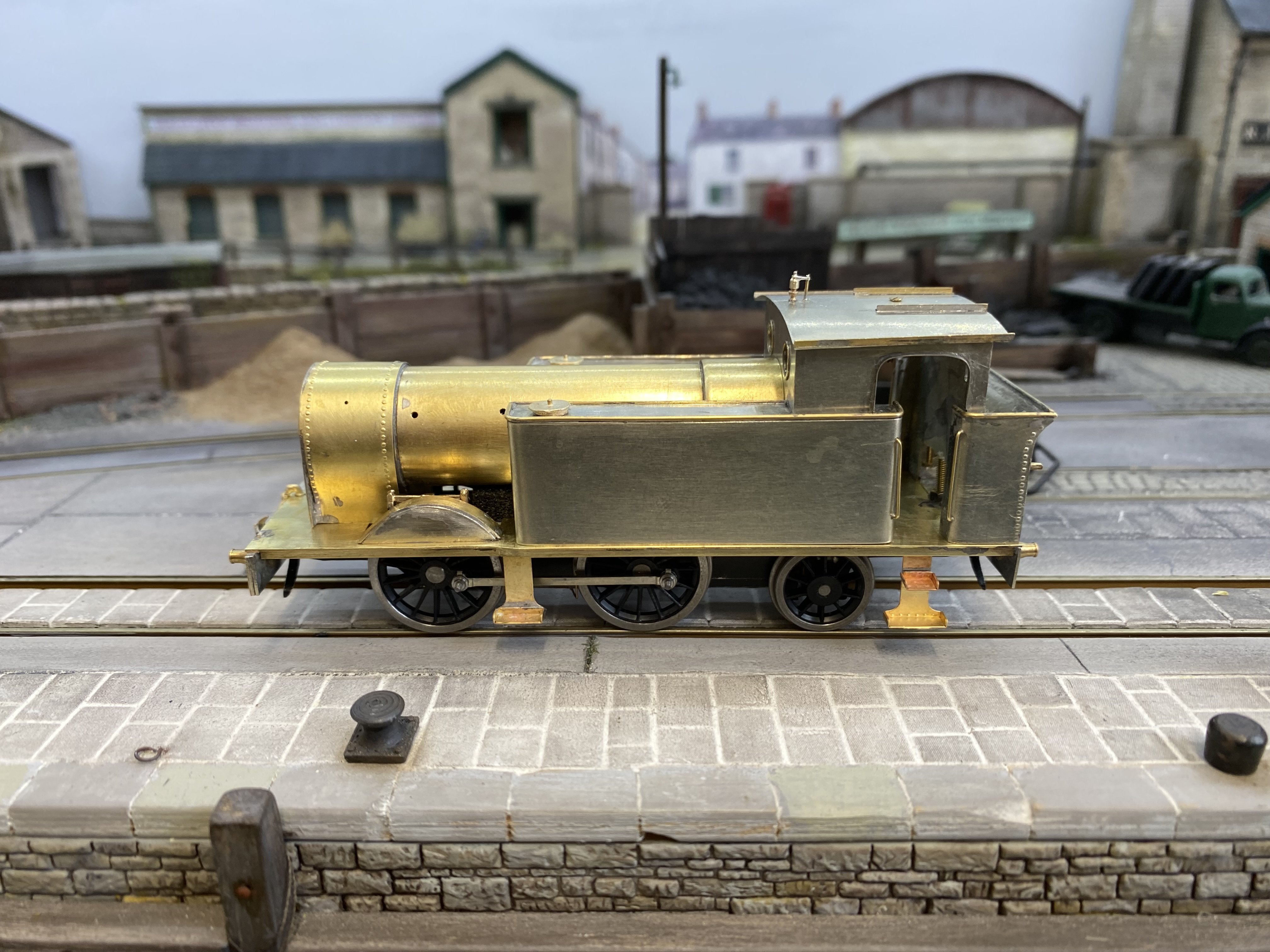

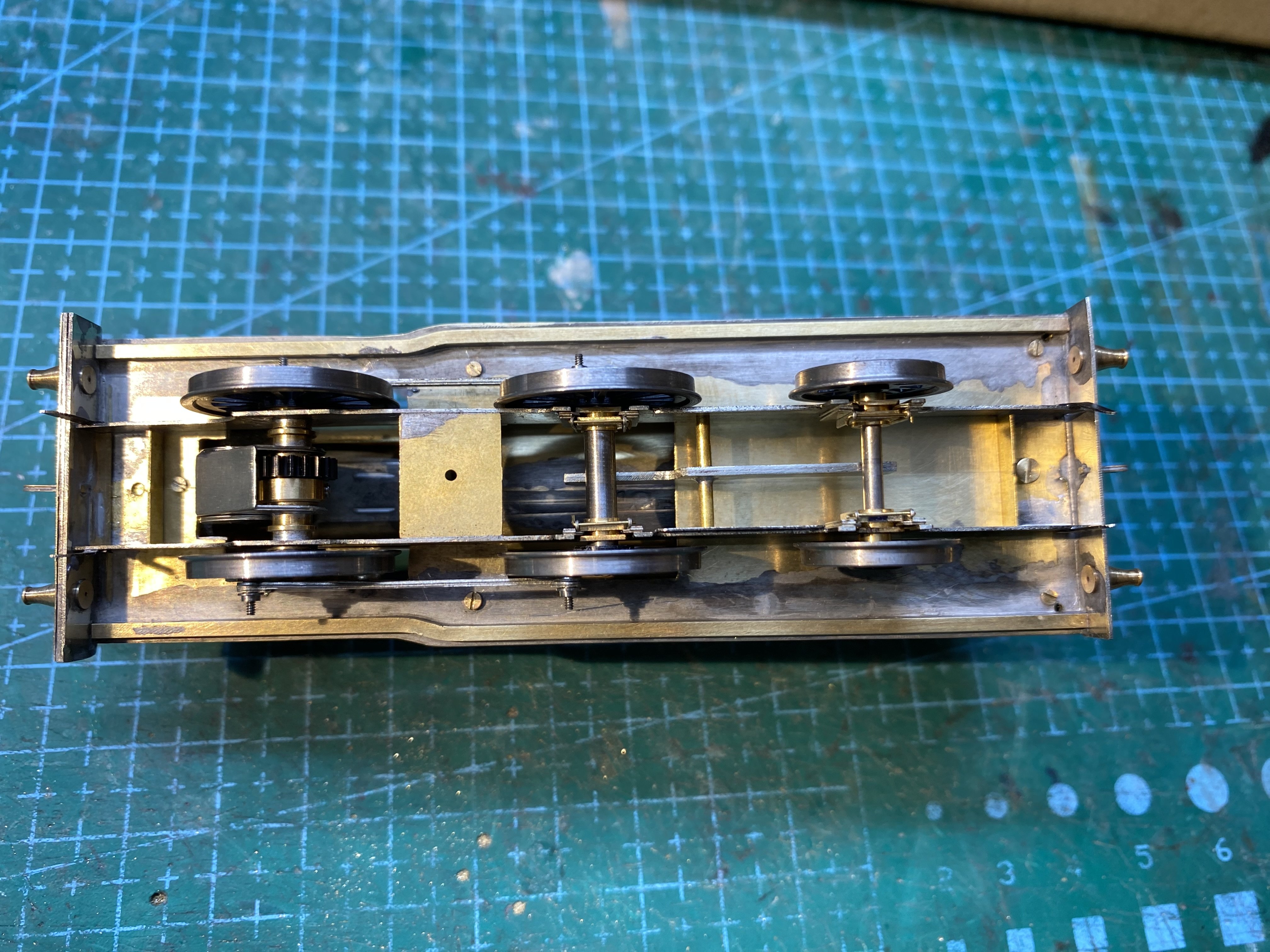

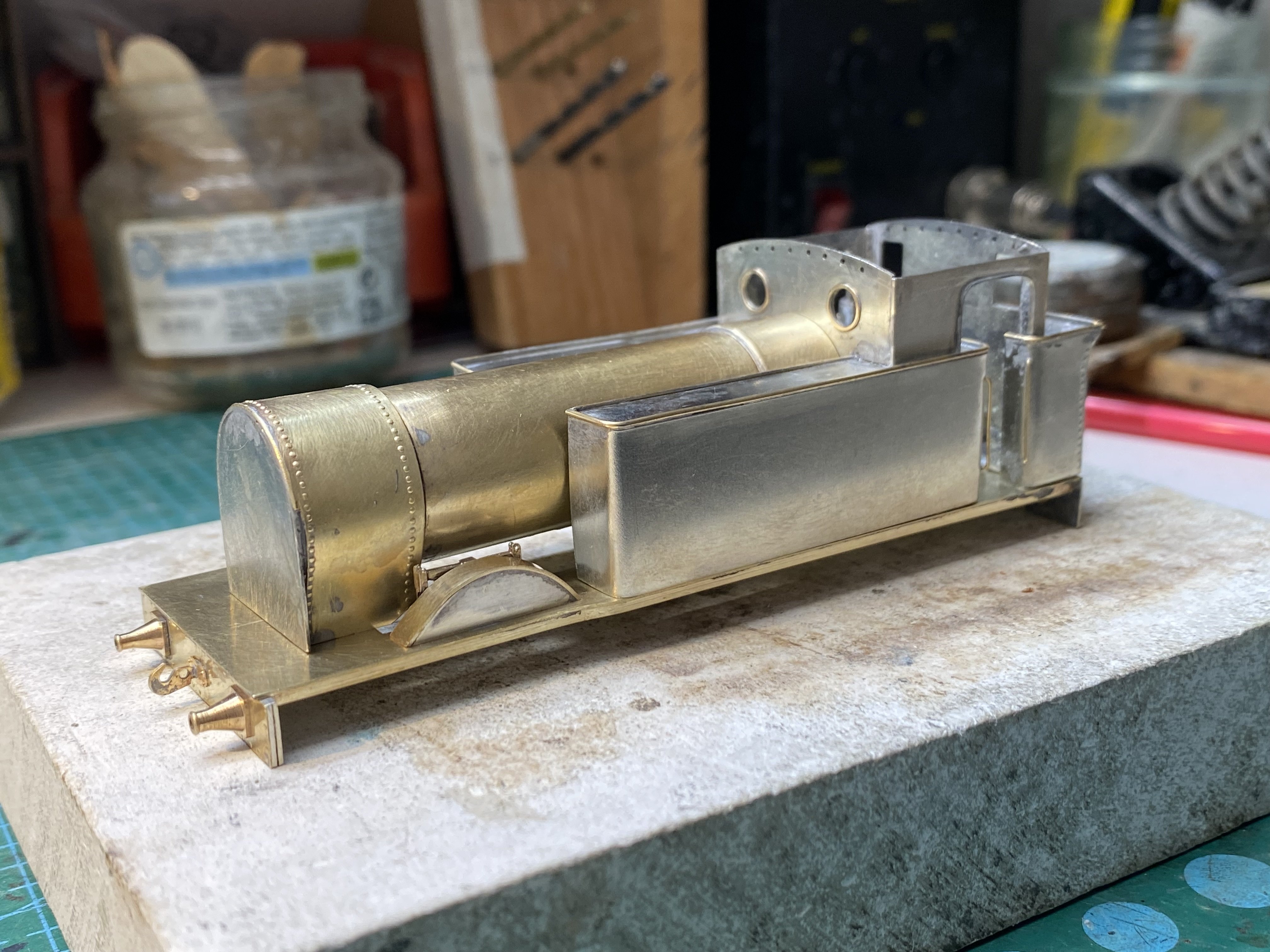

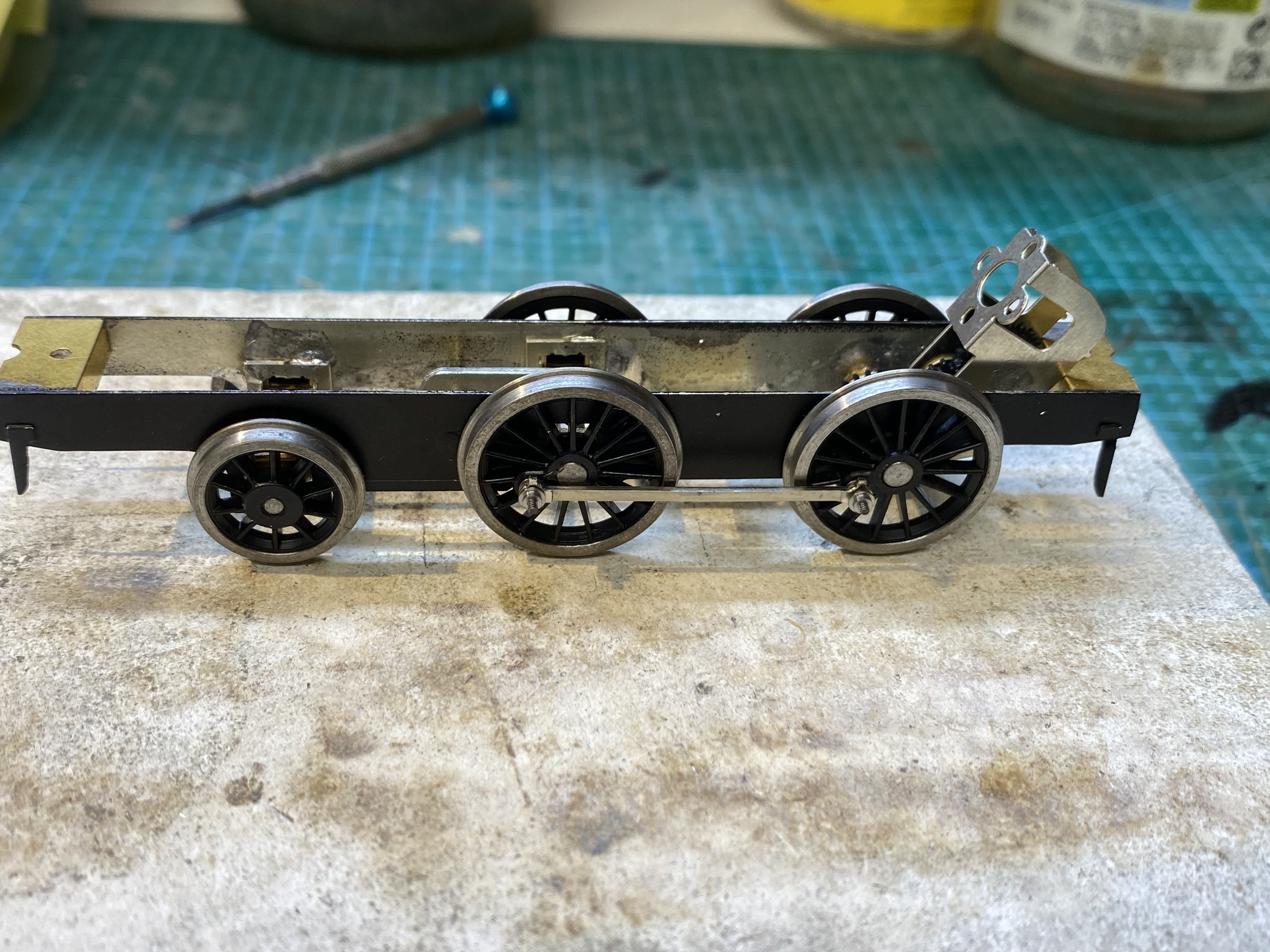

The chassis for No.9 is finally wheeled up and the rods are on. Rolls smoothly under finger power - first hurdle cleared. Crankpin nuts tightened up. Still rolling smoothly - second hurdle negotiated.
Motor fitted and power applied - hurdle three behind us!

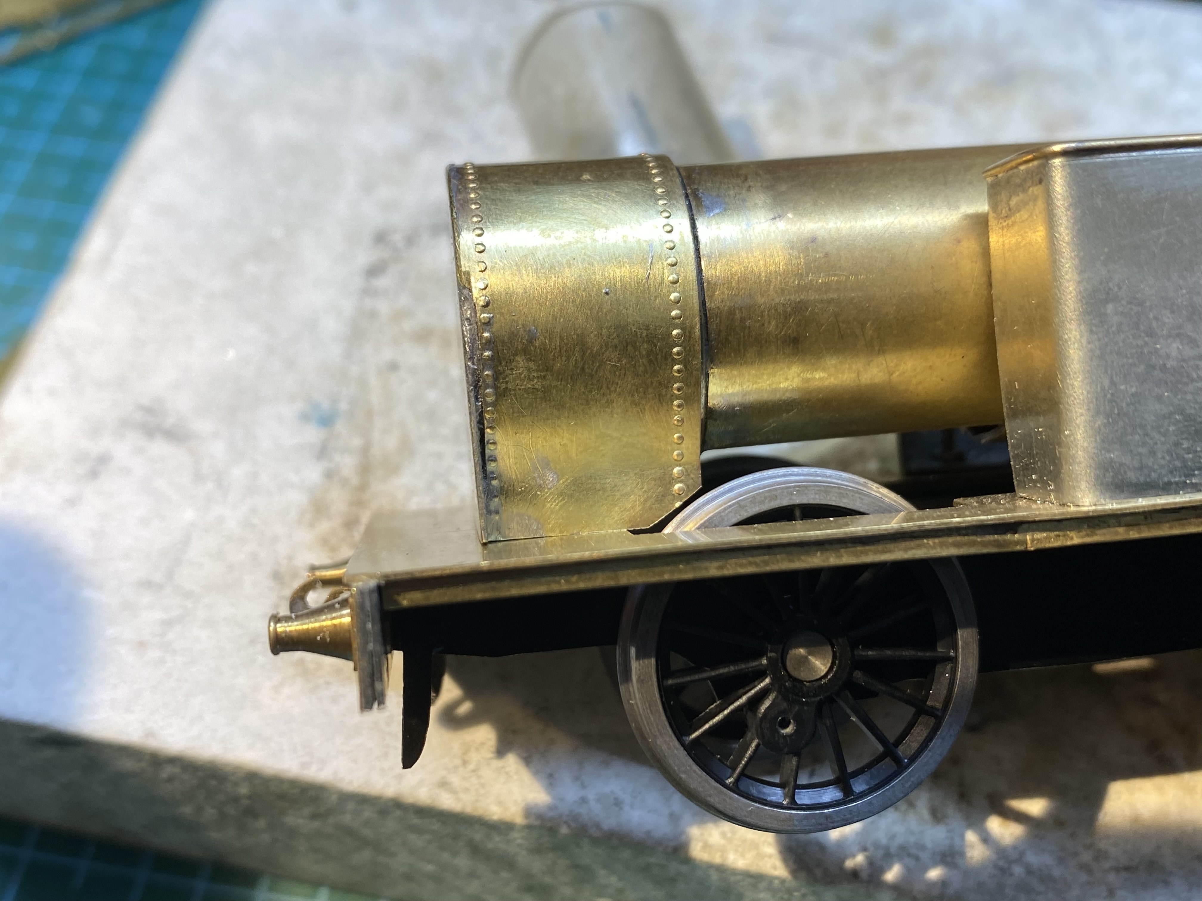

Meanwhile, the bodywork is coming along. The smokebox wrapper/saddle was a pig to attach as usual, the main difficulty being getting enough heat into the job whilst trying to keep things straight and tightly wrapped. Destroyed 2 in the process. I have now embossed about a million rivets.

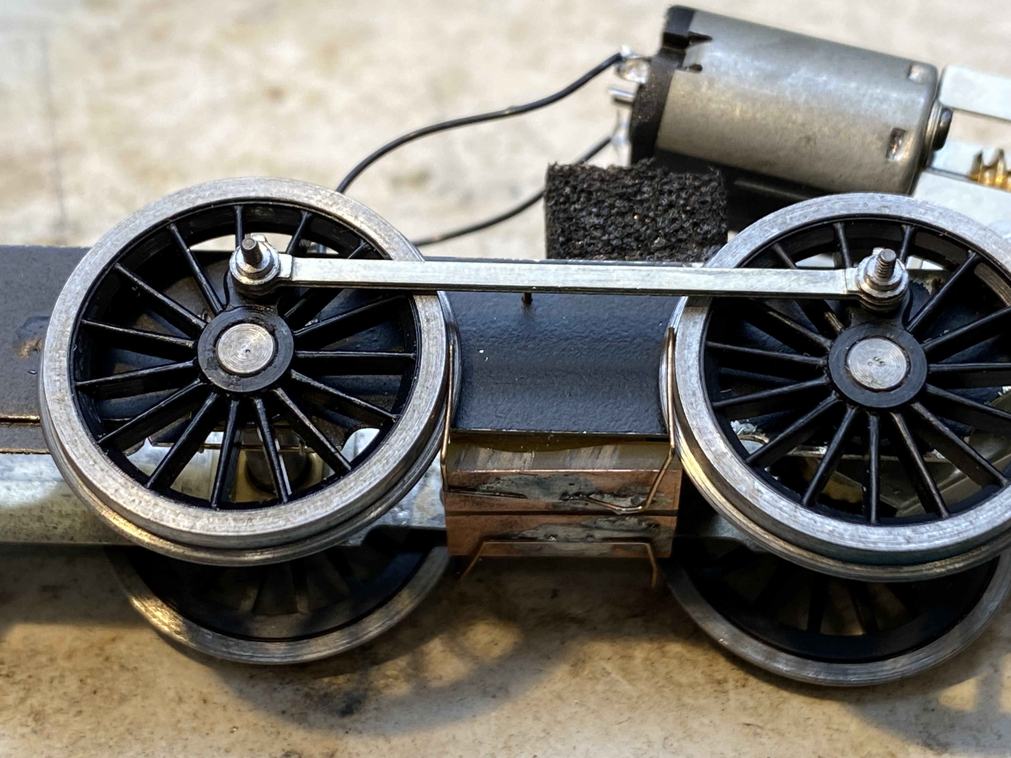

By contrast, the clash between smokebox and front wheels mentioned in the previous post was easier to fix than I expected. Just needed a sliverette (of course that's a word) clipped off the rear edges of the saddle thus ...
... and it's all more or less hidden behind the splashers.

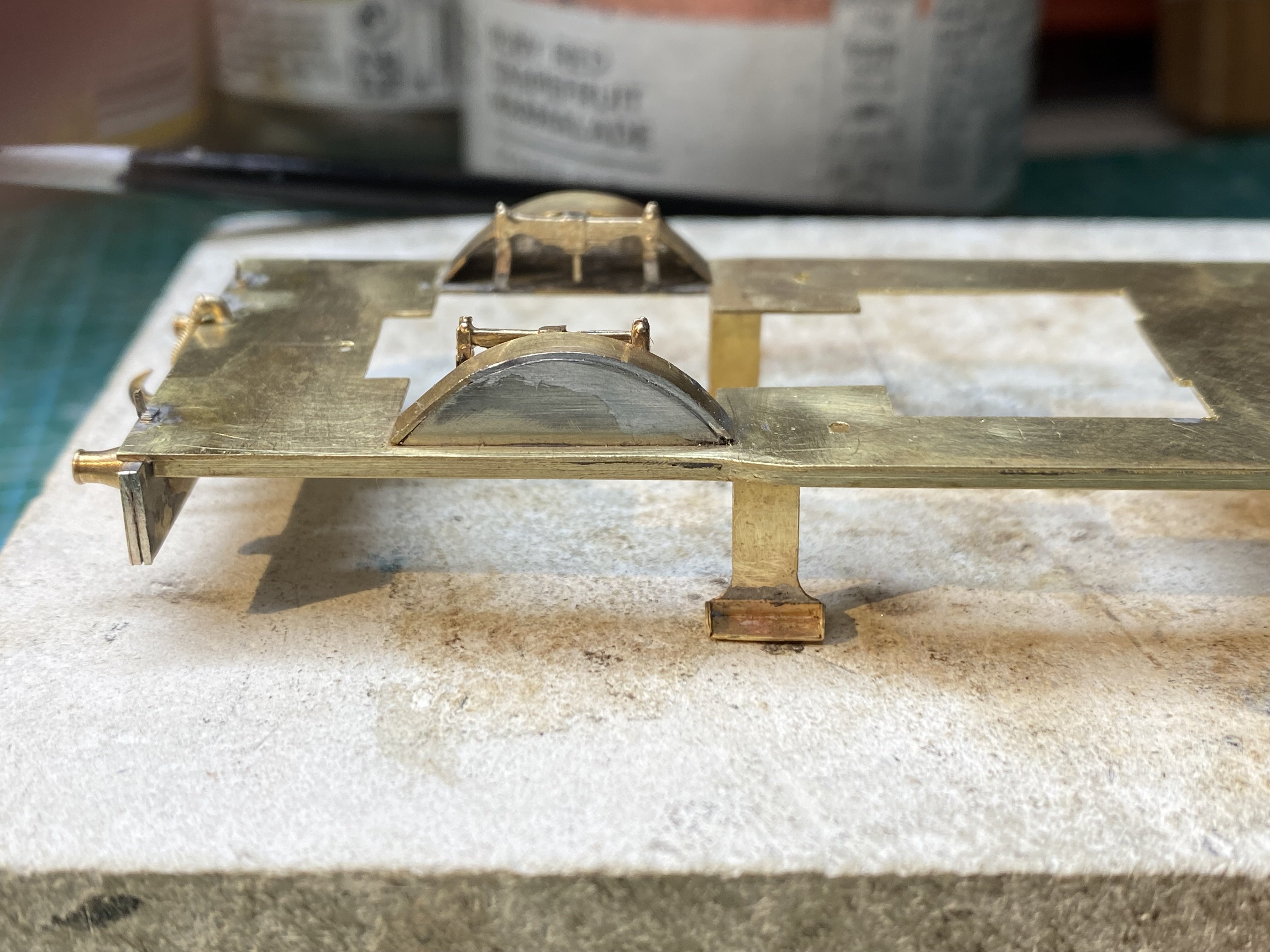

Some cutting and filing got the motor/gearbox to fit inside without too much having to be removed from the boiler bottom.
Drive to the front axle and a compensation beam between the other two...
... and this is progress to date.
Chassis now needs brakes and pickups but that's a trauma for another day😄
Alan

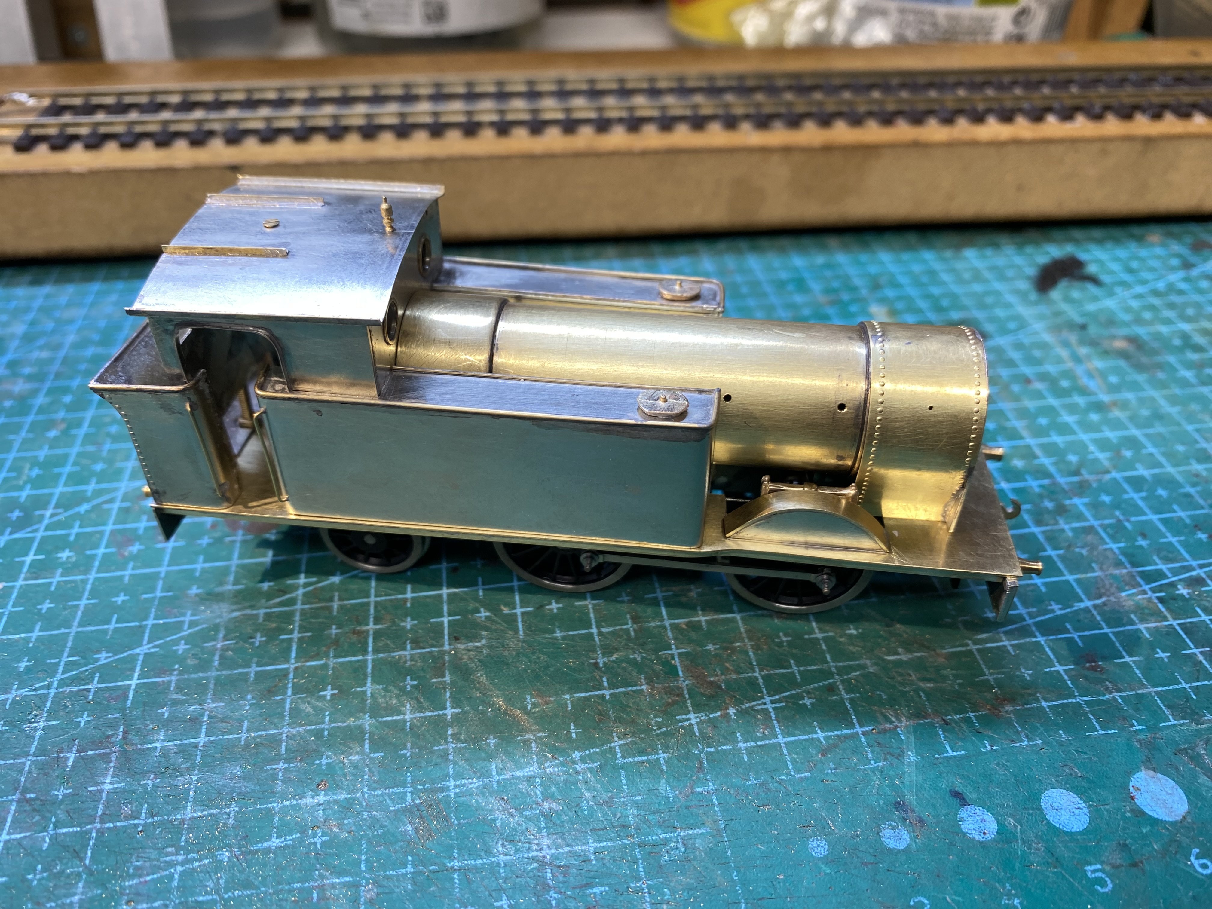

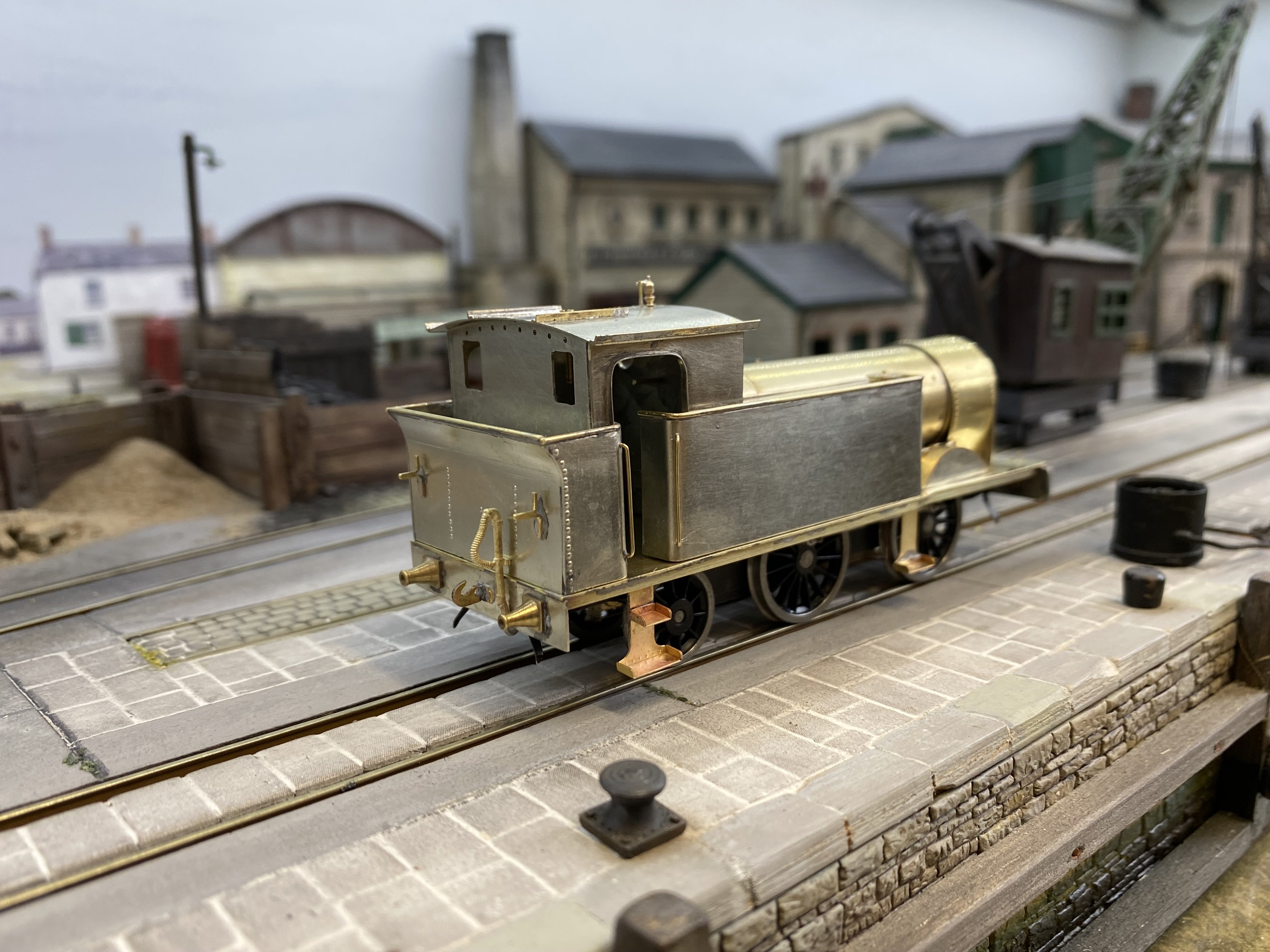

Some detail added to No.9 while the stormy winds blew outside. Lamp irons (scratch), vacuum pipes (Gibson) and steps (More Iain Rice designed etches from Wizard).
Earlier, when I wasn't looking, this happened...
Absolute pain to fix neatly. The fitter responsible has been sent back to soldering school for the rest of the week.
This will probably need filler
No.9 now has pickups on the driving wheels - 31 swg phosphor bronze wire bearing on the wheel treads.  I'd rather make the contact on the wheel flanges from above but that's been nearly impossible to arrange on this one without risking them shorting on the running plate or clashing with the brake hangers which still need to be added.
Having said that, my model of BCDR No.6 has the same arrangement as this and has been reliable.  So far.
Trial run under DC - shuffling along nicely.
