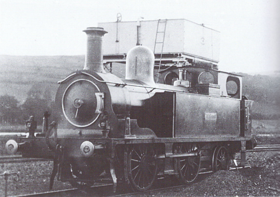

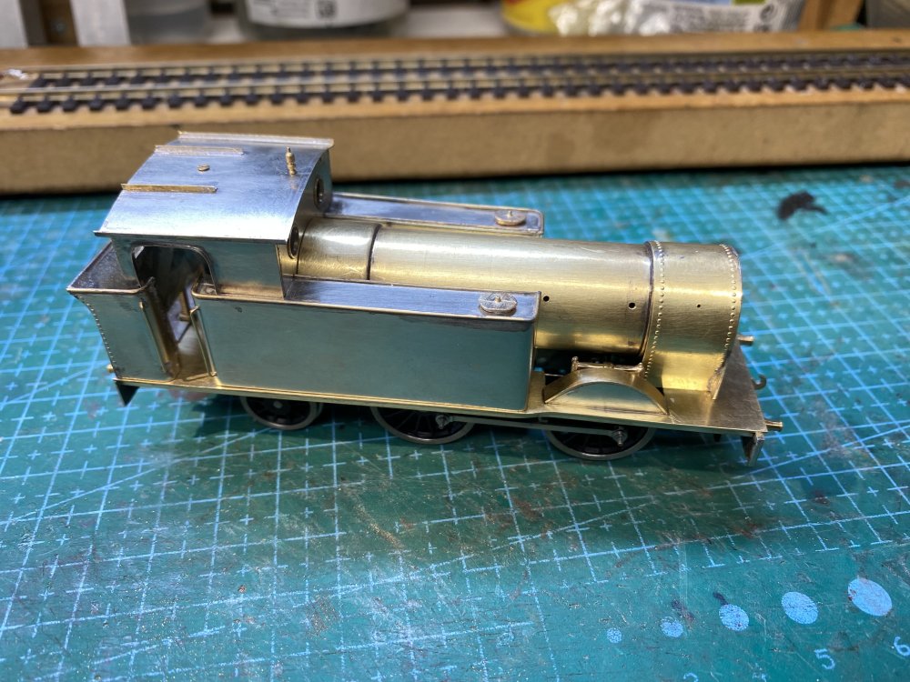

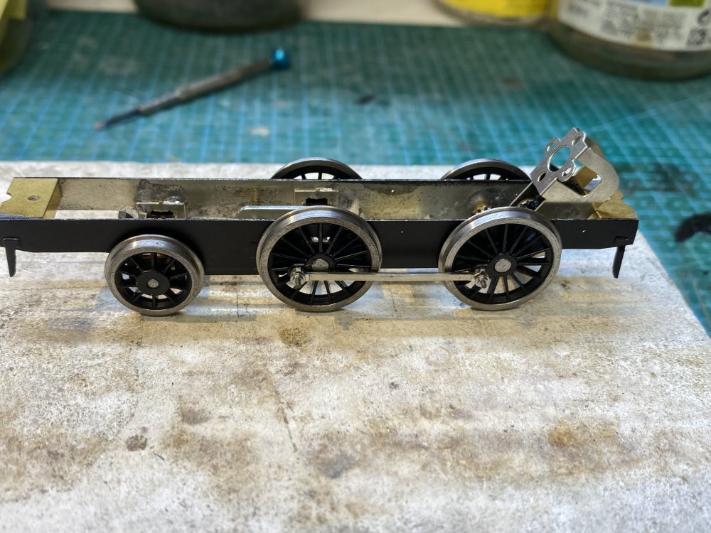

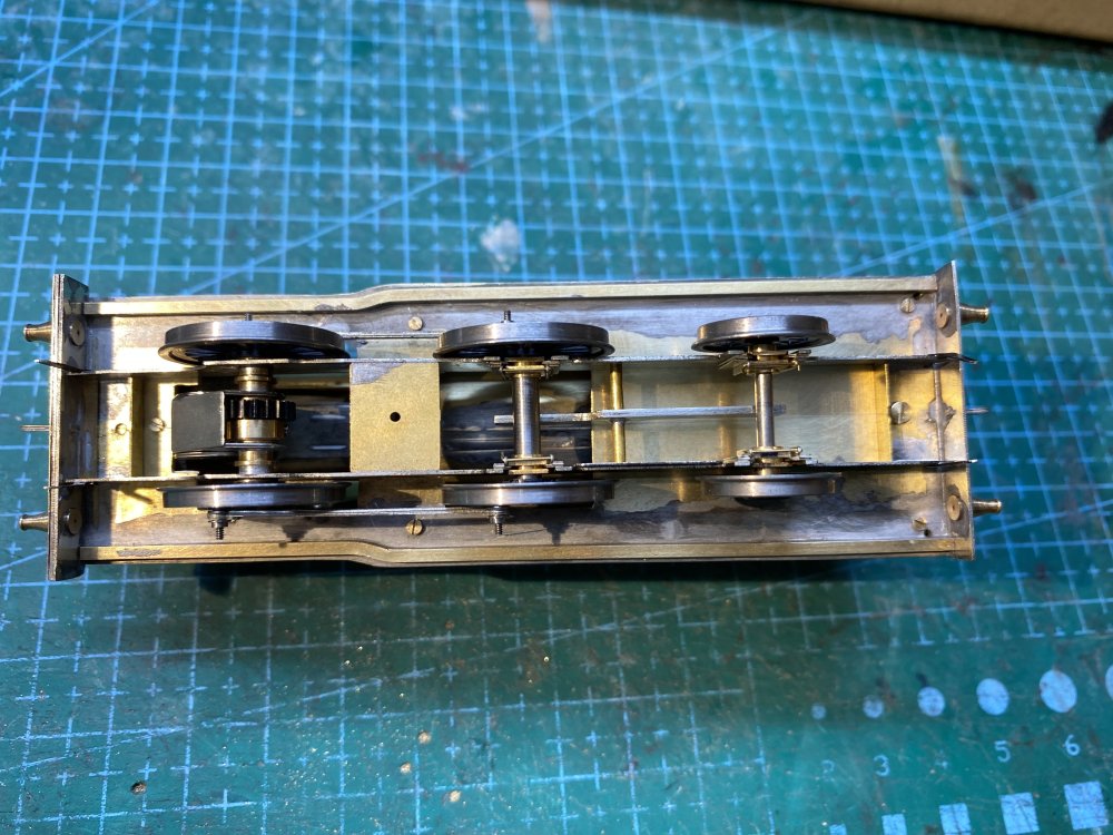

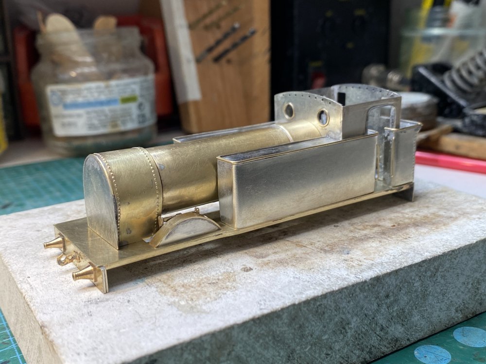

Tullygrainey Posted December 8 Author Posted December 8 15 hours ago, Galteemore said: Excellent. Old no 9 - which was re numbered when the BCDR’s last 4-4-2Ts were delivered c1945 I think Yep that's the one David. Built originally as a tender engine in 1887 but subsequently converted to a tank engine. Marked down for scrapping in 1929 but survived derelict until the UTA takeover. Lost its number to a new bogie tank in 1945. (Information from Desmond Coakham's book) I thought it might be interesting to try building a 0-4-2 chassis with drive on the front axle and the other two axles compensated. It ought to be possible to hide a motor/gearbox in the smokebox and boiler. Much the same as my chassis for BCDR No.6, just the other way round. 2
Horsetan Posted December 8 Posted December 8 1 hour ago, Tullygrainey said: ....I thought it might be interesting to try building a 0-4-2 chassis with drive on the front axle and the other two axles compensated. It ought to be possible to hide a motor/gearbox in the smokebox and boiler.... Anyone fancy a go at Sambo?

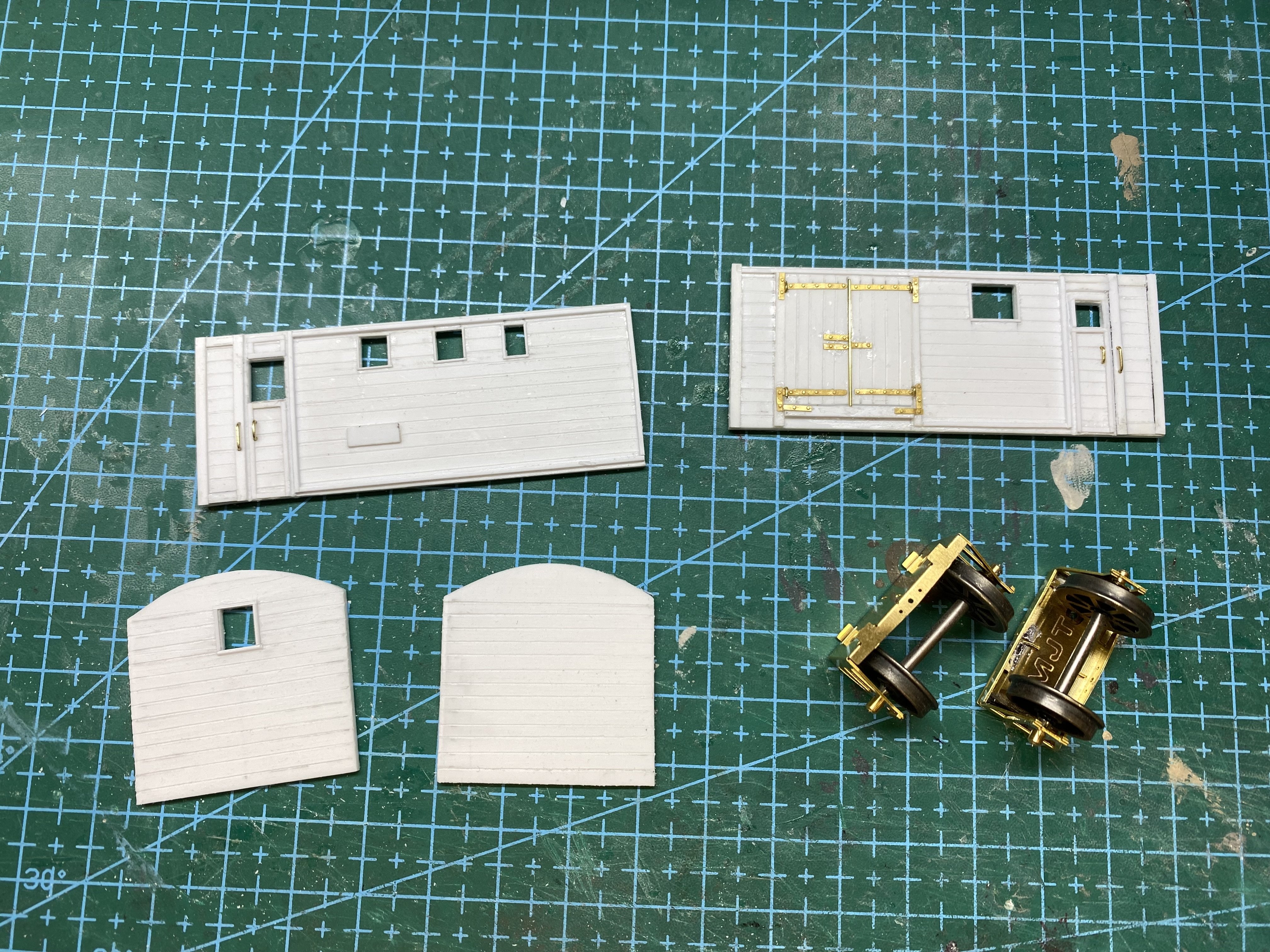

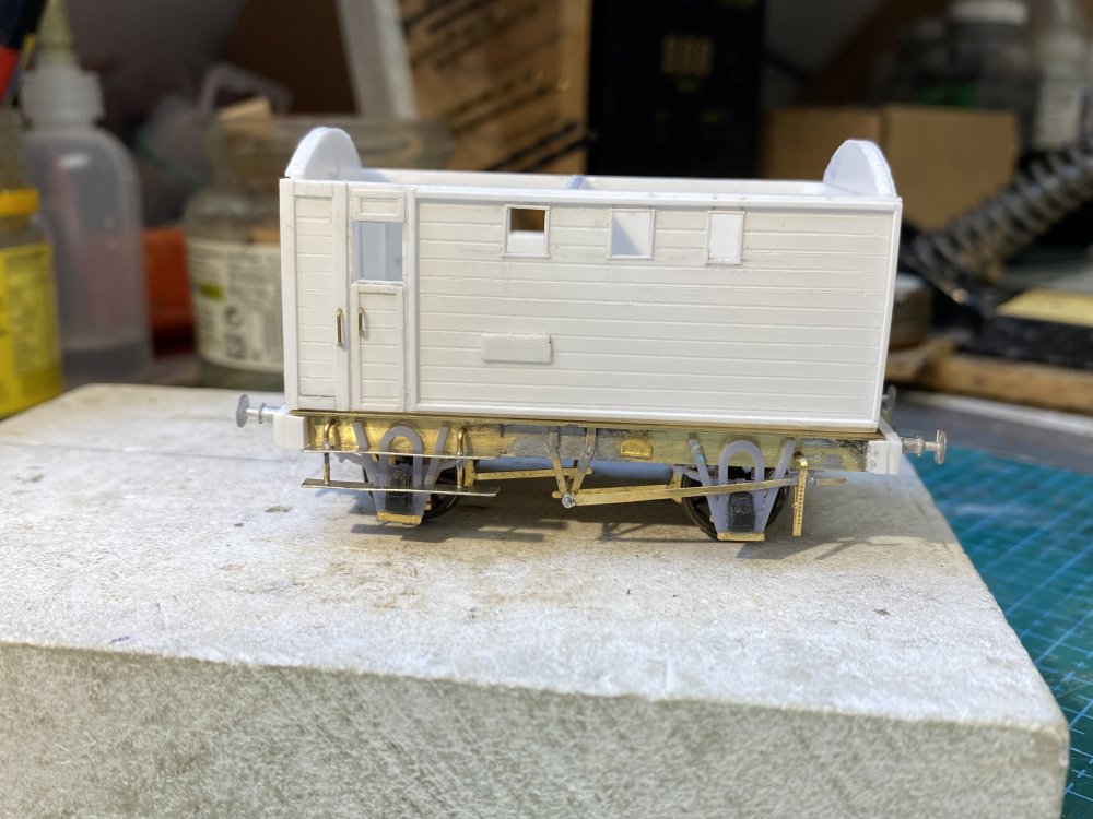

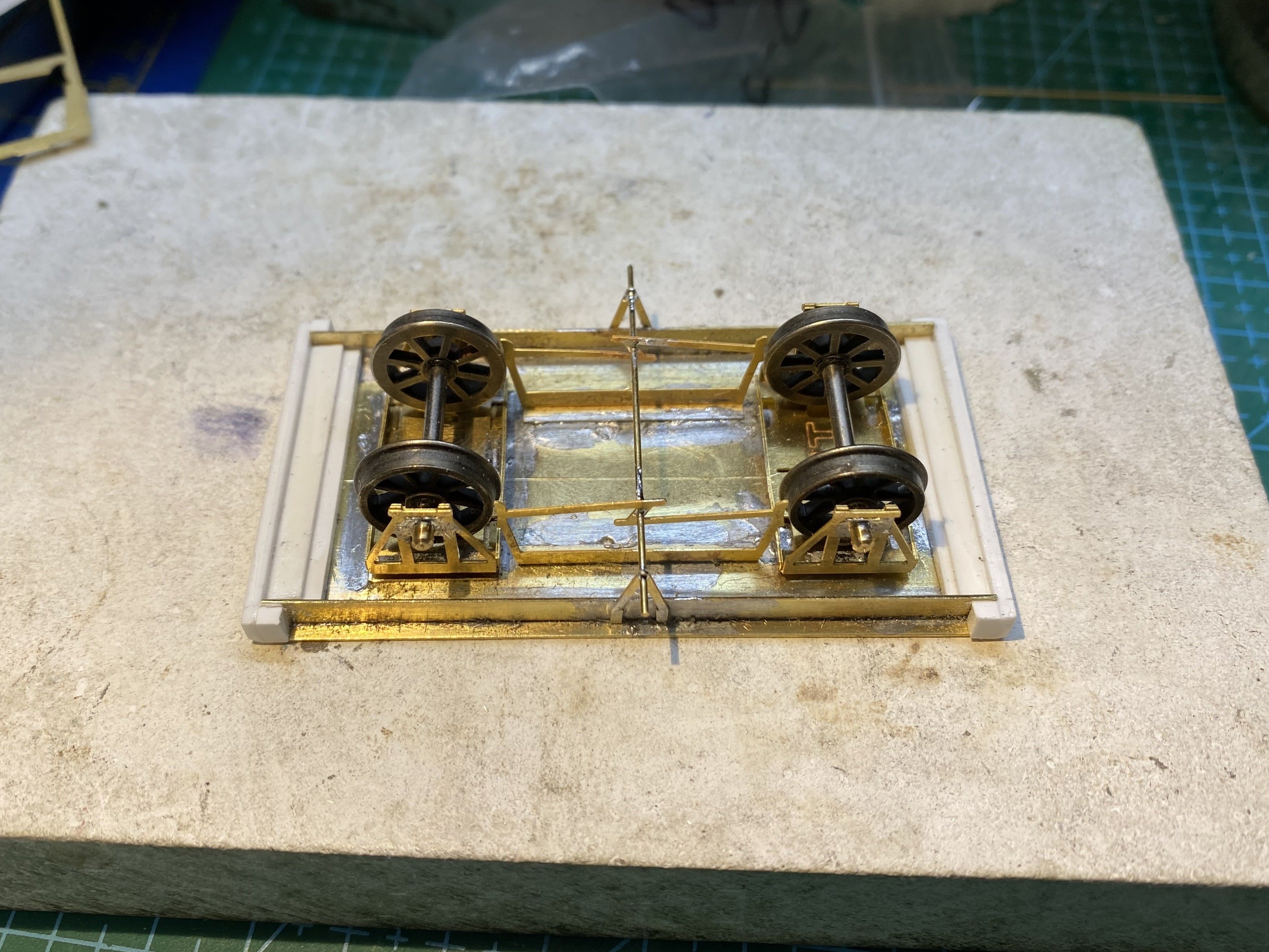

Tullygrainey Posted Tuesday at 19:41 Author Posted Tuesday at 19:41 A wagon for Kilmore. This is the Weighbridge Fitters' van, apparently a one-off with no number. Desmond Coakham speculated that it was built on the chassis of a ballast brake ordered to be broken up in 1908. I used plasticard for the body with some brass strapping from an Alan Gibson etch. The sides apparently differed from one another but the two photos I was able to find were both of the same side so I guessed the layout of the hidden side based on the description in Desmond Coakhams' book. (The Belfast and County Down Railway, Colourpoint, 2010) The chassis uses an MJT compensation etch to create one fixed and one rocking axle mounted on a brass floor. These will do the work of carrying the wheels behind the scene. Brake details came variously from Gibson and Brassmasters wagon chassis etches. All of this then hides behind the outside W irons typical of BCDR rolling stock. They are cosmetic in this model and are superglued to the sole bars. Along with spring units, they are pre-production 3D printed items from Enda Byrne (ckprints.ie) which I got the opportunity to try out (many thanks to Gareth Brennan, Kieran Lagan and Enda for moving this along). They're finely printed and suit this project well. I used tissue paper to texture the roof, flooding it with liquid poly to bond it to the plastic card. The skylight is also a guesstimate since the available photos don't show it well. Next, paint, transfers and weathering. Some couplings, then it's just about ready to go. There are a number of errors (should have a window in each end for one thing) which I'm not going to lose sleep over. 5 2
popeye Posted Tuesday at 21:12 Posted Tuesday at 21:12 That's a nice wagon and looks well. Now take a few days off for Christmas 1
Colonel Posted Wednesday at 07:01 Posted Wednesday at 07:01 Unusual, to say the least, but all the more interesting! Fair bet that nobody is going to do an rtr version any time soon as well - though these days, who knows? Either way, another fine model. As for time off over Christmas, having hosted the family diaspora last week, it tends to be fairly quiet and having just seen the dismal range of stuff that the media has to offer am hoping Santa fulfils my usual wishlist of things to read, things to drink and things to make. Have a good one everybody. 2
Galteemore Posted Wednesday at 08:00 Posted Wednesday at 08:00 Fabulous and unusual. Your subtle finishing really works well 1
