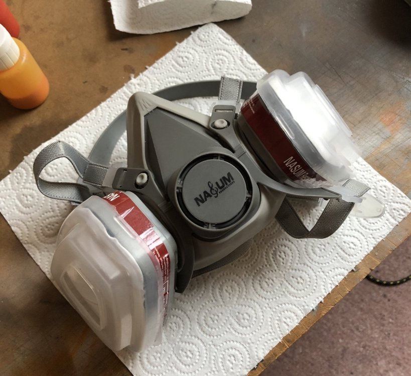

Noel Posted May 20, 2023 Posted May 20, 2023 (edited) 10 hours ago, Gabhal Luimnigh said: Evening all, I'm going to have a go at repainting stock, have any of you bought an airbrush recently, good or bad or alright? Where are they available on this island? I have plenty bits and pieces I can practice on, thanks in advance. A few visuals better than lots of words. Started with airbrush about 6 years ago thanks to some advice and guidance from Richie and others. I started using Tamiya and Railmatch acrylics cause less noxious and less smelly indoors, also was easy to mix CIE orange tan using Tamiya. I’ve since adopted Valejo acrylic paints. Acrylics are water based so easier to clean equipment after painting. Best bit of advice was not to bother buying expensive airbrushes, this Veda no longer in production cost about €28. I was terrified of taking airbrush apart to clean it after first session test, it took me an hour I was so pedantic, then I got cleaning time down to 10mins, now about 120 seconds. In the beginning it too more time to clean than airbrush. It’s not rocket science once you get used to quickly dismantling and putting back together. This airbrush cleaning pot reduces nasty fumes when cleaning airbrush IPA readily available from pharmacy shops is handy for cleaning. Do not use white spirits. compressor was about £80 from Bartsharp in uk prior to brexit costs. Worth spending the few extra euro for one with an air reservoir bottle, and a moisture trap. The air bottle means the pump only runs every now and then to fill the bottle so you get a smoother constant flow of paint and its quieter as most of the time the motor is not running. Acrylics are more forgiving and easier to clean up as they are water based. MY wife would not tolerate the solvents in enamel paints but they can flow better through an airbrush. If you properly thin acrylic paints and use Vallejo flow improver they will not clog up the airbrush. Lower air pressure also a help (ie 20psi rather than 40). Vallejo 'model air' are pre-thinned but I still add a little more water based thinner. My first resprayed coach. Good quality masking tape is essential. It takes more time to accurately apply masking tape at the various stages than painting time. Patience also required, don’t rush to next step in a job. This was done using the standard ‘reverse masking’ technique. YouTube is your friend and university for learning, and giving it a go, start with some older stock. More than anything have fun and enjoy the learning process. The more you do it the quicker and better you’ll get. My first airbrush stayed in its ca se for nearly a year such was my fear. https://www.bartsharpairbrush.co.uk/?doing_wp_cron=1684564496.7064940929412841796875 WARNING: Do not airbrush varnish indoors or near your other stock. It will turn all windows opaque. When varnishing models you will have to remove all glazing and windows or carefully mask over them with tape or maskol paint. Or they will end up opaque milky white. Edited May 20, 2023 by Noel 6 Quote
