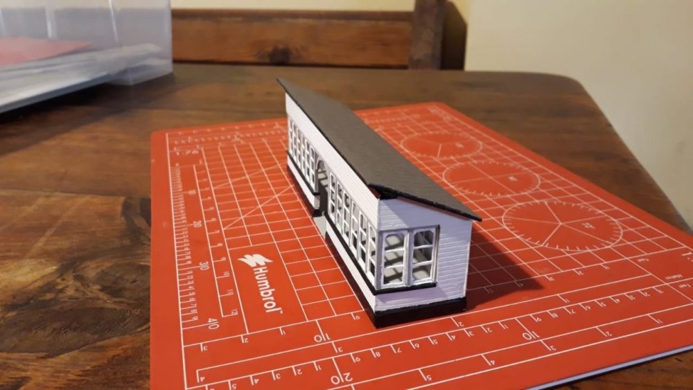

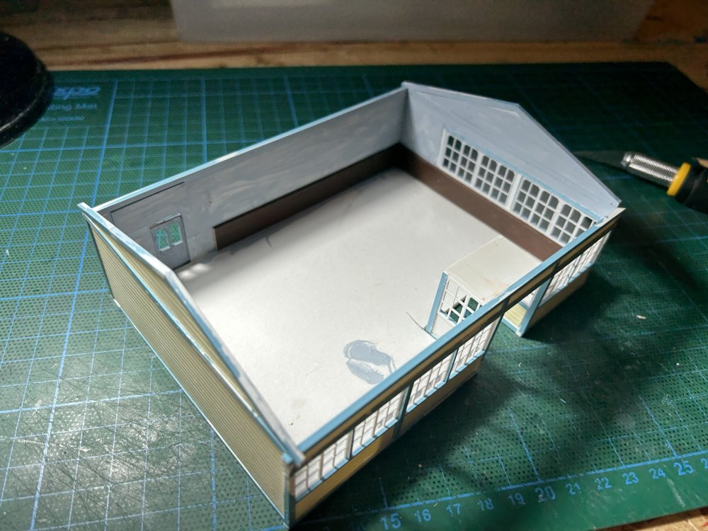

Patrick Davey Posted May 31, 2023 Author Posted May 31, 2023 Some basic interior detailing being added to the pavilion along with roof lettering. 10

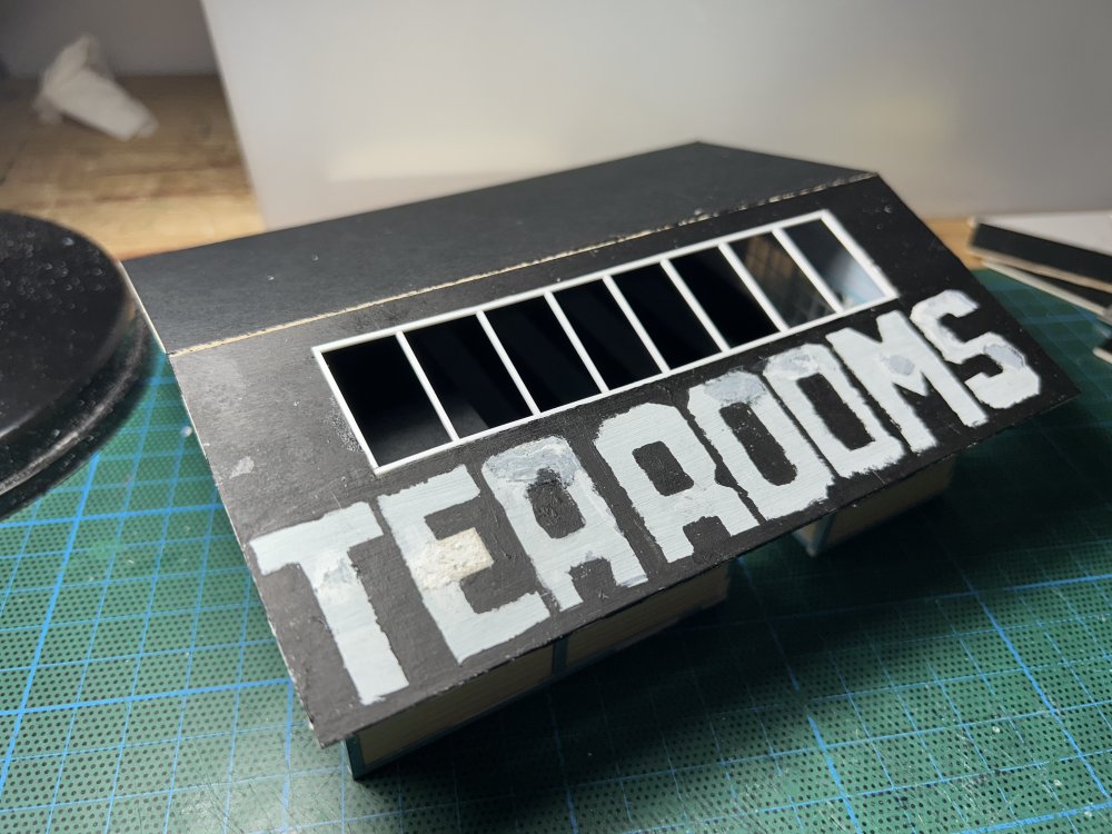

Patrick Davey Posted May 31, 2023 Author Posted May 31, 2023 My obsession for interior detail returns…..and I just had to create skylights, so it might be seen! 12
Tullygrainey Posted June 1, 2023 Posted June 1, 2023 Lovely work Patrick. Just taking in the artwork on the walls now I'm viewing this on a desktop. When I looked at it on my phone earlier, I took them for windows! Can't quite identify the artists though Alan 2
Patrick Davey Posted June 1, 2023 Author Posted June 1, 2023 3 minutes ago, Tullygrainey said: Lovely work Patrick. Just taking in the artwork on the walls now I'm viewing this on a desktop. When I looked at it on my phone earlier, I took them for windows! Can't quite identify the artists though Alan Thanks Alan: they are all originals by someone called Scalescenes Downloads...... 1 2
Tullygrainey Posted June 1, 2023 Posted June 1, 2023 Of course! Should have known. He did some work at Loughan Quay... 2
DJ Dangerous Posted June 1, 2023 Posted June 1, 2023 (edited) Lovely jailhouse feel to those long bench tables. Edited June 1, 2023 by DJ Dangerous 1

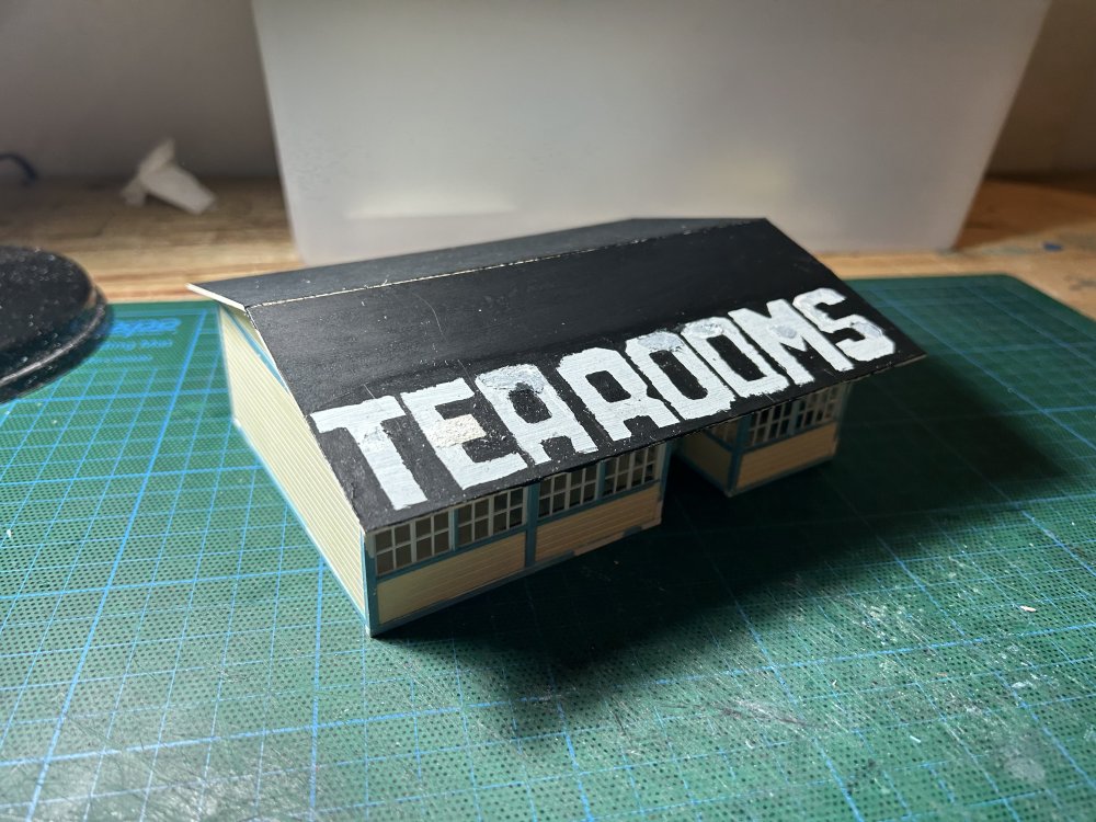

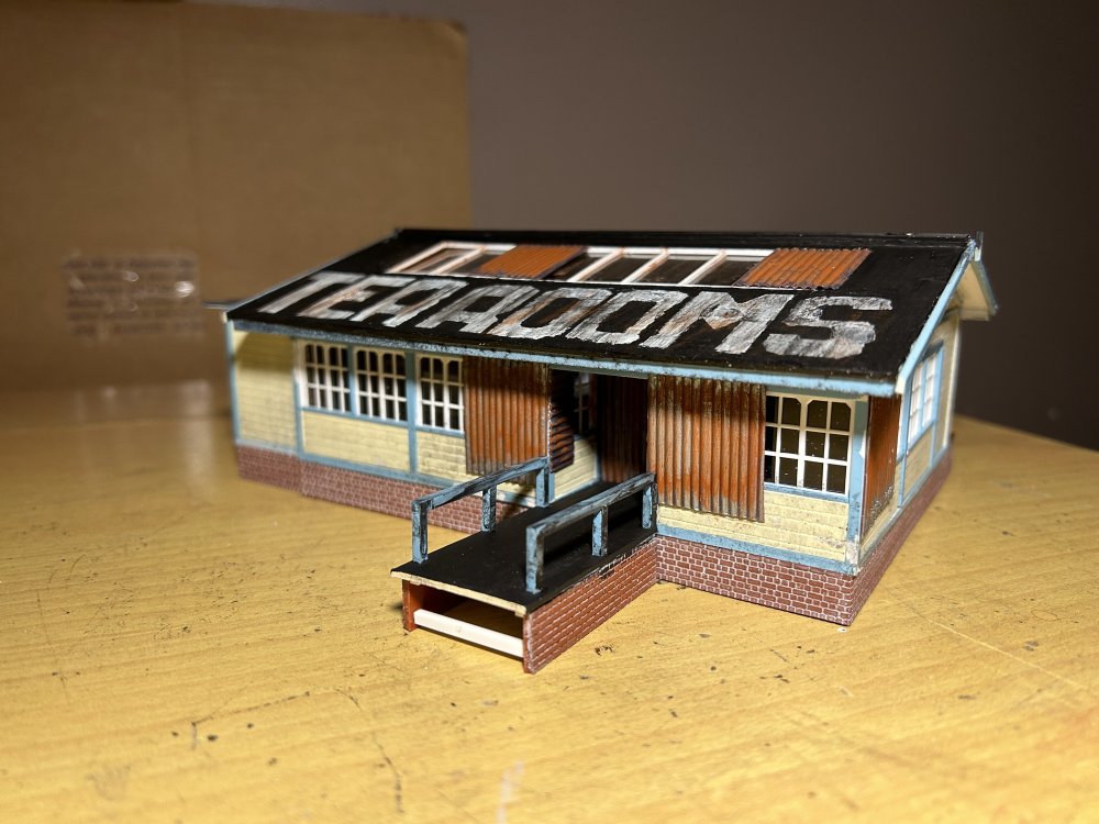

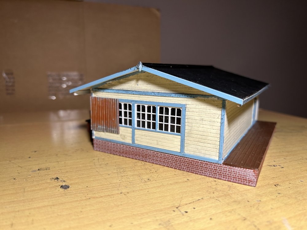

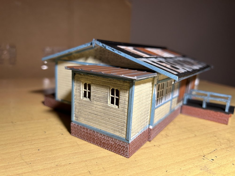

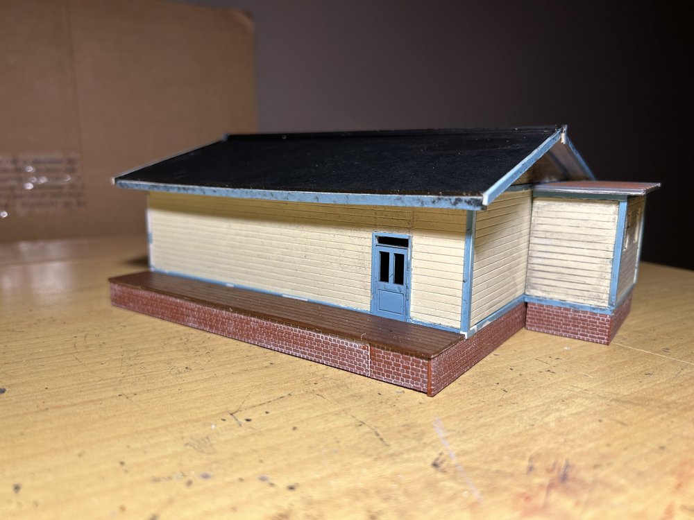

Patrick Davey Posted June 2, 2023 Author Posted June 2, 2023 (edited) Tea room completed. Pity it’s closed, looks like it would have been a nice spot for a coffee and an iced diamond…. Edited June 2, 2023 by Patrick Davey 12 1

Mayner Posted June 3, 2023 Posted June 3, 2023 2 hours ago, Patrick Davey said: Tea room completed. Pity it’s closed, looks like it would have been a nice spot for a coffee and an iced diamond…. Almost looks like it was shut down by the Food Standards people or District Health Board. 4
leslie10646 Posted June 3, 2023 Posted June 3, 2023 9 hours ago, Patrick Davey said: Great suggestion @leslie10646 - it would surely have sash windows? Nice one Patrick - I really asked for that! Now, about the advertising ON THE ROOF -are you expecting passing aircraft to "'drop in" for a cuppa char? I assume that Clogherhead is going to include a local Flying Club with a suitably flat-ish field to land bi-planes? 3
Patrick Davey Posted June 3, 2023 Author Posted June 3, 2023 (edited) A friend on another forum wanted to know who ran the tea rooms and I was able to find out the following information from a Co. Louth local history website: ".....the tea room at Clogherhead station was run by a retired husband and wife team, Earl Grey and Nan Barrie. Their friend's granddaughter would occasionally help out at busy times, she was called Miss Kipling - she was fifteen and exceedingly good at her job but sadly they had to let her go due to her fondness for putting her hair in a bun. There was also a Miss Cherry and she would definitely bake well but some of her products were a bit crepe. The tea house was very popular with visiting troops of brownies and it did well until the 1970s when it hit a bit of a rocky road and the turnover began to crumble." Edited June 3, 2023 by Patrick Davey 1 11

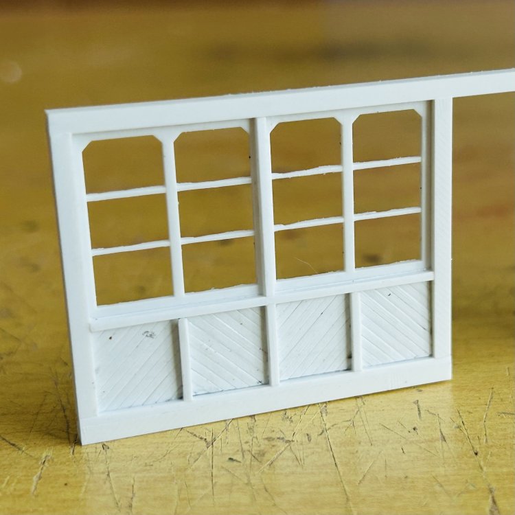

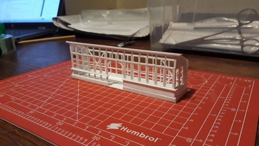

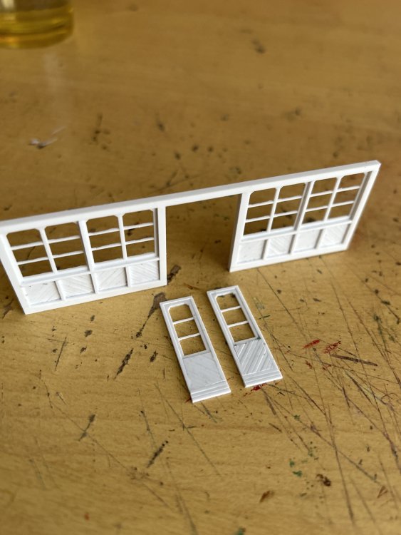

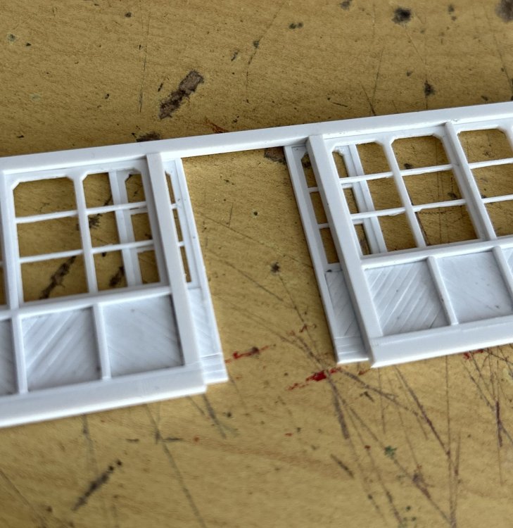

Patrick Davey Posted June 4, 2023 Author Posted June 4, 2023 So it’s on to the station building next, which is going to be based on the very attractive example at Dunleer. A lot of Great Northern station buildings had a glazed wooden panel fronting the platform so that’s where I have started. The diagonal boarding was created by gluing together 1 mm plastic strips and cutting them into 10 mm² panels with the strips set at 45°. There is another layer of small windows to go along the top. The panels had sliding doors, so I might fix these in an open position. 6 6
Galteemore Posted June 4, 2023 Posted June 4, 2023 Classic GNR Patrick. Agreed- Dunleer is a lovely building. Are those signalbox windows again? 1
Patrick Davey Posted June 4, 2023 Author Posted June 4, 2023 1 minute ago, Galteemore said: Classic GNR Patrick. Agreed- Dunleer is a lovely building. Are those signalbox windows again? Yip - the last ones I had, so I’m glad I didn’t break any! 1 1
Patrick Davey Posted June 4, 2023 Author Posted June 4, 2023 18 minutes ago, Patrick Davey said: Yip - the last ones I had, so I’m glad I didn’t break any! The Ratio Midland Railway cabin windows have to have some of the vertical framing removed to match the GN ones and it can be a heart stopping moment each time….. 1 1

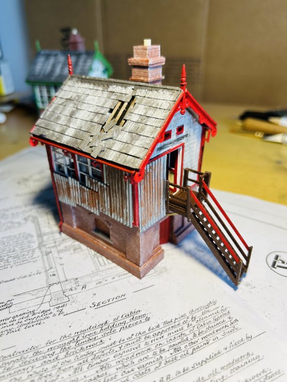

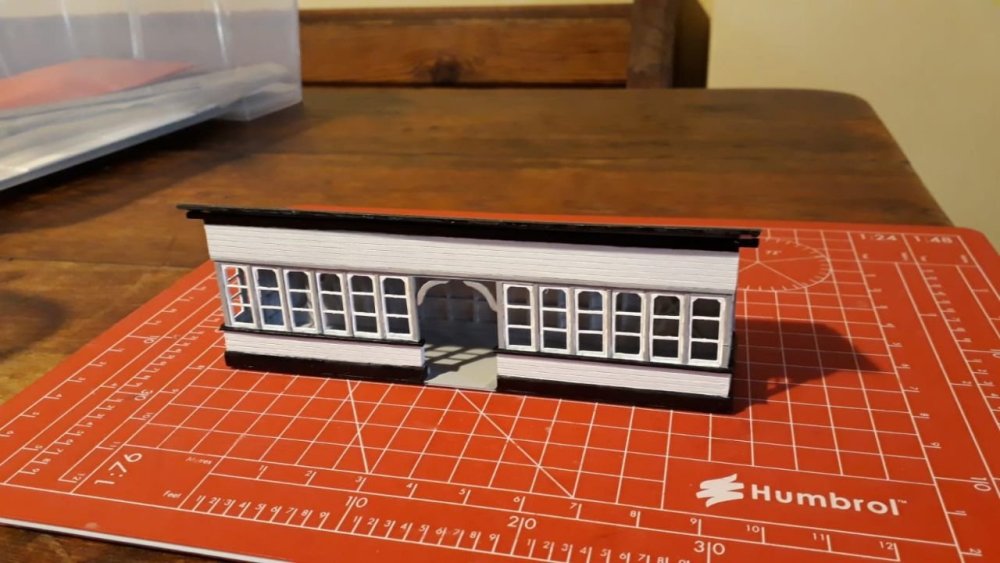

Louth Posted June 4, 2023 Posted June 4, 2023 Dunleer is an great prototype and your model looks great (the island waiting room in Drogheda is somewhat similar to the now demolished one in Dunleer). I recently completed a GNRI platform shelter using Ratio signal box windows. The building had to be constructed slightly over-scale to get the proportions correct. Dimensions were based on the shelter in Gormanstown which is one of the few remaining on the system. I have almost completed a GNRI signal box, again using the Ratio windows, but am a bit stymied by how to do the gable-end finials. Help anyone?? 7 2
Patrick Davey Posted June 4, 2023 Author Posted June 4, 2023 (edited) 1 hour ago, Louth said: Dunleer is an great prototype and your model looks great (the island waiting room in Drogheda is somewhat similar to the now demolished one in Dunleer). I recently completed a GNRI platform shelter using Ratio signal box windows. The building had to be constructed slightly over-scale to get the proportions correct. Dimensions were based on the shelter in Gormanstown which is one of the few remaining on the system. I have almost completed a GNRI signal box, again using the Ratio windows, but am a bit stymied by how to do the gable-end finials. Help anyone?? That is an absolute beauty well done! I would like to see photos of your cabin as well? For a previous build, I had used finials from Shapeways, but they were very easily broken, so I have used whitemetal ones for my recent cabin builds, I shall look up the link where I ordered them from and update this post accordingly. That is a really beautiful shelter, and looks like a very neat build, would like to see more! UPDATE: Here is the link to the whitemetal finials I used: https://www.wizardmodels.ltd/shop/buildings/slc012/ Edited June 4, 2023 by Patrick Davey 2 1
Louth Posted June 4, 2023 Posted June 4, 2023 Thanks Patrick. I will take a few photos and put them up. I'll check out Shapeways and would very much appreciate the link to the white metal finials. Kevin 1
Patrick Davey Posted June 4, 2023 Author Posted June 4, 2023 Just now, Louth said: Thanks Patrick. I will take a few photos and put them up. I'll check out Shapeways and would very much appreciate the link to the white metal finials. Kevin Updated my post above with the link Kevin. They are great finials, quite close to the GN ones and very robust. 1
Louth Posted June 4, 2023 Posted June 4, 2023 Thanks again Patrick. The Wizard finials are perfect. Below are photos before cladding and after painting from the side. Kevin 11 2
