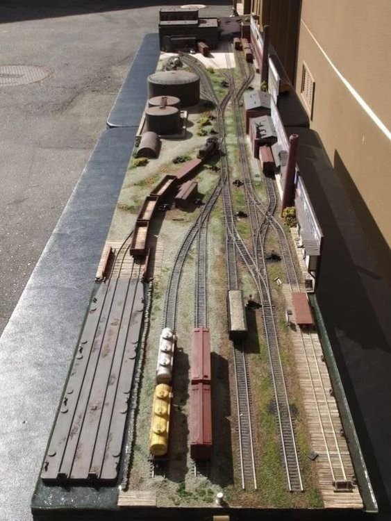

Stoby Posted March 27, 2024 Posted March 27, 2024 Hello to Everybody And Thank you for Having Me On The Site I am a Total Newbie to Model Rail , so i am reaching out for some advice please , First of all i am limited to space , what i have available to work with is 74 Inches Long and 28 inches Wide. And What i would like to fit to the board , is some sort of switching yard ,something that will not be boring and will be enjoyable to use , My First question is What sort of Board i should use ? My Second Question is Track , which to use ? i will try attach some photos i found on the Net to show what i would like to have , if anybody has any ideas or plans i would be grateful, as i am totally new at this , sorry i forgot to mention , i want to base it Around C I E in the 70,s to 80,s Thank you Stoby 3 Quote

Stoby Posted March 29, 2024 Author Posted March 29, 2024 Thank you George and all for the information , i have made my mind up on the layout Theme Freight Yard now my big question to all who are into the track set up Attached is what i would like to have on the Board, Either of the Two plans Again the board is 74 long by 28 wide Could anybody tell me if any of the attached plans will fit on the available space Thanks Quote

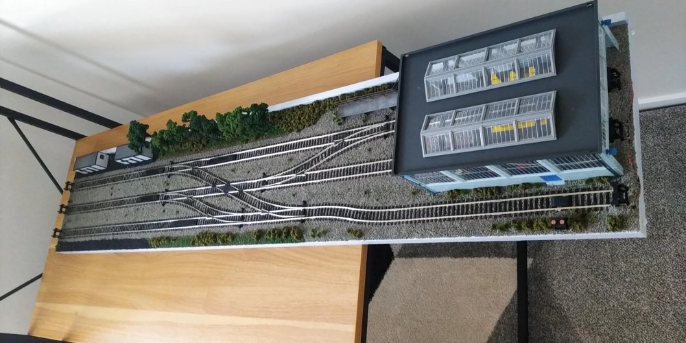

Stoby Posted April 17, 2024 Author Posted April 17, 2024 A change in plan , Due to the space Available , i will go with 7 X 2 Module, in the Hope that more space will become available at a later stage Thanks to Everyone who Helped me so far , i have managed to come to Grips with ANYRAIL. I Came up with a design that works for me , and having had most of the track parts available , i am Happy to say. Trains are now up and running . Attached is the plan A Big thank you to all that helped 6 Quote
meathdane Posted April 17, 2024 Posted April 17, 2024 3 hours ago, Stoby said: A change in plan , Due to the space Available , i will go with 7 X 2 Module, in the Hope that more space will become available at a later stage Thanks to Everyone who Helped me so far , i have managed to come to Grips with ANYRAIL. I Came up with a design that works for me , and having had most of the track parts available , i am Happy to say. Trains are now up and running . Attached is the plan A Big thank you to all that helped Looks like a great plan! Loads of operational fun there! Only thing I might say is accessing the timber siding might be a faff, especially if you're looking to run around an outbound load. Assuming you're going to have the IRM Flats carrying the timber. I could be wrong there mind you if the straight between the two points can hold two flats! That's only minor though, main thing is, you're happy and it looks great! 1 Quote
