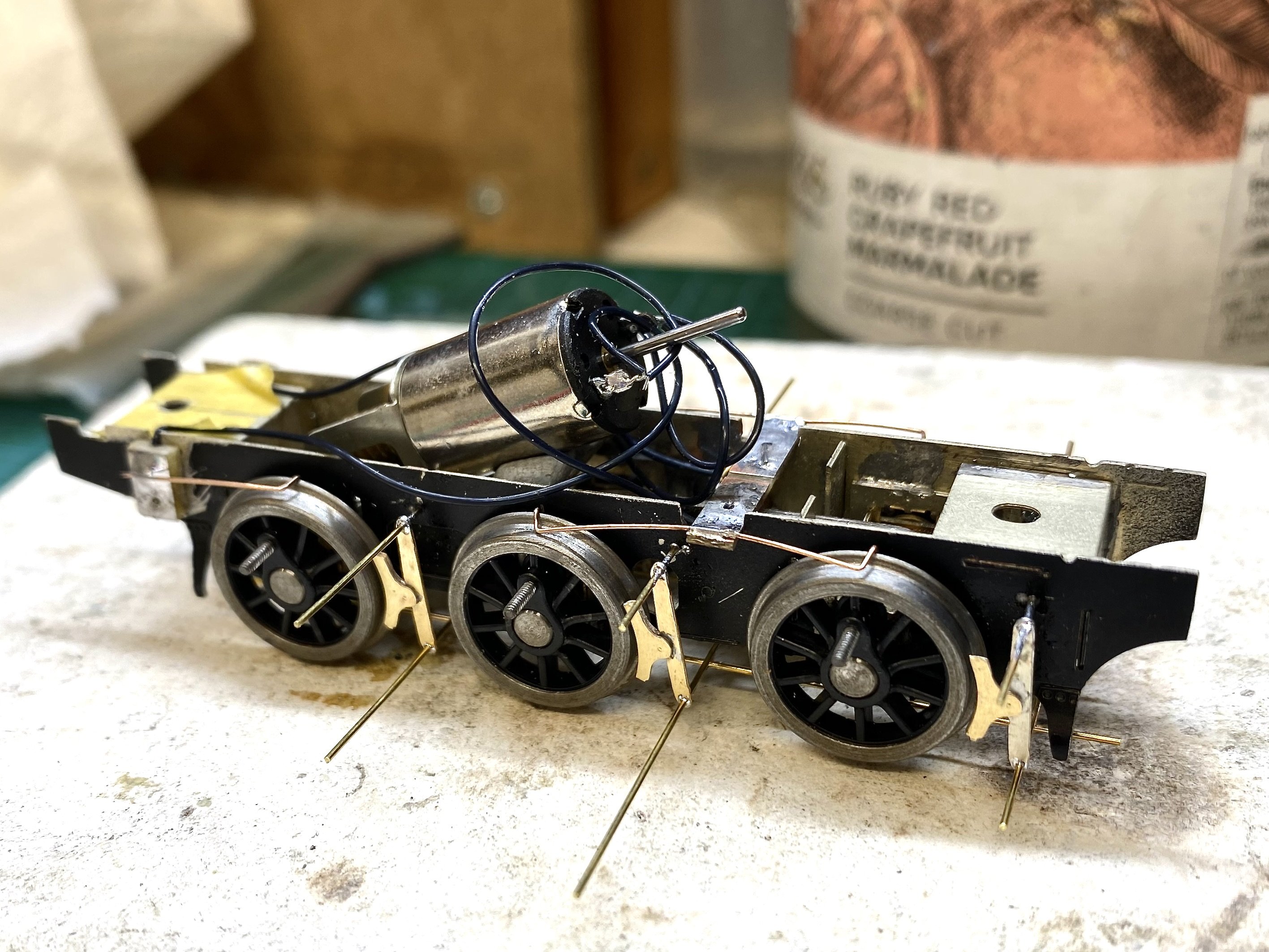

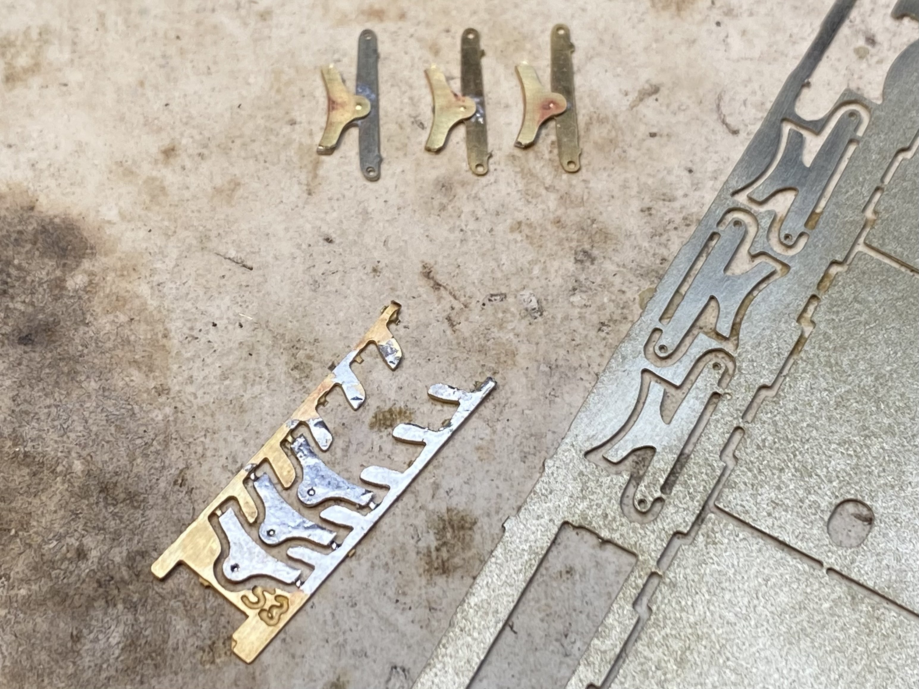

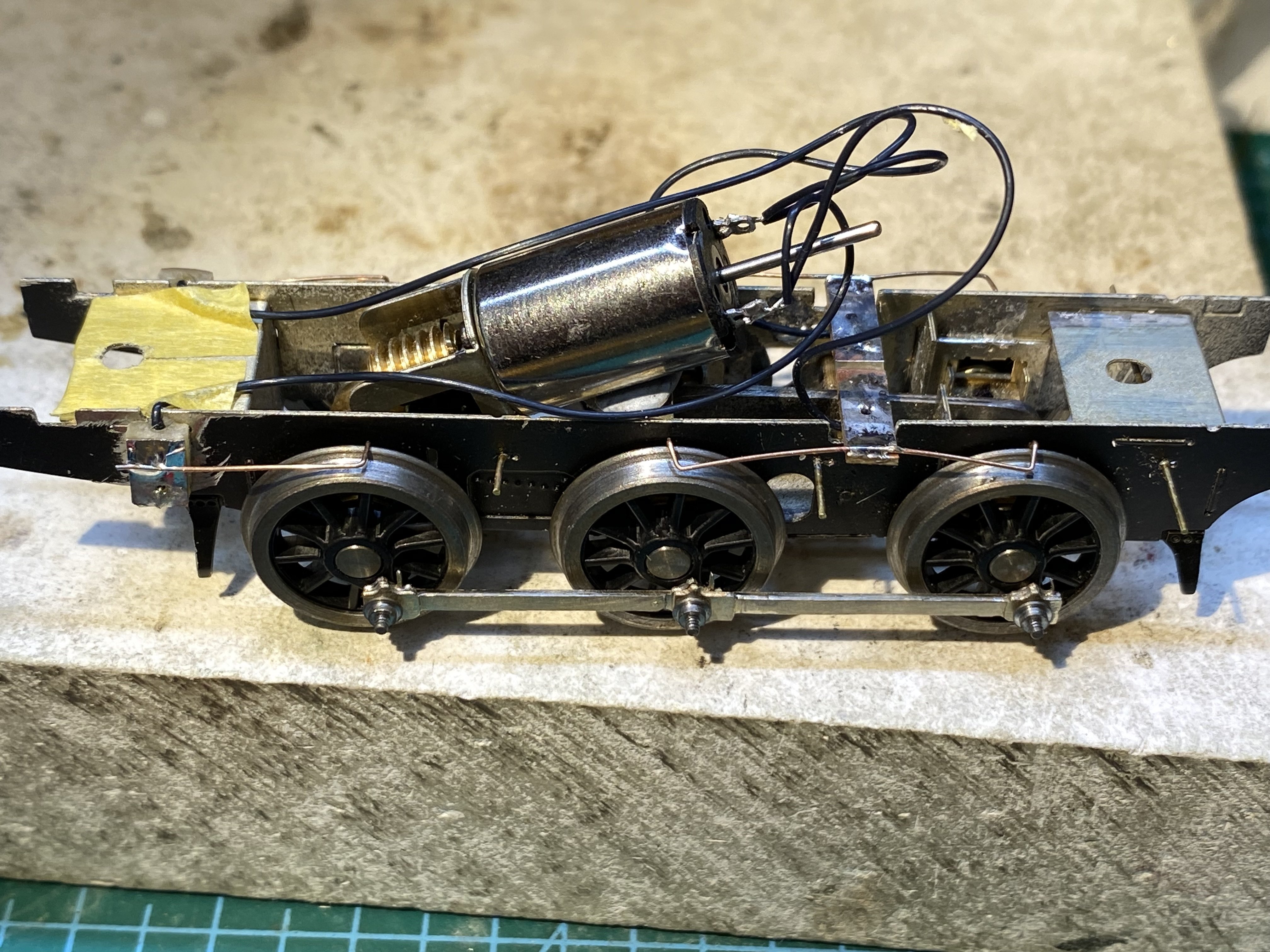

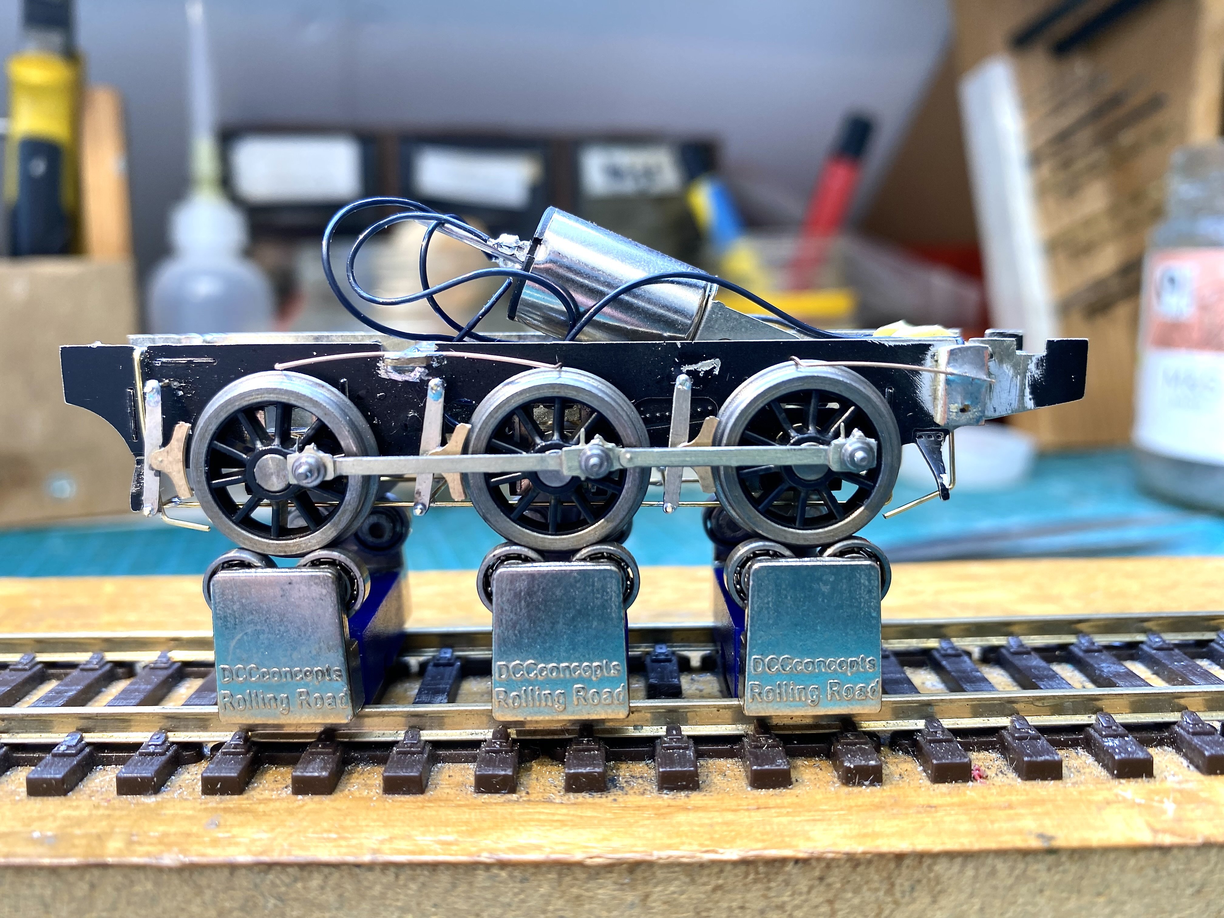

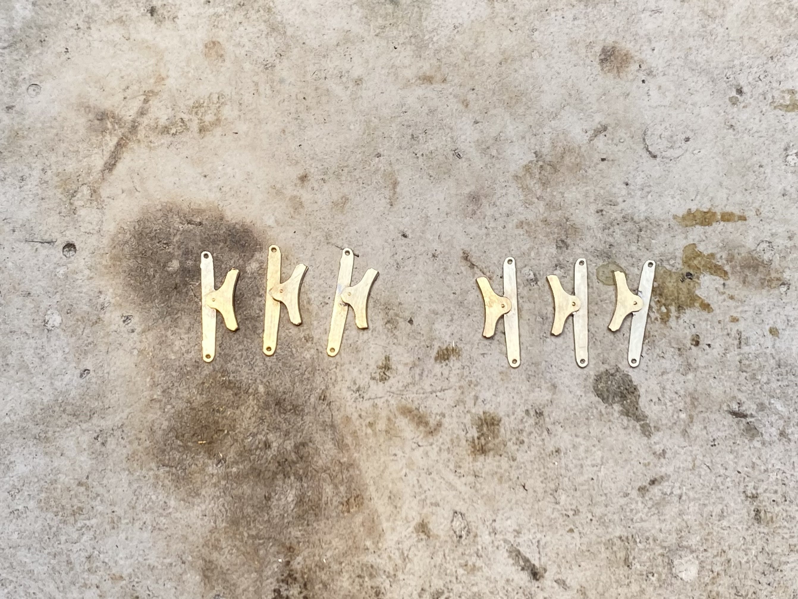

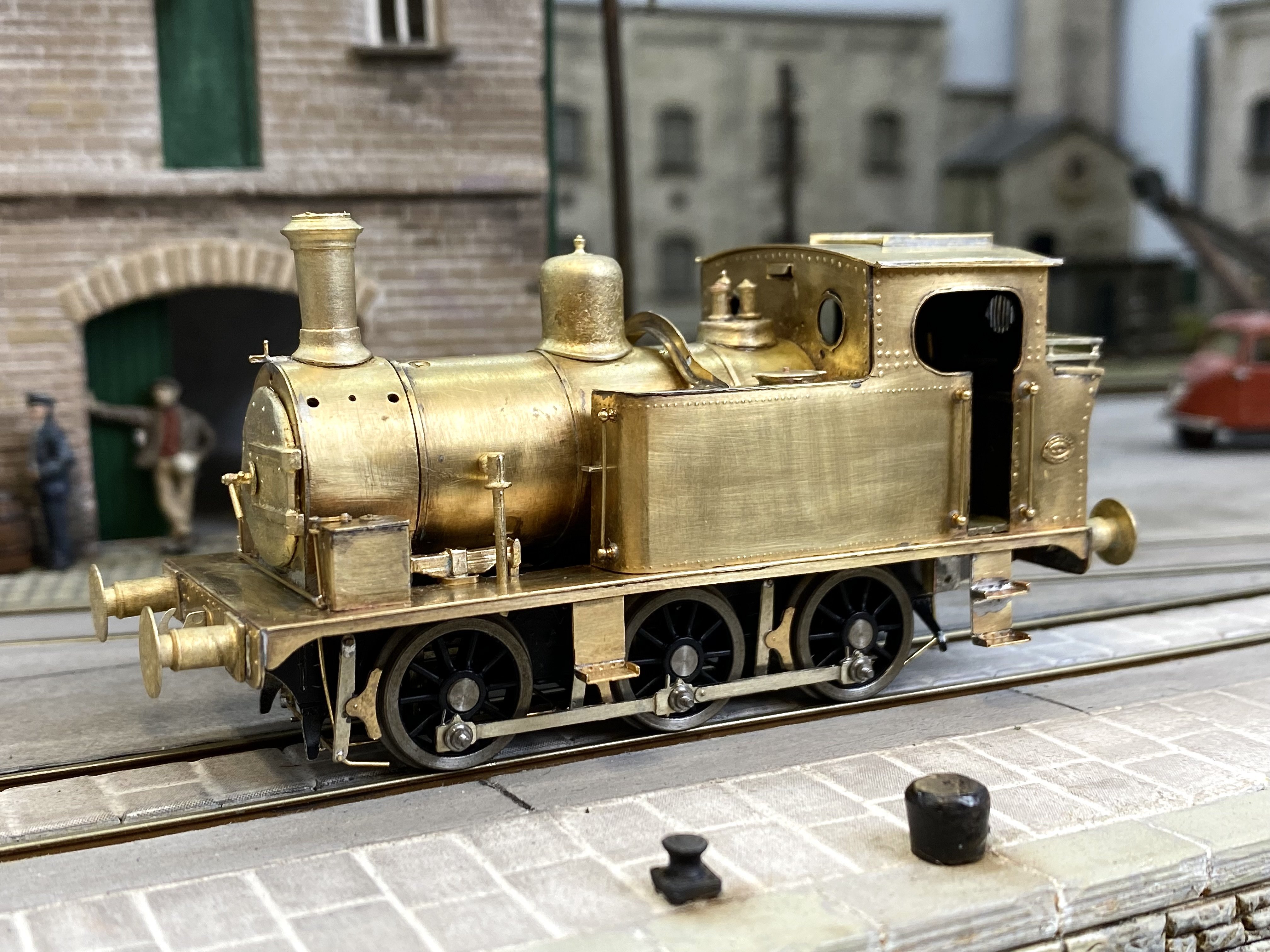

Tullygrainey Posted September 10 Author Posted September 10 Hunslett now has pickups. 31swg phosphor bronze wire shaped to hook over the wheel flanges at the top. Since @Northroader (I think) suggested this method somewhere a while ago, I've been using it and it works well. The hook keeps the pickup wire in place and there are two possible contact areas - wheel flange and wheel back - to keep things moving along. Each brake hanger has 2 bits soldered together. The RSU did this job very neatly Brake rigging is 0.45mm brass rod The whole nine yards - pickups, brakes and sand pipes. Phew! Trial run under DC at Loughan Quay. Bodywork isn't secured yet. IMG_5771.MOV Hardly any burnt fingers today Alan 9
Mol_PMB Posted September 10 Posted September 10 Very smooth! And it looks at home on the quayside. 1 1
Tullygrainey Posted September 10 Author Posted September 10 Just now, Mol_PMB said: Very smooth! And it looks at home on the quayside. Thanks. Does doesn't it!

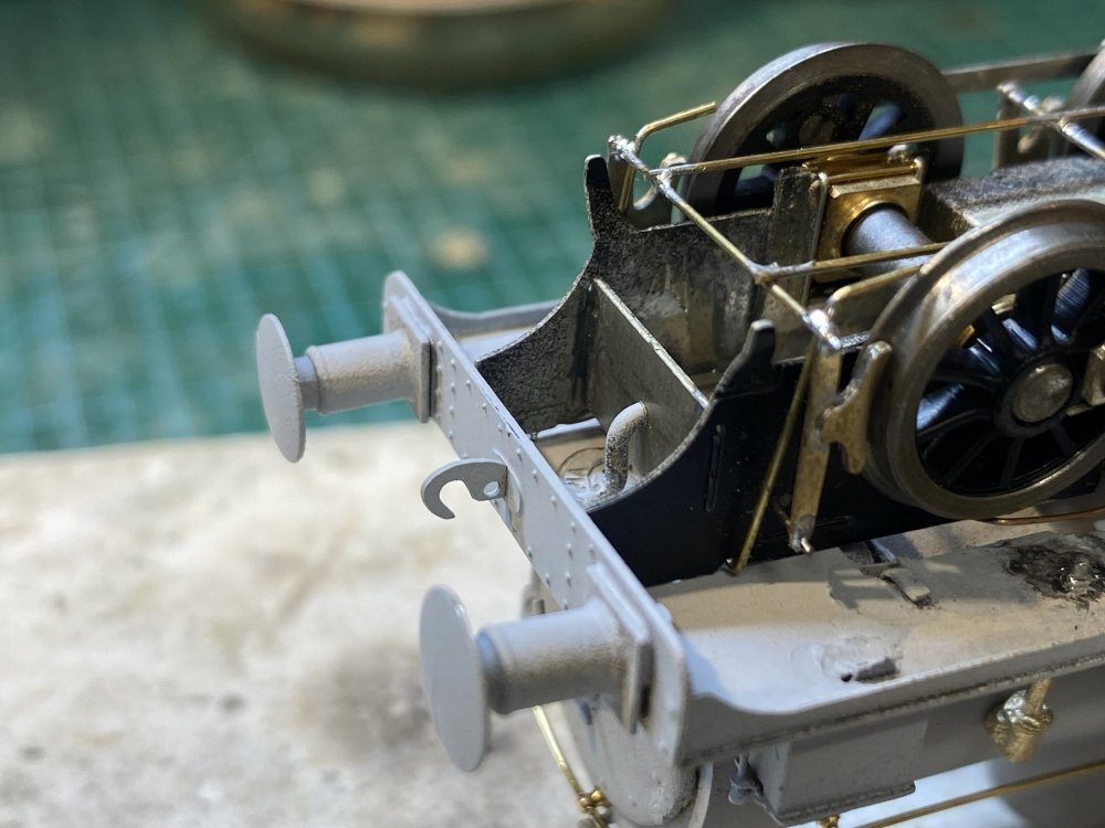

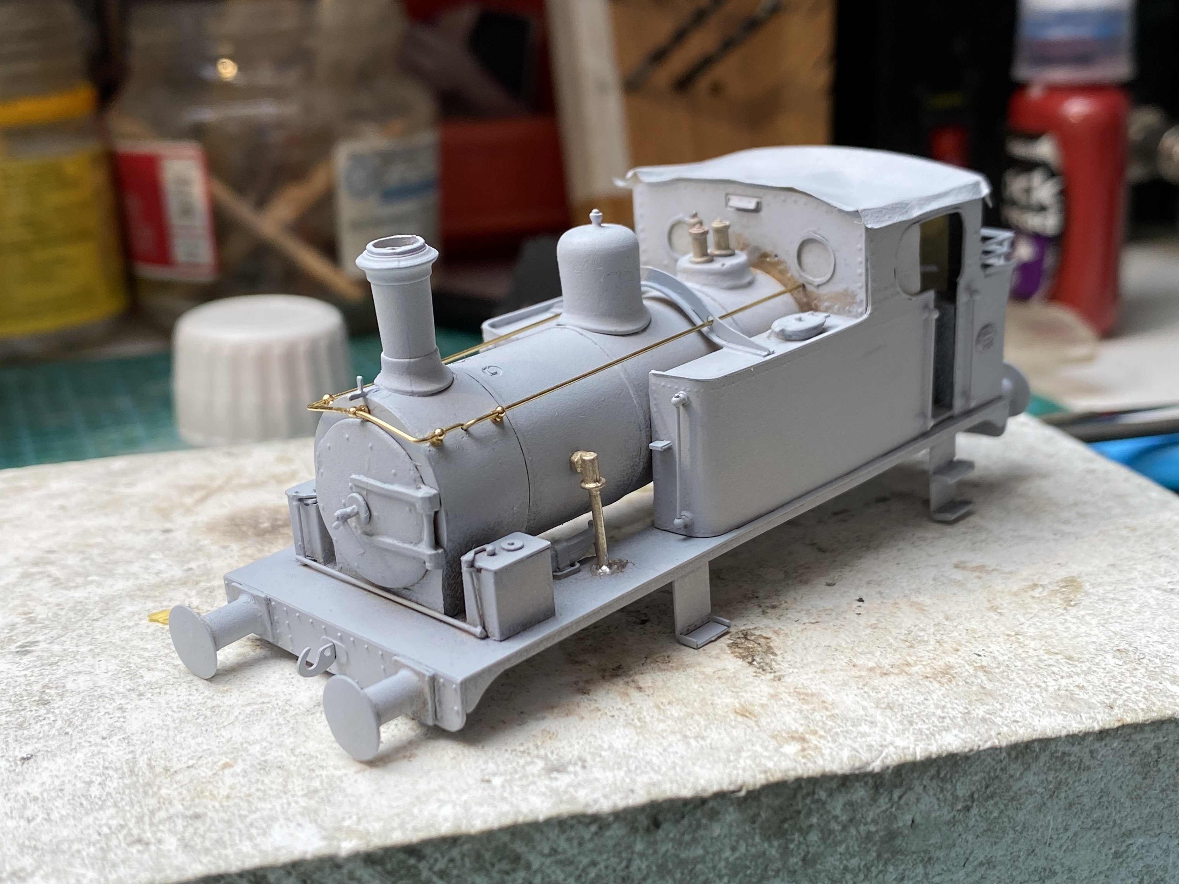

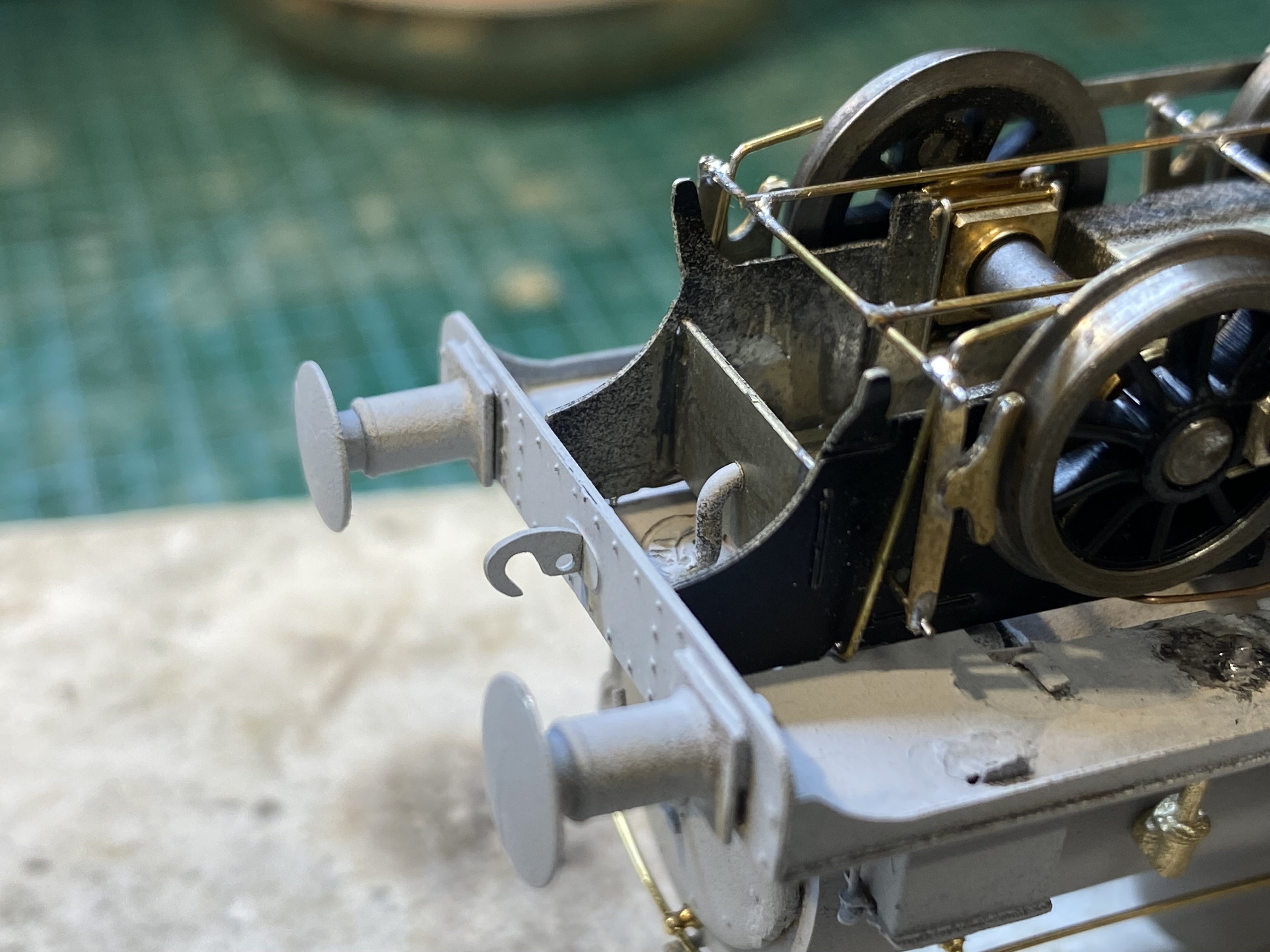

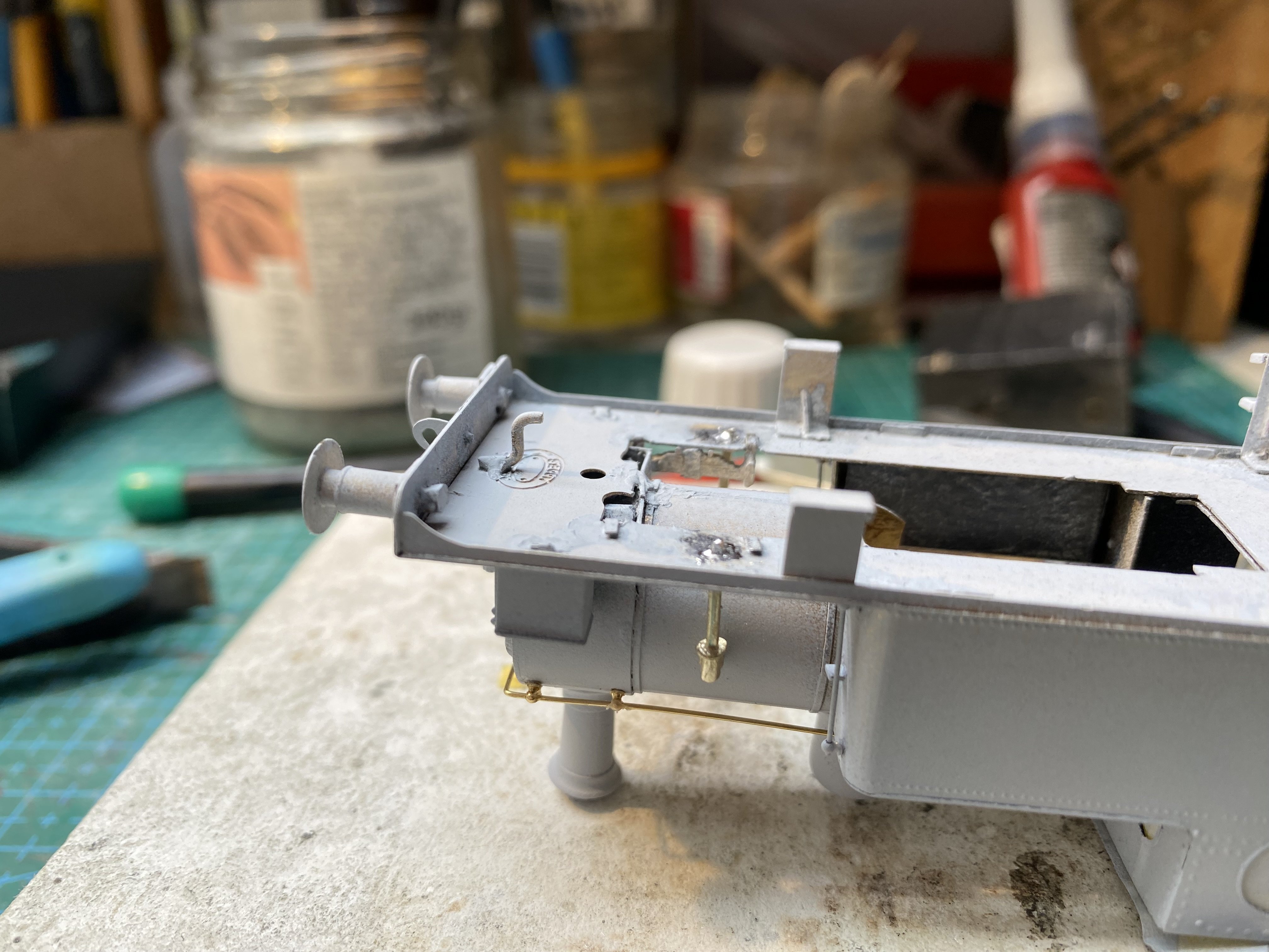

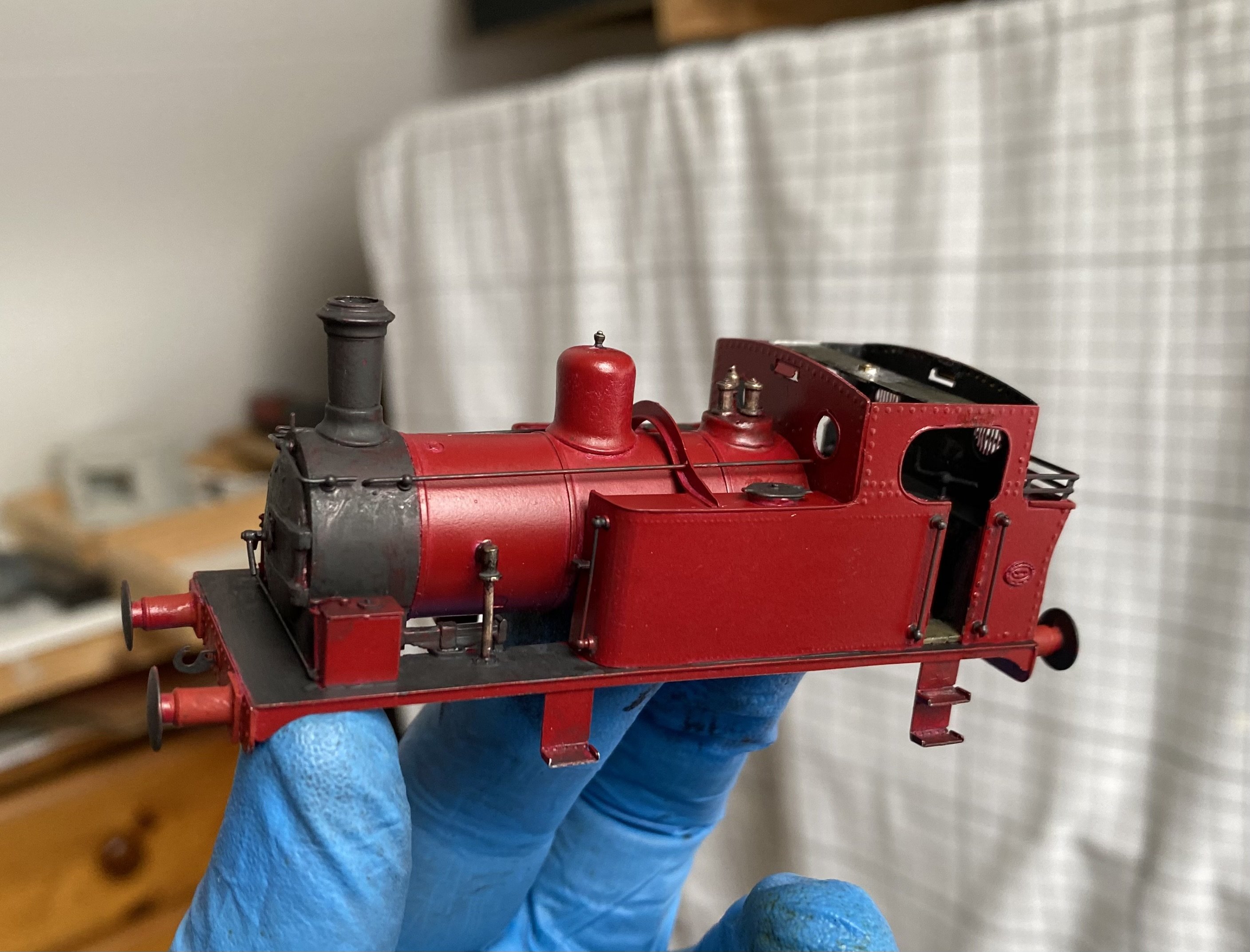

Tullygrainey Posted September 14 Author Posted September 14 (edited) Cleans up nicely does Hunslett But nothing like a coat of primer to show up where the filler needs to go. I must have squandered about half a mile of brass rod getting those handrails the way I wanted them. I'm never entirely happy mounting chassis with bolts front and back, given the chance that tightening both could twist the chassis. So this one has a bolt at the back and this little bit of bent 1mm brass rod at the front which locates into a slightly oversize hole in the front chassis spacer. Chips soon Alan Edited September 14 by Tullygrainey 5 1 1
Galteemore Posted September 14 Posted September 14 Very elegant solution Alan. Agreed - the fore and aft bolts can cause all manner of issues 1

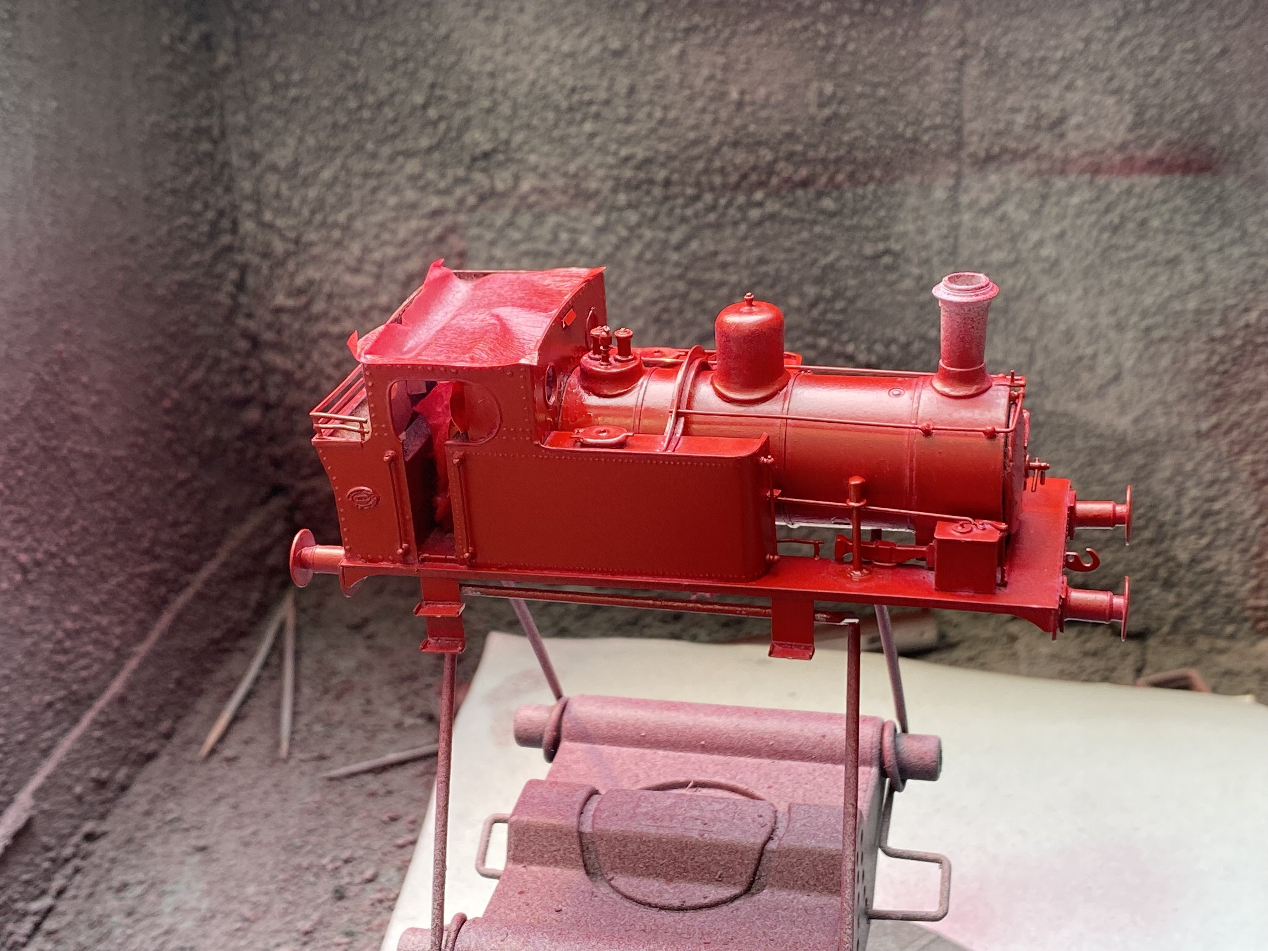

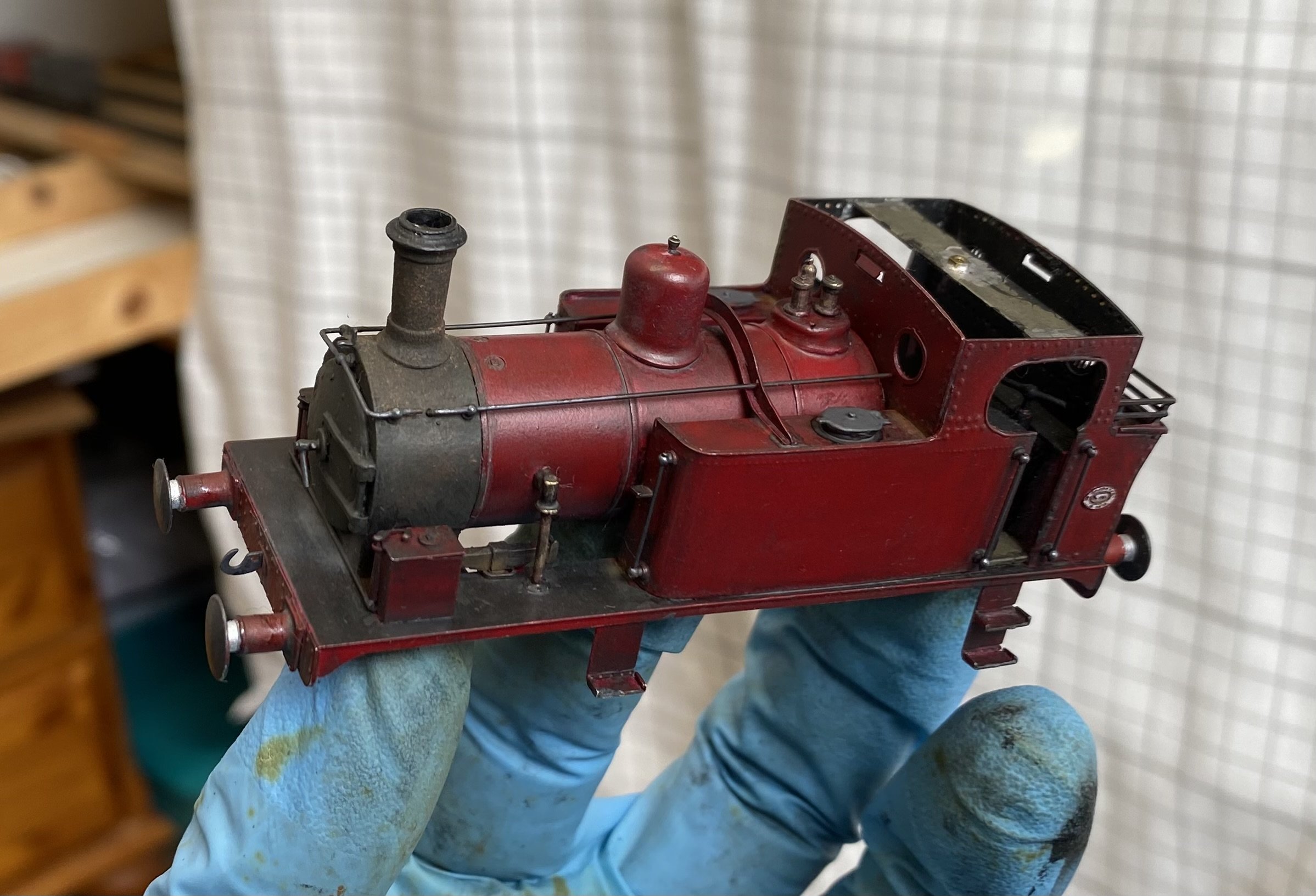

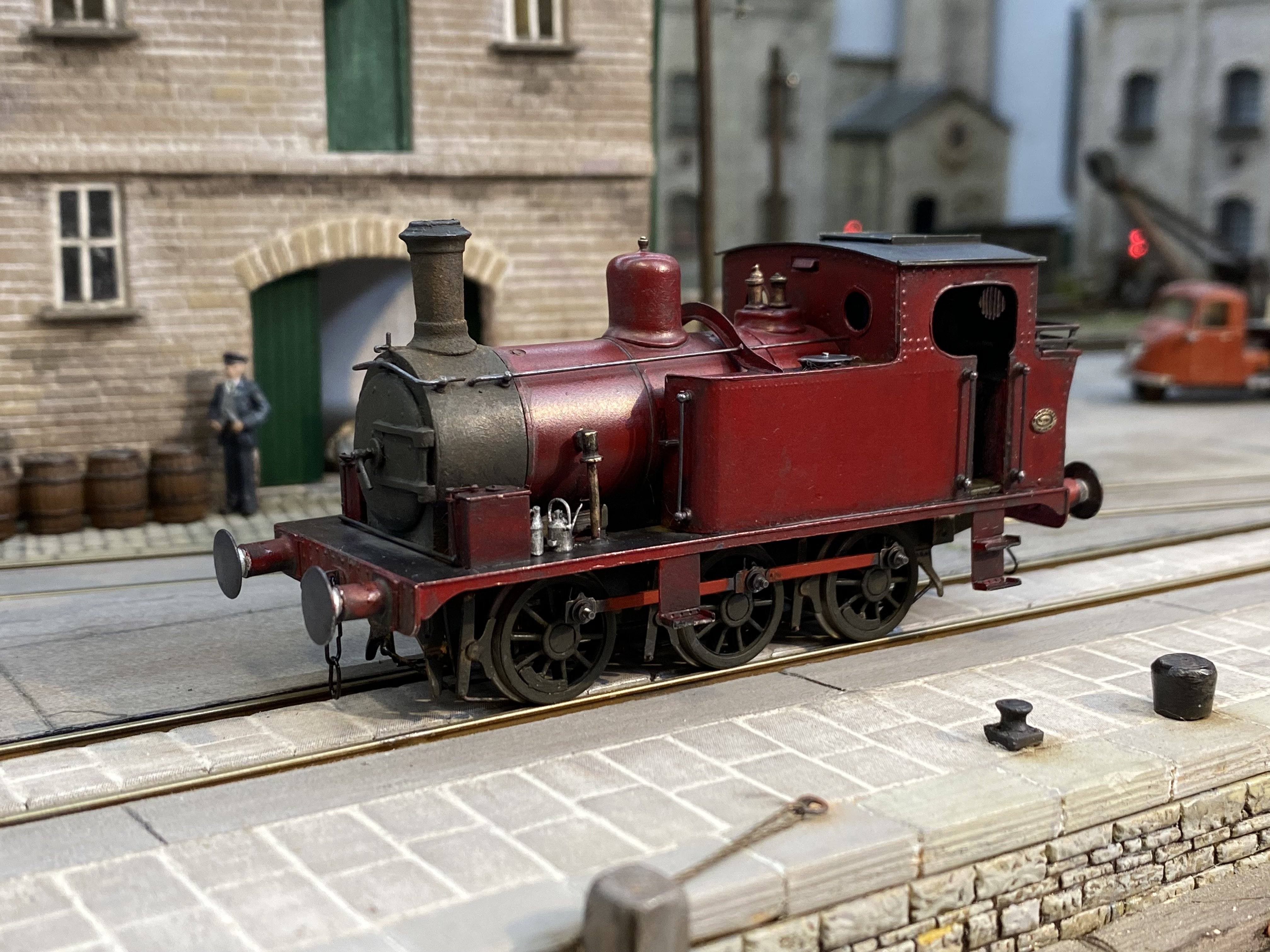

Tullygrainey Posted October 3 Author Posted October 3 Paint for the Hunslett. First an overall coat of airbrushed Humbrol Crimson acrylic.. Then some Humbrol metalcote for the running plate and a matt black/leather/metalcote mix for the smokebox. Enamel this time. Paint stripped off some details such as the safety valves and whistle. ... and finally a thinner mix of the same stuff applied all over and wiped off. Glove nicely weathered. Some details touched up after the weathering wash. Oil cans are from ModelU Hunslett is just about finished now, bar a bunker load of coal. IMG_5899.MOV That's enough of grubby shunters for now. I hear the BCDR calling again. Alan 9 9
popeye Posted October 3 Posted October 3 The weathering really brings it to life. The oil cans are next? I think if they were dirty you would not notice them.
Tullygrainey Posted October 3 Author Posted October 3 6 minutes ago, popeye said: The weathering really brings it to life. The oil cans are next? I think if they were dirty you would not notice them. I did give them a dose of weathering wash but you'd hardy notice. Most of it ran off again! 2
Mol_PMB Posted October 4 Posted October 4 42 minutes ago, Tullygrainey said: I did give them a dose of weathering wash but you'd hardy notice. Most of it ran off again! Most drivers would keep the oil cans clean. It helped keep their own hands clean when oiling, but it’s also very bad form to hand a loco over to a relieving driver with dirty oil cans. 2
Colonel Posted October 5 Posted October 5 A real little gem - build, paint job, weathering, the lot! 1
