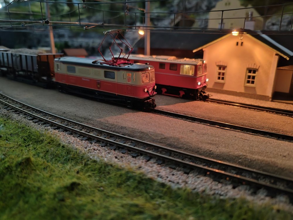

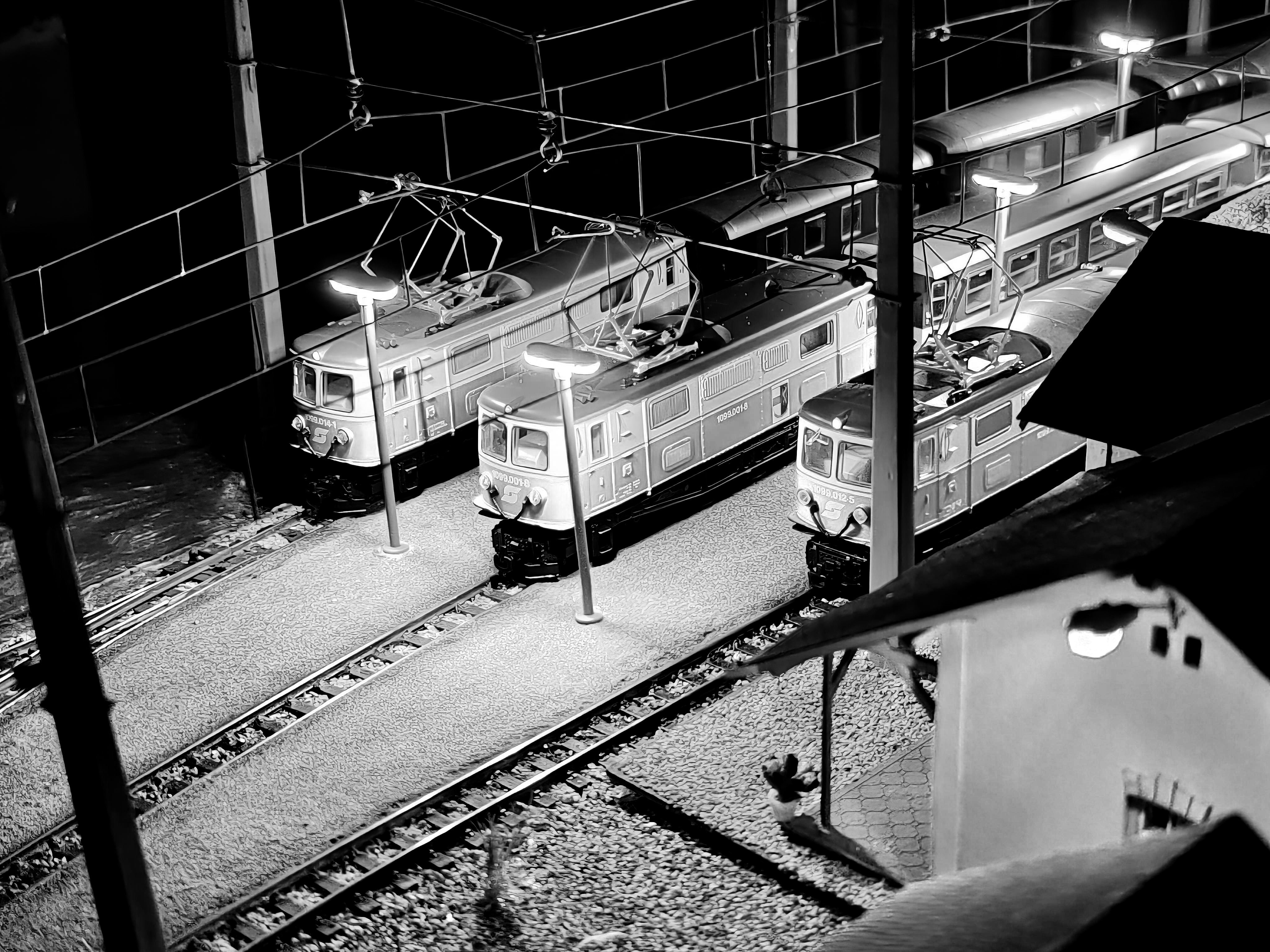

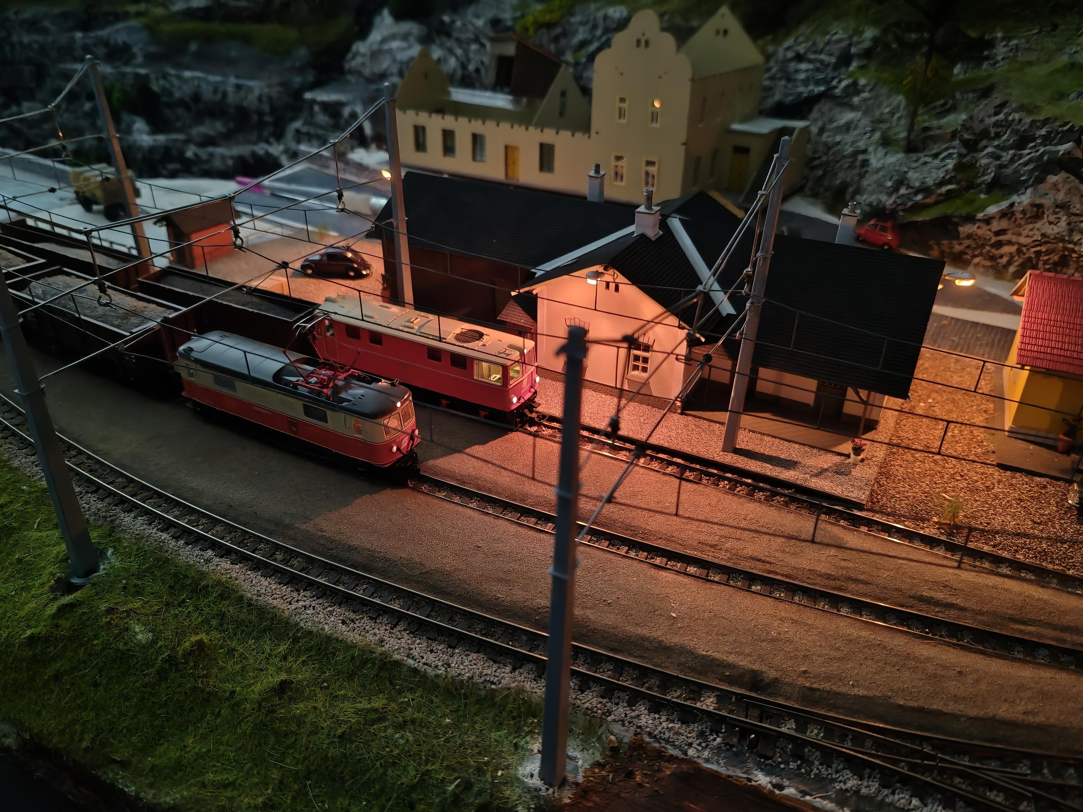

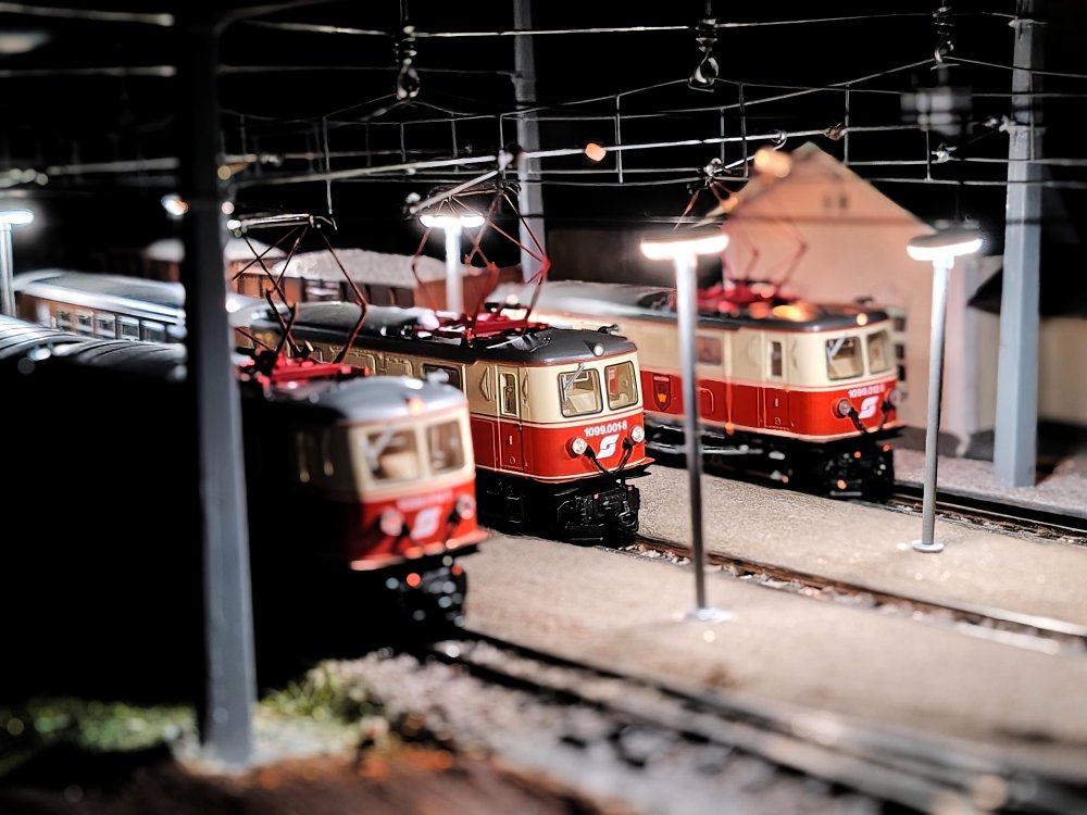

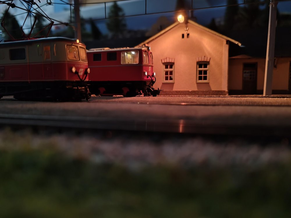

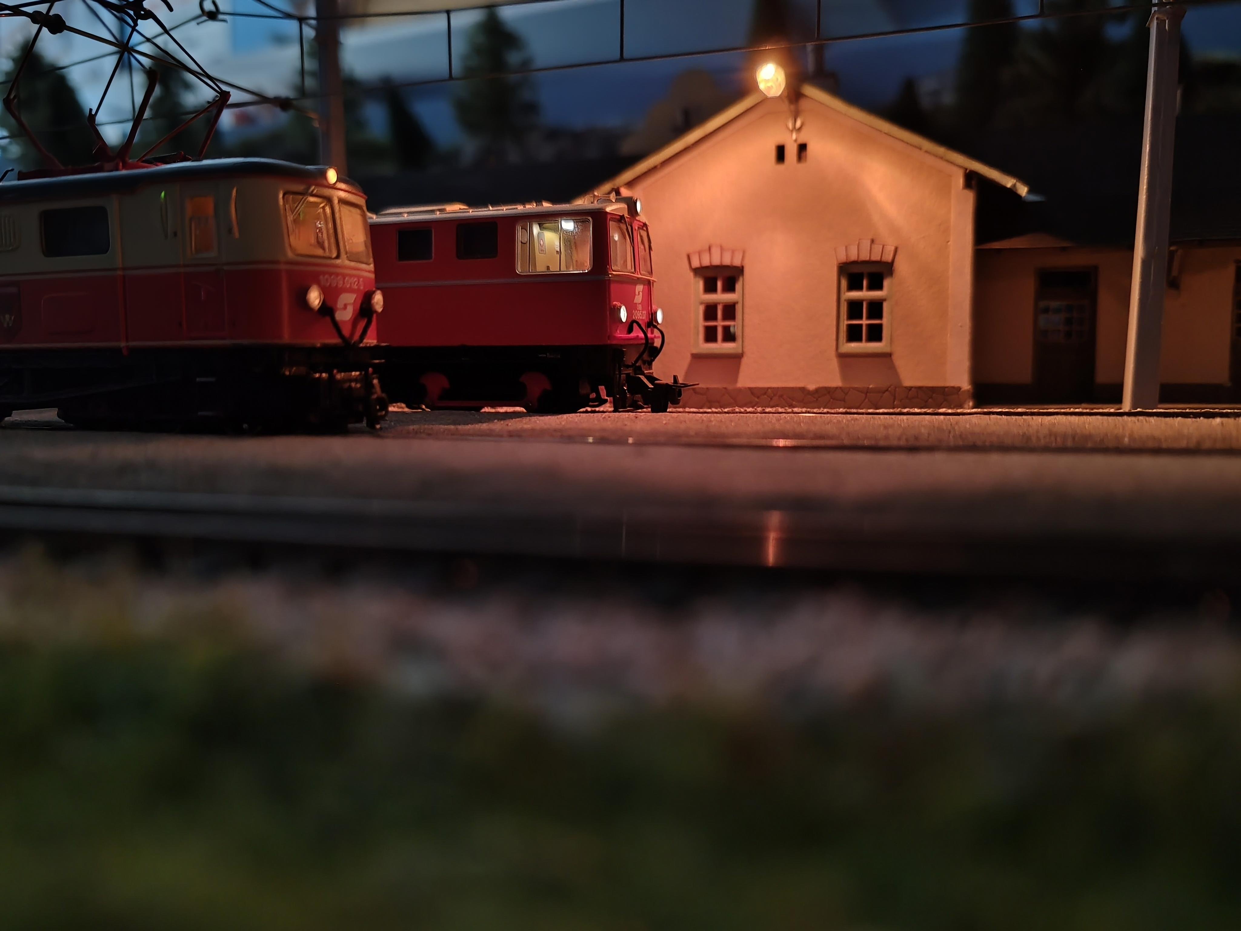

Georgeconna Posted November 25, 2025 Author Posted November 25, 2025 Added some Walthers HO lights to the station and engine shed. Got these ages ago and they fit right in. 6 3
Flying Snail Posted November 25, 2025 Posted November 25, 2025 I know I'm repeating myself from Darius' thread, but the lights really do add something special to the scene. A very nice layout indeed - you must be nearly there now? 1
Georgeconna Posted November 25, 2025 Author Posted November 25, 2025 3 hours ago, Flying Snail said: I know I'm repeating myself from Darius' thread, but the lights really do add something special to the scene. A very nice layout indeed - you must be nearly there now? Thanks but stíl loads to do... Another bundle coming from Gerrmay today. Spending far too much on this!! Little vid. HnVideoEditor_2025_11_25_000915515.mp4 7

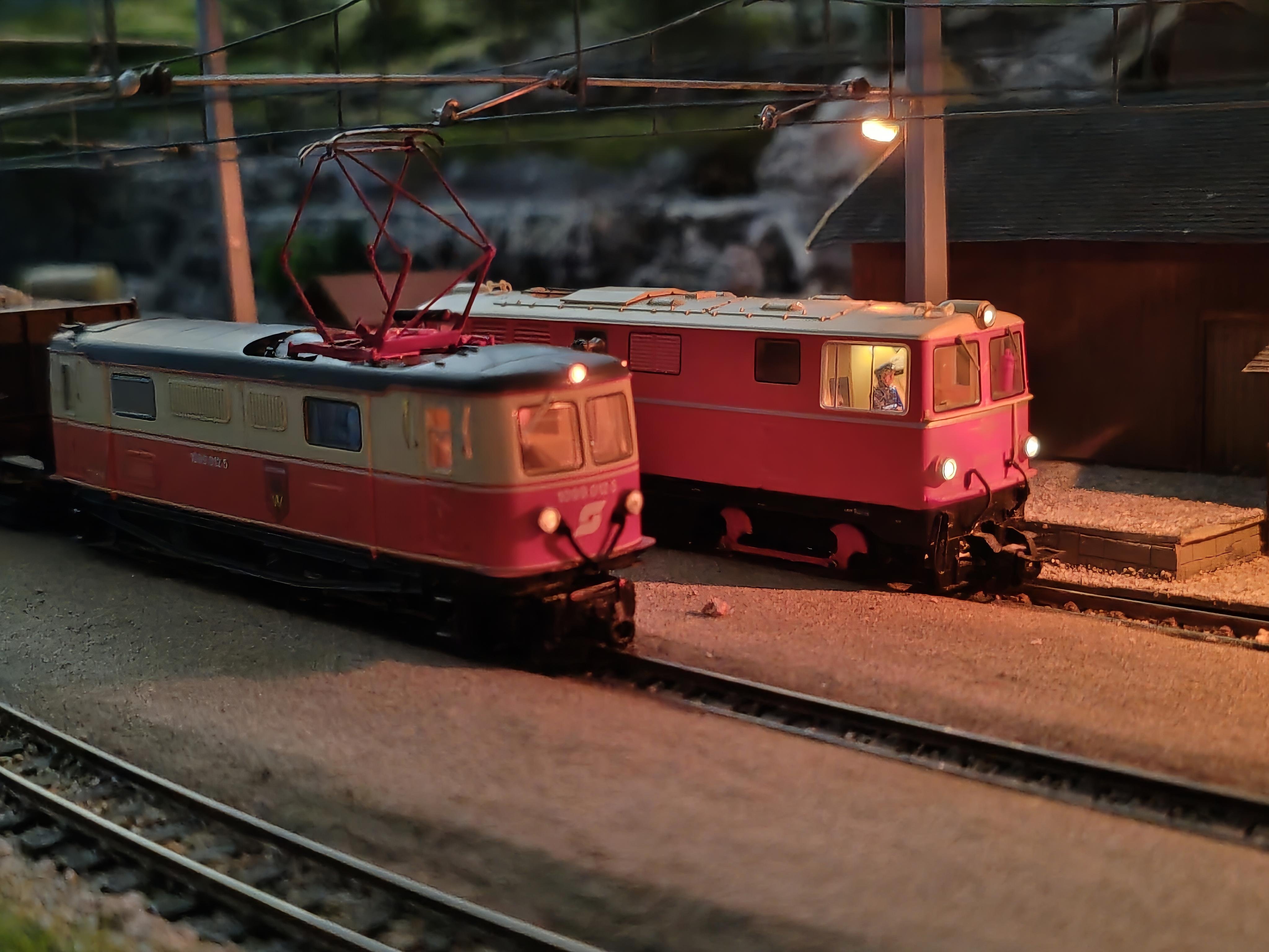

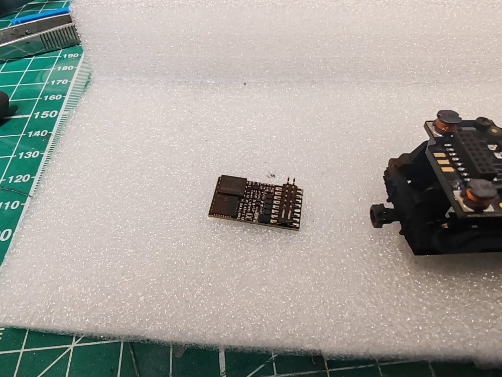

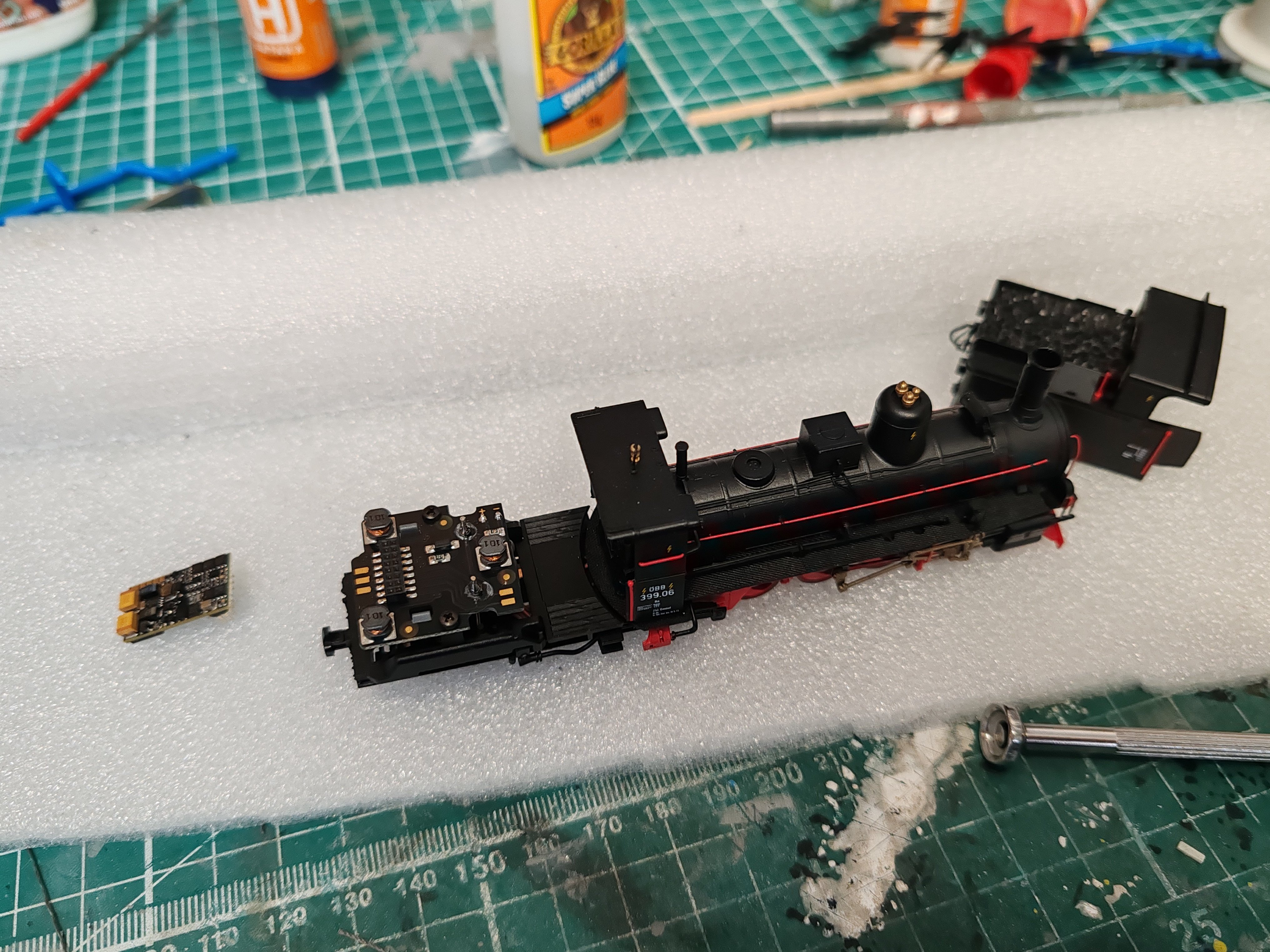

Georgeconna Posted November 26, 2025 Author Posted November 26, 2025 (edited) Hi Folks, Bit of an up a down this week, The Steam loco is kaput for some reason or another. No blanking plate to test of dcc so had to order a plux 22 decoder to test if it is the decoder or otherwise. bit of a shame that, Probably need to go back to Roco for a fix. This is the 2nd issue I have had with a Roco Loco where I had to replace a motor in a barely used 1099. On the plus side my order for a sound equipped 1099 arrived so had a little play with that. electric locos really sound weird when compared to diesels and steam! It is an upgrade of the earlier models I bought with LED lighting and cab lights. I preferred the Filament bulb glow really. Also some passengers installed in 2 coaches, you can barely see them! Got some viessman platform lighting kits as well and 2 cranes from Kibri. hate string being used for cables so will change that as they never hang straight down. Edited November 26, 2025 by Georgeconna 4

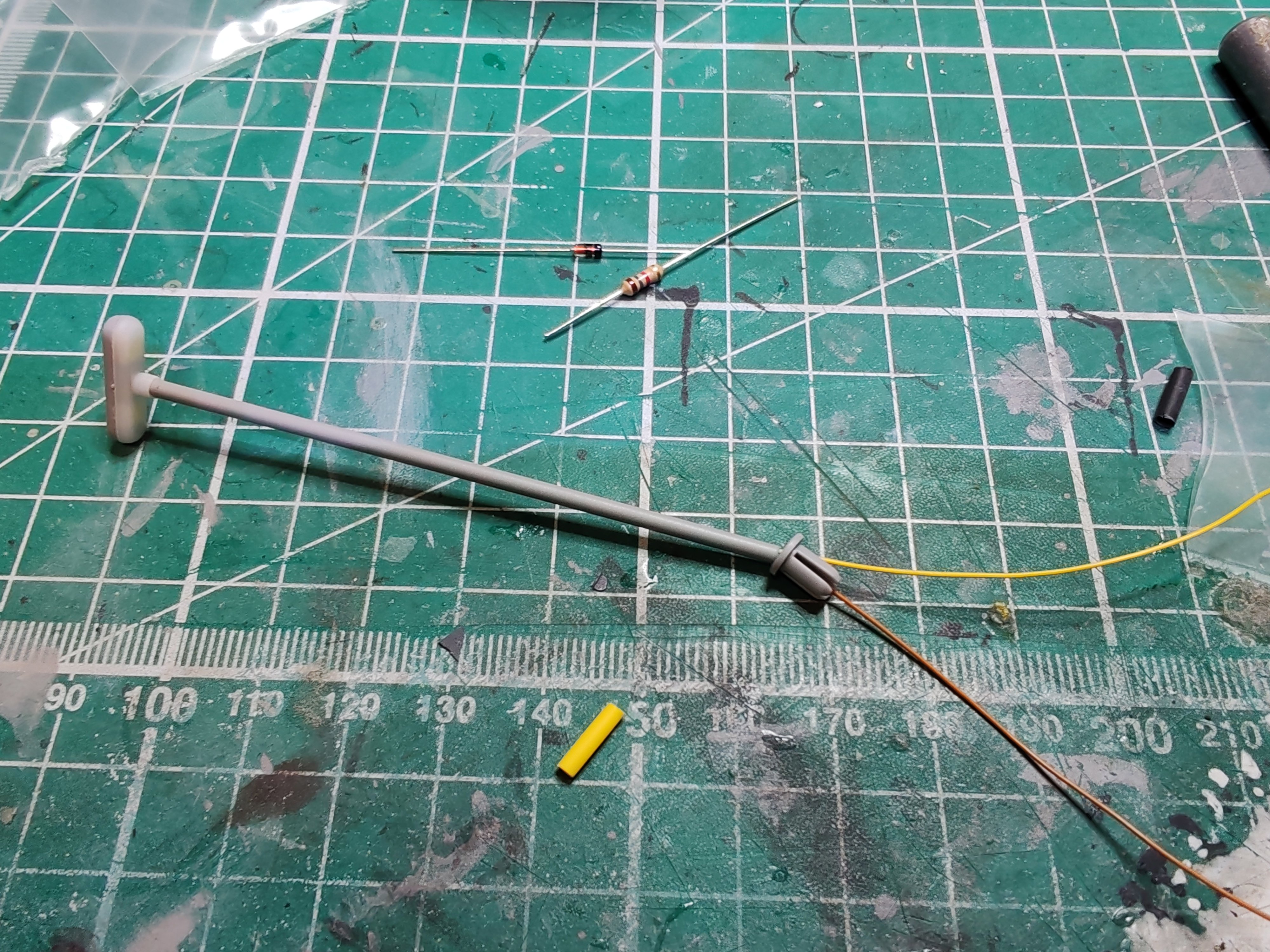

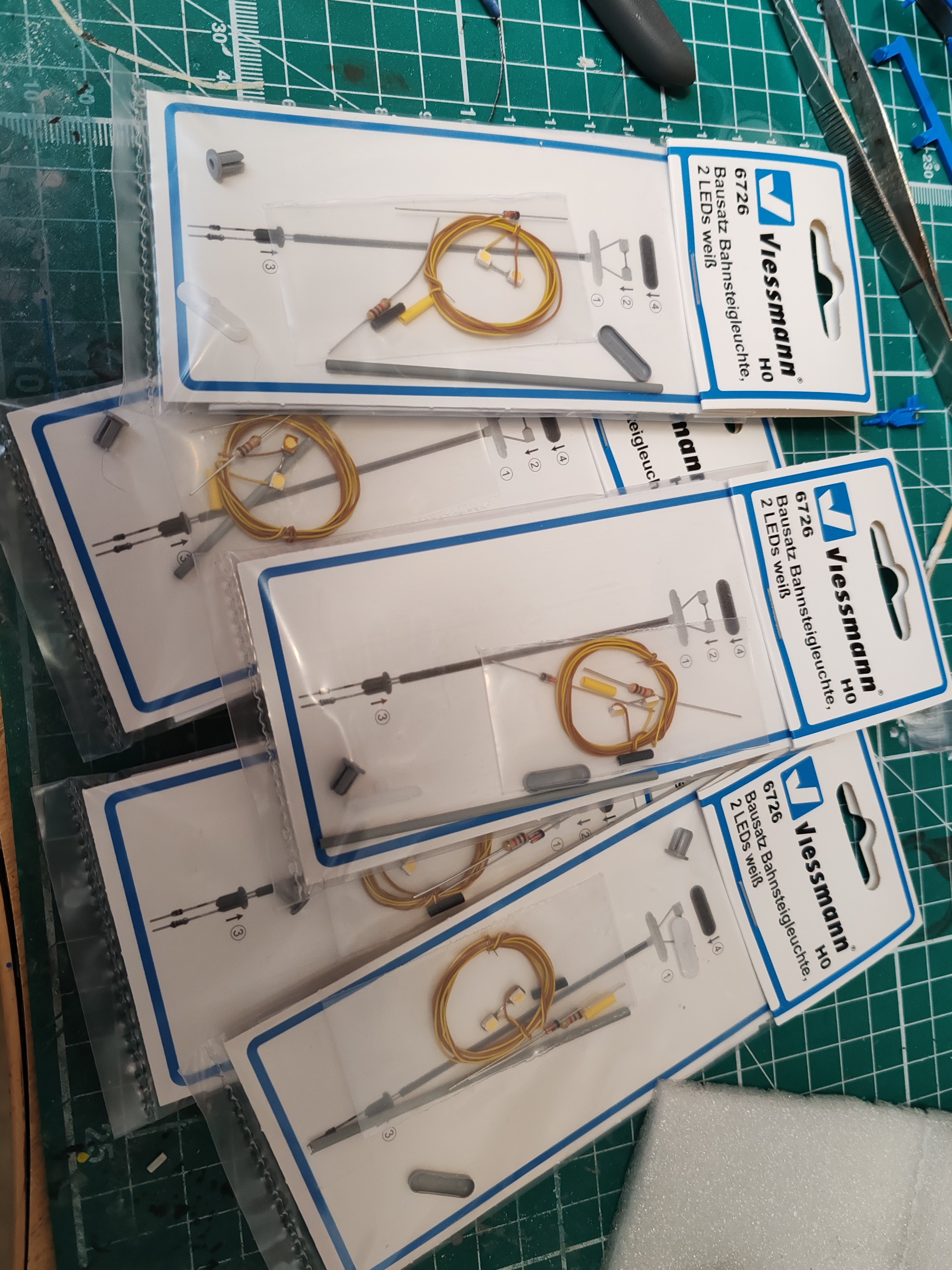

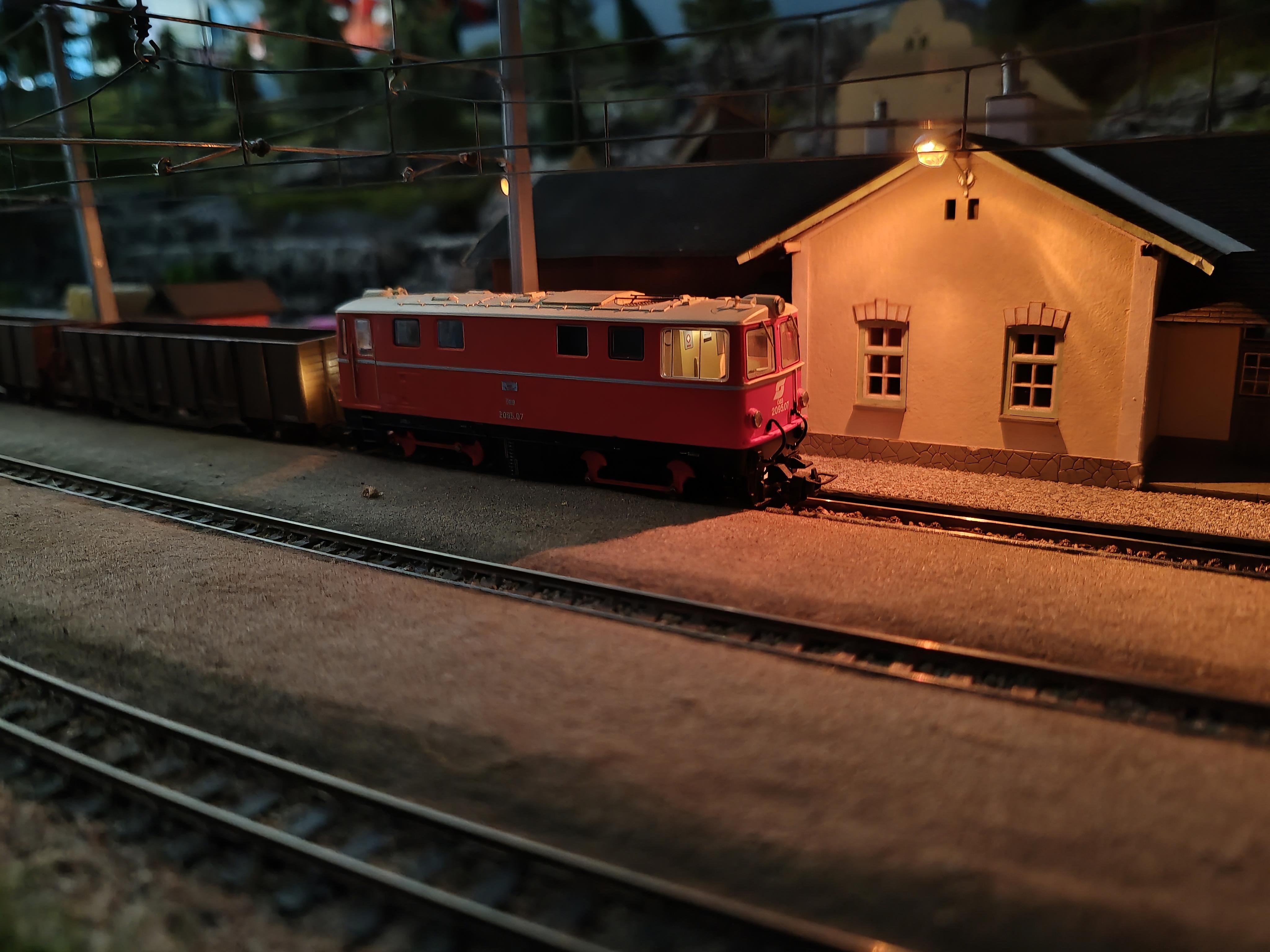

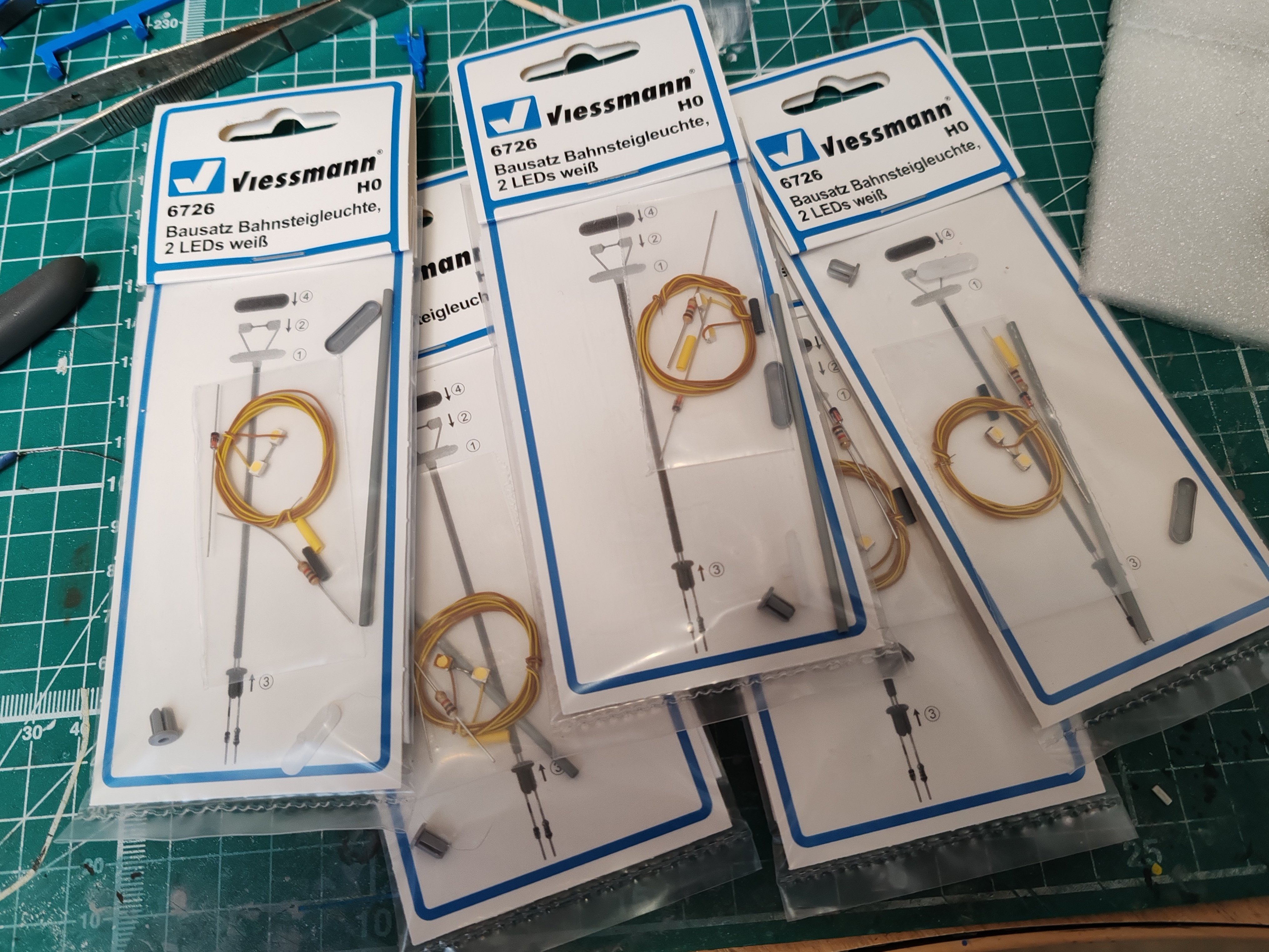

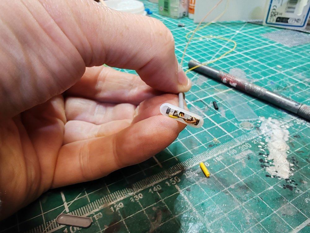

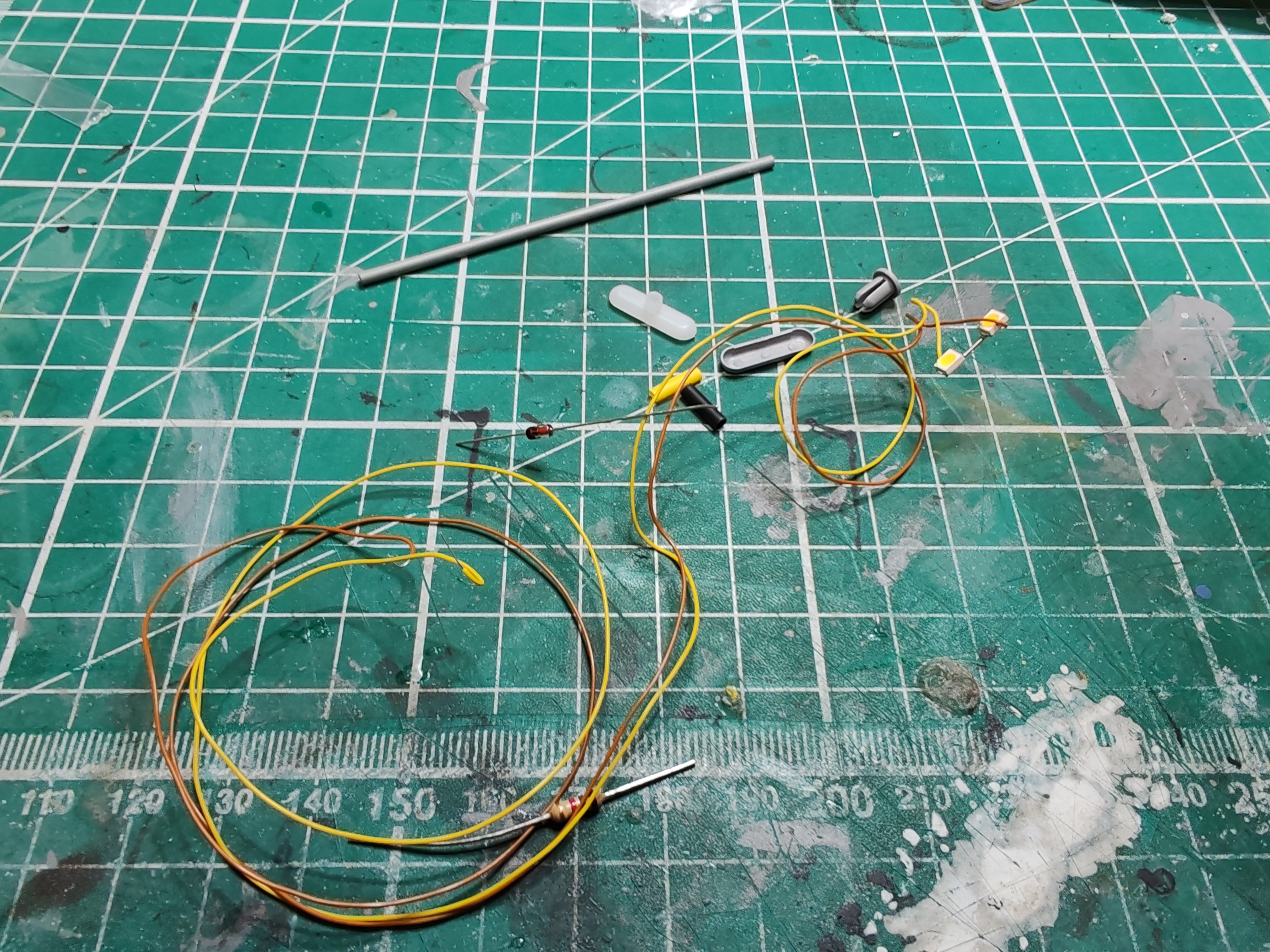

Georgeconna Posted November 27, 2025 Author Posted November 27, 2025 (edited) Sorry to bore the hole off you lads but another bit done this evening. I chose to obtain the Viessman lighting kit, product number 6726 for €5.63 each as opposed to around €14.00 each ready to plant options. A simple, enjoyable and dare I say an exciting outcome, They all worked! one wire had come off a LED but easily soldered back on. Ignore the platform edge sticking up, its not glued down yet. toying with a few lights in the station building. Edited November 27, 2025 by Georgeconna 5

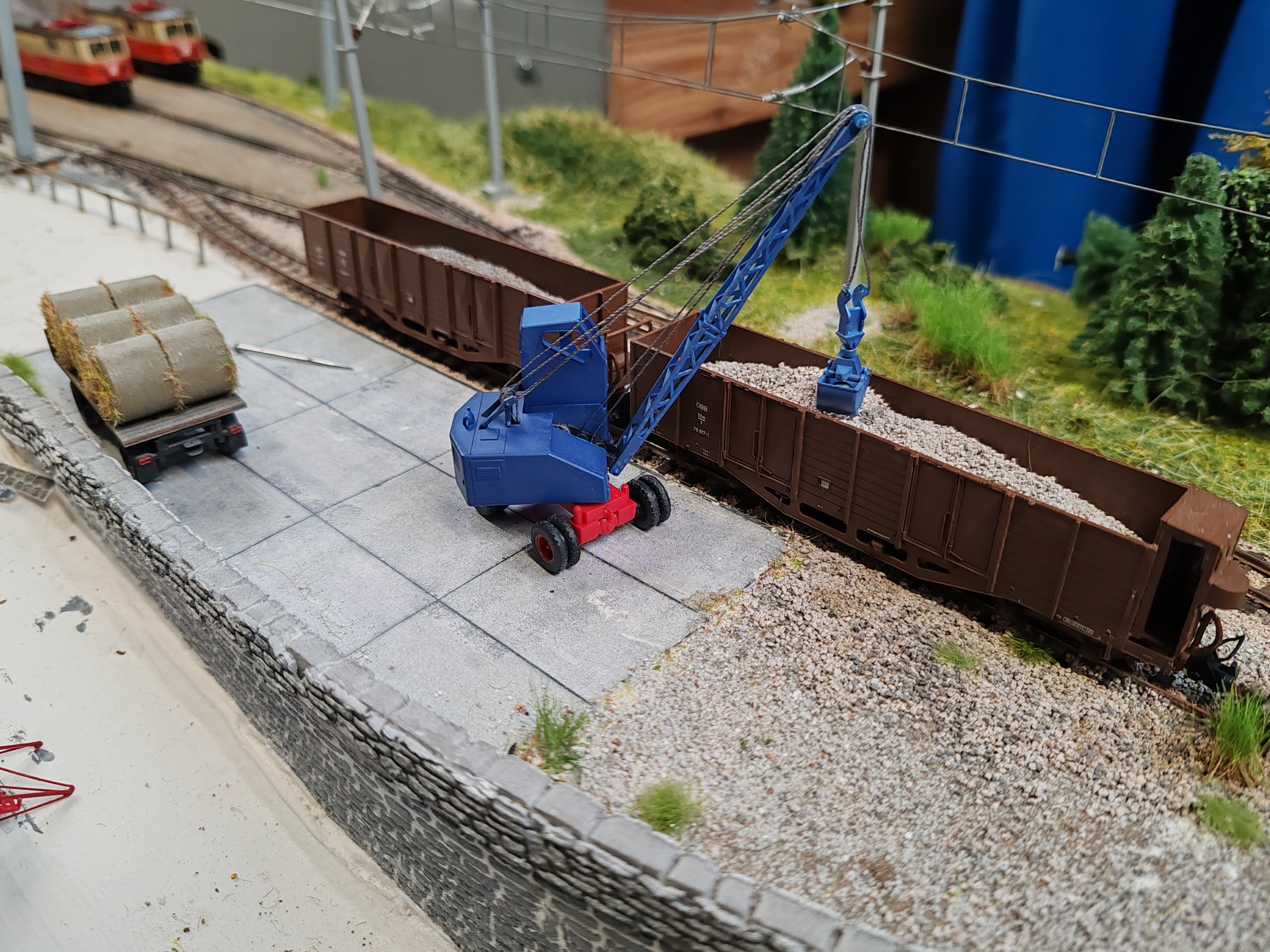

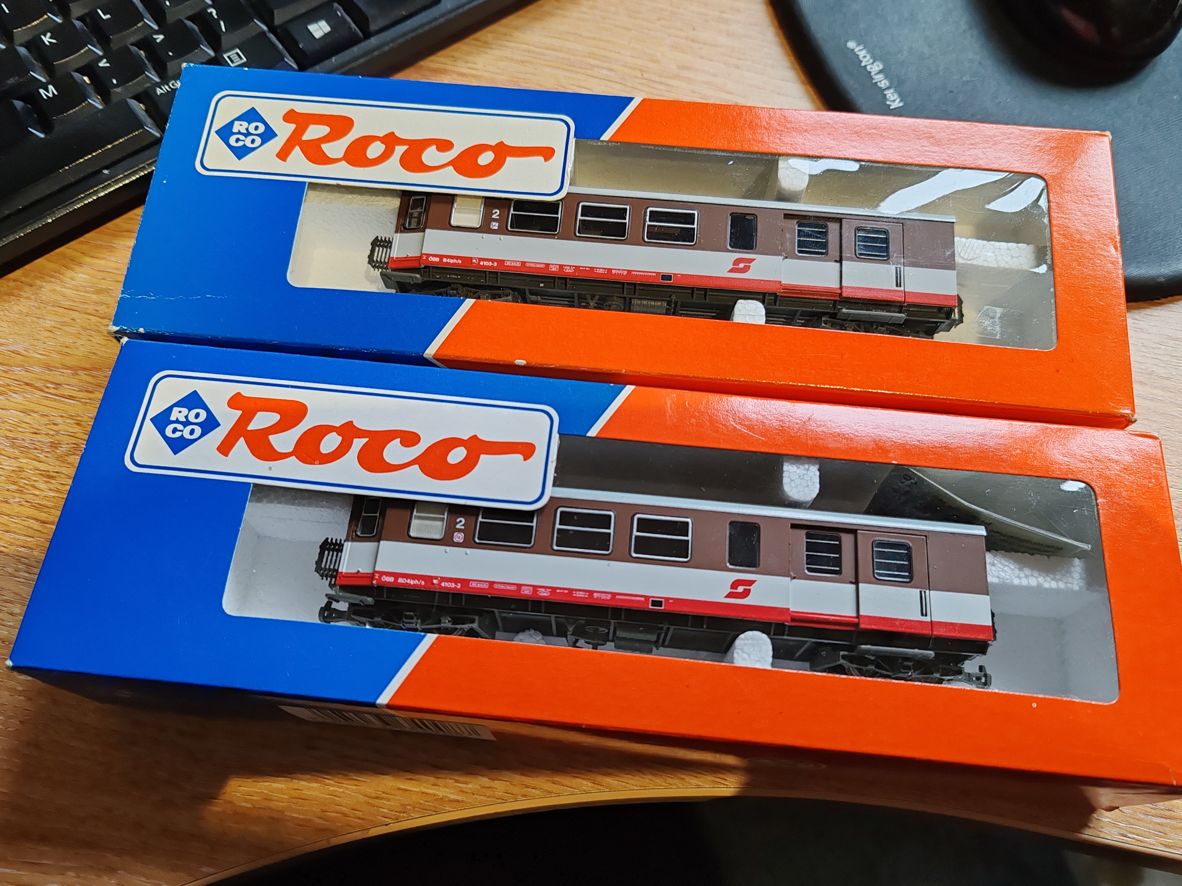

Georgeconna Posted December 1, 2025 Author Posted December 1, 2025 2 2nd hand luggage and passenger coaches arrived today. Hard to get so delighted with these. The wife not so much as I used her baking sieve to sieve some soil out for the layout and there was a few tiny stones stuck in it that got into the cake mix. Ooops 6 1

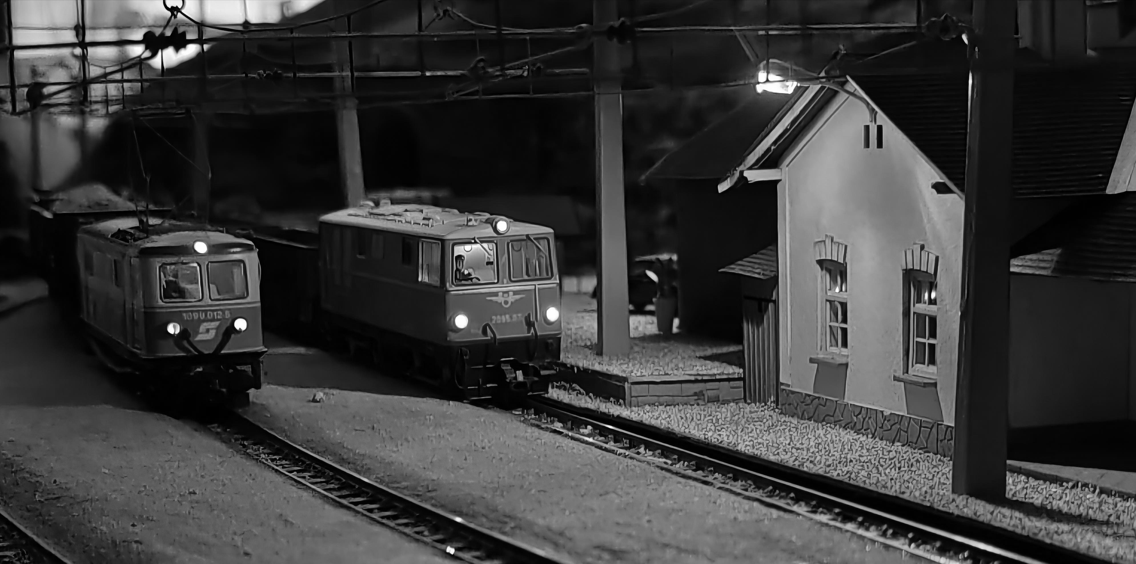

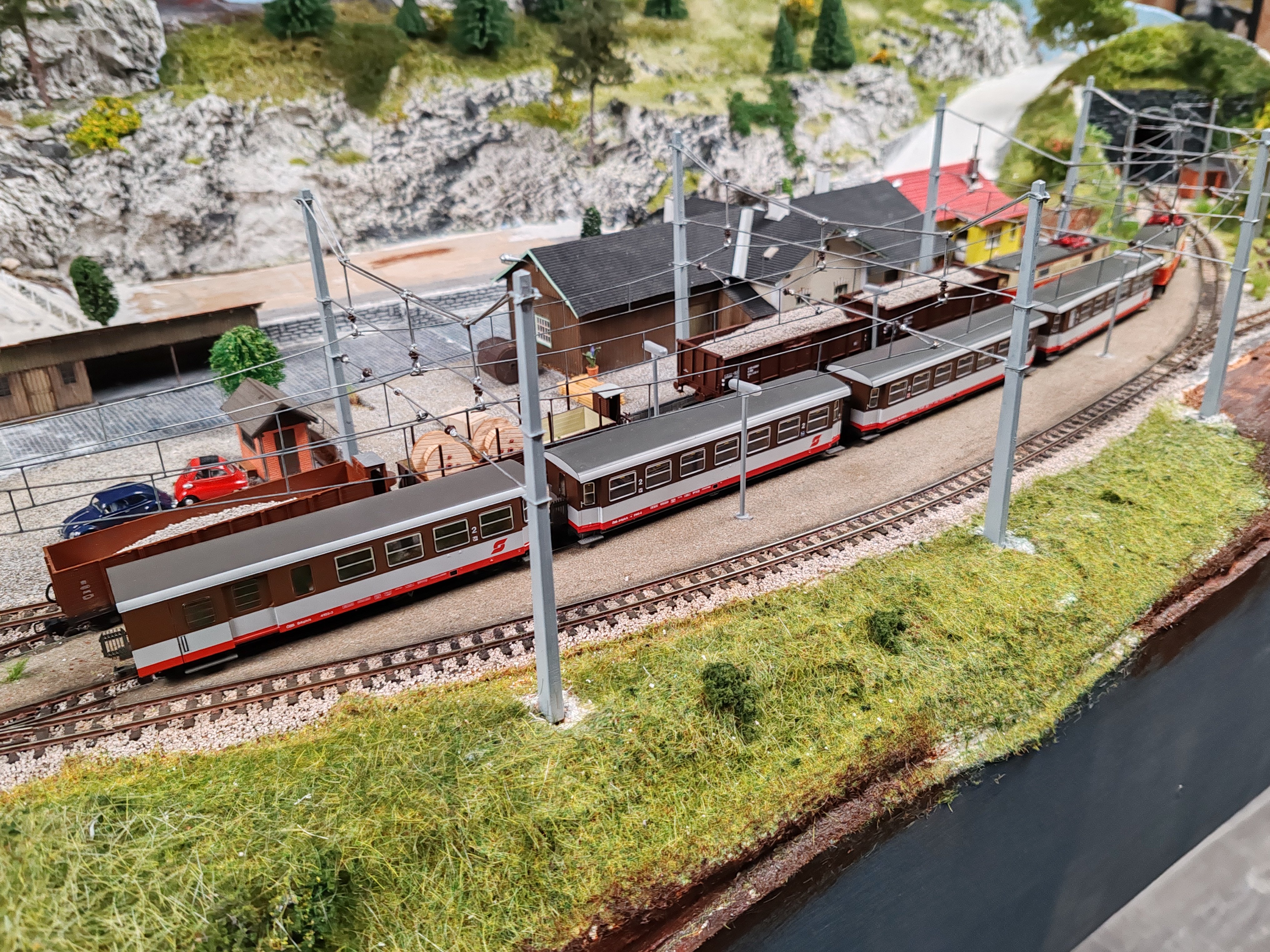

Georgeconna Posted December 3, 2025 Author Posted December 3, 2025 A few trees going in, road being prepped for painting and done more grass down. 4 1

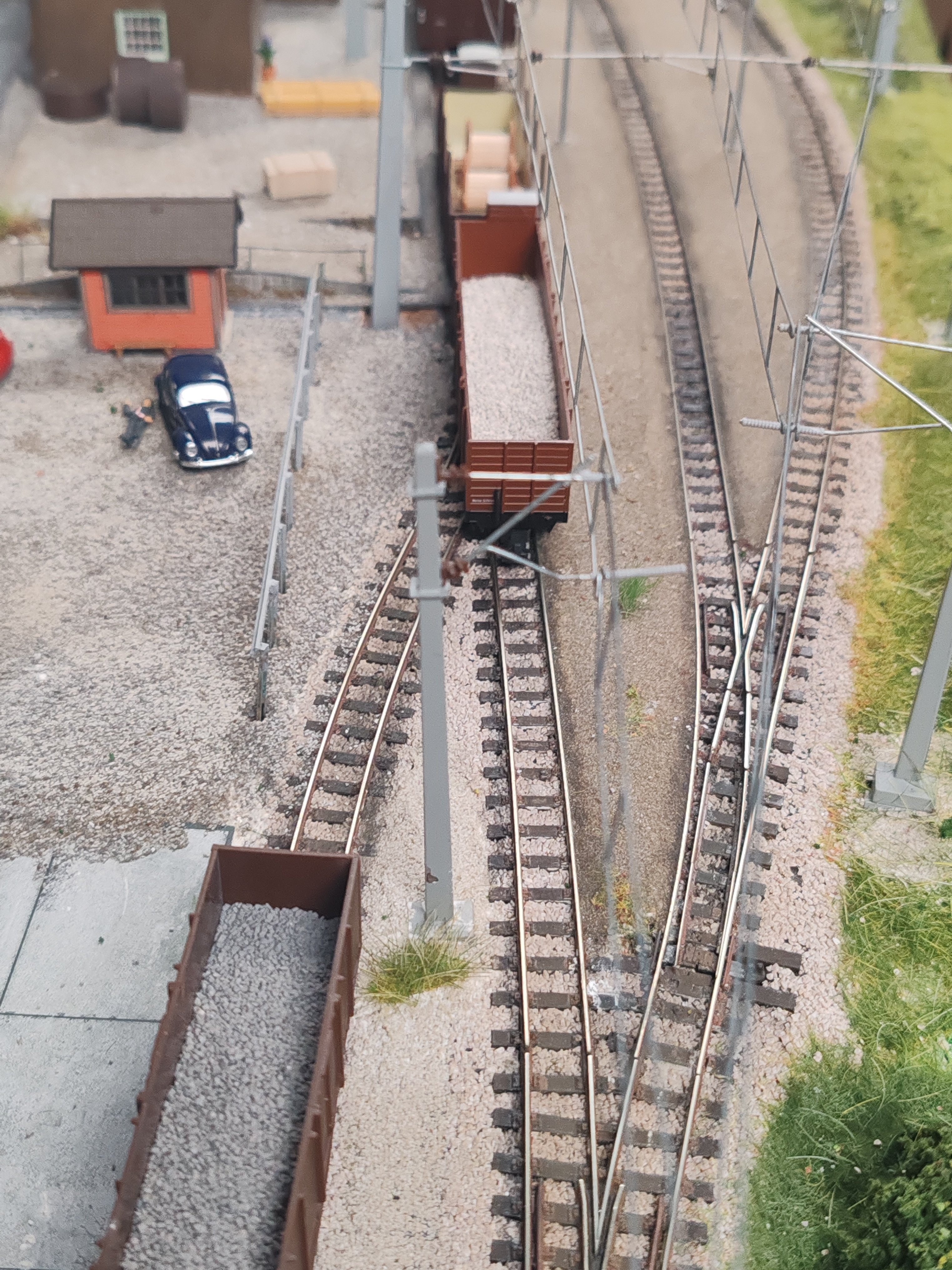

Georgeconna Posted December 3, 2025 Author Posted December 3, 2025 (edited) 9 hours ago, Mol_PMB said: Do I see some transporter wagons in that freight train? One of my favourite things to see on a model. Major planning error, one mast between the siding and running line is too close to the wagons and they snag so I can only reverse in at the moment. Might get a mast that can be located out side the siding to enable straight through running. Edited December 3, 2025 by Georgeconna 5
Mol_PMB Posted December 3, 2025 Posted December 3, 2025 Funny you should find that - I also had a problem with clearances to masts with my transporters, despite my best efforts to plan it out. Bogie wagons on pairs of transporters have particularly large overthrows on curves. 2

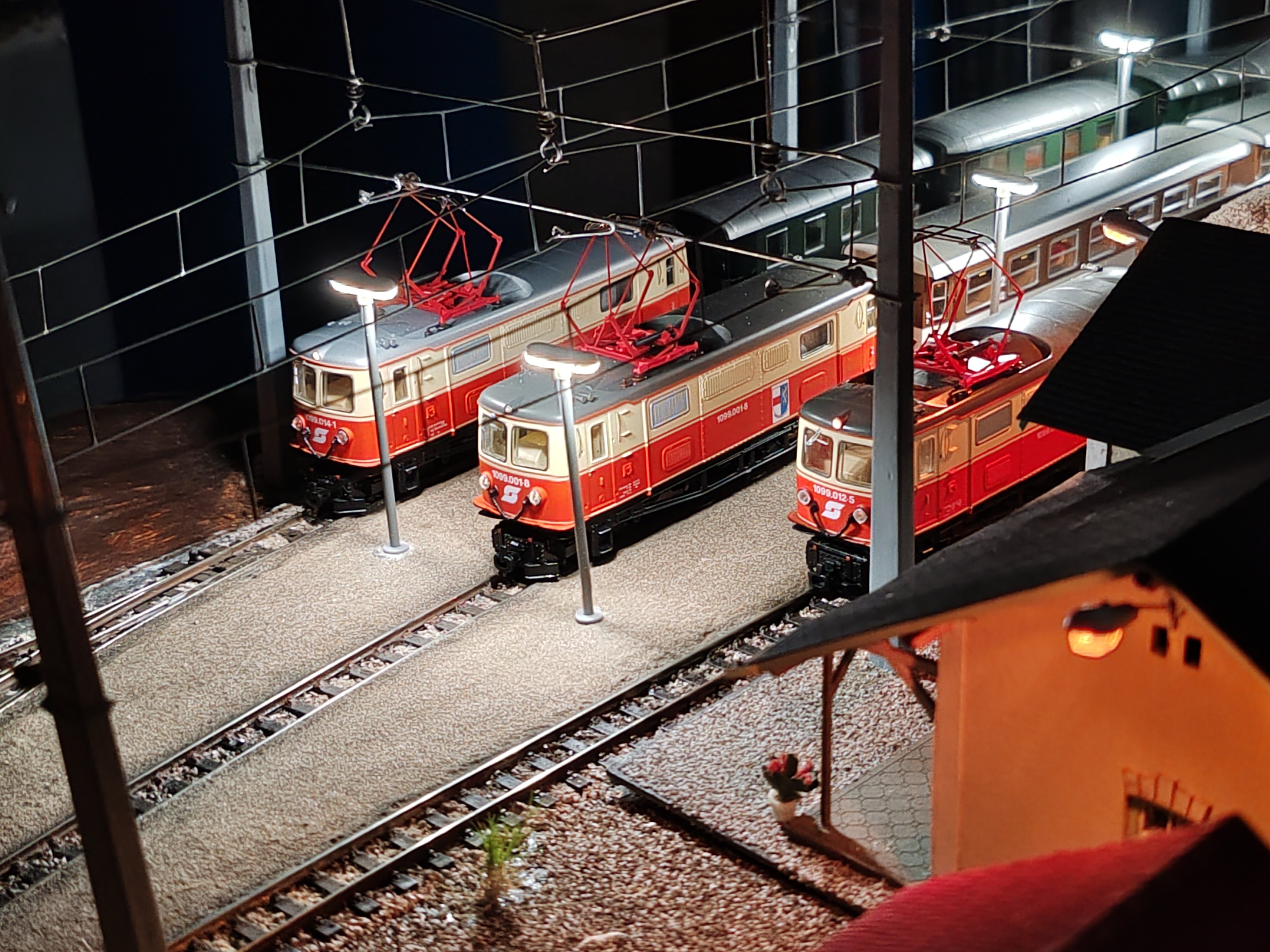

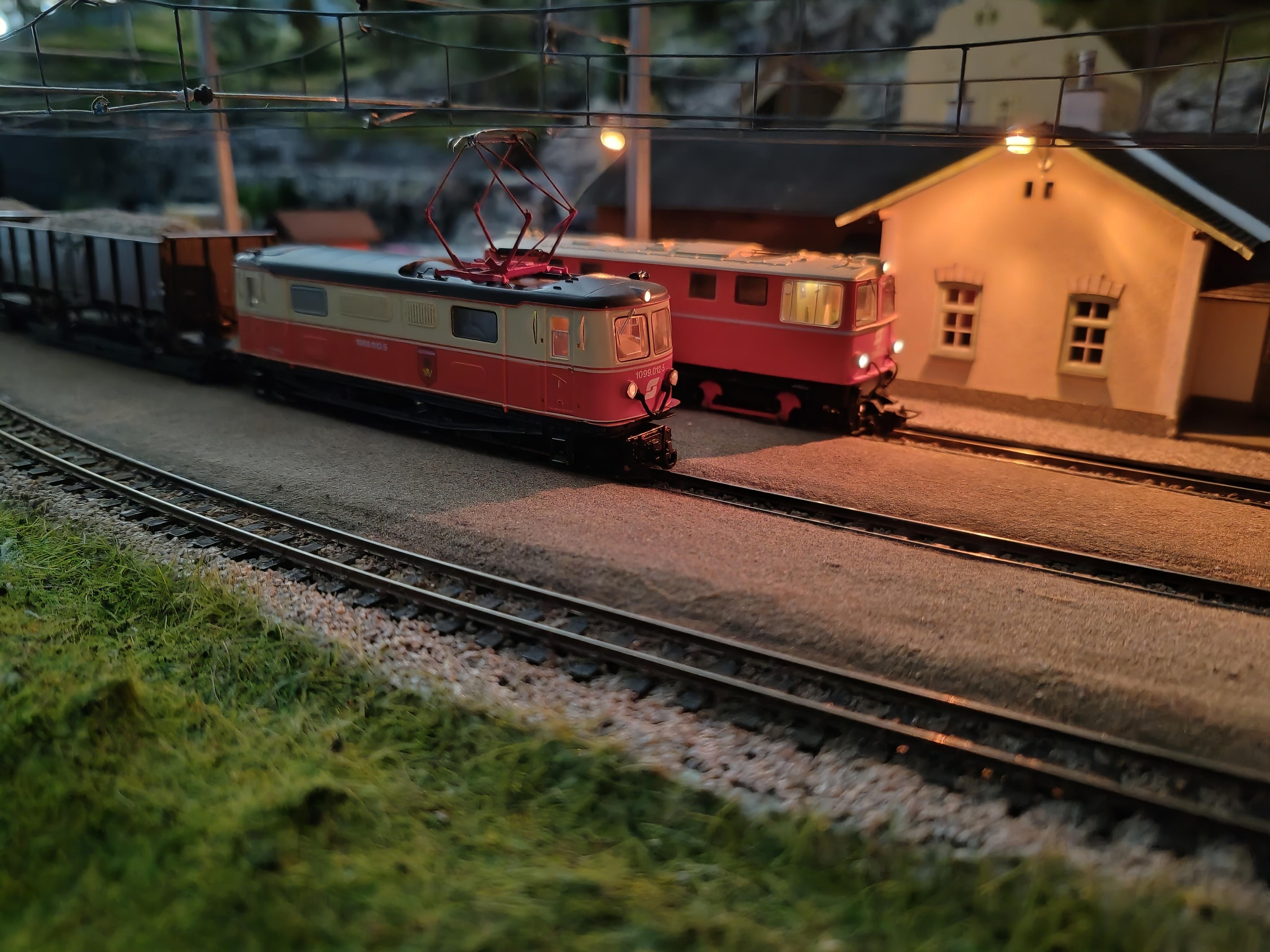

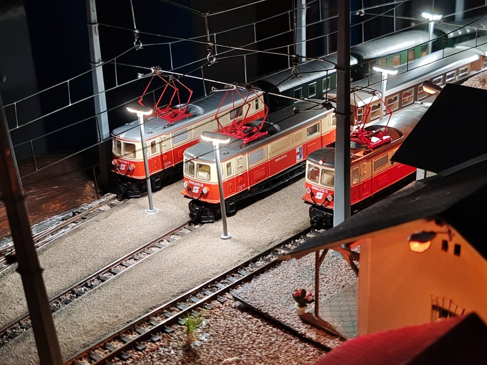

Georgeconna Posted December 12, 2025 Author Posted December 12, 2025 Got some more lights in the station building last night and took a trip back in time with some clever APPs. 2
amdaley Posted December 12, 2025 Posted December 12, 2025 2 hours ago, Georgeconna said: Got some more lights in the station building last night and took a trip back in time with some clever APPs. Hi George. You've done a fabulous job with this layout. Everything looks like it belongs there. The whole thing just looks right. What are those cobble sheets you're using on the roadway ? Tony.
