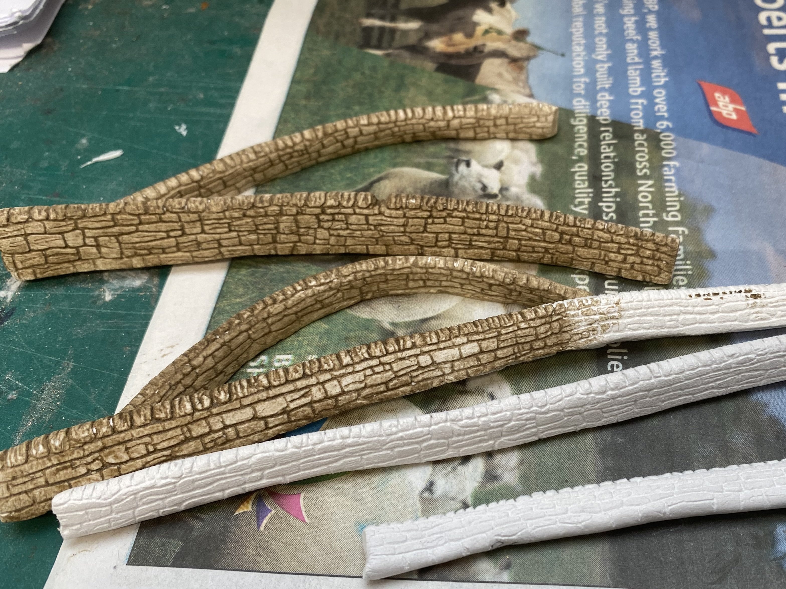

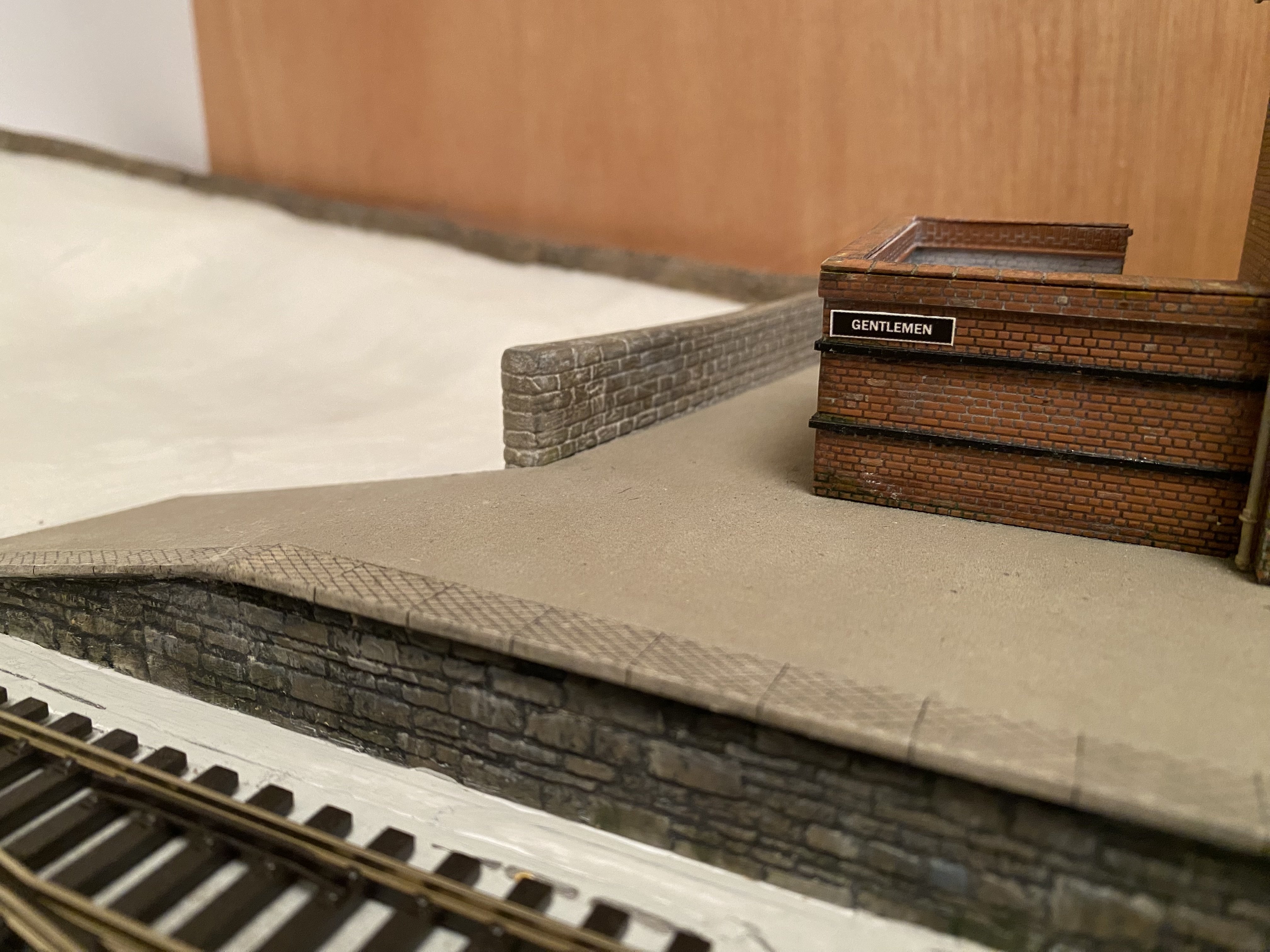

A bit more progress with the layout. A station platform made in two bits because it will cross the join between the two baseboards. I used mounting card for the structure and after a failed attempt to use chinchilla dust for the platform surface - it ended up looking like congealed porridge after the glue went on -  I settled for 180 grit sandpaper glued to the top surface with wood glue.
Many of the stations on the County Down had cast concrete coping stones, 3ft x2 ft, along the platform edge. These had distinctive diagonal cross hatching, 8 lines in each direction. Deciding how to model these held me up for a while. 3D printing might well be the solution but that's a mountain I've yet to climb. Even base camp is still over the horizon. I managed to draw one coping stone to scale on the computer then copied and pasted to get what I wanted. The result was printed onto paper which I'd pre-painted with a suitable mix. (I'd already tried printing first then painting, only for the nice printed lines to disappear under the paint, despite using water colours). The printer survived being fed painted card. Phew!

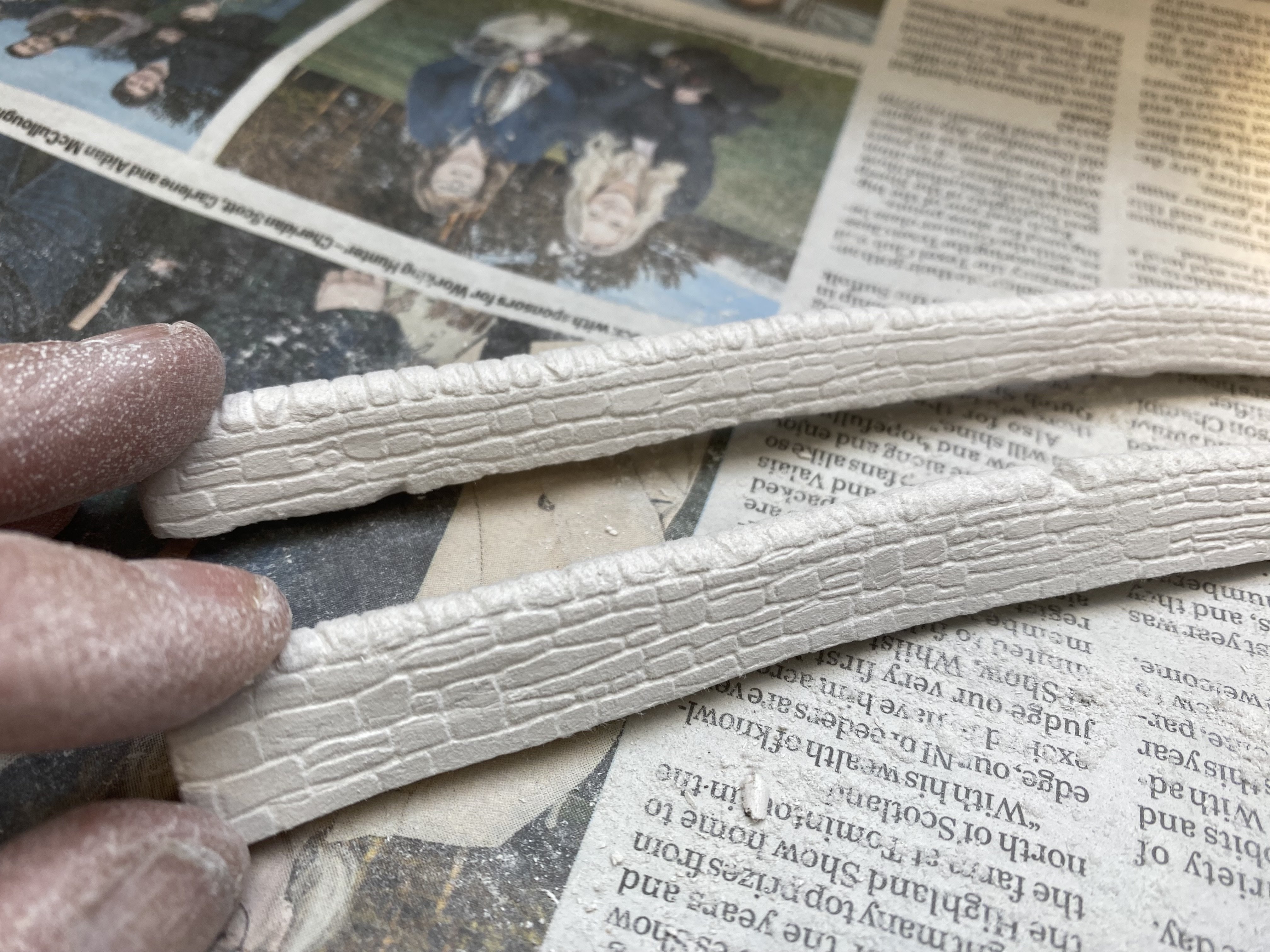

After painting the sandpaper with various shades of artist's acrylic, the coping stone prints were cut into strips, scored and folded then glued down along the front of the platform and wrapped over the leading edge.

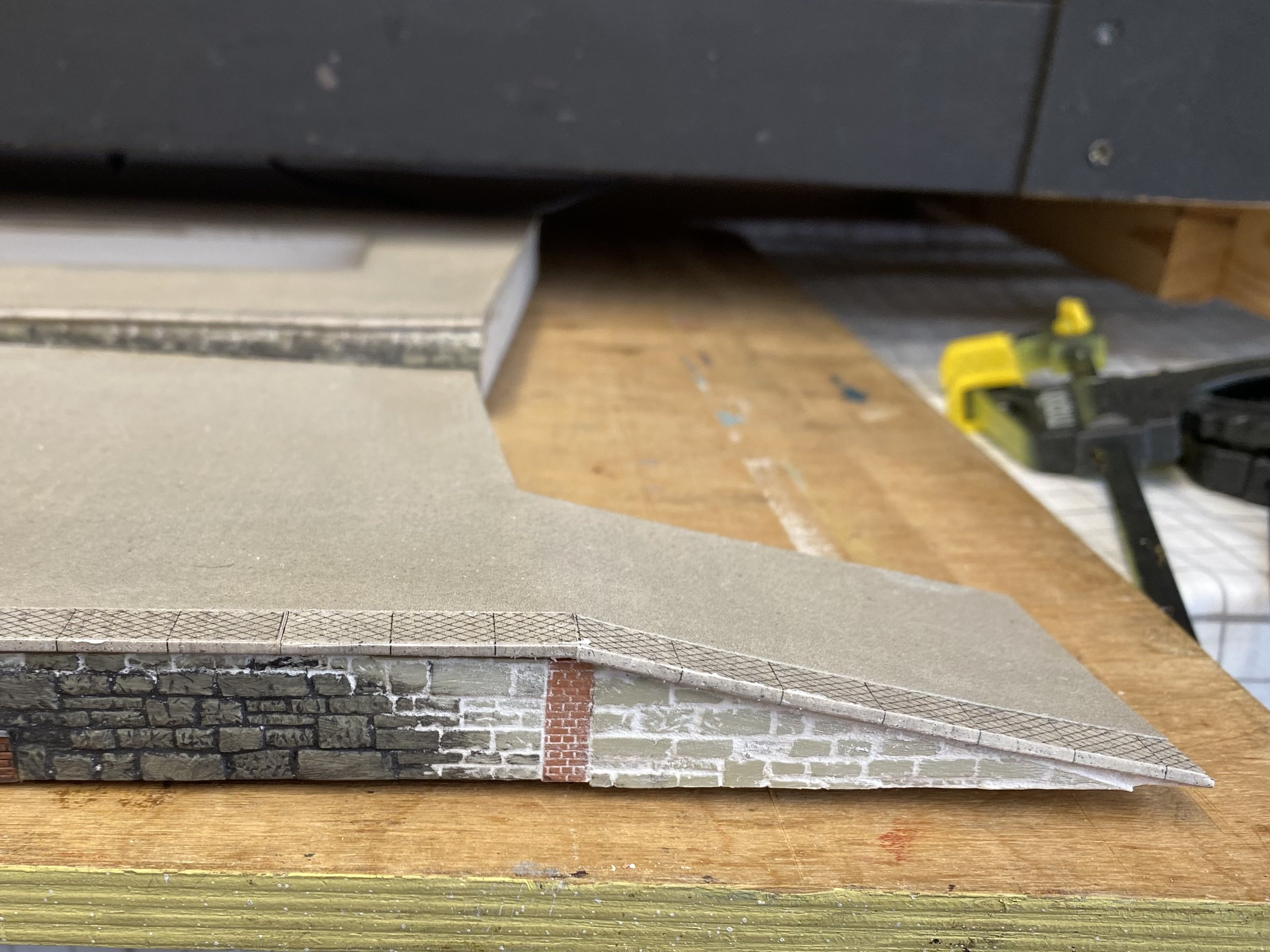

Wills Coarse Stone (SSMP200) was used to cover the platform front, sanded back a bit and wiped over with filler. Paint did the rest.
The station building will bed down into a shaped hole cut for it in the platform. It's still sitting a bit proud in this photo. A bit of weathering will also help to blend building and platform together.

That is looking superb, and your experimentation with different techniques has really paid off.
I was going to suggest the edging could be laser-cut (I have such a toy) but I think your painted and printed version looks wonderful!

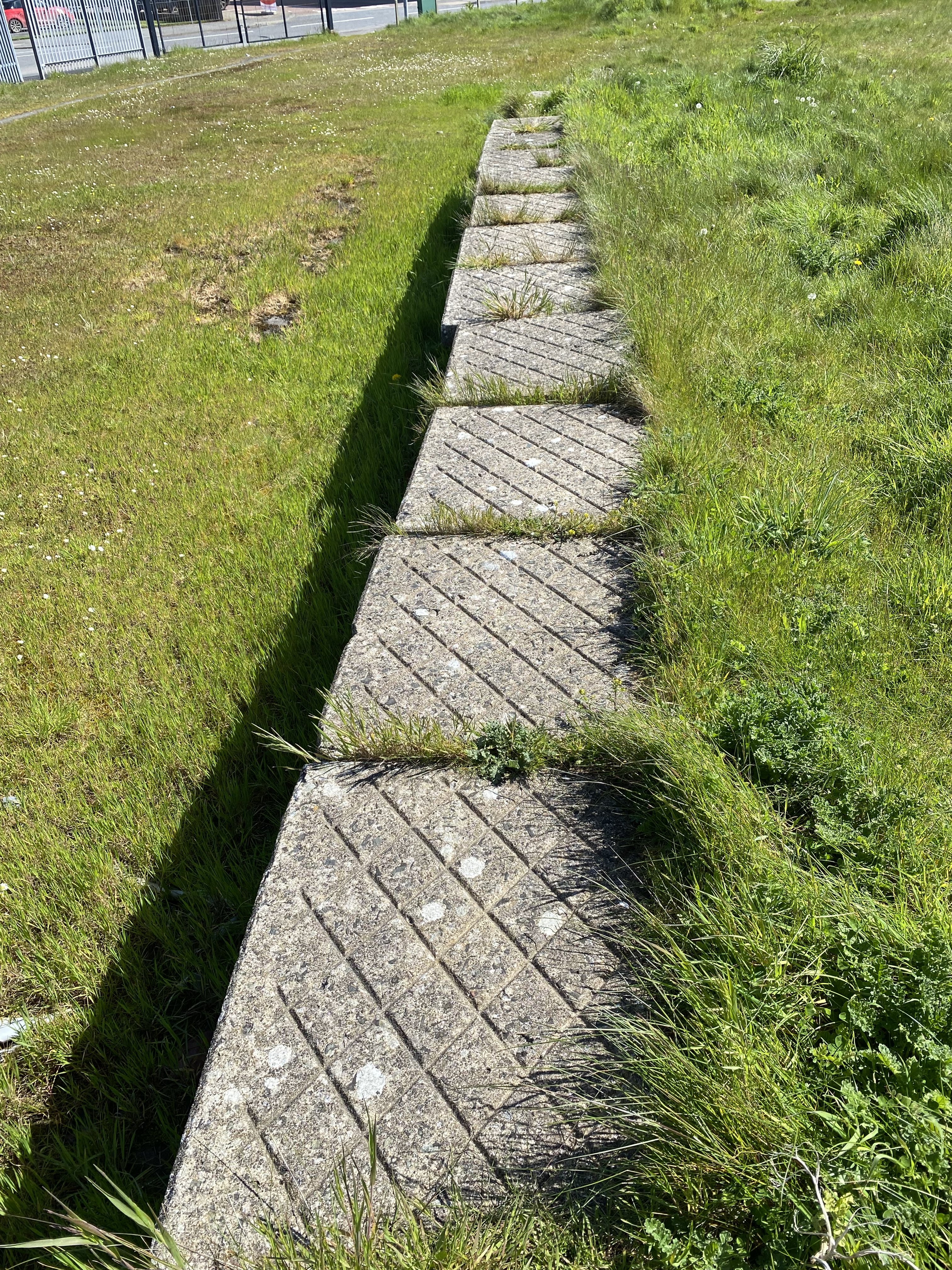

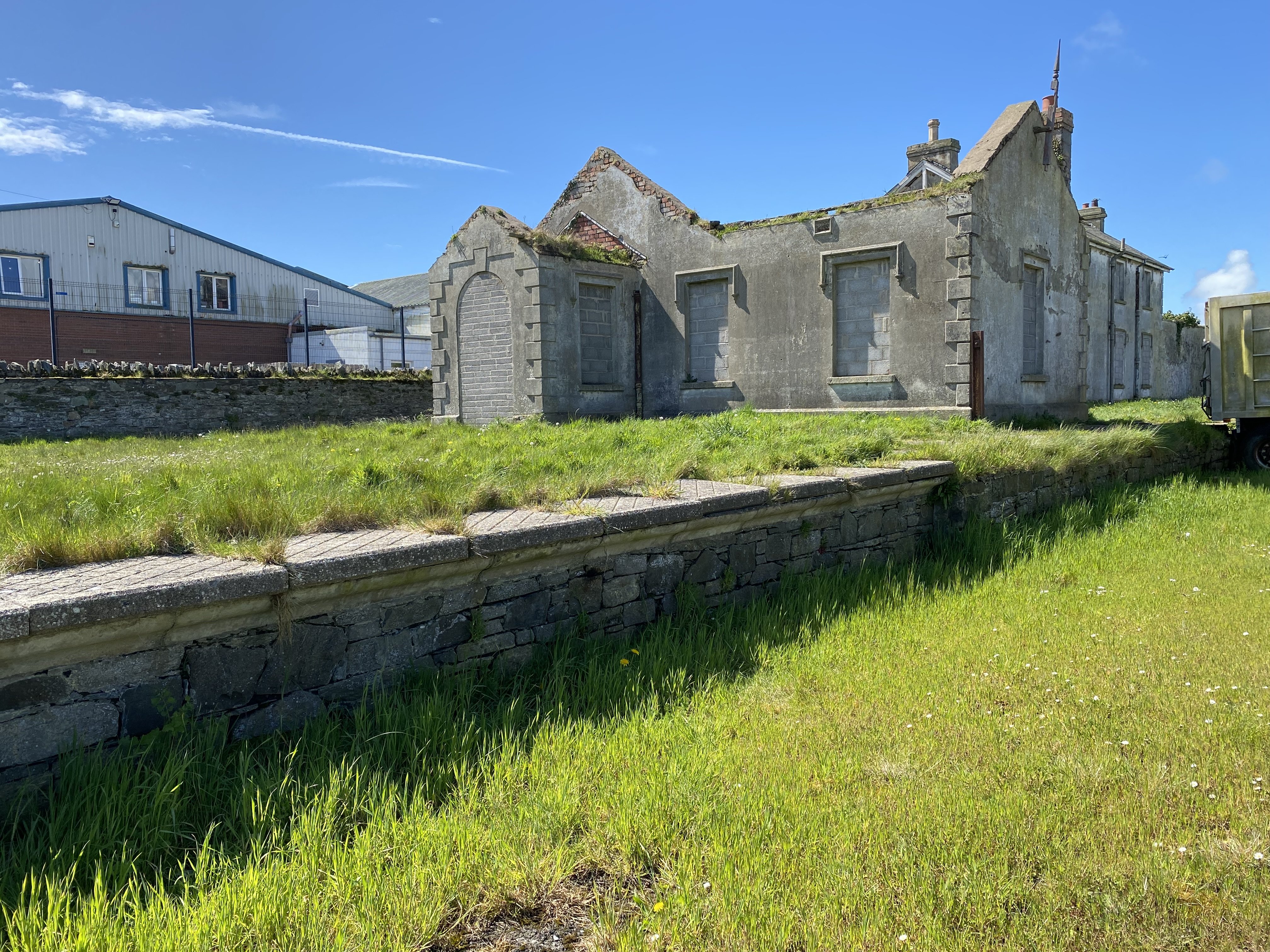

Some survivors on the remains of the platform at Ardglass station. Photos I took last year.

Many thanks. I hadn't thought of laser-cutting. Another technique not yet in my skill set😄

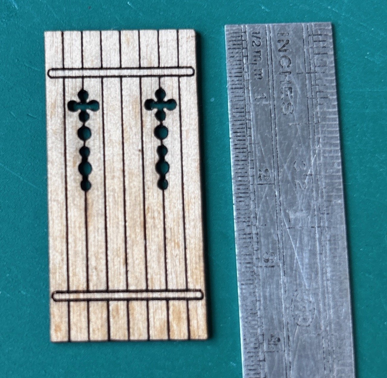

It would do a nice job of engraving the surface patterns and cutting out the strips too. Could be done in a material like 1.5mm or 2mm MDF to match the thickness of the real coping stones.
Here's a little test piece I just found lying around - an elaborate window shutter (this is in 7mm scale) cut and engraved on 1.2mm ply:

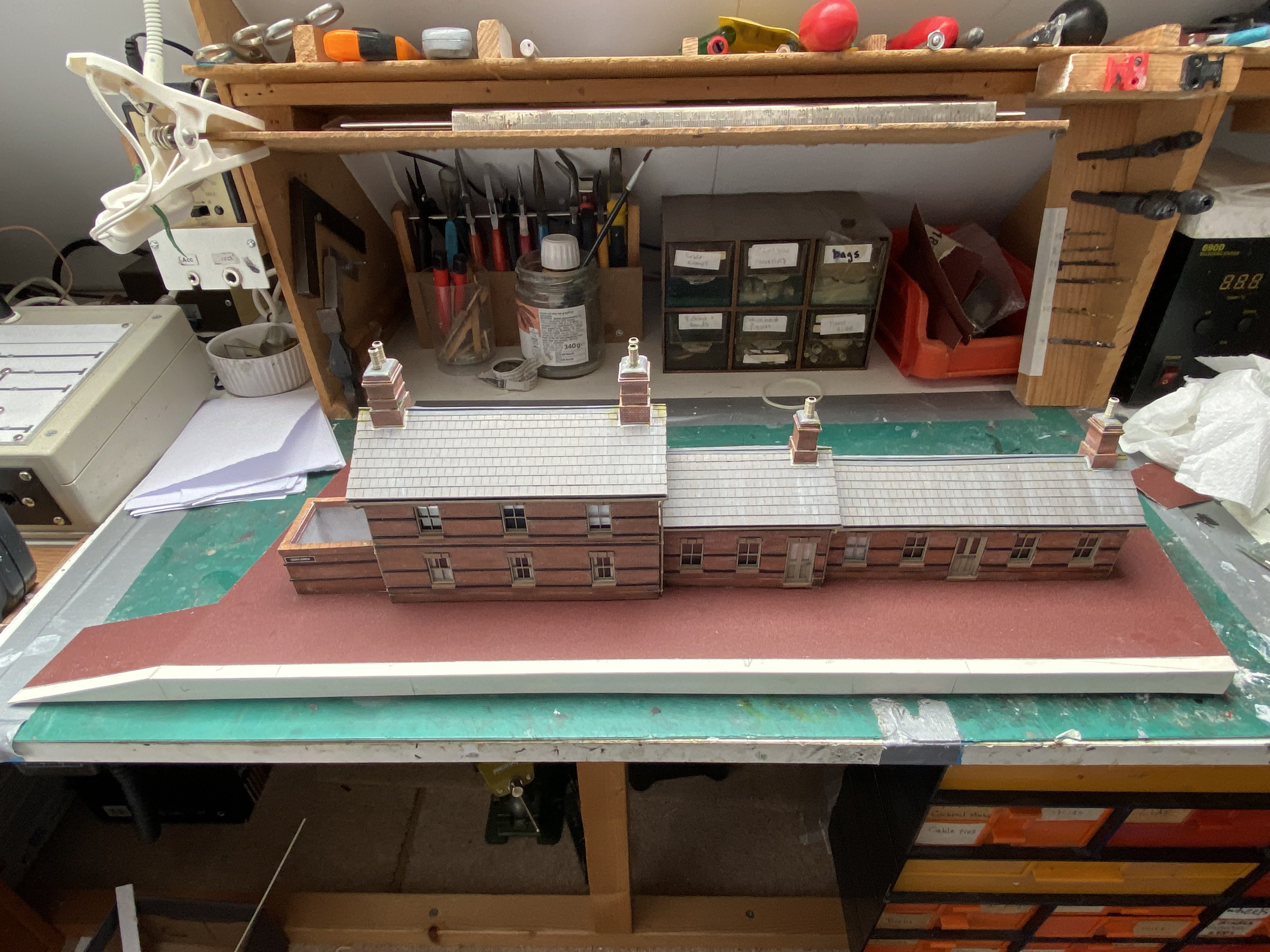

And a whole building I designed and made using the laser cutter:

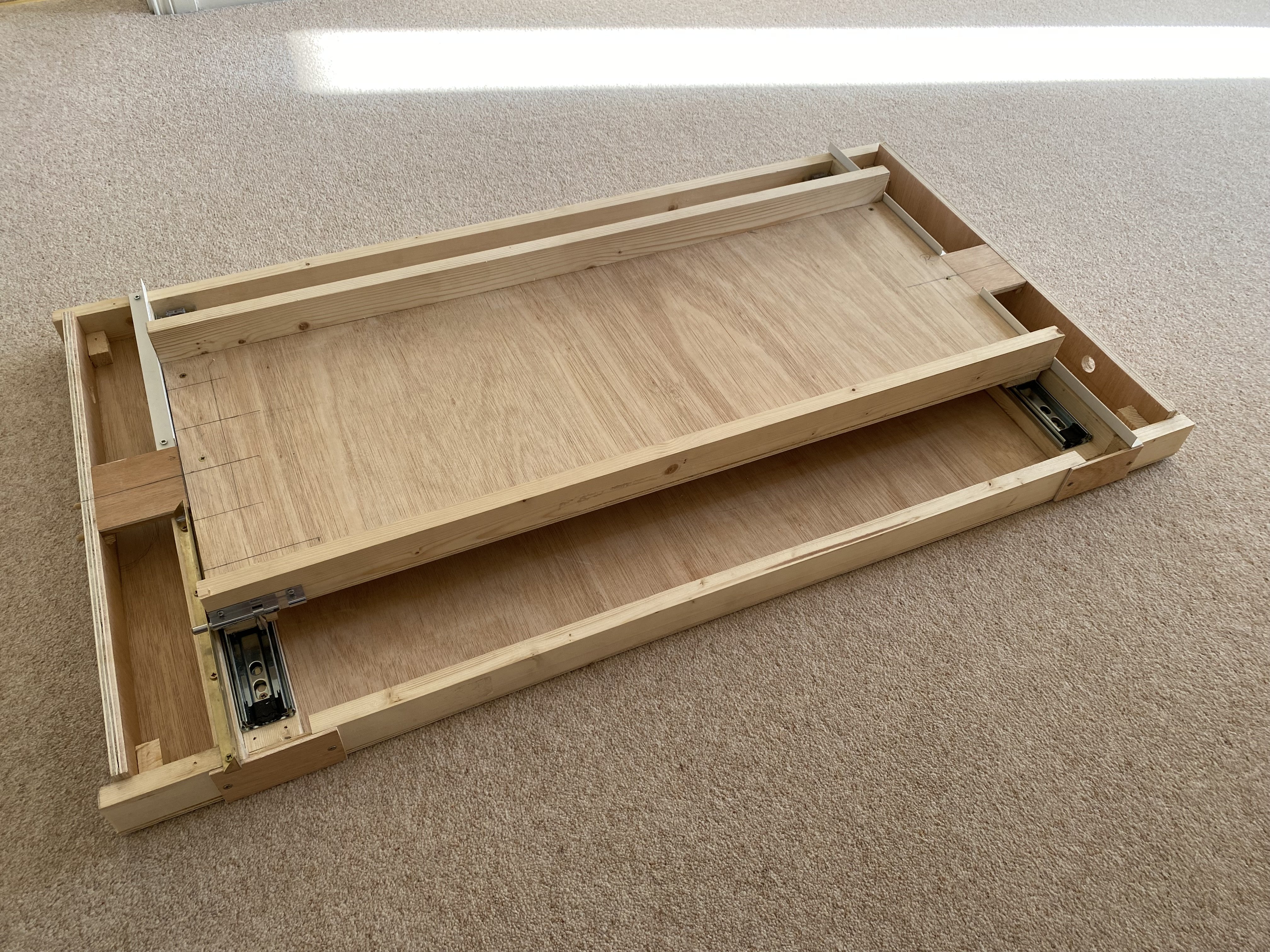

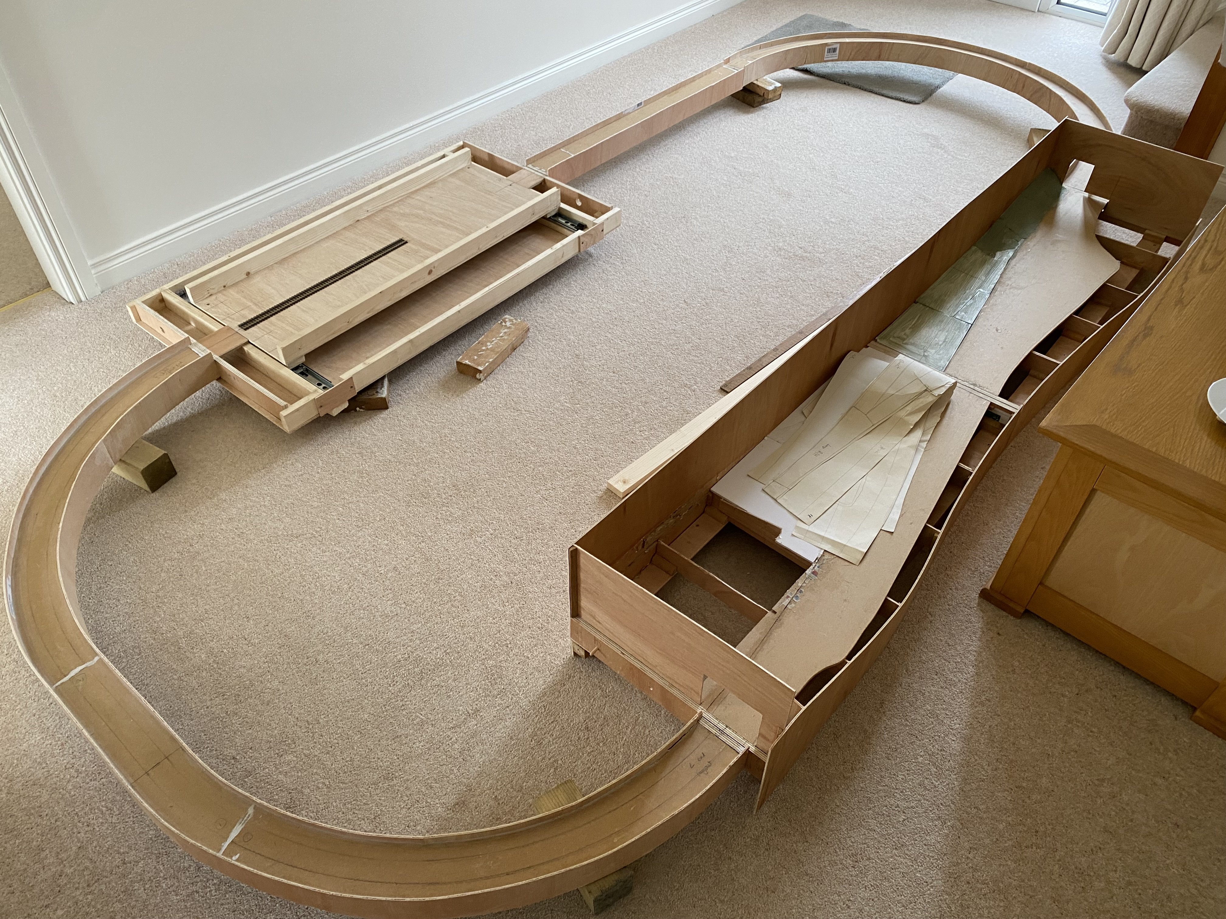

My original intention was to put cassette fiddle yards on each end of this layout. However, if it's to go out to exhibitions, which I hope it will, it could be quite challenging, not to say tiring,  to operate so that there’s fairly frequent movement. There’s also the risk of damage as cassettes are changed or turned around. I know from experience that my locos don’t bounce when dropped.
Thoughts turned to a continuous run with off-scene curves and a traverser at the back to reduce the amount of stock handling and that’s what’s been using up my time and stock of abusive language. I think it’s going to work ok but it’s just about doubled the intended footprint of the layout.

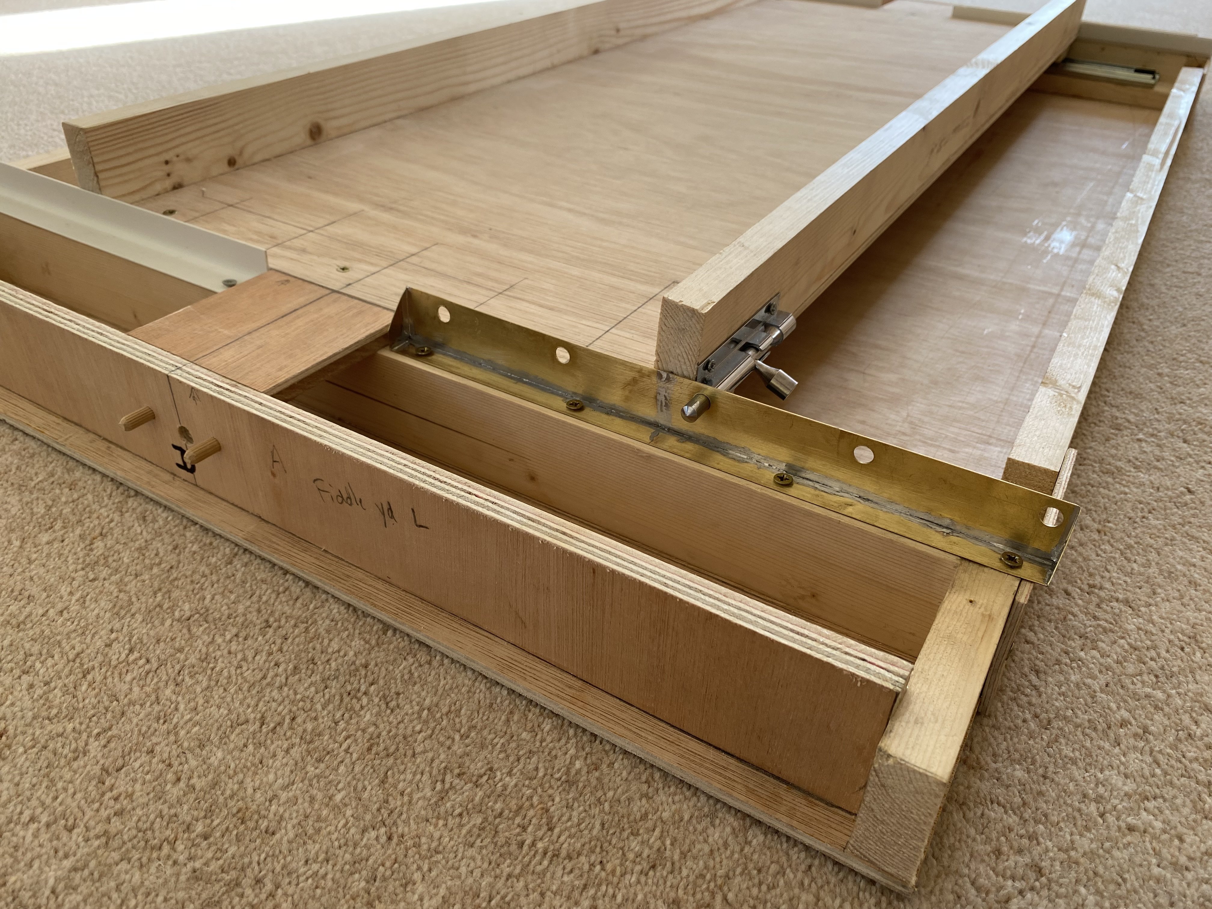

Traversers are tricky things. I’ve made mine using ball race drawer runners laid on their sides rather than upright as they would be in a drawer. It just seemed easier that way to get the levels sorted. It’s probably over-engineered - I’ve seen more elegant designs - but I wanted it to be robust and to cope with reasonably sized trains. No track or wiring yet but it will have 5 roads each of which should be able to hold a loco and 5 coaches. (I have lots of locos. Coaches, not so many. Yet.)
The curved joining sections are made to take 4th radius set track. It took a fair bit of trial and error to get everything to line up. The job was a trial and I made the errors. I was going round the bend, literally and metaphorically.
I don't actually have a big enough space at home to lay it out. This is the front hall.  I may have to throw out furniture.
Of course the whole thing now needs some form of support to get it up to a good viewing level so that’s the current job.

Very neat work! It will certainly transform the operations.
Just a thought - would it be worth having a couple of short, fixed dead-end tracks off each end of the traverser section (flanking the through line)?
This would allow you to store spare locos and swap locos onto trains without handling them. They wouldn’t be accessible from all the traverser tracks but should be able to access some of them.
  • Agree 2

Thanks for this. An idea worth considering. I'll know better what's possible when the thing is up and running. That might be a while yet!😁
Clever thinking for the traverser! Nice too that you can use fairly tight radius curves for the off scene sections to keep the overall footprint compact. The fact that it all aligns nicely is a real challenge on a sectional exhibition layout, so definite pat on the back there!
 Did it once in 0 gauge. The layout was about 30' x 12' of which only the front 16' was scenic. Took it to the Chatham Show, but didn't get any more invites for some reason...
 Changed it to cassettes each end and suddenly the number of operators needed doubled, so your solution is definitely the right one. Presumably, only the layout and sector table will need substantial support, with the curves cantilevered off them and maybe just simple pillars in strategic places for the curves. Minimising the amount off  "stuff" to set up, transport etc is crucial in making exhibiting tolerable - but am sure you know that!

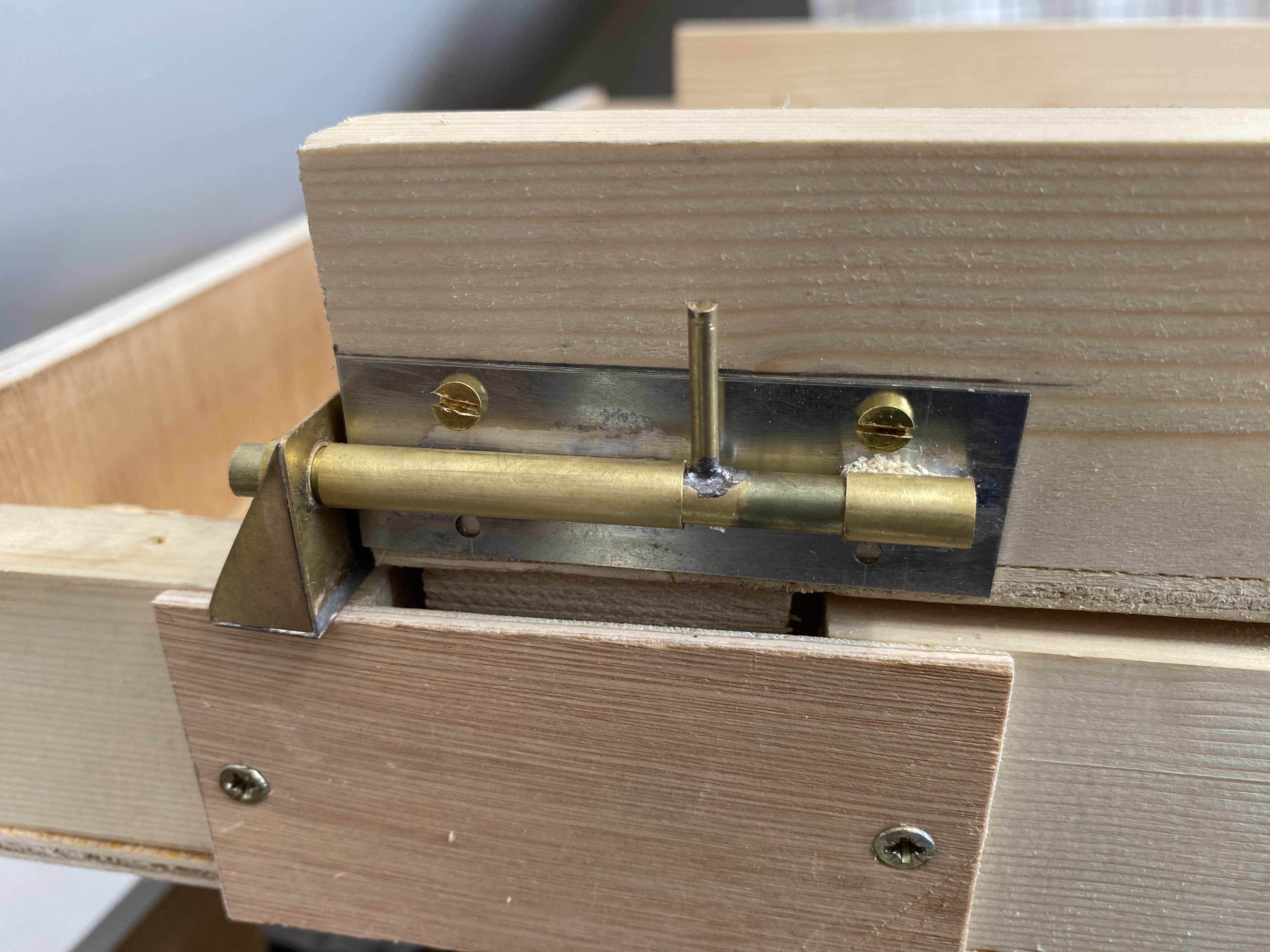

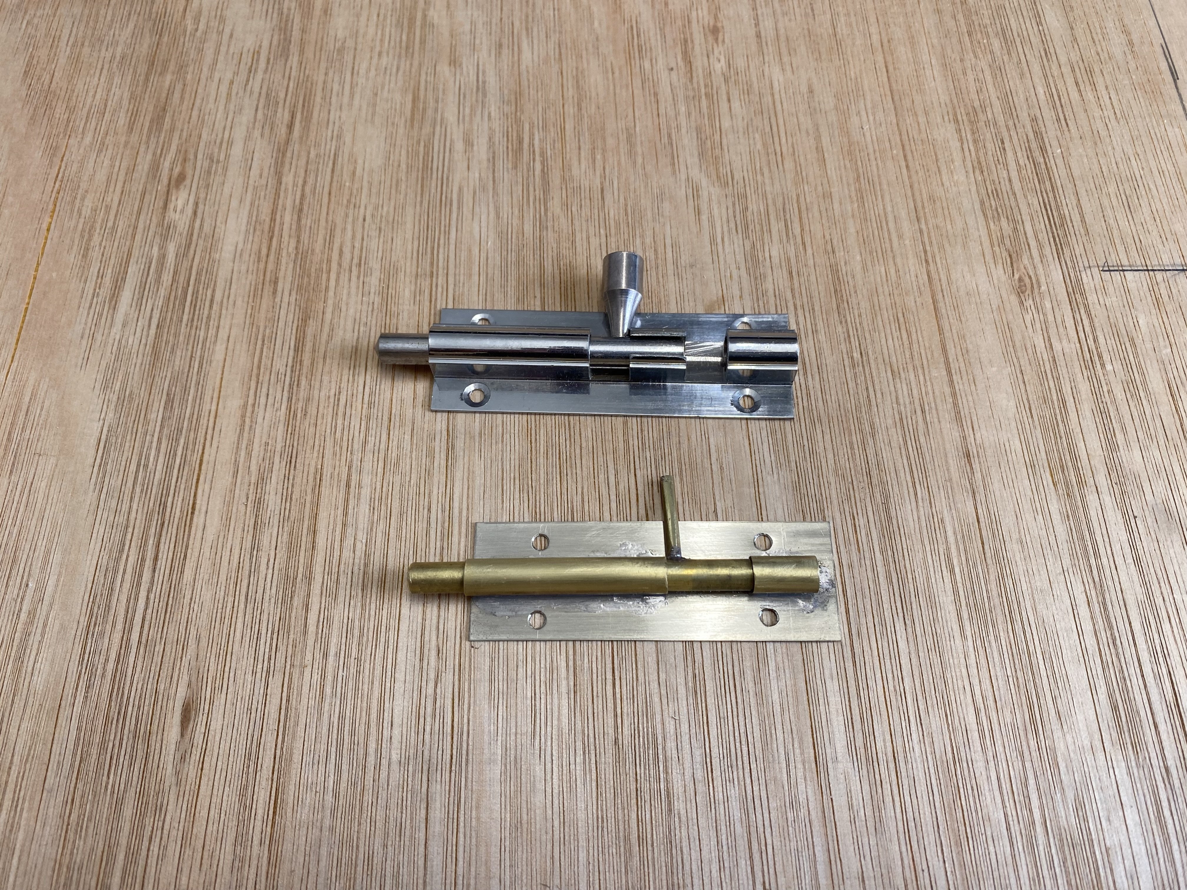

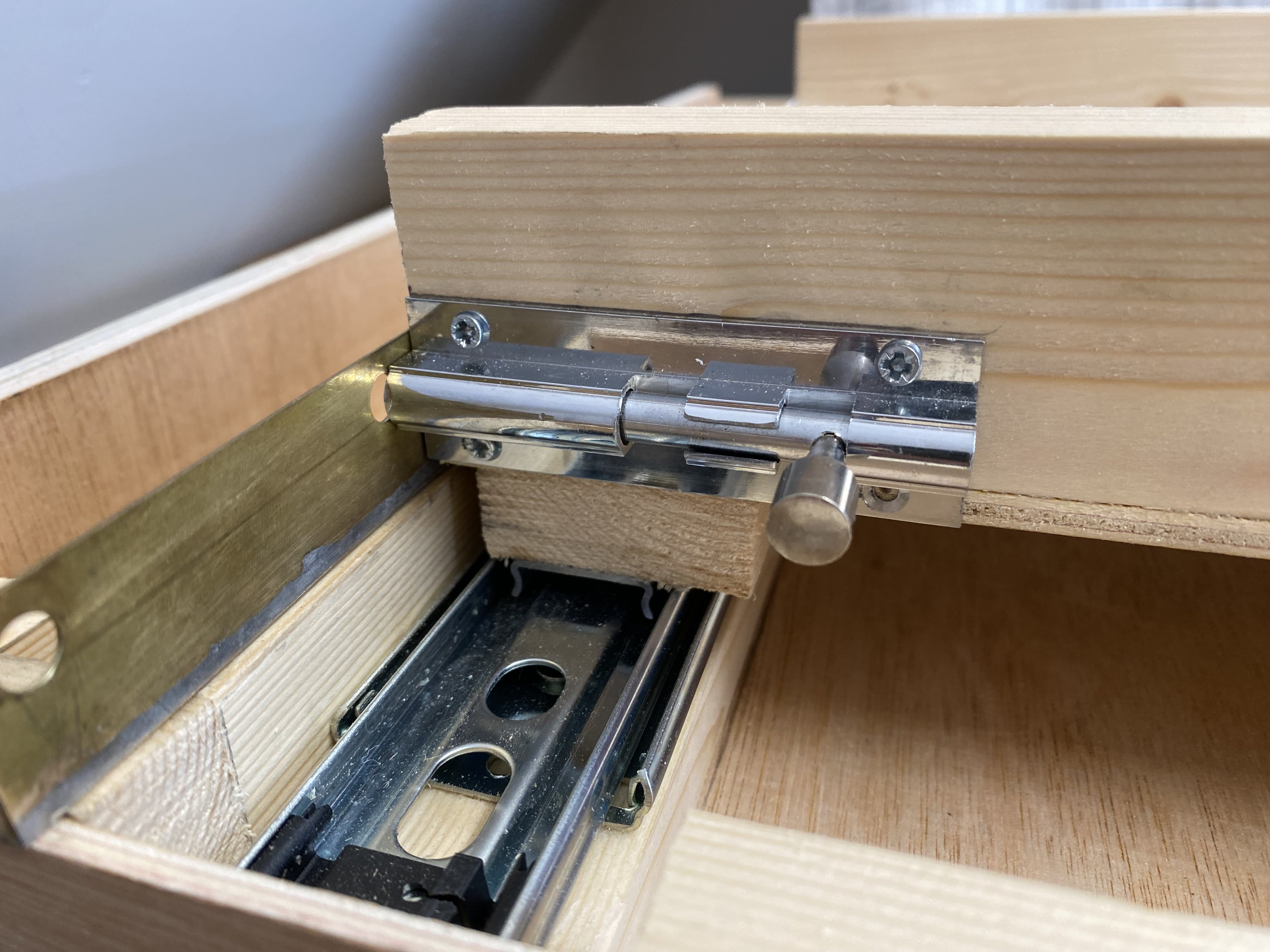

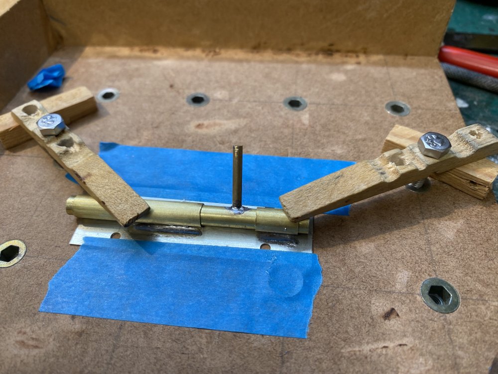

While laying some track on the traverser, I realised that the barrel bolt I'd bought to lock the moving table in its various positions had quite a lot of slop in it. Fine for locking the bathroom door but not nearly refined enough for accurately lining up the sidings with the entry/exit lines.
It took most of the afternoon to contrive a replacement from nested brass tubing. Also had to sleeve the now-too-big holes in the registration plate but all in all, worth the effort. Zero slop and a better chance of the traverser working as it's supposed to. Should've done this in the first place🙄
  • Like 13
  • Informative 2
Looks very neat Alan and should be robust enough for exhibition use.
I use a similar concept for aligning the traverser on a OO layout and turntables on my large scale garden railway using 1mm bore brass tube & 1mm brass wire (formed into an L shape) as the bolt/alignment pin. The brass sleeves are bored vertically (a tight fit) into the traverser deck and frame and soldered to rail web on the turntables which at this stage have stood up to 15 use with quite heavy locos, though I have to occasionally replace the odd pin.
I was able to set the drawer runners on the traverser vertical having an 80mm baseboard depth.

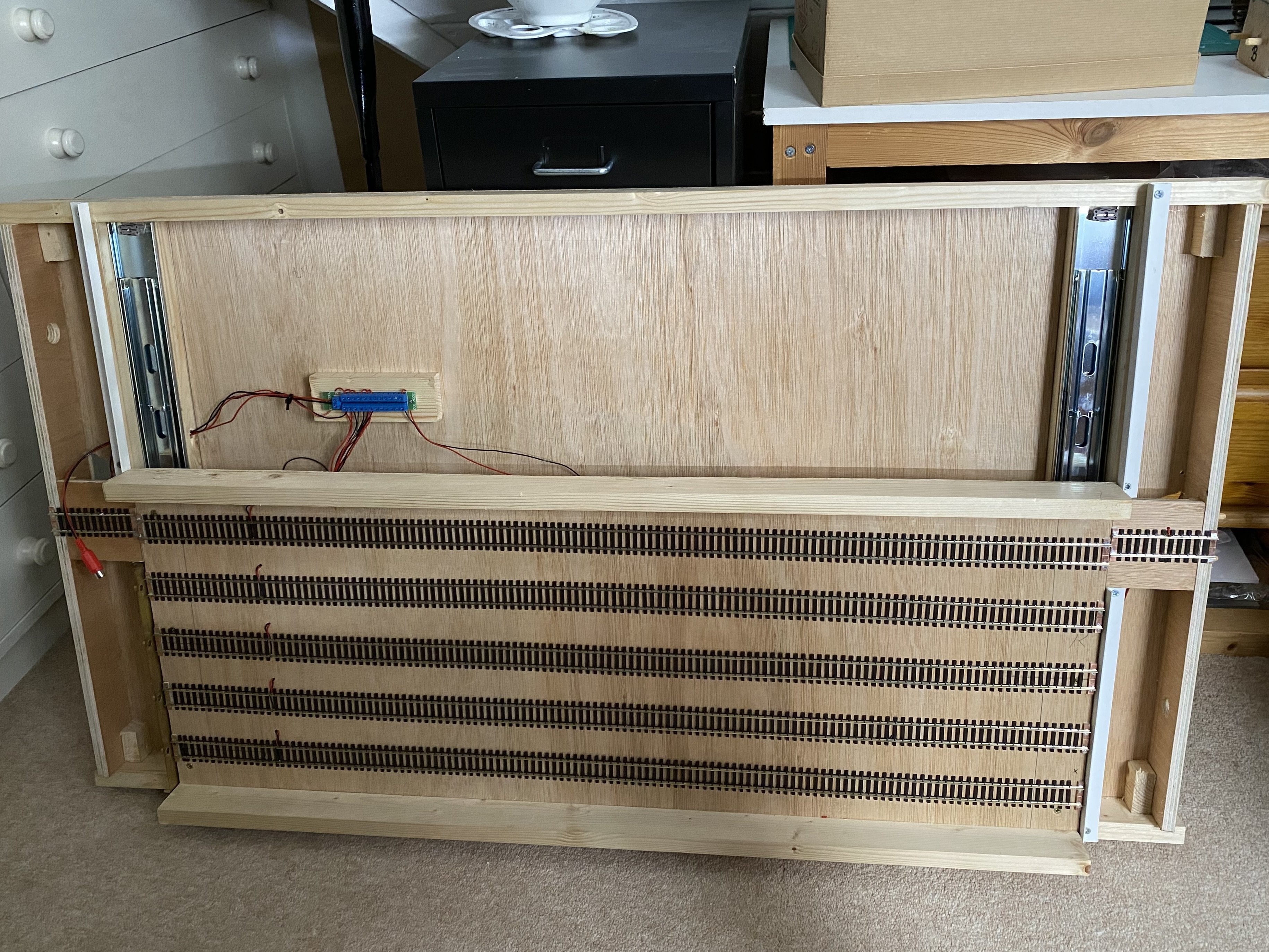

Thanks for sharing this Alan. It's incredibly neat as ever! I've always struggled with traversers/sector plates (the downfall of many a micro layout), and need to drum up the confidence to give it another go. So this, and the earlier post, are very helpful!

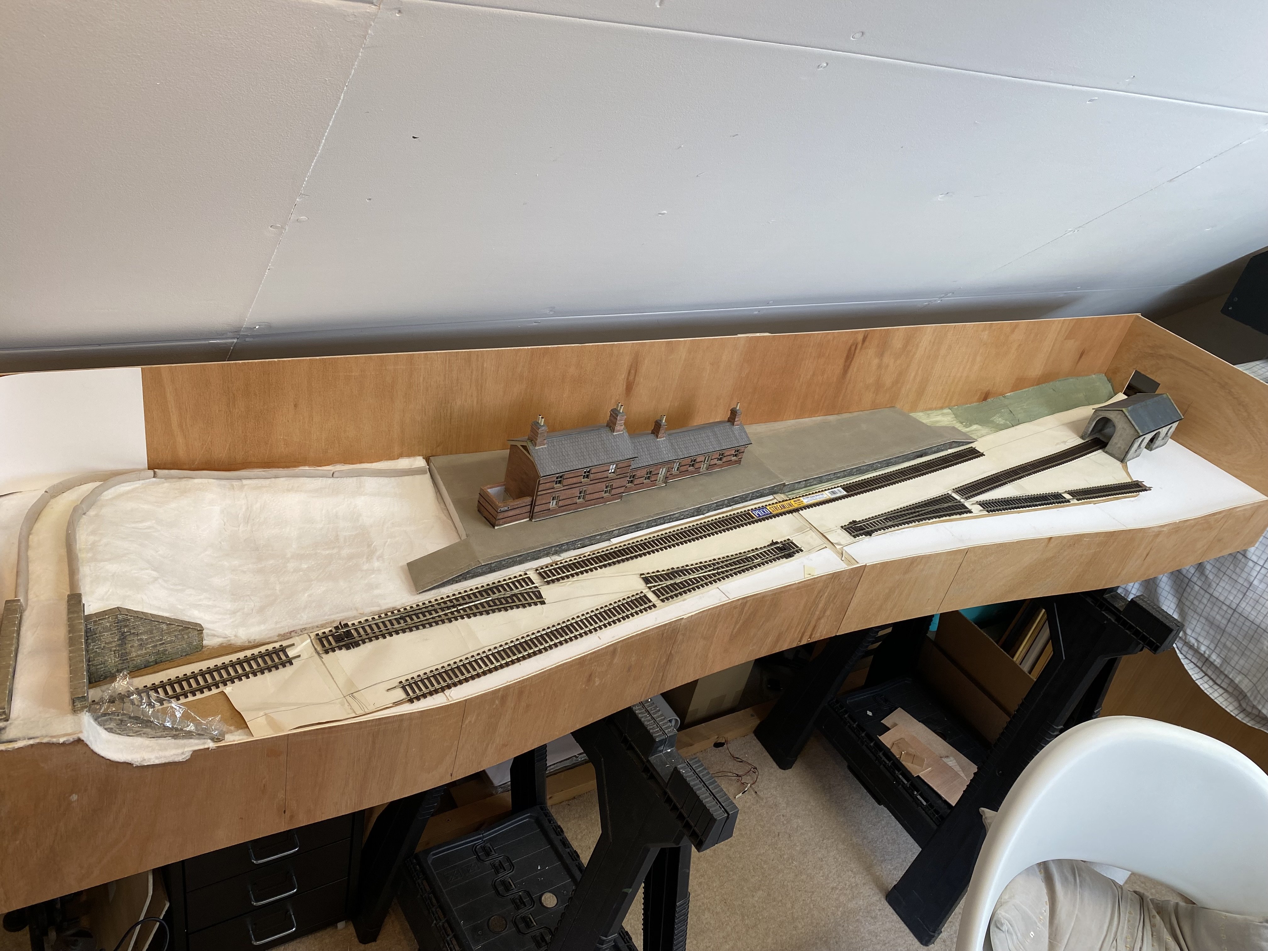

Track is now laid, wired and tested on the traverser. It seems to work pretty well though some of the track ends will need tweaking to line them up a bit better. I've parked it for now while I lay track on the curved link sections.
Despite my best efforts to keep things tidy when wiring track, it never seems to work out that way.
I won't lay track on the scenic section until I've done a bit more of the landscaping...

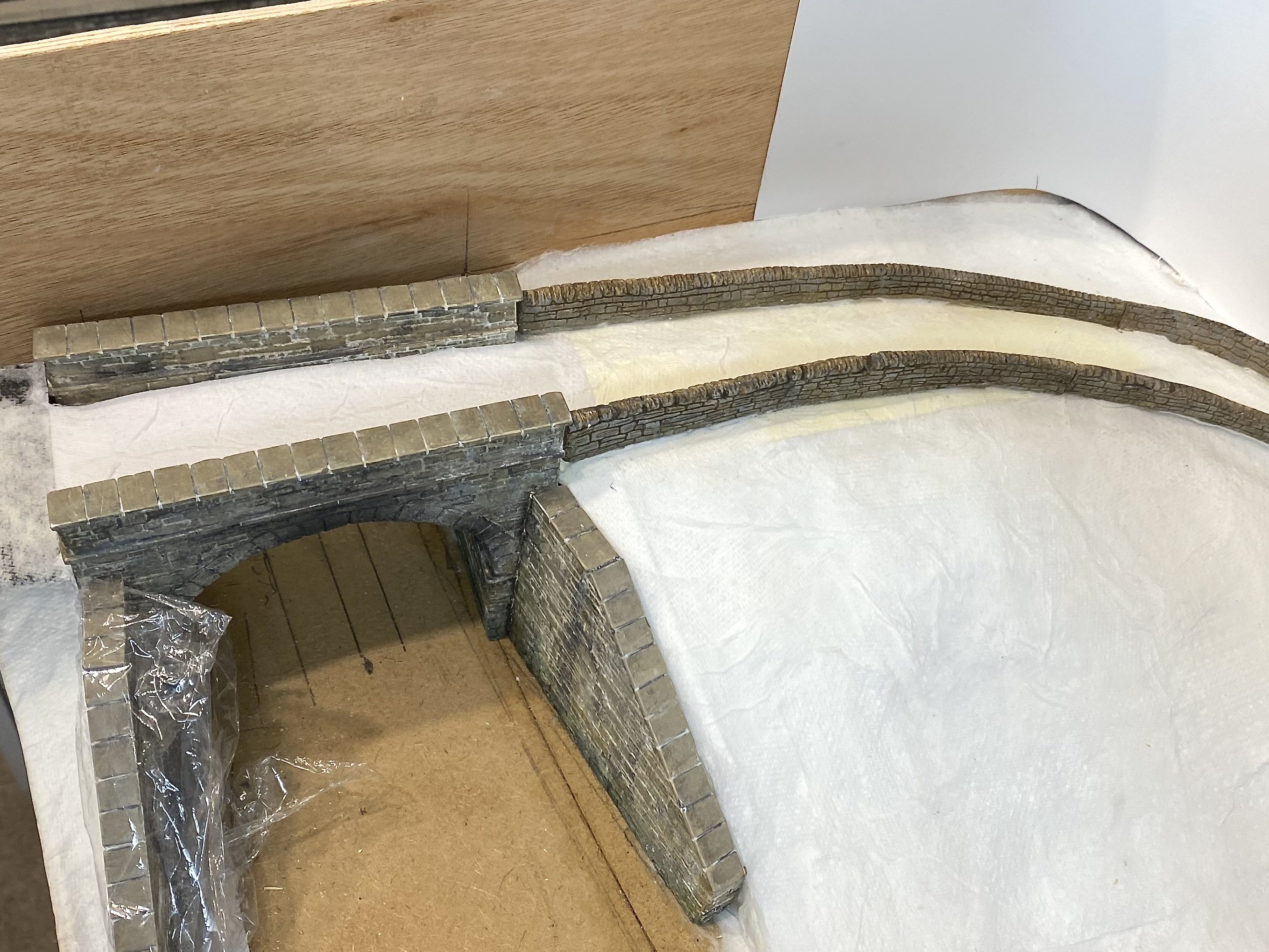

... so I've been stonewalling. Knee deep in DAS dust.

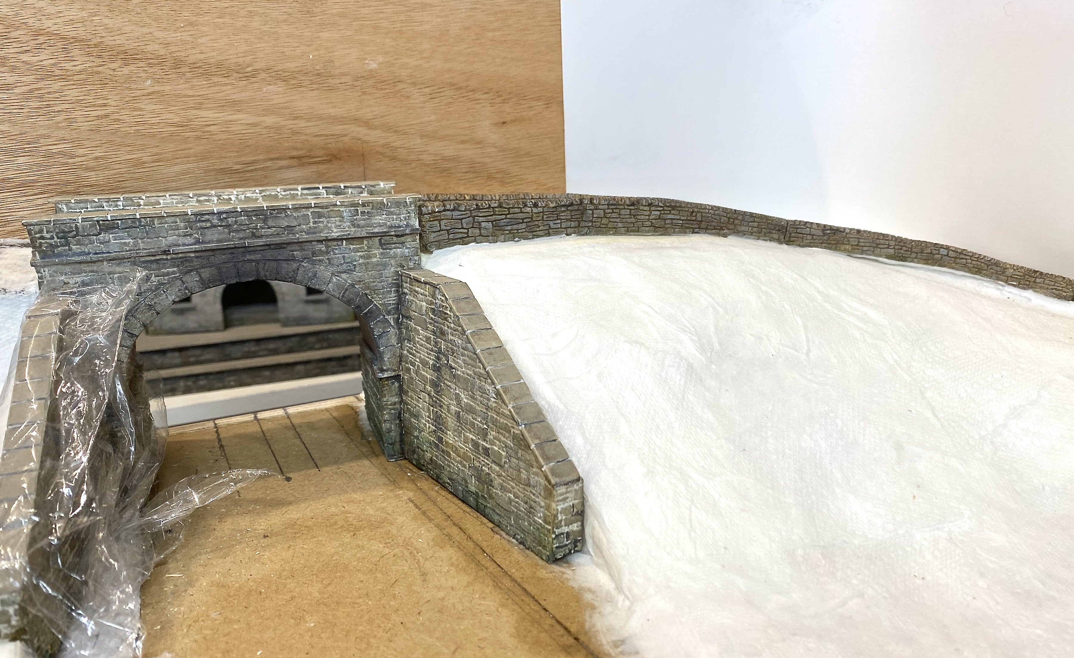

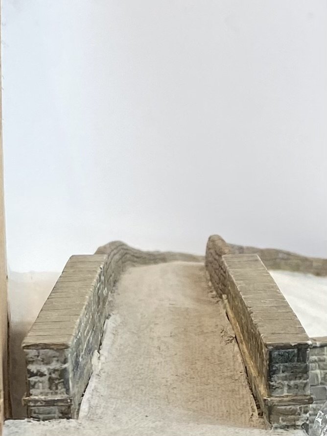

I'm trying some forced perspective with the road over the bridge. It remains to be seen if it'll work the way I'd like it to. The walls get smaller as they curve towards the back scene, eventually meeting just out of sight. The bridge itself also narrows from one side to the other.

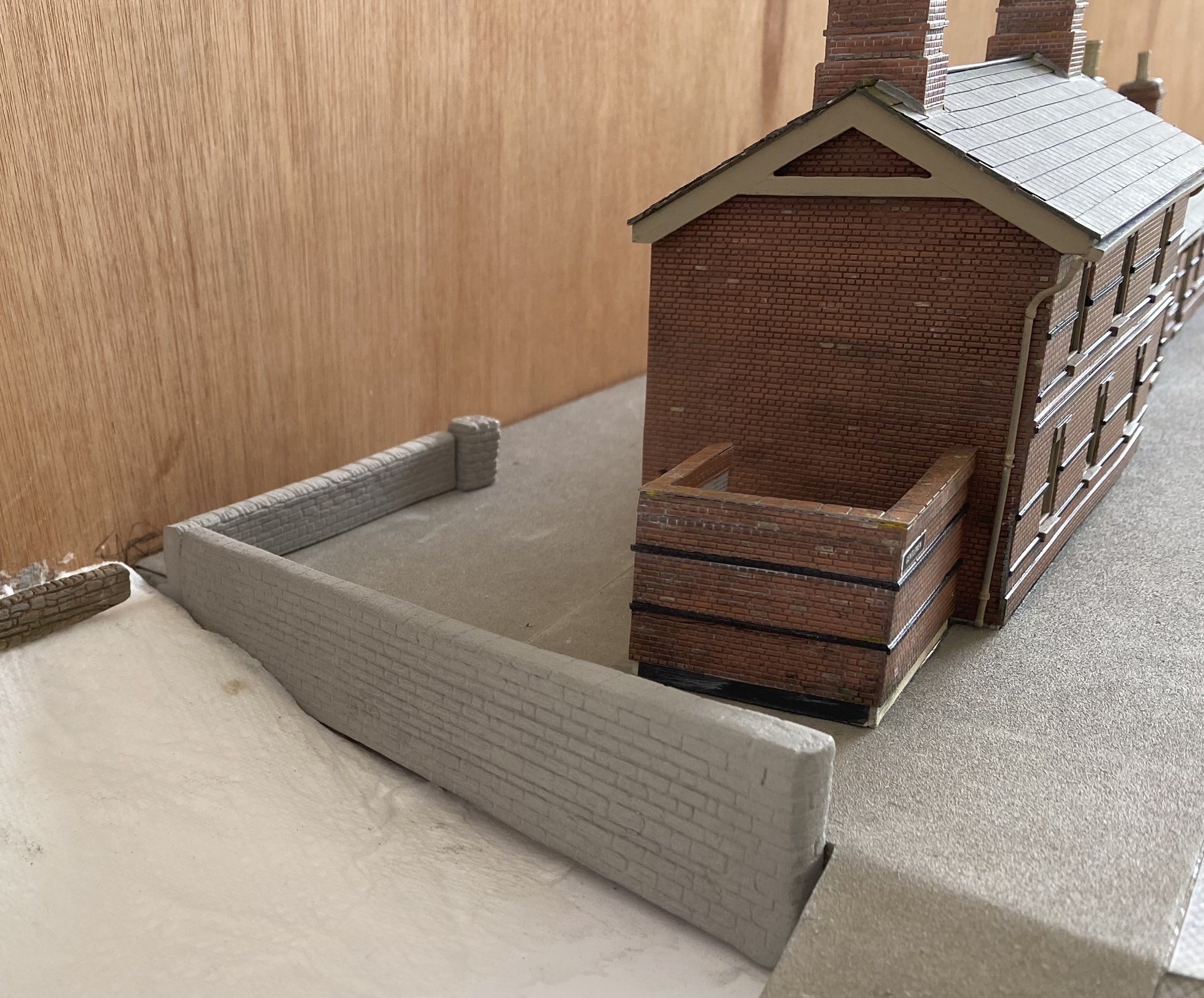

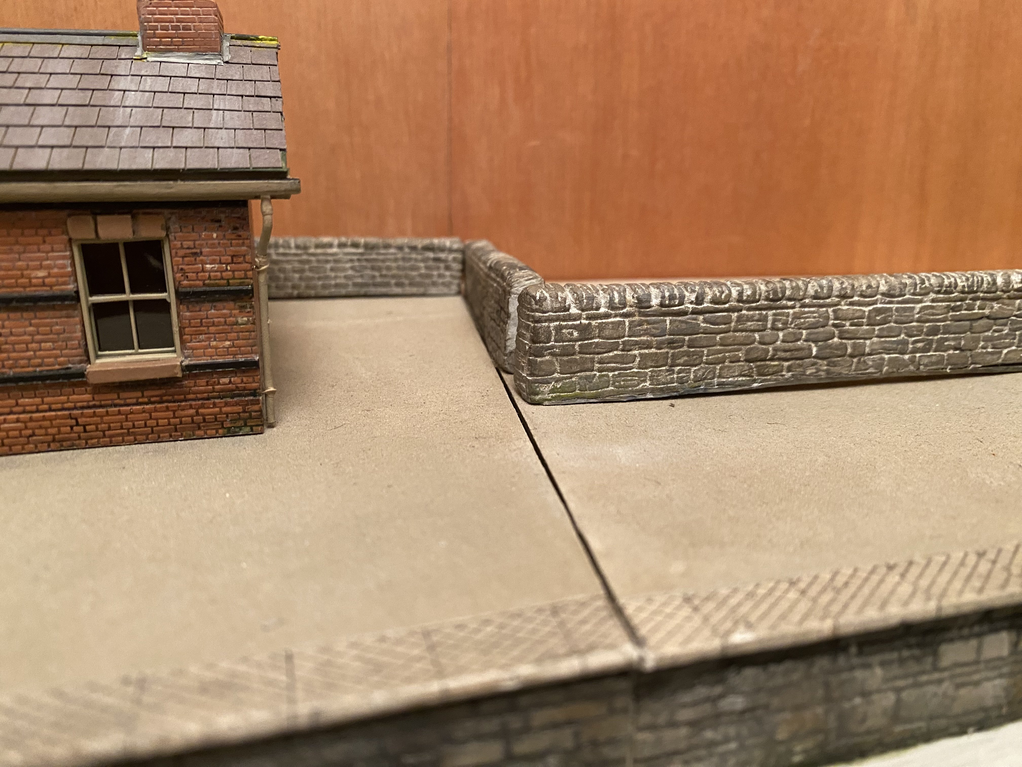

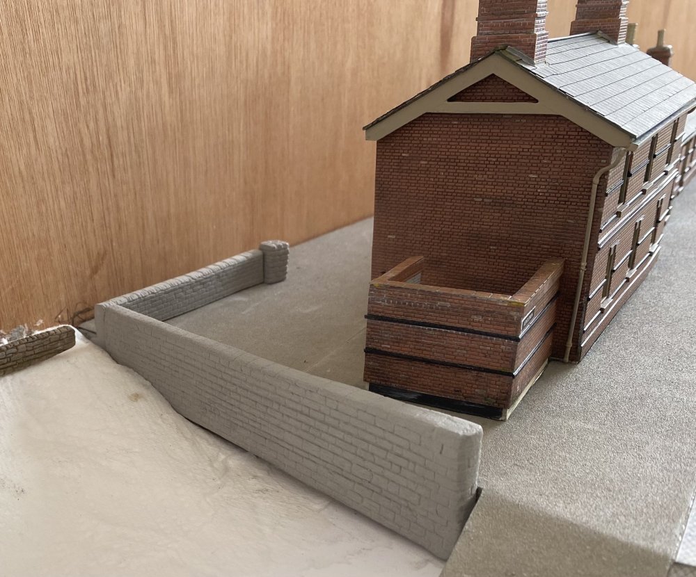

The station is getting some boundary walls too.
Shame about that seismic crack in the platform across the boards but it looks worse in the photo than it is in practice.
This station now has a name at last. Having rejected Ballymurry, Tulllygar, Crossfield, Dungrainey and Trainy McTrainface, I conducted a survey (well I consulted @Patrick Davey) and we decided on Kilmore, a real place, close to the route of the BCDR main line but without benefit of a station. Until now.
Alan
  • Like 10
  • WOW! 7
  • Funny 1
Always interesting to see layouts progress. Like the forced perspective and don't see why it shouldn't work - plus you can always control the viewing angles with strategically placed trees and bushes.
 Wondered why DAS had suddenly become hard to find😁😋😇
  • Funny 2
That's superb Alan. The stonewalling, overbridge, station building. I won't ask how long the walling has taken!
I like the way you are getting the landform in place before tracklaying. It's how we should do things to get that proper railway in the landscape look.
Thanks David. I find that scribing the walls can be quite relaxing in its way. With a bit of music in the background, I can get lost in it for hours on end. It's usually cramp in my right shoulder that stops me 😄  Railway in landscape...  I've had a mental image from the beginning of how I wanted this one to look - a rural BCDR station and there are (were) plenty of examples to inspire that. The challenge is to get as close to that image as possible! As to the order of doing things, it's always a bit of a compromise in my experience. It was easier, for example to paint the bridge and the walls on the bench before adding them to the layout but it's then tricky to keep them pristine as the scenery gets built up and painted around them. Clingfilm and masking tape to the fore!
Edited by Tullygrainey
  • Like 5
I understand what you mean about the relaxing thing Alan. My 'job' like that is painting the track, sleepers and rails. I love it! I get some music on, and get in a 'flow'. I love the instant transformation you get from trainset track to model railway, just with some rusty red and dirty brown! Mind, I cannot stand ballasting. I hate that task. But I have a pal who thinks it is very relaxing.... each to their own!
You've already captured the railway in the landscape look to a tee. I think having that metal picture of how it should look is half the battle. Transforming a 2D plan, to a 3D picture is something that I've struggled with, and a reason I've abandoned layouts in the past.
Keep the updates coming 🙂

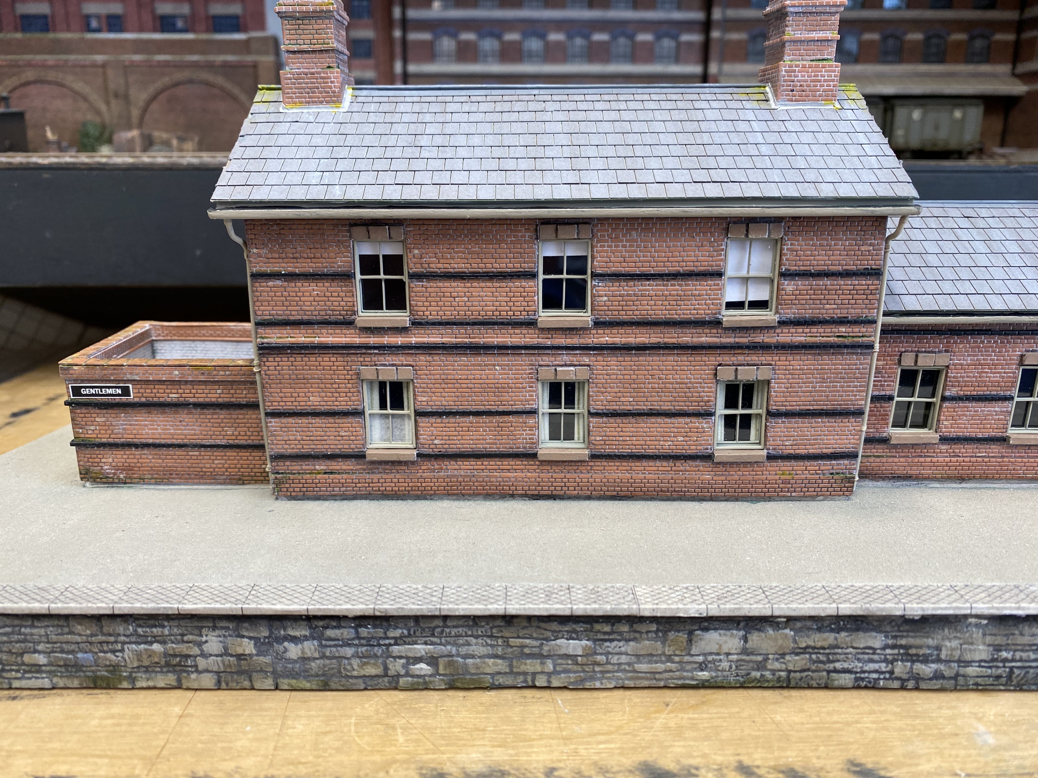

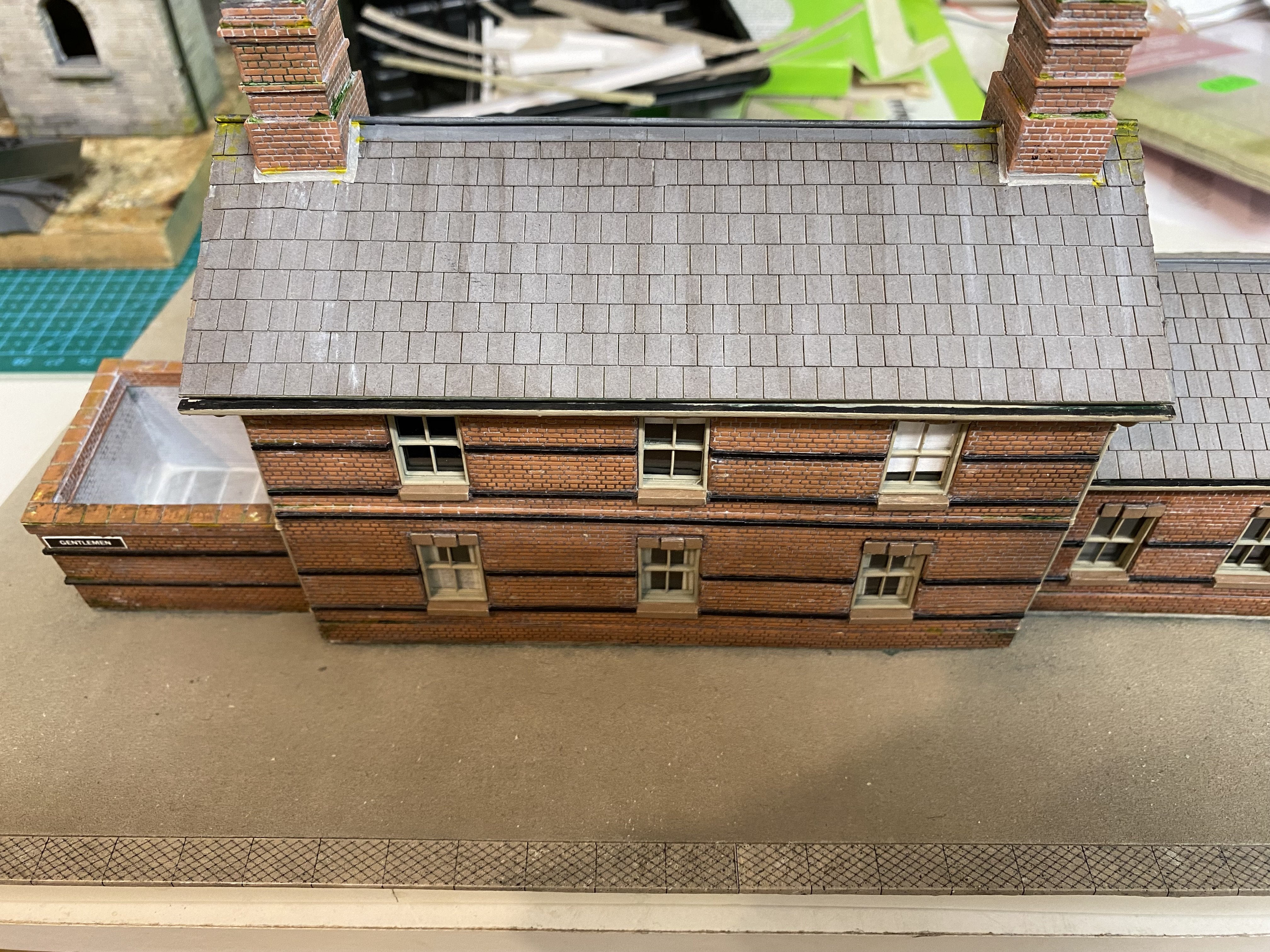

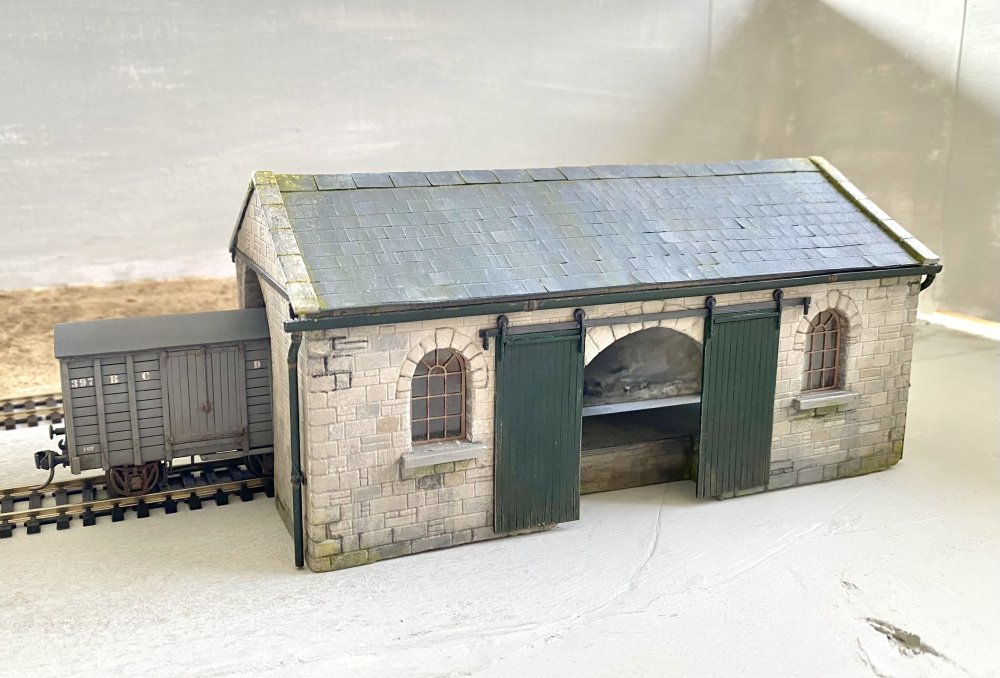

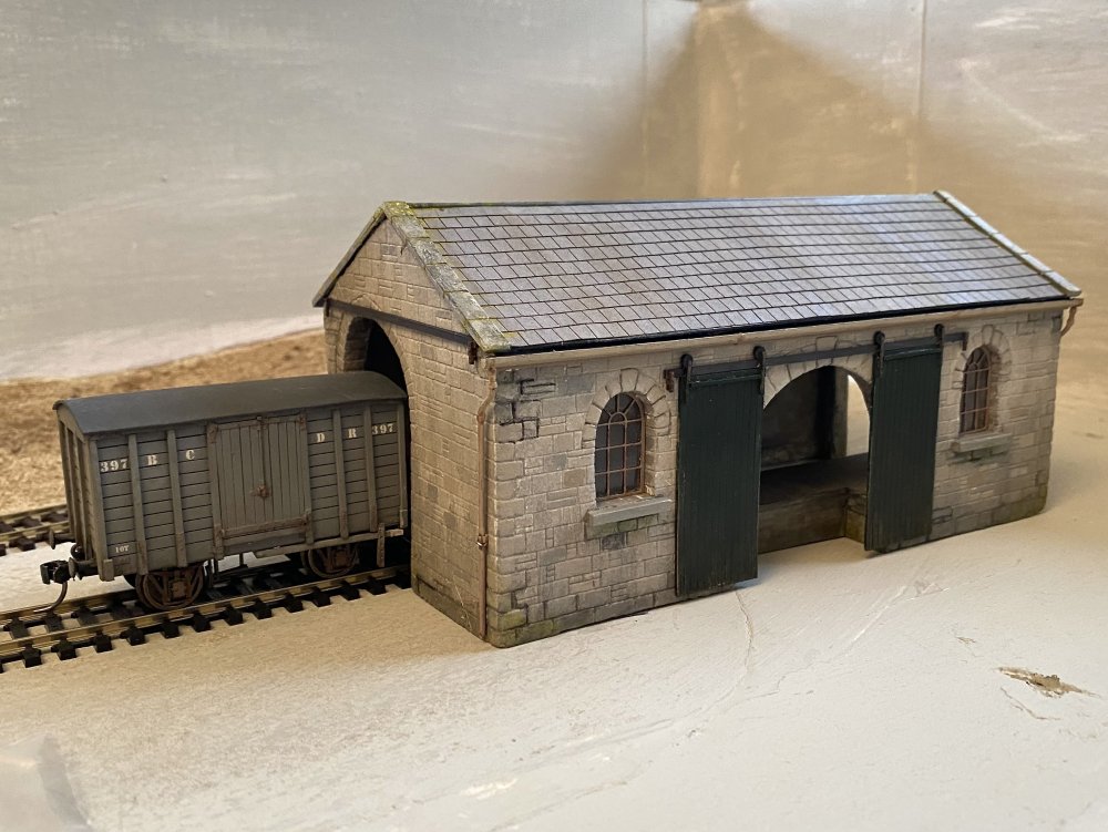

Since finishing the Kilmore goods shed I've not been entirely happy with it and it took me a while to figure out what was bothering me. Goods sheds are big but this one seemed out of scale with the other buildings on the emerging layout. I finally realised that the roofing slates were too large (see the last post above)  - in 4mm, about the size of dinner tables! The guttering and downpipes were also over-scale. Essentially what I'd done was make a small building in 7mm/ft rather than a large building in 4mm/ft.  Re-roofing and re-guttering have improved things significantly I think.
  • Like 13
  • WOW! 3
Safe to say we all liked the first version, Alan...
Interesting to compare the two pictures. Is the roof slates material slightly thicker this time? The slates seem a little more defined. Likewise the ridge, while painting the downpipes a lighter colour makes them stand out less.
 Either way, enlarging the photo to study all this shows more detail and it is just sublime! The lichen on those coping stones is wonderful and the building oozes life.
  • Agree 1
Thank you David. Sometimes it's better to leave things as they are but the niggles about this one just wouldn't go away.
The original roof was done with hand cut strips of light card. The new one is built up with ready made laser-cut strips from York Modelmaking. Not sure what material it's made from but it's flexible and tough and yes,  it is probably thicker than the card I used before and certainly more regular in appearance. It's also self adhesive and takes paint readily. To simulate the ridge tiles, I glued a length of 1mm brass rod along the ridge and butted strips of the York Modelmaking stuff up tight against it on both sides.
I replaced the gutters and downpipes with smaller diameter rod and changed the colour to match the station building. The lichen was done with artist's acrylic, titanium white and cadmium yellow, applied with a fine brush and also the tip of a cocktail stick.
Alan
  • Informative 2

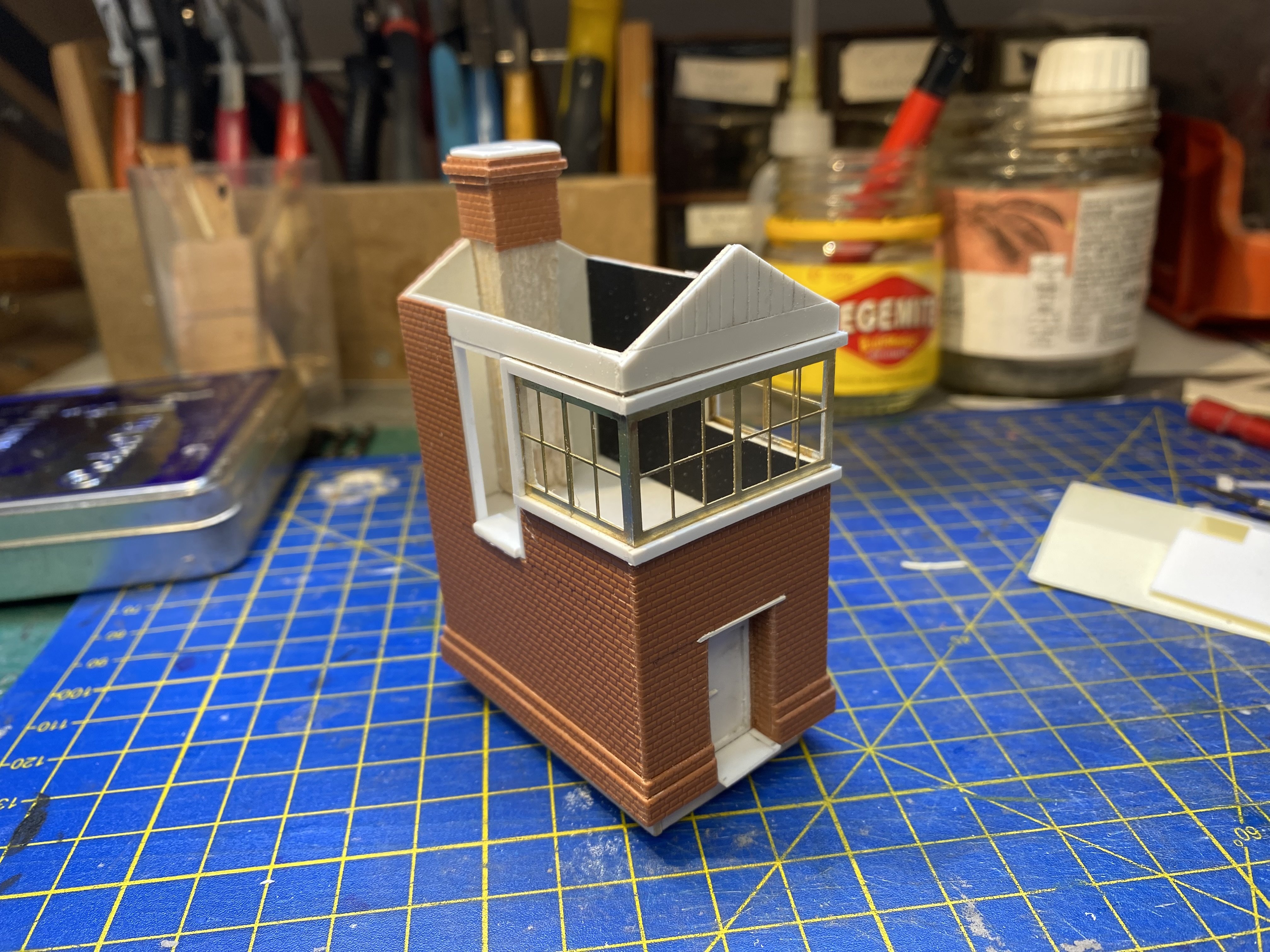

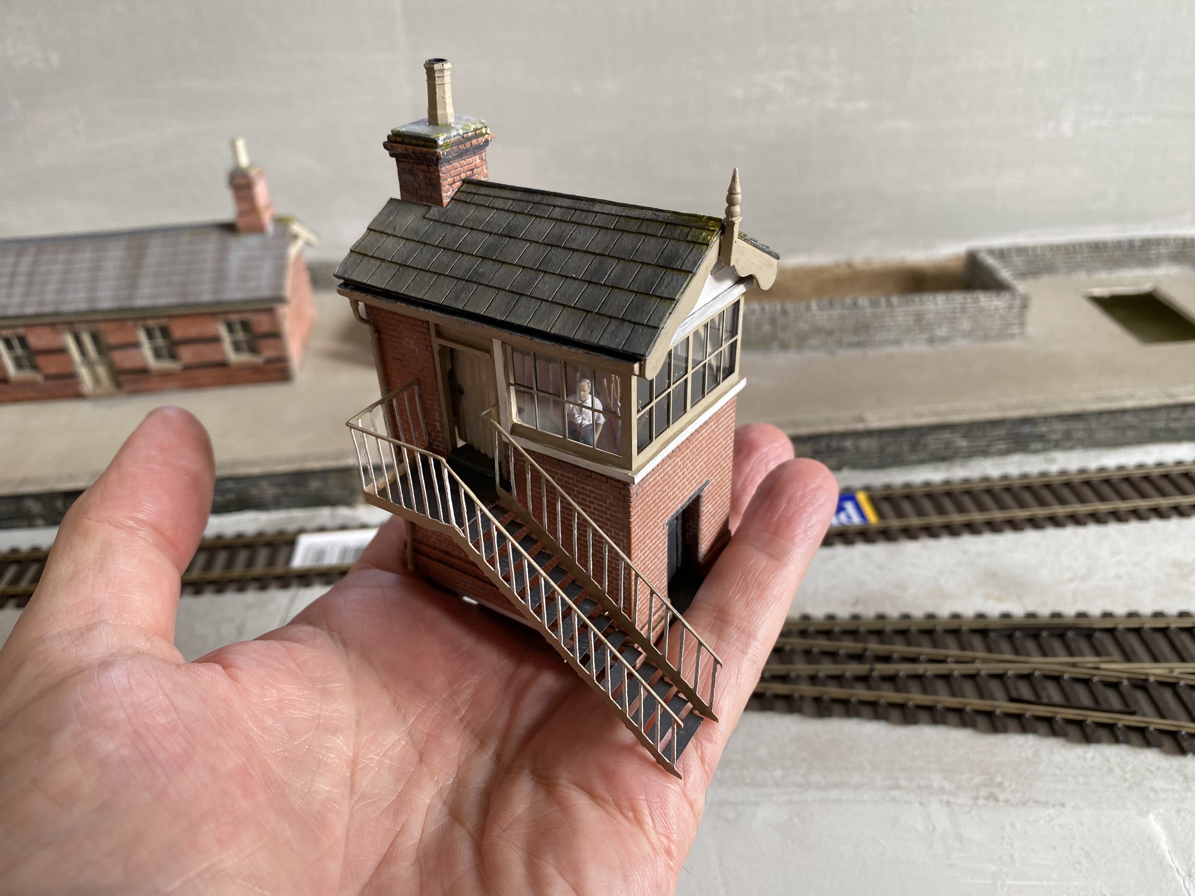

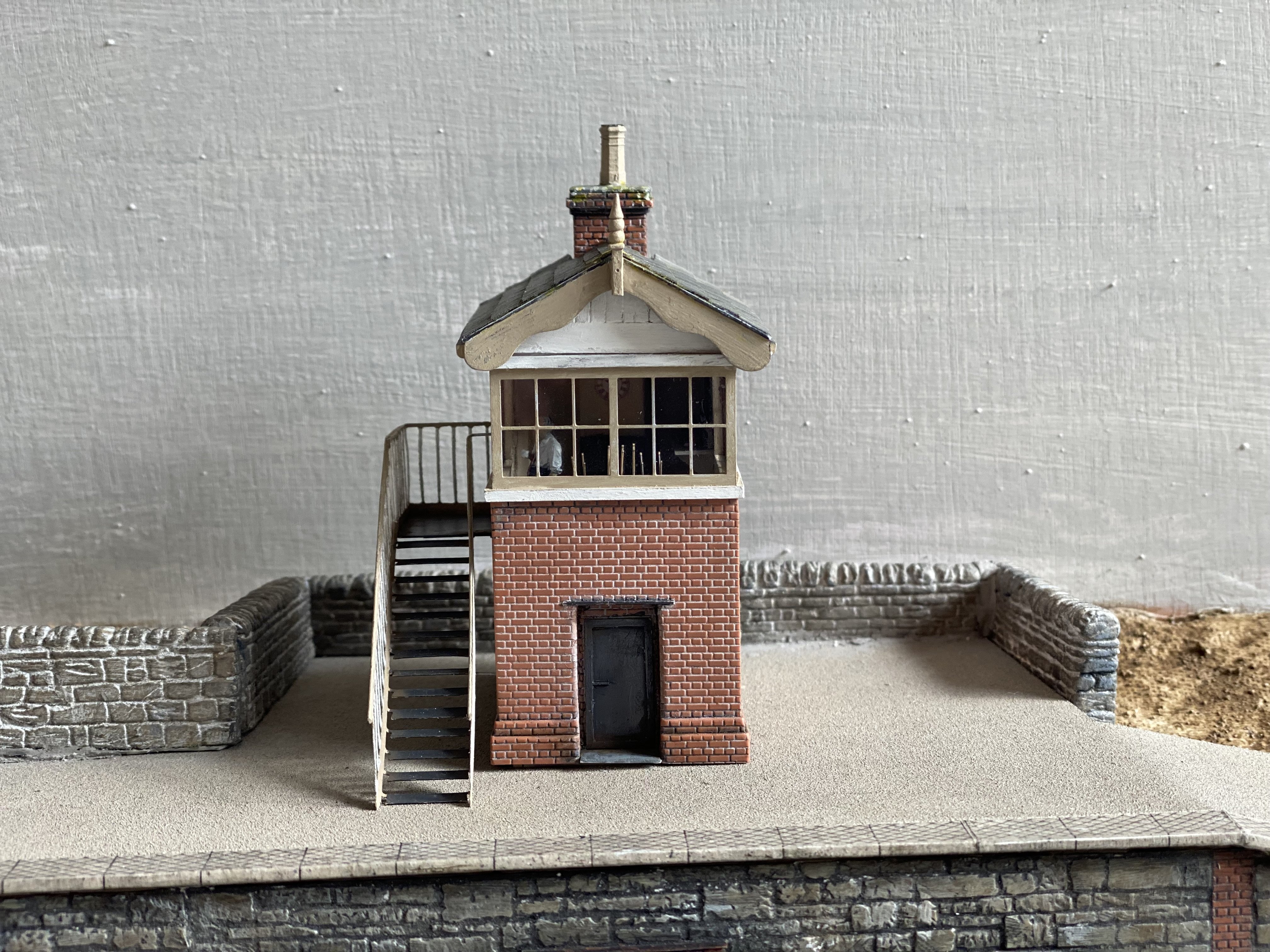

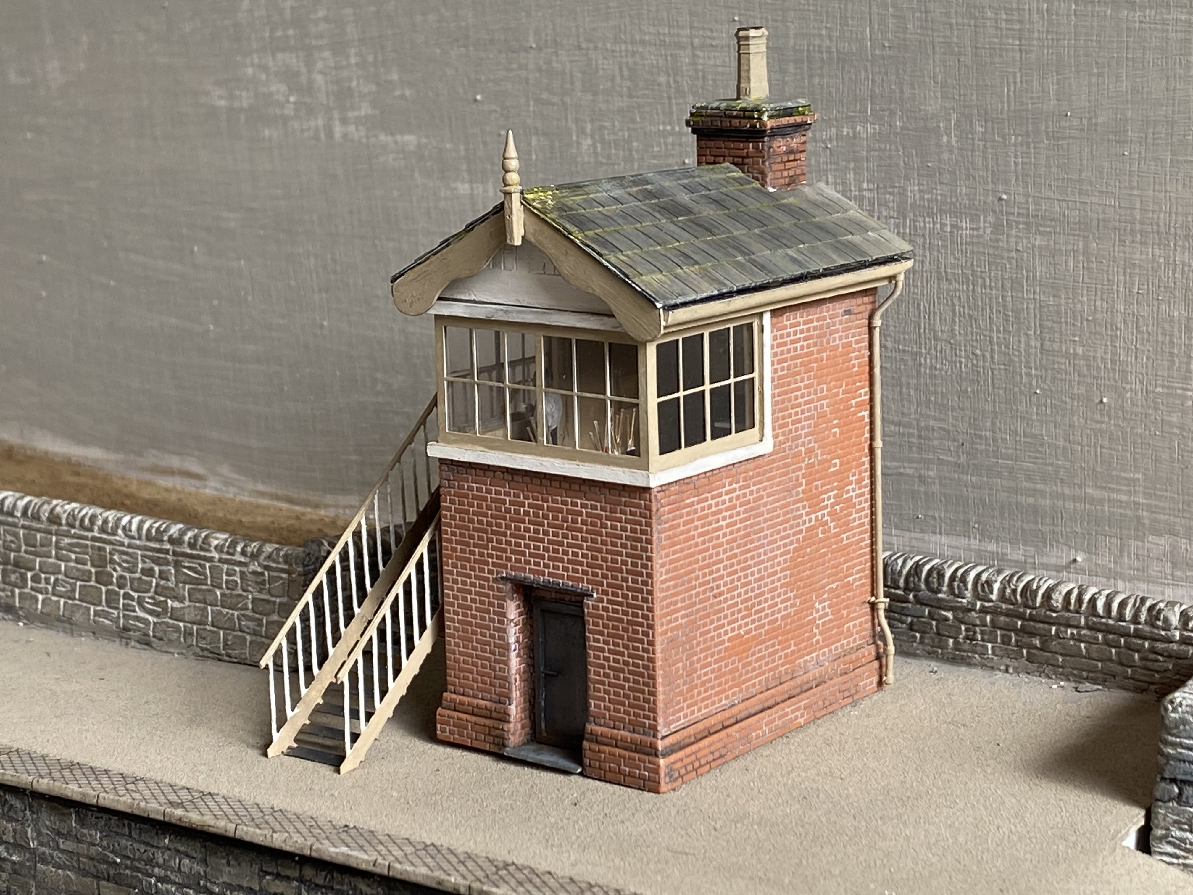

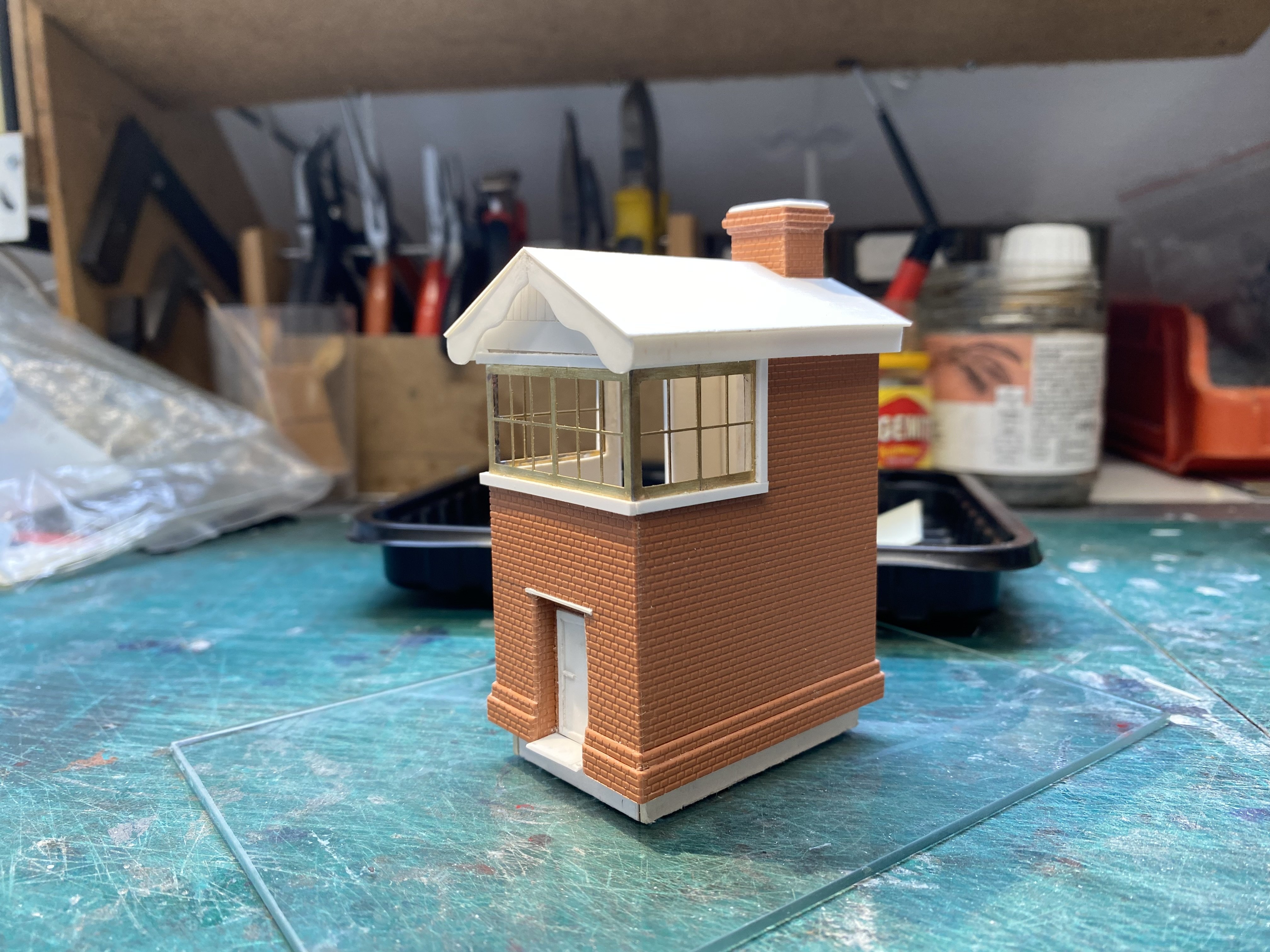

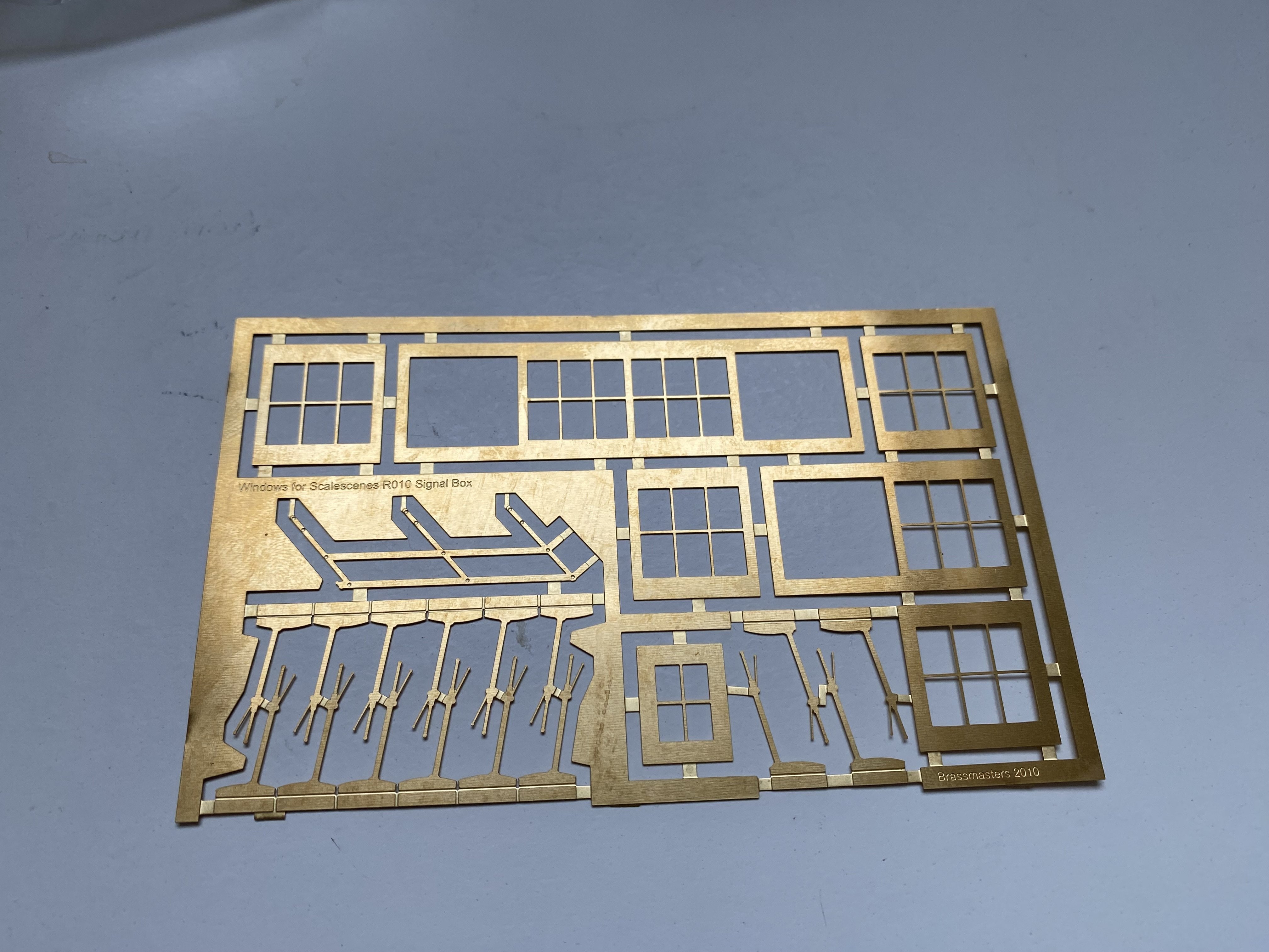

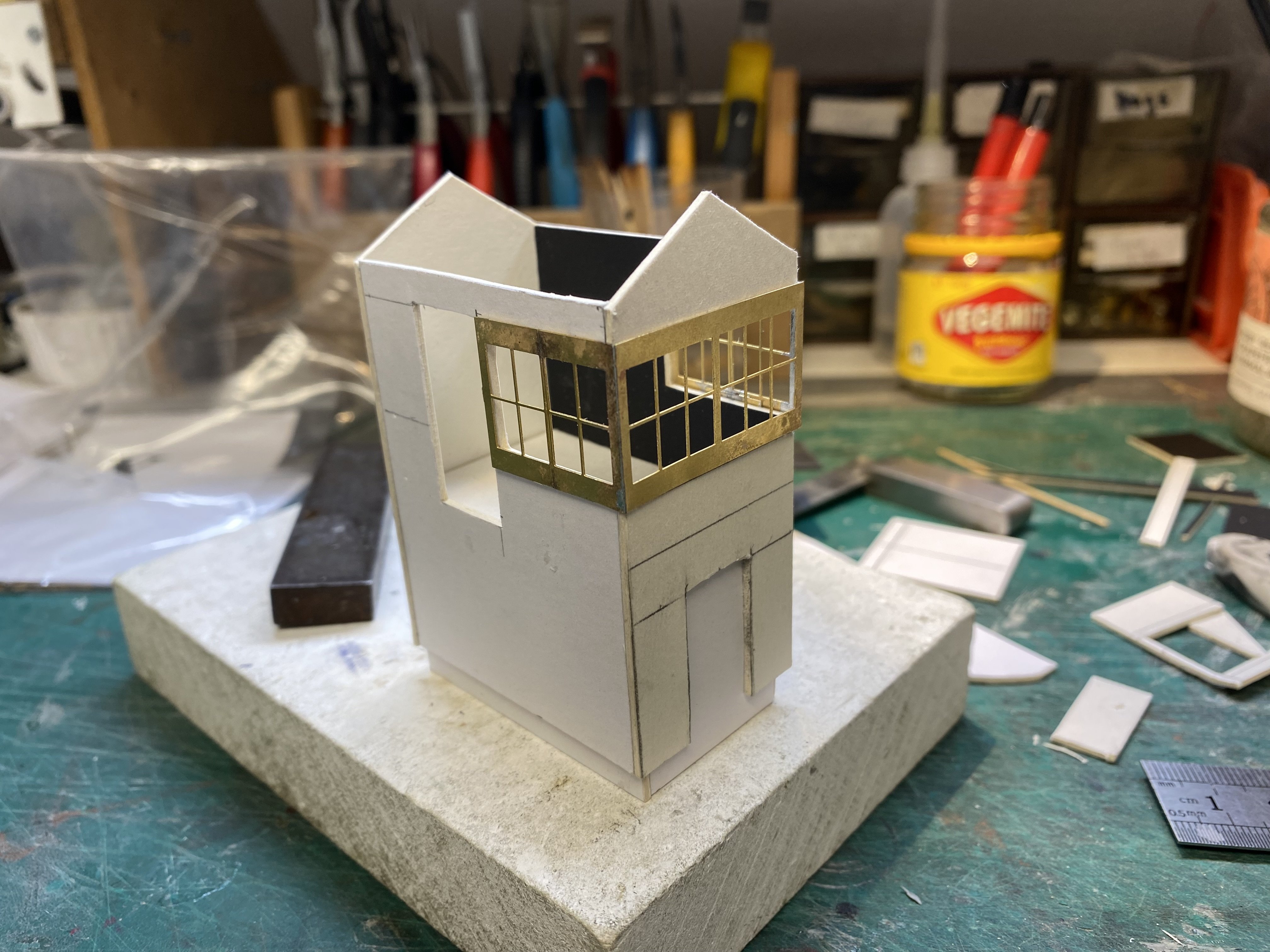

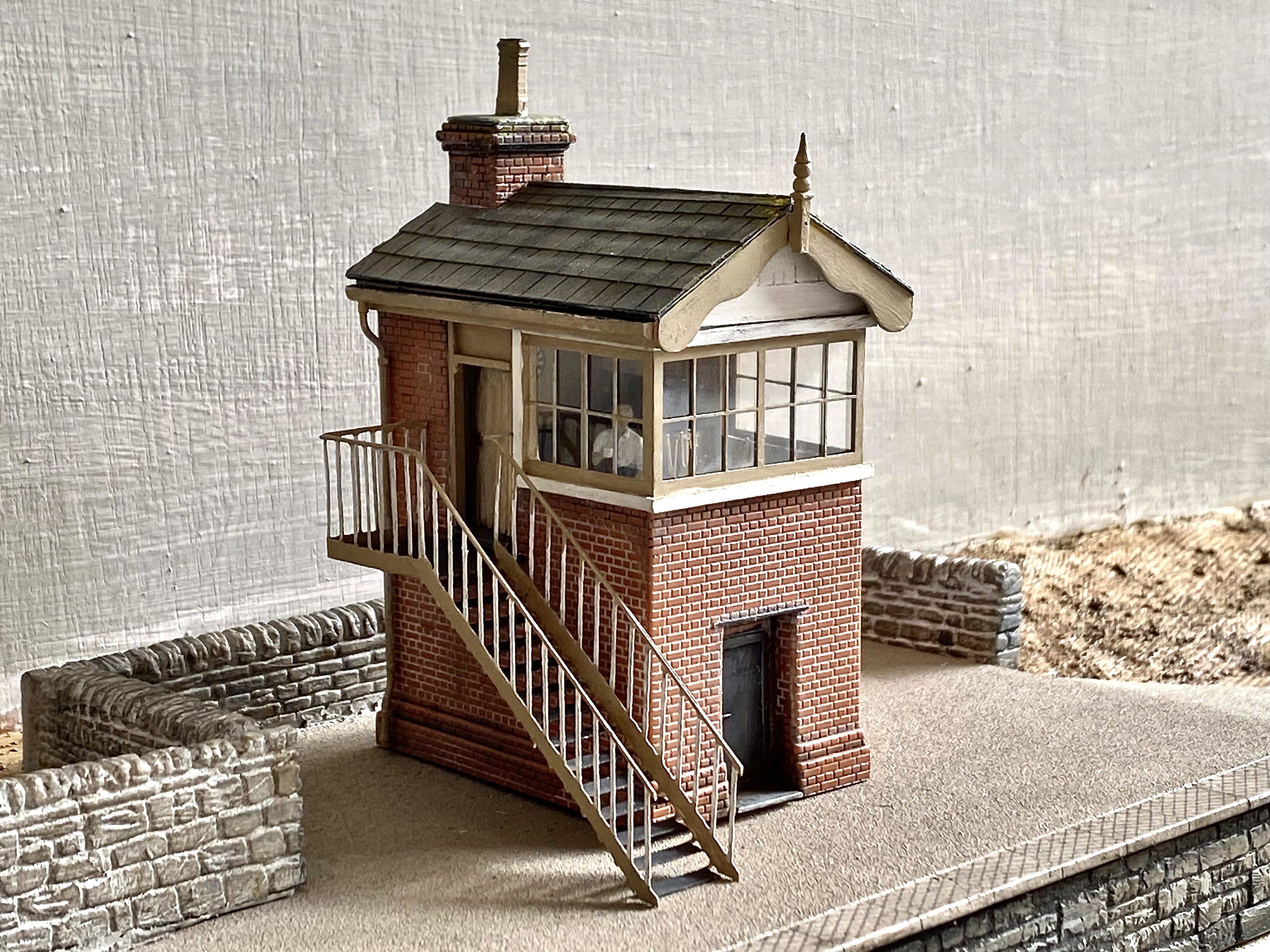

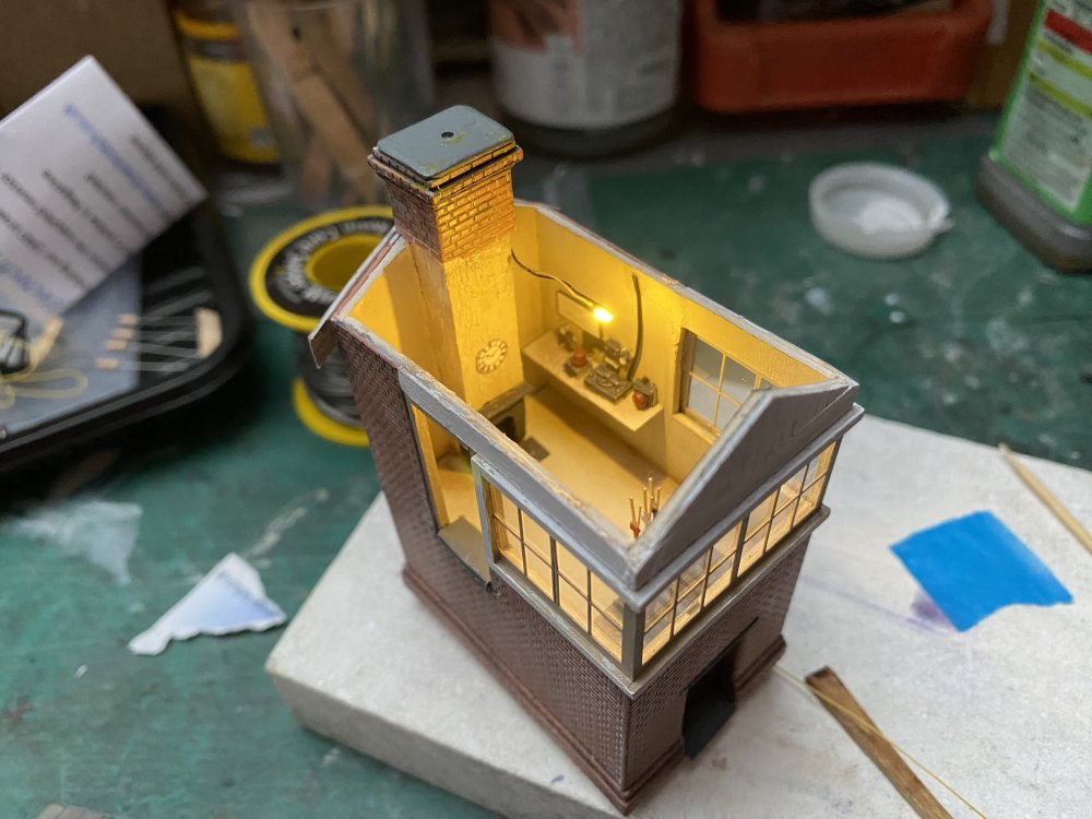

 Tullymurry was a small station on the BCDR main line a short distance from Newcastle. Its signal cabin was compact and unusually (uniquely?), built gable end on to the line. I used it as the guide for this signal cabin for Kilmore. Having never built one before, I studied form at @Patrick Davey's Brookhall Mill and Clogherhead. Thanks Patrick.
Construction is mainly embossed plastic card over a mounting board carcass with some etched brass providing bits that would be difficult to make from scratch. An etch from London Road Models provided the basis of some window frames after a bit of cut and shut.

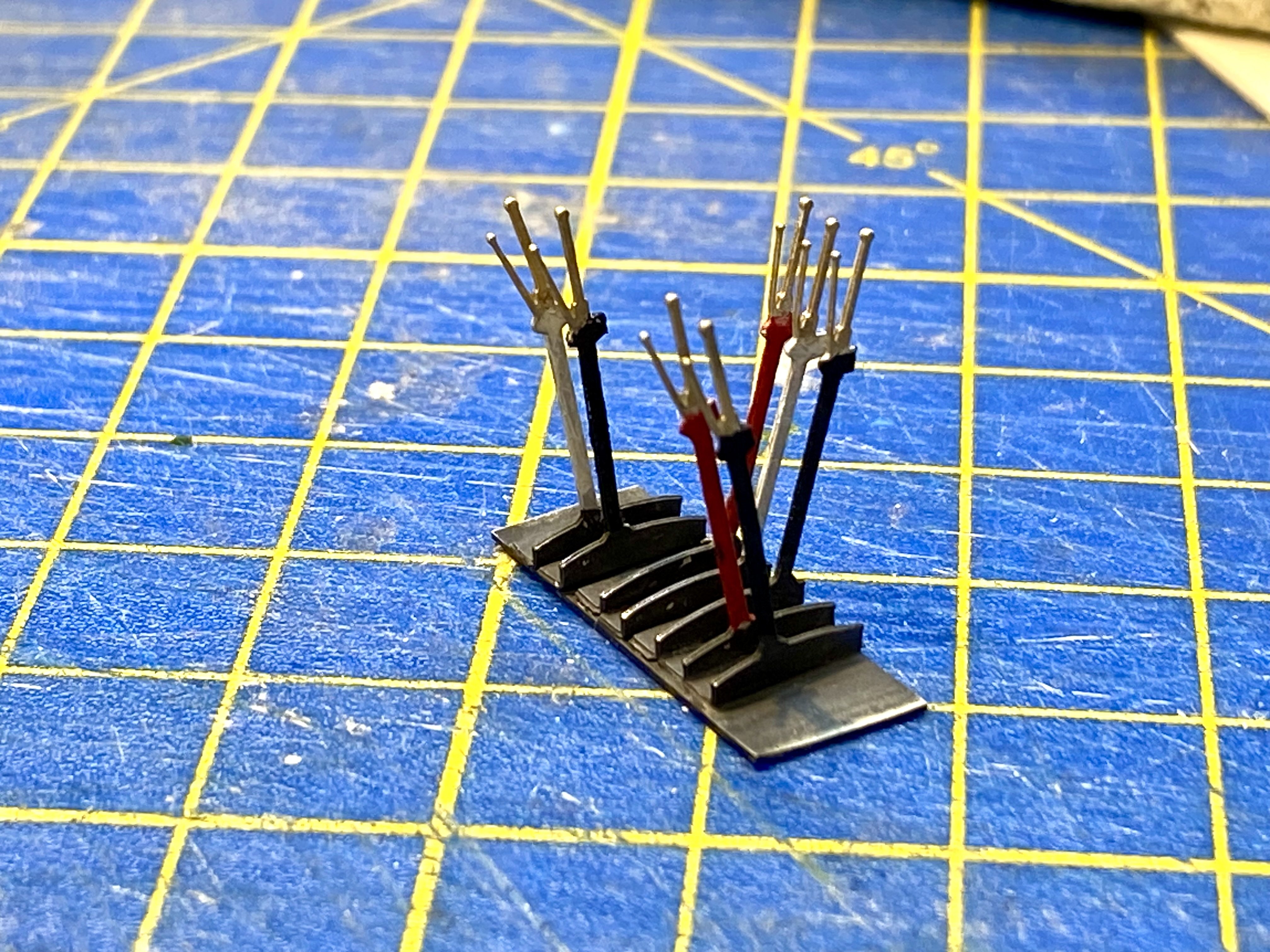

The London Road Models etch also provided the bits for the lever frame...

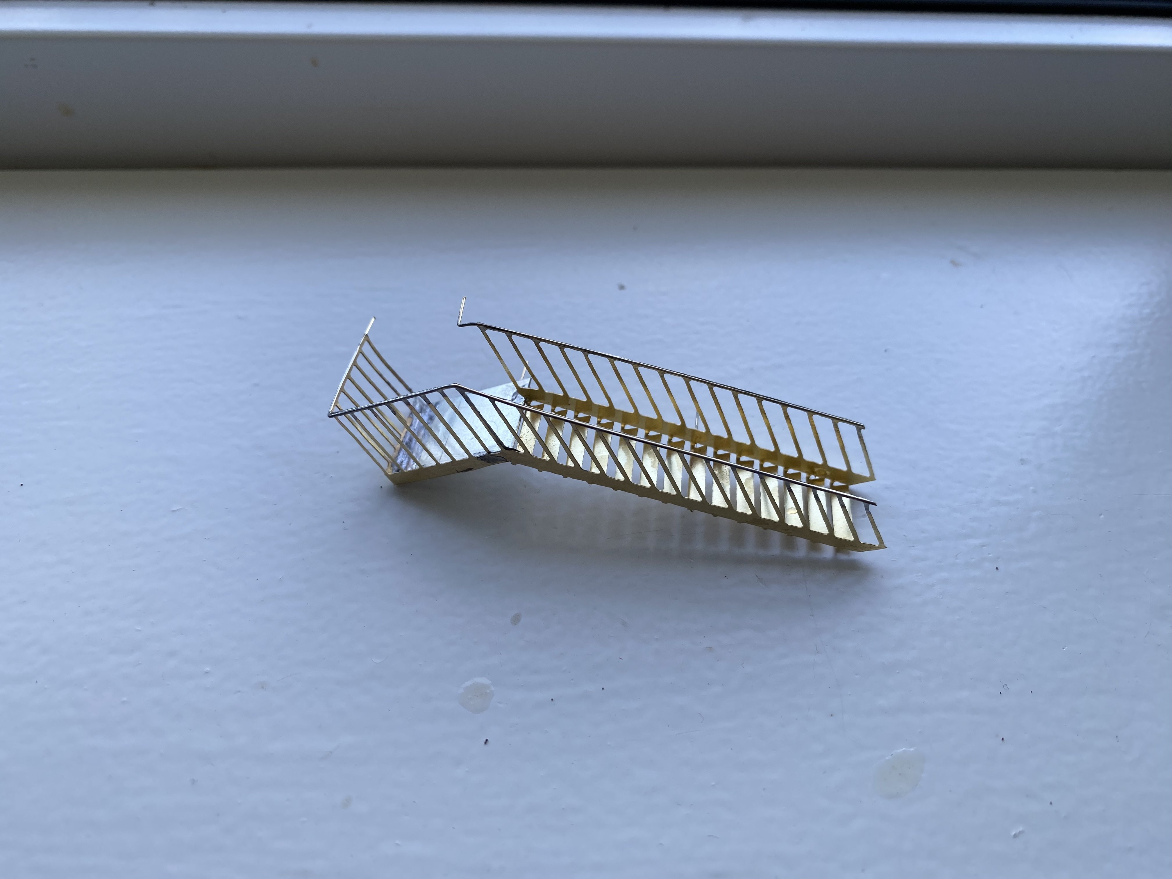

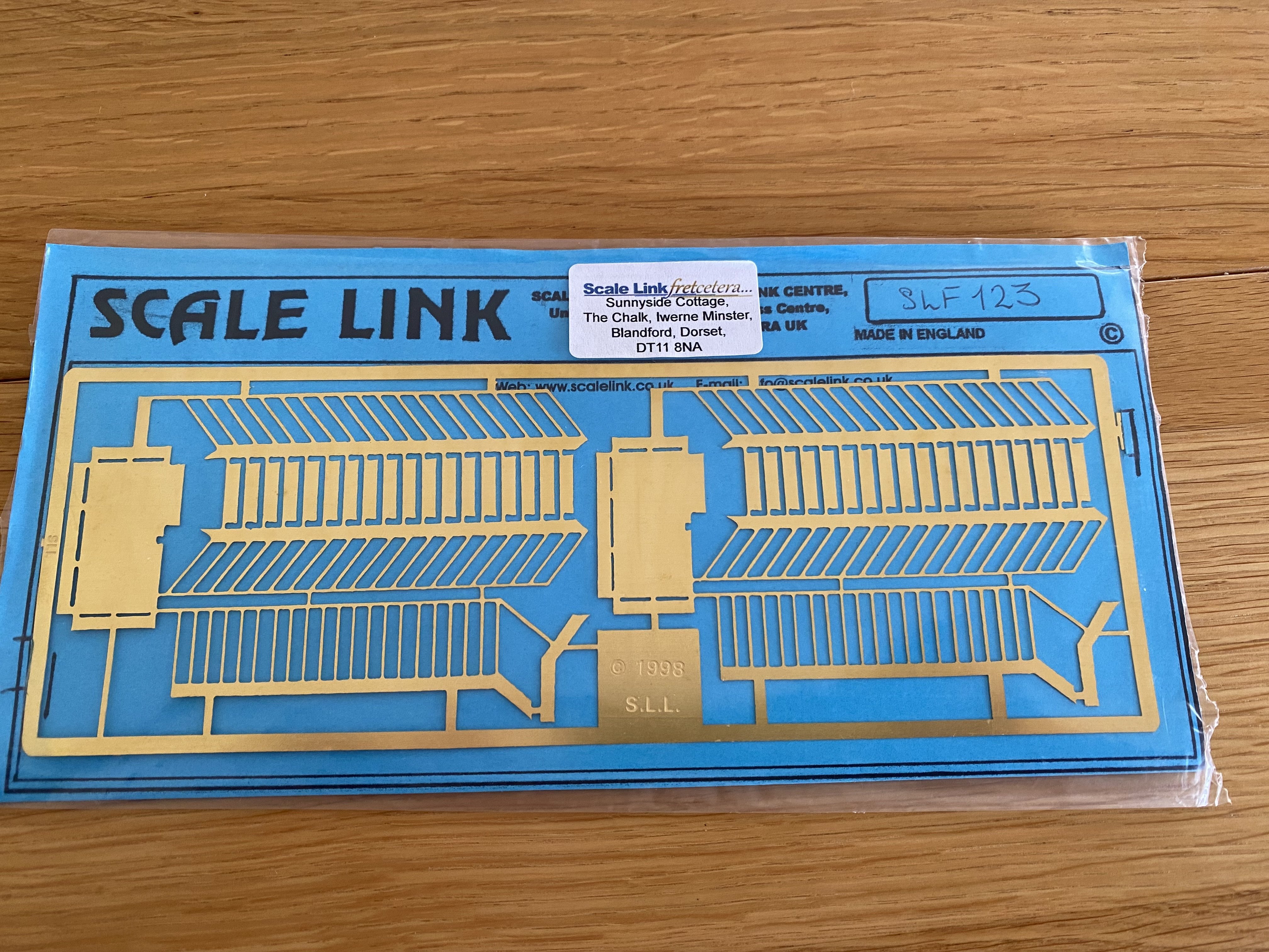

... and an etch from Scalelink Fretcetera gave me some outside steps. Can't imagine trying to make these from scratch.

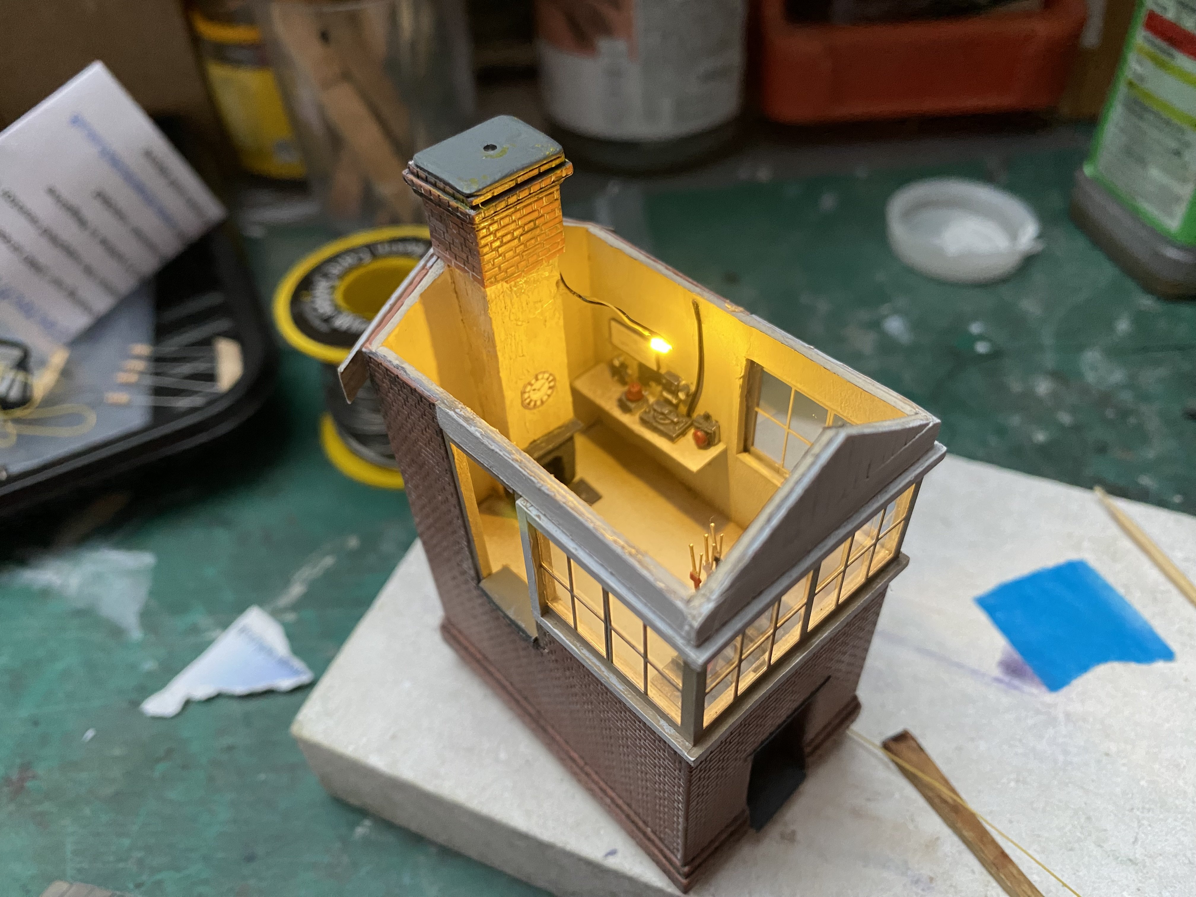

Signal cabins really need at least a semblance of internal detail and this is my semblance. Don't look too closely at all the gubbins on that shelf. I've no idea what they are except that they were left over from one of Patrick's signal cabin builds. He wasn't sure what they were either but they look the part. From a distance. The tiny LED isn't as yellow as it looks in the pic.

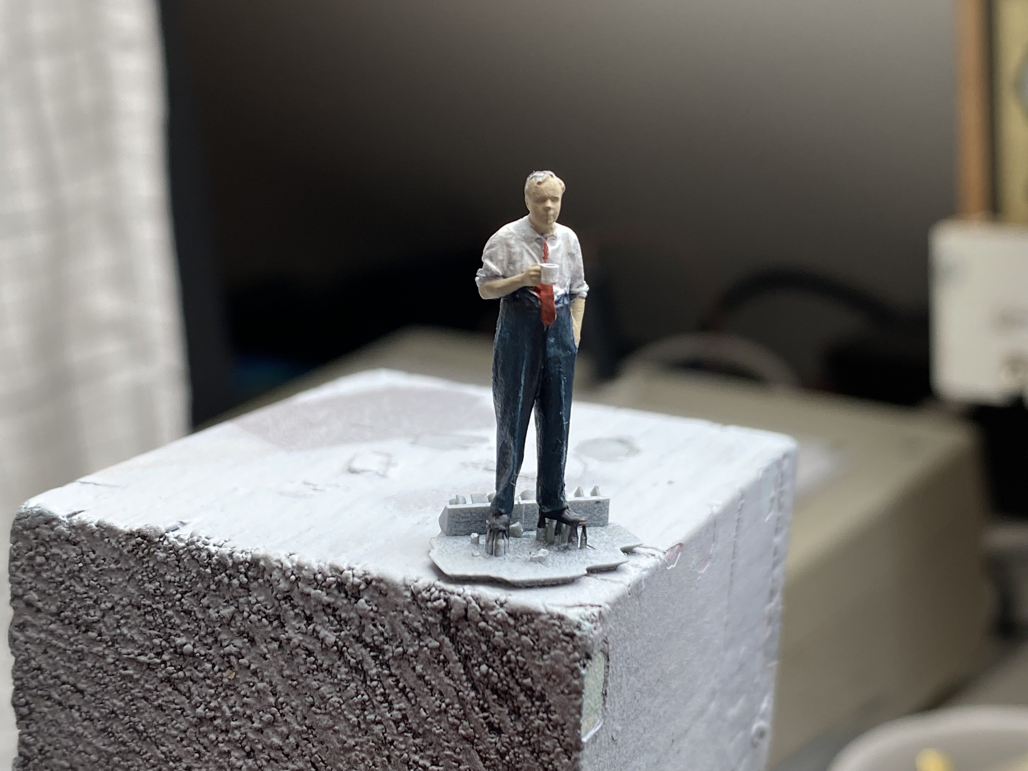

Signalman from ModelU. I think he borrowed the tie from that bloke who's always in the news.
And just about done.
This thing is minuscule!

6 minutes ago, Patrick Davey said:
Really looks the part Alan!!  Does the signalman have a name? He looks a bit distant…….
He's a home bird really.
