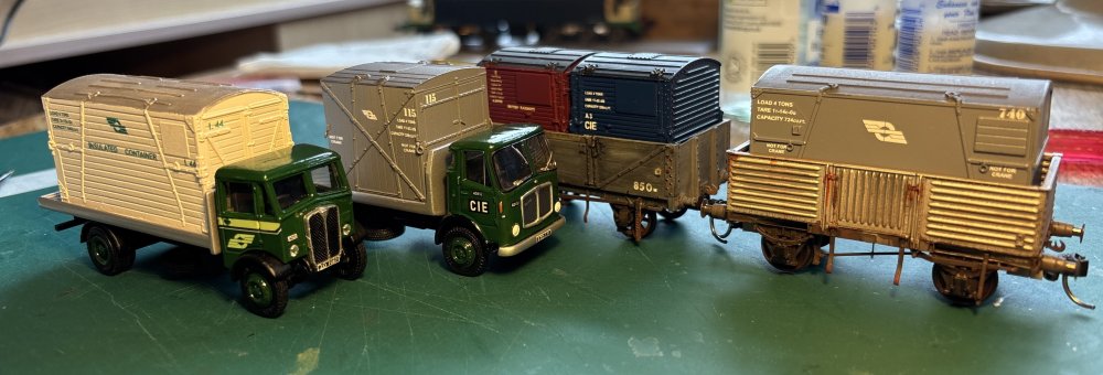

My custom transfers arrived so I thought I'd take a break from the E class and decorate some boxes.
Work in progress. Containers by @Arran at C=Rail, most modified to some extent, and custom transfers by Precision Decals.
The MOL transfers are from C=Rail and the CIE roundels are from Railtec. This was the custom sheet:
  • Like 5
