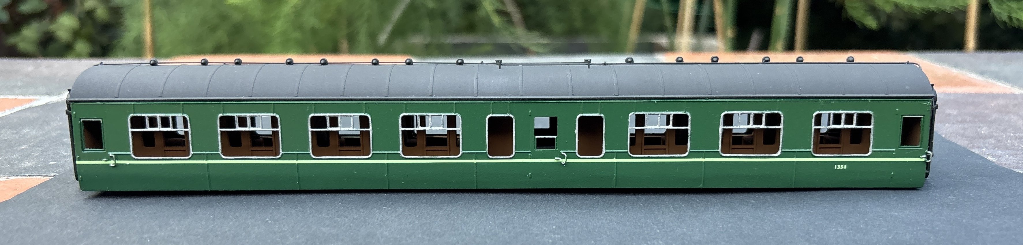

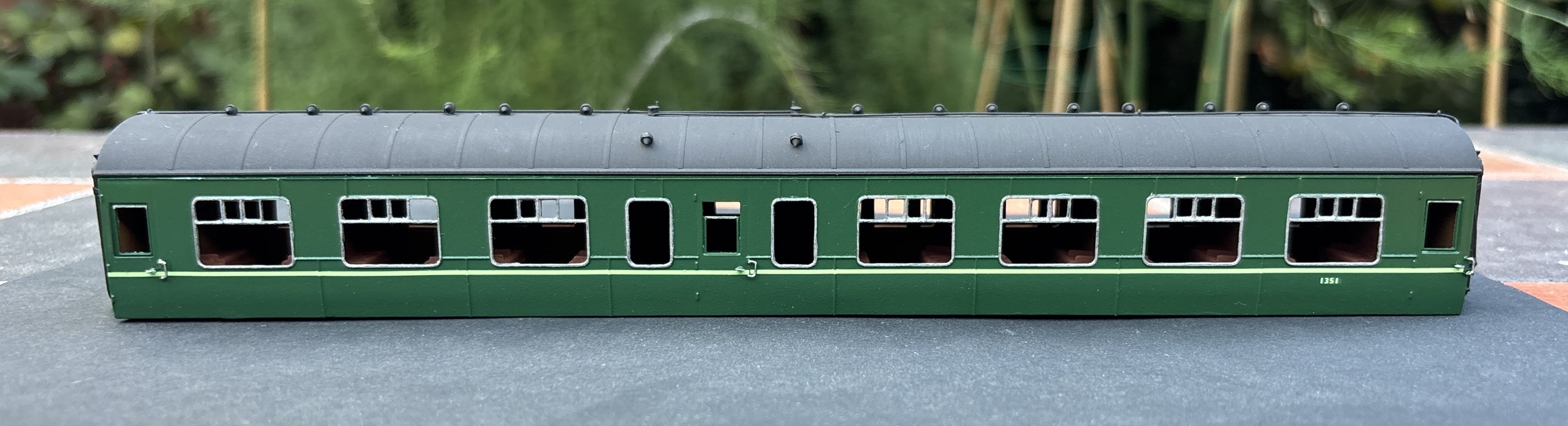

Mol_PMB Posted August 26 Author Posted August 26 The LMS coach conversion with JM Design sides is gradually progressing but there are some frustrations. I’ll get this finished but I’m not sure I’ll do another this way. I had hoped the Pareto principle would apply - to get a coach 80% right for 20% of the effort, but I think I’m going to end up putting in more than 80% of the effort. Would be better to make it all in metal and I may try applying the next set of JM sides to a Comet kit instead. Still, it’s useful experience of the challenges of multi-media constructions. I’m off to Downpatrick for the long weekend, might see some of you there. When I get back I will try and make progress on the second build of the GSWR 50’ coach (including writing the instructions) and the AEC Railcar drawings. But I do have a rather full diary this autumn so please bear with me - I need this to be a hobby not a chore. 12

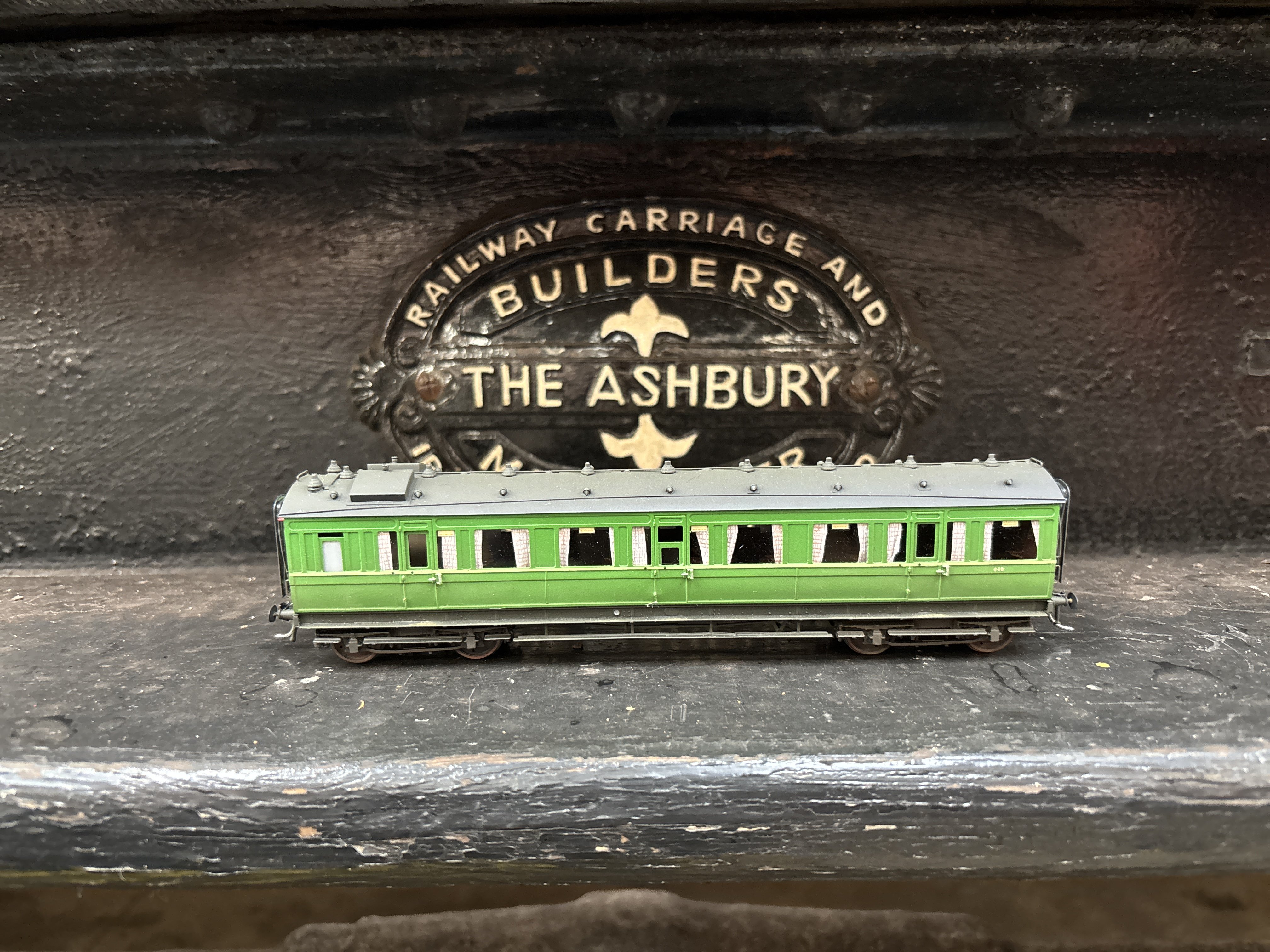

jhb171achill Posted August 30 Posted August 30 (edited) Was delighted to see Mol_PMB’s GSWR coach in the flesh at Downpatrick yesterday. To say this is a work of art doesn’t even do it justice. This is seriously high-end exhibition standard. Edited August 30 by jhb171achill 14 1 1
Mol_PMB Posted August 30 Author Posted August 30 Many thanks JB - you are too kind. I’ve had another wonderful day at Downpatrick seeing more than I had imagined would be possible. The AEC project has seen a boost with a close inspection of 6111. 12
