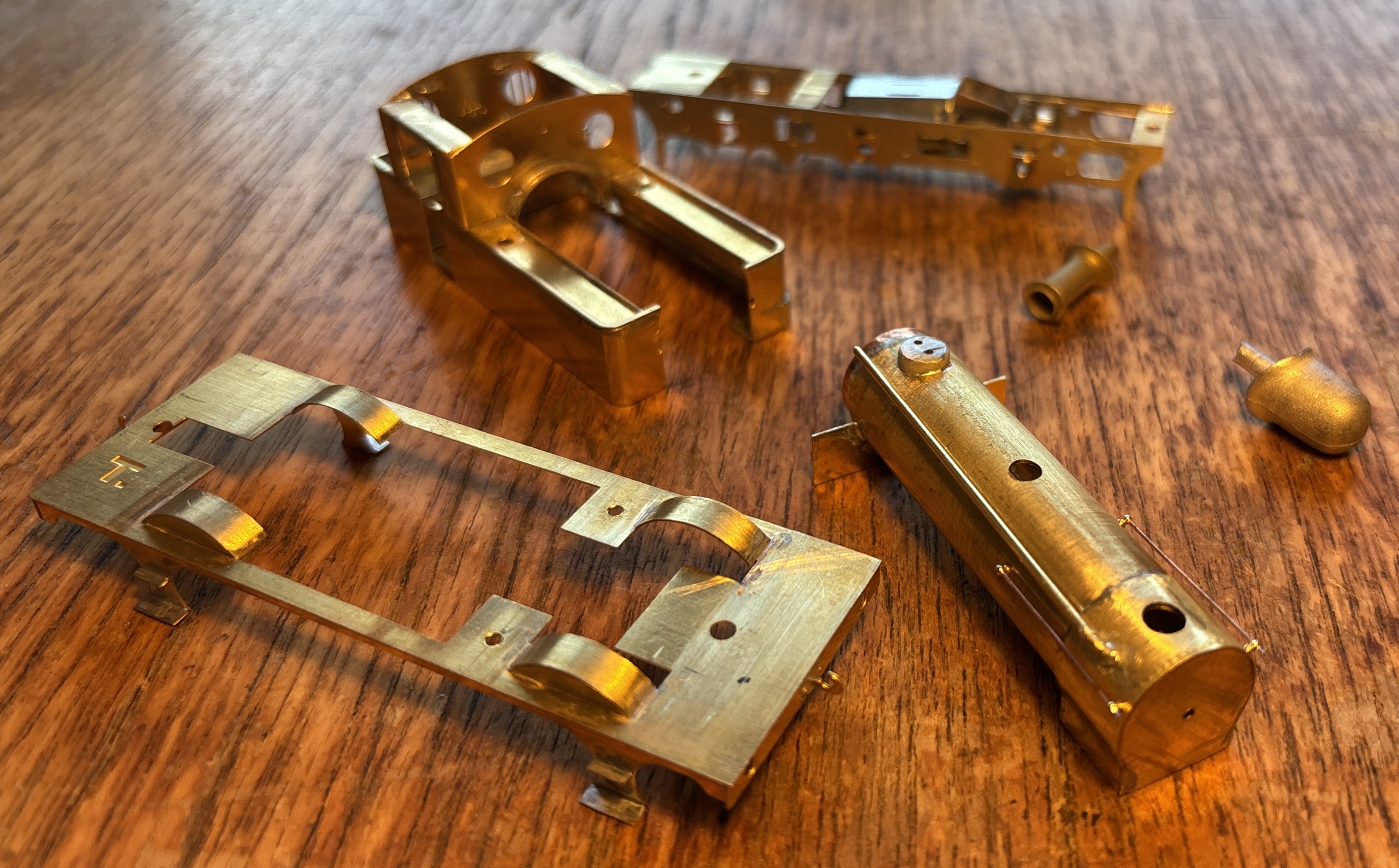

Mol_PMB Posted April 19 Author Posted April 19 Slow progress today but I’m gradually populating the details. I need to get some short Ross Pop safety valves for this loco, but can’t find any for sale. Might have to make my own from bits of brass rod, tube and tiny washers. I have a couple of sets of Markits tall ones, but I want to save those for the G2 and J15 for which they are correct. I have a very busy week ahead so there won’t be much modelling time. 9 7

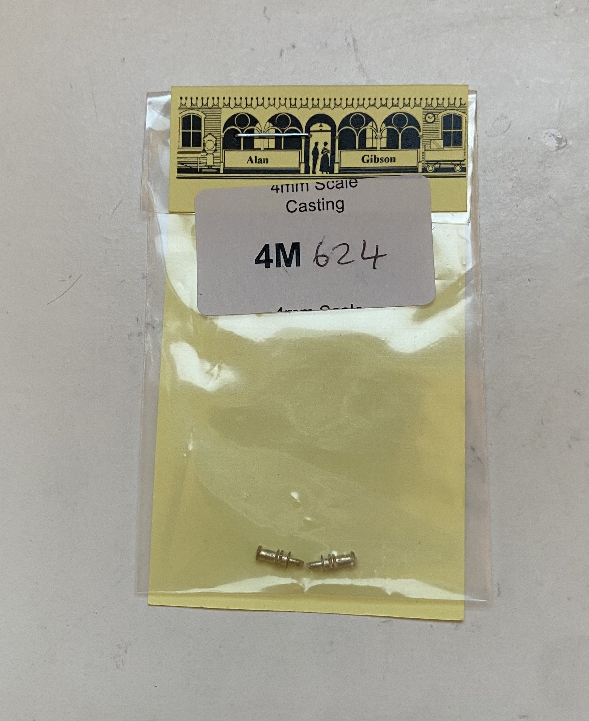

Tullygrainey Posted April 19 Posted April 19 Very tidy Paul and great attention to detail. Ross pop valves do seem to be hard to come by. I had a small collection pillaged from second hand Hornby 0-4-0 Smokey Joes and the like but I've used them all up now. These from A Gibson aren't quite right but might be usable with work though it might be just as easy to make some from scratch as you suggest! 1
Mol_PMB Posted April 19 Author Posted April 19 8 minutes ago, Tullygrainey said: Very tidy Paul and great attention to detail. Ross pop valves do seem to be hard to come by. I had a small collection pillaged from second hand Hornby 0-4-0 Smokey Joes and the like but I've used them all up now. These from A Gibson aren't quite right but might be usable with work though it might be just as easy to make some from scratch as you suggest! Many thanks, that's a good tip. 557 and 560 had tall Ross Pops, but my prototype 559 had short ones. In fact I think there were several types used on the class, and their appearance also varied according to which type of bonnet was fitted. Having made the fittings for the vacuum ejector exhaust pipe from bits of rod, tube and M1 brass washers, I think I could have a go at making a couple of short safety valves the same way. 1

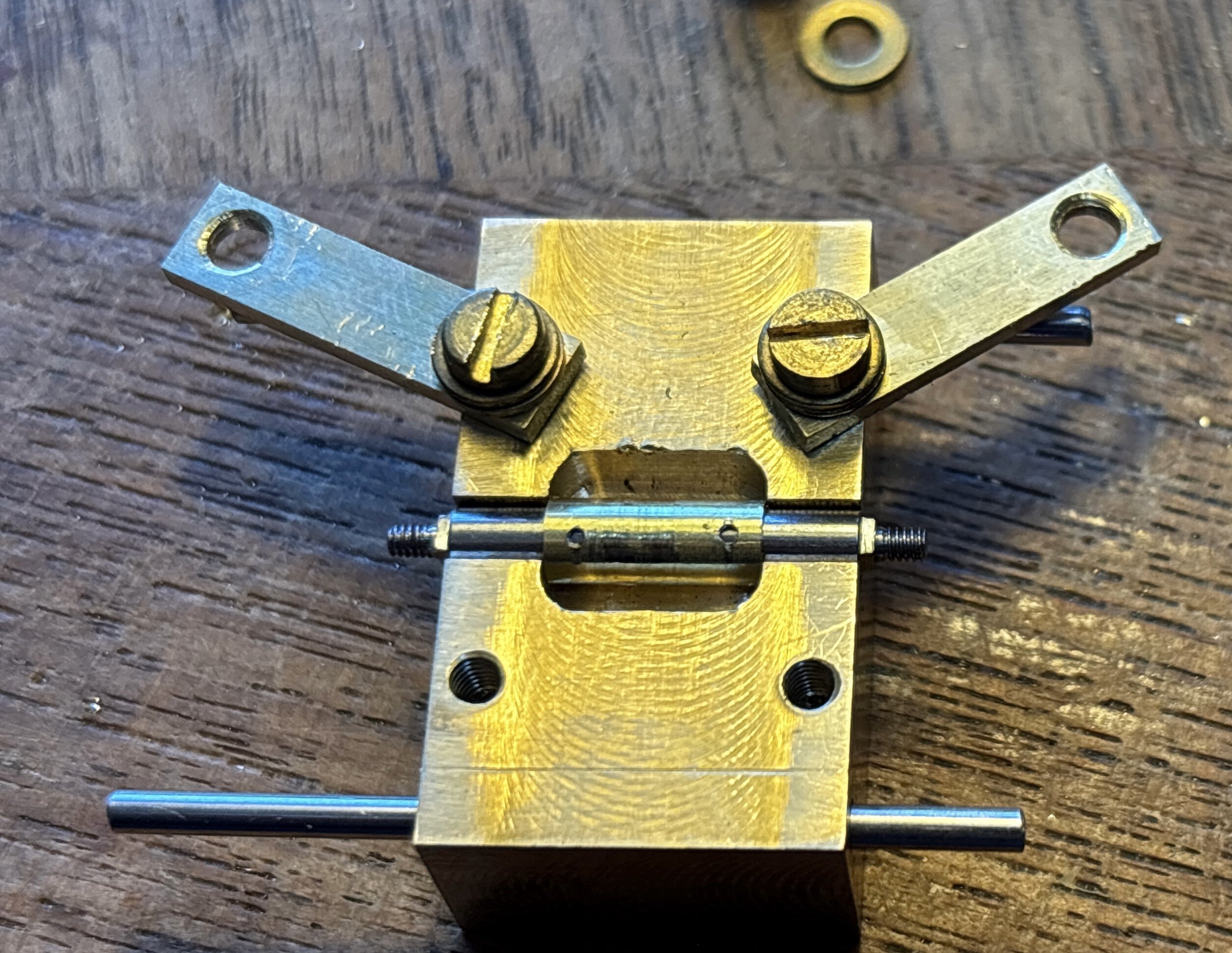

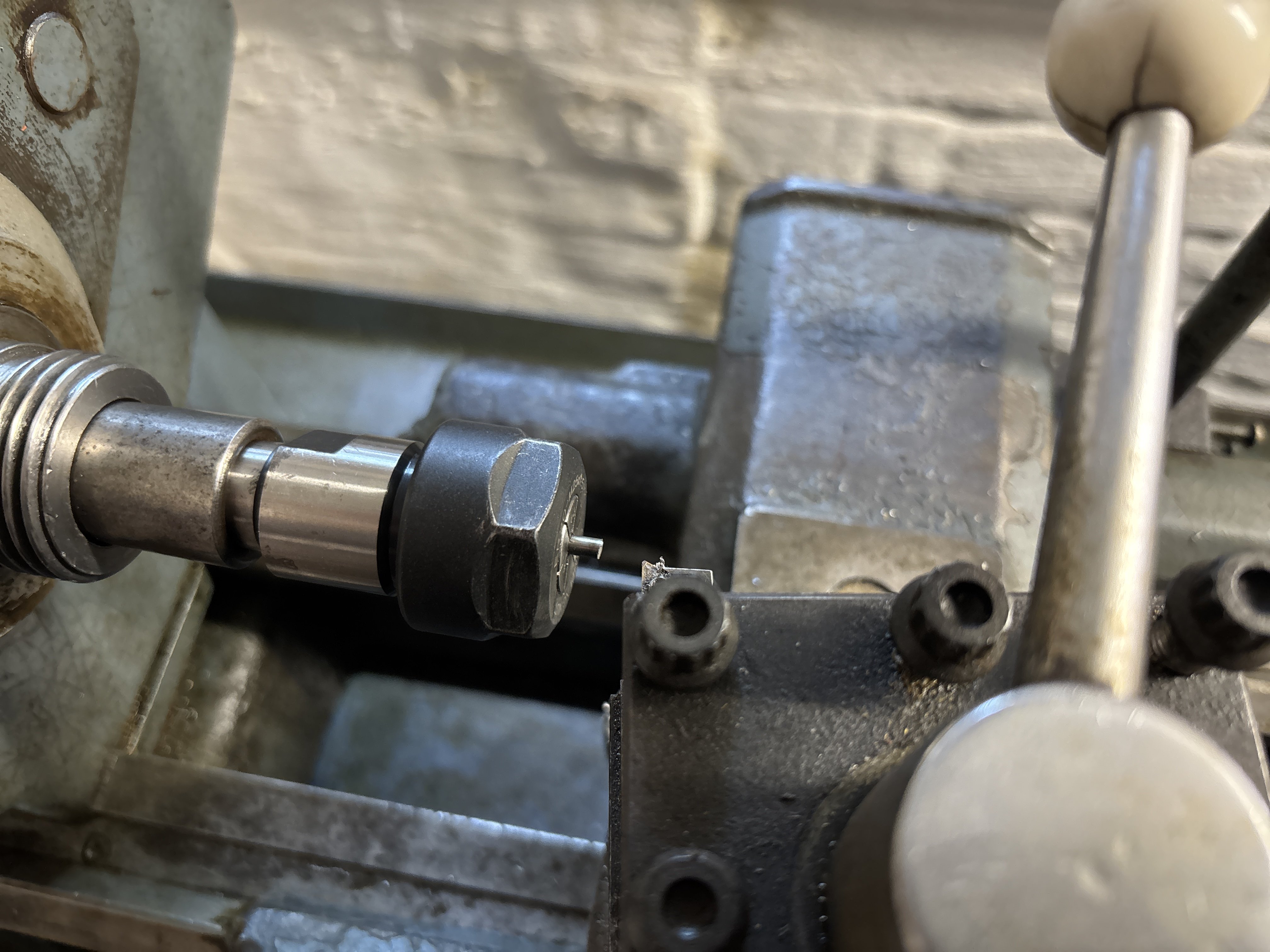

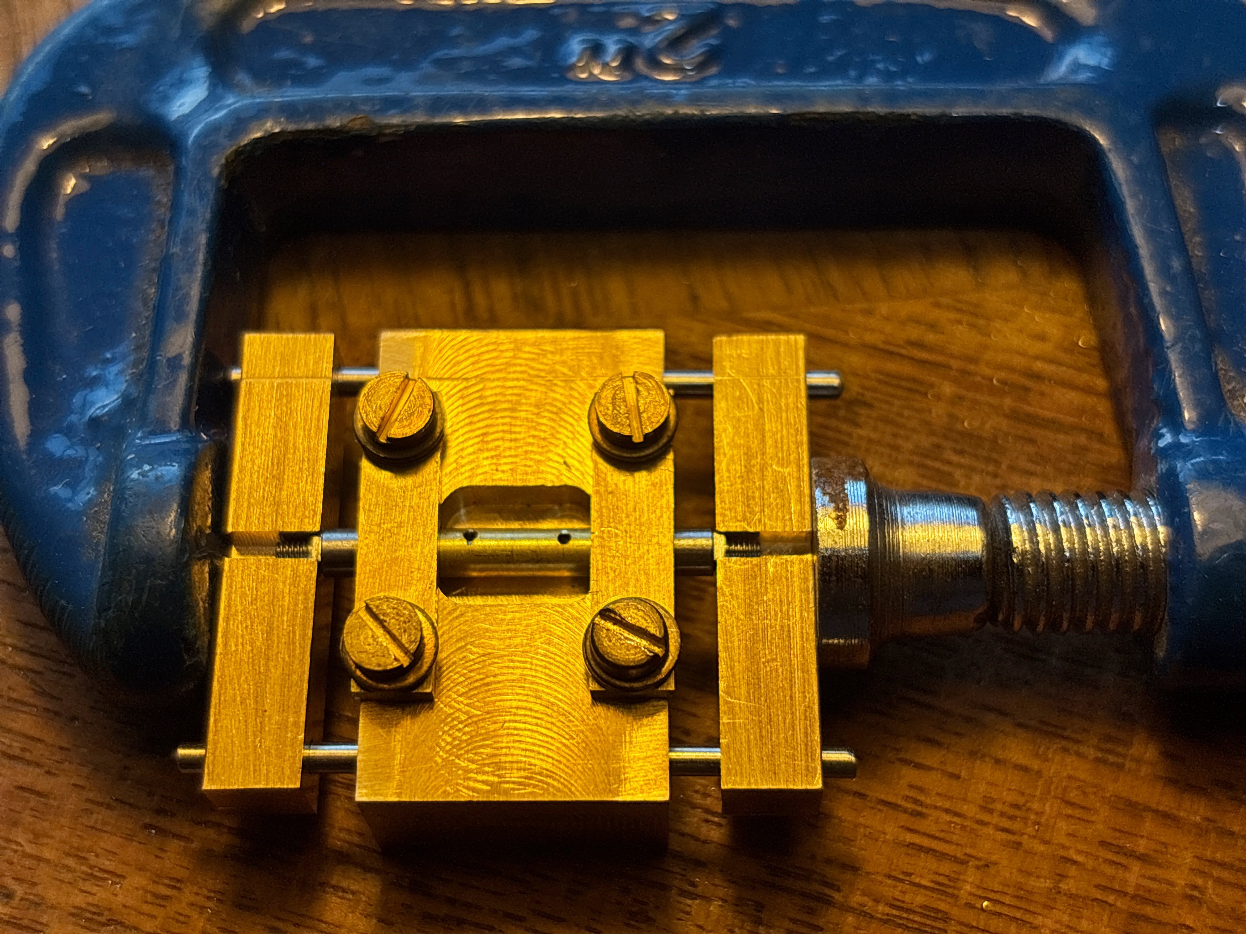

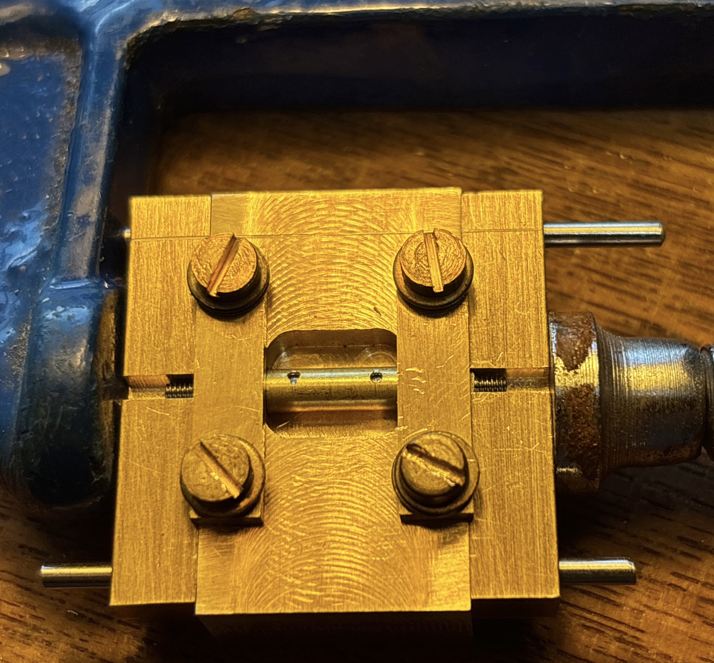

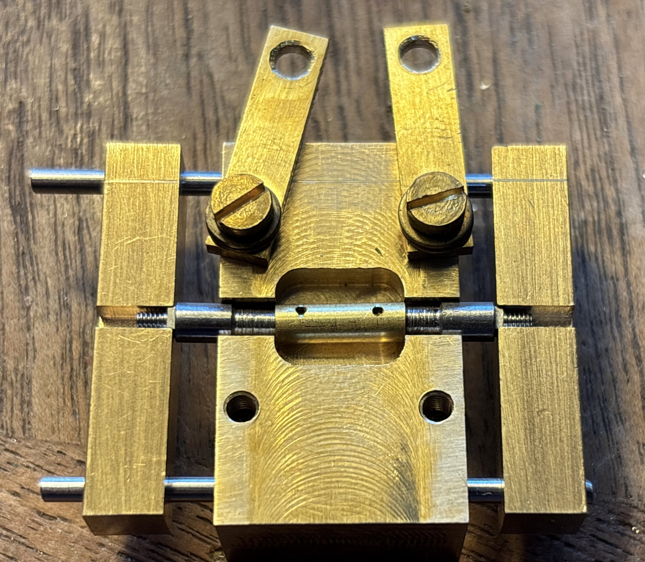

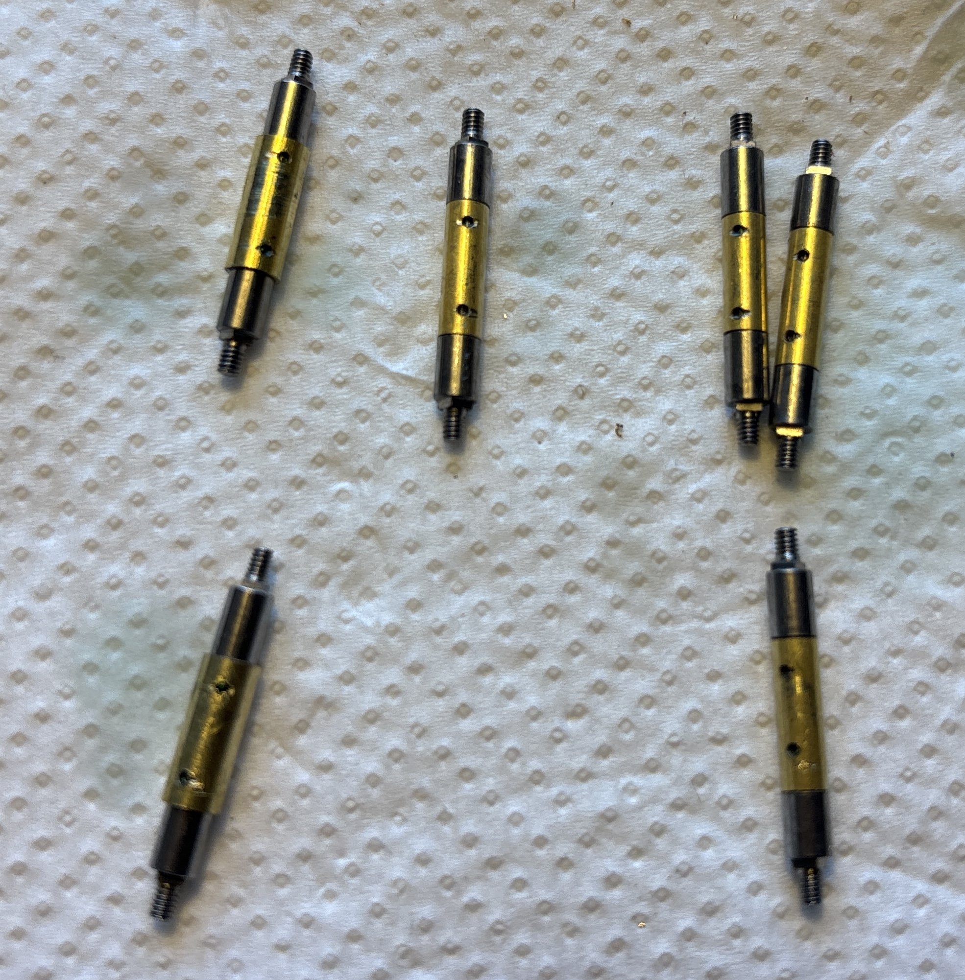

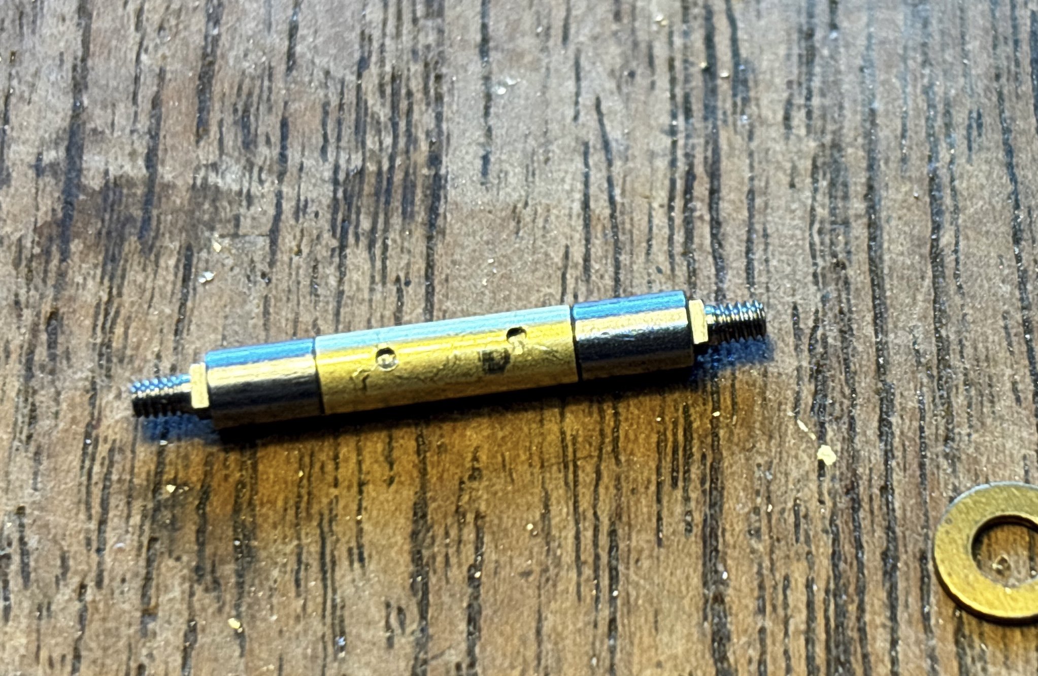

Mol_PMB Posted April 26 Author Posted April 26 I managed to find a couple of hours yesterday to use my friend's lathe to modify the axles for my J26, and to prepare a few more for other projects too. Axles cut in half were set up in a collet and the end turned down in diameter using a homemade go/no-go gauge. There was a bit of slack in the lathe and I didn't have 100% success rate but my process improved through the batch. Back home this morning I prepared the brass tube sleeves and then assembled 6 axles. Four of these use the turned-down axle halves into a 1/8" OD tube to give an axle that's nominally 1/8" all along. The other two use the simpler approach of leaving the axle halves full diameter and fitting a 4mm OD tube over the halves. In both cases I was able to achieve a press fit and used my assembly jig to push the parts together. I drilled small holes in the tubes, and after the axles had been pressed together I fed some Loctite 290 into these holes. This is a very low-viscosity Loctite that seeps into the gaps by capillary action and takes 24 hours or more to set fully. So for now, I'm waiting! I have another busy week this week, including a flying visit to the IRRS archives in Dublin. So not much modelling time but hopefully some more research. This week's eBay success has been the negative of this image, which will hopefully arrive in the next few days. It's good to have a clear photo of this side of the loco I'm modelling, most show the other side. 10 2
Tullygrainey Posted April 26 Posted April 26 Excellent. Your little jig is a fine bit of work. Beautifully made and it seems to do the job well. A useful addition to your tool kit. 1

Colonel Posted April 27 Posted April 27 Clever stuff, Paul and interesting to read about Loctite 290 too. Seems there's a cyano for everything. Since having to find 4mm scale drivers for my 7mm narrow gauge locos, it made me realise how valuable Slater's wheels are and wonder why the likes of Gibson and Ultrascale can't follow the Romford practice of square ended axles? It's not just the ready made quartering they offer either. It may be me, but I find building, fettling and painting a loco chassis requires multiple fitting and refitting of wheels, which Gibson's in particular do not like - a couple of removals and they are soon loose on their axles. Very neat solution to ensuring the axles will quarter correctly too, by the way. 3
Mol_PMB Posted April 27 Author Posted April 27 Many thanks, David. I've also a long background in 7mm scale but now working in 4mm for the Irish models, and I completely agree with your comments on the wheel/axle interface. It also helps that the Slaters 7mm scale wheels have a metal insert, whereas the readily available square-holed 4mm scale wheels are all plastic (there were some with metal hubs or even entirely metal, but not readily available these days). I've also found the wheels need to go in and out multiple times during construction, fettling and painting. I've read of some people who buy twice as many wheels as they need - one set for the building process and another set to fit in the final assembly. It's one reason why I have come to prefer hornblock suspension because the entire wheelset including hornblocks can be removed in one piece. It's not a perfect solution though, it can very fiddly re-fitting them and that's without considering what to do about brake pull rods. 1

murrayec Posted April 27 Posted April 27 10 hours ago, Mol_PMB said: ......... I've also found the wheels need to go in and out multiple times during construction, fettling and painting. I've read of some people who buy twice as many wheels as they need - one set for the building process and another set to fit in the final assembly. ...... I use a set of slightly undersized axles in the wheel area while constructing a chassis and then install the proper axles on the final build. Eoin 5

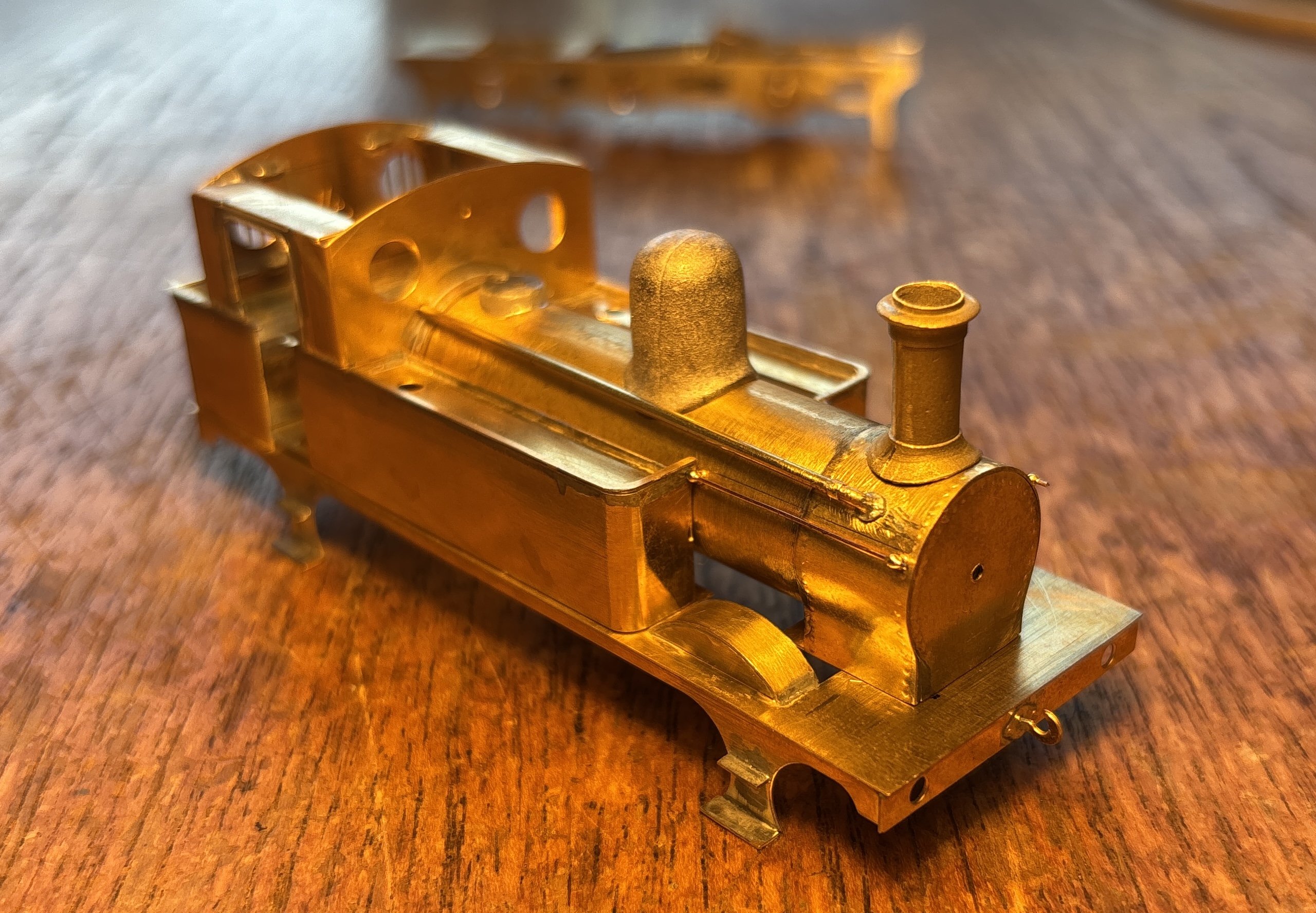

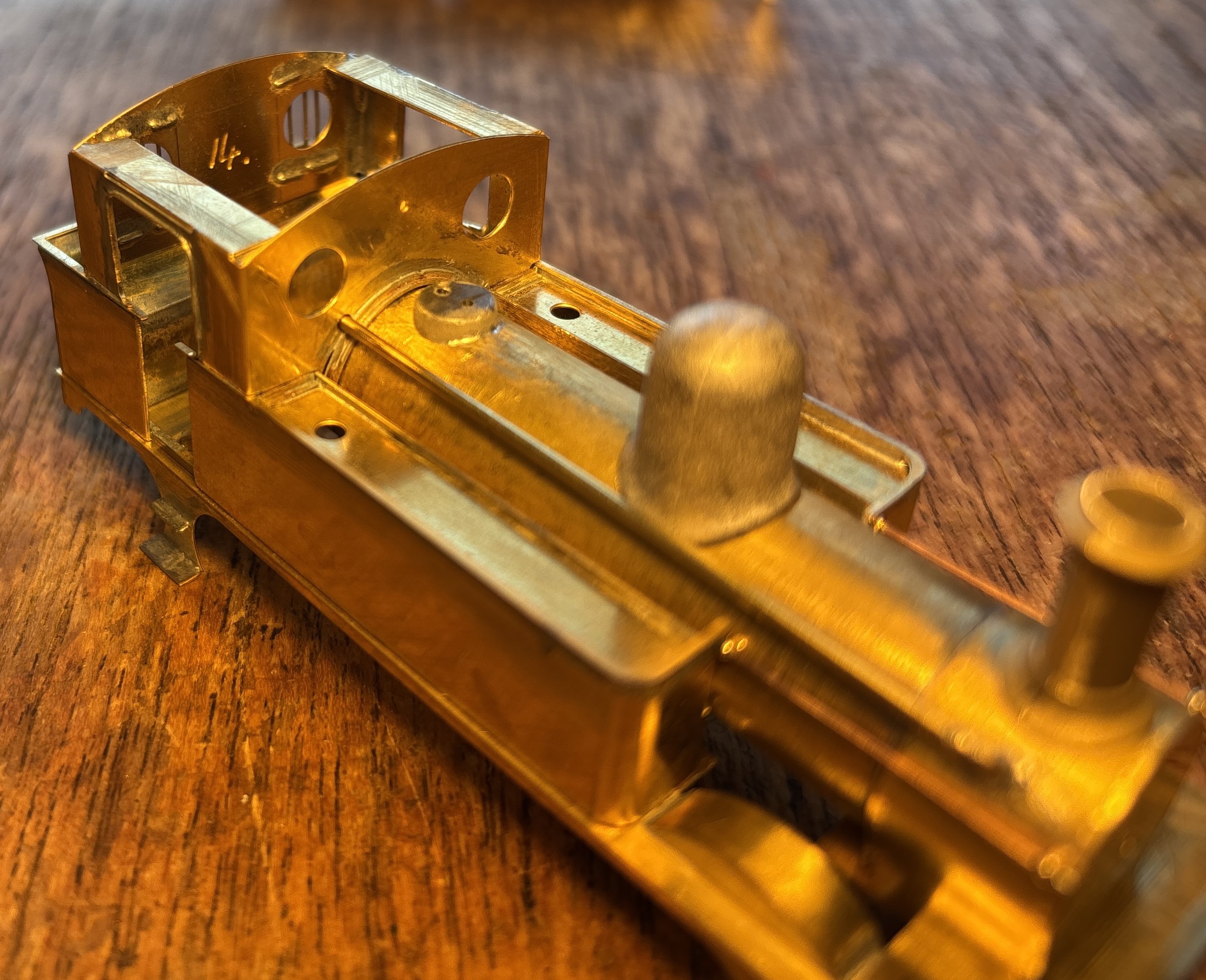

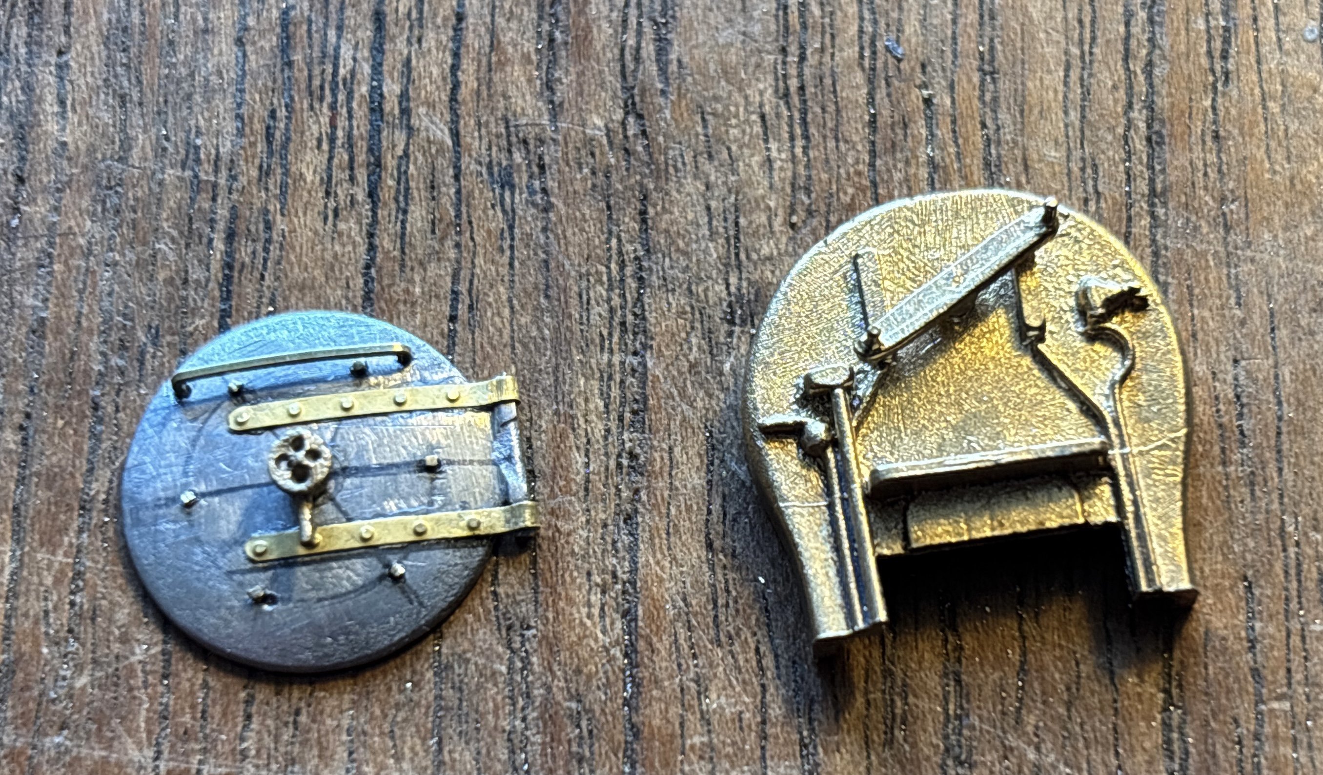

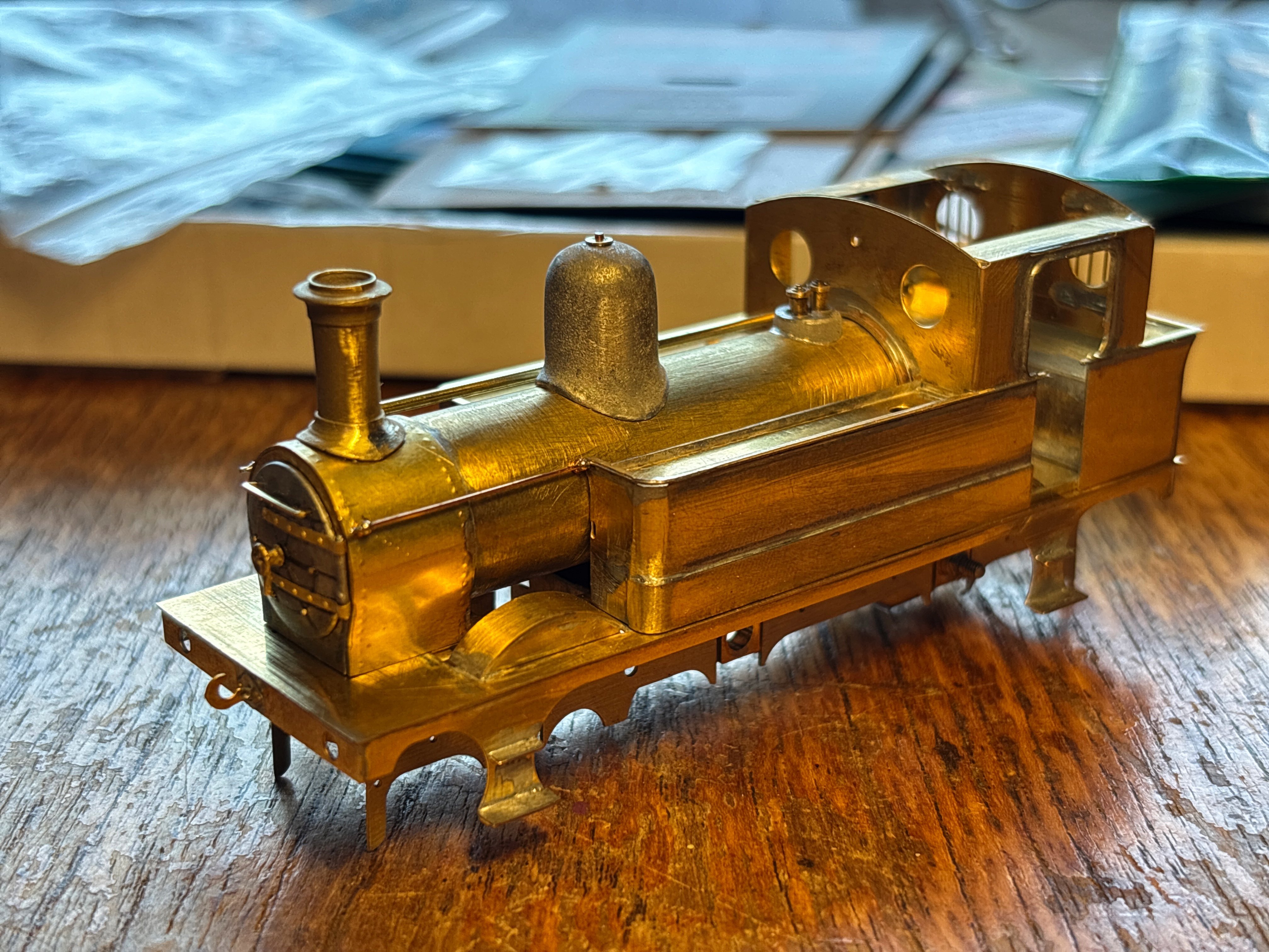

Mol_PMB Posted May 15 Author Posted May 15 Finally back at the workbench today and I’ve been working on boiler detailing. The smokebox door is the original with all the detail taken off and replaced. The backhead (and the smokebox door dart) are lost wax castings from Caley Coaches, adapted to fit. I’ve also been fettling the dome, chimney and safety valves to get a better fit to the boiler. 10

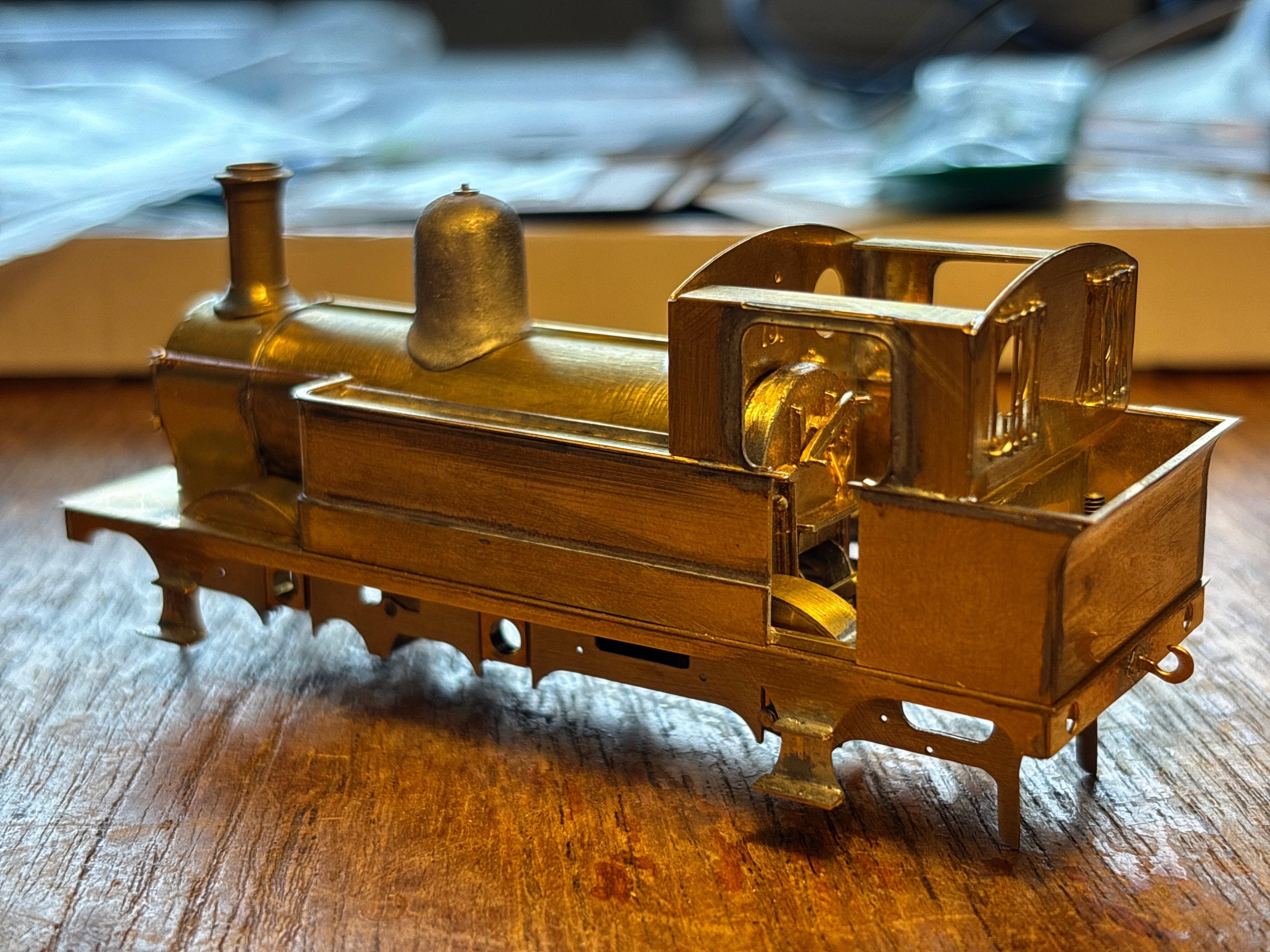

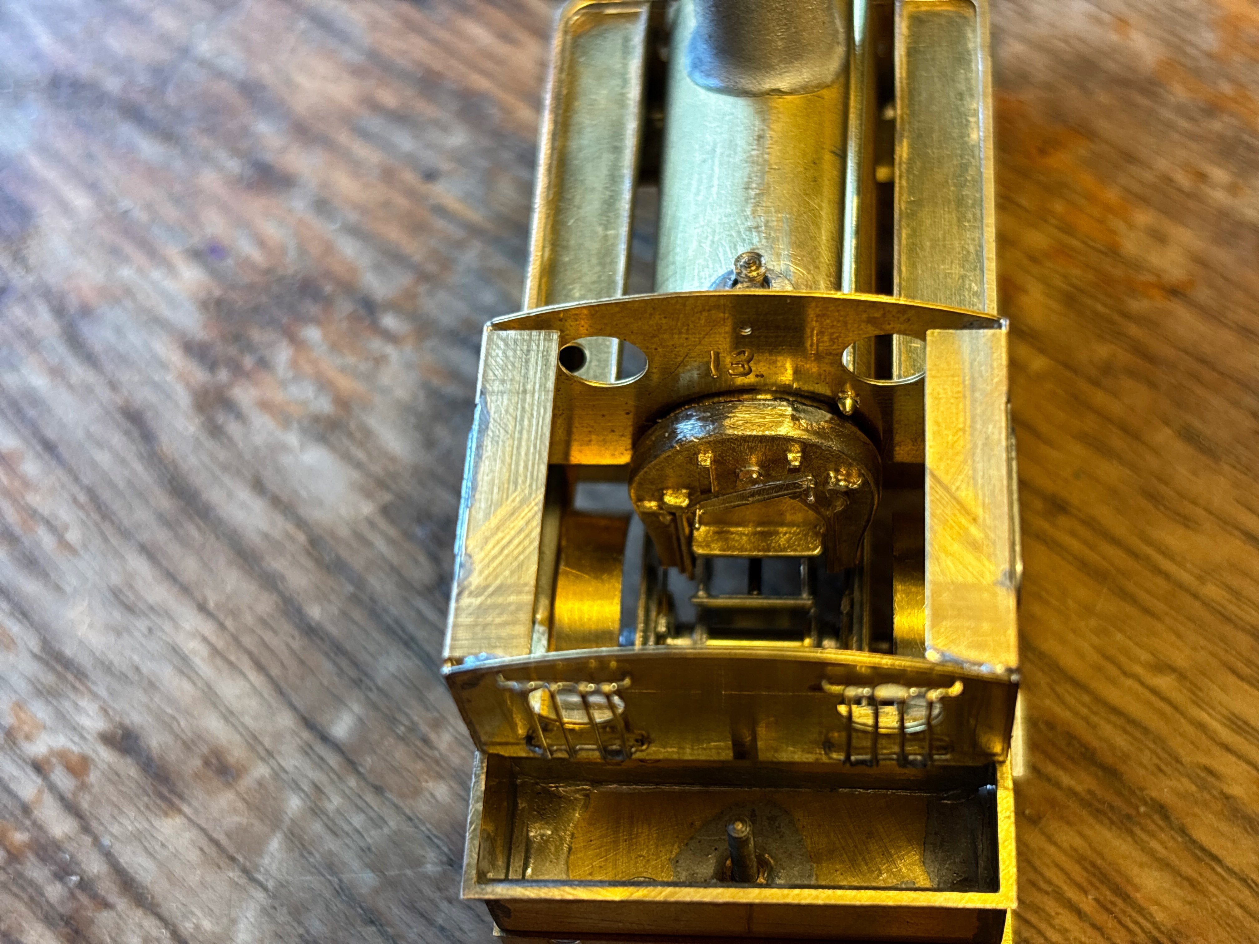

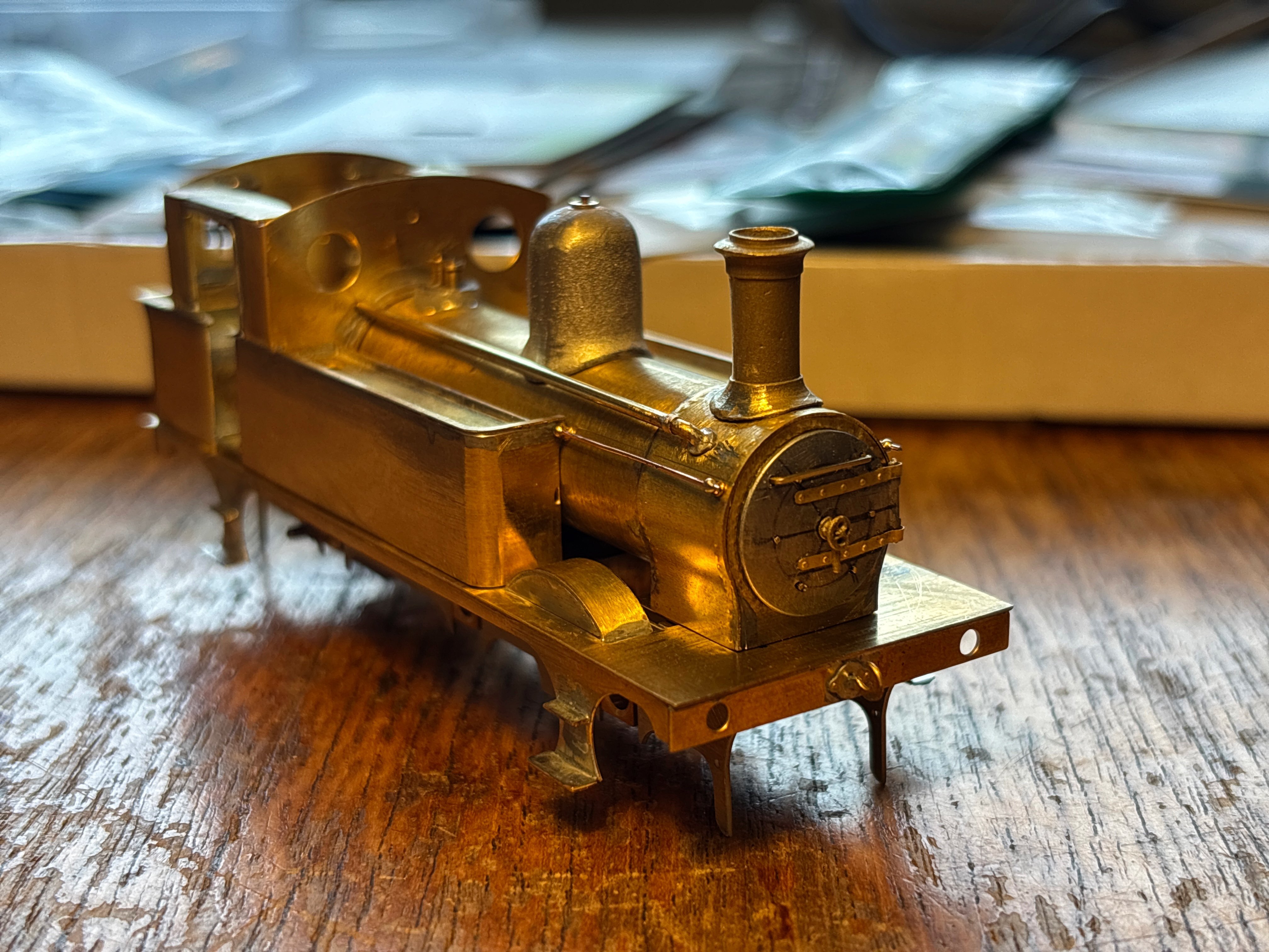

Mol_PMB Posted May 15 Author Posted May 15 The boiler fittings are now fitted, and here’s a trial assembly of the body to show how it looks at present. You can just see the end of the gearbox below where the firehole door ought to be. Once I have fitted the cab floor, more cab interior detail and some crew I think it will be invisible. I have also been preparing wheels, crankpins, and trial-fitting my extended axles. They are looking promising. Still plenty more detailing to do, and getting the chassis going, but I have a weekend ahead of me. 14 2
Flying Snail Posted May 15 Posted May 15 15 minutes ago, Mol_PMB said: The boiler fittings are now fitted, and here’s a trial assembly of the body to show how it looks at present. You can just see the end of the gearbox below where the firehole door ought to be. Once I have fitted the cab floor, more cab interior detail and some crew I think it will be invisible. I have also been preparing wheels, crankpins, and trial-fitting my extended axles. They are looking promising. Still plenty more detailing to do, and getting the chassis going, but I have a weekend ahead of me. That looks like a really neat job - very clean brasswork 2 1
Mol_PMB Posted May 15 Author Posted May 15 5 minutes ago, Flying Snail said: That looks like a really neat job - very clean brasswork I had boxed myself in with the smokebox and I confess that the chimney and smokebox door (and the details on the door) are glued in place. Everything else is soldered, with bolted connections between the four subassemblies. 1
Tullygrainey Posted May 15 Posted May 15 Beautiful job Paul. Looking really well. No shame in glueing white metal castings. In my experience, it's nigh on impossible to solder whitemetal chimneys, domes and smokebox doors in place and I never attempt it. Why risk melting the casting whilst trying to get enough heat into the job when you can use glue which gives you time to adjust the position of everything. It's what 5 minute epoxy is for. 1 4
Horsetan Posted May 15 Posted May 15 12 minutes ago, Tullygrainey said: Beautiful job Paul. Looking really well. No shame in glueing white metal castings. In my experience, it's nigh on impossible to solder whitemetal chimneys, domes and smokebox doors in place and I never attempt it. Why risk melting the casting whilst trying to get enough heat into the job when you can use glue which gives you time to adjust the position of everything. It's what 5 minute epoxy is for. I notice a lot of the top-end German HO loco kits tend to be mostly all brass castings for this very reason.... 2
Galteemore Posted May 15 Posted May 15 Great work. I have soldered boiler fittings before both brass and w/m but use adhesive now. It allows lots of time to test and adjust straightness and plumb, not to mention being more likely to break off in a fall, rather than staying put and potentially doing greater damage to the loco’s shape. 2 3 1
