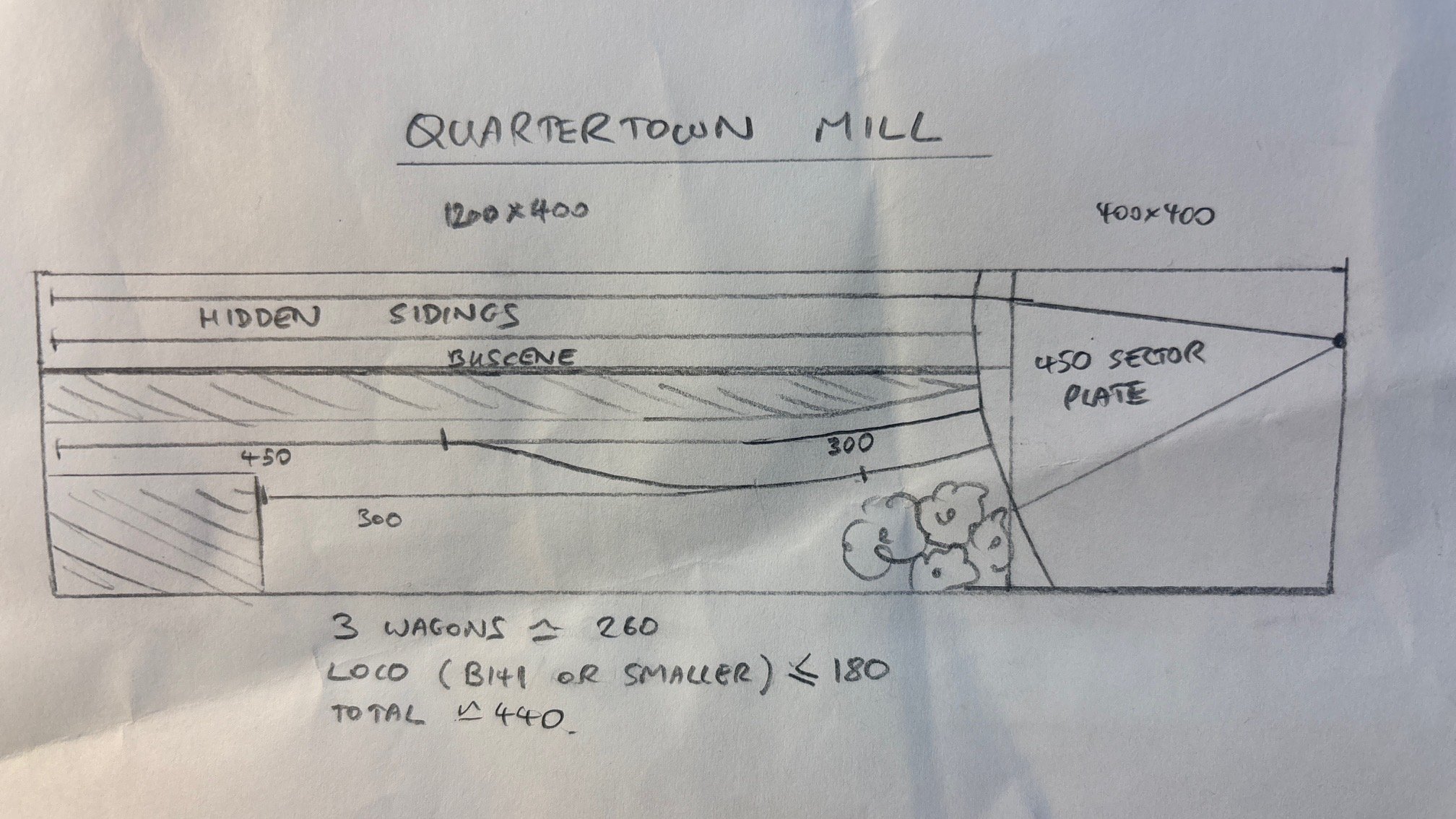

Something like this might work, just a quick pencil sketch but I'll try it out on the confuser later.
Designed for trains of 1 smallish diesel and 3 wagons. Storage for plenty of stock on the two hidden tracks.
In reality I believe the Webb's Flour Mill closed in 1957 but I can give it a slightly longer lease of life into the 1960s.
Grain vans inward and normal vans carrying flour outbound, plus some open wagons with coal for the mill's boiler house. That fits my existing fleet well.
The branch remained open until 1977 with tar bitumen traffic for Roadbinder Ltd which would also be possible to model, or I could choose to represent some other freight not associated with the mill.

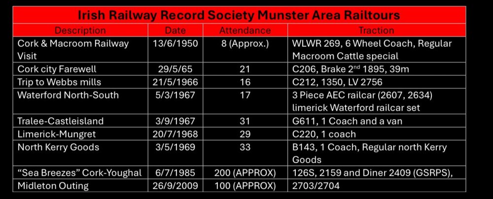

Random IRRS specials also possible - pic posted on this forum by @Westcorkrailway:
Only 2 turnouts to make, not too daunting. Baseboards could be a Grange&Hodder 'cheat' to get things moving quickly.
A mix of industrial buildings and foreground greenery, possibly feature part of the mill leat at the front of the board.

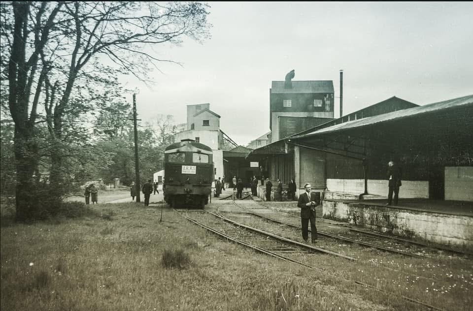

So far I have only found 3 photos of the place when the line was open, though some of the buildings still survive. The others are in IRRS Journal No.198 p.234, and this one:

Wonderful, many thanks! Those extra photos give some useful different views of the buildings and scenery, and the description of the line and traffic is invaluable.
I expect there may be some more photos out there somewhere from other tour participants, but they will be hard to find.

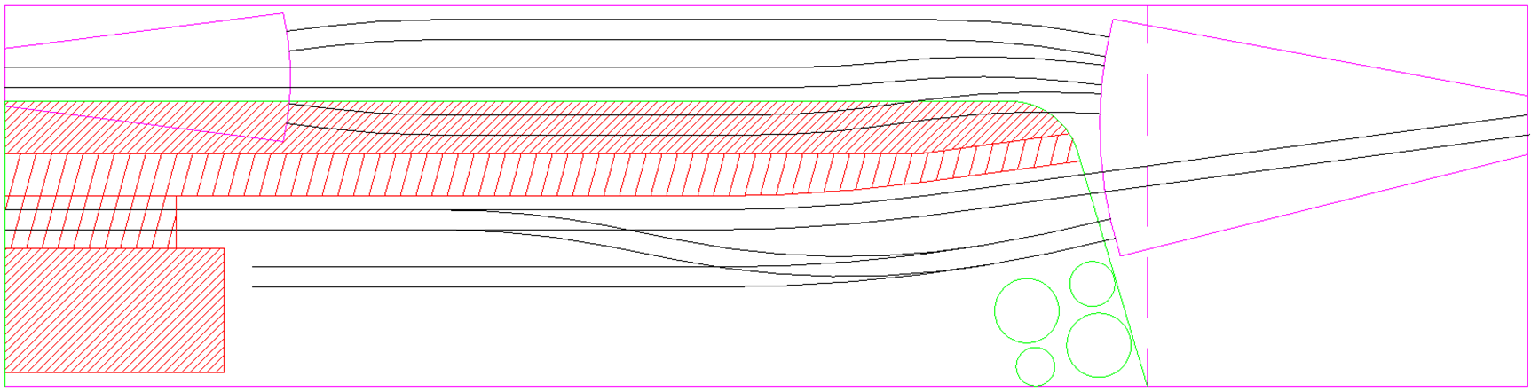

Here's a more accurate sketch of the layout based on Quartertown Mill. Still the same 1600x400 footprint, with a scenic section 1200x300mm. Minimum curve radius 900mm, designed for a max total train length of 450mm including loco or 300mm without.
Rails are black, buildings red, backscene and trees are green. Building outlines are simplified at present.
I've added another smaller sector plate in the fiddle yard to increase flexibility by allowing loco run-rounds or hand-shunting of wagons between tracks.
There is also the option of a third track in the fiddle yard if it can run inside/under the buildings on the scenic part, which ought to be possible.
Grain vans would be dealt with on the headshunt at the left-hand end, whilst flour would be loaded into vans from the platform with canopy in the middle of the layout. Coal for the boilers or tar bitumen would be unloaded on the short spur bottom left. Three wagons can be left in each of those locations without snarling up operations completely. Three wagons and a loco will also fit on each of the fiddle yard tracks.
I think this works out quite well and there's plenty of scope for freight trains to arrive on scene, run round, shunt and depart, then re-marshal in the hidden sidings.
The next step is to draw up a plan for the two points in Templot.

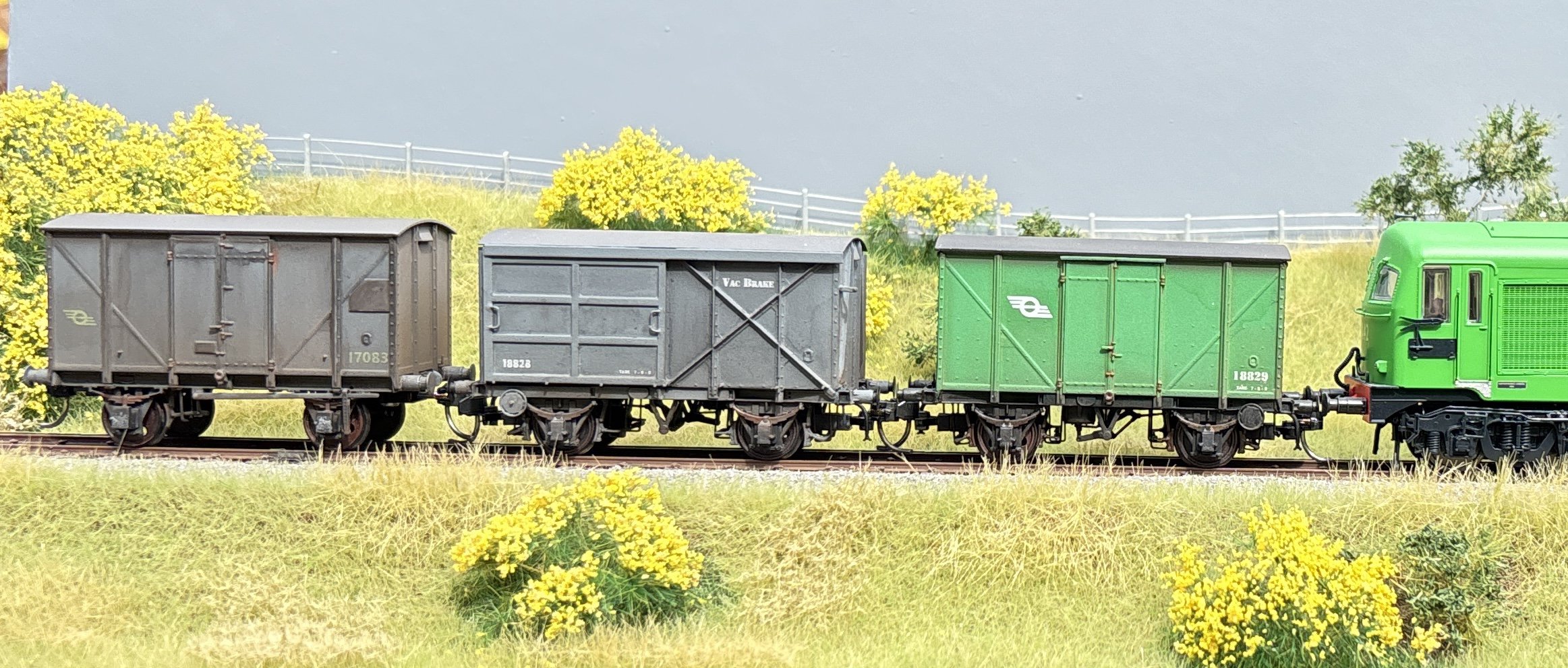

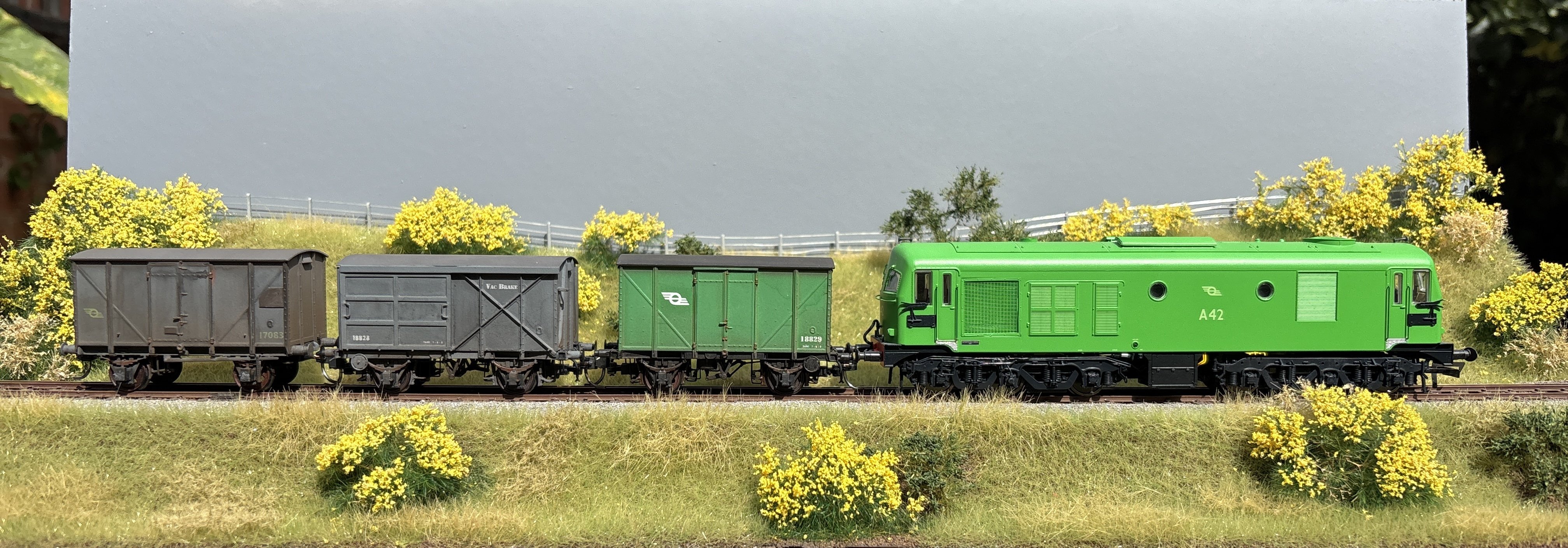

A new arrival from eBay today, a green A class which I had been mulling over for a while and eventually gave in despite @DJ Dangerous badgering me to buy an anteater instead...
I have posed it here with three of my vans which are conversions from the IRM fitted H vans. All of these have been modified to 21mm gauge which isn't as bad as I thought but still a fair bit of work with the brake gear.
The green one 18829 has the extended buffers fitted as per prototype.
The middle one 18828 is one of the rare prototype Palvans converted from H vans. This is a kitbashed Parkside BR Palvan body on an IRM chassis, also with extended buffers. These were originally green too, but at least one received the plain grey livery shown here.
The left-hand one 17083 represents the batch of vans built before the H vans, with a similar body but on a conventional non-triangulated chassis. This uses the spare IRM body from the middle van, on the spare Parkside chassis from the Palvan kit. Both with appropriate modifications.
All have been repainted, lettered and weathered. My green van was probably a fair match to the shade of the green A before I weathered it.
I have yet to test the A class, and of course it's presently the wrong gauge. I have yet to try regauging an A; as with the wagons it will need new wheels but the existing axles should be OK.
  • Like 11

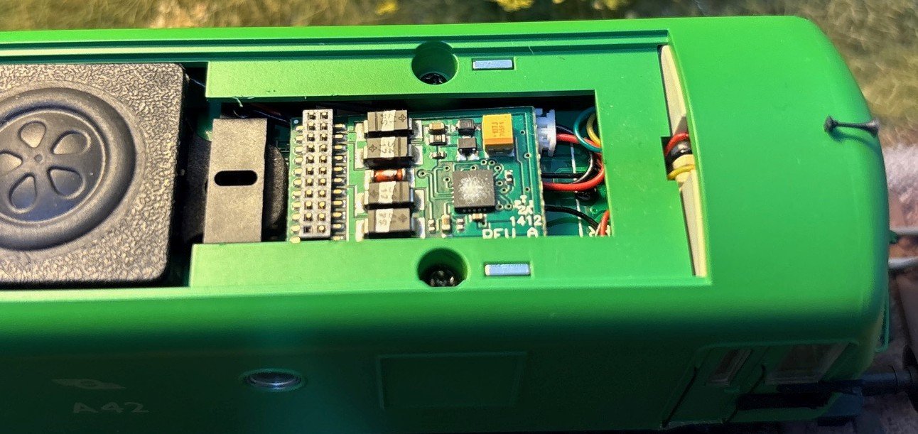

I have tested my green A42 on DCC, having worked out that its ID was 42. No surprise I suppose.
Initially it was very jerky and inconsistent. Giving the wheels a good clean with IPA solved that issue - mechanically it runs. Good news
But there was no sound (this was advertised as DCC sound fitted) and the lighting functions weren't set up right. So I looked in the roof and found that the chip fitted wasn't a Loksound, but what appears to be an old entry-level non-sound Bachmann chip. Bad news
I contacted the eBay seller, and suggested that the best way to resolve this was a partial refund. They responded within a few minutes, agreed to my proposal and sent the amount I had suggested. Good news
Now I need to buy a Loksound V5 sound chip for a Crossley A class. There seem to be two options:
When AS loyalty points are considered, the prices of both are very similar.
They appear to be different products - they certainly have different function listings. The Roads and Rails option has a Kadee Shuffle function which would be useful for me. That doesn't seem to be on the Accurascale function list.
I don't know whether the sounds are from different sources, and/or which might be the more realistic for the Crossley. I have actually driven an XA on the main line in Australia so I ought to know what a Crossley A class would sound like. But it was a long time ago and my memory is more of the steam-era driving controls and the absolute filthy oily blackness in the engine room!
So the Question, for those of you with sound-fitted Crossley A class. Which option did you choose, and why? Are you happy with it?

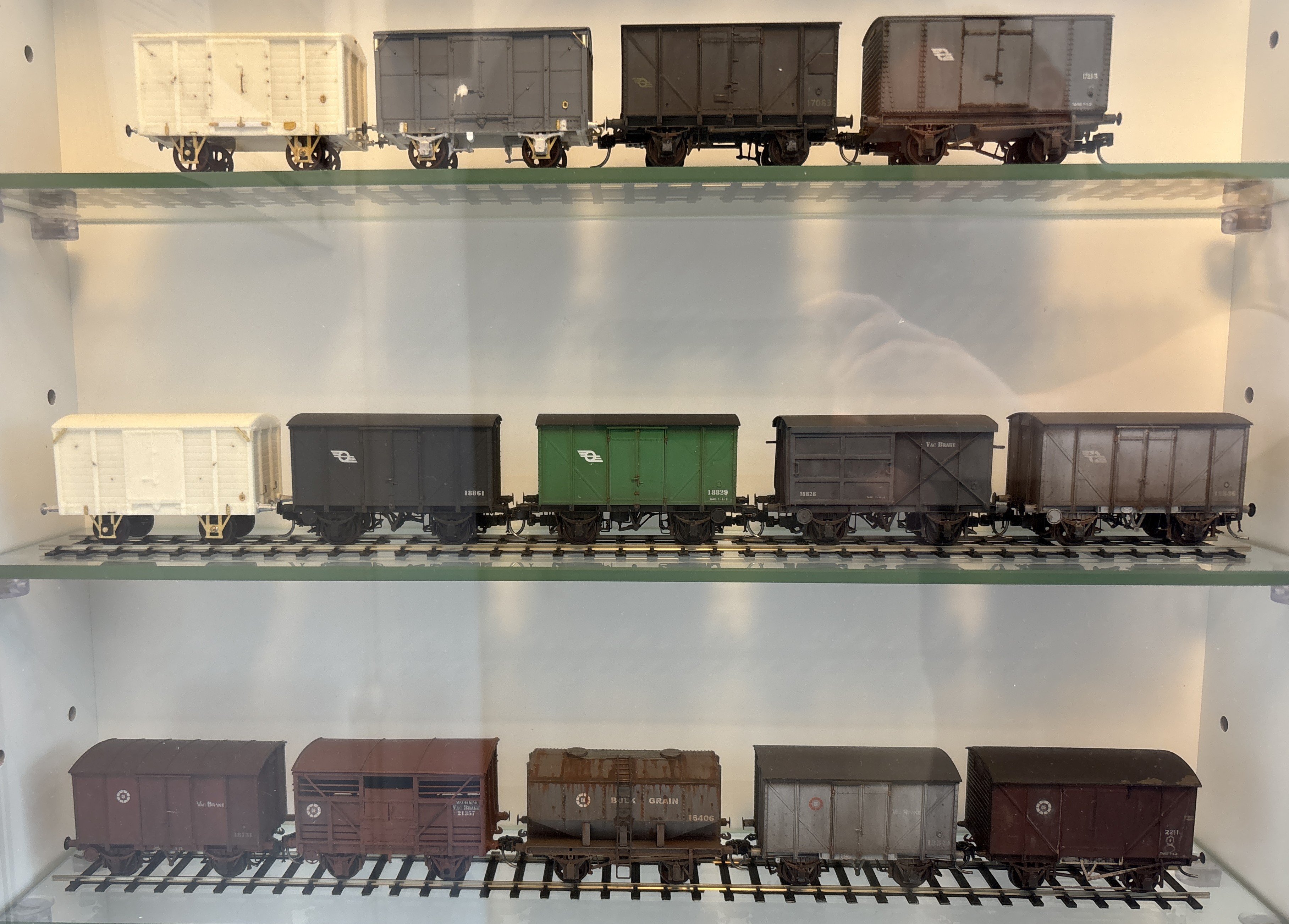

Back to my main interests in the south, here's the collection of goods vans in the 21mm gauge display cabinet:
Top row - 1960s unfitted vans:
  • Provincial Wagons GN 10t van, modified to represent MGWR equivalent. Work in progress.
  • Provincial Wagons GN 10t van, modified to represent GNR sheet-sided equivalent. Work in progress.
  • Modified IRM H van body on Parkside chassis, to represent early CIE 170xx series unfitted van.
  • JM Design LMA van, built as intended.
Middle row - 1960s vac fitted vans:
  • Provincial Wagons GN 10t fitted van, detailed. Work in progress.
  • IRM fitted H van, regauged detailed and repainted.
  • Chassis of IRM H van, regauged, with modified Parkside palvan body, to represent one of the prototype palvans converted from H vans.
  • IRM fitted H van, regauged.
Bottom row - 1970s vans, roundel era:
  • IRM fitted H van, regauged, modified roof.
  • Provincial Wagons cattle van, modified to a vac fitted version
  • JM Design GSR grain hopper, with added details.
  • GNR cement van based on detailed and regauged Parkside kit.
Soon to arrive will be 6 IRM unfitted H vans.
There are also 3 IRM grain vans awaiting the regauging and weathering process. Ideally I'd like to modify one of these by replacing the doors with a plain panel.
Once I've dealt with those, there will be some GSWR 'big boy' vans to make, based on my measurements at Cultra.
I'd also like to make a GNR grain van, and two GSR variants of the IRCH standard vans.
I probably have too many already!
  • Like 11

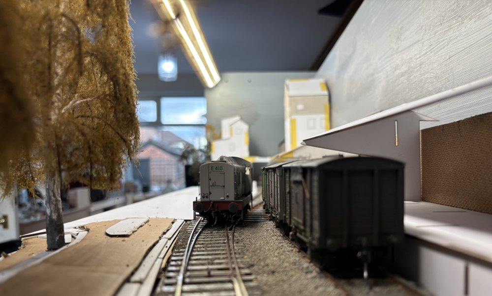

My normal practice is to make my own baseboards, but I thought I would try a kit this time. I placed an order a few weeks ago, and this afternoon the postie delivered this from Grainge & Hodder.
Another thing to add to my list of jobs! These boards are intended for the Quartertown Mill plan I came up with last month.
The IRCH goods vans are in their final stages now so I’ll get them finished before opening the woodwork.
Edited by Mol_PMB

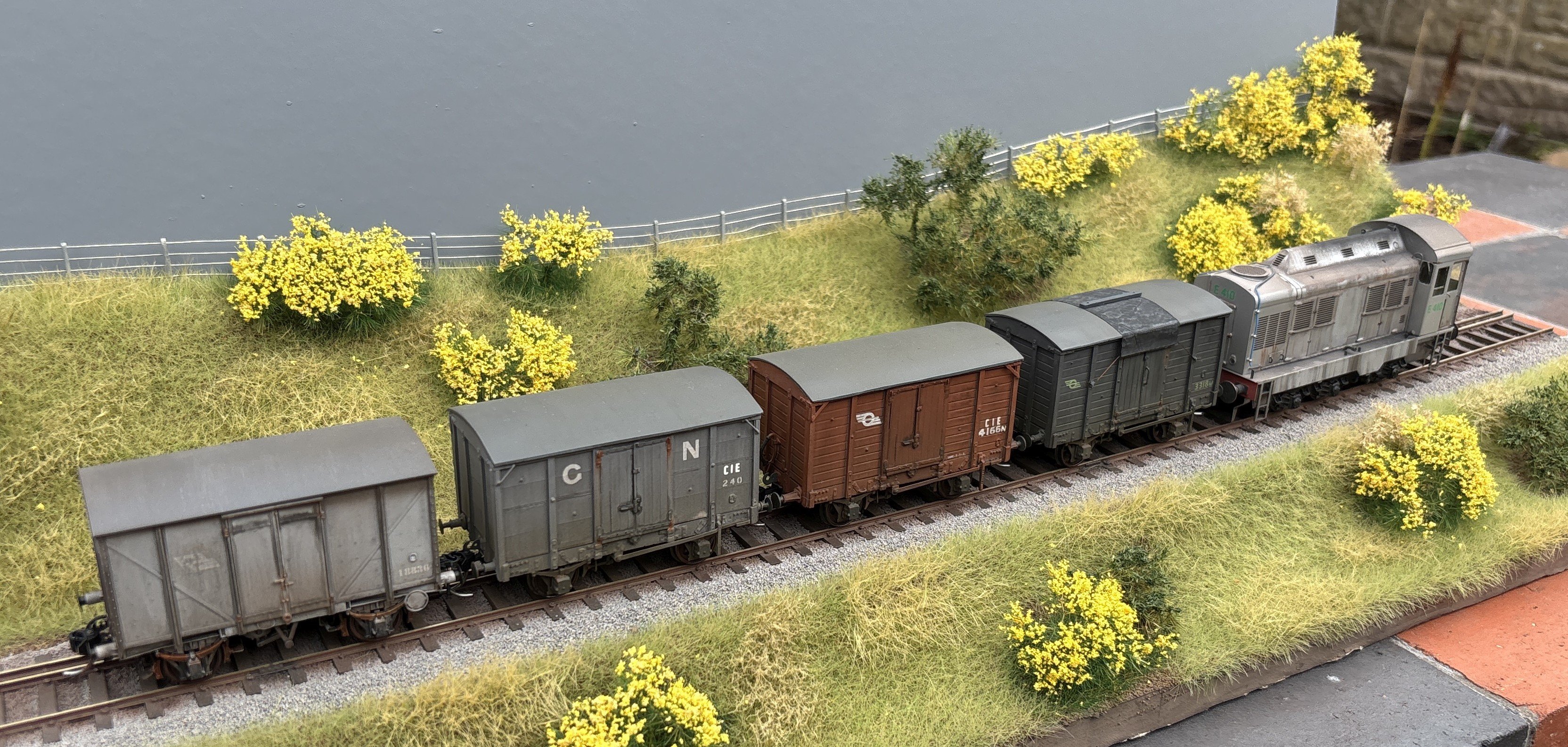

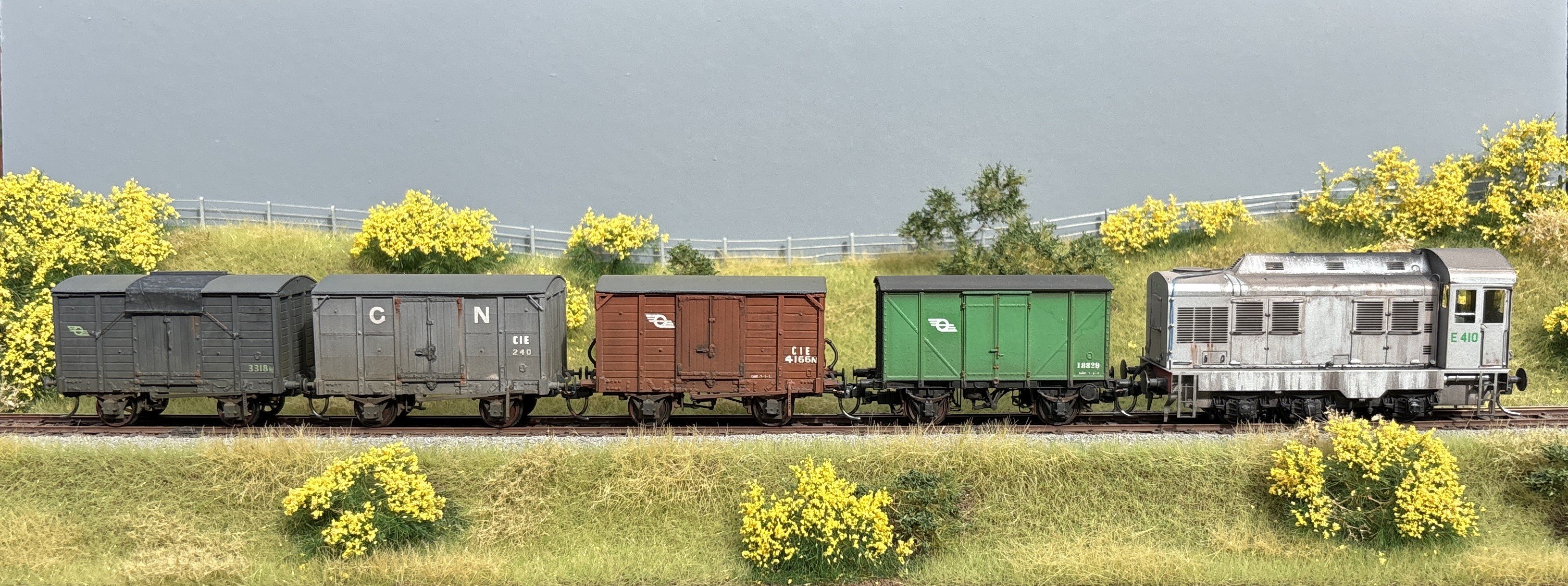

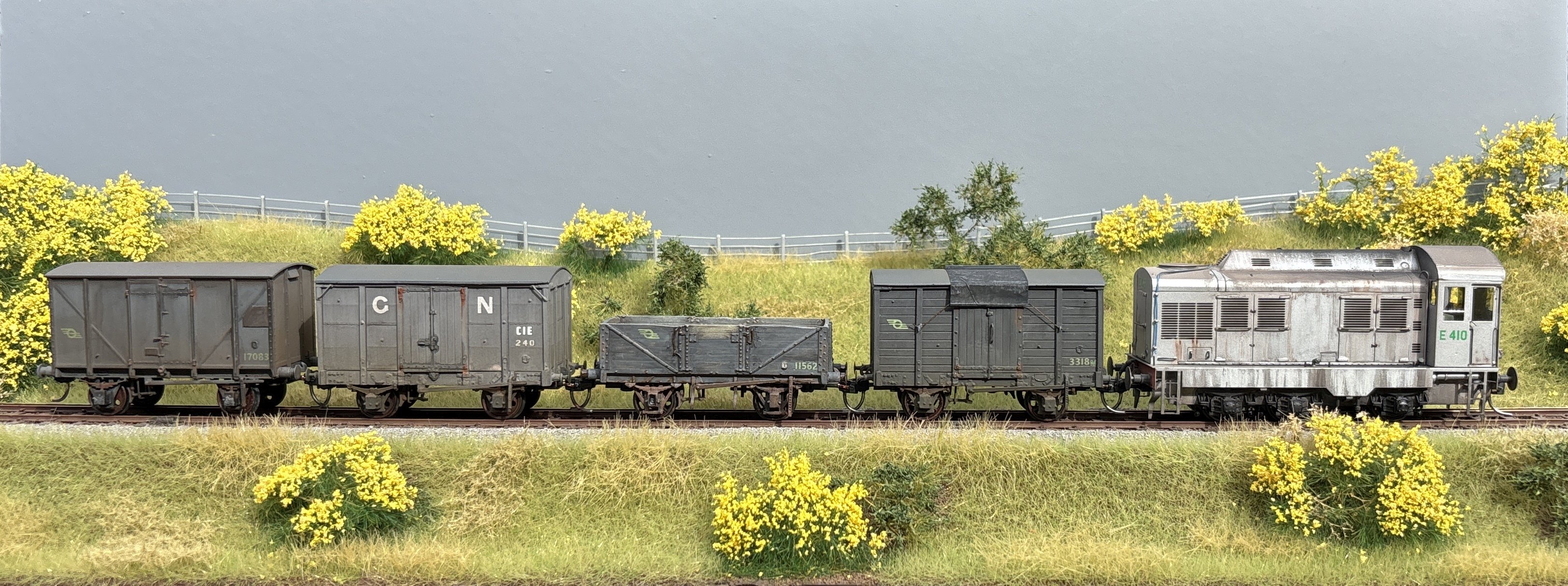

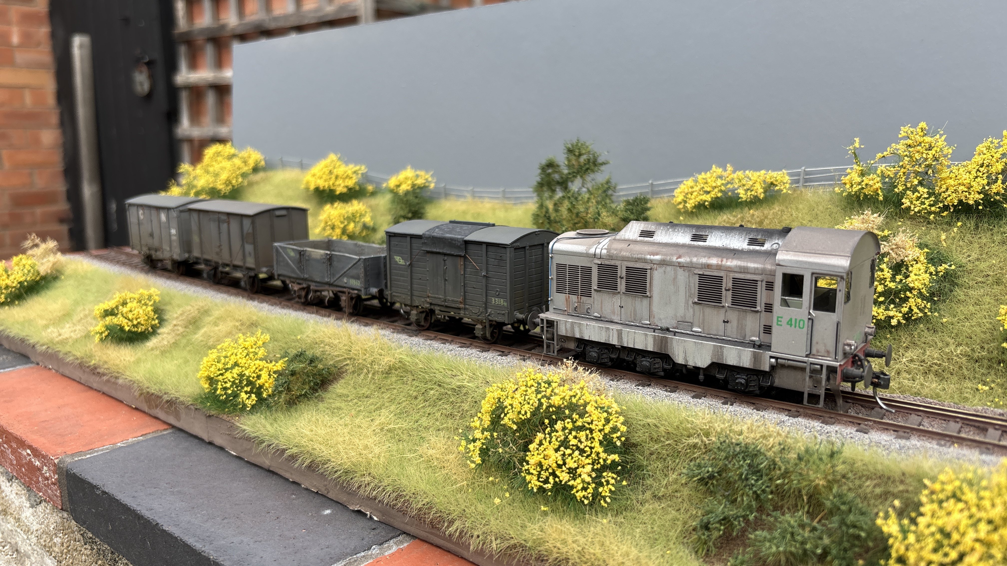

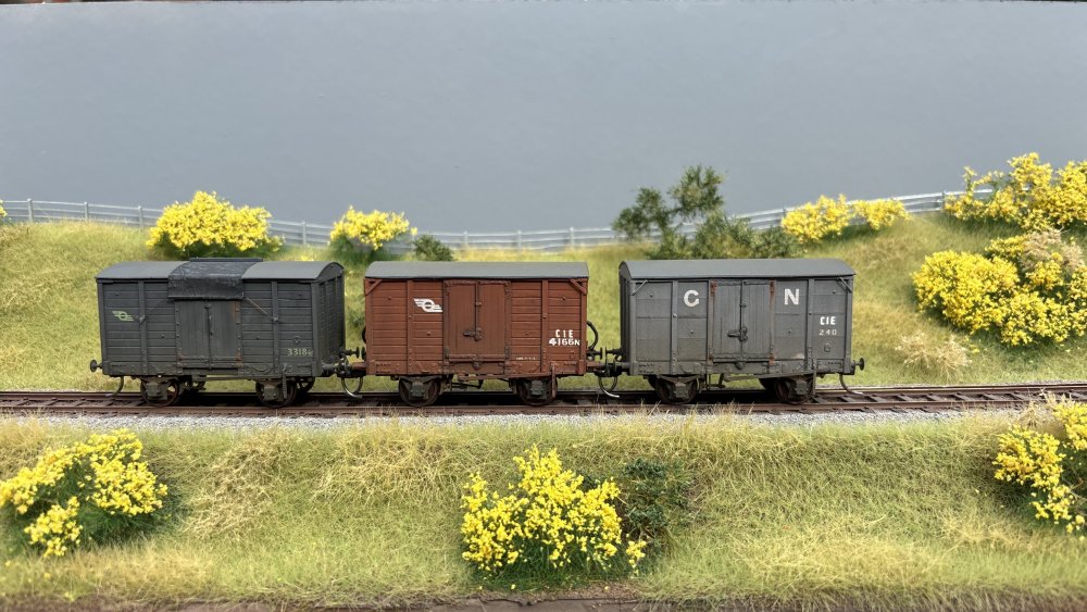

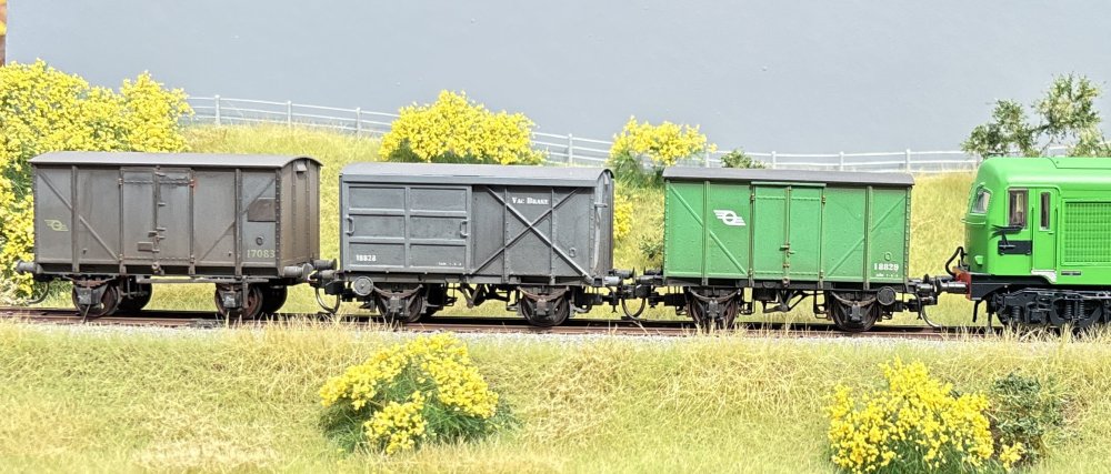

The trio of IRCH vans are now complete, here they are:
Roof view, with an IRM H van and the E class for context:
A selection of wagons in older liveries (early CIE with eau-de-nil snail and numbers, and inherited GNR freshly rebranded):
Here including a comparison with a CIE 'green van' alongside the older GNR goods van fitted for working in passenger trains:
  • Like 15

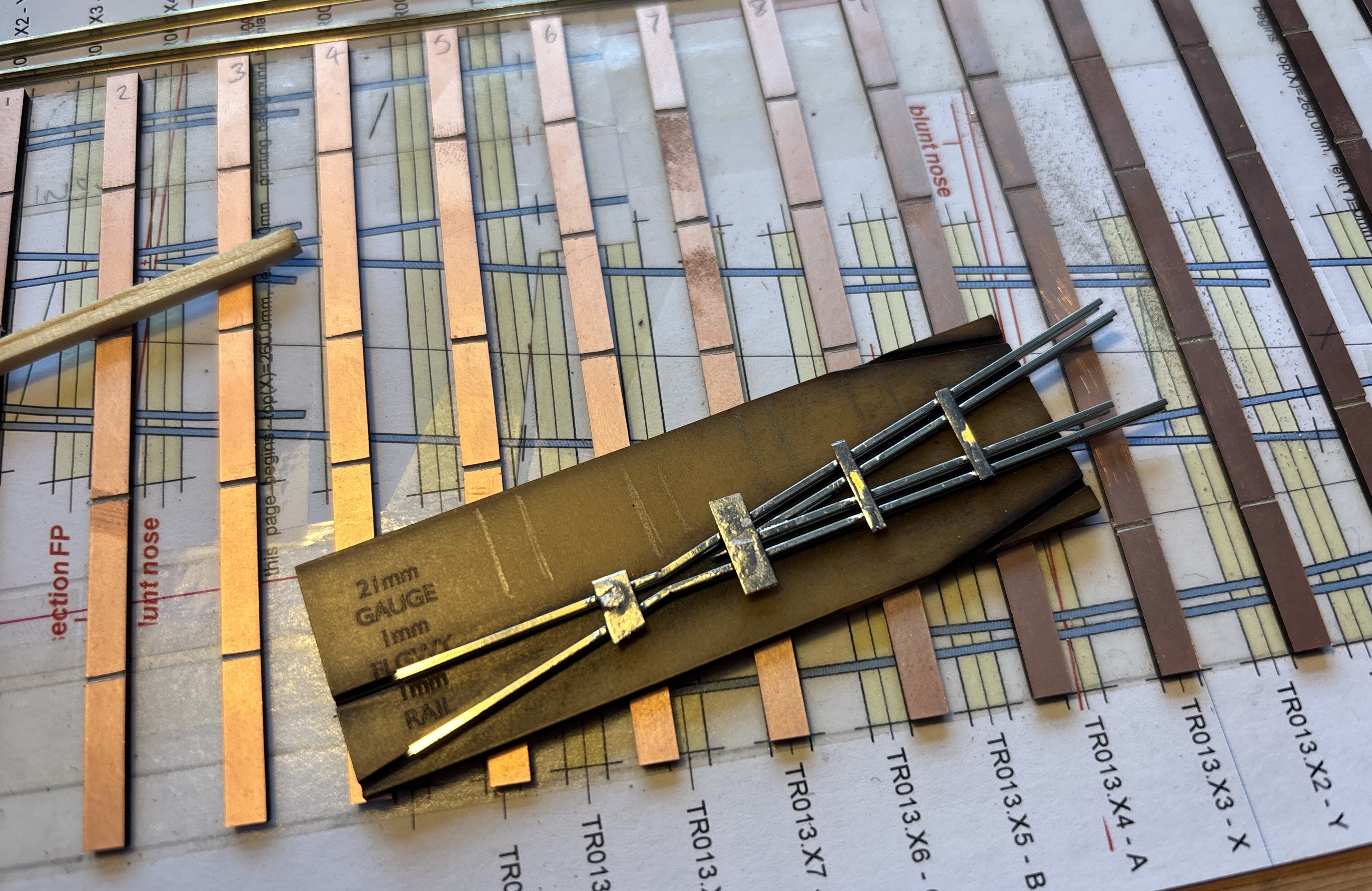

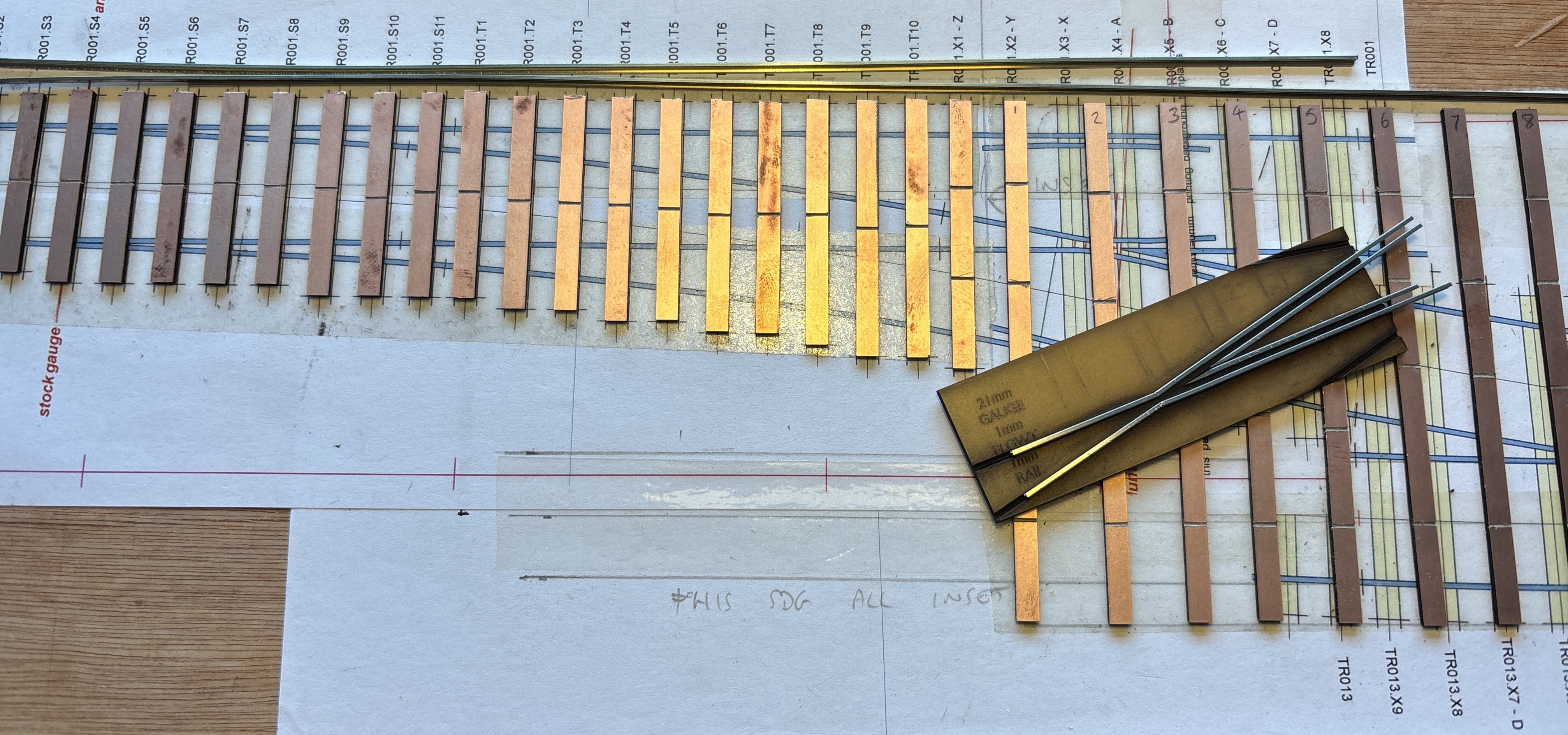

Today I have made a start on some pointwork. I’ve been putting this off for far too long. So far, it seems to be going OK. I have used my laser-cutter to make a couple of jigs to help.
  • Like 17
7 hours ago, Horsetan said:
I see Templot....!
Yes, but used as an unskilled amateur and probably not in the way it was intended.
Hopefully there will be some more progress to report later this week. Real life keeps getting in the way.

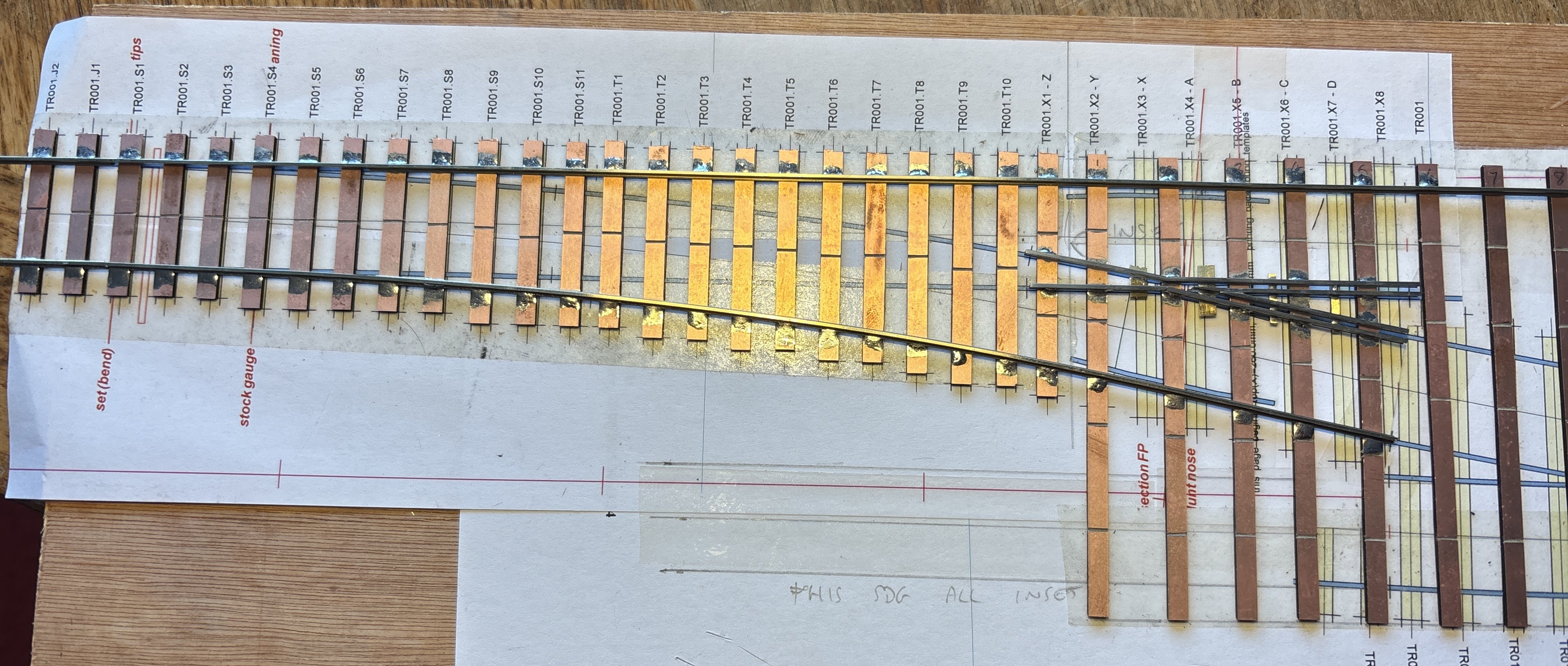

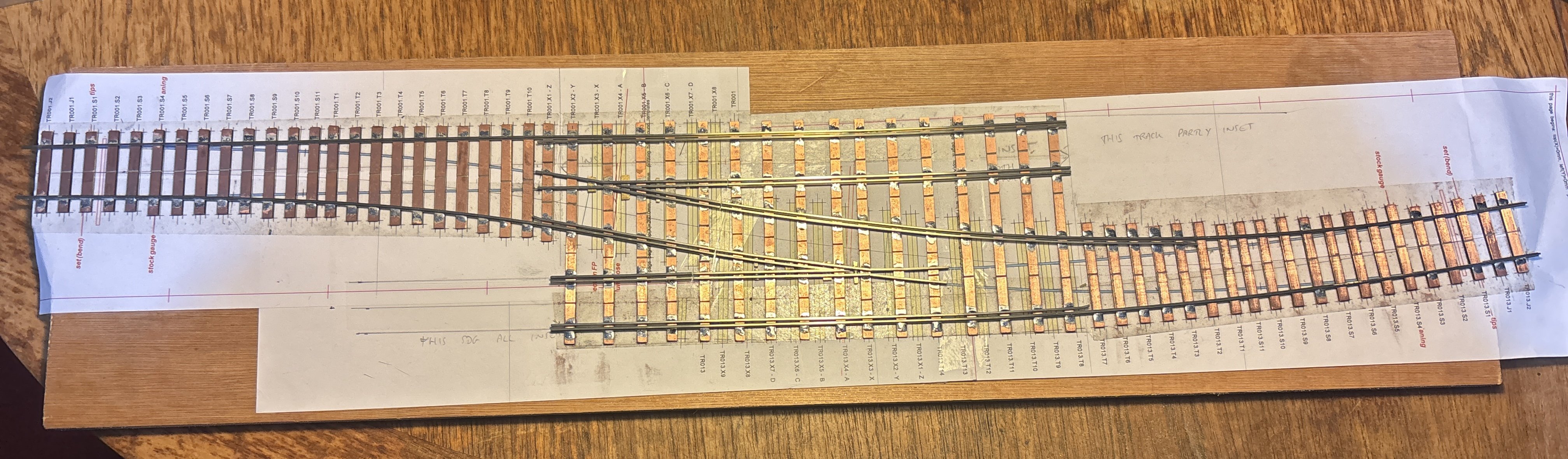

Some more progress on the 21mm gauge pointwork, with the crossings and stock rails in place.
The middle part of this crossover is embedded in concrete so the checkrails are a bit more extensive than usual.
I have a day off tomorrow and I’m going to tackle the switch blades. I think they will be the most challenging part.
