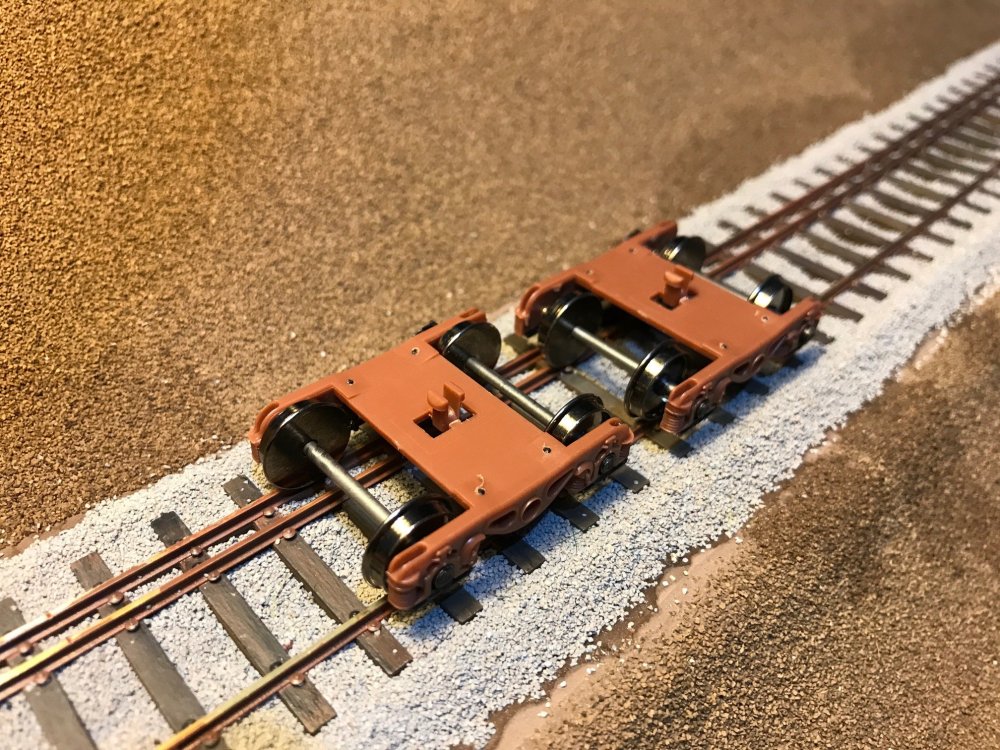

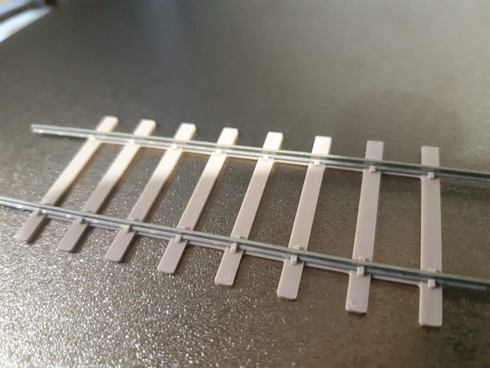

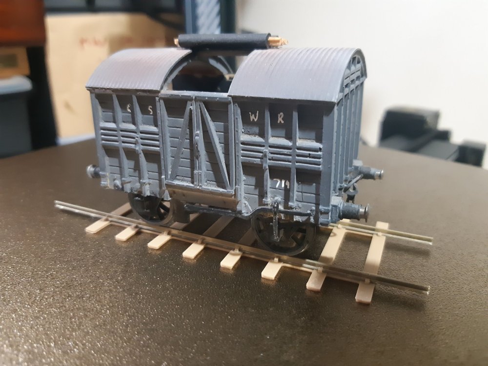

Rob R Posted December 11, 2024 Posted December 11, 2024 (edited) A little taster:- Early days yet, 25mm gauge for S Scale (1:64). Elegoo Neptune 4 Pro, Elegoo PLA filament, 0.4mm nozzle Peco code 75 rail Wagon by Paul Greene Rob Edited December 11, 2024 by Rob R Wagon credit 14 1 3
Weshty Posted December 11, 2024 Posted December 11, 2024 That's a very cool implementation of 3d printing. Coming up on 17 years since I bought the SSM range from Paul. A complete gentleman. 3 2 1
Rob R Posted December 11, 2024 Author Posted December 11, 2024 Fortunately Paul has most of the pointwork for Broombridge already, recycled from Kilbrandon I believe. For new work, copperclad or spiked to ply sleepers would be easiest until the guys at Templot come up with something. R
David Holman Posted December 11, 2024 Posted December 11, 2024 Such a lovely scale. S is actually 1:64, so 5'3 works out as a rather splendid 63/64ths of an inch, which in metric is 25.003mm. I won't tell if you dont! 2 2
Rob R Posted December 11, 2024 Author Posted December 11, 2024 (edited) 6 minutes ago, David Holman said: Such a lovely scale. S is actually 1:64, so 5'3 works out as a rather splendid 63/64ths of an inch, which in metric is 25.003mm. I won't tell if you dont! Yes, but at what temperature? The prints are actually coming out at 25.1mm at the moment but that should allow for the natural tendency for flexitrack to reduce in gauge a little when bent. If it proves to be an issue in testing it is easy enough to tweak. When I get the odd 25 hour day/ 8 day week I'll take a look at 4mm and 7 mm and if possible post the .stl files on here for all. Rob Edited December 11, 2024 by Rob R 4 1

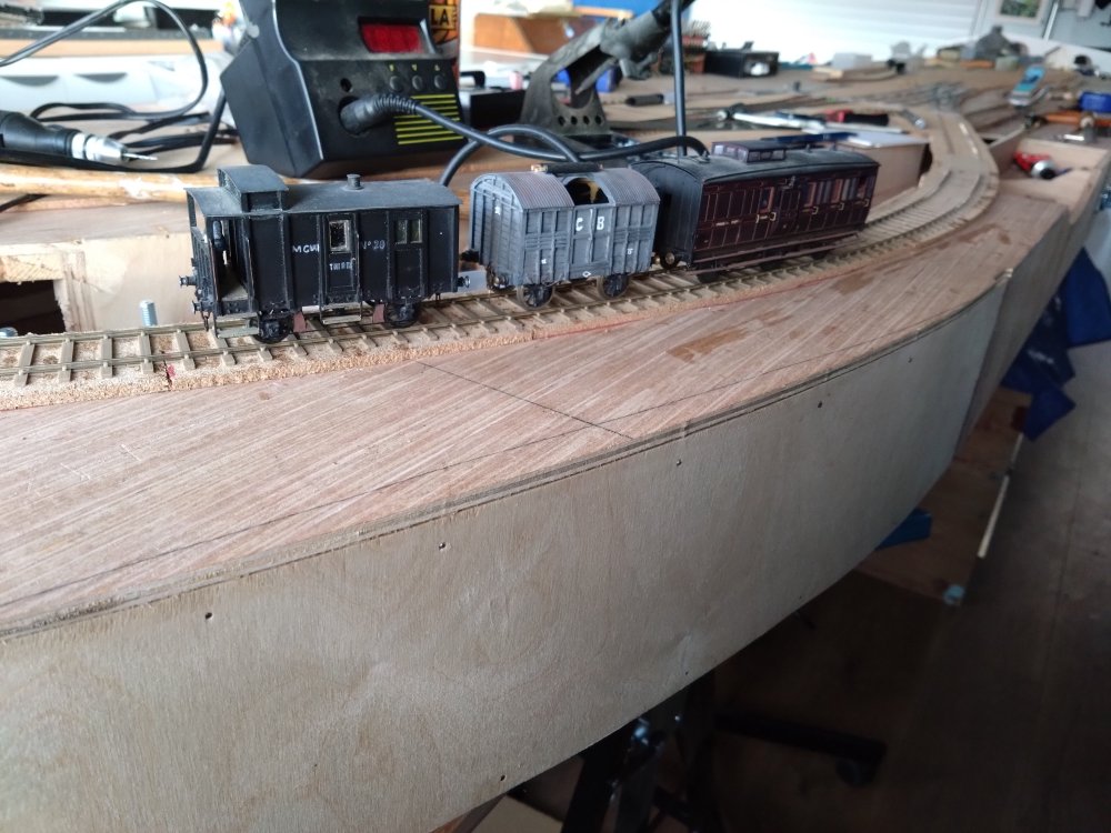

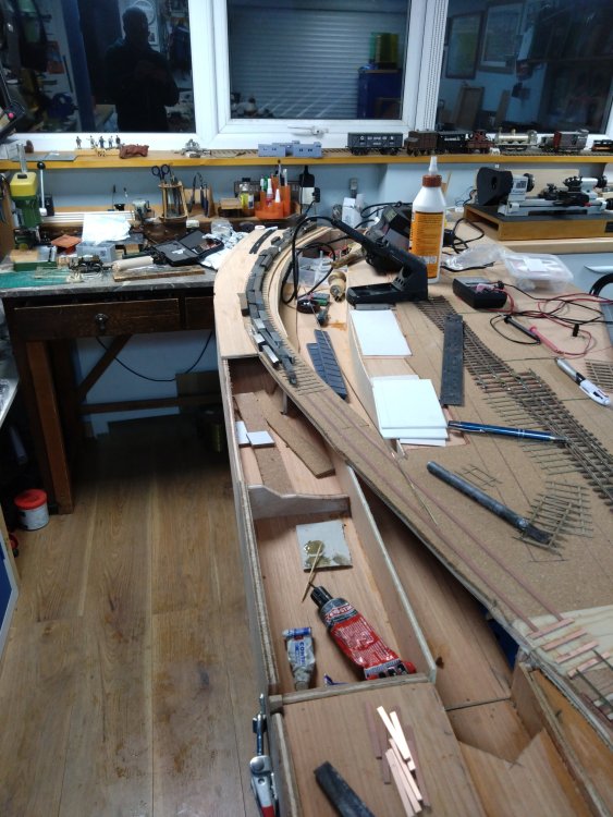

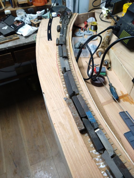

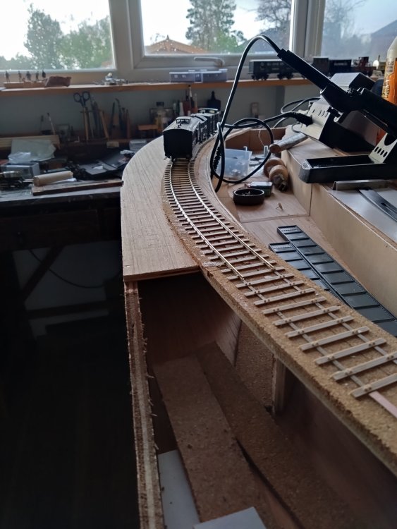

Broadstone Posted January 1 Posted January 1 I have now managed to construct a yard length of track on my layout Broomebridge Junction using Rob's 3D printed track bases and Peco Code 75 rail. I picked a section of track on a 4' radius curve and as the photos show, it looks great. I took my time and learned on the job, but I like that aspect of modelling. I'm really pleased with it and think it looks the part from every angle and is the closest I've come to getting that Irish Broad Gauge spiked FB look - hitherto all my track has lacked spikes and has looked a bit 'naked'! I picked the Liffey Branch from Liffey Junction which in my Broomebridge Junction layout is single track because I dont have the width for the full double track. As I have said it is 4' radius as this an oval continuous run layout. First of all I test glued a length of Rob's sleeper base on the cork using Gorilla woodwork glue and left it overnight. Success, it was glued solid. Secondly I then got enough bases and cut the webs on one side and threaded a yard length of Code 75 rail through before curving and then glueing it down on the cork underlay. Then I weighted it down overnight with loads of tool steel to hold it while it set. I checked the curve against a 4'radius curve I have and made a few adjustments before the glue set. Thirdly, next day I removed the weights then threaded the second rail through. This took some time because the spikes really do hold the rail which is what you want really! Fourthly, I ran some stock up and down and found that at 25.1mm gauge it was a bit tight because you need some gauge widening. I therefore very carefully used a 25.3mm gauge and my soldering iron on a low heat to heat the rail and very gently shift the outer rail outwards by 0.2mm or until the gauge dropped between the rails. Success, all my stock moves through the curve successfully. And the track looks great. Excuse the layout building chaos btw! In future I'll probably thread both rails through before glueing down what would be in effect a length of flexi track. It would also make it easier to curve. These bases are great and the track, even before painting and ballasting, looks really great. Thanks Rob, this a definite game-changer. My problem now is to make sure my pointwork looks as good! 9 8

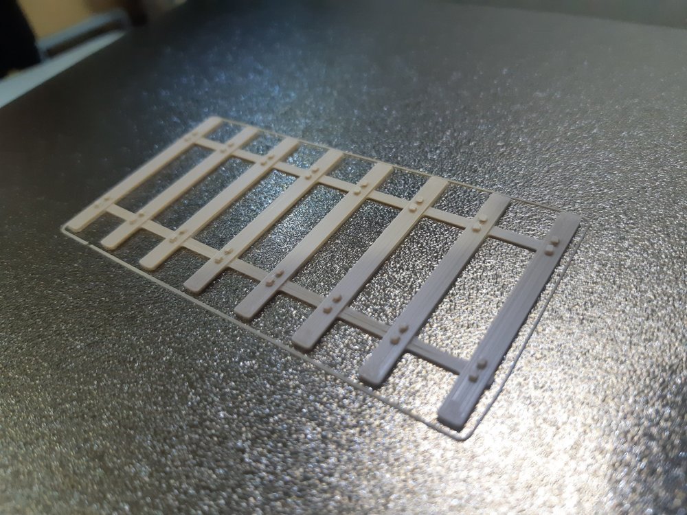

Mayner Posted January 3 Posted January 3 For much of the 20th century the majority of traditional jointed flatbottom track used on Irish main and secondary lines was laid on cast iron baseplated and fixed with fang-bolts (bolt with a large integral washer) to timber sleepers rather than with spikes. Photo from Kiltimagh on the Burma Road, though same baseplate and fixing detail used on the majority of lines laid with FB rail on the CIE system though rail section and baseplate size may vary. e.g 85Lb & 90Lb rail shared the same foot & baseplate width, 95Lb used onmore heavily trafficed lines had a wider foot & baseplate width. A 3D printed track system with a integral baseplate would assist in gauging the track, possibly with a trackpin as 'spike", interestingly American modellers where handlaid track still remains popular spike every 5th tie/sleeper. 3 1 1
David Holman Posted January 4 Posted January 4 Really useful detailing for something I'd not really looked at, with my track being rail soldered to commercial sleepers. The baseplates wouldn't be hard to fabricate, using microstrip, but the fangbolts really stand out and look tricky to do as individual add ons. How easy would it be to 3D print them as cosmetic additions (one for each side of the rail)? Northport Quay would need about 500... 1 1
