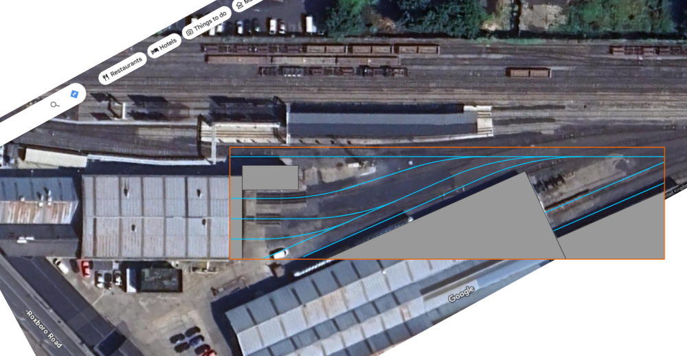

Mol_PMB Posted December 23, 2024 Posted December 23, 2024 Off-topic perhaps for this thread, but this is the sort of thing I'm mulling over for a shunting layout, part of the Limerick wagon works and a tiny bit of the stabling point. Time period would be a bit flexible, mid 1970s to mid 1980s. The available space for the board is shown by the orange rectangle, 1750mm long and 450mm wide. I can fit in the basic arrangement of the yard without much compression, using 1000mm minimum radius curves: The main problem is that the headshunt top right is a bit short for shunting the long siding with a mainline diesel loco, though it wouldn't be so bad with G611 or E428, each of which lived here at one stage. There might be scope for a short headshunt extension but not the full width board; if I did that then I might actually shift the board footprint left a bit to include more of the original WLWR shed. Originally I had thought of viewing the layout from the bottom of the plan, with (at least some of) the six through lines behind, then the retaining wall and the trees as the backscene. But it just becomes way too wide for my space if I do that. So now I'm thinking of viewing from the top of the plan, with the wagon works forming the main backdrop. The two isolated sidings on the right wouldn't be functional but could display some of my growing collection of wagons. Left-hand end of the layout, photographed by Tarkaman in 1988: Looking from the hypothetical extended headshunt, photo by Ernie in 2005: Hmm, lots to think about but I'm afraid it's not a BLT! 2
