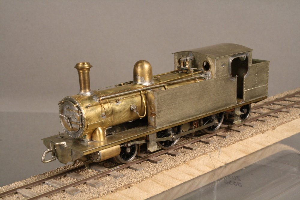

Pete00018 Posted February 4, 2025 Posted February 4, 2025 (edited) Hi All, Just wondering if anyone has built the Worsley Works Passage tank kit (Cork Blackrock and Passage Railway - CBRPR) and how did you find it to assemble? Think I found a ref photo on web of one assembled (attached). Thanks Edited February 4, 2025 by Pete00018 2 1 1

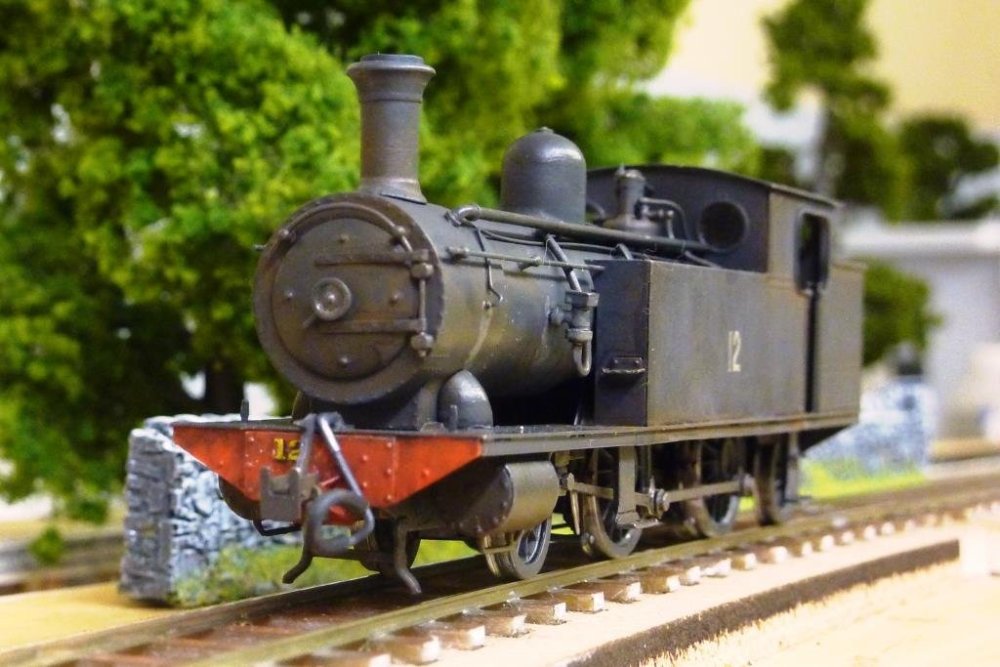

Phil3150 Posted February 10, 2025 Posted February 10, 2025 The photo at the top of this thread is of Simon de Souza's scratch built model. I have also scratch built 12L as pictured Phil 9 1
Tullygrainey Posted February 10, 2025 Posted February 10, 2025 2 hours ago, Phil3150 said: The photo at the top of this thread is of Simon de Souza's scratch built model. I have also scratch built 12L as pictured Phil That is exceptionally good. Beautifully made and perfectly finished. 2 1
