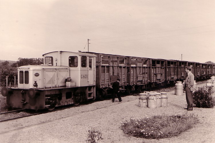

Mol_PMB Posted February 17 Posted February 17 It feels like my E class is on the home straight (and I hope I'm not tempting fate) and as usual my brain is working more quickly than my hands, not always in a helpful way! I'm building my E as E410 on a Fenit theme, and I'm well aware that the G class also worked to Fenit - initially G601s and later G611s. So I was wondering about the options for a G class model. 30-odd years ago I scratchbuilt one in plasticard but it wasn't very satisfactory and is long gone now. I've seen references to several different G class kits, but I'd just like to tap your collective wisdom! In particular, which of the kits would be suitable for 21m gauge and might satisfy my OCD levels? The issue with 21mm gauge is that on the prototype the wheels are very closely spaced inside the frames, so that when using the correct gauge and slightly overscale width wheels, they definitely don't fit behind frames made overscale thickness. It appears that Silver Fox do a resin cast G601, which looks OK if a little basic, but with a one-piece resin chassis that looks like it isn't suitable for 21mm gauge: IR / IÉ 601 Class (G Class) 0-4-0 Deutz | Silver Fox Models Then there's the DC Kits G611, looks a bit tidier but again I'm unsure if this would be suitable for 21mm gauge? CIE/Irish Rail Class G Shunter The third option I've identified is the Worsley Works etched kit for a G611. This looks like it might be suitable for 21mm gauge though I'm not 100% sure: Irish Railways Deutz Diesel CIE Coras Iompair Eireann in 4mm Scale My gut feel is that the Worsley Works G611 is most suitable, but I'd be interested to hear from anyone who has built one of these to 21mm gauge. Also, are there any options for the G601 suitable for 21mm gauge? If this turns out to be too hard, I can always just build another E class! Many thanks, Mol Quote

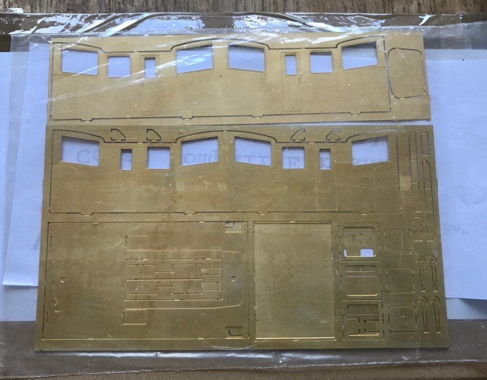

Mol_PMB Posted February 22 Author Posted February 22 Well after placing an order yesterday afternoon, this was just delivered to my door by Allen himself. Can't get much better service than that! The kit doesn't include a chassis, and Allen says it never has done. However, he did put in a couple of nickel silver strips that I can use as a starting point, which was very helpful. The comments in some of the linked threads about the cabsides being in the wrong orientation on the original etch are correct - hence the provision of a second cab etch with them the right way round. Of course this has me wondering about rebuilding the 'wrong' cab as a G601, and if that works then buying a second kit to finish it off. It will have to join the queue as I definitely have too many projects on the go! 4 Quote
Horsetan Posted February 22 Posted February 22 5 hours ago, Mol_PMB said: ... The kit doesn't include a chassis, and Allen says it never has done. However, he did put in a couple of nickel silver strips.... Interesting that the website doesn't mention that omission.... Quote
Mol_PMB Posted February 22 Author Posted February 22 11 minutes ago, Horsetan said: Interesting that the website doesn't mention that omission.... The website does describe it as "CIE G CLASS DUETZ DIESEL 1961 - 1977: Complete Body Kit for the D611 type - No castings." so one wouldn't expect a chassis in a body kit. I won't pick out the typos... However, I found some descriptions of building it which said it came with a 21mm gauge chassis. The wheelbase is 33mm, I'll have to start sketching up some drive options. There are a few oddities, such as there being holes apparently for handrail knobs in the cab backsheet, where there are no handrails on the prototype. Meanwhile there is no provision for the built-in lamps on the cab backsheet of a G611. On the G611, the cabside handrails are set into recesses on the prototype, which could have easily been provided on the etch, but are not. Although in most areas it's a G611, there are some aspects which are more like a G601. However, the Worsley products are sold as scratch aids rather than full kits, and in that context it's certainly a massive step ahead of some blank sheets of brass. It's also inexpensive at £33. So I'm not complaining, and I look forward to adding to my shunter fleet. 2 Quote
Horsetan Posted February 22 Posted February 22 3 hours ago, Mol_PMB said: The website does describe it as "CIE G CLASS DUETZ DIESEL 1961 - 1977: Complete Body Kit for the D611 type - No castings." so one wouldn't expect a chassis in a body kit. I won't pick out the typos... However, I found some descriptions of building it which said it came with a 21mm gauge chassis..... This one suggests there is a fold-up chassis in the pack.... 1 Quote
murrayec Posted February 22 Posted February 22 23 minutes ago, Horsetan said: This one suggests there is a fold-up chassis in the pack.... The WW Kit provides outer frames in the etches, but does not include frames for a chassis. Most builders, but not all, use a 'spud' or Blackbeetle motor bogies for power so all that is needed is a cross support to mount the bogie off....... Eoin 1 Quote
Mayner Posted February 22 Posted February 22 9 hours ago, Mol_PMB said: Well after placing an order yesterday afternoon, this was just delivered to my door by Allen himself. Can't get much better service than that! The kit doesn't include a chassis, and Allen says it never has done. However, he did put in a couple of nickel silver strips that I can use as a starting point, which was very helpful. The comments in some of the linked threads about the cabsides being in the wrong orientation on the original etch are correct - hence the provision of a second cab etch with them the right way round. Of course this has me wondering about rebuilding the 'wrong' cab as a G601, and if that works then buying a second kit to finish it off. It will have to join the queue as I definitely have too many projects on the go! Interestingly the original version of the WW G (cabsides wrong orientation) was supplied with a simple fold up 21mm N/S chassis complete with 2 nylon worm & gear sets! Even more interestingly Jeremy Fletcher talks about a fold up 21mm gauge gear box supplied with the parts on his article on building the loco on the WW website https://www.worsleyworks.co.uk/Image-Pages/Image_4mm_Deutz-3.htm Photos of Mike Edge (possible pattern for DC G Class) & Jeremy's G Class indicate that at one stage the WW G was supplied with plastic spring and axlebox castings. I still have the original 21mm gauge fold up chassis supplied with my G Class, perhaps some day get around to motorising it with my own drive based on a High Level QuadDriver or more likely a drive designed by Paul. I used a scratchbuilt chassis to power the loco while running in OO, basically two plain strips of brass and commercial turned frame spacers possibly supplied with an SSM J15! 1 Quote

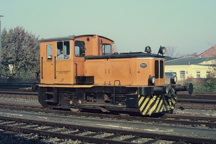

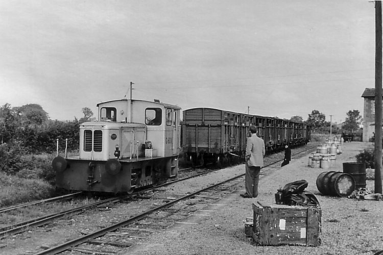

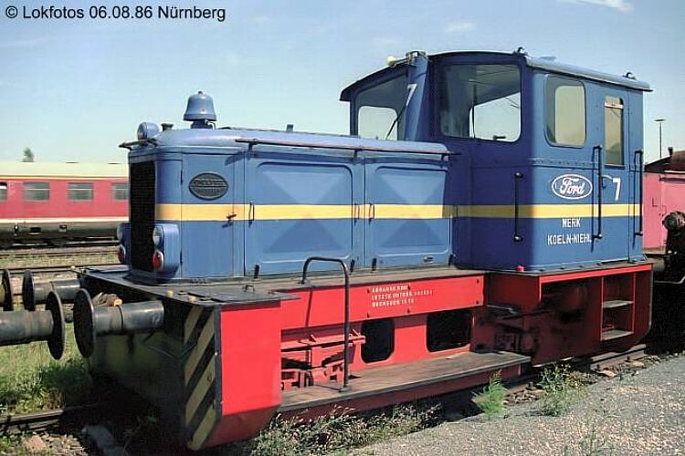

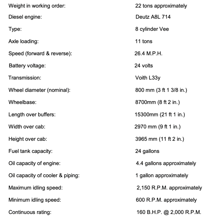

Mol_PMB Posted April 10 Author Posted April 10 I have been doing some more research on the G class, prompted by a discussion with @jhb171achill last weekend about the dimensional accuracy of some G class models. I haven't seen any official drawings of the G class so I've been looking into the origins of the design. Here's a nice photo of the preserved G601, from Jonathan Allen on Flickr: These small shunters are a variant of the widespread German Köf II design, of which over 1000 were built. The standard Köf II was a much squatter loco, because it was designed to be moved long distance on a flat wagon. Nevertheless, if you look at the photo below you'll see some common features with G601 above, things like the axleboxes and springs, oblong holes in the main frames, bonnet access doors, cab front windows. https://en.wikipedia.org/wiki/DRG_Kleinlokomotive_Class_II There are dimensioned drawings of the Köf II here: http://www.industriespoor.nl/tekeningDeutzA6M517.htm https://www.gartenbahn-werkstatt.de/de/zeichnungen/horst-dieter-hettler/diesel-lokomotiven/ https://www.woernitz-franken.de/koef.htm There are however several differences from the Köf II, not just the cab but the engine, which is air-cooled on a G but water-cooled on the Köf II. The G601 class is a Deutz model A8L 614 R, a variant of the Köf II produced in smaller quantities for industrial users in Germany, the Netherlands and elsewhere. There's more information on the A8L 614 R here, including drawings on all three websites: http://www.industriespoor.nl/tekeningDeutzKK130B.htm https://cftr.evolutive.org/amateur/engins_moteurs/Deutz_e.php https://www.rangierdiesel.de/index.php?nav=1405415&lang=1 Here's a Flickr photo from Alex Leroy illustrating one of them, with a clear resemblance to the G601s. The cab, bonnet and frames appear identical, but the bufferbeams and running plates are different, and the frames are closer together to suit 1435mm gauge. So it should be possible to carry over many of the A8L 614 R dimensions (from the drawings linked above) and check against the G class. Searching for A8L 614 R on the rangierdiesel website gives a list of 67 locos, which include G601 (Deutz 56119), G602 (Deutz 56118), G603 (Deutz 56120); note they are not in order. https://www.rangierdiesel.de/index.php?view=fahrzeuge&object=A8L+614+R&nav=1406157&lang=1&action=results Clicking on 'typengalerie' and selecting Deutz and A8L 614 R gives a gallery of hundreds of images of these locos across Europe, which have a great deal in common with the G601s, although they mostly have a low-level running board rather than a footplate at cab floor height. Here's an example: http://www.rangierdiesel.de/images/basic/deutz_56744_58.jpg There are even three photos of G601 at work which I hadn't seen before: http://www.rangierdiesel.de/images/basic/deutz_56119_51.jpg http://www.rangierdiesel.de/images/basic/deutz_56119_52.jpg http://www.rangierdiesel.de/images/basic/deutz_56119_53.jpg Some of the later A8L 614 R class had the larger windows of the G611s: http://www.rangierdiesel.de/images/basic/deutz_57236_53.jpg So, what about the G611s? These were an improved model with more power, designated A8L 714 R. Searching for A8L 614 on the rangierdiesel website gives a list of just 7 locos - our familiar G611 class. https://www.rangierdiesel.de/index.php?view=fahrzeuge&object=A8L+714+R&nav=1406157&lang=1&action=results The list gives works numbers as: G611 (Deutz 57225), G612 (Deutz 57224), G613 (Deutz 57226), G614 (Deutz 57228), G615 (Deutz 57223), G616 (Deutz 57227), G617 (Deutz 57229); note they are not in order. There's also a link to a photo of the preserved G613. Later, the model designation became KK140 B, such as this example on Flickr from Helgoland01. This may have had a different engine, but I'm not sure. Note the light clusters similar to the G611s but positioned differently: My next step is to overlay the 3 drawings of the A8L 614 R and compare to the Worsley Works etched parts, and we'll see where we go from there... 5 1 5 Quote

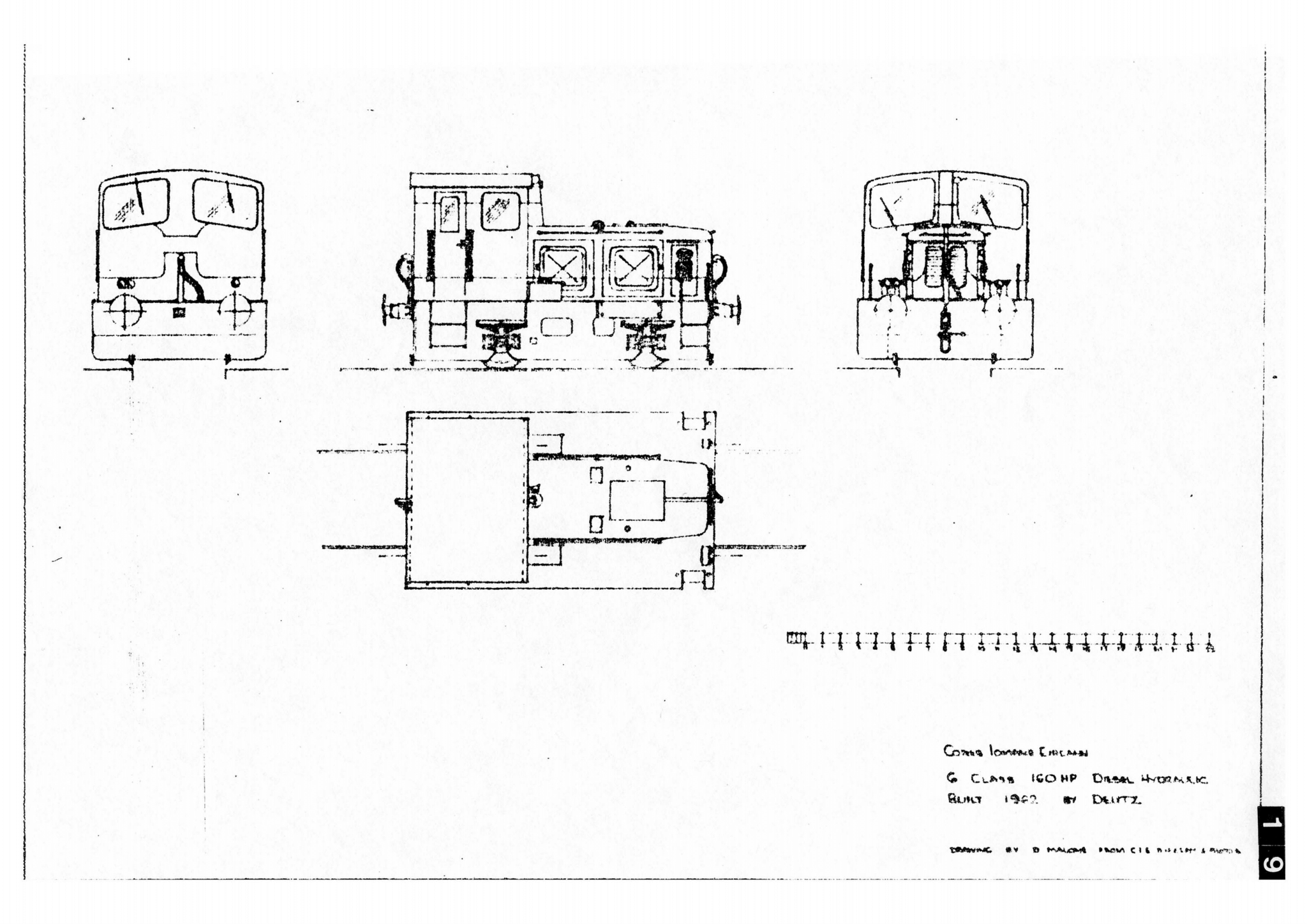

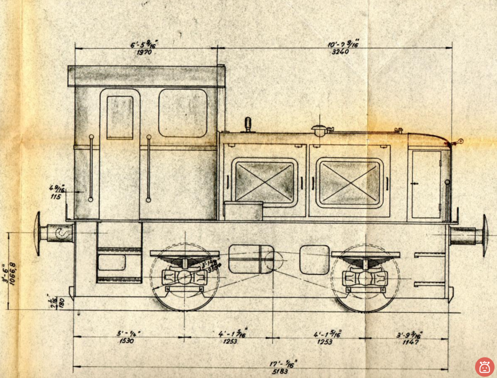

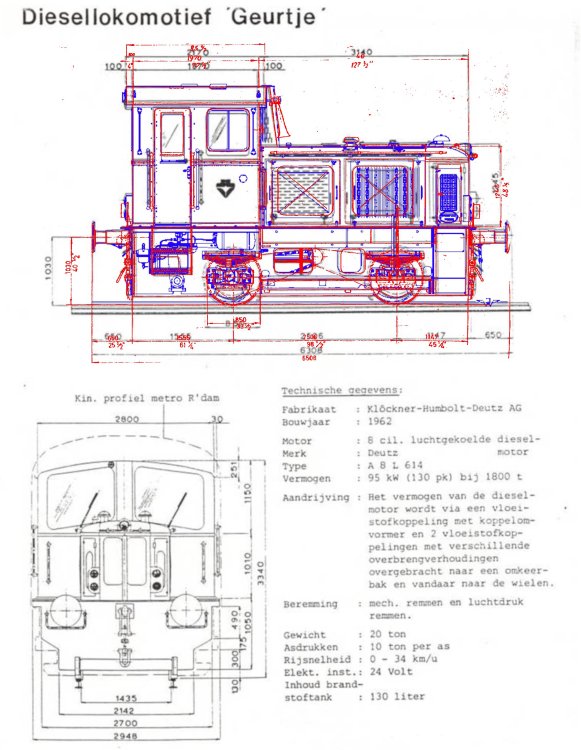

Mol_PMB Posted April 13 Author Posted April 13 I've tried scaling, aligning and overlaying the 3 drawings of the German/Dutch version. They're similar but not quite identical in shape. I also found this elsewhere on the forum, so now I need to try and overlay this too. It's not great quality though = does anyone know of a better version? 5 1 Quote
GSWR 90 Posted April 28 Posted April 28 (edited) I assume that this is a drawing of a G601 as it does't have recessed handrails, it has the straighter exhaust, and it doesn't have vacuum bags or marker lights. However it doesn't have the air horn which the 601s did have and the 611s didn't have (since the 611s had vac loco brakes) The below details are for G611s. If you're making a model, remember to add the exhaust whistle (video of whistle in action) and the small electric horn at the top of the front of the cab as well as the obligatory can of easy start. If you want any measurements, please let me know and I can do it in person on G617 Edited April 29 by GSWR 90 5 2 Quote

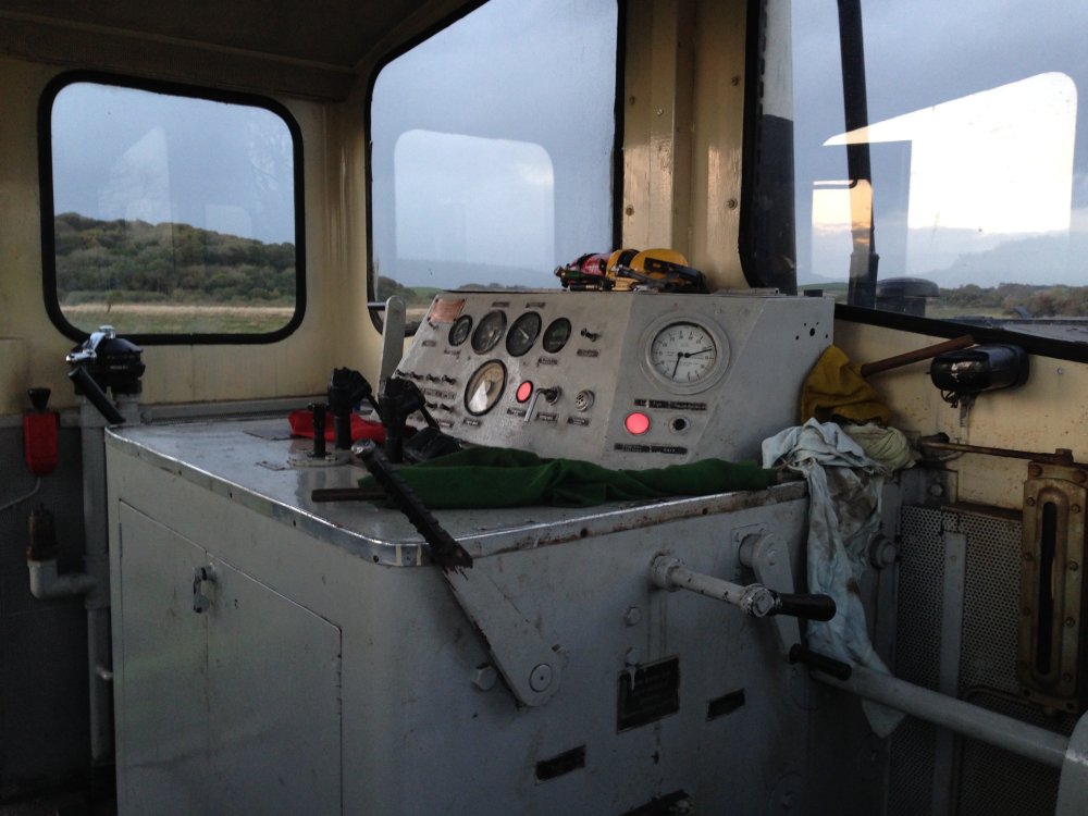

Blaine Posted May 1 Posted May 1 On 29/4/2025 at 12:47 AM, GSWR 90 said: The below details are for G611s. If you're making a model, remember to add the exhaust whistle (video of whistle in action) and the small electric horn at the top of the front of the cab as well as the obligatory can of easy start. If you want any measurements, please let me know and I can do it in person on G61 They had electric horns, similar to what you would find on a car (beep beep), the air horns are a more recent addition in DCDR days. Less said about the whistle the better 1 hour ago, jhb171achill said: A friend from AAFB, the Mallorcan preservation / railway historical society, told me that spares for these were still very readily available (well, in 1993 anyway). Exact same engine, apparently, as G611-7. They were an off the shelf design, so parts availability was quite easy. Deutz as a company still survive, but no longer making railway equipment 3 Quote
GSWR 90 Posted May 1 Posted May 1 6 hours ago, Blaine said: They had electric horns, similar to what you would find on a car (beep beep), the air horns are a more recent addition in DCDR days. Less said about the whistle the better G617 and G611 both have their electric horns still, G613 has it I think but it doesn't work so there's a pair of electric air horns in the bonnet. Unfortunately G617 has no whistle and I don't think G601 has it either, not sure about G616. The 601s had an air horn (originally with a cowl on top) on the front of the cab – I assume that means that they had air loco brakes, which would have been a handy addition to the 611s Quote

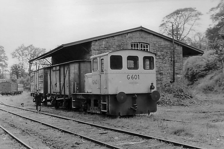

David Holman Posted May 3 Posted May 3 Looking at one of your earlier pictures, the loco only has three link couplings, so chances are it might also only have a mechanical hand brake, operated by a wheel in the cab, as per a steam loco. Presumably, when the Gs were used to operate mixed trains, a vacuum or air brake must have been fitted, along with screw link couplings. Given that there were two batches, could this have been fitted to the later ones from the start? There were other differences too, in cab windows. Quote
Mol_PMB Posted May 4 Author Posted May 4 On 29/4/2025 at 12:47 AM, GSWR 90 said: I assume that this is a drawing of a G601 as it does't have recessed handrails, it has the straighter exhaust, and it doesn't have vacuum bags or marker lights. However it doesn't have the air horn which the 601s did have and the 611s didn't have (since the 611s had vac loco brakes) The below details are for G611s. If you're making a model, remember to add the exhaust whistle (video of whistle in action) and the small electric horn at the top of the front of the cab as well as the obligatory can of easy start. If you want any measurements, please let me know and I can do it in person on G617 That's wonderful, many thanks! Sorry for the delayed response, I've been away on hols for two weeks and only now catching up. Cheers, Mol Quote
Mol_PMB Posted May 4 Author Posted May 4 On 3/5/2025 at 7:06 AM, David Holman said: Looking at one of your earlier pictures, the loco only has three link couplings, so chances are it might also only have a mechanical hand brake, operated by a wheel in the cab, as per a steam loco. Presumably, when the Gs were used to operate mixed trains, a vacuum or air brake must have been fitted, along with screw link couplings. Given that there were two batches, could this have been fitted to the later ones from the start? There were other differences too, in cab windows. The G611s were delivered with vacuum train brakes and screw couplings, as seen in this NLI image on Flickr dated February 1962, and showing at least 5 of the class: This photo shows them in green livery, and G613 also carries a cabside number. The locos were repainted in black'n'tan before entering service. There were quite a lot of other detail differences between the G601 and G611 batches, including windows, grilles, lights, frame and footplate cutouts, waist strip around cab, handrails. 1 1 Quote
Mayner Posted May 4 Posted May 4 (edited) On 3/5/2025 at 6:06 PM, David Holman said: Looking at one of your earlier pictures, the loco only has three link couplings, so chances are it might also only have a mechanical hand brake, operated by a wheel in the cab, as per a steam loco. Presumably, when the Gs were used to operate mixed trains, a vacuum or air brake must have been fitted, along with screw link couplings. Given that there were two batches, could this have been fitted to the later ones from the start? There were other differences too, in cab windows. G601-3 were acquired as part of an experiment to operate goods trains on the Banagher, Newmarket and Castleisland branches on which regular services ceased during the 1947 fuel crisis. G601 survives with the ITG https://www.irishtractiongroup.com/loco/g601 members who have worked on the loco should have information on the braking system. I measured up the loco at Carrick before the cab and engine housing was encased in metal cladding. Apart from 3 link couplings, no train brake and different cab windows the arrangement of shunter's steps and running plate at the front of the loco is different between the G601 & G611 Class. One G611 Class duty was Liffey Junction Pilot which included a weekly? Edenderry goods working and occasional goods trains on the Meath Road after Clonsilla-Navan closed to regular traffic (62 or 63) The final goods working over the southern section of the Meath Line was a Liffey Junction-Drumree Cattle Special with special permission to load to 15 wagons, nothing heavier than a G allowed because of the poor state of the track! The G ran to Kilmessan to recover a single wagon after placing the cattle wagons at Drumree. Apparently the rails on the cattle bank sidings at Drumree were grass grown the G struggled to achieve traction and some teens from local farms helped by push the loco and laden wagons out onto the 'main line' There is an account of the story by 'Spare Link' in one of the Great Southern Preservation Society newsletters of the 80s Edited May 4 by Mayner 4 1 2 Quote
