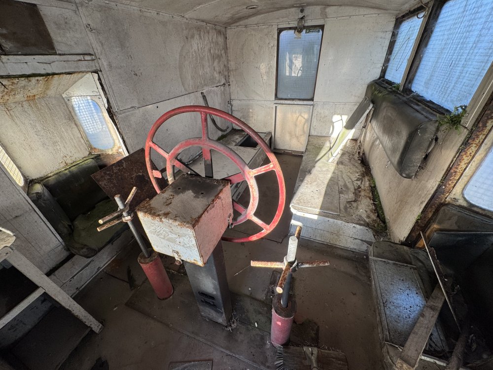

Speaking of beds on railway vehicles, I remember back in the late 1970's when the new ballast plough vans were being fitted out in the carriage shop. That there was a bed base made from plywood fitted in the van for staff? If someone has further information? My claim to fame on the plough van ,was doing some glazing with another guy on just one of the vans. Paul.....

Here is the inside of the plough van at Downpatrick, 24852 built 1978. Definitely looks like those two benches were once beds

That's them alright, thanks for the photo. That's certainly a flashback.

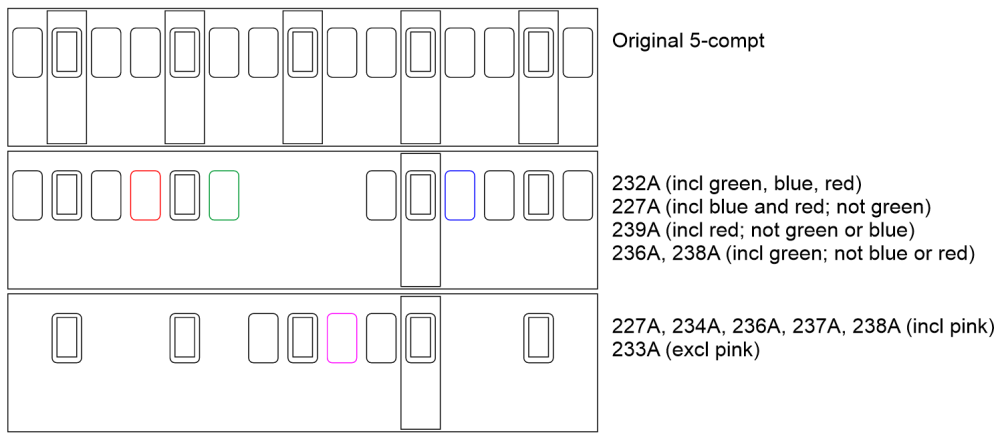

This is a diagram, not to scale, showing the former 5-compartment coaches converted to sleeping cars. The arrangement seems to have been reasonably consistent but with subtle variations between coaches. I don't have photos of both sides of all vehicles, but there are enough to show that there were distinctly different window arrangements each side.
The top diagram shows an unmodified 5-compartment coach.
The middle diagram shows the side which retains windows near the ends, but the windows near the middle are blanked. The black windows are present on all vehicles, whilst the coloured ones are more variable and may or may not be present.
The bottom diagram shows the opposite side, which retains windows in the middle but most windows at the ends are blanked. Almost all vehicles are the same on this side, just 233A has one extra window blanked.
In all cases, only one door remains in use on each side. They have all been significantly re-panelled too.
247A appears to have started life as a 6-compartment coach. All the photos I've found so far show the same side, which retains windows in the middle but most windows at the ends are blanked, similar in principle to the 5-compartment coaches but of course they are in slightly different places:
224A was a former 4-compartment coach and was quite different, retaining its panelling and almost all of its windows, as well as 2 doors remaining usable. I haven't found a photo of the other side. Not much point doing a diagram of this as so little has changed:
Now, SSM make kits for 4-compartment and 6-compartment coaches, but not the most common 5-compartment... Worsley works do make a 5-compartment though I'm not sure how the kits compare in style and dimensions.
I'm also not certain that the prototype coaches were all the same length.
