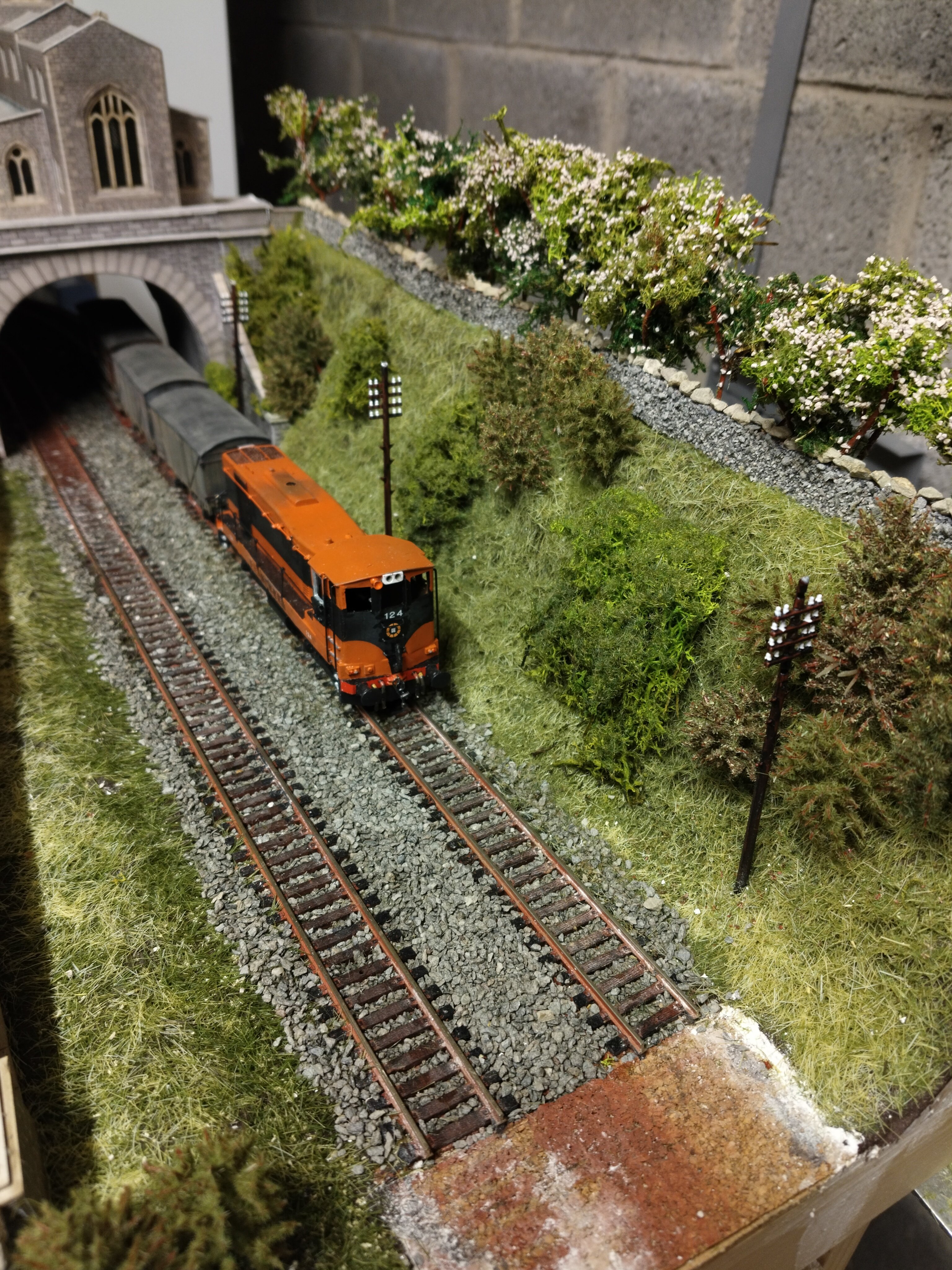

Popular Post dropshort105 Posted April 26, 2025 Popular Post Posted April 26, 2025 (edited) Edited 18 hours ago by dropshort105 20 2

dropshort105 Posted April 26, 2025 Author Posted April 26, 2025 I have been collecting bits and pieces and planning to build a layout for 40 years, I have finally started building it. 2 1
leslie10646 Posted April 26, 2025 Posted April 26, 2025 Brother, that is truly remarkable for a "First effort". You'll soon be challenging for the "Top Spot" here if you keep this up! 3
Patrick Davey Posted April 26, 2025 Posted April 26, 2025 Lovely scenes!! Now you have got started, keep going!!! Thanks for posting. 1 1
jhb171achill Posted April 26, 2025 Posted April 26, 2025 Superb, as are the scenic details. I love the oul ruined cottage! 1

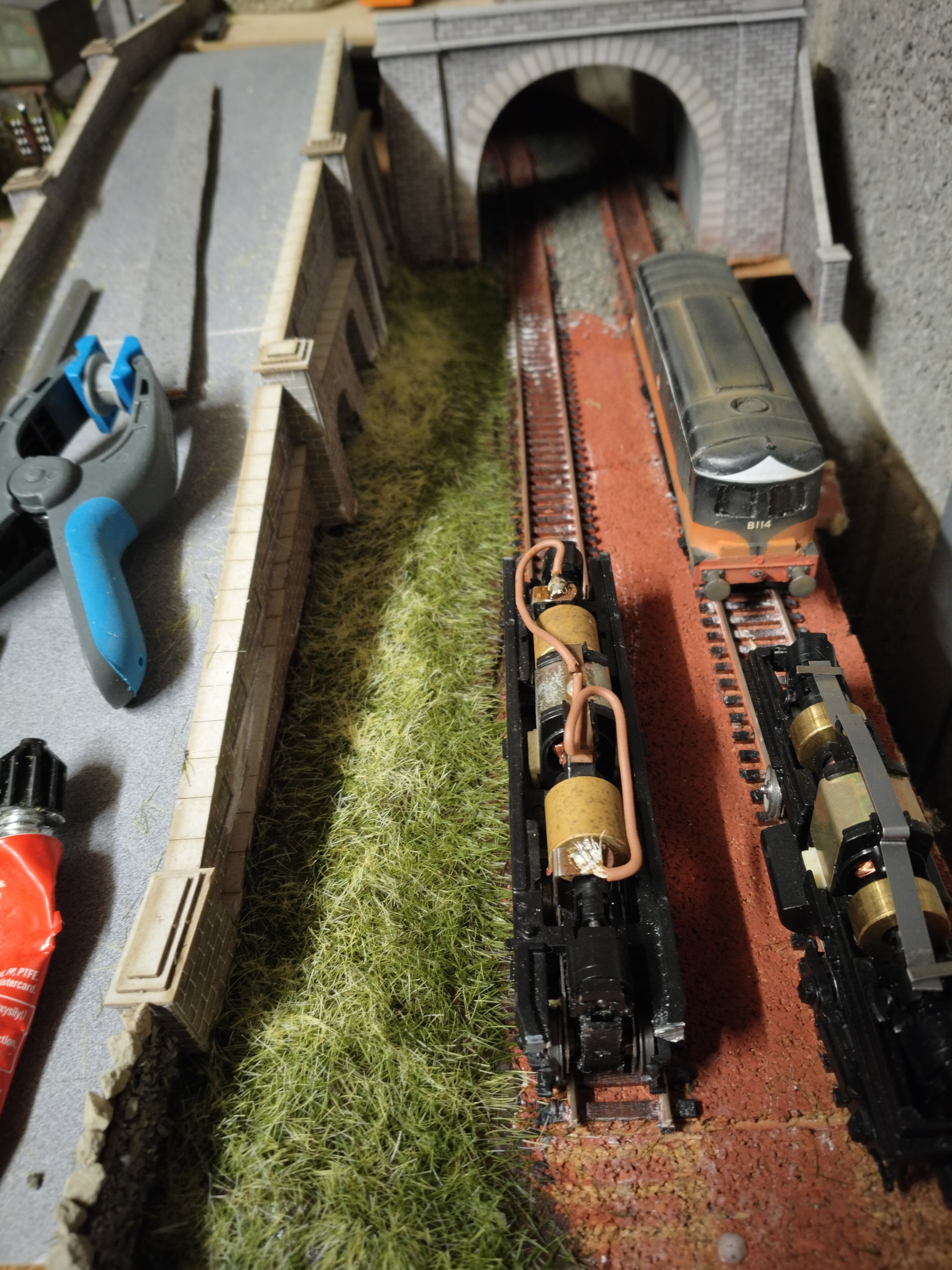

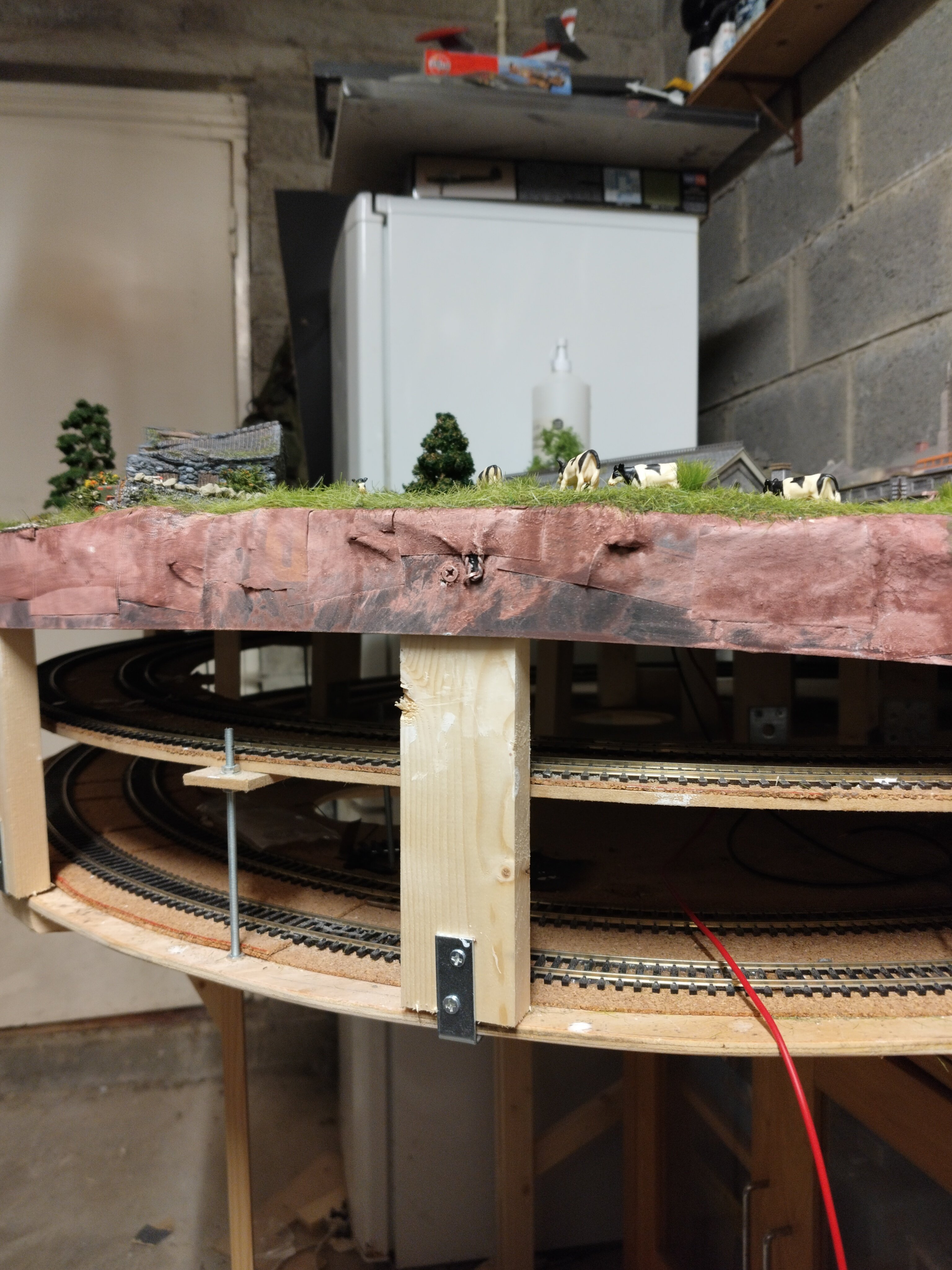

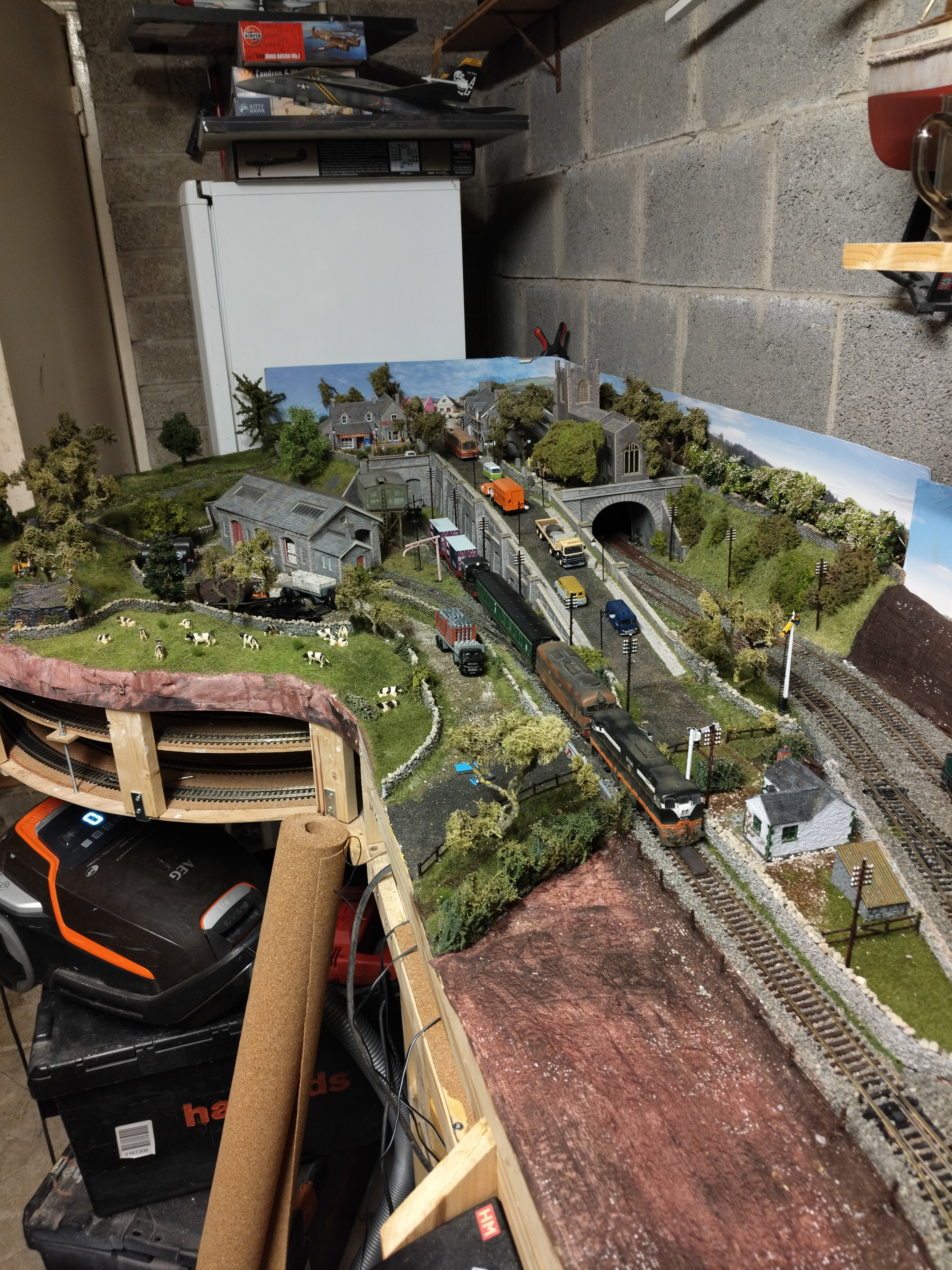

dropshort105 Posted April 27, 2025 Author Posted April 27, 2025 The landscape is hiding one of two planned Helix leading to a subterranean fiddle yard, at least that's the plan, trains disappear into the tunnel down the helix and park up for a while and a different train appears at the station. 3 1

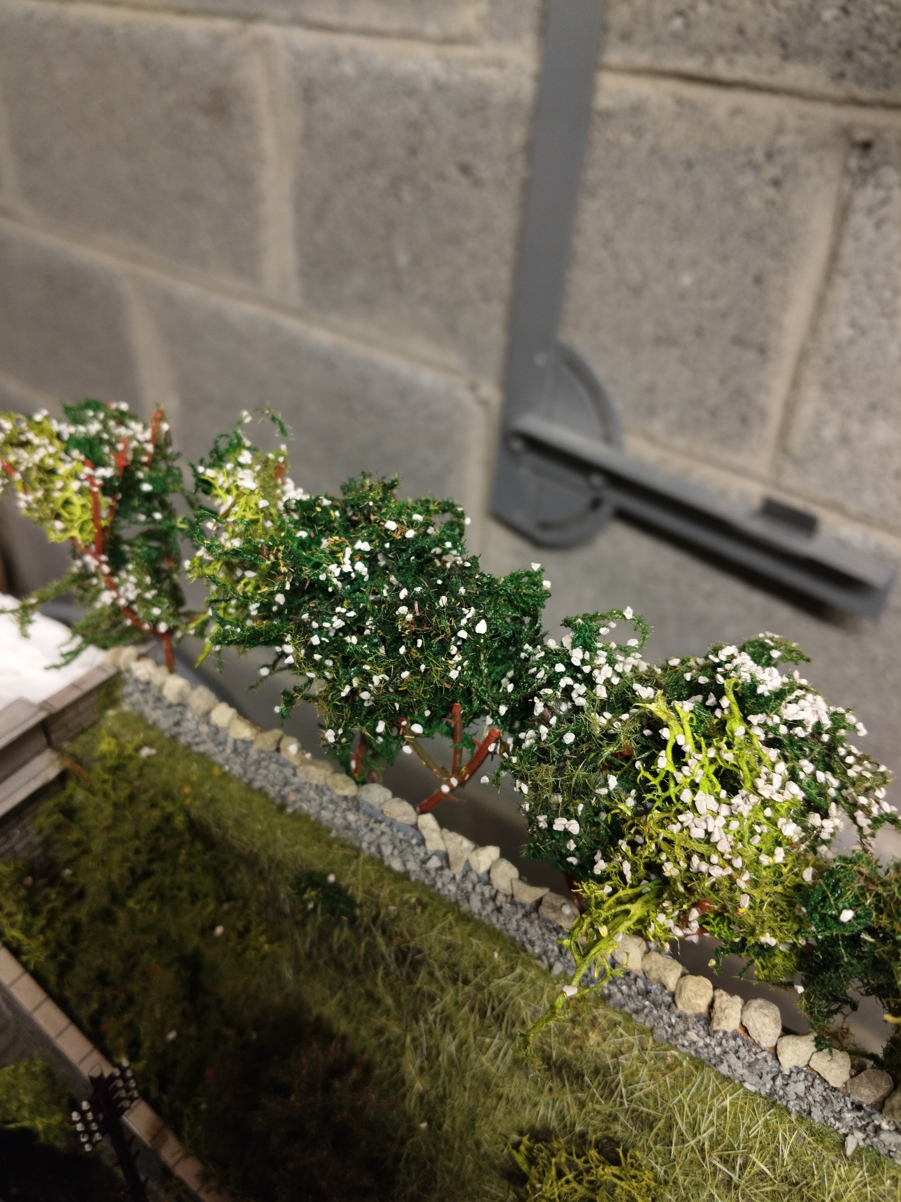

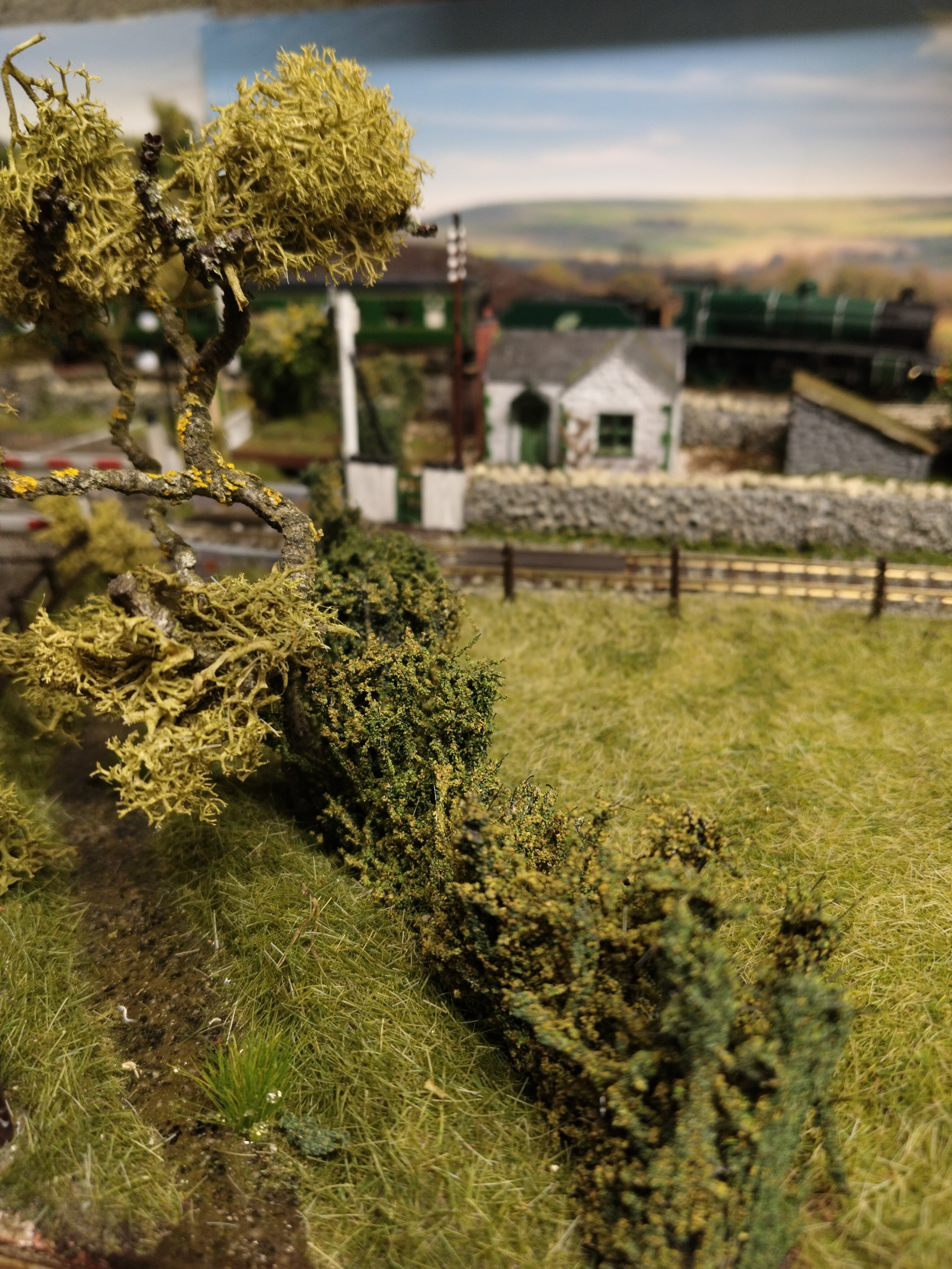

dropshort105 Posted May 17, 2025 Author Posted May 17, 2025 Tunnel mouth is done, my mother loves the whitethorn trees at this time of year so I figured I would try making some, I'm happy with the result. 12 4

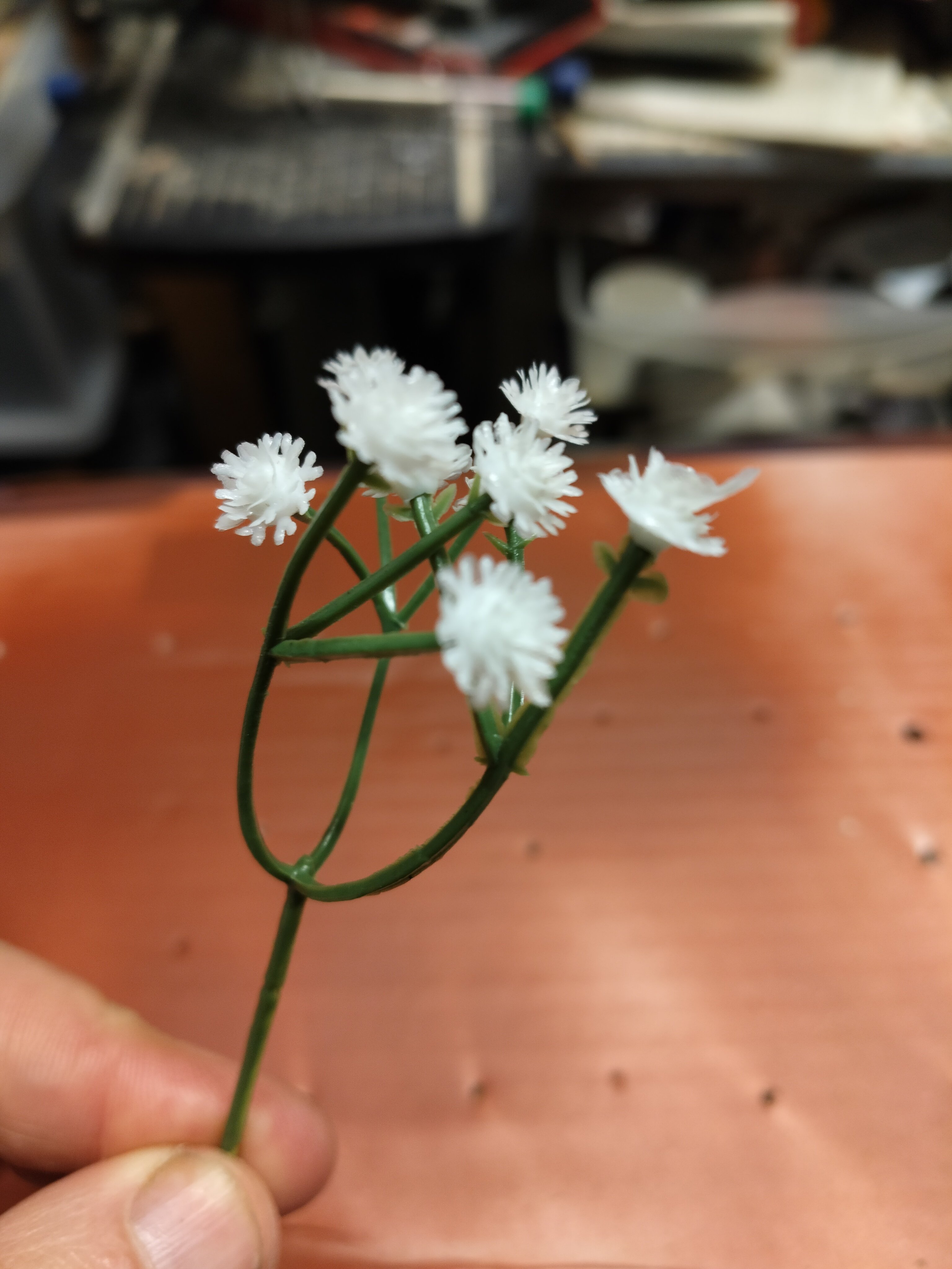

jhb171achill Posted May 17, 2025 Posted May 17, 2025 Those bushes really look the part. Substitute yellow, and you've gorse too. How did you make them?

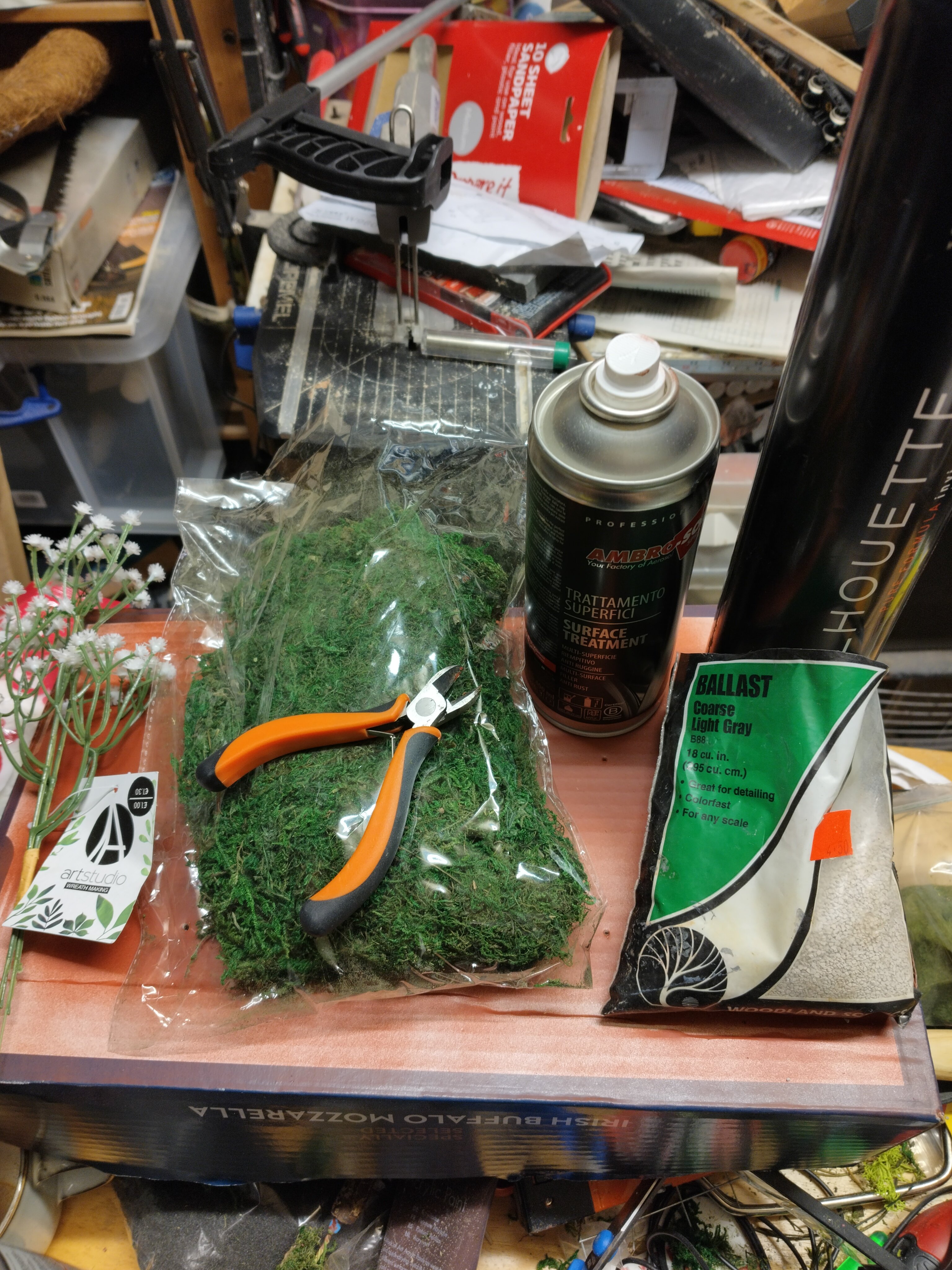

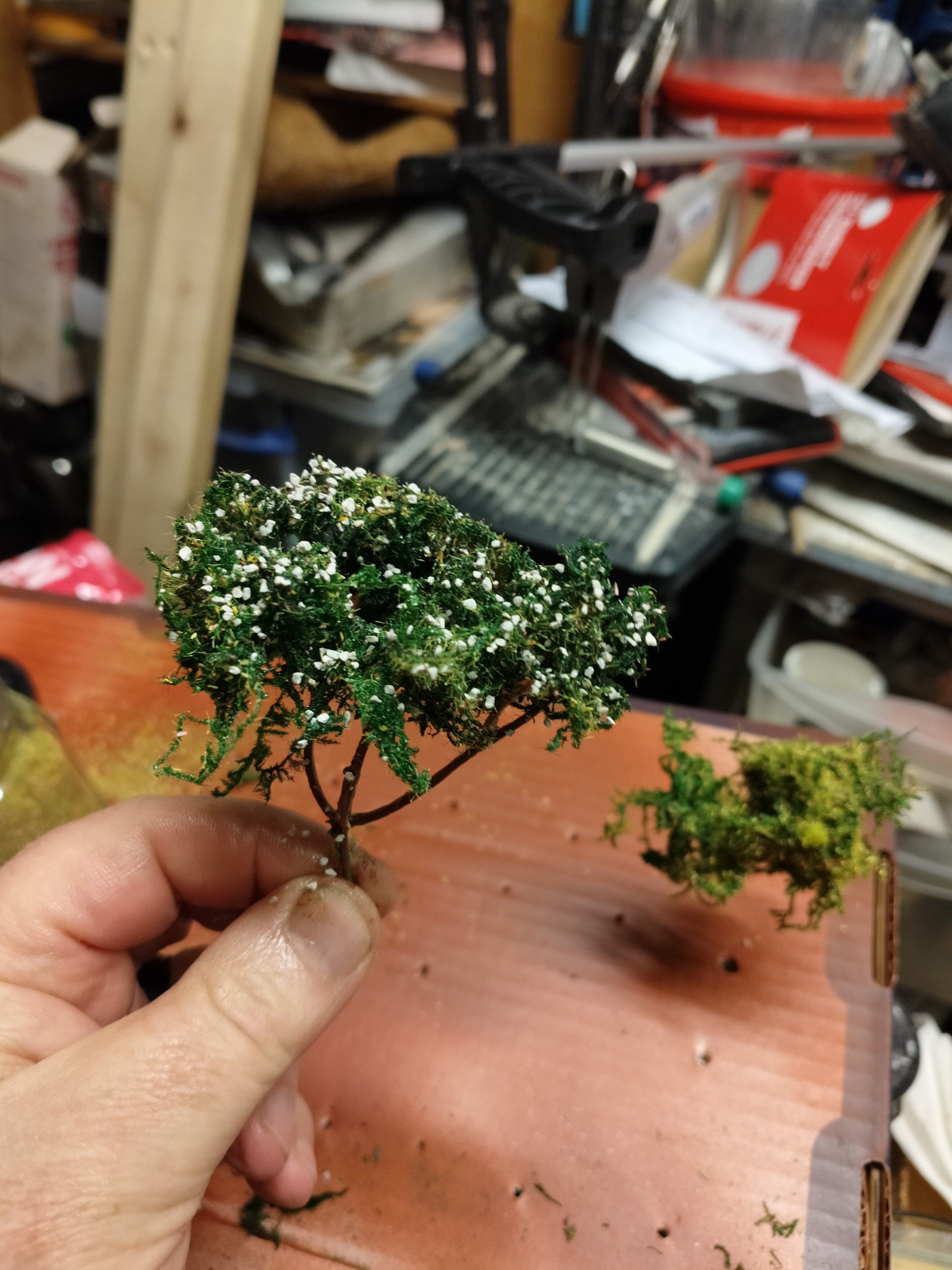

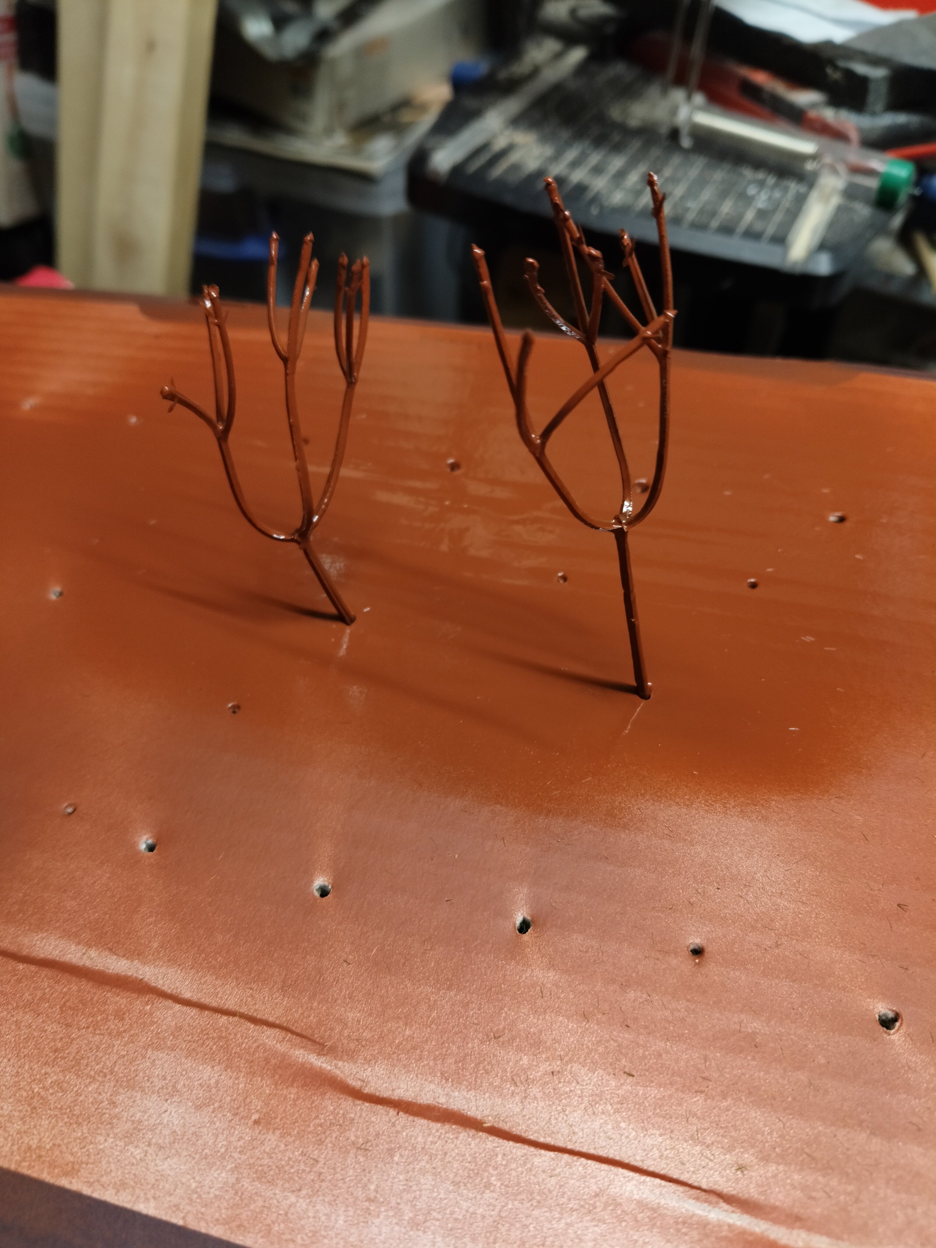

dropshort105 Posted May 18, 2025 Author Posted May 18, 2025 9 hours ago, jhb171achill said: Those bushes really look the part. Substitute yellow, and you've gorse too. How did you make them? I will make some more today and take some pics of the process, it only takes a couple of minutes. 4

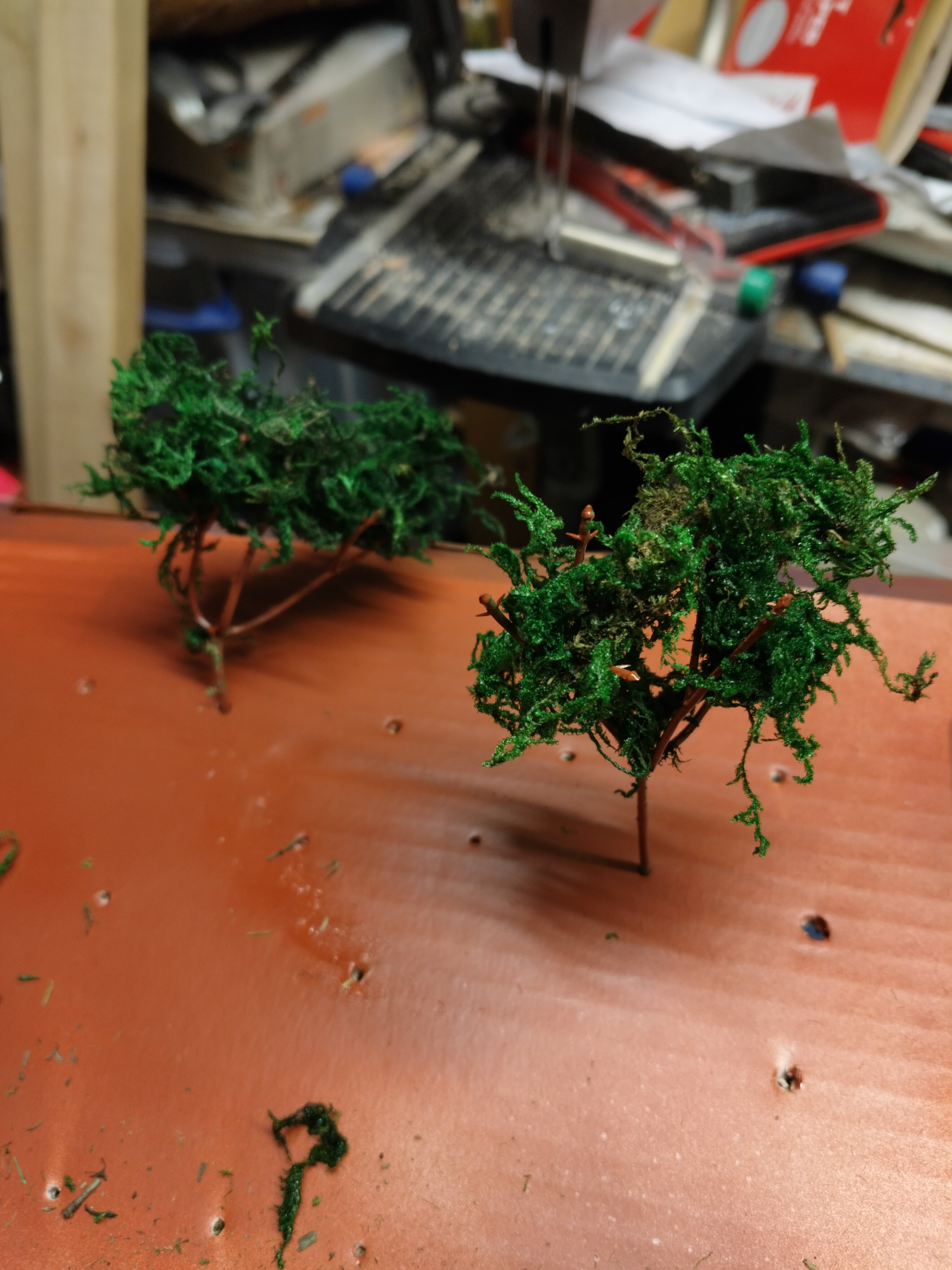

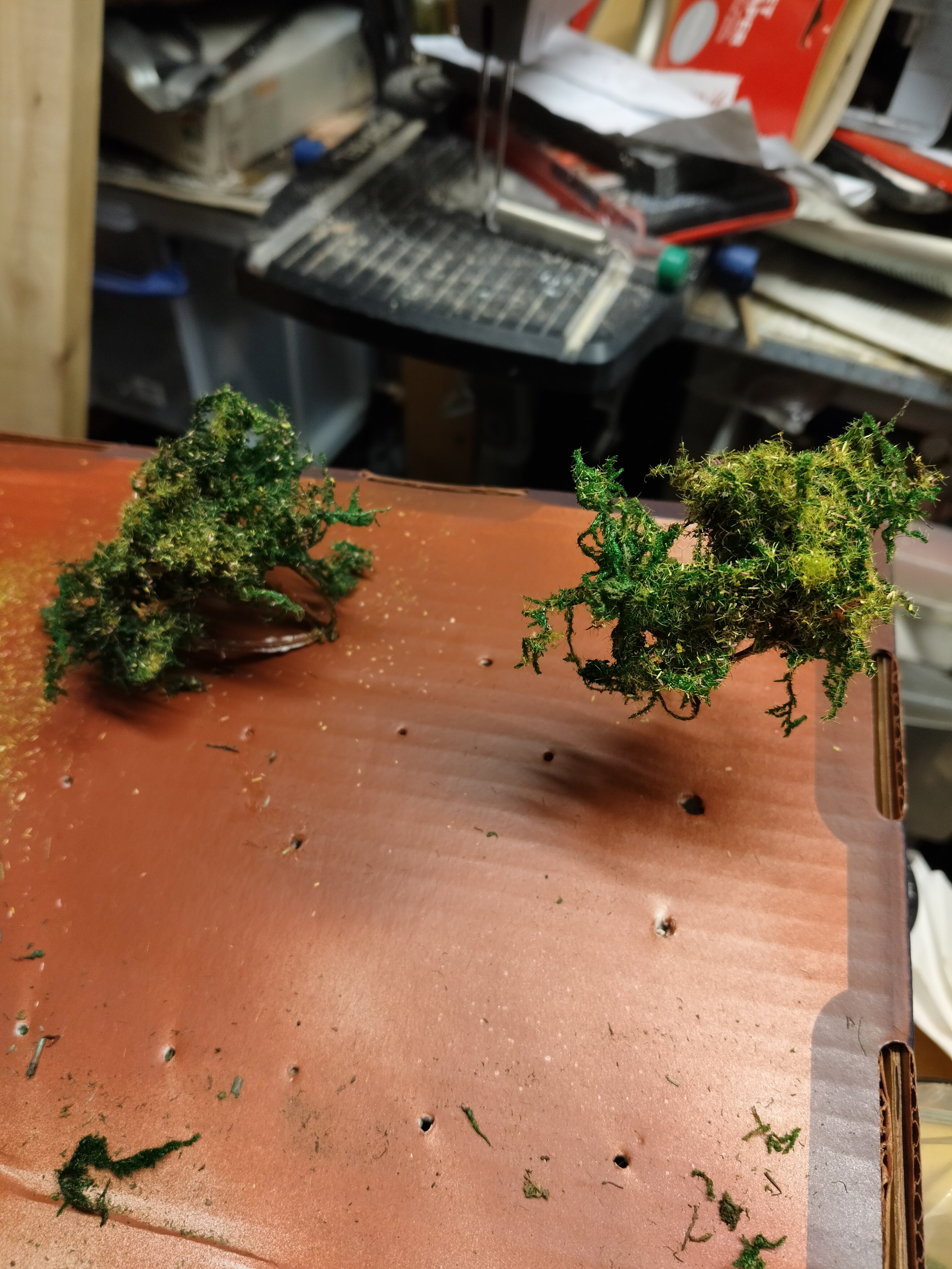

dropshort105 Posted May 18, 2025 Author Posted May 18, 2025 Plastic flowers and dry moss from The Range, some brown paint, hairspray, important safety tip ( do not steal it from your wife ). Some green scatter and some light gray coarse ballast, although I'm sure some household condiments like semolina would work just as well. Clip off a couple of the stems, pull the flowers off and chuck em, they are way too big. Paint the stalks. Shove dry moss in between the branches and apply a liberal coating of hairspray. Apply more hairspray and liberally apply scatter, I alternate between colours, this gives it a bit of shading and reduces uniformity. Apply another liberal coating of hairspray and then the gray ballast. Drill a hole, and shove it in with a little PVA, 15 minutes and you are done. 10 1 1

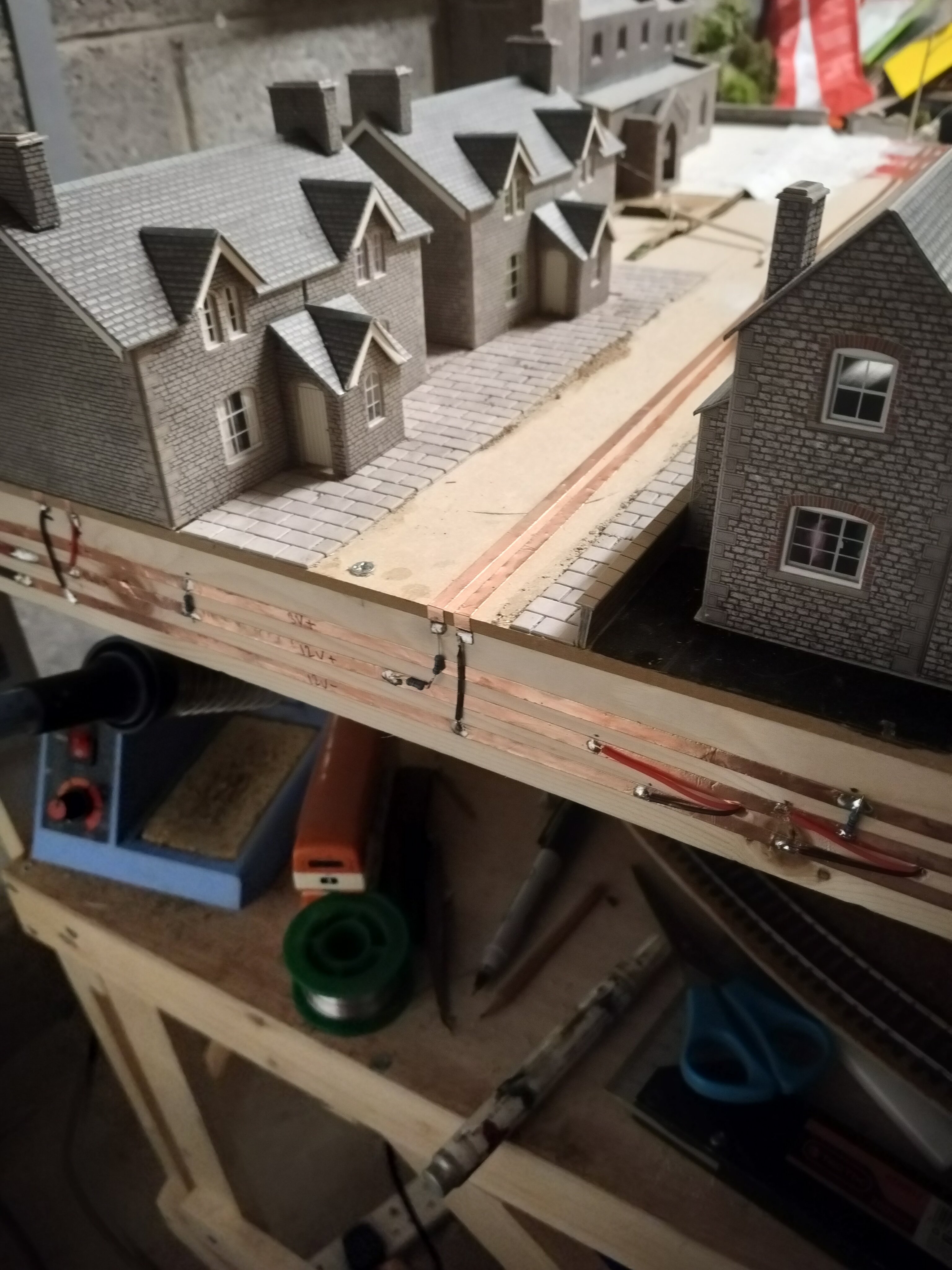

dropshort105 Posted May 19, 2025 Author Posted May 19, 2025 As it is very difficult to get under the landscape for wiring lights and whatnot, I run a 12v circuit around the frame with copper tape, one positive one negative, I run a third strip wired to the 12V positive via a 3V resistor, the gives me a 3v circuit as well. I can then run 12v or 3v power along along the surface to wherever it is needed, then hide it under roads, buildings or even the flower beds. A great benefit is that I don't need to individually fuse 3v lights etc as they can simply be wired directly to the 3v circuit. Of course the circuit on the frame will have to be covered over later for safety. 6 1

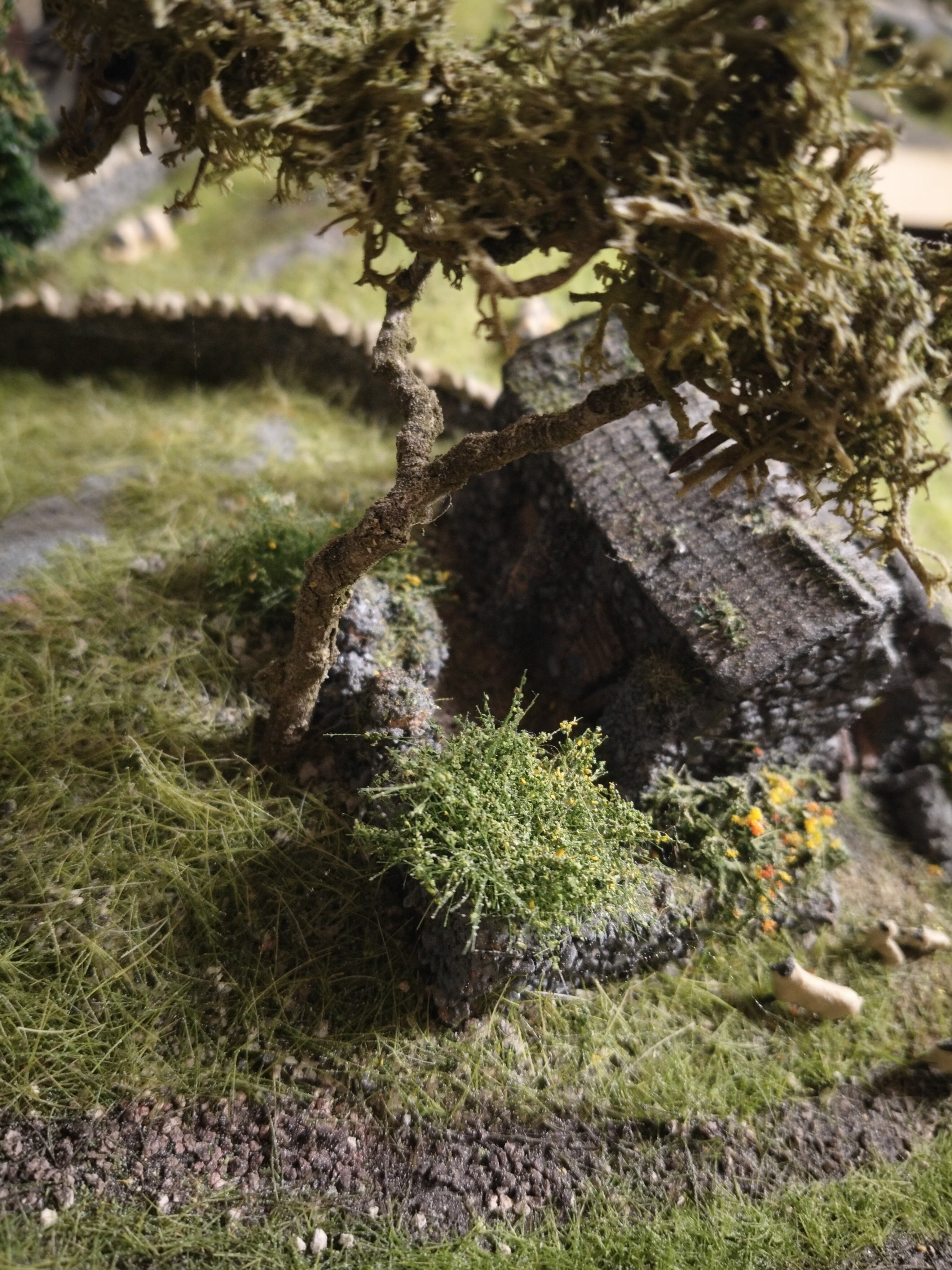

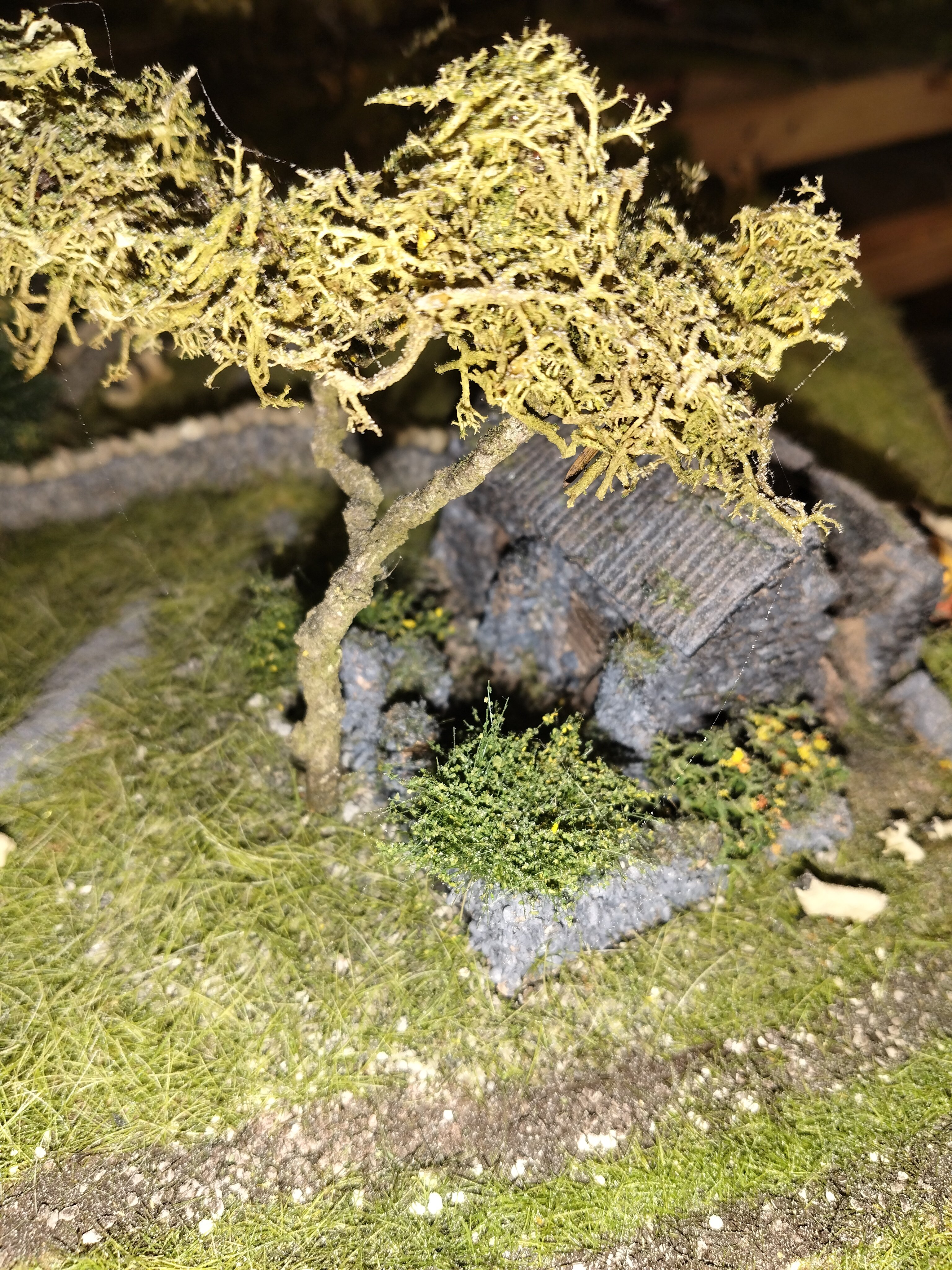

dropshort105 Posted June 3, 2025 Author Posted June 3, 2025 (edited) I was out for a walk yesterday, the twigs on a dead tree cought my eye, I have no idea what kind of tree it was, but five minutes with some lichen and some scatter, they came up beautifully. Edited June 3, 2025 by dropshort105 14
Mol_PMB Posted June 3, 2025 Posted June 3, 2025 Inspired! They look superb. It’s amazing what natural materials can offer to the modeller, this is great inspiration to the rest of us. Thank you! 2 3 1
jhb171achill Posted June 5, 2025 Posted June 5, 2025 Brilliant. The texture and colour of the tree trunks, being 100% natural, looks 100% real. We see many model trees with really convincing shapes and foliage, but shiny brown plastic trunks! Well done! 2
dropshort105 Posted June 5, 2025 Author Posted June 5, 2025 17 hours ago, jhb171achill said: Brilliant. The texture and colour of the tree trunks, being 100% natural, looks 100% real. We see many model trees with really convincing shapes and foliage, but shiny brown plastic trunks! Well done! Yeah, usually the real thing doesn't scale down very well, I think these ones do, and plenty more where they came from, with the price of half decent looking trees , I might go into commercial production 1

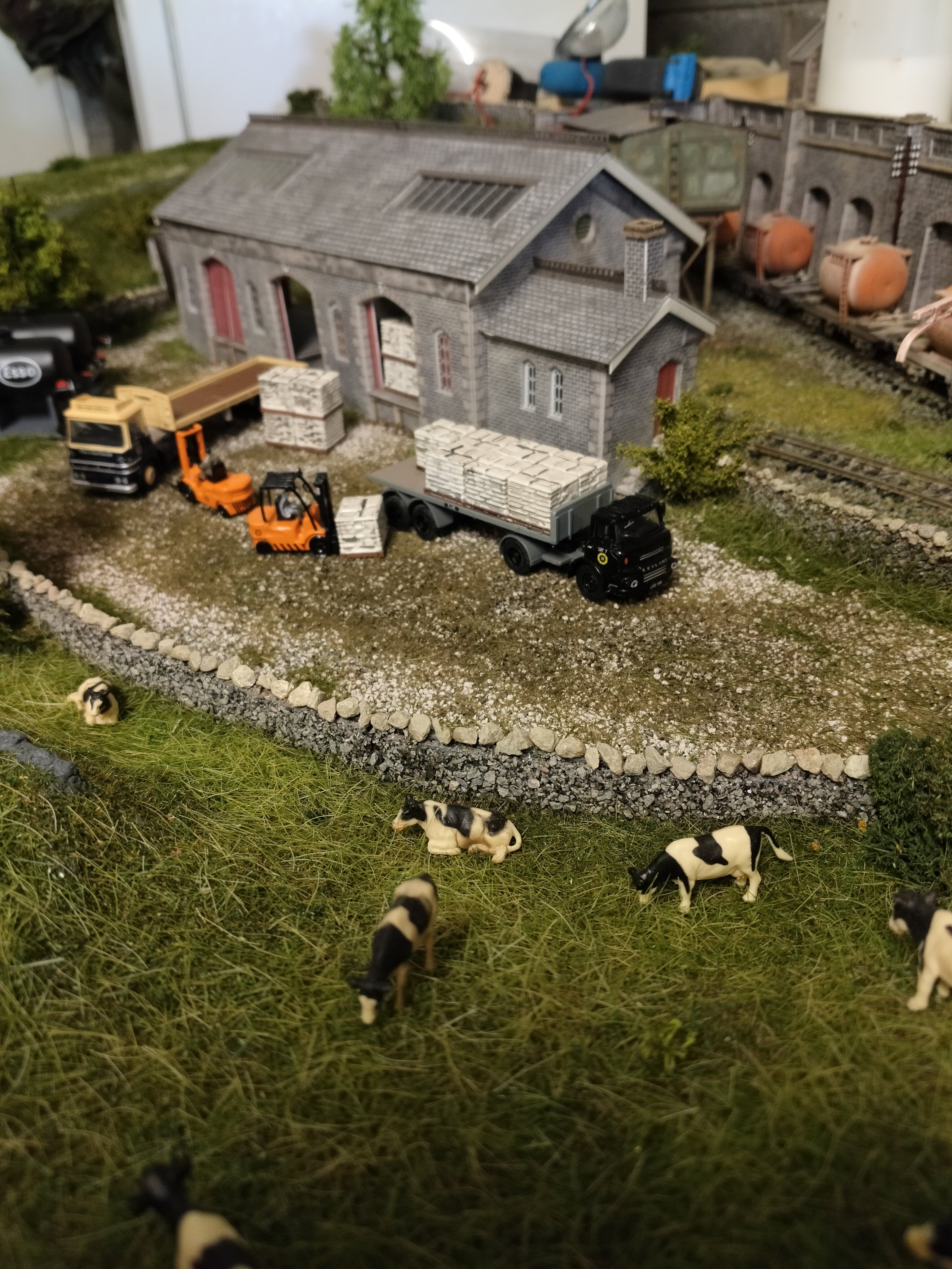

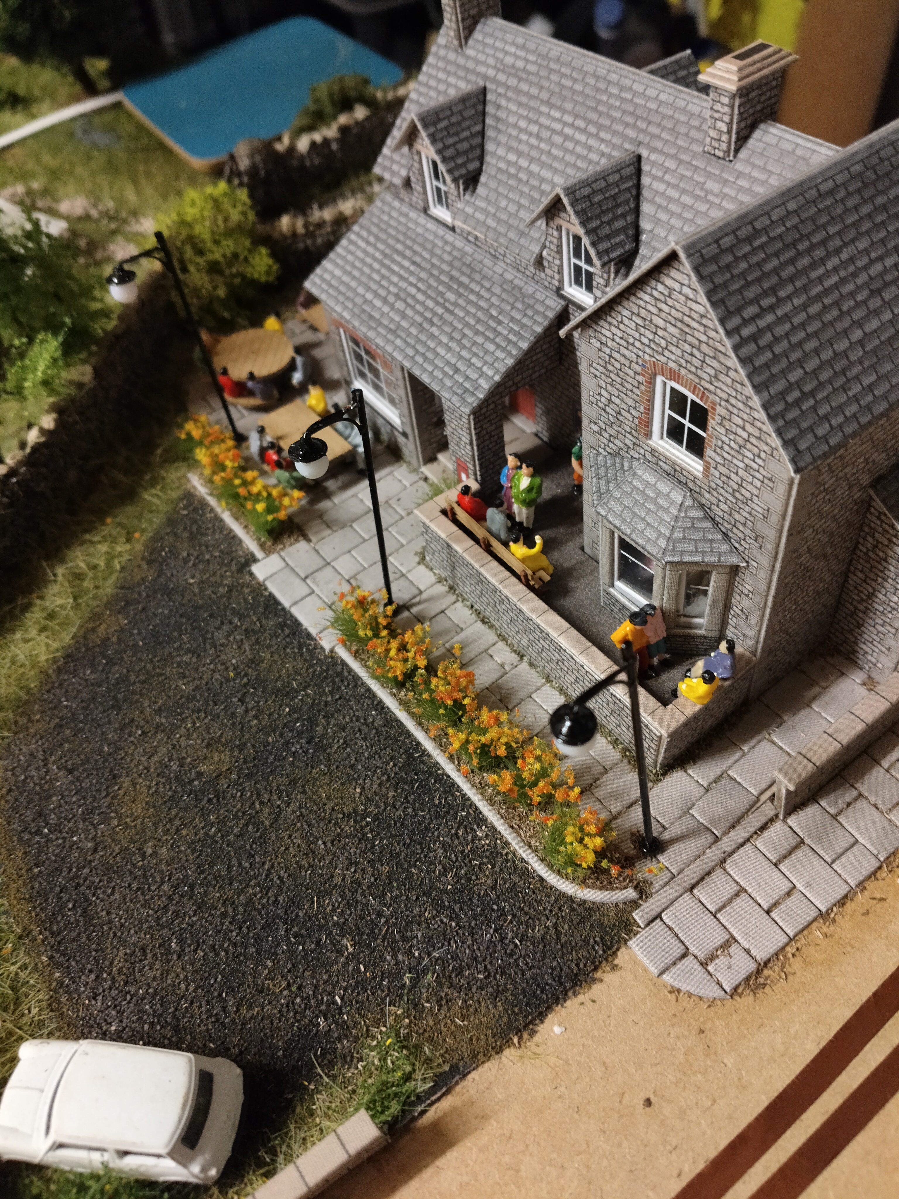

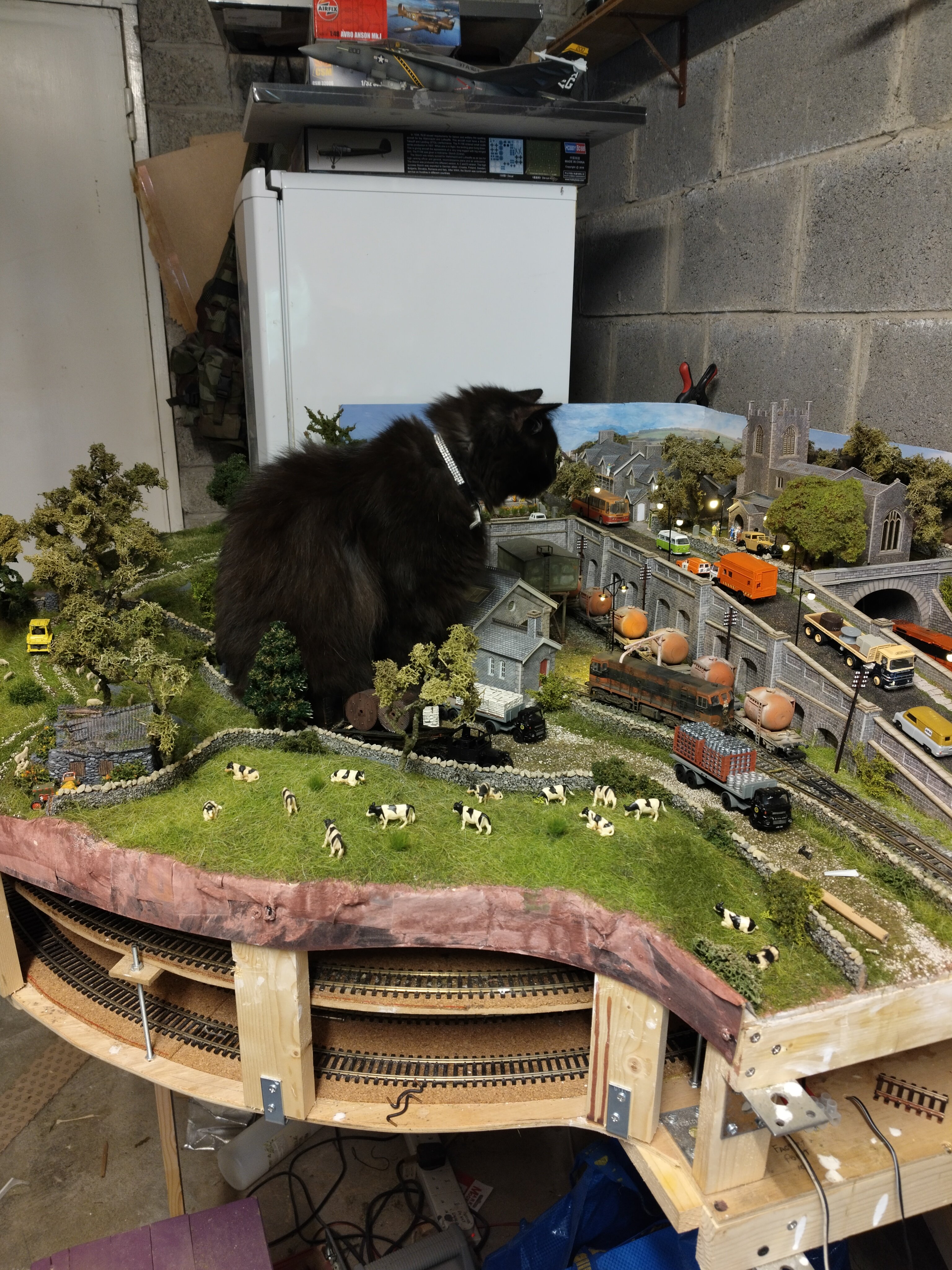

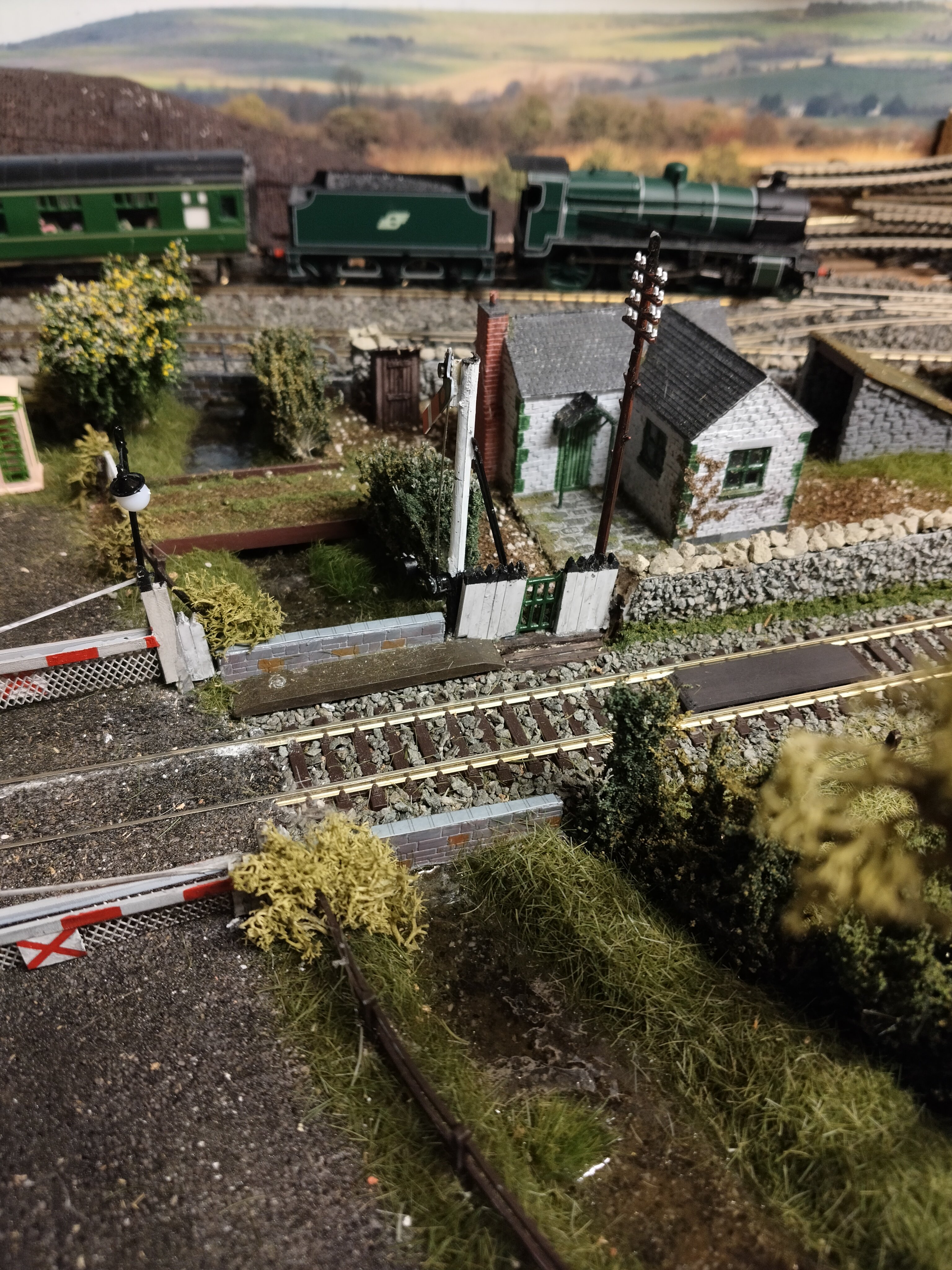

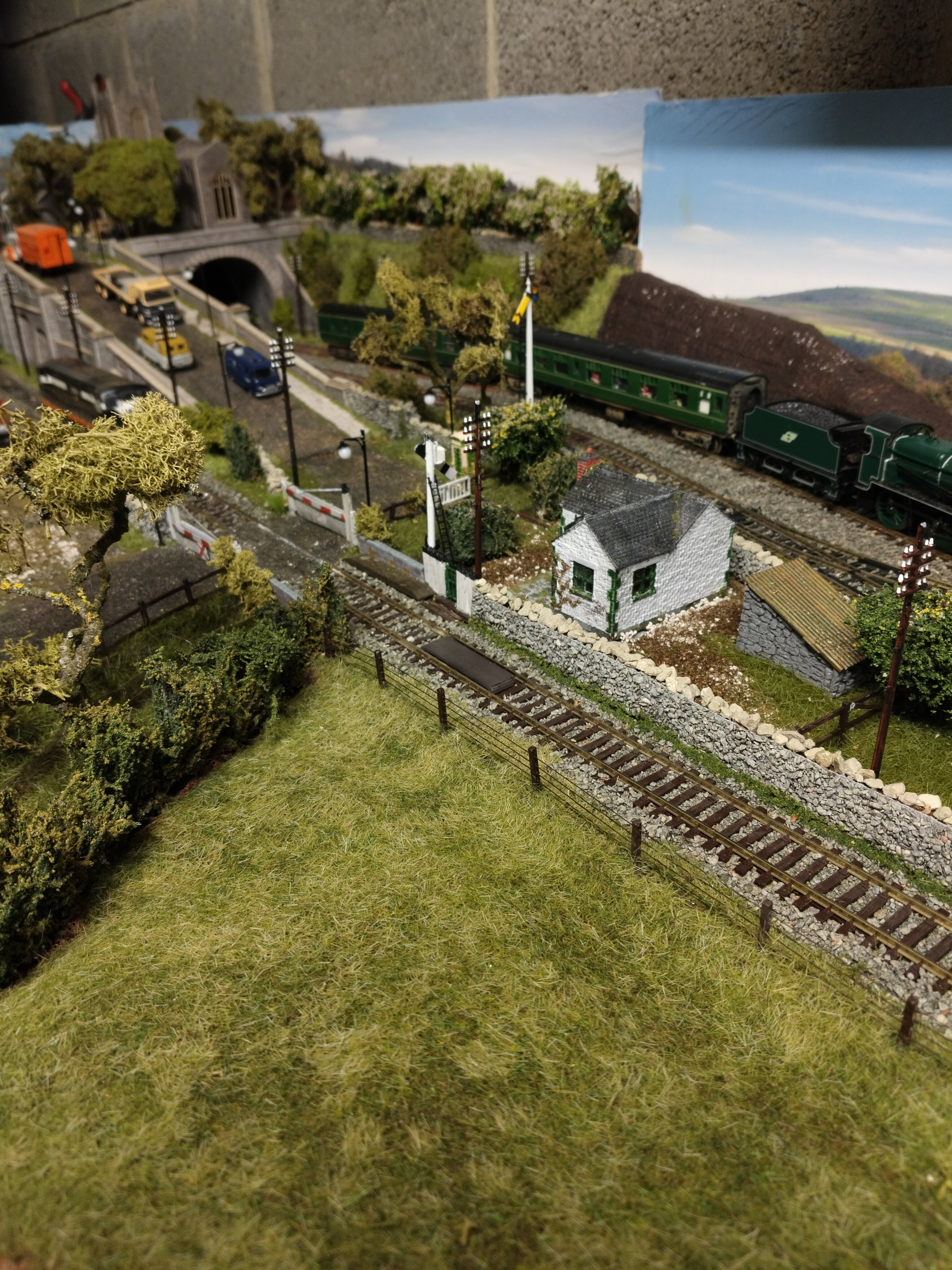

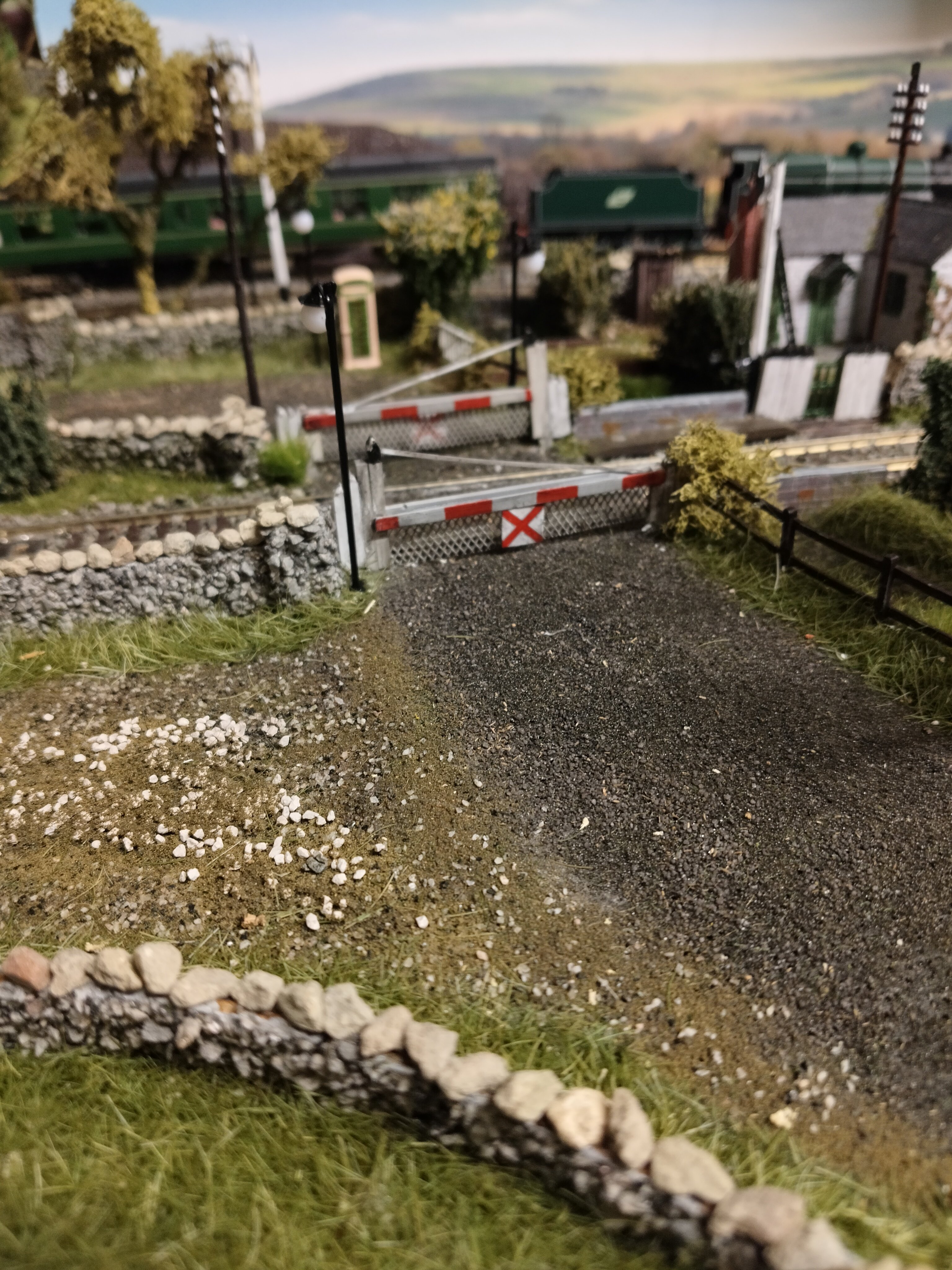

dropshort105 Posted November 1, 2025 Author Posted November 1, 2025 Scenics have now migrated to the main baseboard with the addition of a level crossing and keepers cottage, I build in a ditch as well to give a bit of 3D depth to the fairly flat baseboard, I'm reasonably happy with the look of it. 14
dropshort105 Posted November 1, 2025 Author Posted November 1, 2025 I really need to work on my photography
LNERW1 Posted November 13, 2025 Posted November 13, 2025 I like the helix, I am planning on using two myself on my home layout. What radius track have you used, and what is the gradient? 1
dropshort105 Posted November 13, 2025 Author Posted November 13, 2025 (edited) It is double track, radius 2 and 3, can't remember the gradient off the top of my head, will measure it tomorrow and get back to you, I'm sure I wrote it on it someplace so I would remember, but every loco I have gets up it alright, some of the older traction tyre ones needed the tyres replaced with a magic American potion called Bullfrog Snot, don't ask me where they came up with the name. Edited November 13, 2025 by dropshort105 1

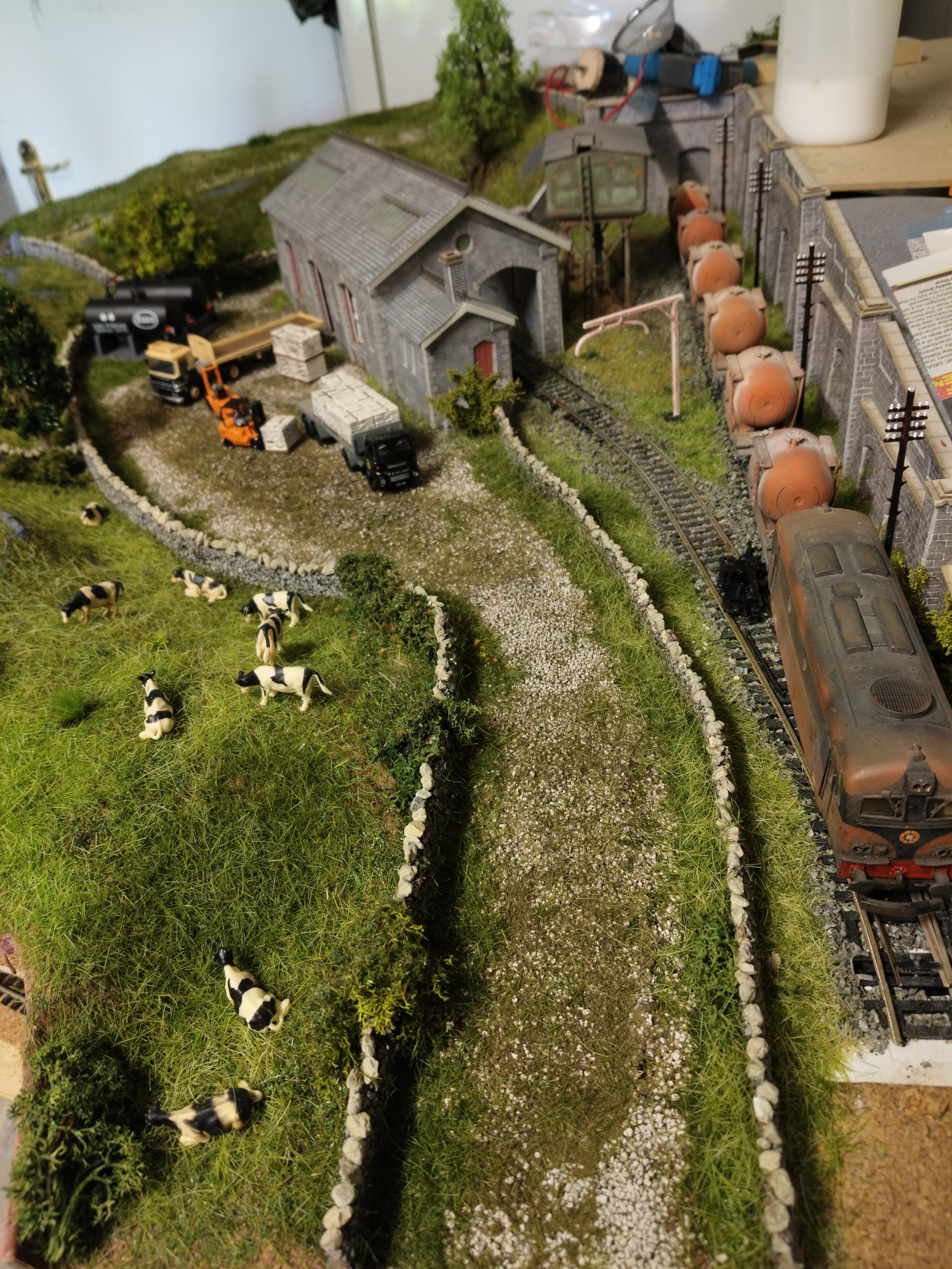

dropshort105 Posted November 13, 2025 Author Posted November 13, 2025 Just now, dropshort105 said: After landscaping 4 1

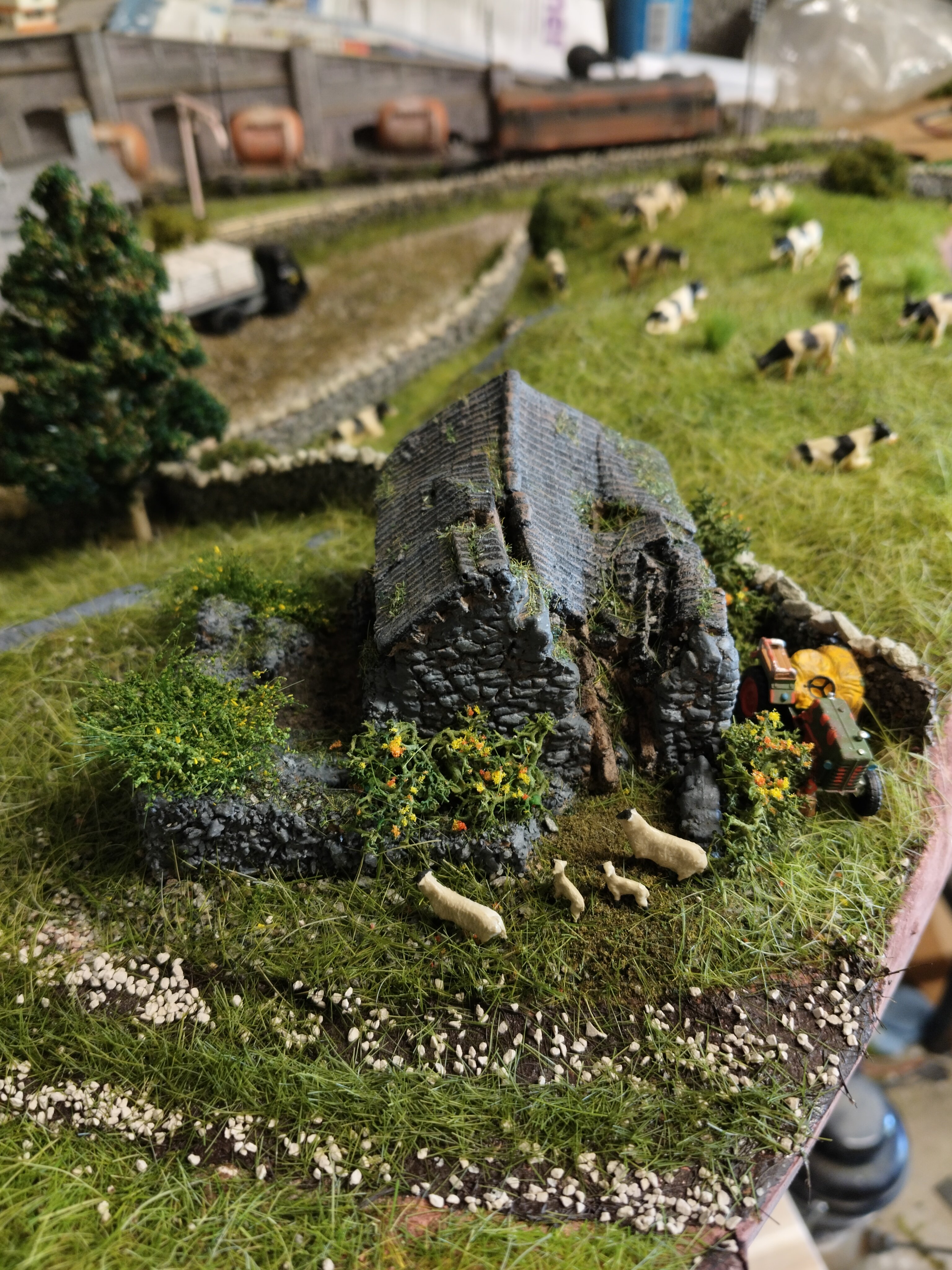

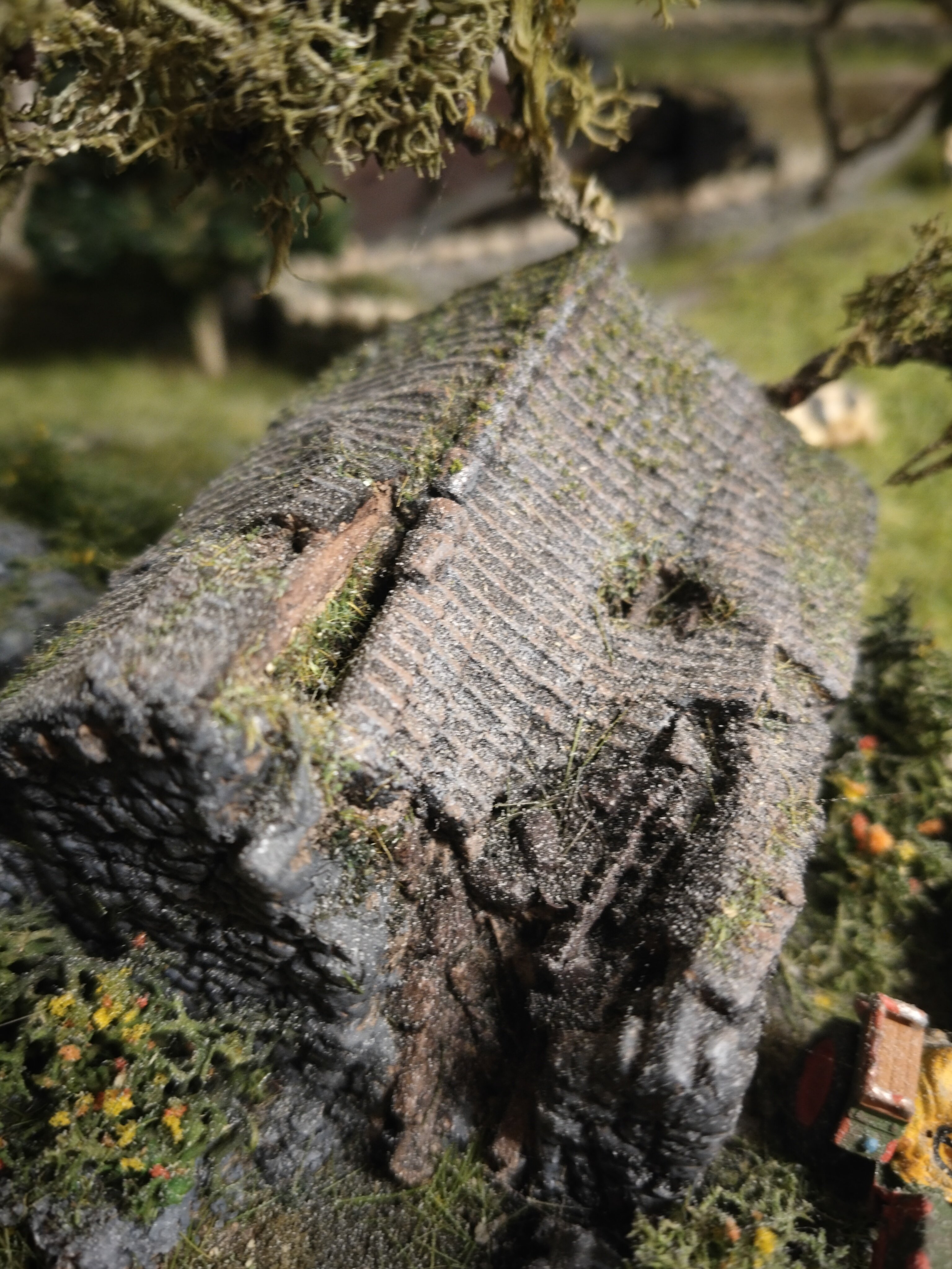

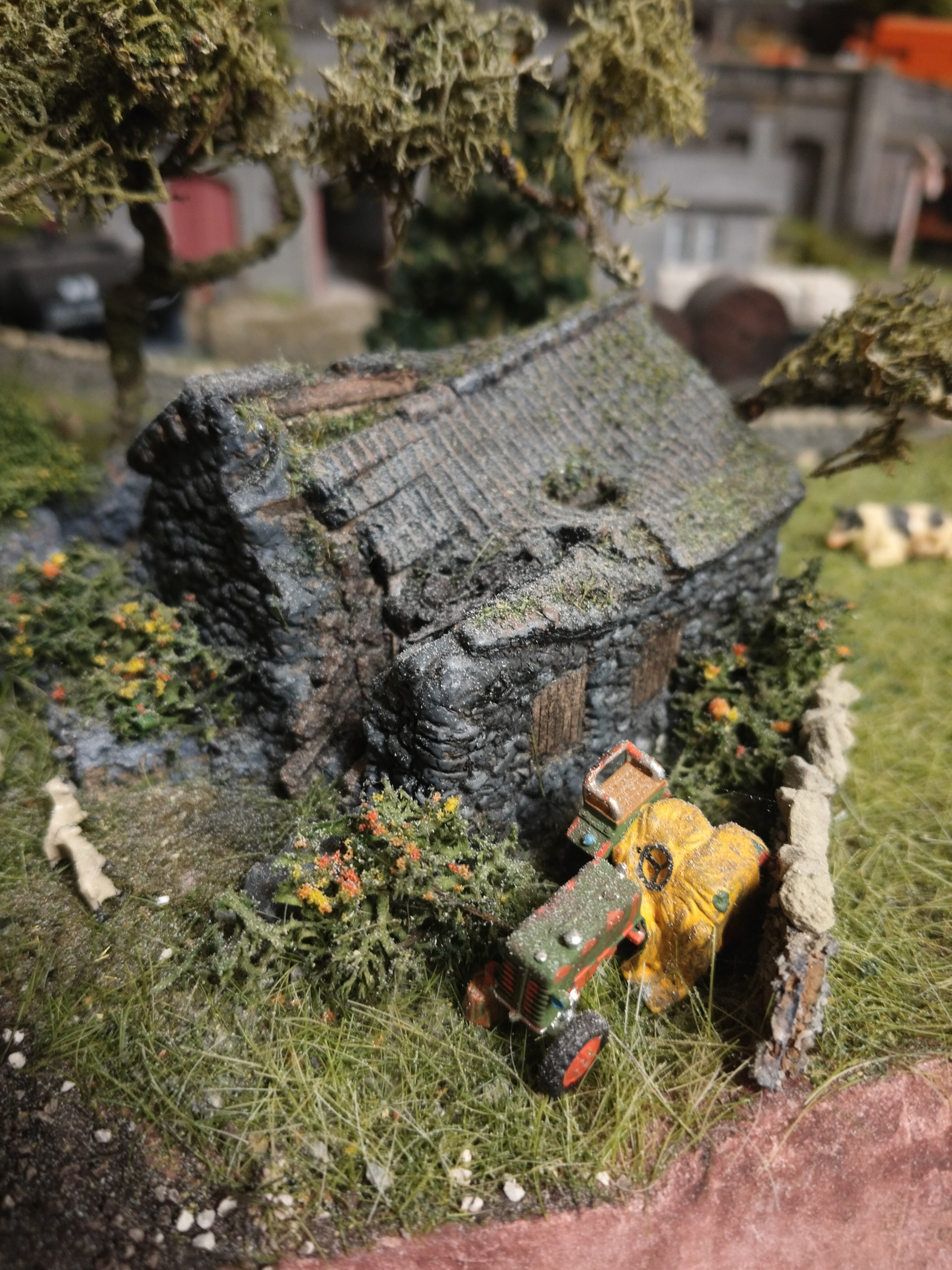

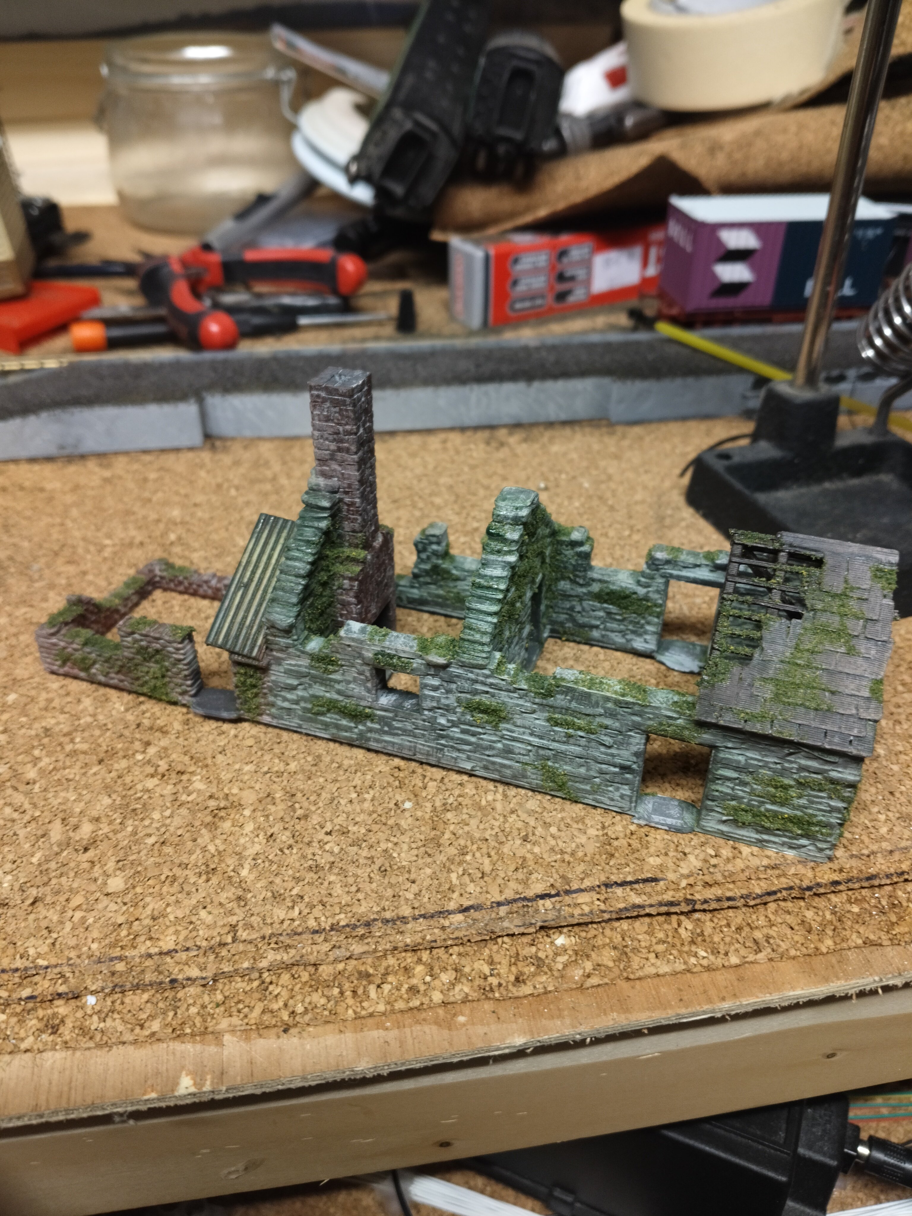

jhb171achill Posted November 14, 2025 Posted November 14, 2025 I absolutely love that old ruined cottage with the collapsing roof. Tell me more about that - perfect for any rural Irish layout, and something I had in mind myself. 1 2

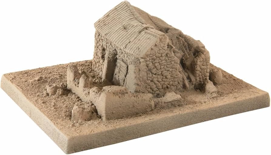

dropshort105 Posted November 14, 2025 Author Posted November 14, 2025 (edited) 16 hours ago, jhb171achill said: I absolutely love that old ruined cottage with the collapsing roof. Tell me more about that - perfect for any rural Irish layout, and something I had in mind myself. Its made by Noch, a moulded building made out of some super duper foam stuff, it comes with a reasonably nice tree and a little abandoned tractor, well worth the tenner I paid for it but certainly not worth the forty or fifty retail price, The tree in the photo isn't the one that comes with it. Edited November 14, 2025 by dropshort105 6

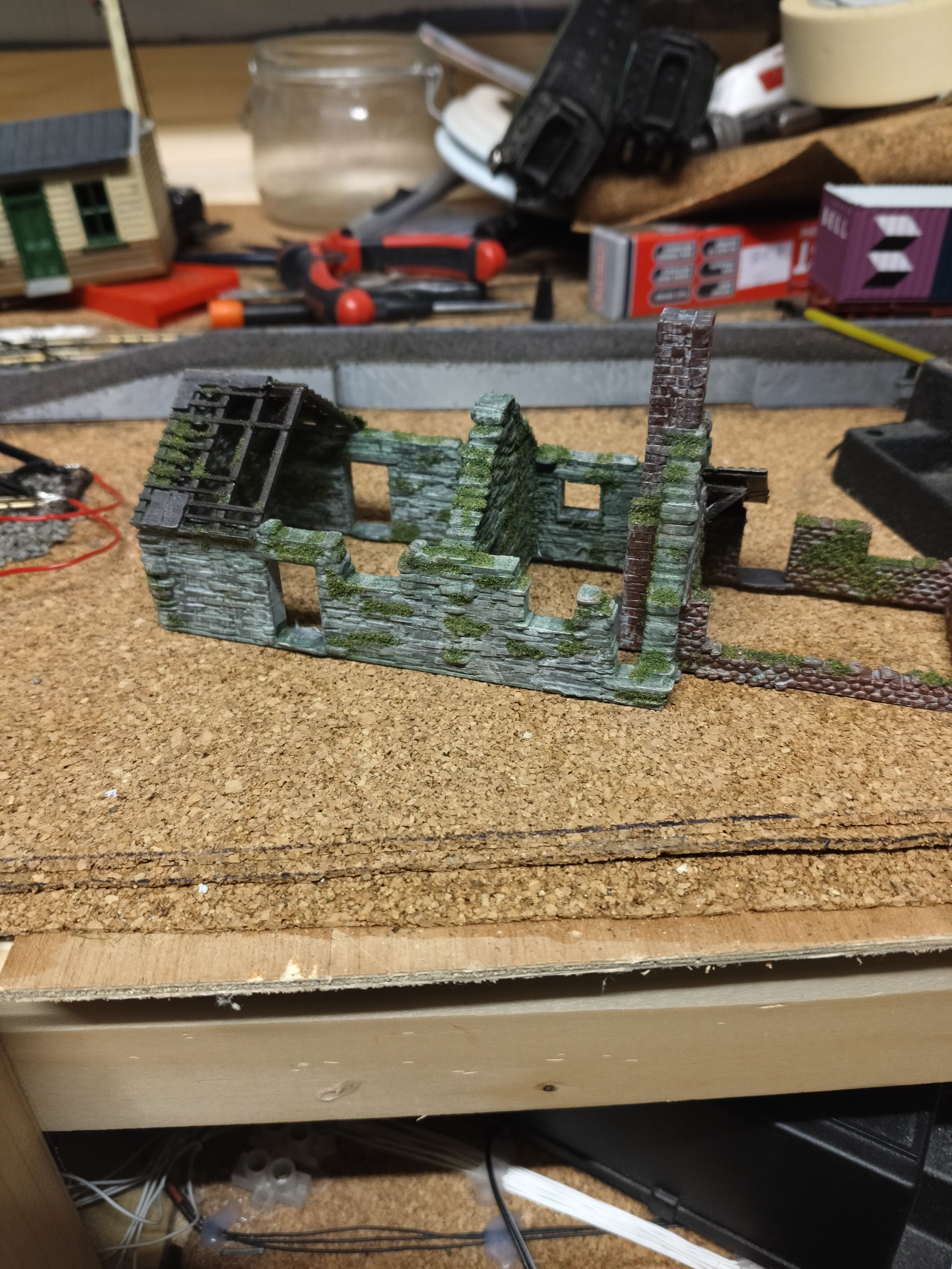

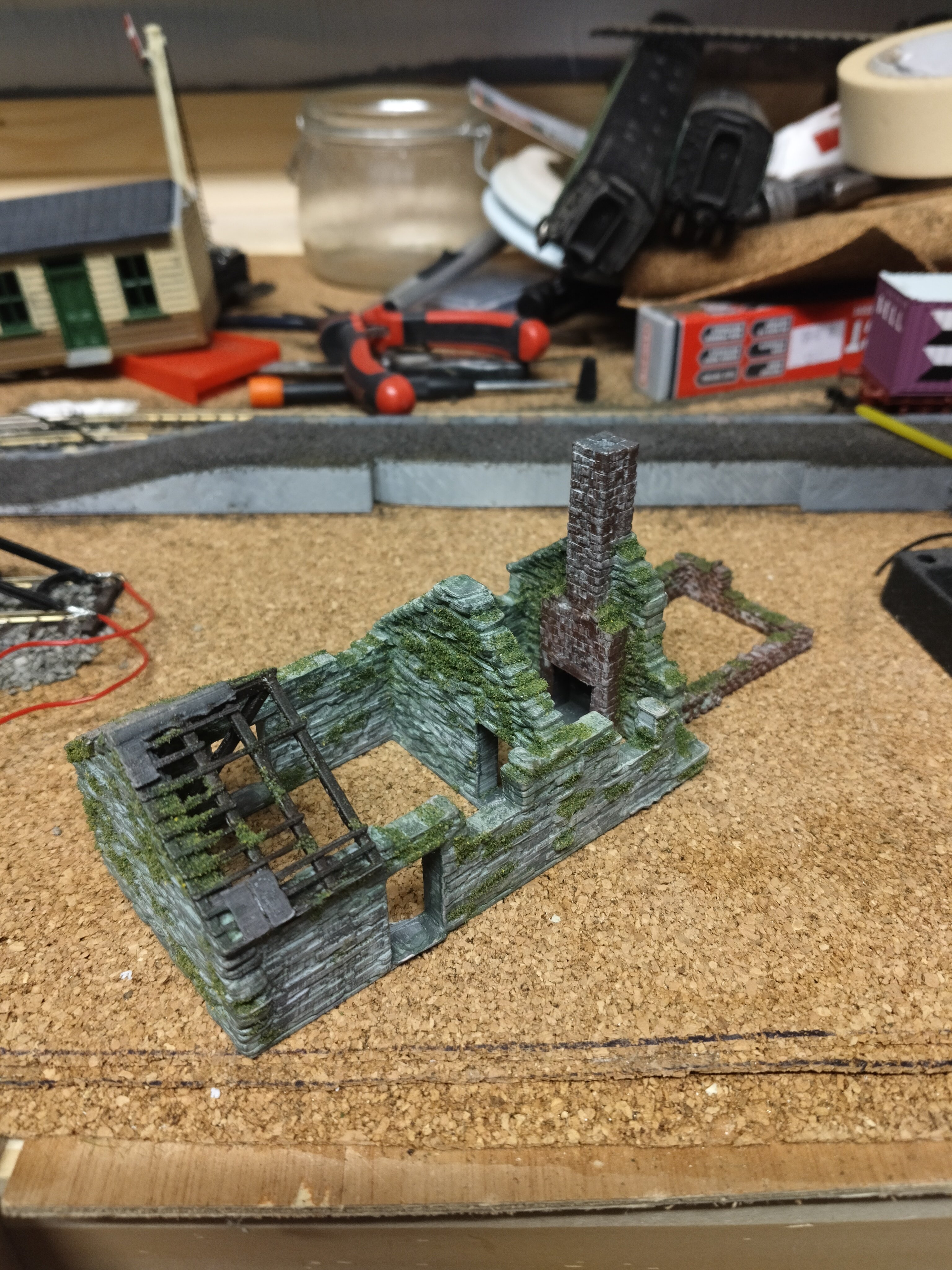

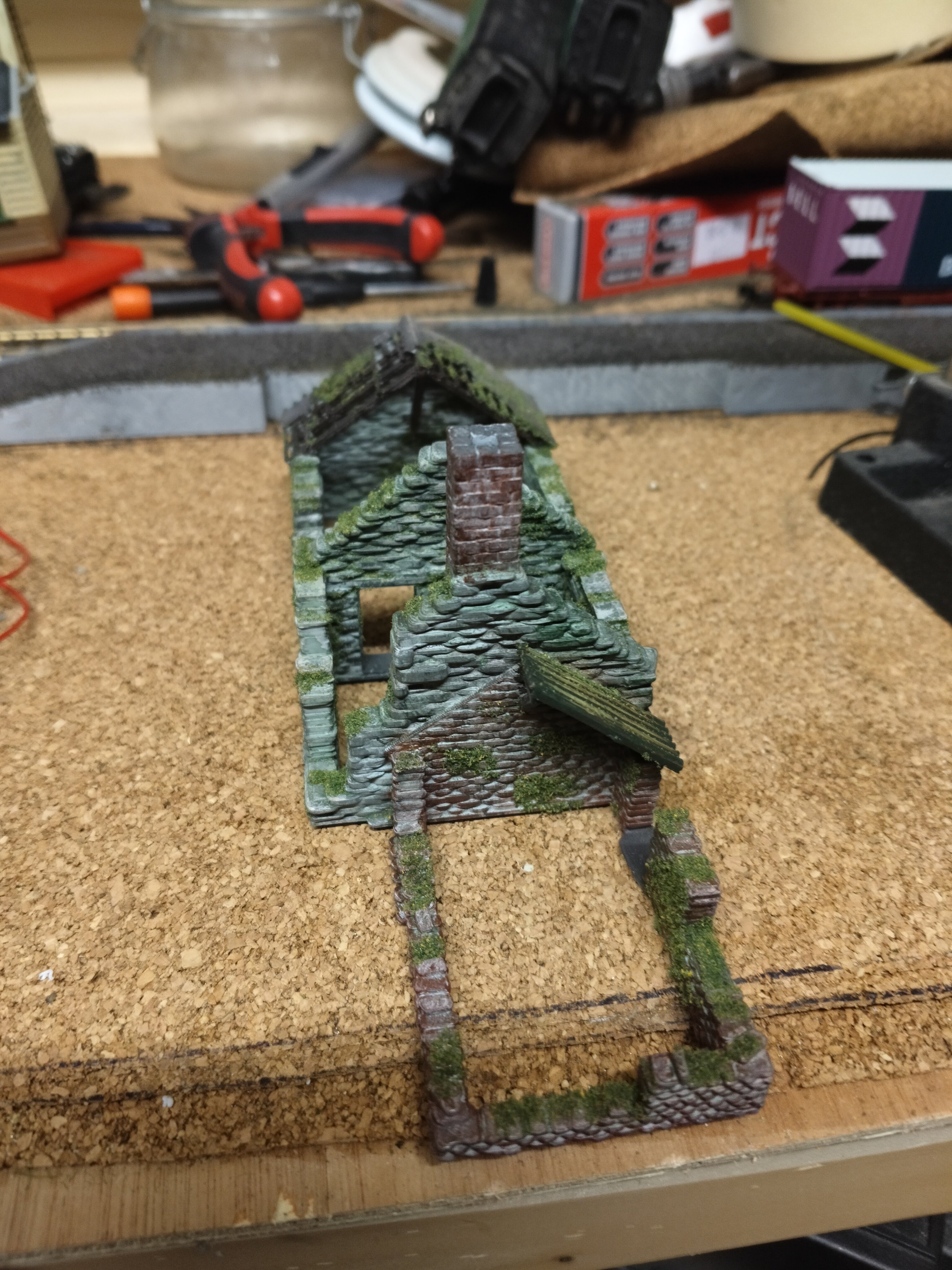

dropshort105 Posted November 14, 2025 Author Posted November 14, 2025 This one is made from a free 3D printer file,if you think you might like one and if you have access to a 3D printer, I will send you on the file, if not drop me a pm and we will get you fixed up. 10 2
