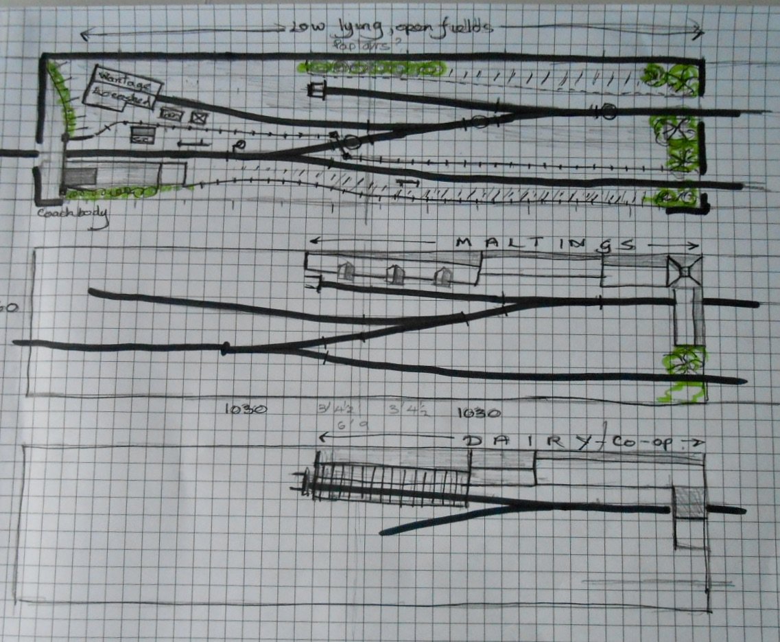

David Holman Posted August 10 Author Posted August 10 On 30/7/2025 at 10:33 AM, Northroader said: I’d be inclined to ditch the right hand crossover, just a straight entry into the back siding from the fiddle yard through just one point out of the loop? On due consideration, you would lose the private siding aspect, so maybe not, perhaps something like Ruyton Road, plus the engine shed? https://www.rmweb.co.uk/forums/topic/154530-ruyton-road-revisited-what-to-do-with-an-old-classic/ sorry, I always think Iain Rice added at least one more point than necessary, now that Whitley could lose a siding, and keep it all compact and less points, and… (why don’t you just shut up, Bob?) I think you are right about that extra point, while have also tinkered around with the position of the others, as shown below. The other two sketch plans give an idea about other options. The 6'9 overall dimension will be shortened to 6'6/2m, so that I can use the lighting and pelmets from Fintonagh/Swillybegs. No point in making extra work if you don't have to! Moving the point off the mainline means almost all shunting moves will take place on scene, while making the loco shed siding longer means it can double up as an exchange siding. The initial project will see the narrow area against the back scene as just a low bank, with a row of poplars to hide the baseboard joint. A couple of trees on the right should hide the exit from the fiddle yard, while the back scene itself will be painted to represent low lying countryside. Shades of Wissington, perhaps. Both these sections will be removable, to allow a granary/maltings low relief set of buildings instead and [later still] a dairy cum Co-op option. I've worked out what I need for the baseboards and an order will go in for some pre-cut 6mm birch ply. Track on the mainline will probably use either Peco or C&L flexitrack, with one of the latter's point kits, so everything will be bullhead. The private sidings will be Code 100fb on copper clad sleepers to give a lightweight look . With only a few buildings and scenic items, there is every reason to get as much fine detail as possible. Am thinking the locoshed at Wantage Town, while the passenger halt may just do with a grounded coach and/or van body. As well as recent projects on this forum, inspiration is also comimg from some new books by James Hilton & Wild Swan. They very much focus on minimum space/maximum detail and are well worth getting hold of. 3

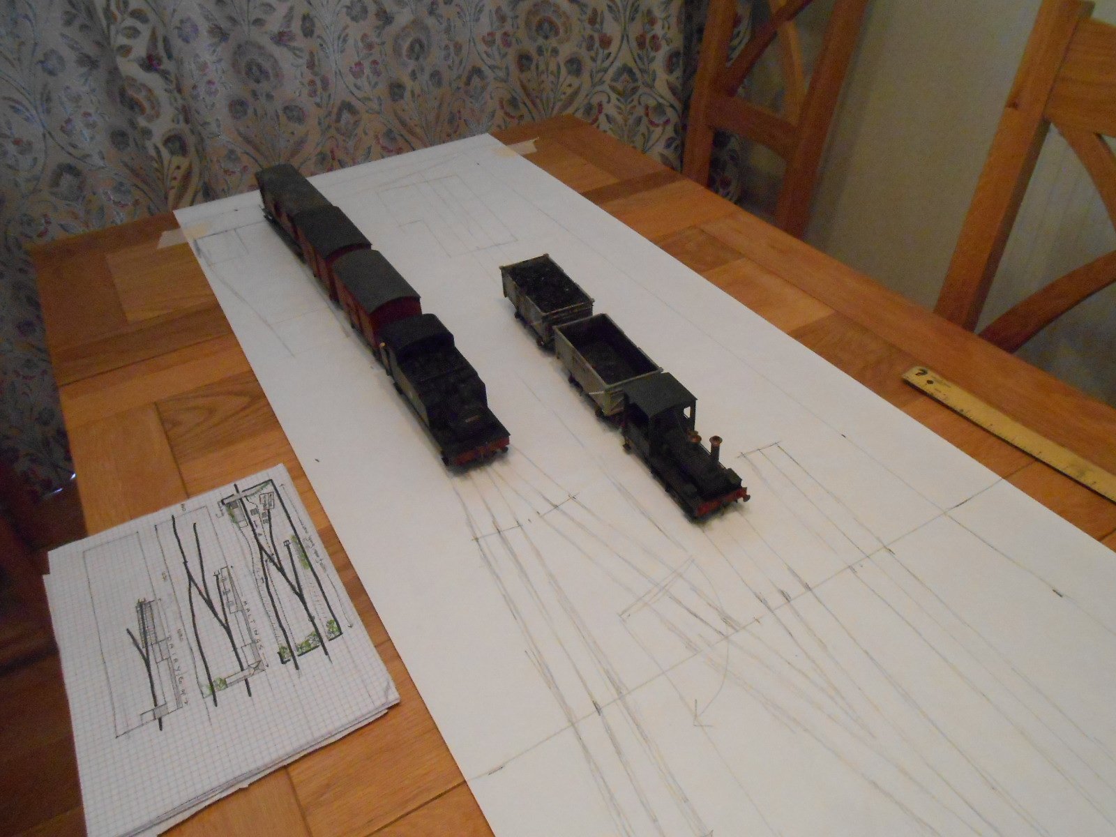

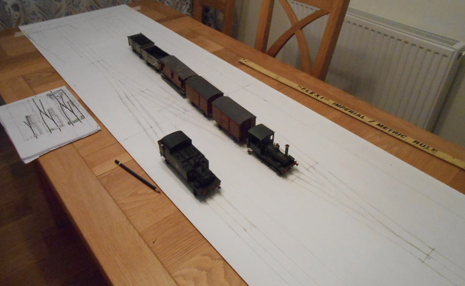

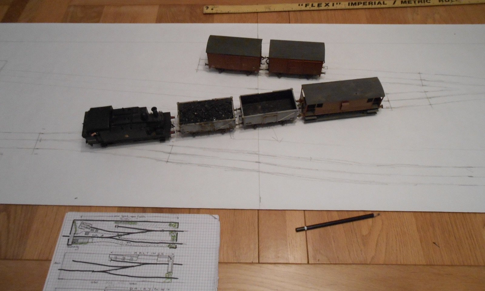

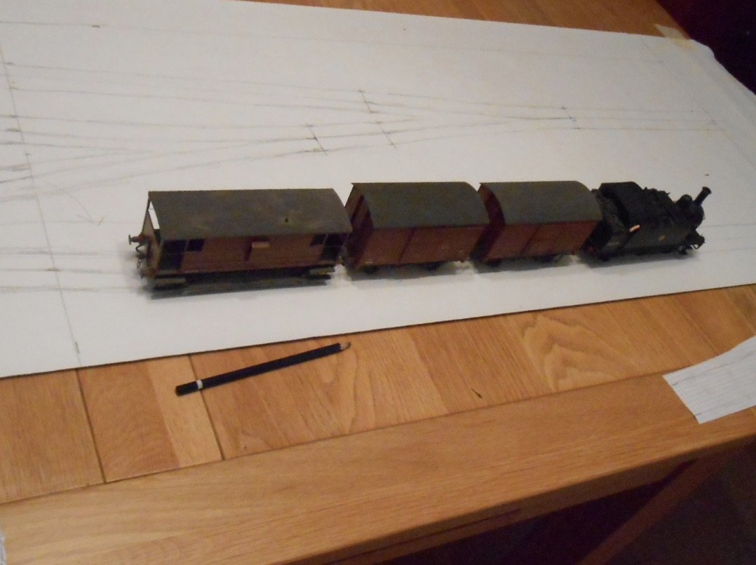

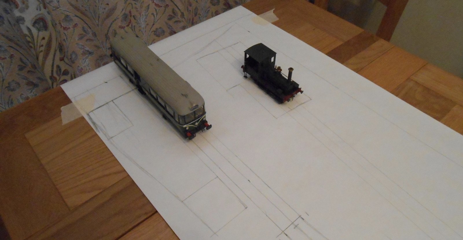

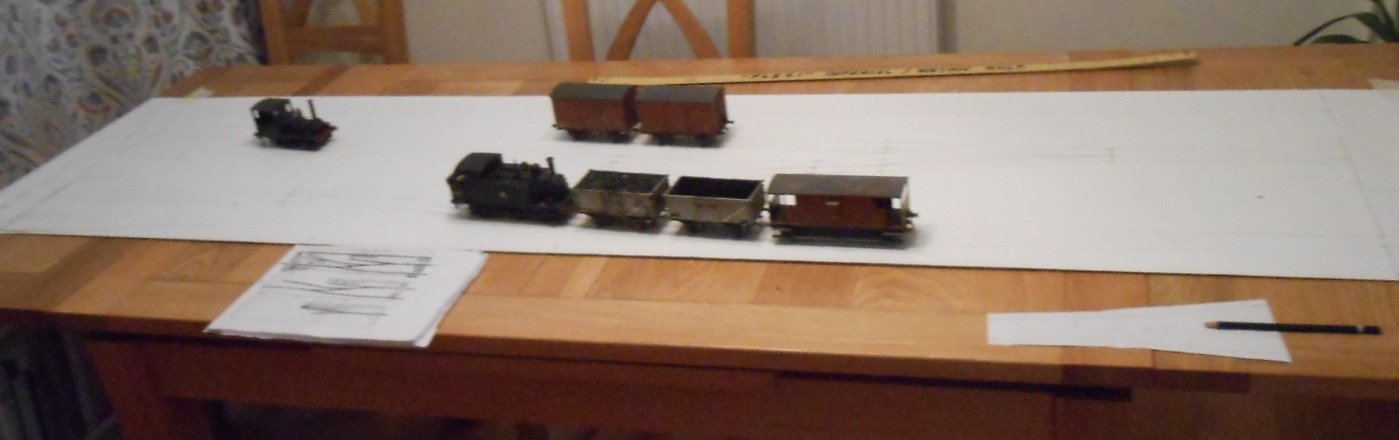

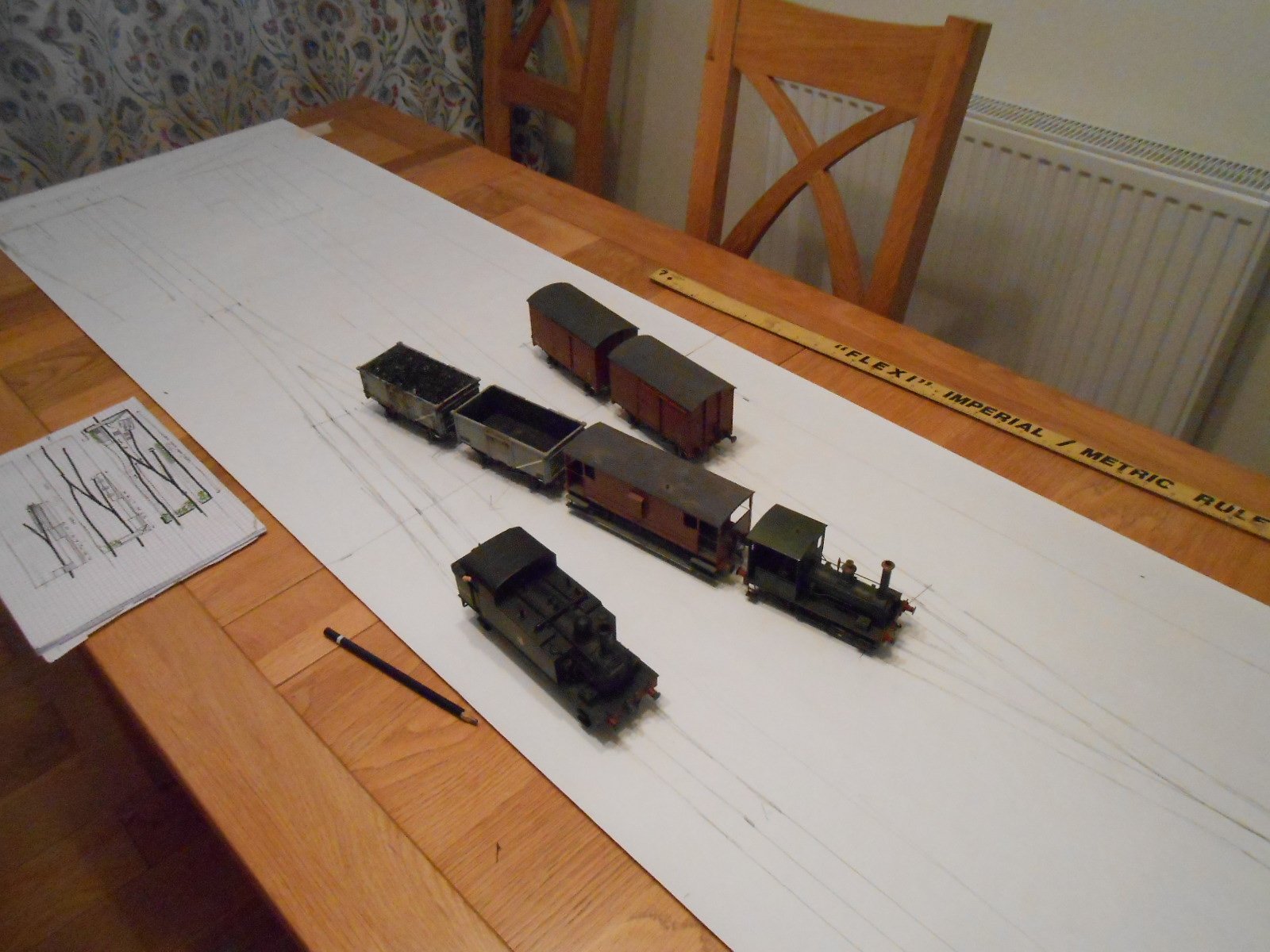

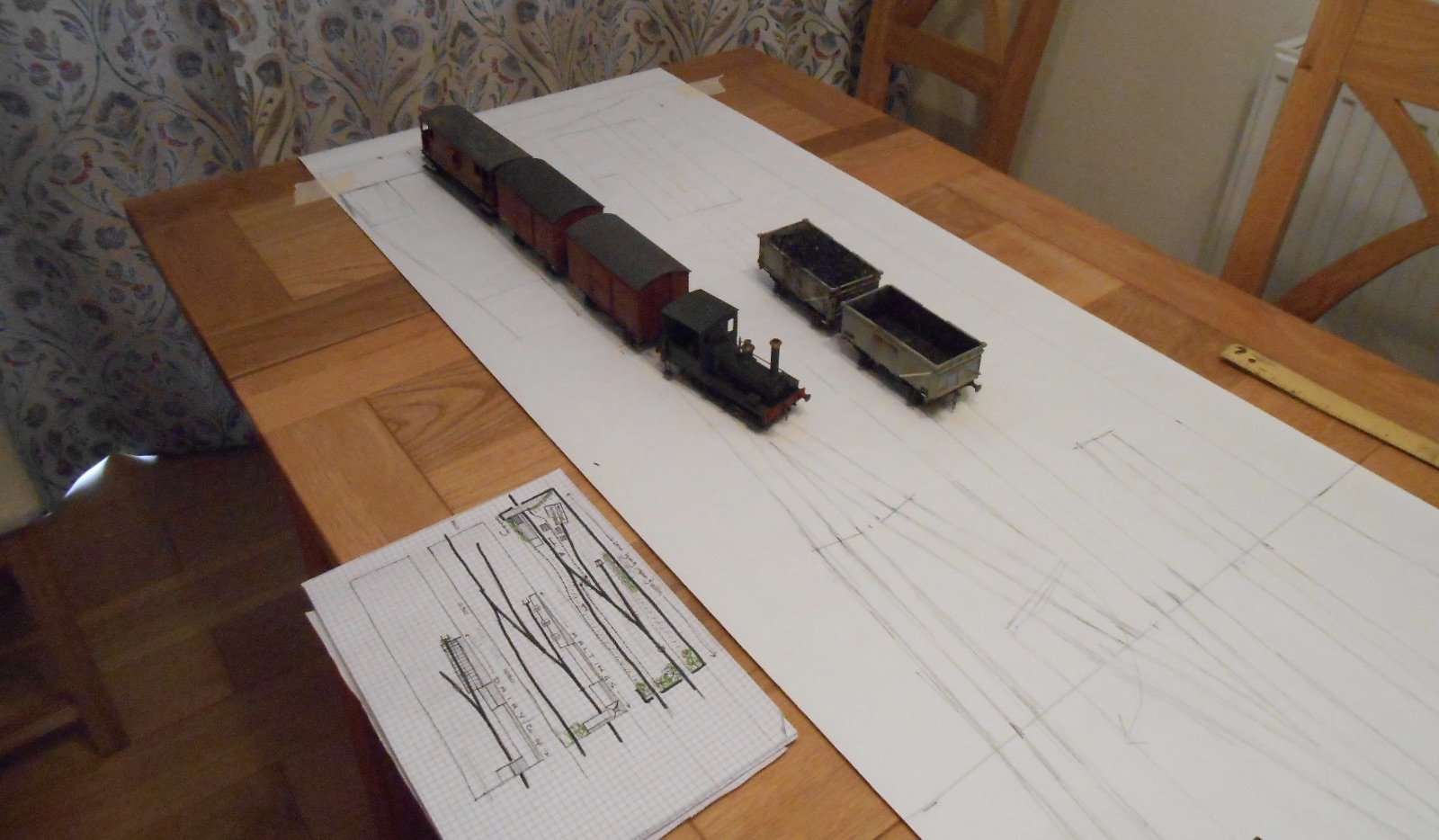

David Holman Posted August 14 Author Posted August 14 Building upon my zen [!] this afternoon, spent a pleasant hour or so drawing out the new project full size on some lining paper. Doing this helps ensure that the clearances are adequate, especially as you can pose various items of stock. I also moved stock around to check that likely sequences would work. Unfortunately, it is hard to see the pencil lines of the track plan, but my sketch plans should help with orientation. The first picture shows my J69 approaching the junction to the private sidings with a typically short goods train. Behind, ex Wantage Tank, Jane waits in the loco shed road, while the two vans are in the rear siding. The next two pictures show how the J69 can push its train into the private sidings [note the mainline engine would not be allowed through the gate], for Jane to collect. Jane then moves the train into the loco shed/exchange siding and then collects the two vans from the rear siding, placing them with the brake van. The two vans and brake now form an out going train, which Jane moves on to the mainline, for the J69 to collect. After, Jane will shunt the open wagons off scene for loading/unloading. The final two pictures show my railbus in the platform of the halt and the J69 in the same place with a horse box - again, both typical workings from 1950s East Anglia. So, it all seems to work, which is just as well as I've already put in an order for some 6mm pre-cut birch ply. At the moment, it may well be all the track will be bullhead [Peco], but using Marcway 1.8m wye points because they are such good space savers. Other orders will go in soon: three tortoise point motors, four uncoupling magnets, plus associated switches and wire. 8

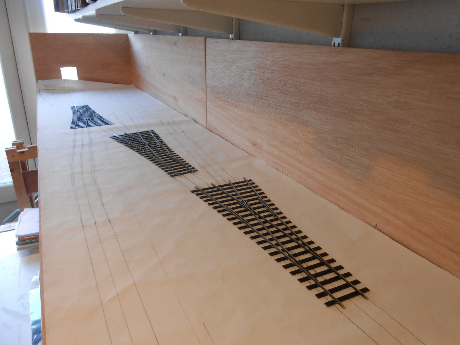

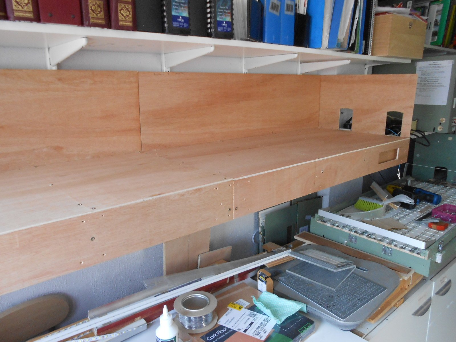

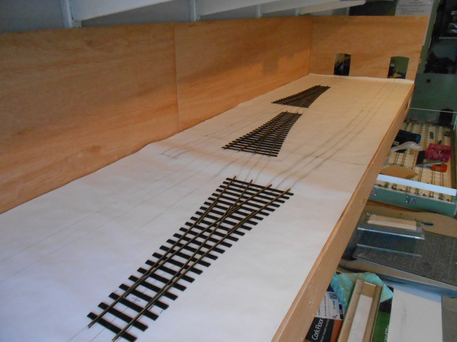

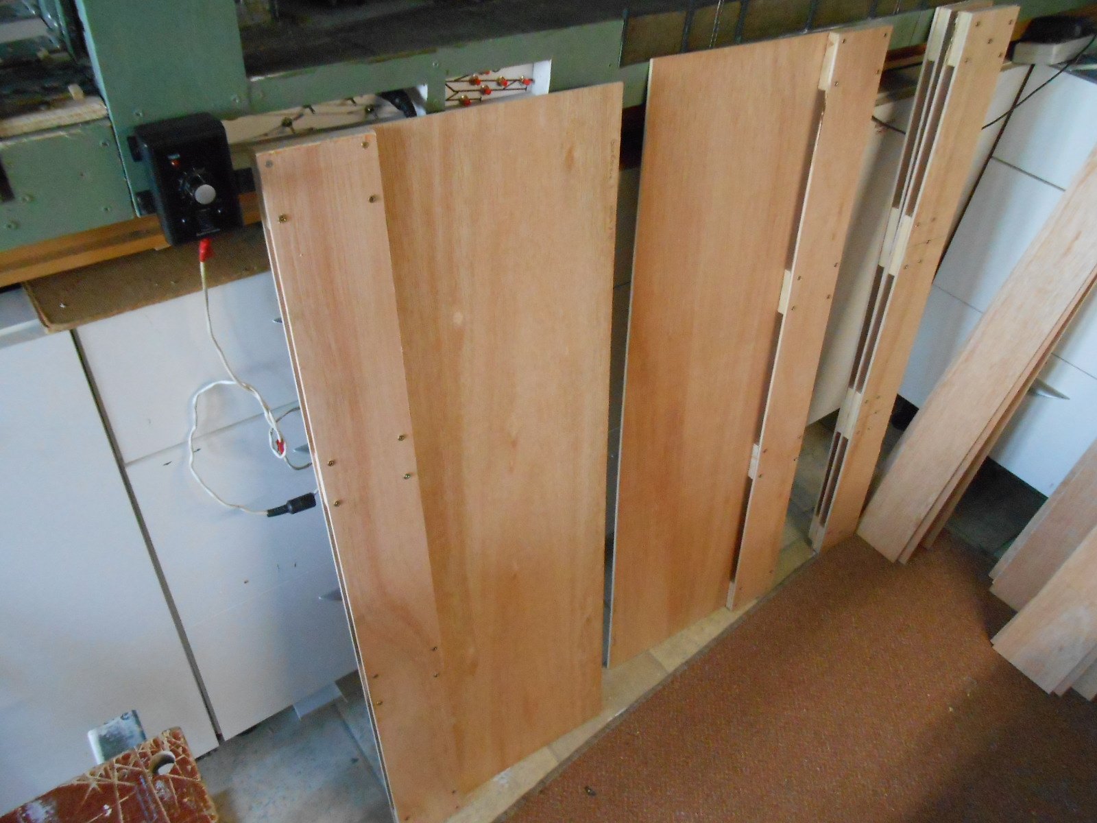

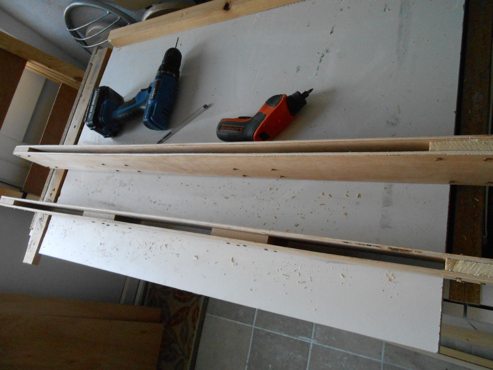

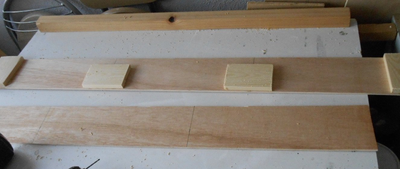

David Holman Posted August 24 Author Posted August 24 Got the plywood on Tuesday and have been assembling the two baseboards since then until this afternoon, when [returning from the garden centre], found a package containing my three points from Marcway. Not best pleased to find £200 worth out in the open on my doorstep, but then nobody would know what was inside and doubt if anyone would be interested anyway! As the ply is fairly thin, have gone back to slightly older practice by using the 'ply sandwich' method, where the frames are two strips of 10 cm ply either side of rectangular blocks of 12mm softwood. Screwed and glued, they are light but very strong and stable. Baseboard joiners ensure alignment, with M^ bolts to hold everything together. So, the workshop now has three layouts, with two sitting on the higher shelves and the one being worked on lower down. The arrival of the points has allowed a visualisation session this afternoon, starting with the left hand end. I need to have a decent view blocker here, to hide the hole in the end back scene. Looking in books and on the Web, found that Tollesbury in Essex had a nice, small, timber built station building that suits the space, but also need to find a suitable over bridge to copy. 8 1

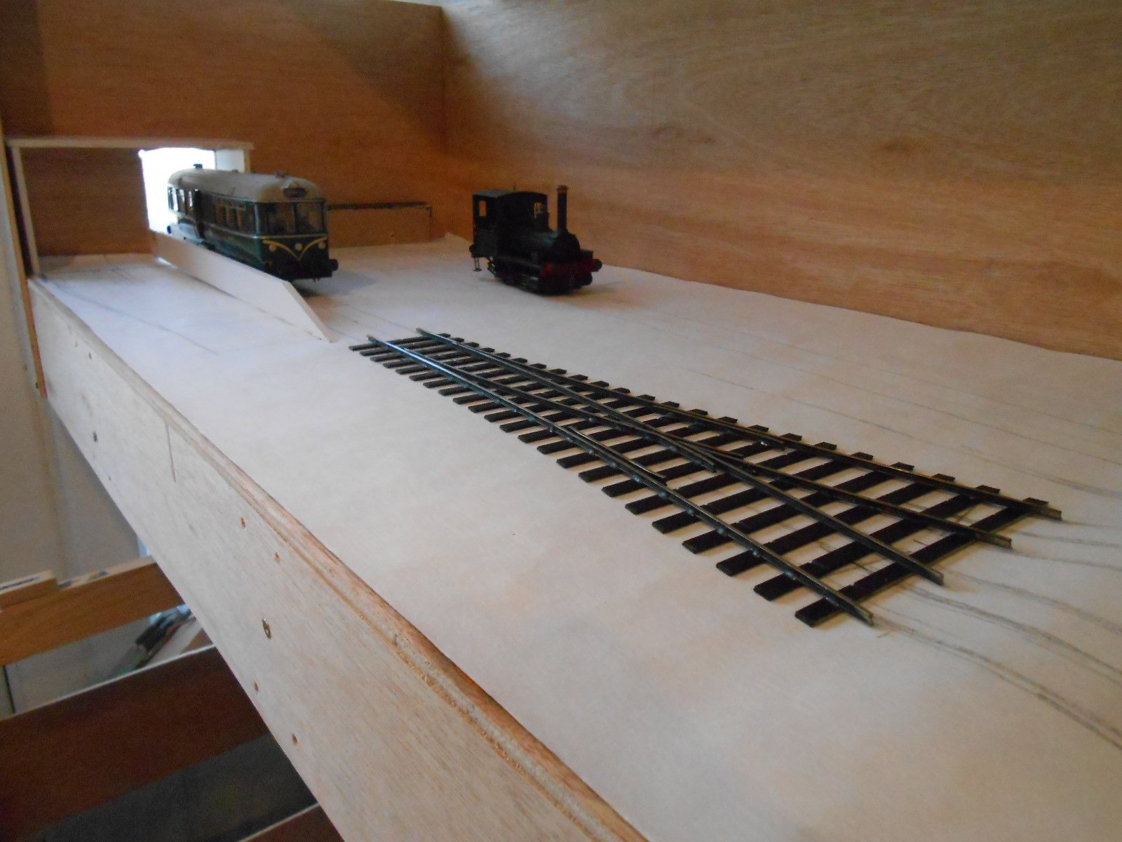

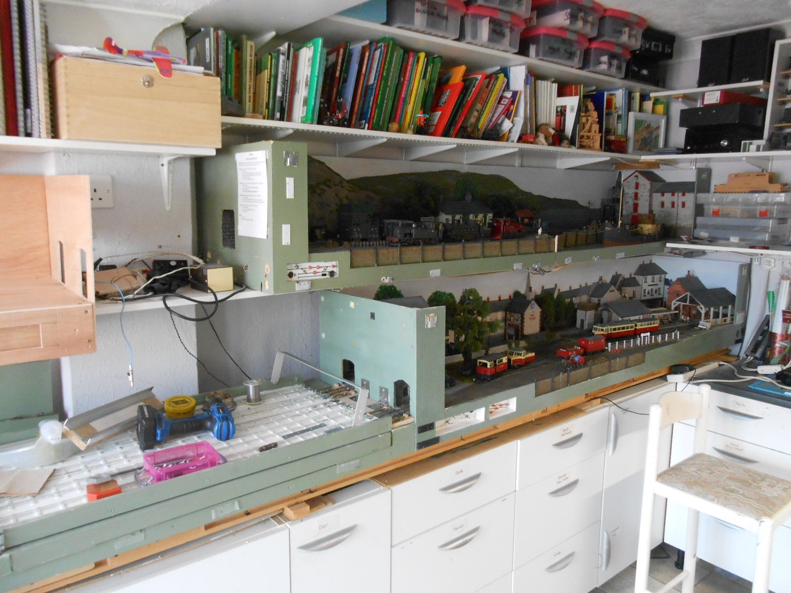

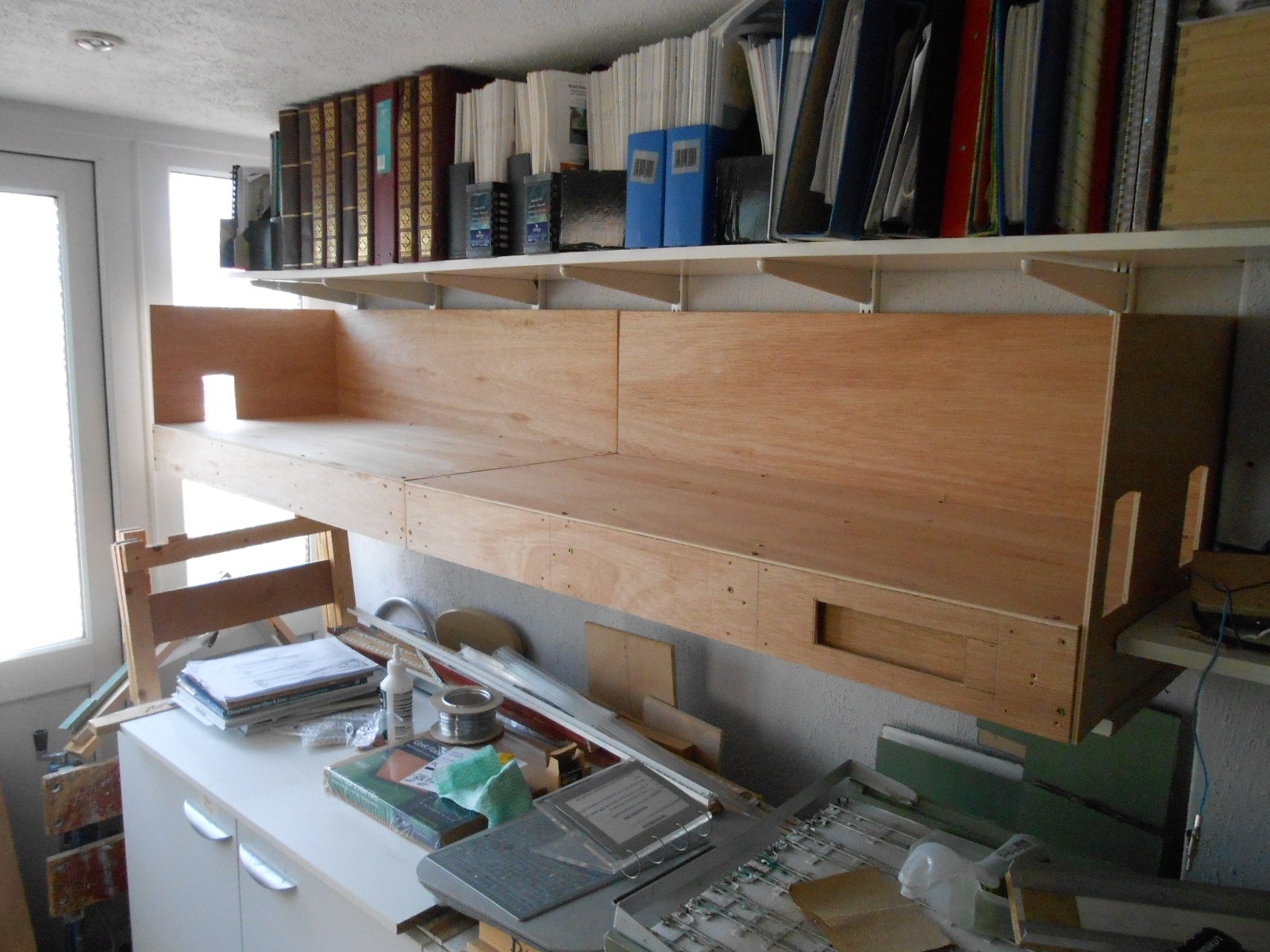

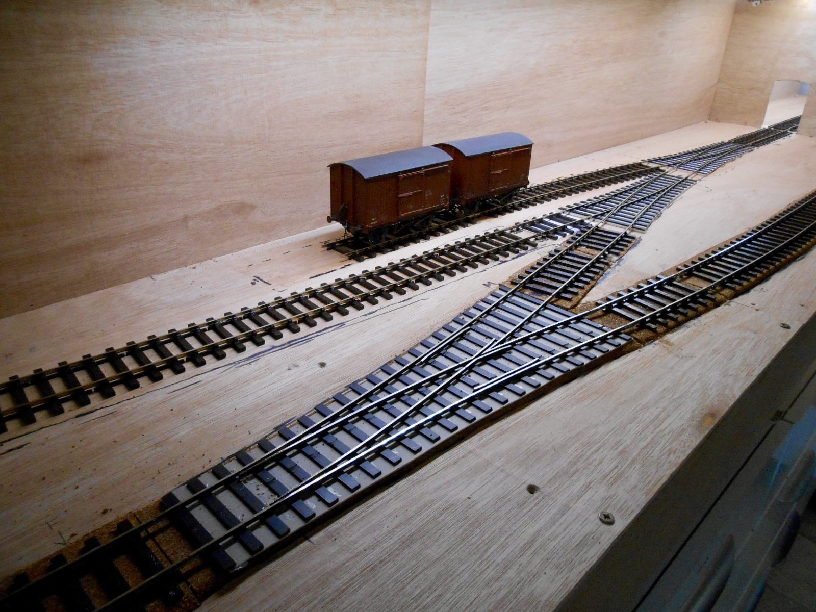

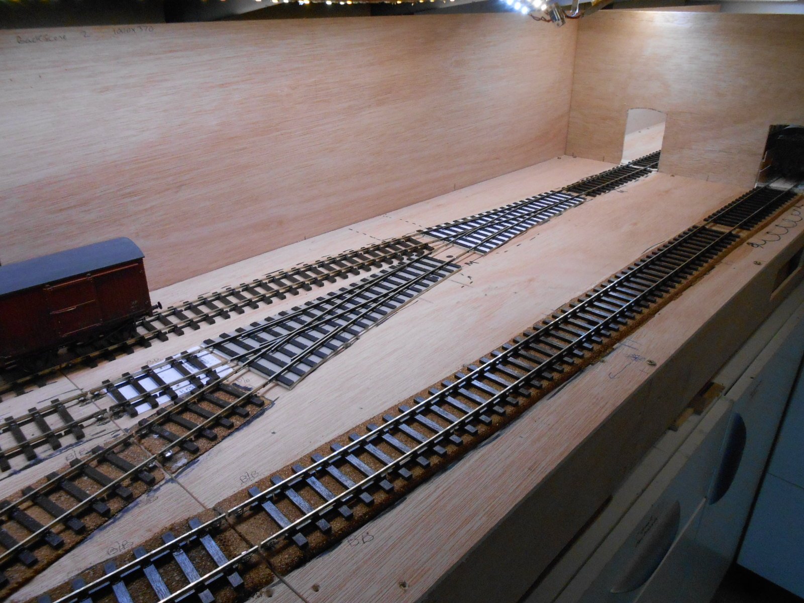

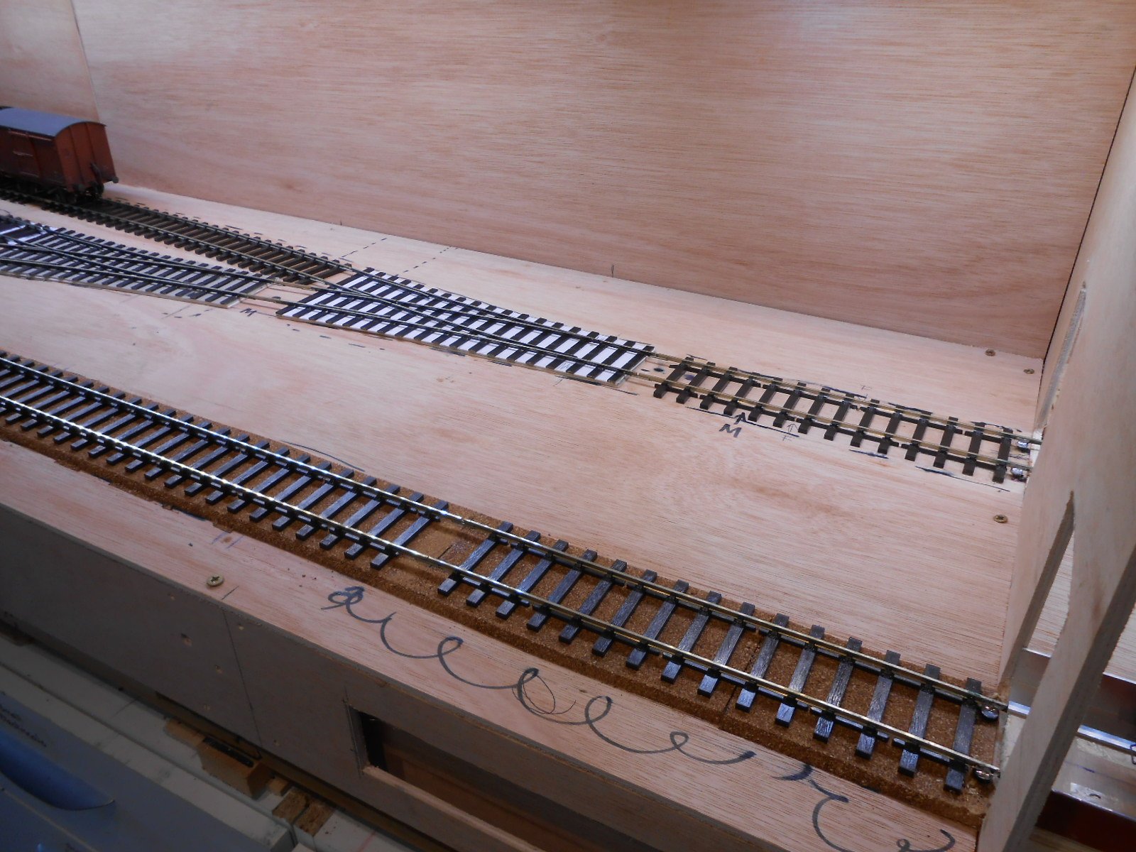

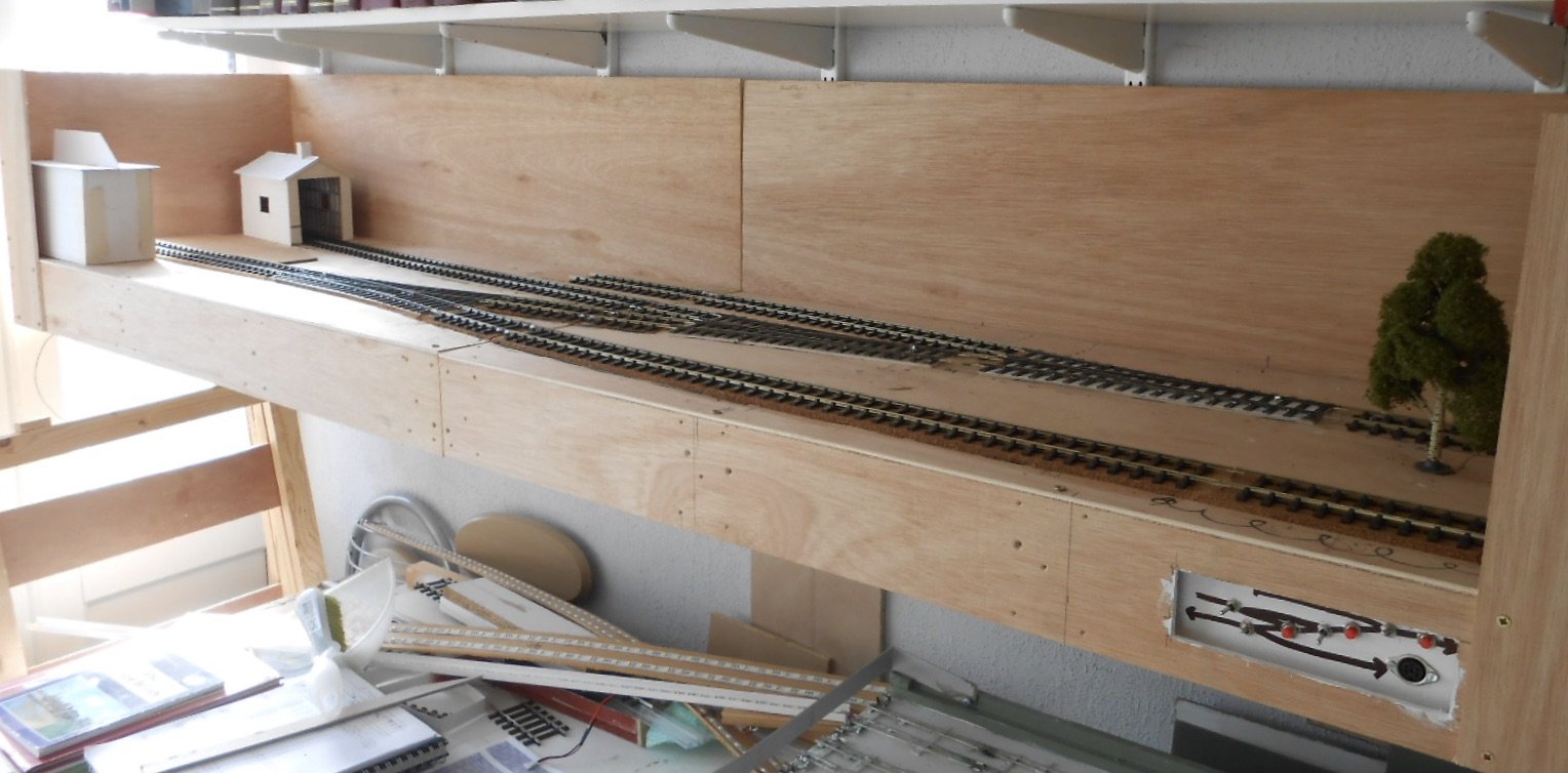

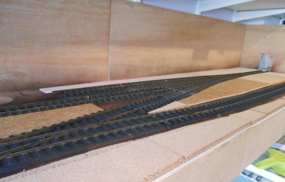

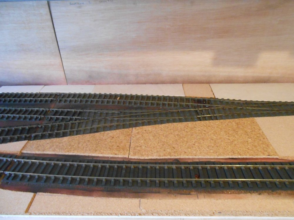

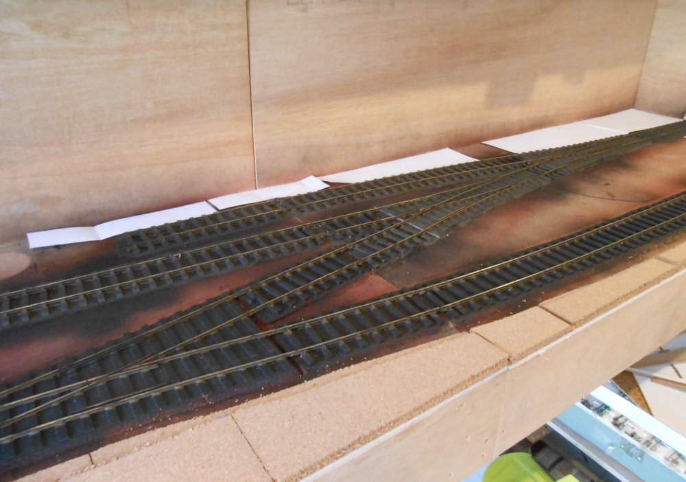

David Holman Posted September 1 Author Posted September 1 The new layout [no name as yet] has now been moved to the lower level in my workshop, so it can sit on the longitudinal beams that I use for my exhibition layouts. This has let me get on with track laying. Couple of surprises here - didn't realise how expensive Peco bullhead track now is [over £11 a yard] and that Marcway points are 2mm shallower, due to their thinner sleepers. Sharp in take of breath with the former, mounting board to level up the latter. Took a while to get the alignments right, but while things are not quite as I'd originally sketched out, I'm happy with the way it has worked out. As you can see, I'm using cork tiles as underlay for the 'main line' track , but the private lines are laid direct to the plywood baseboard surface. Am hoping this will give a small, but noticeable change in levels. The left hand end has caused me much thought and experimentation, to try and find ways of masking the hole in the sky. Current thinking is that the main building will be based on the station house at Snape, while the Tortoise point motor box will be a on crossing keeper's hut. On the other side of the track will be the station [more of a halt really] platform, which a grounded van body will sit. Behind this, where the Wantage tank is waiting, will be a timber loco shed, based on either Wantage or Mid Suffolk types. In front of the platform ramp will be road access to the yard, while between this siding and the mainline, I may put a second short wooden platform, so that should I decide the private line leads to an airfield or a mental asylum, passengers could transfer. The right hand end will initially be shielded by trees, but will eventually be either Snape like maltings, a dairy, or whatever else takes my fancy. Beyond that, is the main fiddle yard, constructed this morning. Main line trains will be on cassettes - have used these many times in the past. At just 27" long, they will hold a tank engine, two wagons, plus a brake [or just a single wagon if it is a tender loco]. Each cassette is simply a piece of 9mm ply with two lengths of aluminium angle as the track. Simple, but effective. At the moment, the plan is to have further cassettes racked on the back board of the fiddle yard. The off scene private railway track is just a length of Peco. On line orders are gradually arriving to enable the wiring: point motors, electro magnets for uncoupling [Alex Jacksons], plus switches, sockets, wire etc. Never my favourite occupation, but needs must! 5
Galteemore Posted September 1 Posted September 1 That’s coming on very nicely. Great minimum space layout. 3 1

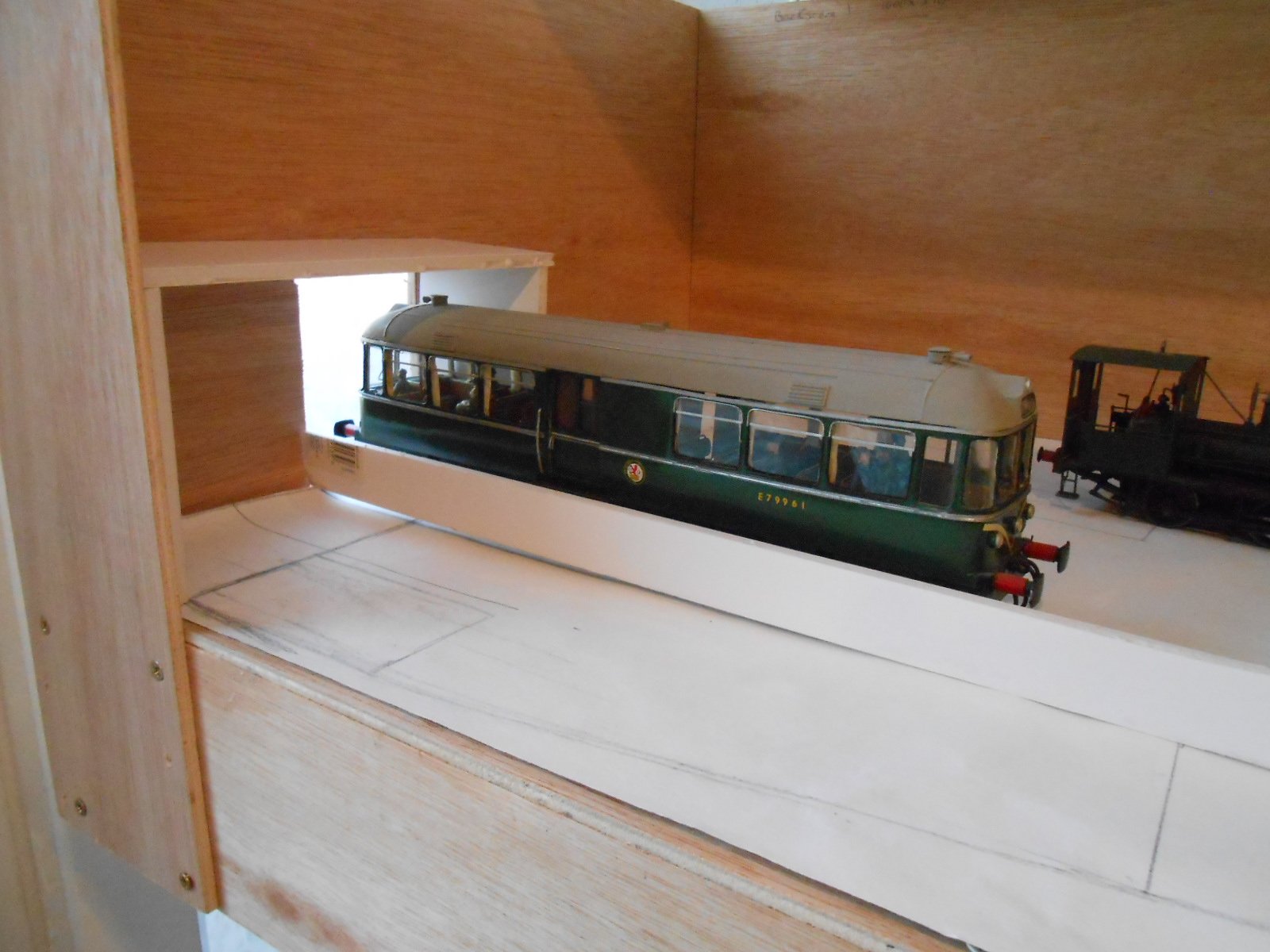

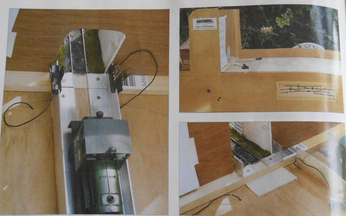

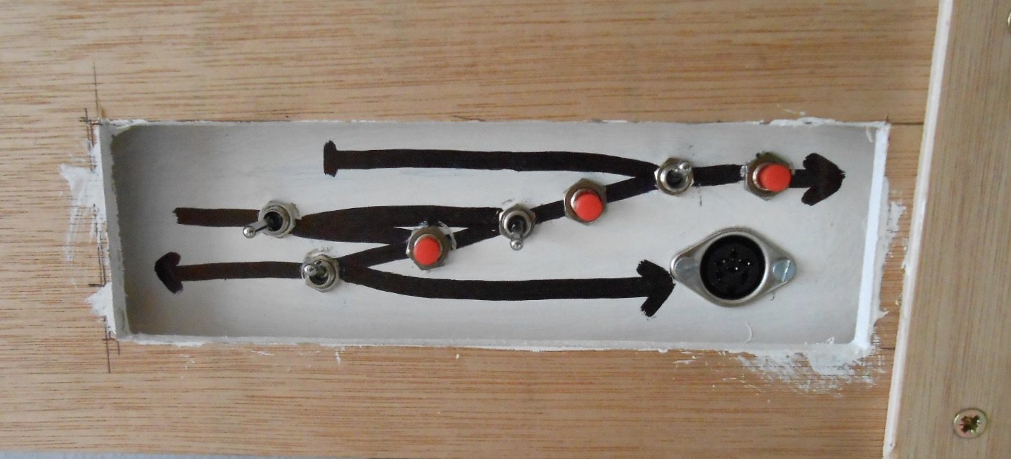

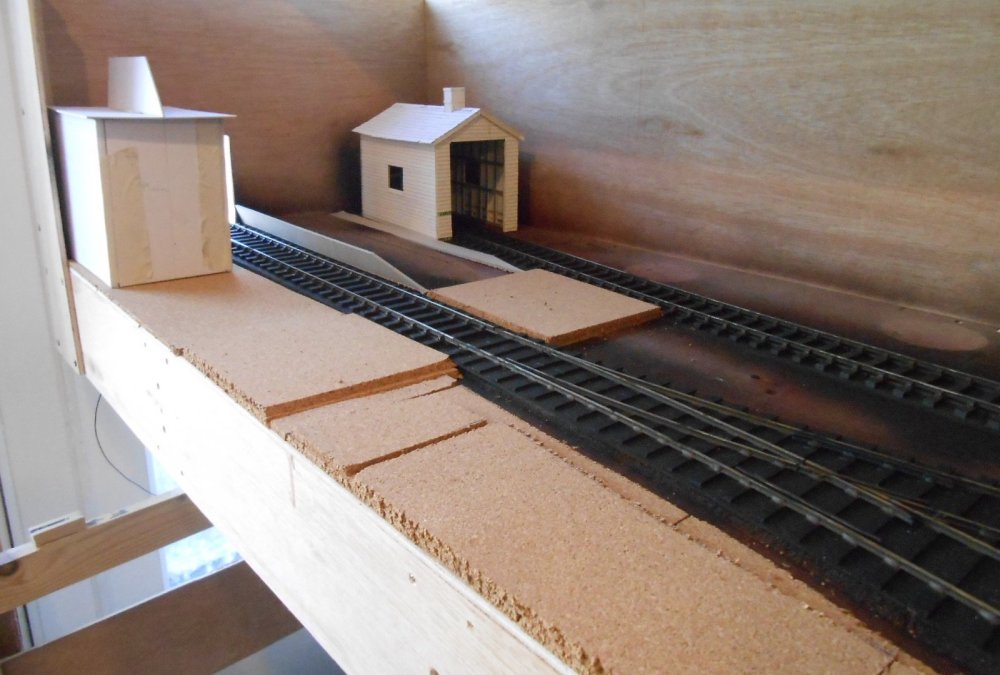

David Holman Posted September 3 Author Posted September 3 Been making lists, to try and minimise the pain of wiring. So, holes drilled for sockets, switches, point motors and the like, along with fitting the wings of the 'proscenium arch, each end. Very Iain Rice. The inlaid control panel with have three point switches, three push to make switches for the uncoupling magnets, plus an isolating switch for the loco shed. Am using Tortoise point motors, but as these are about 10cm deep, I make simple brackets from plywood, so they can be mounted on their sides. Above, you can see where I've drilled holes next to each point blade. A piece of stiff wire is soldered to each blade and then to a piece of copperclad below the baseboard, which then acts as an invisible tie bar. Below, you can see the brackets I've made for the Tortoises, with the hidden tie bar alongside in the second picture. The bracket includes a pivot arm, with the torsion rod from the tortoise going through one end and [eventually] a piece of stiff wire the other, going to the tie bar. Clever idea that I was given by Gorden Gravett. 7
Mol_PMB Posted September 4 Posted September 4 Very nice work and ingenious use of the Tortoises on their sides. I also like the invisible tie bar concept! 1

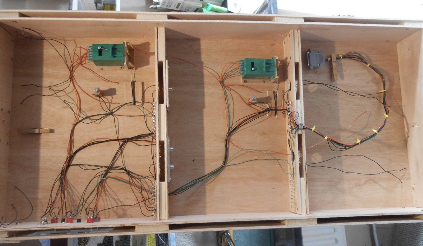

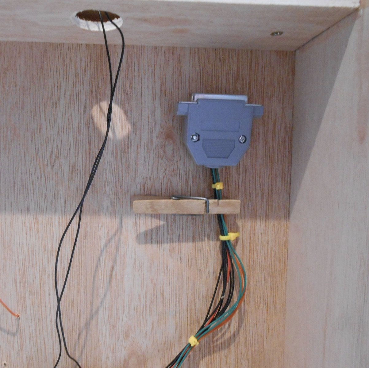

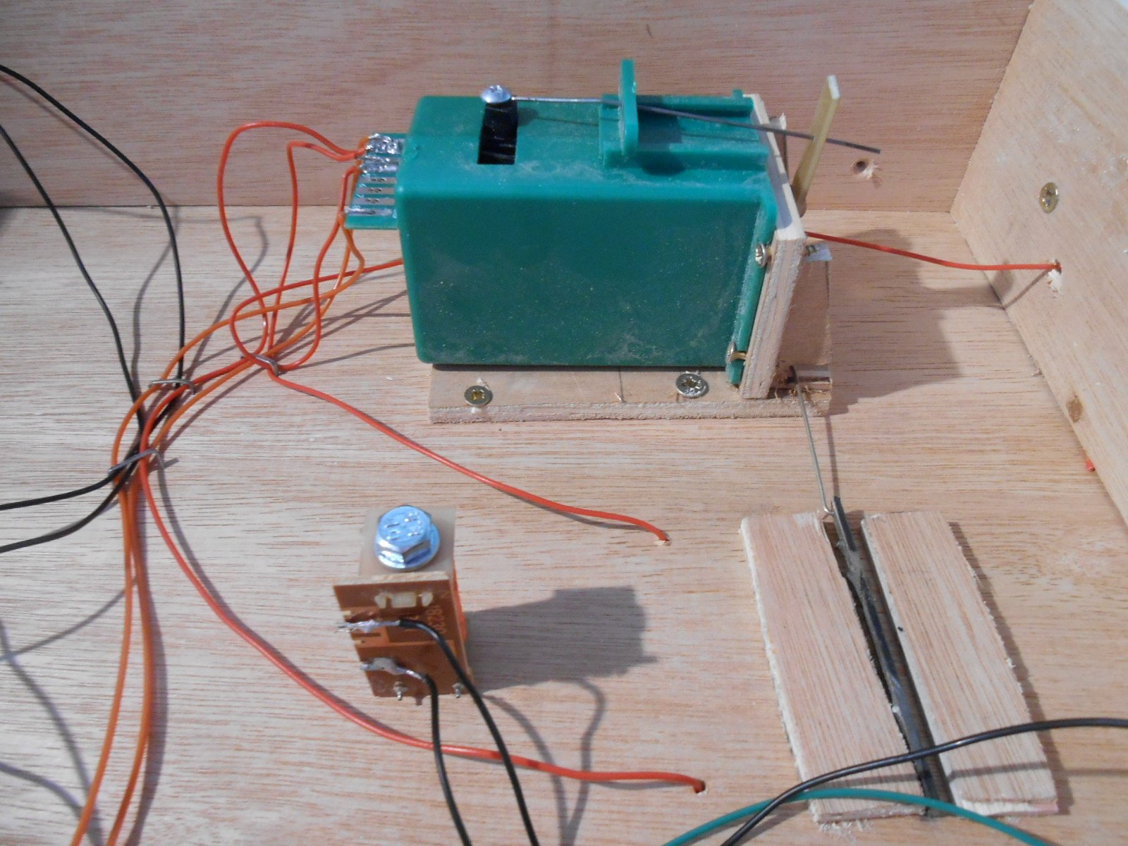

David Holman Posted September 21 Author Posted September 21 Oh frabjous day! Callou! Callay! He chortled in his joy. [Jabberwocky, in case you are wondering] Yes, the wiring is done. Fairly conventional: I have long used tag strips and a wiring diagram, so don't worry too much about coloured wires. That said, have used black for track, orange for points and green for electro magnets. A couple of tricks were to mount the Tortoise point motors on their sides and hot glueing a clothes peg to the underside of the baseboard to hold the computer plug and socket. Made a bit of a horlicks of the mimic diagram for the control panel, but hopefully it can be touched up with a fine brush. With the track laid and wired, have been playing around with sight lines and basic buildings. To this end have been building a loco shed and have mocked up a station building shell, which will be closely based on the one at Snape Maltings. More on these later, though with the Farnham/Aldershot show coming up soon, now need to turn my attention back to Irish matters, in order to make sure Northport Quay is working well. 4 1
Flying Snail Posted September 21 Posted September 21 10 minutes ago, David Holman said: A couple of tricks were to mount the Tortoise point motors on their sides and hot glueing a clothes peg to the underside of the baseboard to hold the computer plug and socket. That's a top tip right there .. like all the best ideas its so simple when you see it!! 2

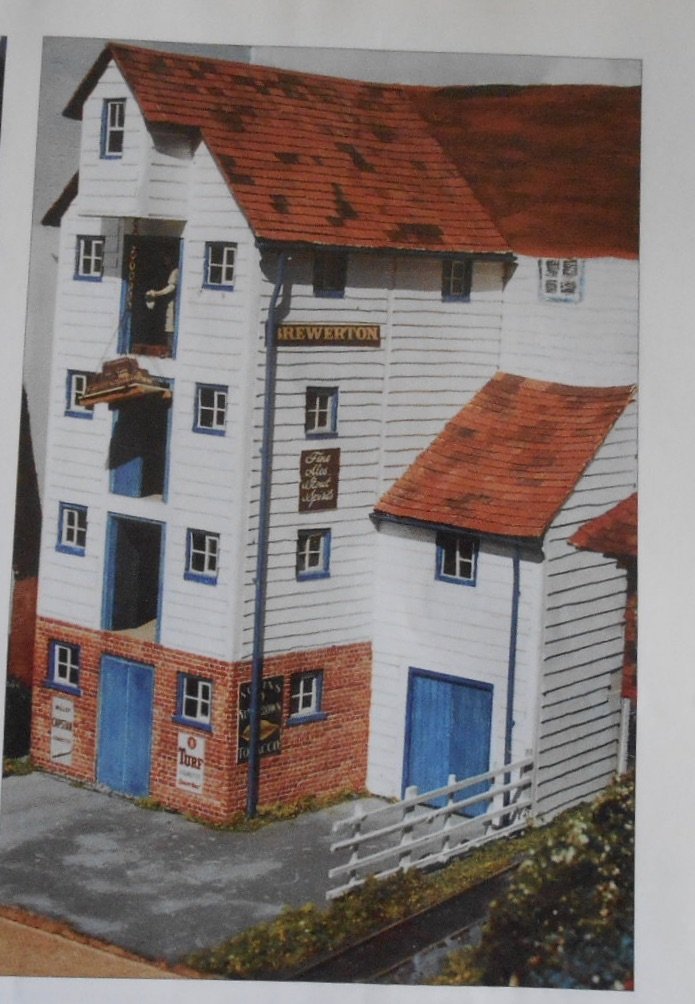

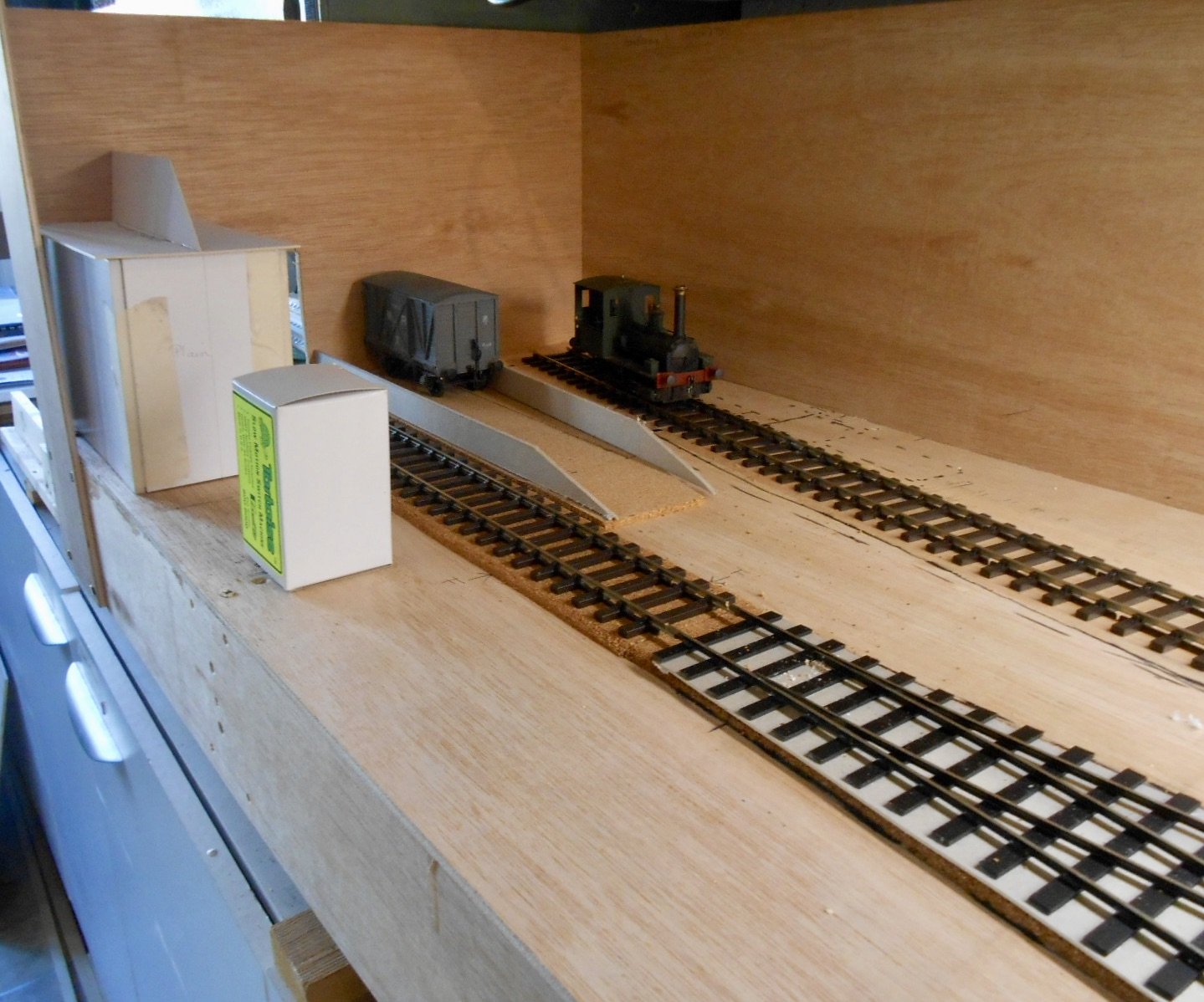

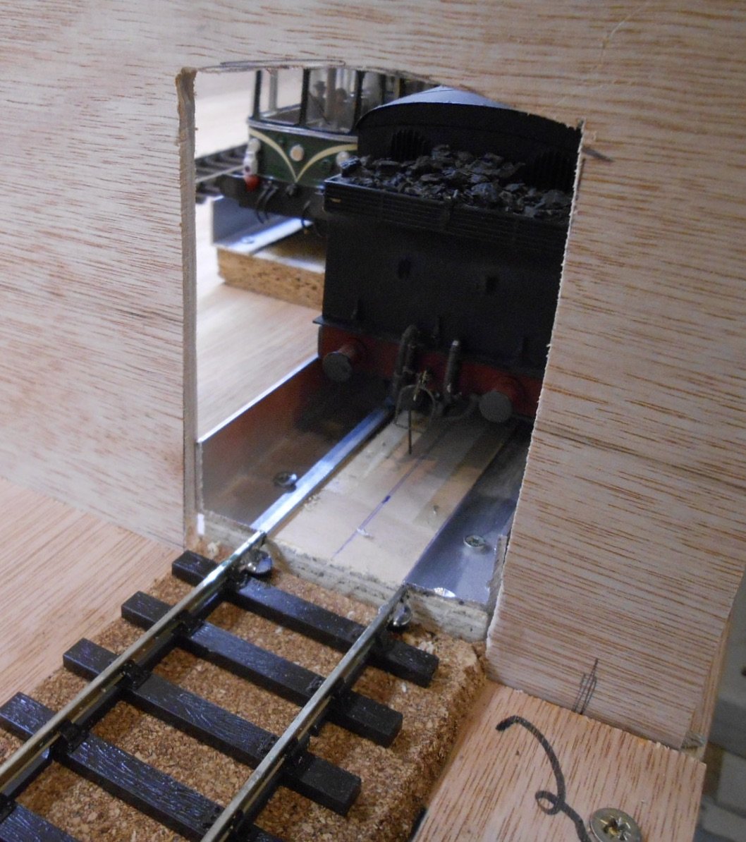

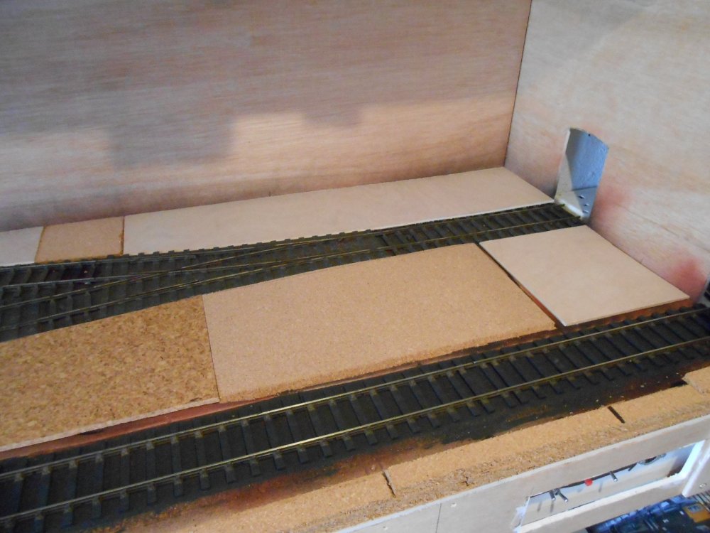

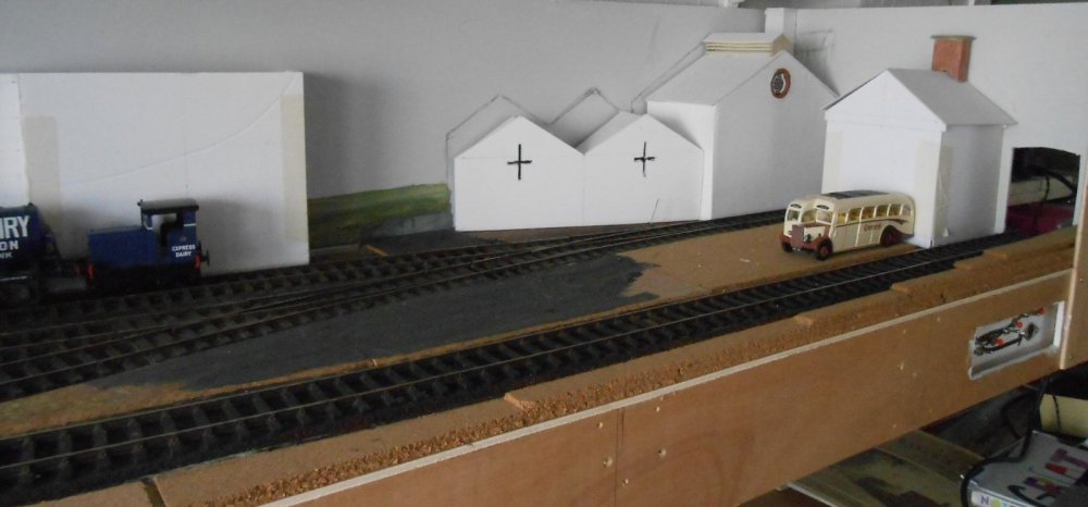

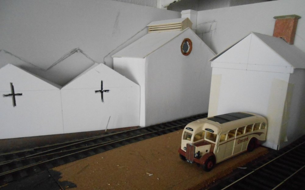

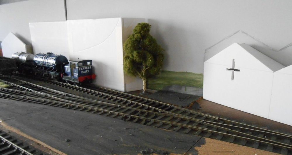

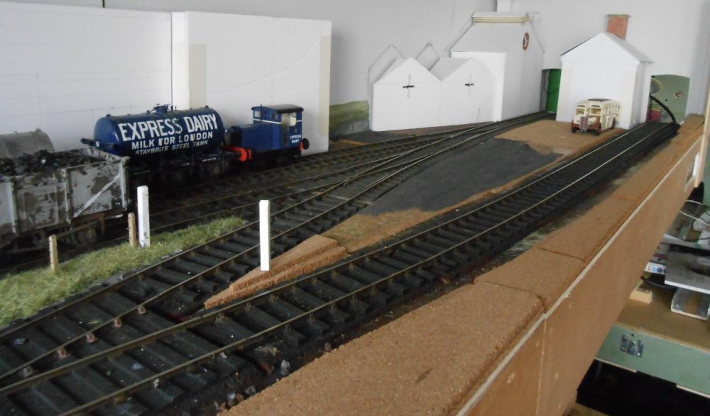

David Holman Posted November 17 Author Posted November 17 After two shows with my Irish stuff, fancied a change to the new layout. As ever, despite many ideas for the scenic side, things aren't quite working out as I'd thought. Am currently happy with the left side of the layout. The hole in the sky will be hidden by the station house (based on Snape), with interest in the corner provided by the platform end, a grounded van and the loco shed, complete with water tank and coal stage. Have managed to paint the back scene a suitable light, plain sky colour and at the moment the middle section is going to include a stand of fenland like wind break trees. These, from forest in a box (aka sea foam) will sit a top a low cutting The eventual intention is this section may become a small diary, but Wild Swan's Milk on the Rails is currently out of print. The right hand side was going to be based on Snape Maltings, but having drawn a couple of sections out on mounting board am thinking they look too big and rather dominate the scene, making it look unbalanced overall. Thoughts now turning to Garret's engineering works at Leiston, where their private line left the station via a narrow lane, squeezing between various buildings none of them particularly tall. 5
Mol_PMB Posted November 17 Posted November 17 15 minutes ago, David Holman said: The eventual intention is this section may become a small diary, but Wild Swan's Milk on the Rails is currently out of print. The right hand side was going to be based on Snape Maltings, but having drawn a couple of sections out on mounting board am thinking they look too big and rather dominate the scene, making it look unbalanced overall. Thoughts now turning to Garret's engineering works at Leiston, where their private line left the station via a narrow lane, squeezing between various buildings none of them particularly tall. I like the idea of Garret's works, how many lowmac wagons have you got for their products? 17 minutes ago, David Holman said: The eventual intention is this section may become a small diary, but Wild Swan's Milk on the Rails is currently out of print. I'm not sure that East Anglia has the right climate for growing dates I do like your approach of roughly mocking up the buildings to get a feel for the size and proportions. I need to do that for Quartertown Mill. My version will probably be to draw something rough on CAD and laser it into cheap cardboard. Then I can develop the CAD into a final version. I've got lazy with the scalpel since I bought the laser! 1
David Holman Posted November 18 Author Posted November 18 No lomacs (yet), but the idea of the layout is both to use some of my older models as well as providing an excuse for building a few new ones. Not sure about Sirapite, but the Heljan 48DS, especially in Express Dairy livery is very tempting, even though it would break the habit of a lifetime by buying something rtr! 1

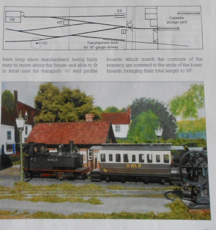

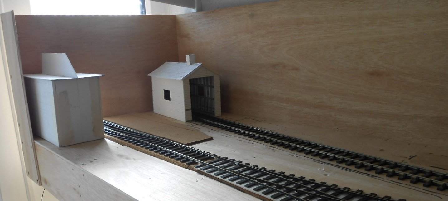

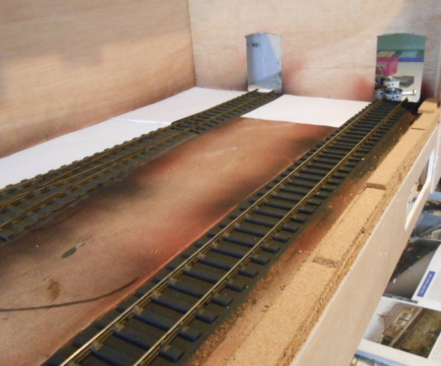

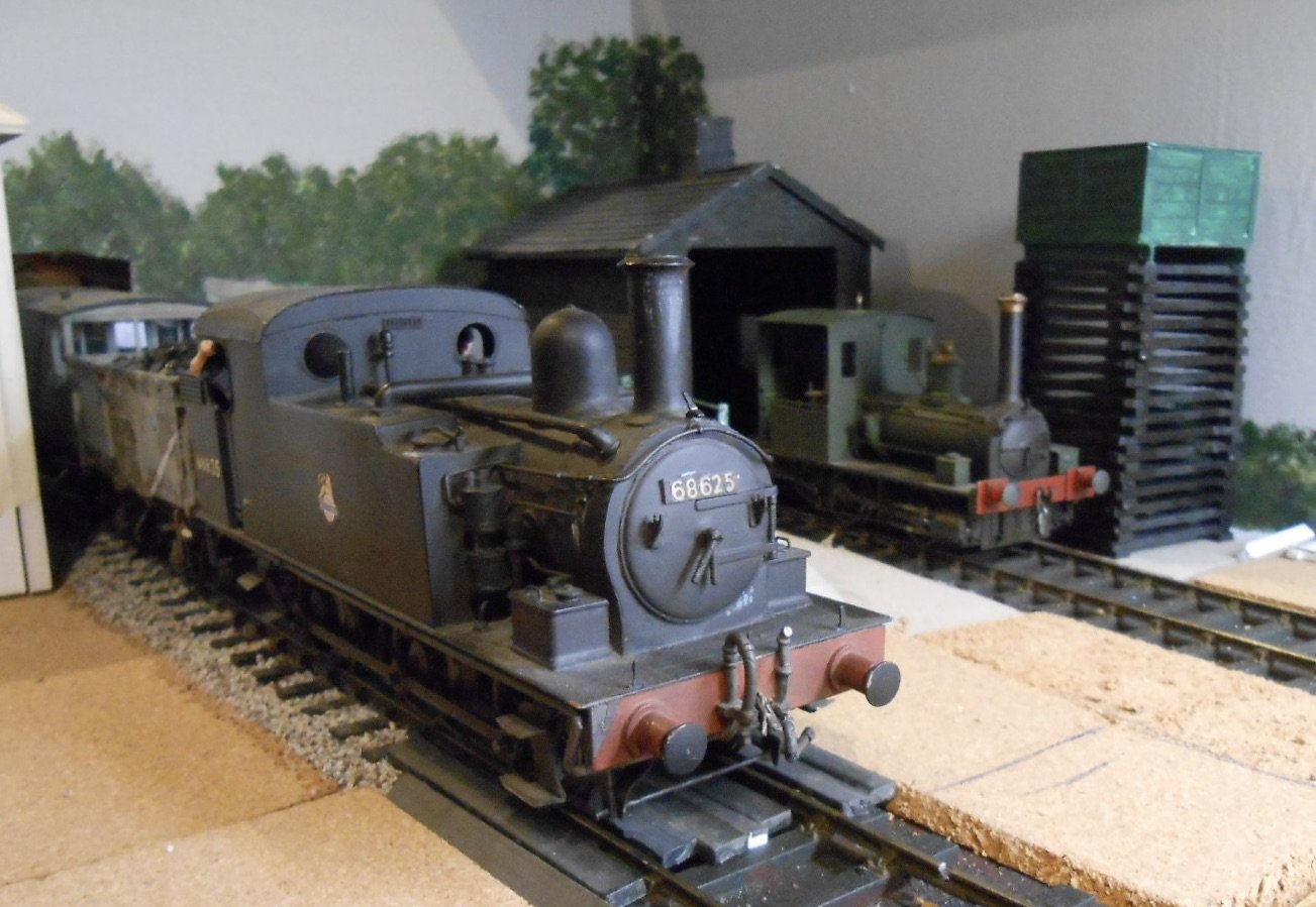

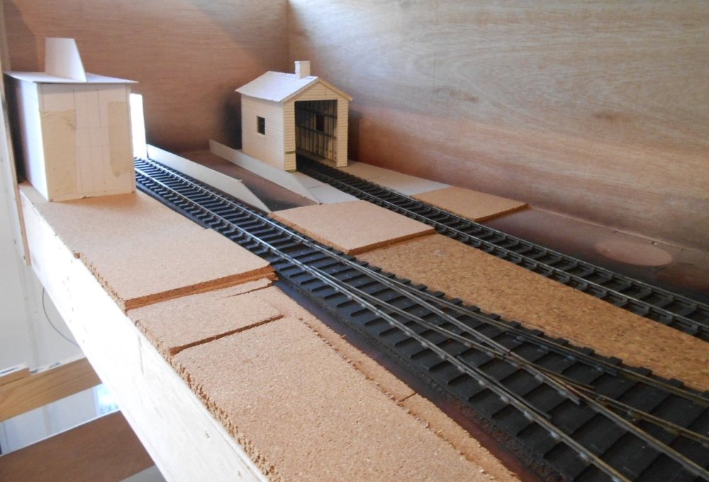

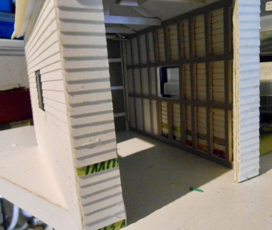

David Holman Posted November 20 Author Posted November 20 Managed to get both ends of the layout 'blocked in' now, having thought long and hard about the composition. Post Tolworth, have been asked by the Gauge 0 Guild to write an article about Swillybegs/Fintonagh & while drafting this realised what I had done for this layout was also needed now. Looking through my many books again for inspiration, found it in two of my favourite pictures - one of the exit from Wantage Town & the other of Leiston, & the line to Garrett Engineering Works. Each show a railway sneaking away between houses and industry: in the case of Wantage, the buildings on the left are the town gas works, so both options provide plenty of traffic. So the right hand side of the layout is a mix of the two, with what will be the works office filling the space between the two lines and low relief gas works buildings forming the back scene. An access road crosses the works tracks [and this will curve away behind the gasworks on the back scene]. The two slightly fuzzy pictures below show how I tried to make a very low relief building look like it is extending into the back scene. One thing I've always disliked is buildings that are simply cut off at the sky. On the other side of the layout, finally got around to mocking up a hipped roof for the station house and likewise more structure to the platform. An old Slaters Midland Railway van has been grounded on the platform, while behind this, on the back scene, the rest of the platform [including part of a shelter] has been sketched in to suggest the line disappearing into the distance. As for the centre of the layout, a small milk depot is still favourite, but for now, I have plenty to be getting on with. 9
Galteemore Posted November 20 Posted November 20 Coming together really well David: and the techniques you’re demonstrating are widely applicable

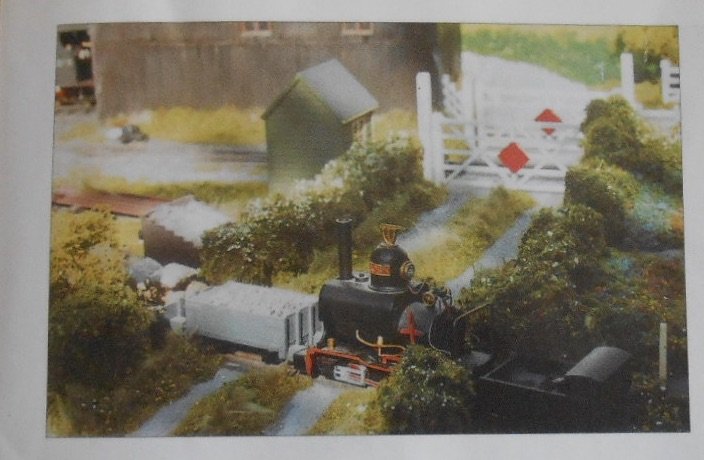

Georgeconna Posted November 21 Posted November 21 Are the Cylinders on top of the boiler on that loco. Traction engine style? Looks like a good start!
David Holman Posted November 21 Author Posted November 21 Yes George, a traction engine on rails. It is called Sirapite and was originally going to be named after a gypsum product - plaster of paris. Until somebody realised that Parisite didn't sound too good. 3

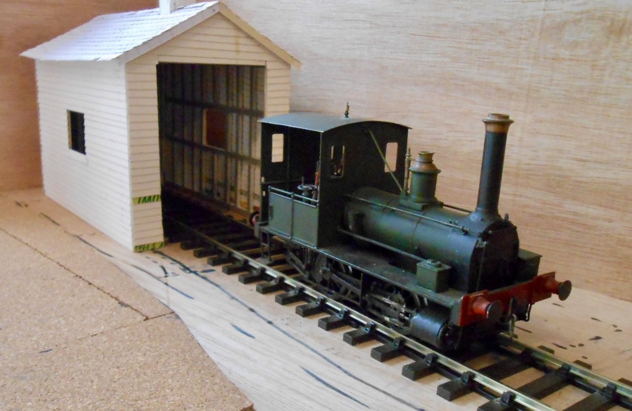

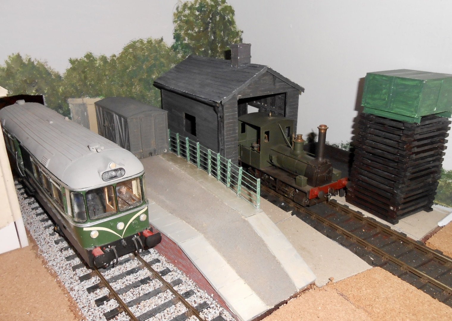

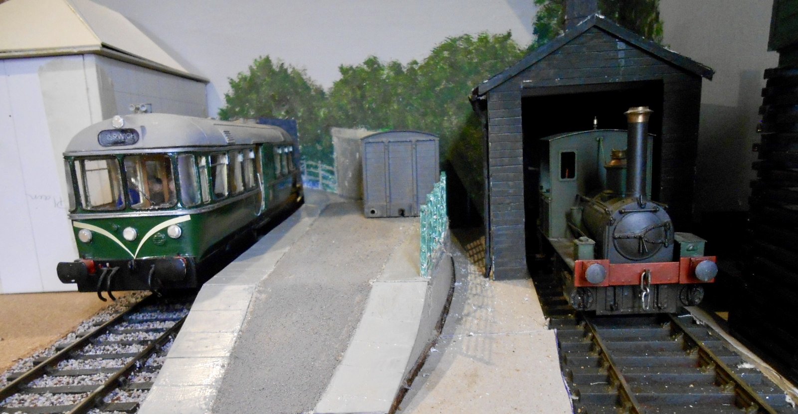

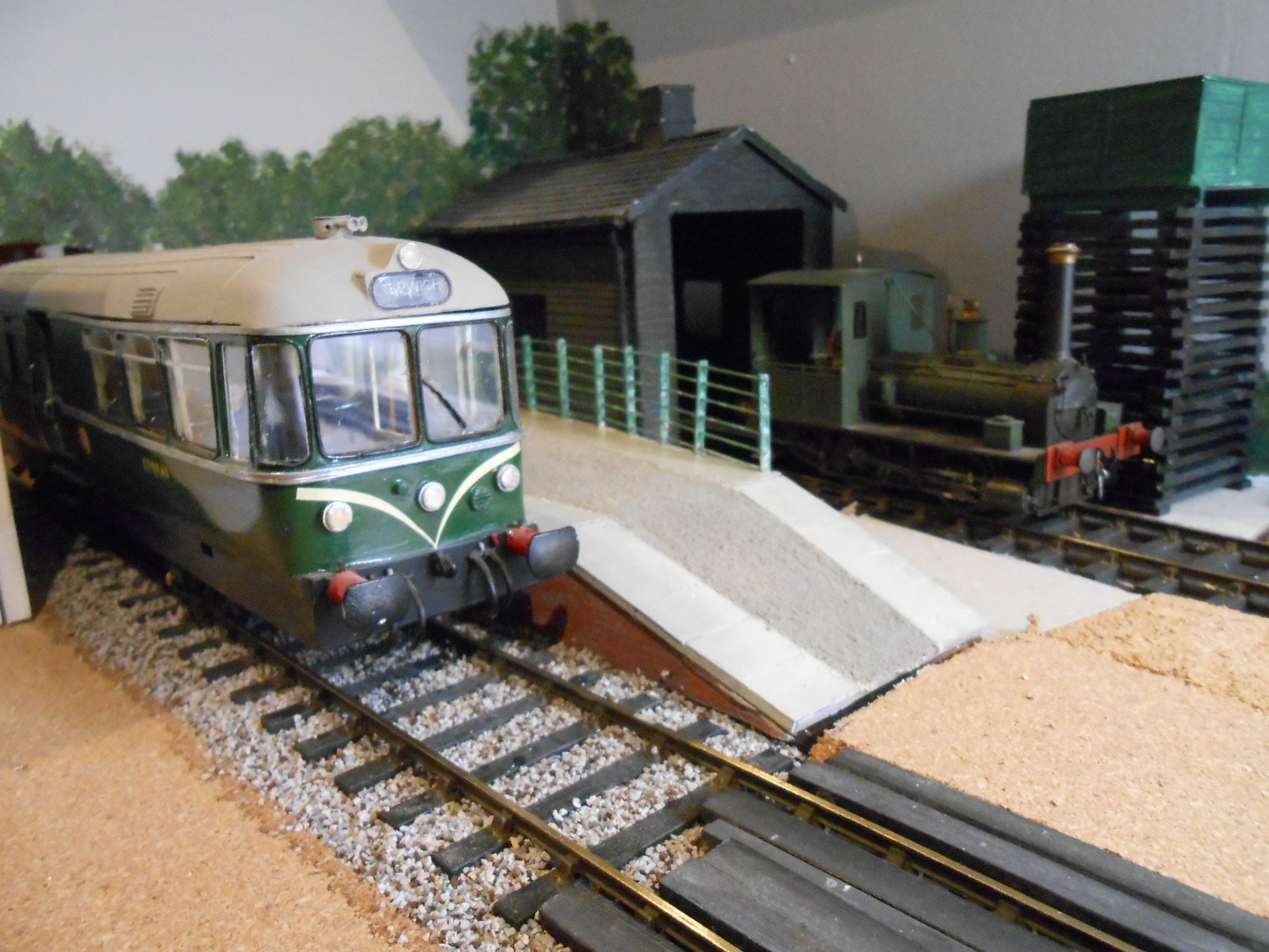

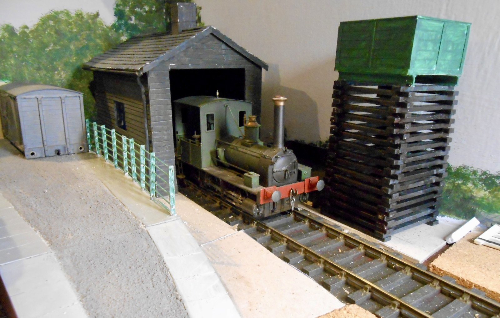

David Holman Posted November 23 Author Posted November 23 Decided to try and fill in a complete section this week, so made a start with the left hand side, where I'd got several pieces on the go, namely the platform, loco shed, water tank and coal stage - none of which had been painted, or indeed fixed down. However, the first job was to paint the some of the back scene: a few trees, plus a suggestion of the platform merging from 3D into 2D. The platform was was covered in some Howard Scenics embossed brickwork that I've had in a folder for a good 20 years [!], then coloured with wax acrylic crayons, followed by a wash of mortar colour. The platform surface is just thick card, with the paved edges being plastic sheet. Surprised myself by creating concrete colour with a mixed of mainly white, plus small amounts of yellow ochre & black, applied in several thin washes. I'd actually tested this on a garden water feature which I've been repairing & found it a good match for the real thing. The other items have received a couple of coats of paint, but now need detailing & weathering, but couldn't resist posing a few items of stock to help set the scene. 5 1
Mol_PMB Posted November 23 Posted November 23 The trees look very effective. Hopefully I can achieve something similar with mine.
Galteemore Posted November 23 Posted November 23 Fabulous - the little tank looks so at home in its shed !
