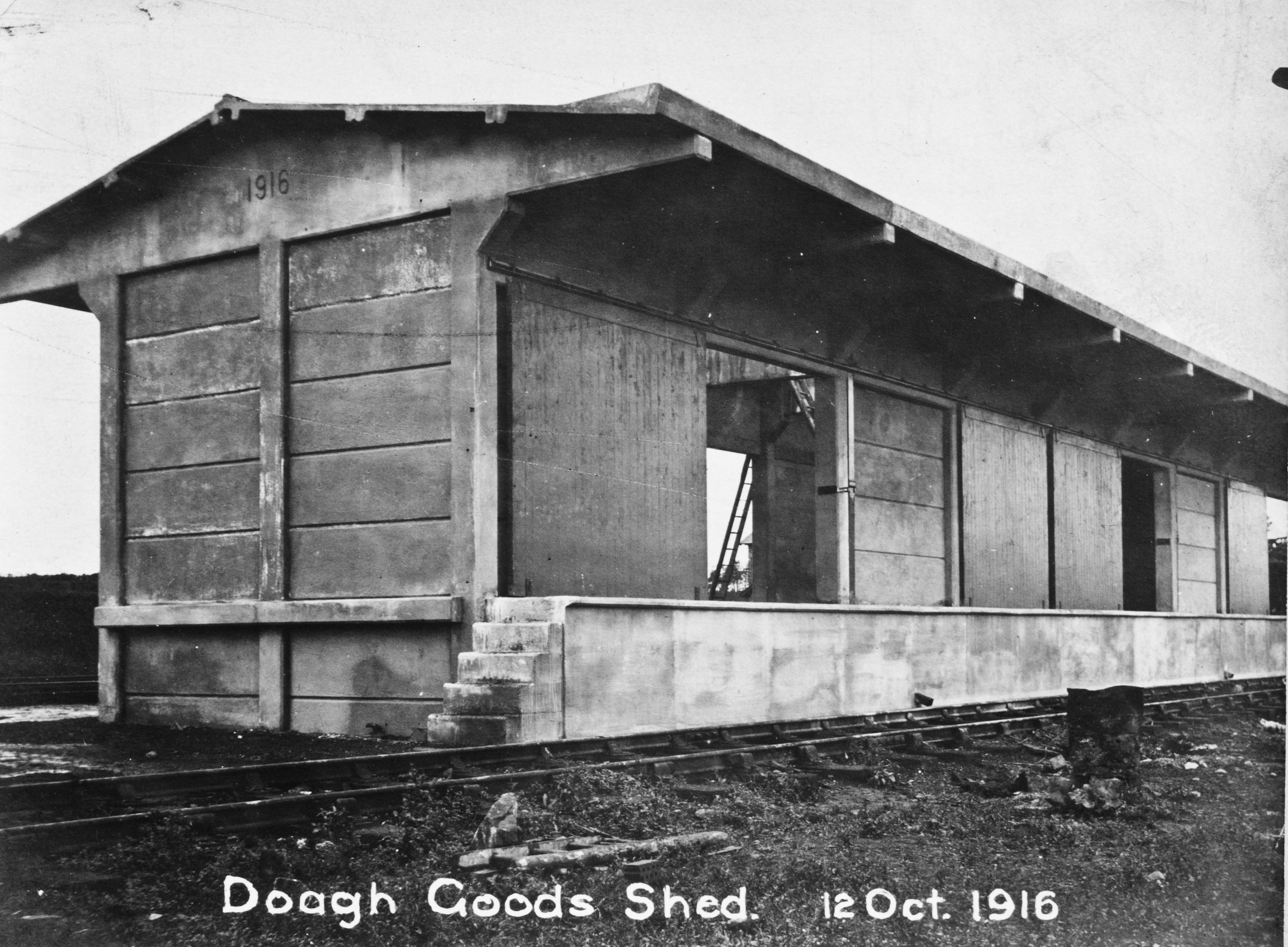

The NCC made good use of concrete structures from fence posts to buildings and had a concrete casting yard at York Road. One of their products was the goods shed at Doagh, built from cast concrete sections in 1916. I have a small goods area so I thought that a reduced size shed like the one at Doagh would be ideal. I have some photographs taken during construction - If I remember correctly, I photographed them from a page in a book at the IRRS premises. I presume they were official photographs by the NCC.

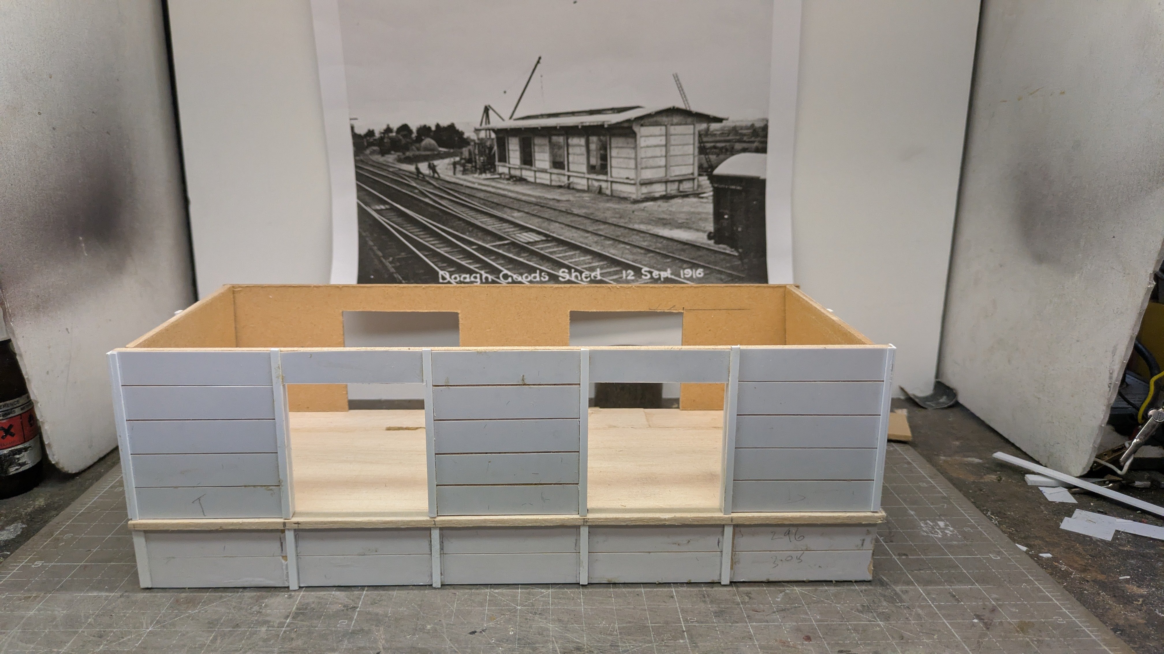

The basic structure is bass wood, balsa and 2mm mdf cutwith a knife or on my small bandsaw. A machine that has proved invaluable for many projects on the layout! The shell is then overlaid with strips of Evergreen plastic to build up the features.

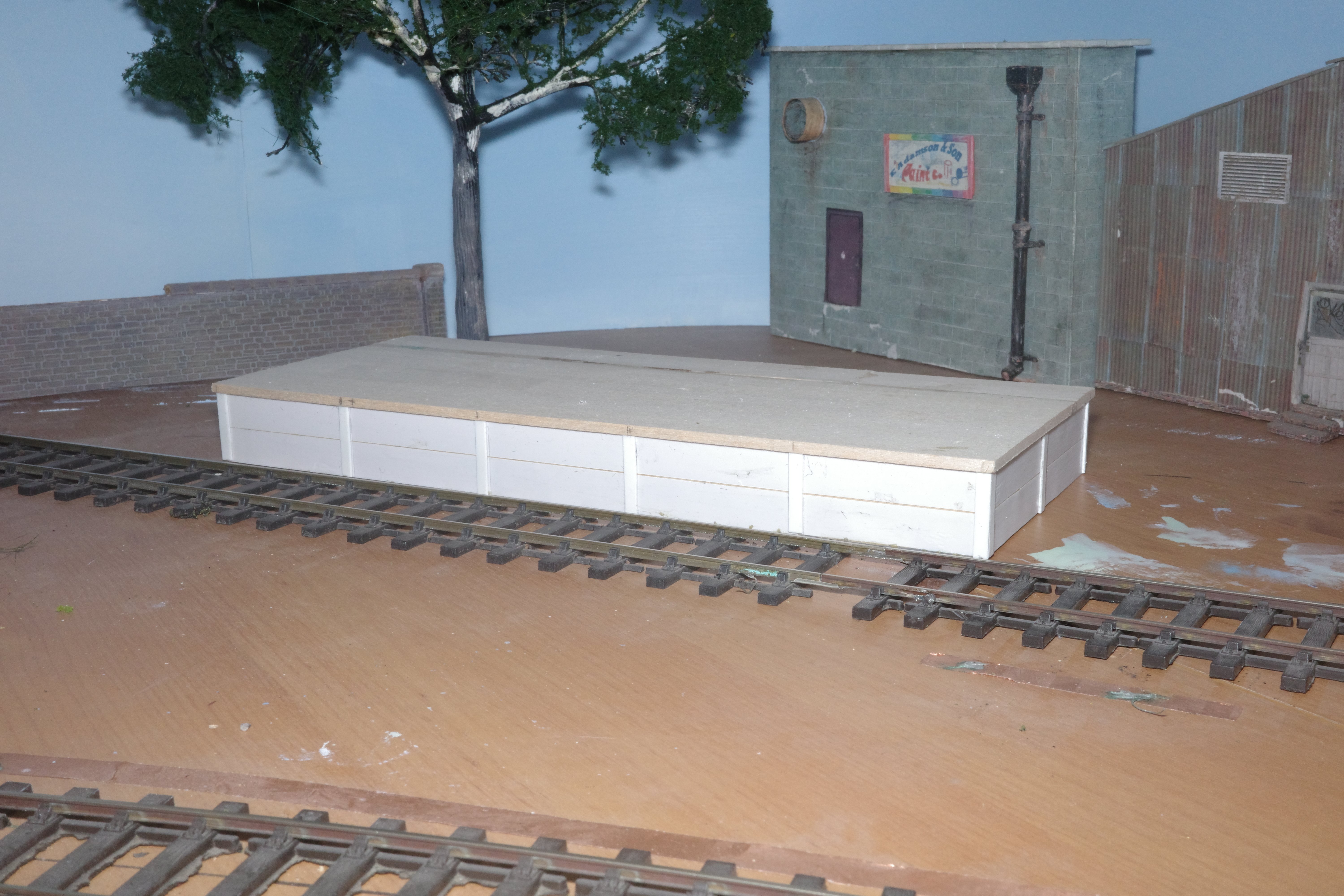

I made the base separately

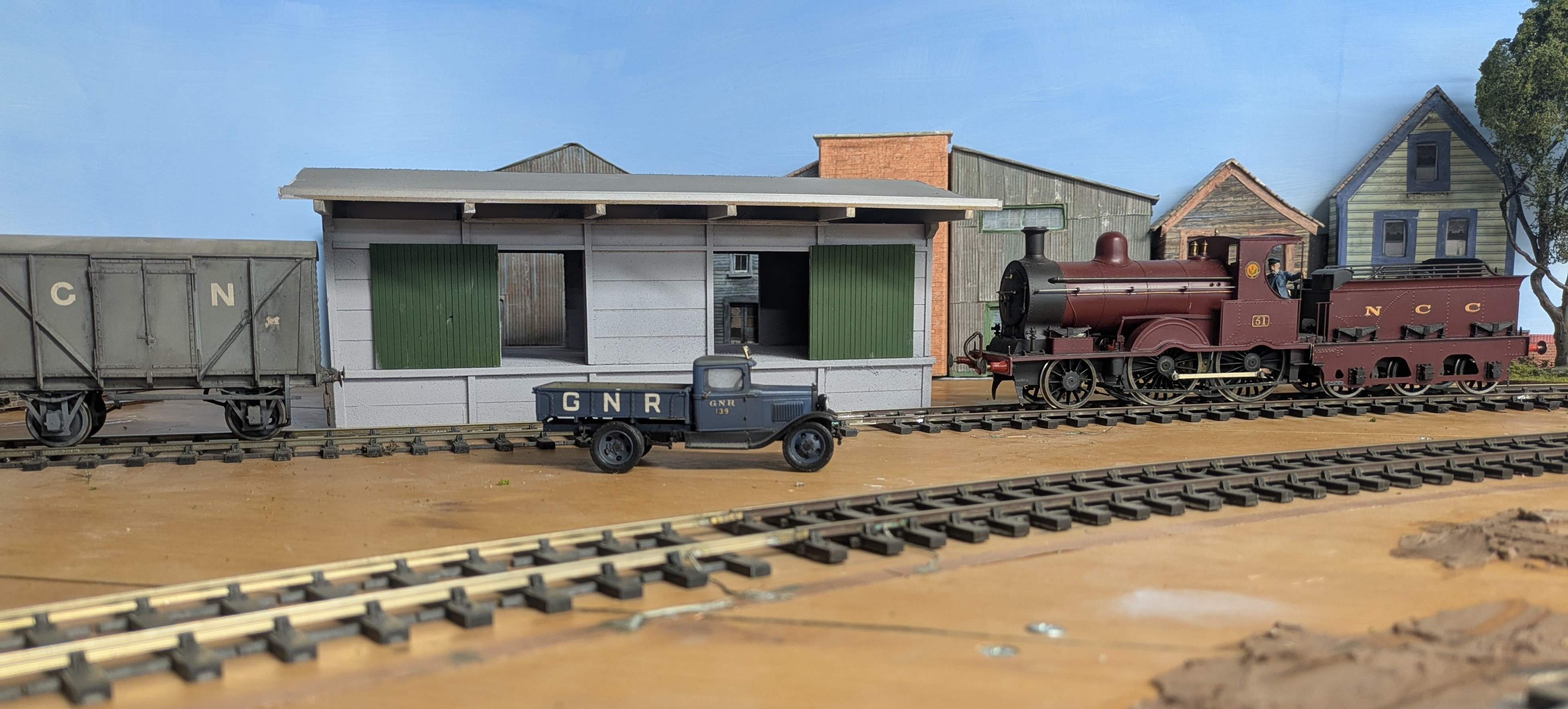

And now approaching completion. I'm not modelling any detail inside and the rear is just mdf. Time is of the essence! Some weathering will improve its appearance.
  • Like 13
Looks way nicer that the prototype, which must have been a horrible place to work, especially in winter. Handsome 2-4-0 lurking  in the background.
