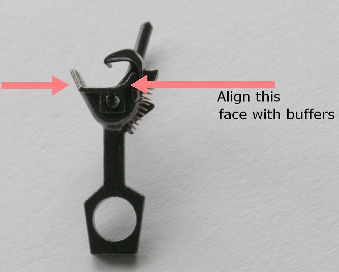

Bizarre that the IE/IR livery have different size pockets to the CIE livery cravens.
Photo from RMweb Kadee Resources page

Reading the resources on kadees , I don't believe the NEM versions are a solution
I have to agree. Body mount a draft box Kadee would be the ideal solution. I don't own any MM Cravens so I can't comment on the amount of work required to get the couple sitting at the right height but anything would be better than faffing around with NEM pockets!

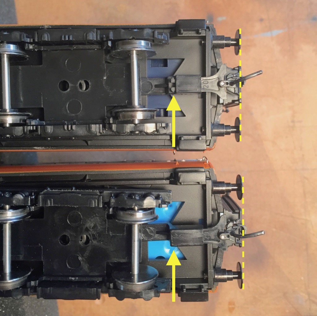

I've posted a copy of this to my workbench also but for completeness of this thread I've add the photo here also.  Found a way to easily get the tension lock couplings off Murphy Model mk2 aircon coaches without damaging them with force, and as per @BosKonay's recommendation glued a Kadee no 19 and no 20 under the NEM pocket of my mk2 coaches.  Then I couple the no 20 end of one coach to the no 19 of the next, alternating each coach.  So far has worked a treat in forward and reverse.
