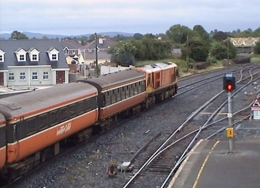

0 Irishswissernie Posted April 20, 2017 Posted April 20, 2017 Cravens and other non air conditioned types never ran in service with "supertrain" types, though a very small number of instances of older types being towed out of service behind a Mk 2 (but not Mk 3) set did occur. This reminded me of a trip I made on the early morning (I think about 6am at Limerick Junction) Cork to Dublin in June 2003. The set normally compose of Mark 2 Air conditioned stock had a Cravens at the head end . It was in use, you can see the windows on the doors are open. A couple of 'stills' from my video Ernie
0 craven1508 Posted April 20, 2017 Posted April 20, 2017 nice find, i think theres a photo on eire trains site with cravens mixed with mark 2 galways and others.
0 jhb171achill Posted April 20, 2017 Posted April 20, 2017 Absolutely brilliant, Ernie, a great find. Such instances were exceptionally rare indeed. In terms of generators, such trains had the converted Dutch vans.
0 DiveController Posted April 21, 2017 Posted April 21, 2017 In terms of generators, such trains had the converted Dutch vans. Three Dutch vans were rebuilt to run with the ex-BR Mk2A rakes of the early 1990s. The original builds could run with any vacuum braked stock such as the Mk2D Aircon stock
0 Dhu Varren Posted April 21, 2017 Posted April 21, 2017 I would suggest that it is highly unlikely that the Cravens coaches shown in the trains of Mk 2 AC coaches earlier would have been in service. Although both types of coaches are vacuum braked and could run together, from a passenger point of view, the gangways on the Cravens are totally incompatible with the Mk 2s. The Cravens are steam heated, so there would have been no heat available, and the electrical systems are probably not compatible either. Three Dutch vans were rebuilt to run with the ex-BR Mk2A rakes of the early 1990s. The original builds could run with any vacuum braked stock such as the Mk2D Aircon stock The original Dutch vans could run 'out of service' in a train of Mk 2 AC stock but, like the Cravens, their gangways were incompatible, and their electrical systems were not suitable for running air conditioning. The three rebuilt Dutch vans were only suitable for use with the Ex BR Mk 2a & 2b coaches obtained secondhand in 1990/91, as these coaches, unlike any other IR coaches apart from Mk 3s, were air braked, and their electrical systems totally different to any other IR coaches.

0 Irishswissernie Posted April 21, 2017 Posted April 21, 2017 (edited) The Cravens was in use; I traveled in it from Limerick Junction to Portarlington. I didn't notice that the corridor connection would be locked as I didn't need to switch coaches. As it was a warm day 18th June 2003 (found me diary!) the lack of heating didn't twig either. Ernie Edited April 21, 2017 by Irishswissernie
0 DiveController Posted April 21, 2017 Posted April 21, 2017 (edited) The original Dutch vans could run 'out of service' in a train of Mk 2 AC stock but, like the Cravens, their gangways were incompatible, and their electrical systems were not suitable for running air conditioning. Thanks for the correction and explanation, David. The Cravens was in use; I traveled in it from Limerick Junction to Portarlington. I didn't notice that the corridor connection would be locked as I didn't need to switch coaches. As it was a warm day 18th June 2003 (found me diary!) the lack of heating didn't twig either I suppose IE could strengthen with the Craven in limited circumstances, return to non-gangwayed coaching, in summer during daylight hours, though this must have been an exceptional circumstance. Edited April 21, 2017 by DiveController

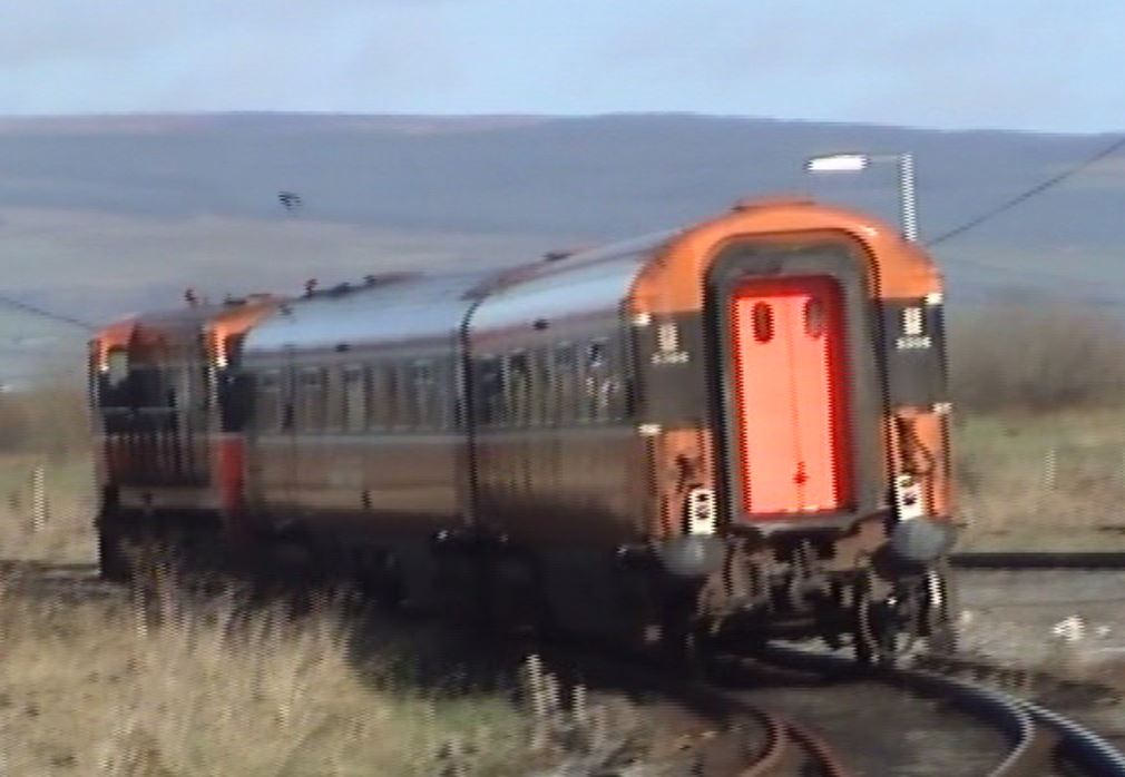

0 Irishswissernie Posted April 25, 2017 Posted April 25, 2017 It's possible the coach was not supposed to be in use but that someone forgot to lock the doors... Yes, this is the most likely explanation, I thought nothing of it at the time but then I had been up since 5am and had to sort out my own breakfast at the Ballykisteen Lodge B&B etc. As for locked gangway doors, I regularly caught a service from Basle to Zurich Flughafen at Brugg which had a double deck First Class coach in the single level set. Its connection was/is at the upper level,but it was always in service. Swiss double deck sets often had a single deck Driving Trailer at that time also in regular service. I have added another rarity on Flickr from video stills - a 2 coach Push/Pull set on the Limerick shuttle. Ernie
0 jhb171achill Posted April 25, 2017 Posted April 25, 2017 That is most certainly a rarity! Thanks for sharing, Ernie!
