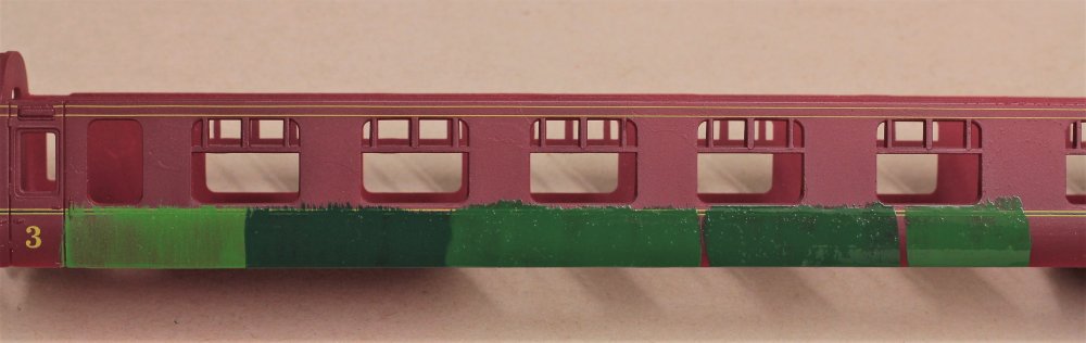

0 popeye Posted February 14, 2018 Author Posted February 14, 2018 I have done a quick test of Humbrol No2 & No3 on a coach. It's a bit rough but from left to right 1 No2 + yellow 2 No3 Brunswick 3 No2 + No3 4 No3 + yellow 5 No2 + No3 + yellow 1
0 johnminnitt Posted February 14, 2018 Posted February 14, 2018 I'd vote for patch 4 for newish paint, patch 3 for more worn/faded I think. Mind you I can't claim to have a good eye for colour.
0 murrayec Posted February 15, 2018 Posted February 15, 2018 (edited) Hi popeye 4 looks OK to me on the red background. Eoin Edit;- Looking again- 3 i'm now liking but less Humbrol 2 in it?? Edited February 15, 2018 by murrayec
0 popeye Posted February 15, 2018 Author Posted February 15, 2018 Yes, i think it will be 3 or 4. I will look at it in the daylight and see what it is like. I will mix some paint until it looks right.

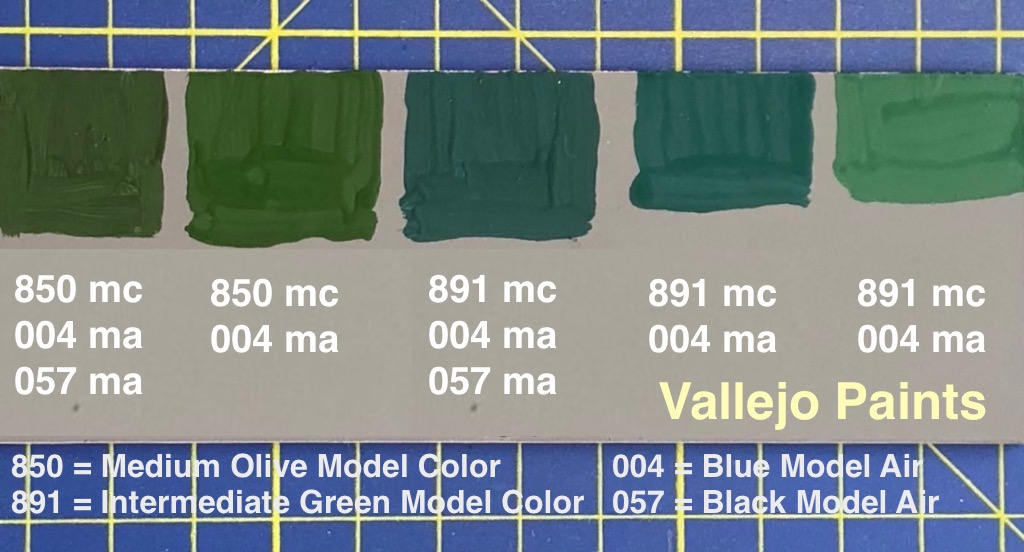

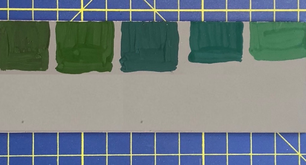

0 Noel Posted February 15, 2018 Posted February 15, 2018 Popeye inspired me to try a few vallejo mixes of various greens this morning. Apologies for using a paint brush. I was trying to see if I could get near the RPSI green as well as various CIE early and late 1950s shades. Its a little subjective because in the flesh if I look at these samples in different light they can change appearance quite a bit. Not quite got the RPSI green but getting closer.
0 johnminnitt Posted February 15, 2018 Posted February 15, 2018 Could you say what colours/mixtures they are? The second from the left looks quite promising to me for a somewhat faded CIE green?
0 Noel Posted February 15, 2018 Posted February 15, 2018 6 hours ago, johnminnitt said: Could you say what colours/mixtures they are? The second from the left looks quite promising to me for a somewhat faded CIE green? I've updated the test sample photo below to show the Vallejo paint numbers used, apologies without ratios, as I usually mix paint by eye rather than by measure. When I am happy with the shades I will have to thin the final mix because some of the paint is pre-thinned for direct air brush use (Model Air), but the two greens are 'Model Color' spec which needs to be thinned for airbrush use. Vallejo have two product lines 'Model Air' and 'Model Color', both basically the same but 'Model Air' is pre-thinned. 'Model Color' can be better value as you effectively get double the paint due its thickness. 1 1

0 popeye Posted February 16, 2018 Author Posted February 16, 2018 9 hours ago, Noel said: Hi Jonathan. 'Eau de nil' stripes added to test sample below. Is the one on the RHS anywhere near to the C class green post 55 or the coaches? Noel I think a wee bit of yellow in the second one might work for the C Class. 1

Noel
