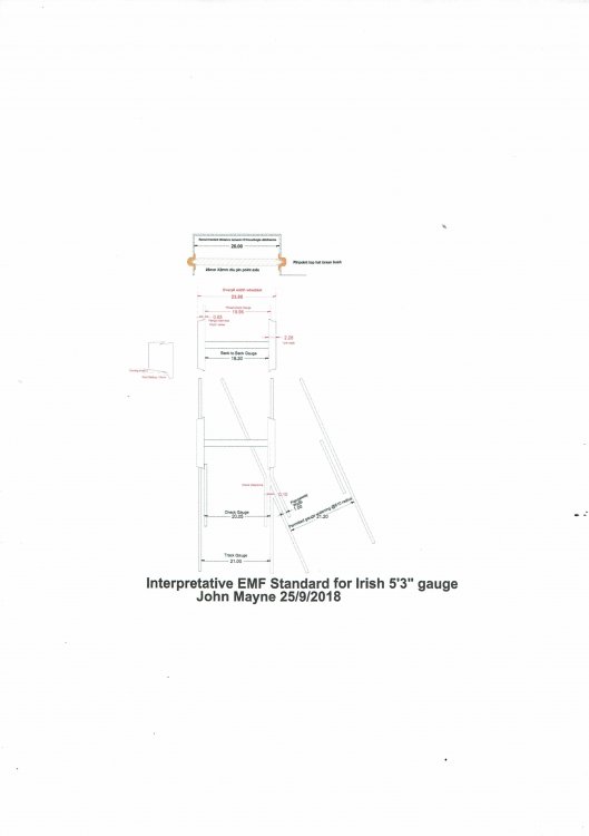

Mayner Posted September 25, 2018 Posted September 25, 2018 (edited) I though it would be useful to apply the EMGS standard to Irish 5'3" gauge to help people weight up the pros and cons of modelling in 21mm gauge and to make an objective comparison between working to P4 or to EM/OO fine wheel and track standards. In particular to dispel the misconception that 21mm EM profile wheel sets are substantially wider than P4 wheel sets and it is necessary to reduce the gauge to 20.2 (Irish EM)or increase clearances between splashers/side frames & w irons to accomodate the greater width. EM & P4 standards were developed by groups of modelers in the UK who aspired to a higher standard of modelling than was achievable with models and components available in 4mm scale during the 1940s and the 1960s. P4 adapted a wider gauge of 18.83 compared with the 18.2 adapted by the EM Gauge Society combined more significantly with more prototypical running tolerances and wheel profiles. Closer running tolerances in combination with finer flanges and wheel tyres demand a more precise standard of baseboard, track and wheel assembly than required in EM or OO. Some form of springing or active suspension is usually required in P4 though not absolutely necessary if working to OO/EM standards. One P4 modeler raised controversy in a recent-ish Model Railway Journal by running stock with EM profile wheels on P4 track in order to achieve reliable trouble free running. 21mm modelers appear to mainly work independently or in small groups and have tended to develop standards on their own initiative rather than through groups. Tony Miles pioneered fine scale 21mm developing a similar set of wheel and track standards more or less concurrently with the P4 Society. Tim Cramer published an article on modelling in 21mm in the Railway Modeller in 1972, using proprietary OO/EM wheels set at a back to back of 19.5mm. I started working in 21mm in the mid 1980s building locos and stock though did not have time or space for a layout. I got involved with the MRSI Loughrea group when I returned to Ireland in the mid 1990s and had a pleasant surprise when my locos and stock some with quite fine wheel ran on Loughrea. Interestingly I had no problems running locos and stock with EM/OO finescale wheels set at 19.5mm back to back through the pointwork on the Loughrea layout, though it was necessary to reduce the back to backs on wagons fitted with older wheels with a coarser profile to 19.3mm which correlates with the EM standard. Note on tyre width and back to back One of the major differences between the P4 and EM gauge standards is that the P4 standard specifies min-max tolerances for back to back gauge and tyre width while the EM standard specifies specific values. Provided the back to back gauge and tyre width does not exceed the standard the overall width of a 21mm OO/EM wheel set is marginally narrower than a 21mm P4 set at maximum tolerance. for back to back and tyre width. In practice Ultrascale , Gibson OO/EM wheel sets do not exceed the 2.27mm tyre width specified in the standard and excessive wheelset width width is unlikely to be a problem. Interestingly the majority of my steam locos are fitted with Sharman B profile wheels (alas no longer available!) these wheels have a tyre width of 2.07mm very close to the 2mm max specified in the P4 standard! I have included WCG or Wheel Check Gauge (Back to back +1 Effective flange) although not identified in the EM Gauge Trackwork Standard In some of his works on trackwork and rolling stock, Iain Rice identified that the "Wheel Check Gauge" (distance measured between the rear of one flange to the face of the opposing flange) rather than the back to back gauge as the vital constant in assuring the correct relationship between wheels and track. The WCG becomes particularly important when wheels with different flange thicknesses are used on a layout (e.g. mixing scale wheels like Ultrascale & Gibson with universal wheels from rtr manufacturers). Scalefour Digest 1 Track and Wheel Standards.pdf EMF Standard for Irish Broad Gauge Track.pdf Edited September 25, 2018 by Mayner 2 1
merlinxlili Posted September 26, 2018 Posted September 26, 2018 Very good John! The bottom line appears to be that one can build track to 21mm P4 standards, but use EM section wheels and it works. Is that right? The article in MRJ was written by a modeller who had built a large railway which suffered from persistent derailments. Apparently this is a relatively common problem at exhibitions which leads to complaints about unreliability, the need for constant fettling, etc. Needless to say there has been some debate on the subject. In my opinion this is a matter of horses for courses. Obviously it is pleasing to build a railway as accurately as possible and to develop skills as one goes along, but on the other hand few people have the luxury of being able to spend lots of time on their hobby, so a compromise has to be made. The mind's eye is a wonderful help for this, provided one doesn't take any close-up photographs which unfortunately the/my mind's eye refuses to accept. So my own conclusion so far is that I would like to build railway models as accurately as possible, within my limitations of time and skill, but also concentrating on what is visually important (obviously the thing has to work well). I also throw in the idea that for any prototype there are a number of things that really characterise it in a model, which are probably subjective to each modeller. So a modeller should try to get these details right, while many other aspects may be compromised with minimal effect. For me big clunky wheels, rods, etc, ruin the effect, so finer running gear is highly desirable. I would like to build in 21mm gauge and make use of finescale track to achieve that delicate look. The use of EM wheels seems to be a great compromise, providing slender wheels with a much greater chance of them staying on the track. The S4 society have all the gauges needed for track and wheel set construction to P4 standards, including 21mm gauge. Maybe better not to mention that EM wheels might be used? 1
Mayner Posted September 26, 2018 Author Posted September 26, 2018 2 hours ago, merlinxlili said: Very good John! The bottom line appears to be that one can build track to 21mm P4 standards, but use EM section wheels and it works. Is that right? I haven't tried running EM profile wheels on P4 track, so I can only take the author of the articles advice at face value. I think the issue started with intermittent derailments when the authors grand children were visiting, similar problems occur on a high proportion of model railways regardless of gauge or standards when there are visitors about. Visually there is little difference between 21mm point and crossing work laid to EM or P4 standards, the plain track will look exactly the same. The only real difference is that flangeways are 0.32-0.35mm narrower in P4 than EM not exactly noticeable at normal viewing distance. Building large complex 21mm gauge layout in a short space of time is basically out of the question unless you are a Tony Miles that has the ability to recruit and manage a team of to build and operate a large layout. I am not sure if the S4 Society currently supply track gauges and axles suitable for 21mm gauge.

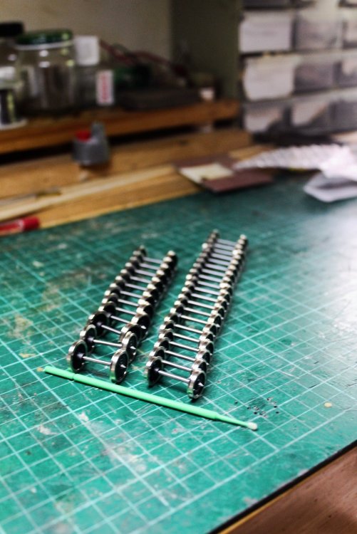

Mayner Posted December 2, 2018 Author Posted December 2, 2018 (edited) Just received delivery of 21mm wheel sets ordered in February. Main issue a bit like CIE ordering the second batch of Deutz is that the rationale the wheel sets has changed during the past 10 months. The intention was to order enough wheels for 1970s passenger train (Cravens, 1953 Buffet, BR van) and re-gauge a rake of IRM wagons which no longer fit in with the overall scheme of things. The 3'1" disc and 3 hole wheels will end up under GSR era wagons which is much the same as when I was planning to re-gauge a rake of Airfix MK2D coaches nearly 20 years ago. Wheels are certainly to a high standard , unlikeley to work loose on their axle or loose a tyre unlike some wheels at the scale end of the market. I will probably go back to Ultrascale when I use up my stock of Sharman steam loco wheels. Edited December 2, 2018 by Mayner 2 1

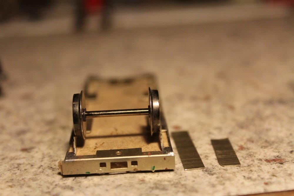

murrayec Posted December 7, 2018 Posted December 7, 2018 (edited) Hi jhb The spud motor lends it's self to conversion pretty easily, just replace the axles with longer ones, replace the pick-ups, and also the wheels need to be replace as the spud has stepped axles ends- down to 1.5mm! Here are a few photos of the spud set up for a 21mm DART;- Eoin Edited December 7, 2018 by murrayec 1
