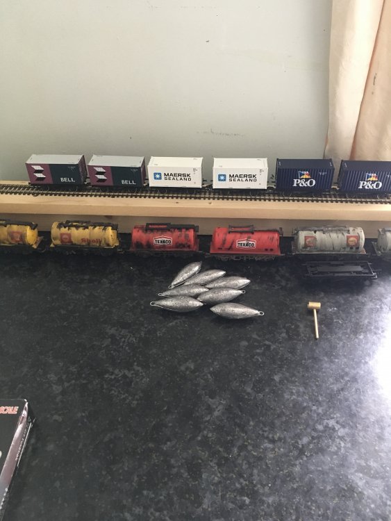

Hi All.  I have a Hornby diesel class 40  1.76 scale 00 gauge. And  would like to know would the class 40 be capable of pulling a rake of 15 freight wagons ?  with a combined weight of 105 ounces . weight  all ready added to the wagons  Thanks for your help .

Yes that's right. I have a rake of 15 wagons , tankers , and containers and I added to each one a 5 ounce led weight use for fishing. I have all 15 done and the total combined weight of the 15 wagons come to 105 ounces my layout is on the flat with 3rd and 4rd  rad thanks to all for the replies

Hi lads and thank you for the reply’s . The reason I added the weights was because of delrailment. The size of the wagons from buffer to buffer is 4”1/2 inches long. Or 11.5 cm. There the Hornby 2 axel tanker wagons , Esso,BP, Shell. There 5 ounce lead fishing weight on each wagon . Total weight included the wagons 105 ounce. The loco was bought from Hattons It the Hornby class 40 with TT Sound. .There a rake of 15 wagons . Cheers.

Five ounces = 141.75 grams. That seems excessive if you're adding that weight to each of your 15 wagons as you're expecting the loco to haul the equivalent of over two bags of sugar (albeit with less rolling resistence!).
To put it in perspective, P4 finescale modellers are advised to have 25g (0.88 ounces) per axle in order to prevent derailments, and that would be considered overkill for standard OO gauge (our Accurascale 24.5t hoppers weigh 26g in total and we have had no reports of derailment issues from any customers, including finescale modellers). If you're experiencing derailments, it's more likely due to an issue with a particular wagon (a wheelset may have the incorrect back-to-back measurements, for example), or there may be a problem with the track - either a manufacturing flaw or in the way it was laid.

I have to agree with Garfield here, 5 ounces per wagon is WAY too much weight. As he said the wheels may well be the issue here. Can I ask, are they metal wheels? A lot of the cheaper Hornby tank wagons come with plastic wheelsets. These can often be out of gauge or just distorted and they cant be fixed. If you switch them out for metal sets they will run much better straight away and probably won't need any extra weight.

Hi lads .yes the wheels were plastic. But I change the all out for metal. And used the back to back gauge on each of them . I agree what your saying about the excessive weight I give it a go and see how it react. Is it easy to burn out a loco motor? Cheers

Well lads I did the test run , just useing the 6 container wagons. That was a weight of 42 ounce. Perfect on the straight but keep spinning out on the bends. So back to the drawing board, I will have to half the weight and see how that goes. Thanks to one and all for your great help and suggestions cheers Joe.

Suggest each 4” two axle wagon including the added weight is absolute max 3oz or 85g and that’s still a bit on the heavy side for use with tension lock couplings. Those wagons should run ok out of the box. Wheels may be the culprit.

Hi Noel I might drop it to 2 oz. per wagon. I was after changing out all the plastic wheels for metal. And used the back to back gauge on them.the track seems fine everything else is running perfect on it. All the wagons were bought second hand and there Hornby which I never had any luck with the Hornby products cheers.

18 to 27 grams max should go into a wagon- no more unless you want to burn your loco motor out! If you still have problems with de-railing it's down to bogie, or coupler, or track problems! Run one wagon behind the loco with weight in it try 18grams first- if that works ok keep it hooked up and couple on another- test that and see if it runs ok, go through all wagons testing like this with the same working one hooked to the loco, connecting the one to test to it, and then you will find the problem.....

Thanks lads getting some great advice here. And Irishthump, they derailed on curves, and even on the straight. With a small rake of 15 wagons it could be a small problem with one wagon. It trying to pinpoint it that’s were the fun starts.

Try just shoving individual wagons round the curves, empty, and see what happens.
Is it one wagon? Does it happen at the same place? Etc...
It can be all sorts of things - misaligned track joints, debris/ballast against a rail, duff wheels, a nick on a flange, the list goes on...
