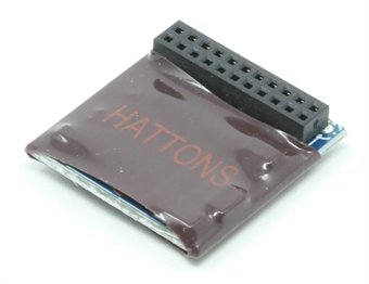

heirflick Posted June 18, 2019 Posted June 18, 2019 Any of youse boyos use these chips that Hattons recommend for Murphys 201 and 071 locos? Any thoughts appreciated as always! Hattons Originals DCR-21Pin-Direct-V2 21-pin 6-function 1.1Amp direct plug decoder with back EMF
0 The Derry Road Posted June 18, 2019 Posted June 18, 2019 Seamus Ive use these in two 071s and a 201 and 4, 141/181s without any issues, on a recent visit to Hattons I was informed that these chips are supplied to them by DCC supplies. Most of my BR stock has these also. Again never had any issues Regards TDR

0 Past-Avenue Posted July 8, 2020 Posted July 8, 2020 Hi guys I have 2 of these chips in 071's and the only thing I can't do is turn on the cab lights . Is there a way to change the CV's or what am I doing wrong ? Enda
0 DiveController Posted July 26, 2020 Posted July 26, 2020 (edited) @Past-Avenue Is it 4 function or 6 function chip (one above seems to be 6 functions)? If I recall correctly there is no, or no controlled, cab lighting is the 141s but there is in the 071s. You'll need an extra function or an extra function per cab to control those. If not one of the CVs may need to be changed Edited July 26, 2020 by DiveController
0 Past-Avenue Posted July 26, 2020 Posted July 26, 2020 Hi DiveController its a 6 function decoder and I've got it in a 071 .Is it only a matter of changing the CVs and if so witch one etc. Enda
0 DiveController Posted July 30, 2020 Posted July 30, 2020 On 7/26/2020 at 3:16 PM, Past-Avenue said: Hi DiveController its a 6 function decoder and I've got it in a 071 .Is it only a matter of changing the CVs and if so witch one etc. Enda Sorry for the late reply. I don't have any of these but I looked it up on the Hattons site and they refer to the instruction manual here https://images.hattons.co.uk/mediafiles/hattonsdecoderinstructions2016.pdf Oddly the 6 function decoder refer you to this manual which refers to a 4-function decoder. Nonetheless int he absence of any better advice you might be able to use use F3 green wire and CV51 to operate the cab light. Maybe setting it as directional will allow the cab in the direction of travel to be illuminated by selecting F3?
