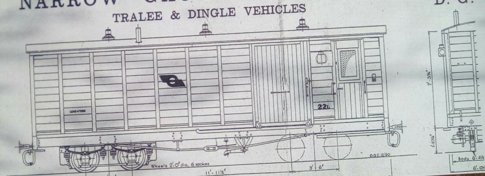

PorkyP Posted July 5, 2019 Posted July 5, 2019 (edited) I'm wanting to build this van in 7mm scale, I've got some nice dimensioned drawings but as only one side is shown I'm wondering if the other side of the van is identical, as regards position of the doors etc ? The van was ex T&D and was substantially rebuilt for, (and likely by) the C&L and renumbered 22L There's a guards access door and a sliding goods door at one end of the van, I'd kind of assume these would be repeated at the same end of the van on the other side, but can't be sure, so if anyone could confirm or deny that'd be grand ! I've included pictures of a 4mm model of the same van ( not my model btw) just for identification. Edited July 5, 2019 by PorkyP 3
Galteemore Posted July 5, 2019 Posted July 5, 2019 (edited) I may be missing something but it seems to be the same on both sides in your pics. Here’s a passenger version - seems to bear out your theory...as you can see right through the back with doors apparently opposite each other... If you want to be absolutely sure, just buy the Alphagraphix kit of the van! Edited July 5, 2019 by Galteemore 1
jhb171achill Posted July 5, 2019 Posted July 5, 2019 A couple of carriages on the T & D were rebuilt as brakes. I think there were two thus treated, though I’d have to check, but possibly three. One, as seen above, retained windows but the other as also seen above, didn’t. The Great Southern rebuilt them as goods brakes on the T & D, and following its closure in 1953, one was transferred to the C & L. 1
PorkyP Posted July 5, 2019 Author Posted July 5, 2019 Thanks gents! I wasn't sure if the creator of the model in the pics even got it right, I just used them to show the type of van! Logic would kind of suggest the two sides be the same, but you never know, it'd be annoying to build it all wrong!...the one I'm thinking of ( no 22L) certainly went to C&L had no windows just plain planked sides, I've included the drawing I have, sorry about the "gradient" but hey, it did originally come from Tralee & Dingle..!!! 1 1
murrayec Posted July 5, 2019 Posted July 5, 2019 PP David Rowlands book 'The Tralee & Dingle Railway' has a picture (as Galteemore's post above) of No.2T page 70 and again its shown on page 29 from the other side- indicating the doors are opposite each other. Eoin 1 2

irishrail201 Posted February 29, 2020 Posted February 29, 2020 I have the two original carriage plates from 22L..it was rebuilt by CIE in its final condition (attached). Also some other T&D bits, my collection has grown though! 2
irishrail201 Posted March 21, 2020 Posted March 21, 2020 On 7/5/2019 at 6:04 PM, jhb171achill said: A couple of carriages on the T & D were rebuilt as brakes. I think there were two thus treated, though I’d have to check, but possibly three. One, as seen above, retained windows but the other as also seen above, didn’t. The Great Southern rebuilt them as goods brakes on the T & D, and following its closure in 1953, one was transferred to the C & L. Hi Jonathan, All the brakes that survived the civil war/war of independence were converted to cattle brakes with exception of 14T a 30' brake which was transferred to the West Clare, AND survived! Who knows it may well be out there. 2
jhb171achill Posted March 21, 2020 Posted March 21, 2020 I believe that no two were exactly identical as a result, Irishrail201 - is that correct?

irishrail201 Posted April 2, 2020 Posted April 2, 2020 On 3/22/2020 at 2:31 PM, Galteemore said: Lovely - one of my favourite spots. Apparently the Guards captured a German agent in the vicinity either there or at the Junction in 1940/41. He was waiting for a train by the most up to date timetable the Abwehr had - which didn’t factor in the closure! That was Dingle, he was caught by Dick Mack who was in the local FCA. They allowed him to travel on passed tralee where he was "picked up". JHB they were all different as a result, the one that went to Leitrim 22L had external framing done at Limerick, whereas the one that went to Clare had external panelling. Also that image of Castle is superb! My grandad travelled on it to the Christian Brothers in Tralee. I have a 7mm model of the station building! Yes I know the loco is HO scale before anyone asks my sanity. 6

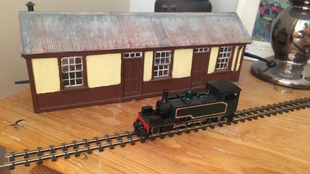

Jamie Davis Posted 12 hours ago Posted 12 hours ago On 2/4/2020 at 11:51 PM, irishrail201 said: That was Dingle, he was caught by Dick Mack who was in the local FCA. They allowed him to travel on passed tralee where he was "picked up". JHB they were all different as a result, the one that went to Leitrim 22L had external framing done at Limerick, whereas the one that went to Clare had external panelling. Also that image of Castle is superb! My grandad travelled on it to the Christian Brothers in Tralee. I have a 7mm model of the station building! Yes I know the loco is HO scale before anyone asks my sanity. I have the exact same Chivers Finelines T&D Hunslet model. Where did you source your lining from? Mine has just a solid red band and I'm not the biggest fan. Thanks. 1
