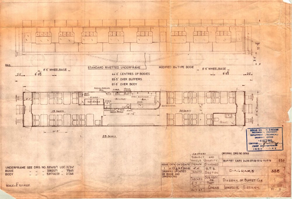

CIE dose not appear to have had a type "name" for the coaches introduced in the early 1950s.
Officially coaches would have been referred to by their purpose and running nos. for example Buffet Car 2406-
 Early CIE stock was similar in design and construction to the pre-war Harty/Bredin coaches, basically aluminium paneling (Harty/Bredin steel) on timber framing on riveted/later welded steel framing on GSR style bogies. CIE introduced new types including 64 seat open coaches, buffet cars, and brake end coaches, the original CIE coaches introduced 1950 were 60" same length as Harty/Bredin, coaches CIE standardised on 61'6" as a body length from 1951 and coaches built from 1953 onwards including the Dunsandle coach ran on Bullied Triangulated underframe with Commonwealth bogies similar to the later Park Royal and Laminate stock.

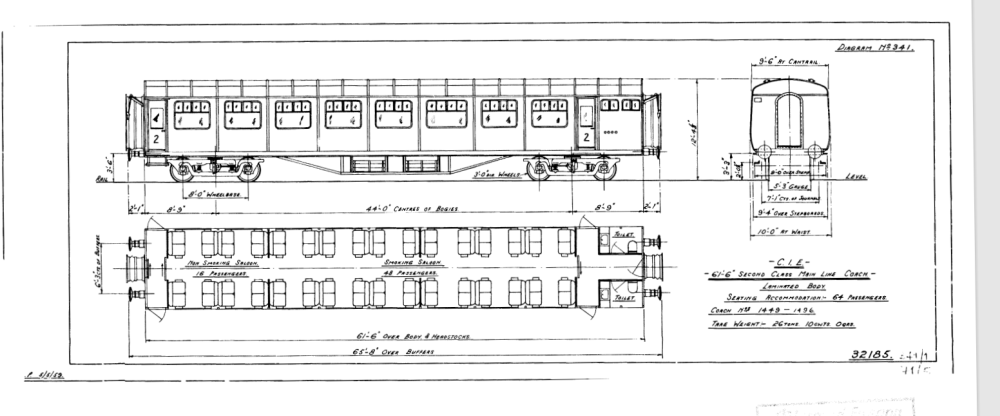

While the early CIE coaches and the Laminates are similar in overall length and general styling there are a lot of structural and detail differences between the two types.
The end profile and paneling detail of the earlier coaches including the Buffet Cars is completely different to the Laminates.
The earlier coaches were narrower with an almost upright profile above waist height, the Laminates were wider 10'3" with a tear drop end profile, not unlike the Craven coaches.
Older stock including the Buffet Cars tended to stick out like a sore thumb in trains made up of Laminate or Craven coaches because of the different end profiles.
The cover slips on the panel joints are quite noticeable on the older stock with vertical cover slips above the windows, the Laminates were built using composite Aluminium, insulation (asbestos?) and ply panels.
Preserved CIE 1953 Side Corridor Second(Standard) Class Coaches GSRPS Tralee 1993. The majority of pre-Park Royal & Laminate stock was withdrawn in the early 80s following the commissioning of the DART and introduction of the 1st Batch of MK3 Coaches
CIE Diagram 64 Seat Laminate, Tear drop end profile, Vertical cover slips between panels, small windows toilet panels.
To add to the confusion CIE rebuilt some 64 seat Laminate coaches using traditional coach building techniques during the late 70s-early 80s with a different paneling/cover slip arrangement to the original laminate stock!
When is a Laminate not a Laminate?
 Laminate 1463 Mullingar 1981-2 withdrawn following a minor shunting accident, the coach was repaired and entered service with the RPSI during the 1980s
Rebuilt using traditional timber framed carriage building techniques paneling and cover slip detail different to the original Laminates.
Worsley Works introduced kits for the 64 seat and main-line brake end versions of the Laminates during the early 2000s, I produced etched side overlays for the earlier CIE coaches "shrunk to fit" the Dapol 60' Stanier coaches, at the time it was not viable to produce a full kit for the older type of coaches due to the multitude of types and relatively low level of demand.

I would go so far as to say that the vast majority were rebuilt in that manner by the early eighties when they were withdrawn, I worked on some of the RPSI ones in the mid eighties and as John says they were laminates in name only .
