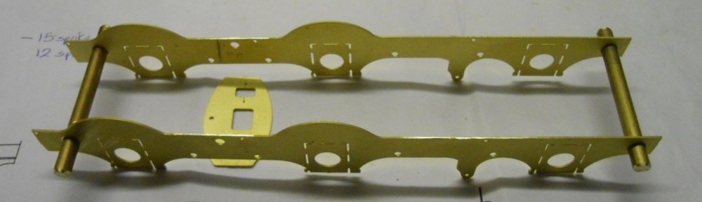

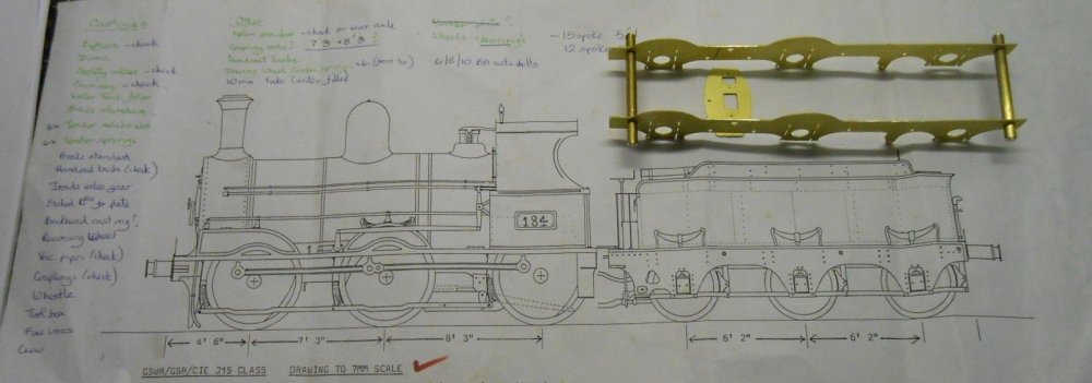

So, where was I? Is it really four weeks since my last post on the 101? An exhibition, man flu [far worse than bubonic plague of course], household chores and the like - they all eat into modelling time! However, as might be gathered from other posts, work has progressed on the 101's tender and the model has now reached the stage where it is not far off the paint shop. The tender, like the loco, proved interesting, to say the least. Frames were straightforward, with 5mm brass rod used for spacers, drilled to take 8BA bolts to fix to the body. At first, this was easy too, the only awkward bit being forming the flares along the top edge. The etches contain a fair amount of detail, including the distinctive tool boxes, plus all the brake gear too. Here is where it started getting complicated, with pull rods both inside and outside the wheels. The real difficulties arose in trying to work out what the original, 1864 gallon, tenders were like on top and at the front. The instructions and photos are of the preserved version, while pictures in books rarely show more than three quarter views of the whole loco, so you are left having to guess what is going on elsewhere. The etches do not cover the tender top surfaces, while [to me at least], it was hard to make sense of the coal space. In the end, I fabricated both from thin brass sheet and it seems ok, while all photos show the tender top liberally covered with coal, so what is underneath hardly matters. Having bemoaned the number of handrails on the loco [eight around the cab alone], I then found there are a further four on the tender. The GSW certainly didn't want its crews falling off the footplate, it seems. As with the loco though, there are no castings in the kit, so I had to source things like springs, axle boxes, buffers etc. I managed to find some suitable spring/axlebox castings at the Reading trade show in December. A fair bit of fettling has been required - separating spring from 'box and filing the latter so they fit in the outside frames. The springs themselves then needed hangers so they can sit on the top edge of the footplate. The etches contain plenty of hangers, but they are flat, so I soldered short lengths of 1mm brass wire to each 'leg' and then rounded this all with a file. This has meant I could drill holes in the footplate surface to take each of the 12 legs. The springs themselves will be glued in place with 5 minute epoxy, probably after painting, because otherwise lining the tender will be difficult. Several things can't be finished until I've visited the Roxy stand at the Tonbridge show next Saturday. A couple of short handrail knobs for the smokebox, a set of etched numbers for the number plates and some sub-miniature plugs and sockets so I can add pick ups to the tender. Hopefully, everything will be ready for priming by then, though this phase can be quite fraught at times. Witness coats do have a habit of showing up unwanted blemishes that then need filling and priming again, while cleaning up always seems to find a few weak solder/glue joints that need doing again. Getting there though. Life is complicated - that's why it is fun. Allegedly... -
