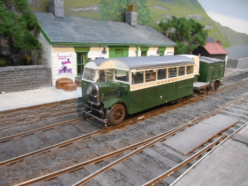

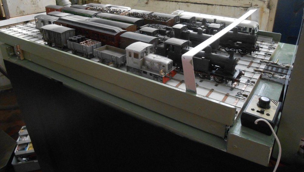

The Swilly coach is now pretty much finished. Final jobs included fitting roofs to the duckets, glazing, plus lettering, numbering and a bit more weathering. At least the Swilly didn't go much on complex liveries for its coaching stock - the diamond logo [hand drawn with various fine marker pens], plus 'guard' at the van end and a number [both transfers] and that's it. I also made some covers for where the lamp tops went after electric lighting was installed. Hopefully it looks suitably care worn. Eventually, it will form the mixed train with a couple of wagons and the Barclay 4-6-0T With another show coming up for NP Quay, decided I ought to improve my stock storage, so invested in some new plastic ones from The Range. Not sure about the Barbie Pink lids, but they mean my stock now stands on its wheels and I can [hopefully] protect the AJ coupling hooks better. I can also fit a complete train in each box, which makes for easier setting up and packing away. The three deeper cardboard boxes contain the station building, the crane and some spare stock if/when required.

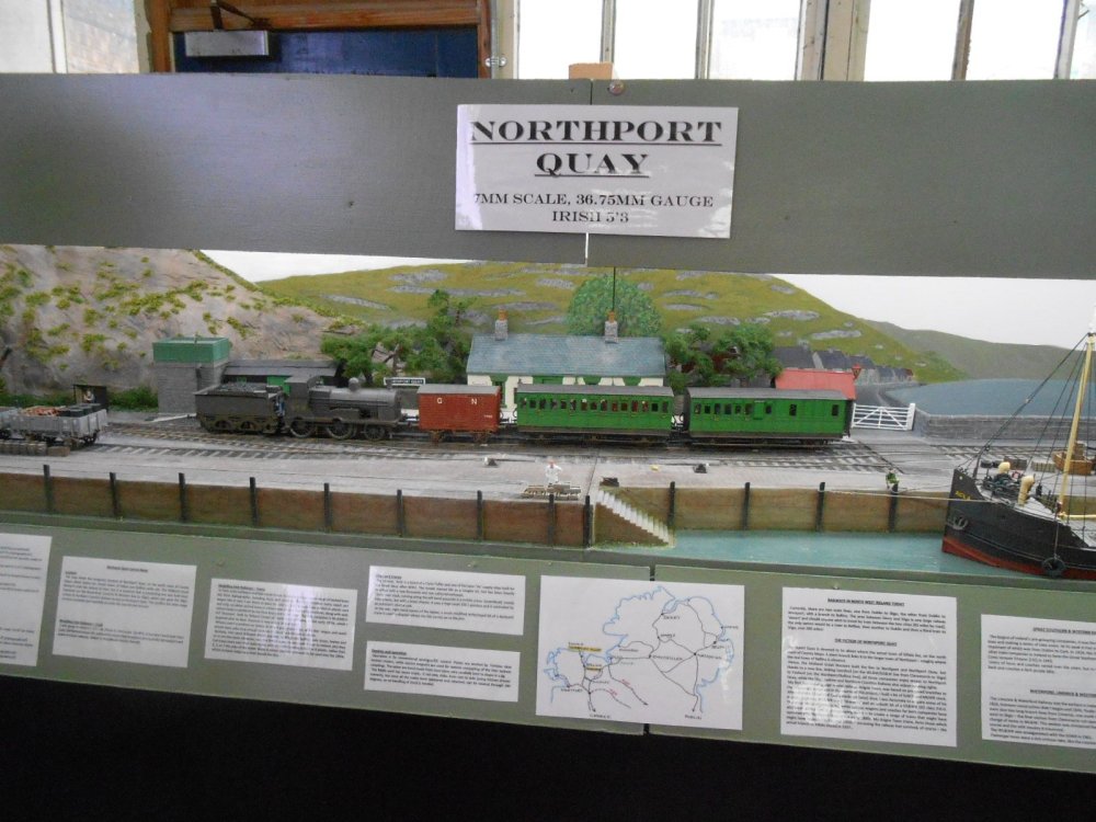

Northport Quay gets its second outing at the South Hants show next Saturday. Venue is the Admiral Lord Nelson School, 10.30 - 4.30 and will be running the 1900s stock. Nothing after that until second half of next year at the moment, though should be a few coming up, post Uckfield.
