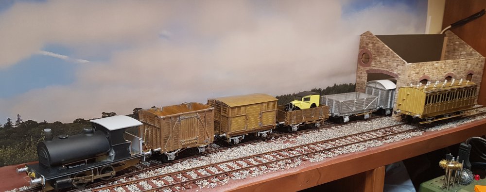

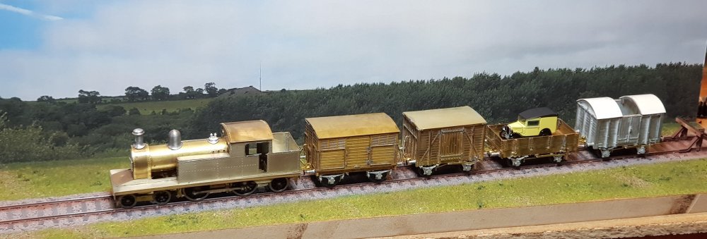

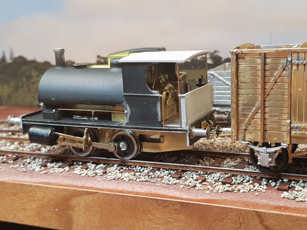

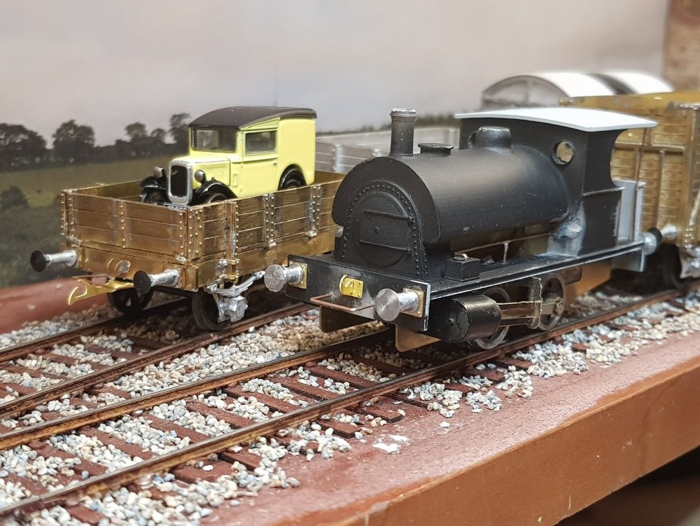

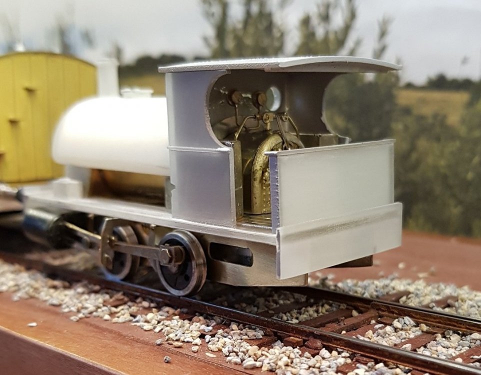

    Class 495 Build

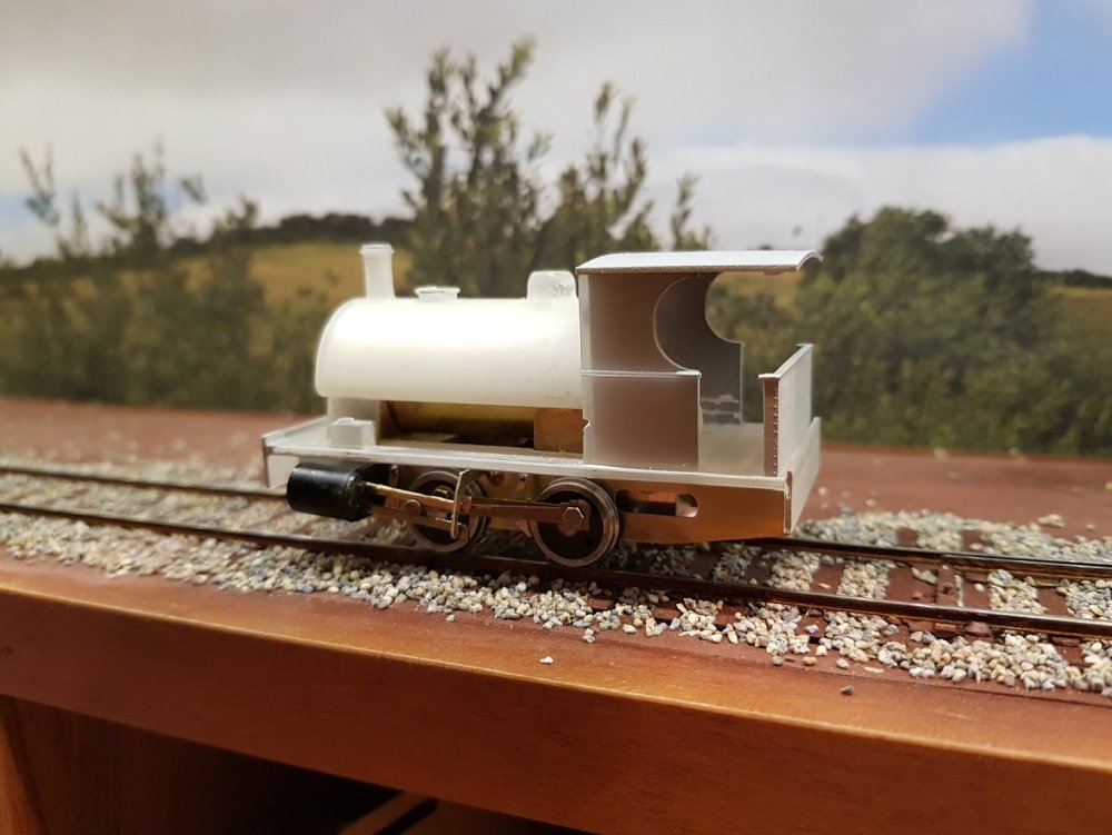

    Some progress on 495. Chassis insert into the body is sorted which allows fixing of the cab interior in place. This then allowed addition of handrails, cab back and roof. Buffers, hooks, and sandbox operating rods were also added. I will need to add some weight as it is a little low on tractive effort. When pulling the 5 wagon rake, which in fairness is quite heavy, it does struggle on occasion. Some weight between the frames, front and rear should help. It does run well and looks well hauling the rake of wagons. Some more detailing needed before heading to the paintshop as it is looking rather scruffy at this stage. Quick shot of 495 on the siding with 423 on the main track. More as time permits. Ken

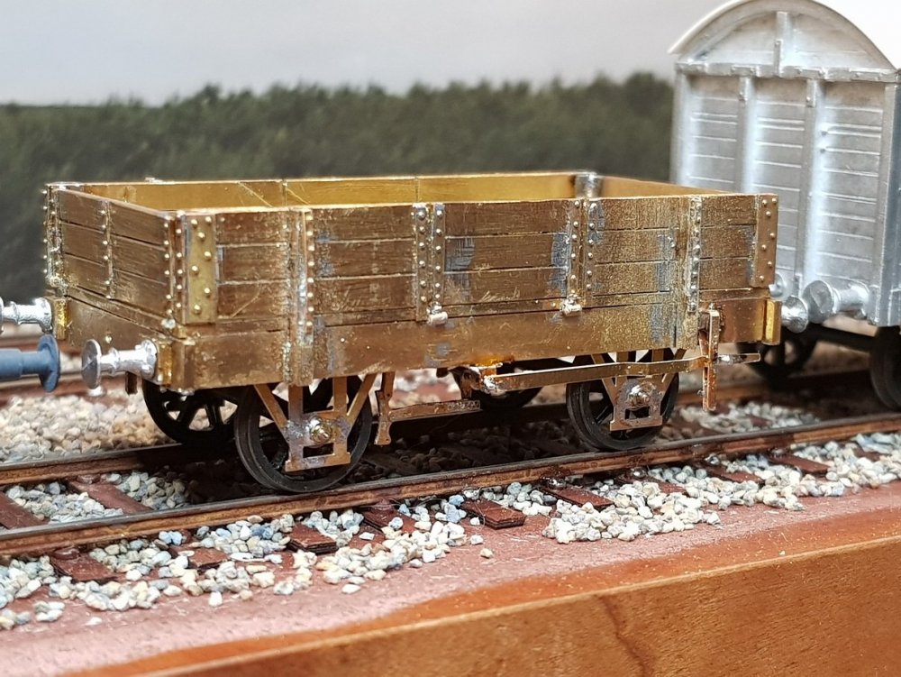

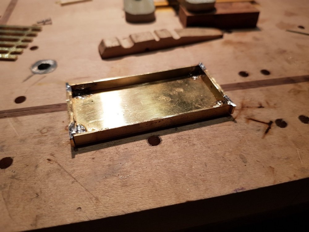

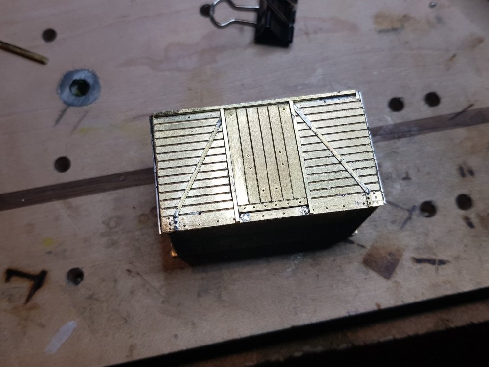

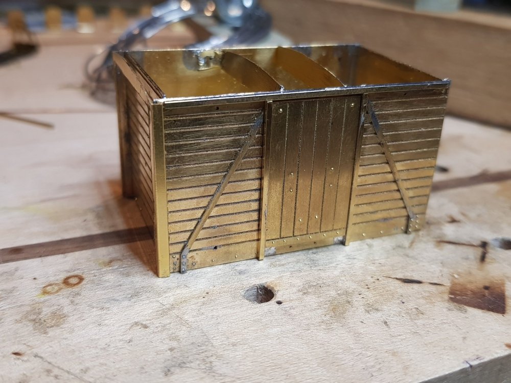

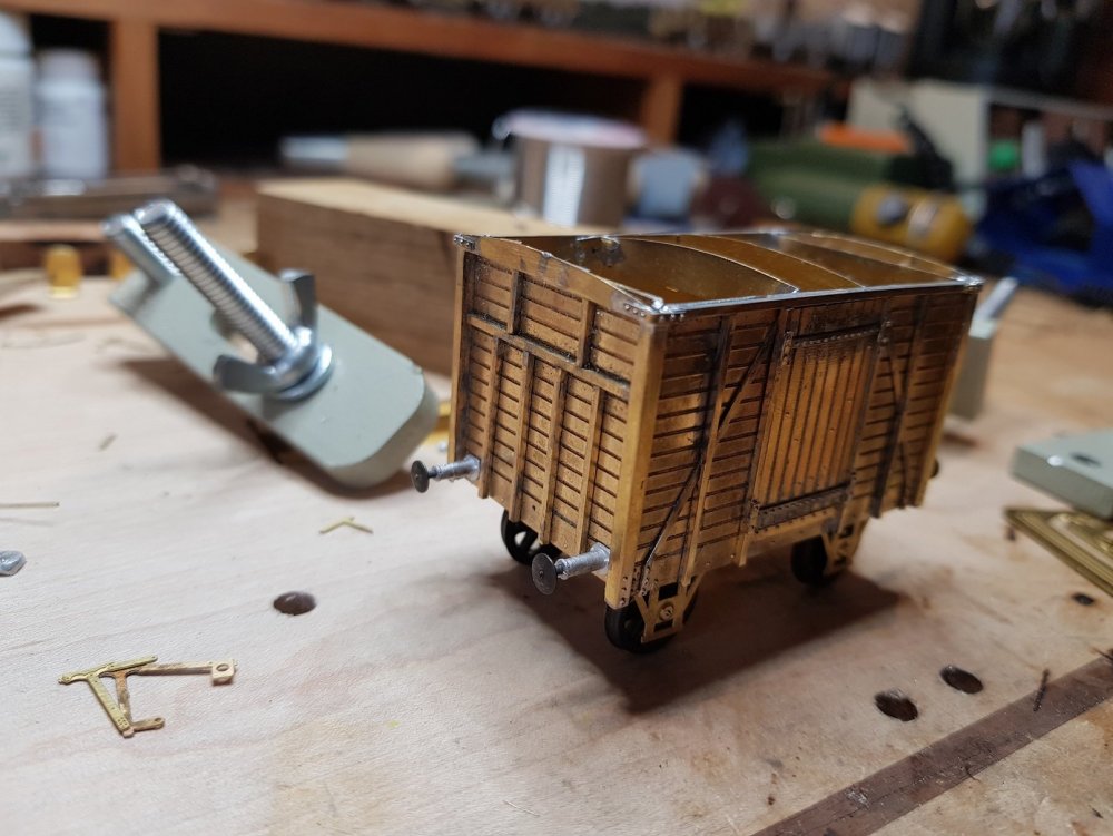

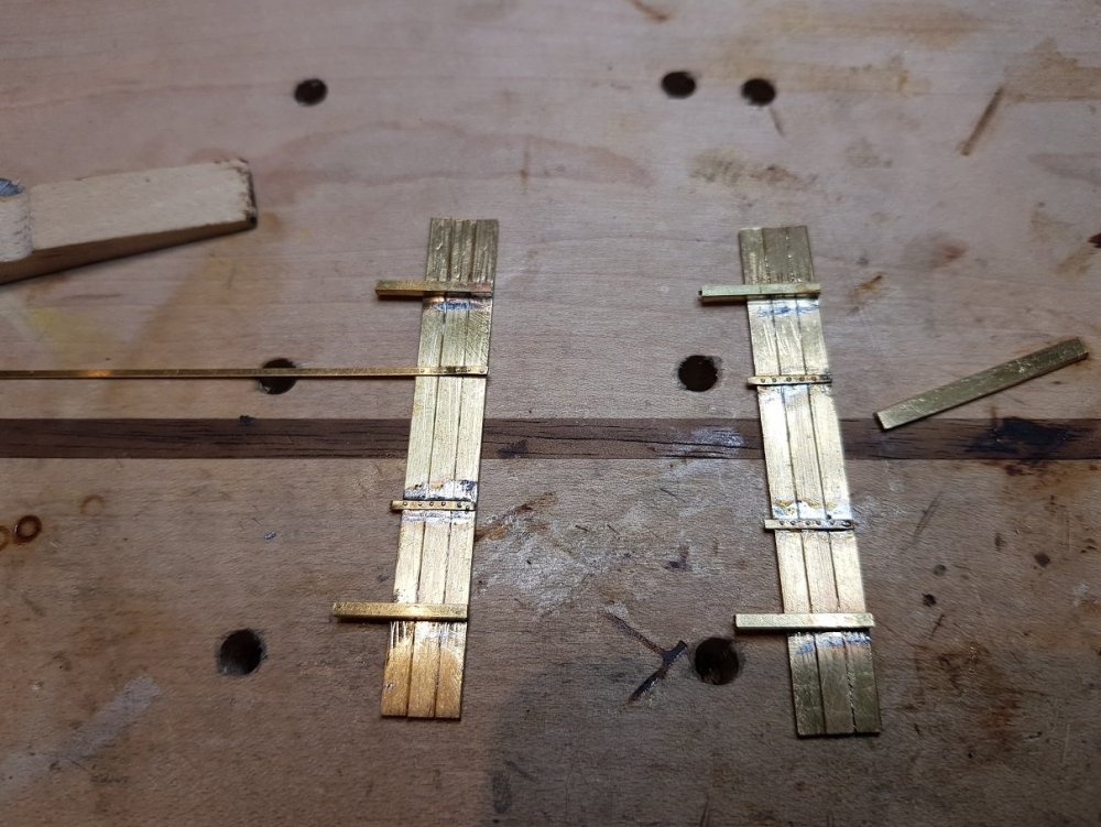

    KMCE's Workbench

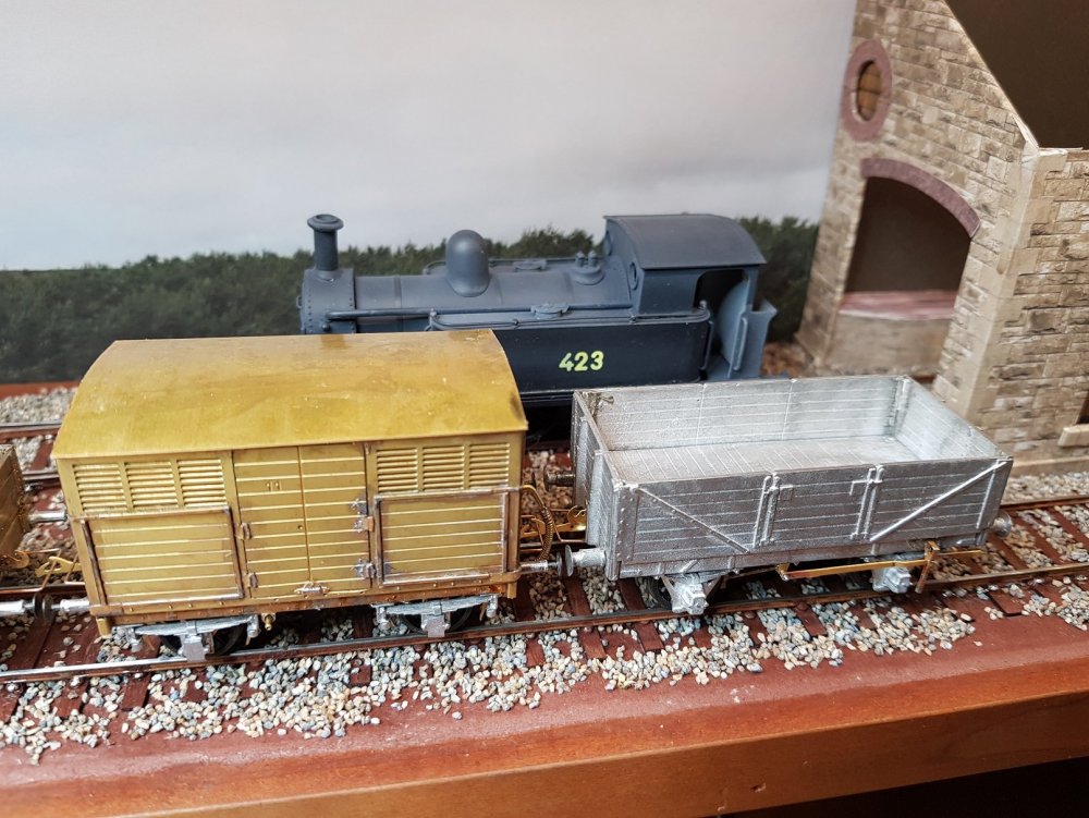

    Got some work done on the covered wagon. Quite a lot of work went into this one, as all parts needed to be added to the base wagon shown above. Still waiting for a delivery of corrugated iron for the roof to complete, but all other physical work is complete. All uprights and cross members are 1 x 1mm brass. Corner posts are tri folded 0.3mm brass cut & groved on the mill. Hinges and corner straps are 0,5mm brass riveted to suit. It has come together rather well and just needs a roof and a good cleanup for painting. Some shots of the wagon with others which give an indication of how short it is. Wagons behind 495 which also has had some work done today - see Class 495 post in Irish models for more details. More later. Ken

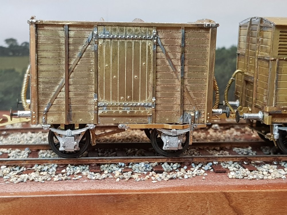

    KMCE's Workbench
    The van in question is a Studio Scale Model (SSM) kit in white metal. It is quite heavy with thick castings; the detail is not a sharp as perhaps it once was (Sorry Des!). They are a really interesting wagon & it would be good to scratch build a version which may be a little closer to scale thickness I'll perhaps tackle that after the wagon I'm currently working on; a DSER 13'-6" covered wagon.. These are small wagons but have really nice detail and should provide a nice model once complete. Very nice small wagon which should look good in a rake with the other wagons. This would bring me to 5 wagons - an Inklenook Sidings shunting puzzle is beckoning!!!! Ken

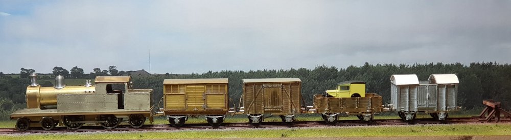

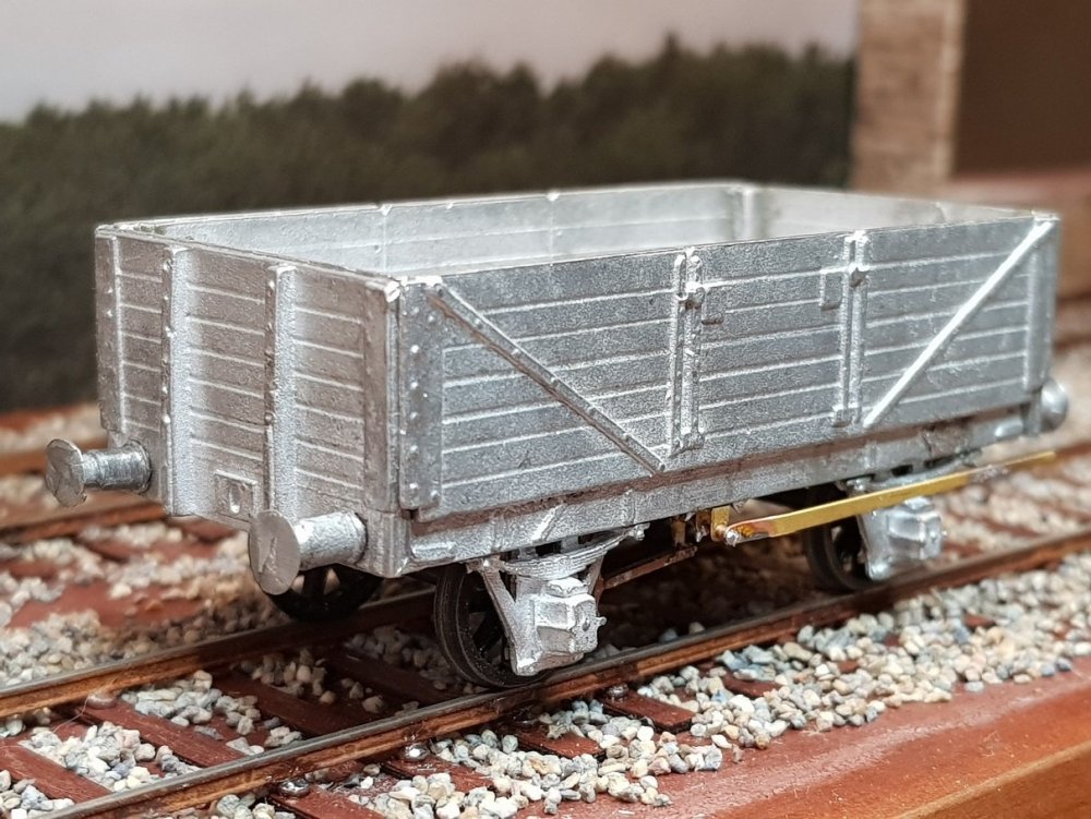

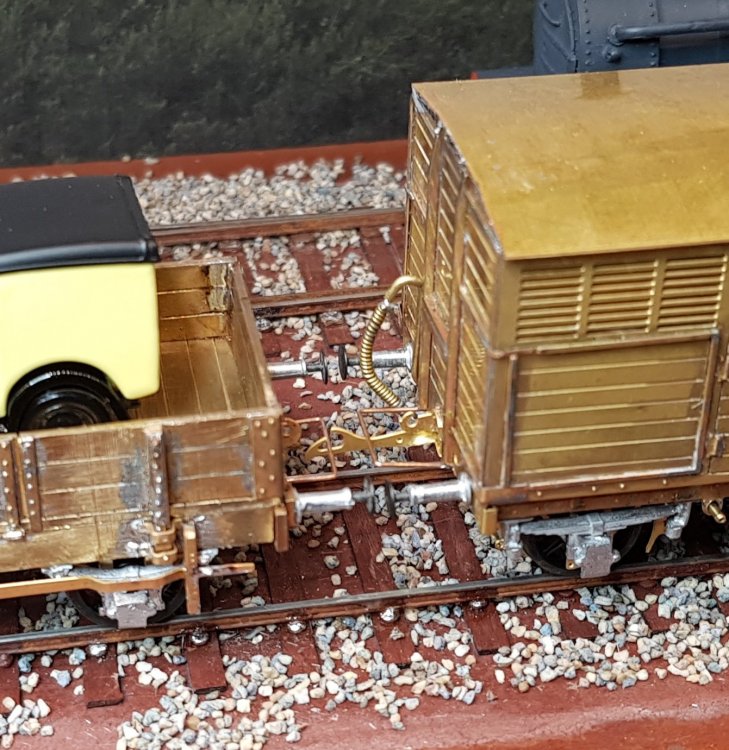

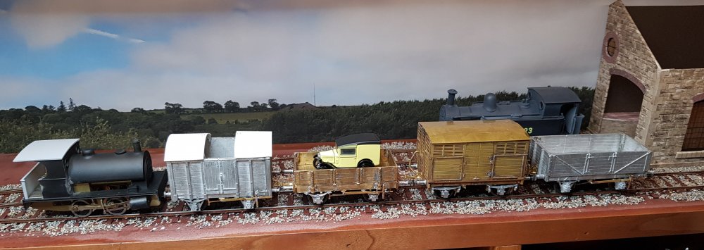

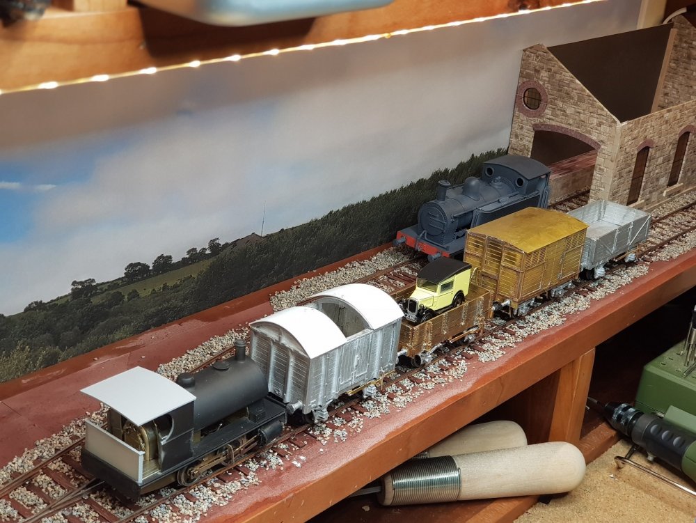

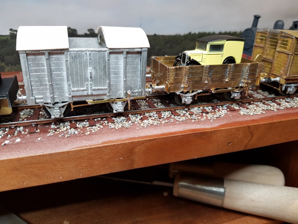

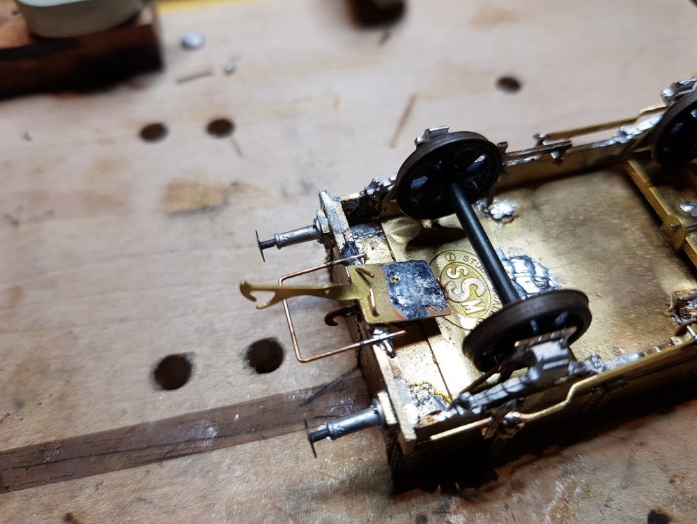

    KMCE's Workbench

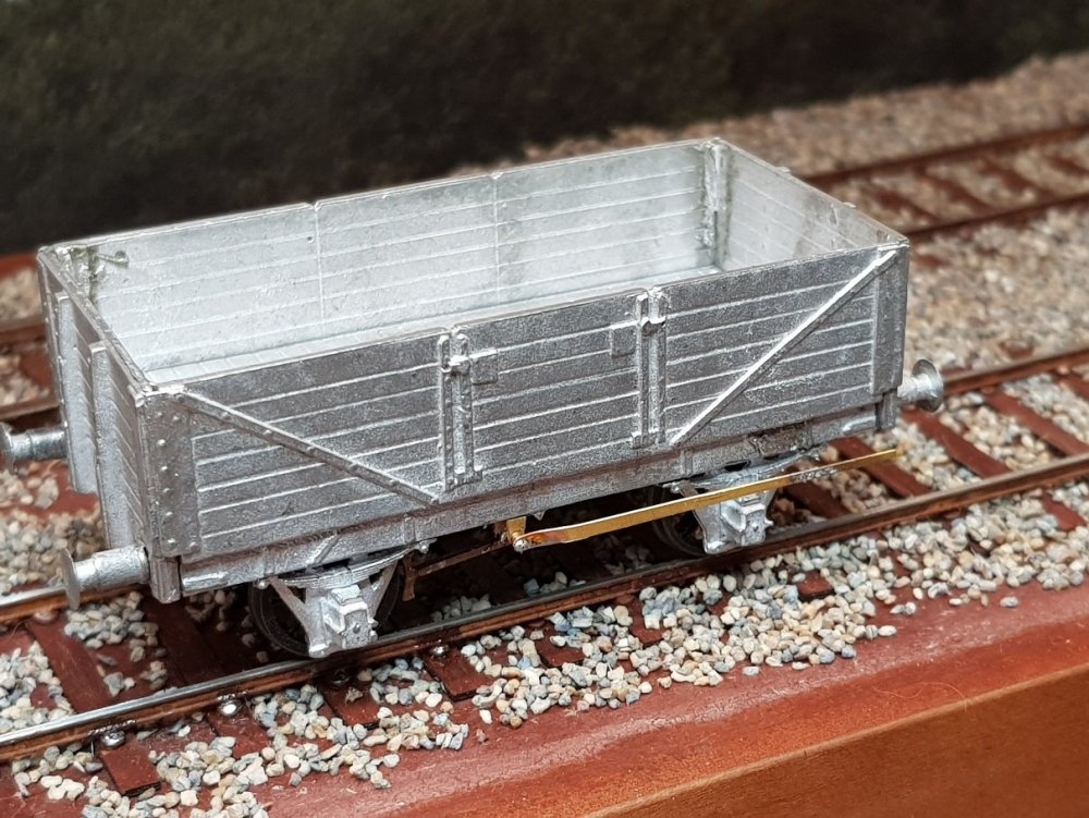

    Some work over the weekend. Progress on the wagons. Finishing off with springs, axle boxes, brakes, and coupling system. I have been holding off on the coupling system, which I really shouldn't have, as some integration into the kits may have eased the installation. Not withstanding that, the installation was quite straightforward with adjustment based on buffer length. The coupling system of choice is the Spratt & Winkle system from Model Signal Engineering as it's unobtrusive but effective and allows remote uncoupling. It involves the fixing of a coupling paddle / hook to the underside of the frames, while adding a simple wire loop / hoop stops the hook from pivoting too high. On the other end of the wagon another hoop provides connection for the hook of the adjoining wagon. Remote uncoupling is by means of three links of soft iron wire connected to the hook (not done yet) which is drawn down by magnets buried under the track. The three links and very slim appearance of the coupling system provide a closer to prototypical look. S&W coupling hook / pivot. Connection between wagons Wagons are virtually complete and can now head for the paint shop. GSWR open wagon (Studo Scale Models) , with SL&NC Vehicle Wagon (Scratchbuilt). MGWR Fishvan (JM Design) and GSWR (?) 7 Plank Wagon (SSM) with Class 423 (Scratchbuilt) in the background. More soon. Ken

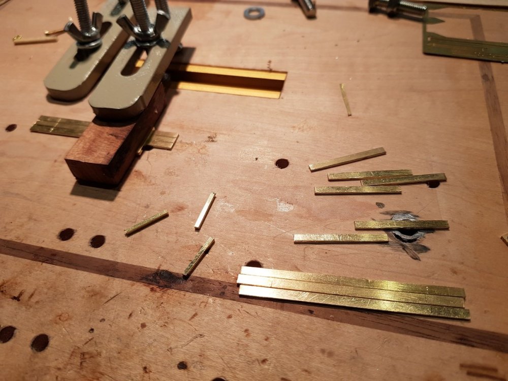

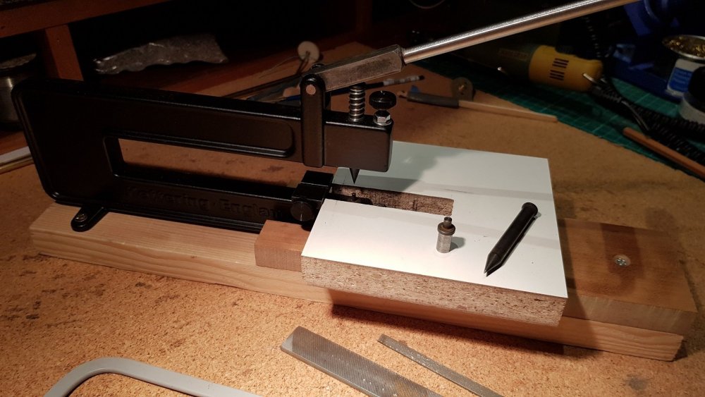

    Hello Noel, Rivets were punched onto 1mm x 0.5mm strips using a Kettering Rivet Press supplied by Midland Railway Centre. Ken

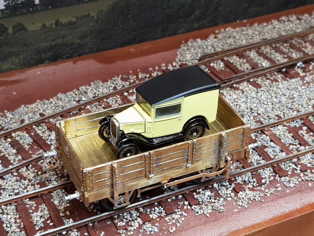

    KMCE's Workbench

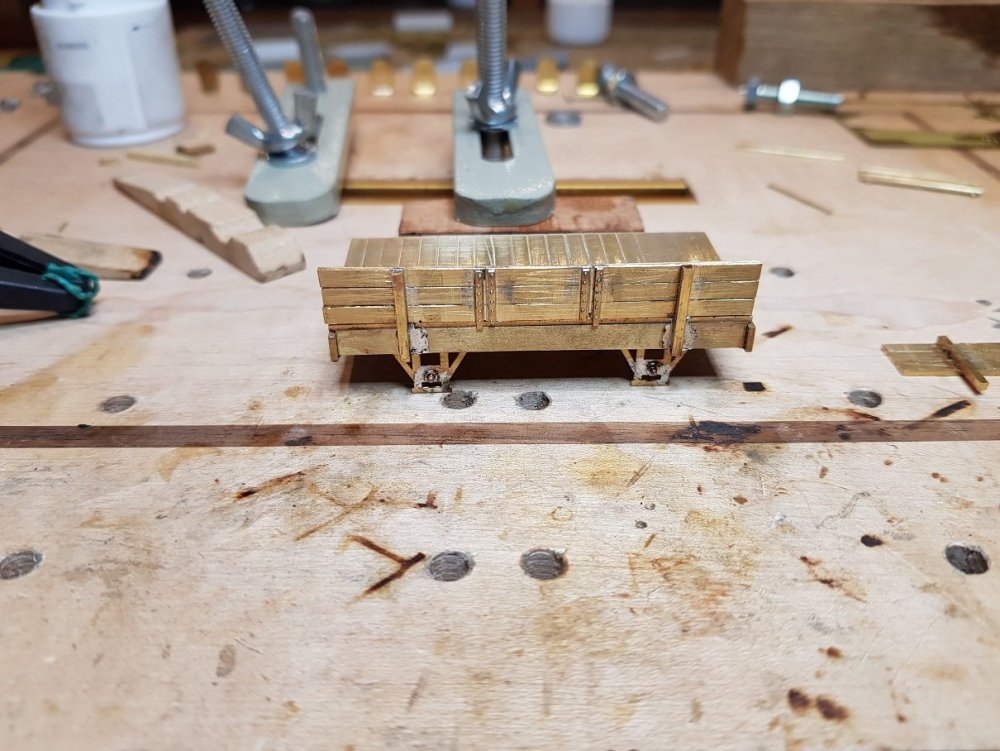

    Some work to date: I rather like the look of the SL&NC Road Vehicle Wagon, and having some 1mm brass sheet, I decided to have a go at creating one. Drawing created of the wagon, which allowed a cut drawing be produced which was then cut out on the CNC. Really tough stuff, and many broken bits, trimming and sanding later we ended up with some reasonable parts. I bougth the 1mm some time ago thinking I would use it for loco frames, but 0.5mm is more than enough and closer in scale so this was surplus - I won't be buying it again as it is difficult to work with, both cutting & soldering. Floor, buffer beams and solebars/frames assembled. Sides are created from individual planks cut out, which is probably over the top, but will provide good detail. These were then assembled with some uprights and strapping added c/w rivet detail for the opening door section. The uprights were then used to fix the sides to the frames. This wagon is a little unusual in that the sides line up with the frames with no overhang. The sides were originally designed to be removed thus they lined up with the frames and slotted into straps on the frame. Other sides and additional strapping was added to complete the wagon body. Compensated W-irons from SSM were then added, including the brake detail and brake levers. Temporary buffers were added for effect and we arrive at this: Wagon with Austin 7 Van purchased at the show last Sunday. Some more strapping needed for the uprights, springs, axleboxes, draw hook and coupling system to be added to finish it off. A good cleanup is also needed ot get rid of excess solder, marks, etc before we get to painting. I also decided to assemble an SSM open wagon kit I have had for some time now. Whitemetal is a very different material to work with, but the kit went together rather well. Again SSM compensated W-irons and brake detail added - this needs to be completed as the lever is not shaped, so will need to come off again and lever guides to be added. Nice wagon and a hefty weight. Final detailing such as drawhook, coupling system, tidying up and into paint. All tolled, we are getting some nice rolling stock together. Numbering gone onto the loco, so final coats of varnish needed plus some weathering to finish off. More as time permits!! Ken

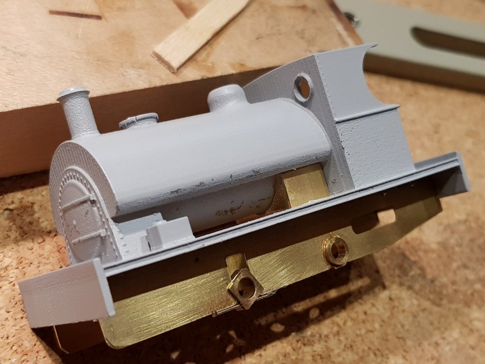

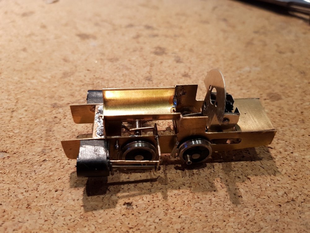

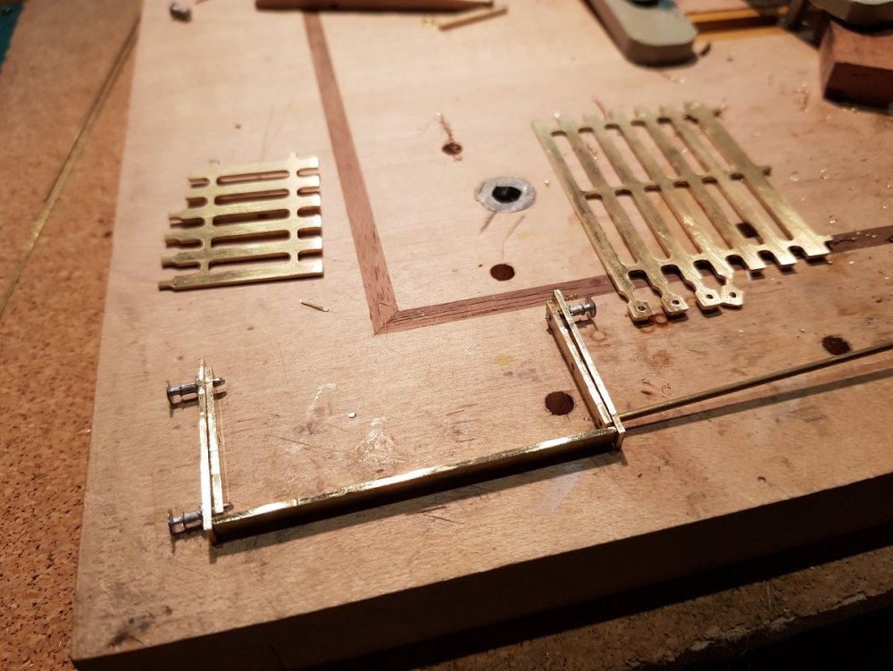

    Class 495 Build

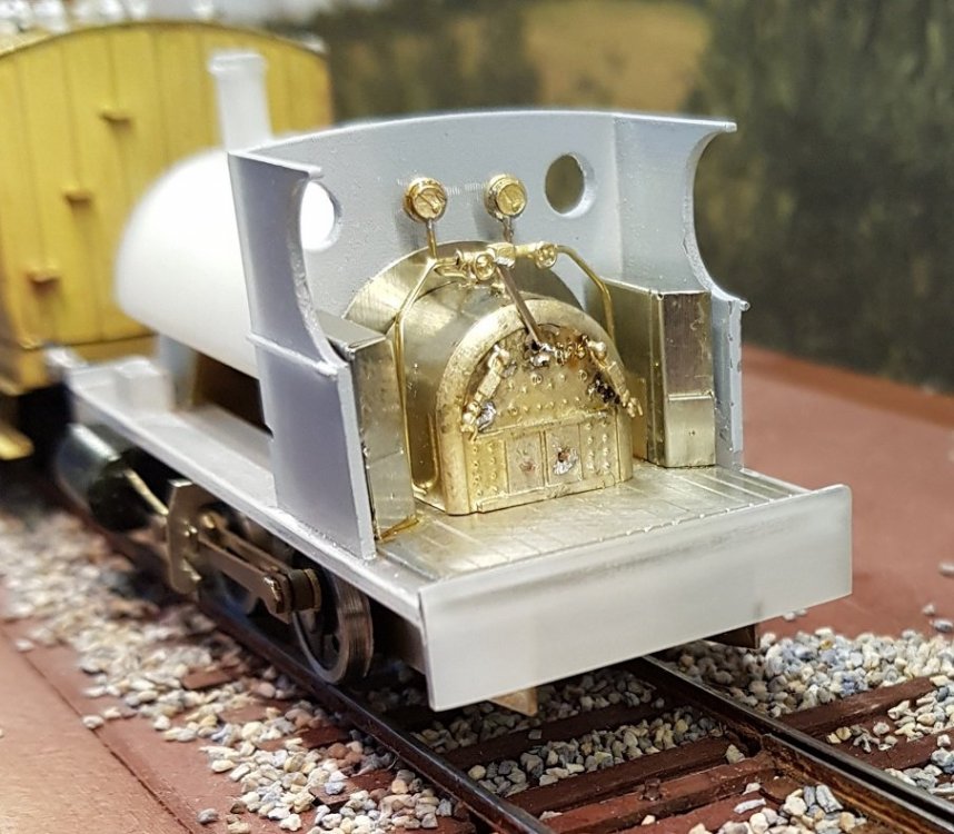

    Fiddly little bugger! Parts from the High Level Pug kit - nice cast brass parts. Needs some tidying up and painting! Ken
  16. KMCE
    Class 495 Build
    After much hoo-hahing with other projects, the poor 495 was shelved for a while. It appeared in the background of some of the photos of other models, but was very much on the back burner. As I got the correct final drive gear from High Level quite some time ago, I decided to have another go at making some progress on this build. The hgh level kit is designed to insert the motor into the boiler and complete the gearbox while the cab was off, however given the 3D print was constructed with a full boiler tube back to the cab and a fixed cab, this was not going to work. Thinking cap on, I decided to redo the frames, include the fire box sides and create an underside for the boiler, which meant I could cut away the boiler on the 3D print, and include slots to allow the top of the gearbox up into the cab area. This means a separate running chassis and drop on body. Brakes on, cylinders, slides and cross head supports installed, gearbox completed and set in place to arrive at this. A front plate, which will both support the front of the boiler base, and tapered to replicate the back of the smoke box was added. Not overly visible due to the angle, but it will be seen later in one of the shots. As mentioned in other posts, the finish of the 3D print was not really good, which was only highlighted by a coat of primer. Much scrubbing with a fibre pen and some 1000 grit paper helped to reduce this roughness which will need another prime to check to see how the flattening is progressing. Plate replicating the back of smokebox is just visible in this photo. Some nicks and dings to be addressed, but overall the finish is better. In the interim, pick-ups were added at low level using a small strip of copper clad and 0.35mm PB wire, motor wired and running gear added. Quartering is proving to be problematic with slightly erratic running not helped by wheels not being completely true on the axles. In fairness the wheels are pretty trashed having being on and off too many times. I will get a set of spoked wheels from Alan Gibson which will more accurately represent the prototype which will help running. In spite of all that the loco runs; with an 80:1 gearbox this loco can operate at very slow speeds. I think a flywheel may help to smooth out the running also. 20190120_190334.mp4 More soon, Ken

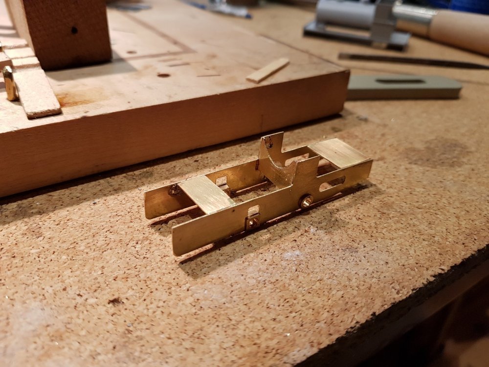

    KMCE's Workbench

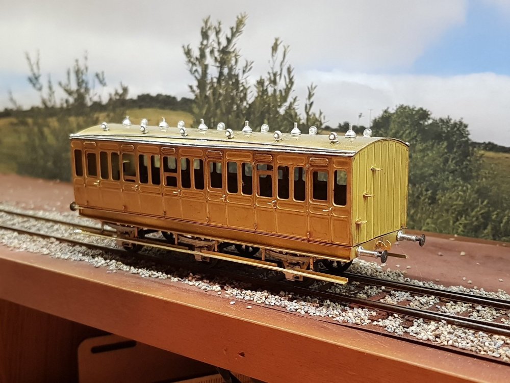

    Got some work done on the 6 wheeler. Ditto here - roof did not fit so a new was made and rain strips added. Sides were also short when the tumblehome was added so ends needed to be sanded down to settle the body on the frame. The gap between the body and base was then strengthened and filled with a 1mm angle. Cleminson chassis built and underframe completed. Not the best chassis it has to be said, W irons were too far apart, even for 21mm gauge and required some tweaking to get right - it also seems to leave the ride height a bit high, and this is with 12mm wheels instead of the required 14mm wheel. There is no compensation, however the side play in the axles will probably be enough. I will leave it for now, but may look at re-doing the chassis if it gives problems. Even with said comments, it is developing into a nice coach. Brakes and a bit more detailing to the underframe to be completed and then off to the paint shop. Interior to be completed once painting is done. More as time allows! Ken

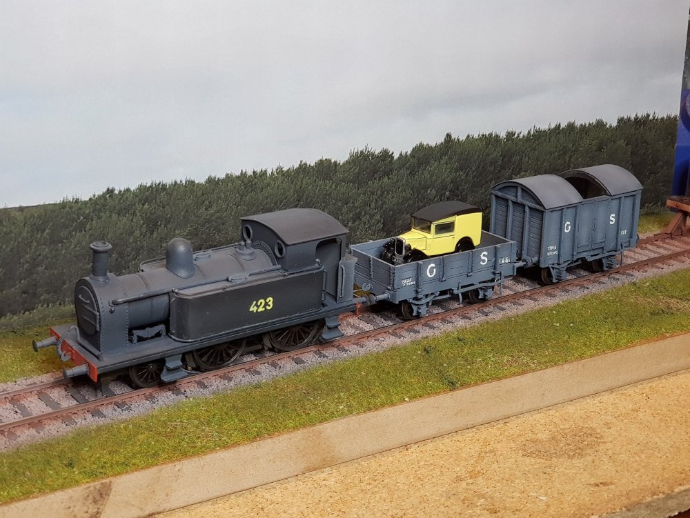

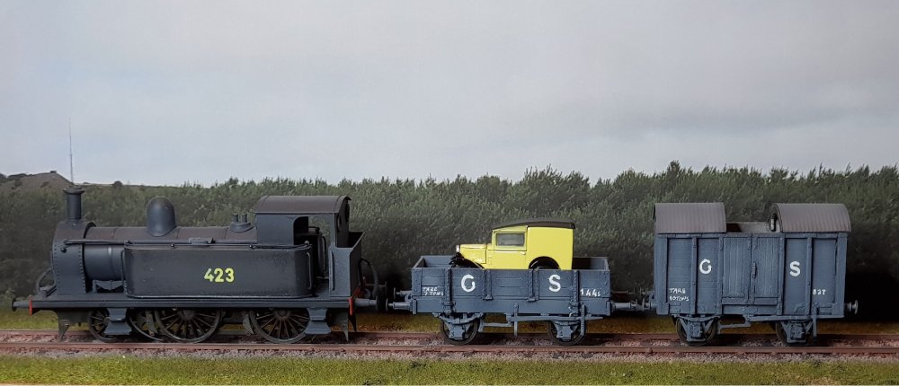

  25. KMCE
    KMCE's Workbench
    423 Practical Completion. Many thanks for the comments guys - they are much appreciated. Finally reached the end of the construction phase on 423 - it has taken just over 2 months from cutting of frames to this point. Latest work included fitting of springs for front axle, draw hook and vacuum hoses. Box section and PB wire were added to simulate sand pipes. Pick ups and wiring for motor are complete and after much fettling we have pick up from all axles. Wheels quartered and coupling rods fitted followed by a test run to fine tune the quartering. Finally we have motion!! Off to the paint shop now........ 20181229_182156.mp4
