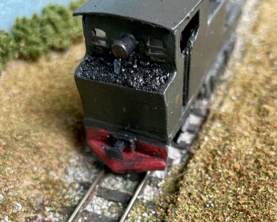

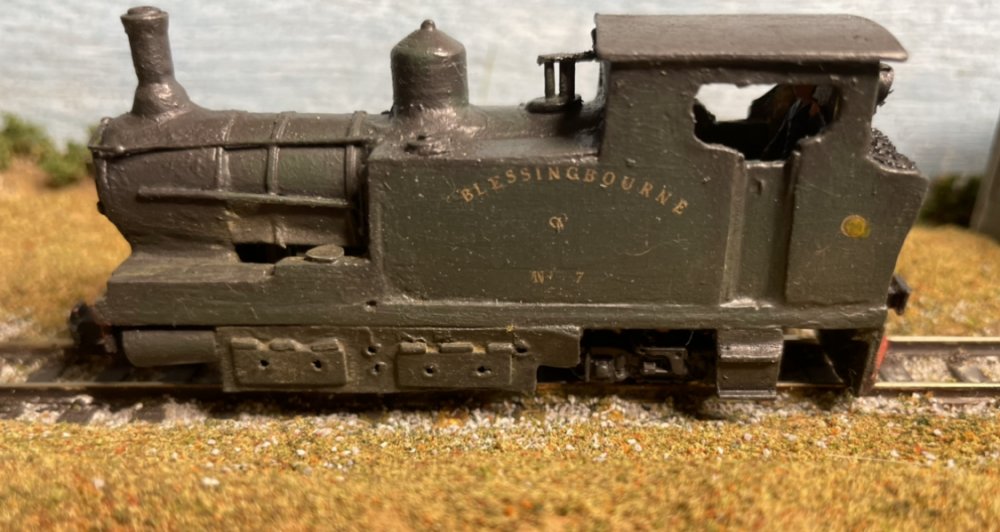

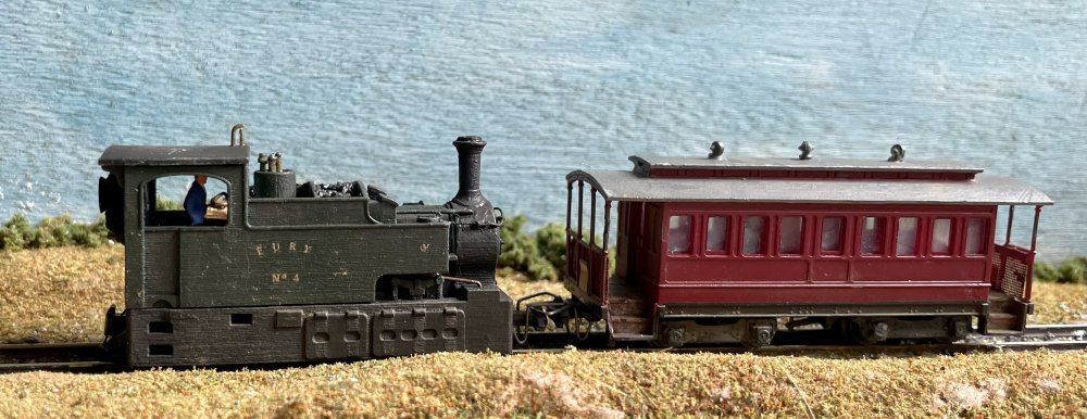

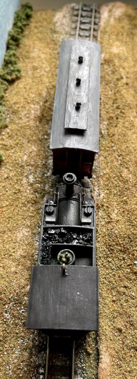

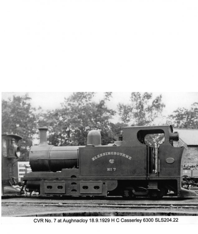

Galteemore Posted May 26, 2021 Share Posted May 26, 2021 (edited) Inspired by @J-Mo Artsrecent photo of an 009 Clogher Valley ‘Blessingbourne’ I thought I’d best finish off mine - although in fairness I did only start it 10 days ago! The real thing was a disaster with appalling adhesion - but a very smart loco. An ideal fit for a Kato bogie chassis - almost! The motor is wide just where the boiler is meant to curve inwards, but I have tried to disguise that. All scratch built -bar the handrail knobs. I turned up the dome and chimney from brass bar. She has separate wire handrails, glazing fore and aft, real coal and a crew. The lettering is a distinct feature of the real thing. Although mine is a little high on the tank sides it hopefully captures the arc of the original. It’s a bit crude but for a first 3mm effort I’m happy enough. In this scale the emphasis is more on trains in the landscape than microscopic detail - I hope....As you can see, she’s a bit smaller than the 7mm loco I have just built ! And she does sit nicely on scale 3’ track. Edited May 26, 2021 by Galteemore 10 Quote Link to comment Share on other sites More sharing options...

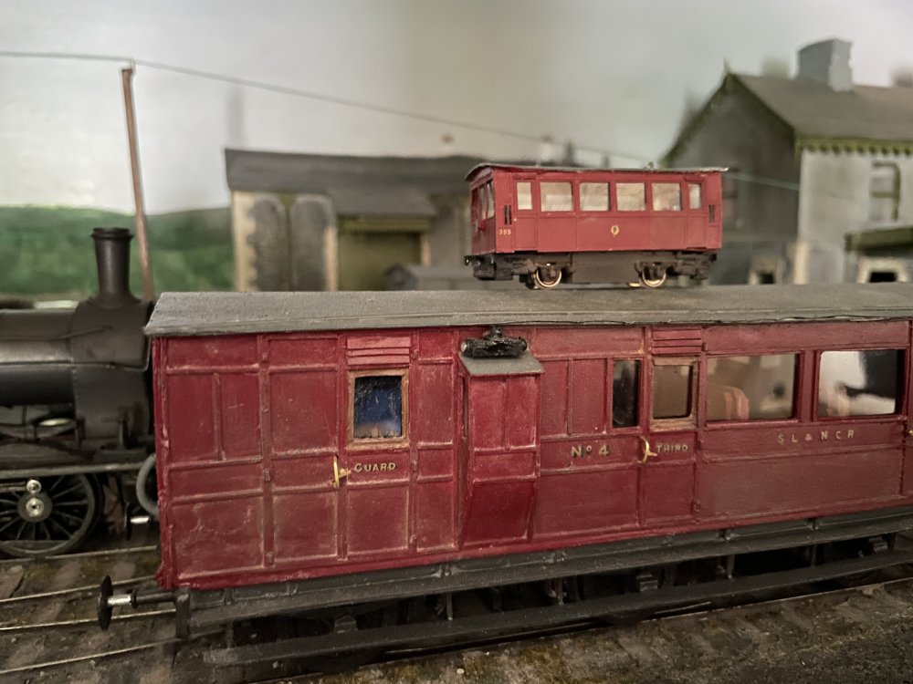

Galteemore Posted June 6, 2021 Author Share Posted June 6, 2021 Dragged on a few weeks now but more or less finished this West Clare Drewry railcar. Worsley Works etches provided sides ends and floor, most of the latter being cut away to fit in a little Kato motor. It’s far from perfect but runs like a dream. Finished in weathered GS colours. It’s small compared to a 7mm coach ! 8 Quote Link to comment Share on other sites More sharing options...

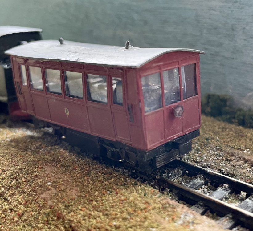

Galteemore Posted June 20, 2021 Author Share Posted June 20, 2021 (edited) Shapeways prints fettled, detailed, and painted. Clogher Valley No4 ‘Fury’ and coach. Hopefully pass the 2’ rule. The driver is a Preiser TT German station master who is not at all happy to find himself demoted from Hauptbahnhof to hedge-hopping tramway ! Edited June 21, 2021 by Galteemore 7 Quote Link to comment Share on other sites More sharing options...
jhb171achill Posted June 20, 2021 Share Posted June 20, 2021 I wouldn’t have thought that a 3D print at that small a scale would look anything other than crude - but those lol superb! 1 Quote Link to comment Share on other sites More sharing options...
David Holman Posted June 20, 2021 Share Posted June 20, 2021 Looks like a fair bit of fettling has been going on, not least the loco chimney. Never mind the two foot rule, both models certainly merit much closer study. Lovely work. 2 1 Quote Link to comment Share on other sites More sharing options...
Mayner Posted June 21, 2021 Share Posted June 21, 2021 Is the CVR coach Worsley Works or did Andrew Mullins produce a 3mm scale version of the Branchlines CVR coaches I am tempted to build a CVR 0-4-2T & a 4w Passenger Brake in 4mm myself to go with a pair of Branchlines Coaches & a Horsebox I bought/built about 30 years ago. 1 Quote Link to comment Share on other sites More sharing options...

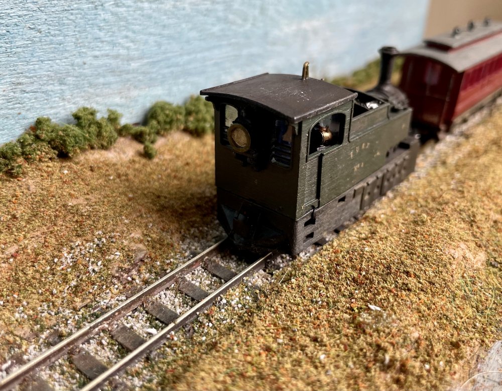

Galteemore Posted June 21, 2021 Author Share Posted June 21, 2021 (edited) 36 minutes ago, Mayner said: Is the CVR coach Worsley Works or did Andrew Mullins produce a 3mm scale version of the Branchlines CVR coaches I am tempted to build a CVR 0-4-2T & a 4w Passenger Brake in 4mm myself to go with a pair of Branchlines Coaches & a Horsebox I bought/built about 30 years ago. The CVR loco and coach are both Shapeways, John, from David Hurst. Loco runs on Kato pocket line chassis drastically cut down, and has had handrails, whistle, pipework, cab interior, glazing, and real coal added, with my own fabricated smoke box dart. Transfers are Fox 1mm lettering. The coach is a simple Shapeways, almost clips together, albeit with brass mesh added to the ends to replicate the original. Runs on Peco Welsh NG bogies. He also does the loco in 00n3, which may interest you: I think it was a collaboration with Paul Titmuss. The Clogher valley locos are a bit of a trap for the unwary 009 modeller as they will look far too big on 2’ scale track, so he also does a scaled down version for 009 ! Edited June 21, 2021 by Galteemore Quote Link to comment Share on other sites More sharing options...

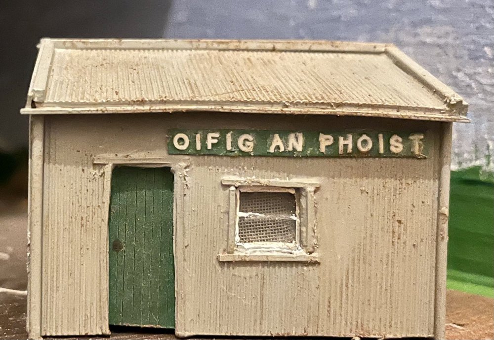

Galteemore Posted July 8, 2021 Author Share Posted July 8, 2021 (edited) One of my earliest memories of trips to Leitrim in the 70s involves the corrugated iron shops - now closed - between Belcoo and Manorhamilton. That’s shops made out of the stuff, not retailing it…..For Drumkeeran Road, I’ve tried building one from plastic sheet etc. Crude but 2’ rule and all that - it’ll be at the back of the layout. First pass with some weathering today. Edited July 8, 2021 by Galteemore 6 Quote Link to comment Share on other sites More sharing options...
David Holman Posted July 9, 2021 Share Posted July 9, 2021 Guessed at Post Office and Google translate confirms! Wonderful lanuage. 2 Quote Link to comment Share on other sites More sharing options...

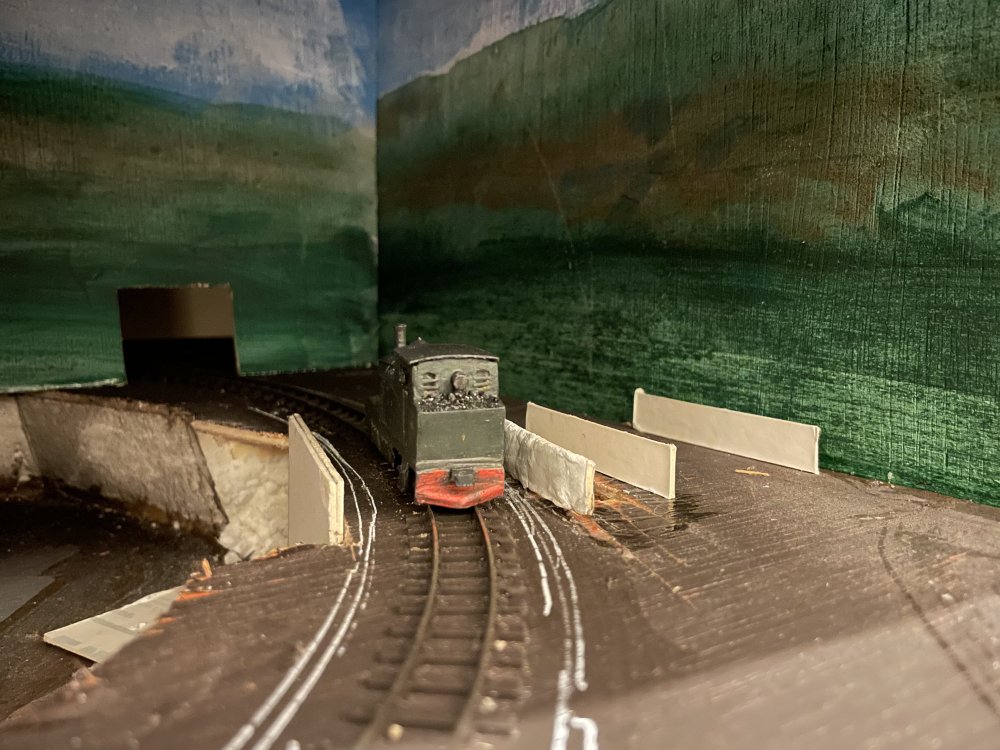

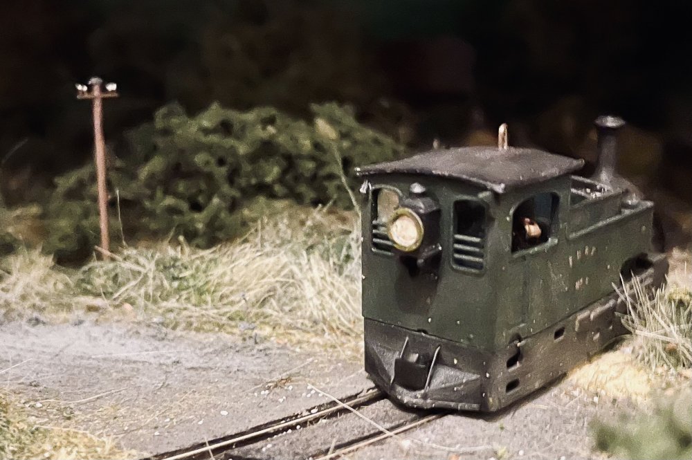

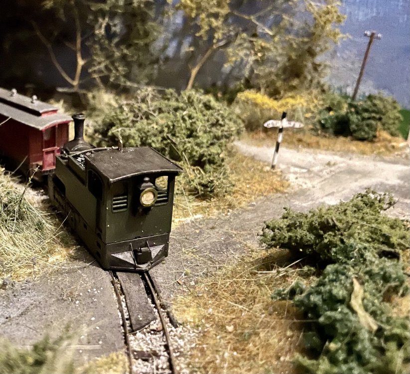

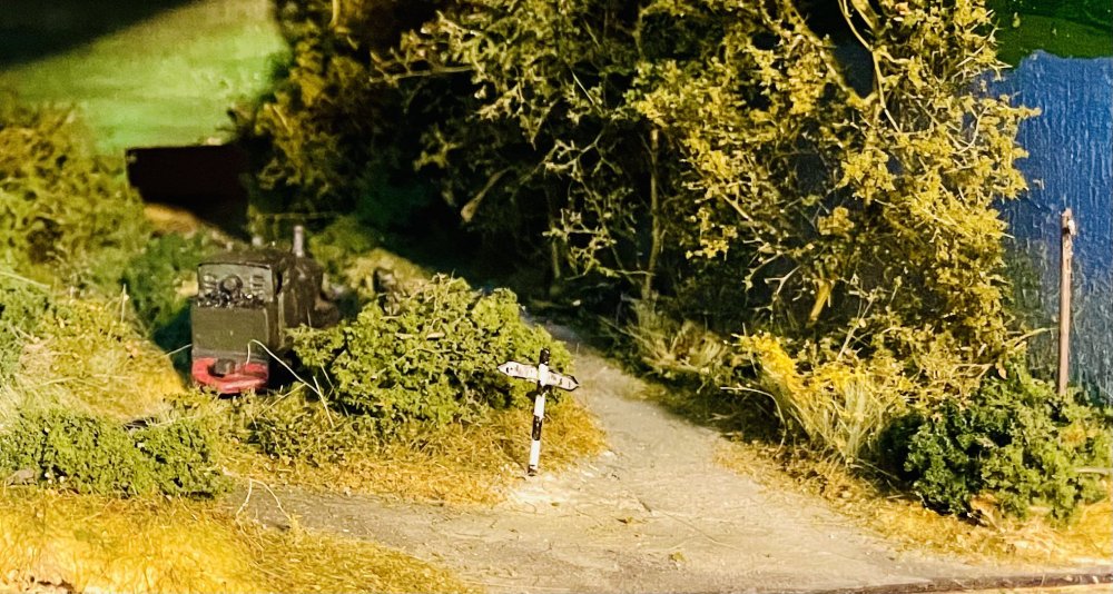

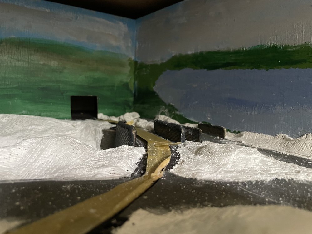

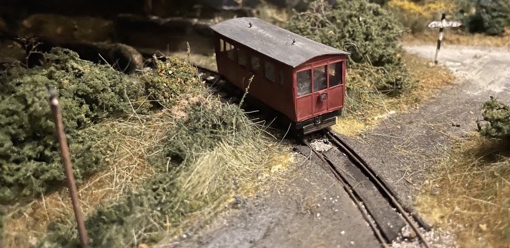

Galteemore Posted July 18, 2021 Author Share Posted July 18, 2021 (edited) Some scenic stuff progresses - some views of the same location several days apart - including the addition of a lake stage right ! The sequence illustrates how the backscene gradually fades into obscurity as detail is added. Fair bit of tidying up to do but getting there. Picture 1 proves there really is a railway somewhere in there ! Edited July 18, 2021 by Galteemore 11 4 Quote Link to comment Share on other sites More sharing options...
murphaph Posted July 18, 2021 Share Posted July 18, 2021 Lovely bit of atmosphere in that scene. 1 Quote Link to comment Share on other sites More sharing options...
jhb171achill Posted July 18, 2021 Share Posted July 18, 2021 On 9/7/2021 at 7:10 AM, David Holman said: Guessed at Post Office and Google translate confirms! Wonderful lanuage. Nach labhraíonn tú Gaeilge ar bith? Quote Link to comment Share on other sites More sharing options...
Westcorkrailway Posted July 18, 2021 Share Posted July 18, 2021 2 hours ago, Galteemore said: Some scenic stuff progresses - some views of the same location several days apart - including the addition of a lake stage right ! The sequence illustrates how the backscene gradually fades into obscurity as detail is added. Fair bit of tidying up to do but getting there. Picture 1 proves there really is a railway somewhere in there ! Now THAT is dense vegetation Stunning 1 Quote Link to comment Share on other sites More sharing options...
Rob Posted July 18, 2021 Share Posted July 18, 2021 Brilliant- that last photo is excellently realistic- love the signpost! 1 Quote Link to comment Share on other sites More sharing options...

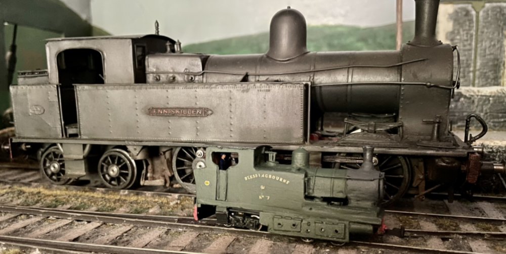

Galteemore Posted July 22, 2021 Author Share Posted July 22, 2021 (edited) Thanks everyone. Been a fun experience thus far. Tried out the Clogher loco and coach, and Drewry railcar for size - in between sorting out the buildings of which more soon I hope. Edited July 22, 2021 by Galteemore 7 Quote Link to comment Share on other sites More sharing options...

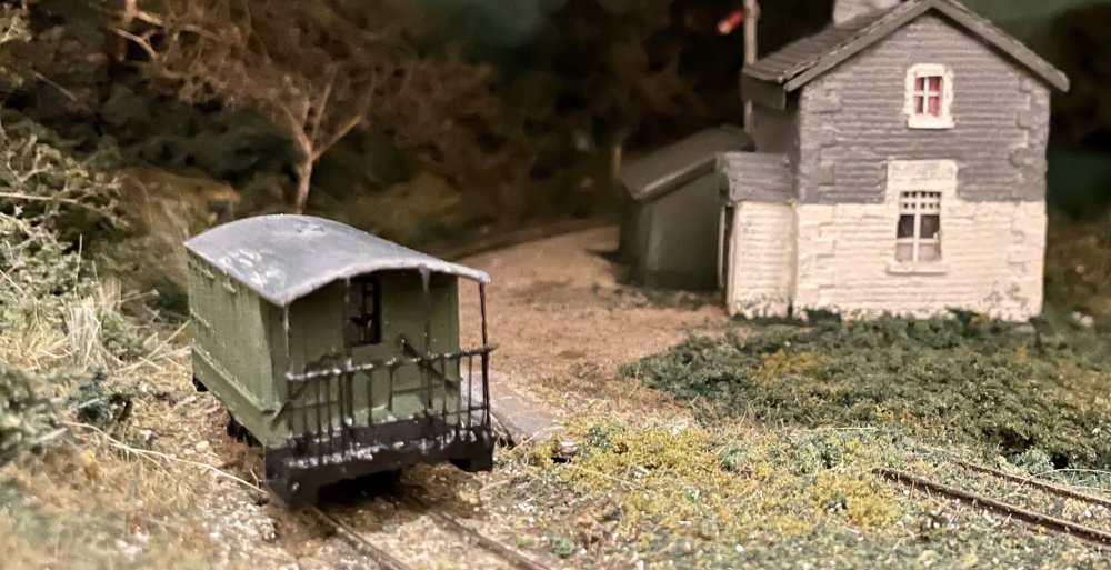

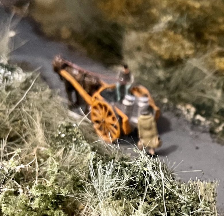

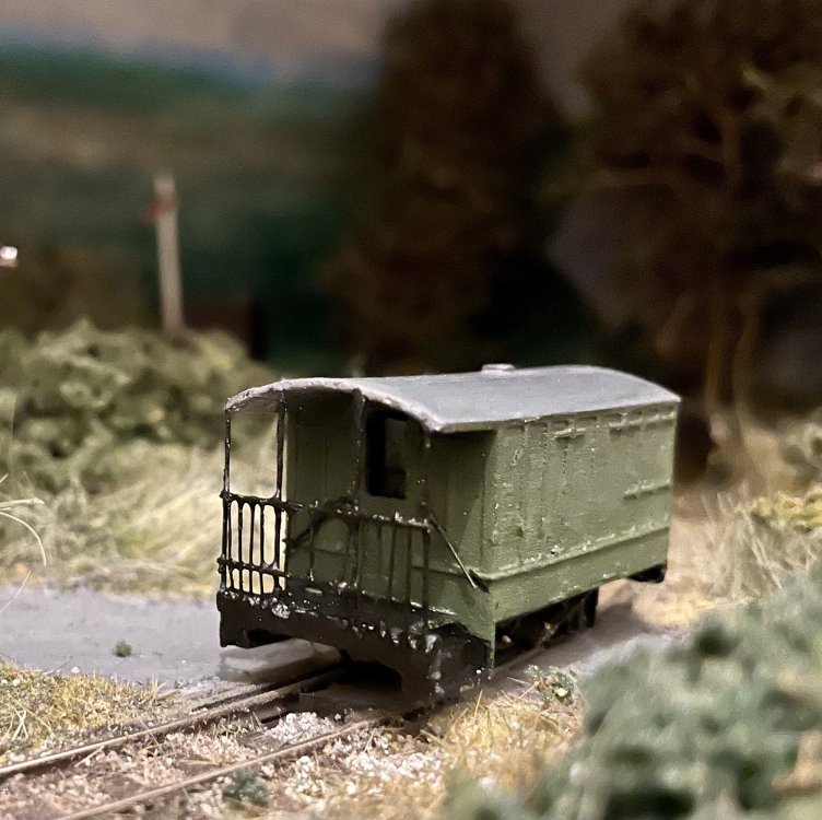

Galteemore Posted September 22, 2021 Author Share Posted September 22, 2021 (edited) First item of C and L stock - brake van. Body is a 3D print mounted on an old Farish chassis - the built in moulded chassis was a bit sub par and needed broken off! Railings built up from plastic rod and entomological pins. Needs a bit of weathering but priority right now is building stock for Saturday’s show !! Have also created a little cameo of two locals chatting on the road…. Edited September 22, 2021 by Galteemore 5 Quote Link to comment Share on other sites More sharing options...
jhb171achill Posted September 22, 2021 Share Posted September 22, 2021 Love the "faded" paintwork on the brake van! 1 Quote Link to comment Share on other sites More sharing options...
