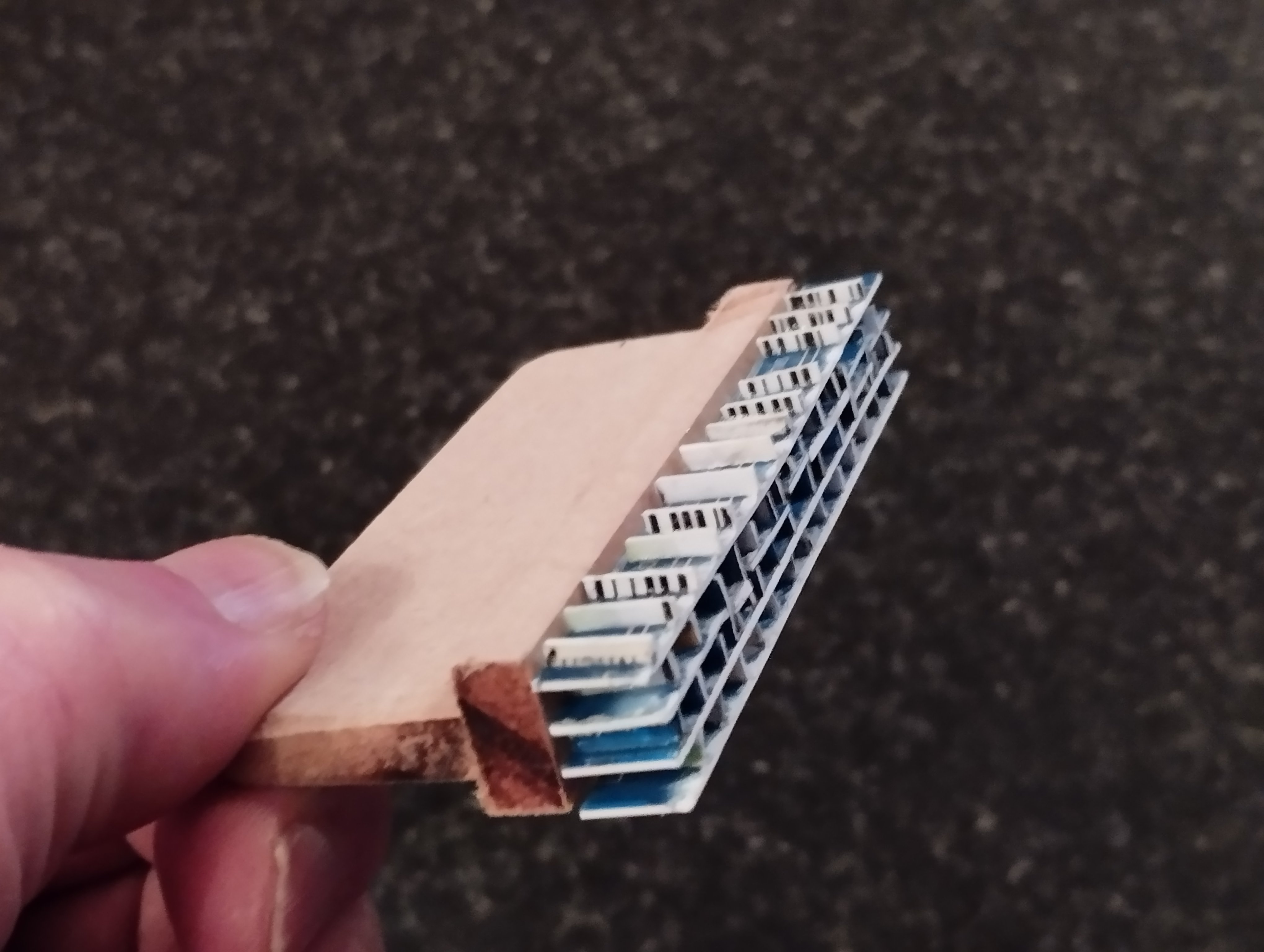

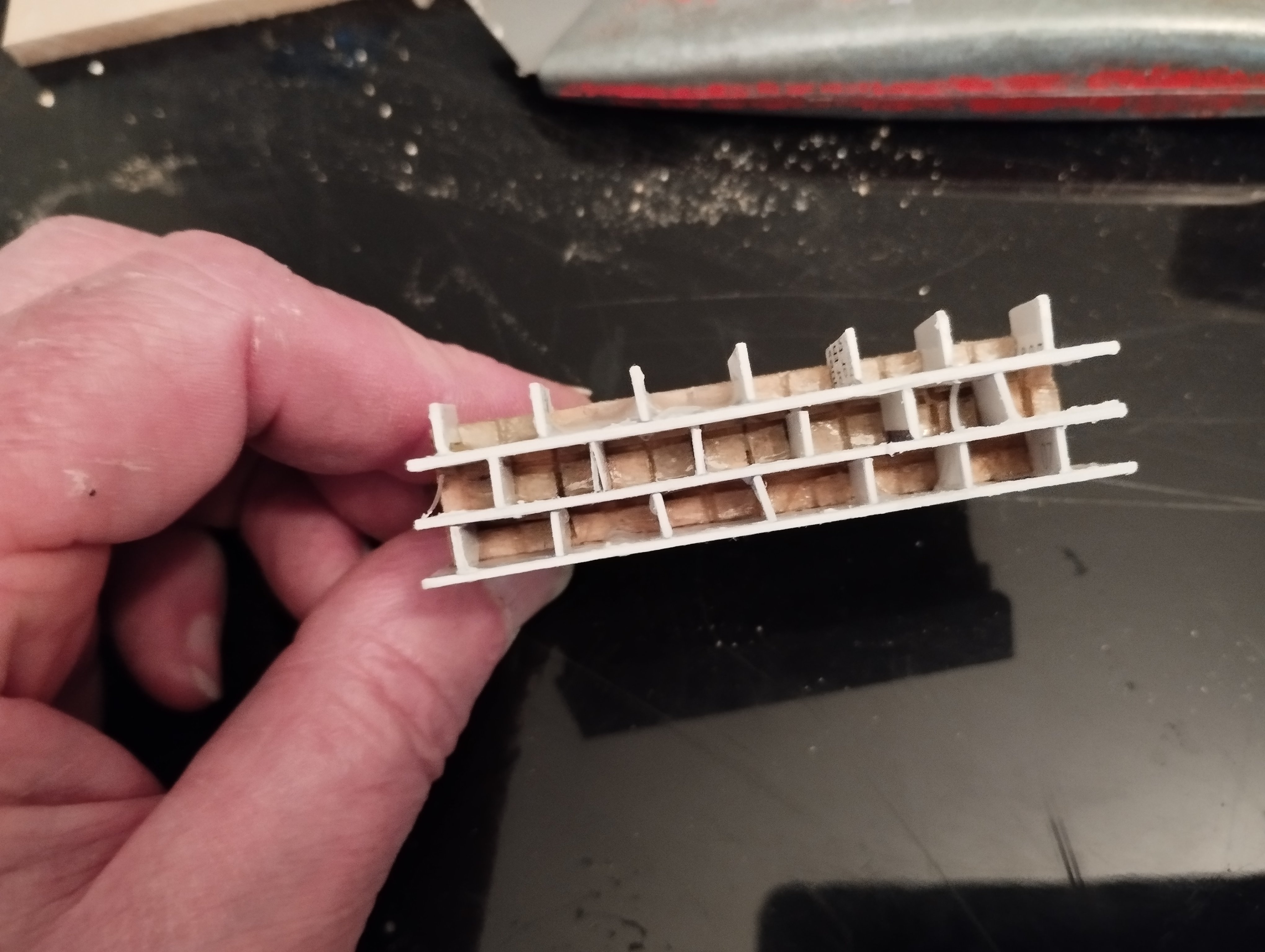

derek Posted April 27 Author Posted April 27 (edited) Thanks lads. The walls were made from Das clay @Patrick Davey. I made a "former", basically a frame of 6mmMDF 100mm long by 48mm high. Clay pressed into it an levelled off. stone effect was achieved by use of this yoke I made a couple years ago from an old tv box card. My name and account number are still on it This pic is of another jig I made for smaller stones, but it gives a better view of how it was made The clay is then removed and flipped over to do the opposite side (placed back in the frame). Best side is turned to the camera ha ha. Ok so, more greenery it is. Thanks again @Galteemore @Metrovik, @Patrick Davey and @Gabhal Luimnigh Edited April 27 by derek 4 2

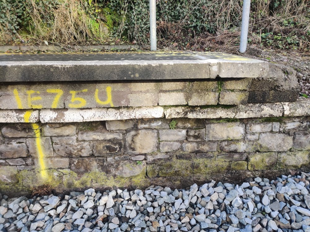

josh_ Posted April 29 Posted April 29 On 7/12/2023 at 7:57 PM, Barl said: As the lads have said a new platform should aim to be 915mm above top of rail but in reality this can vary greatly depending on whether you're modelling an older platform or a lesser used platform. More attention tends to be given to platforms with greater foot traffic. . Whether or not the track has been relaid and/or tamped can also impact on the platform height. I took the photo below during a platform inspection I was carrying out recently and you can see the variation in the height of the copings and the height of the new vs old coping stones. Ive seen it quite a lot and u can also spot where the extension of a platform is with the brickwork dropping

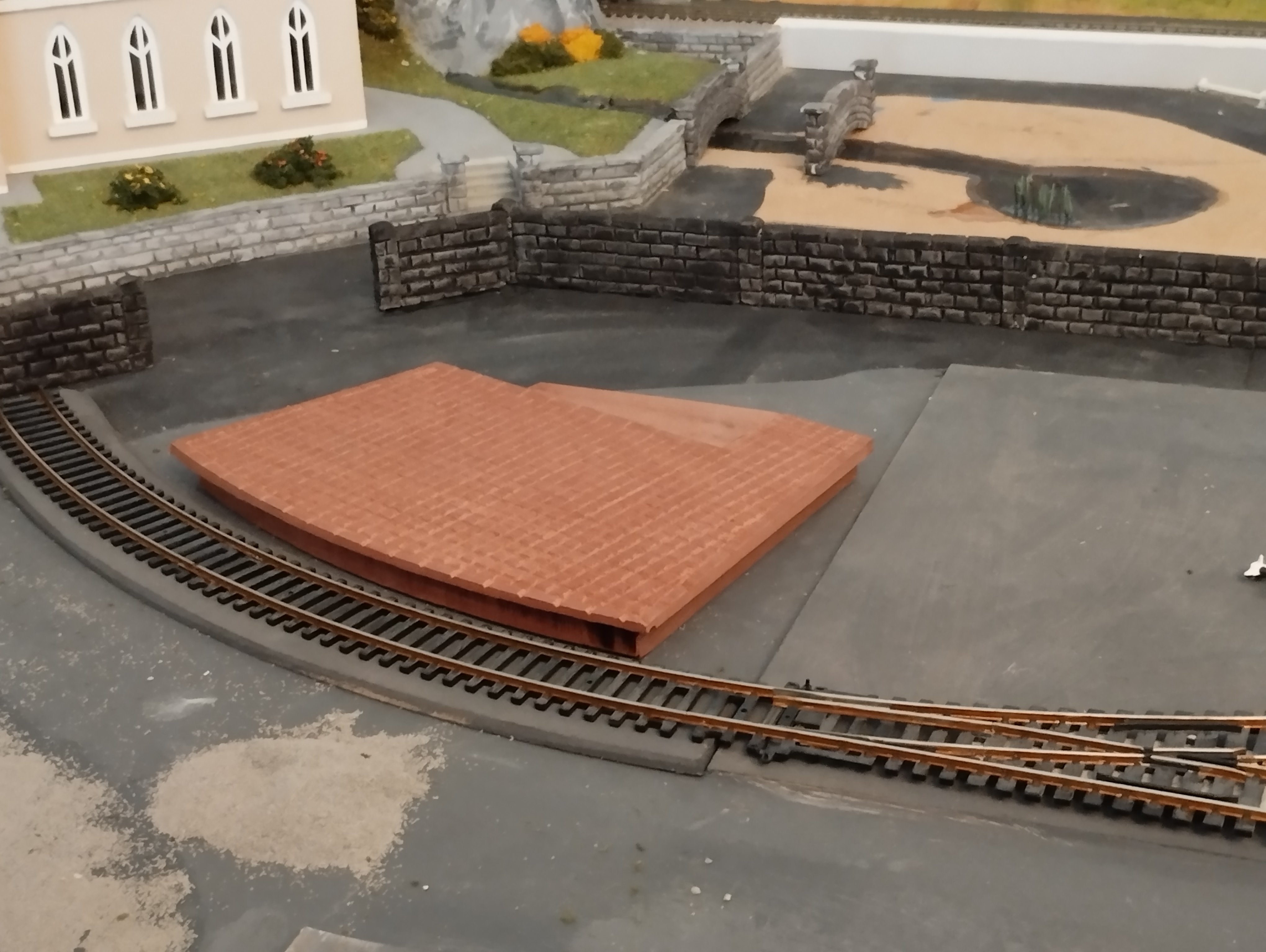

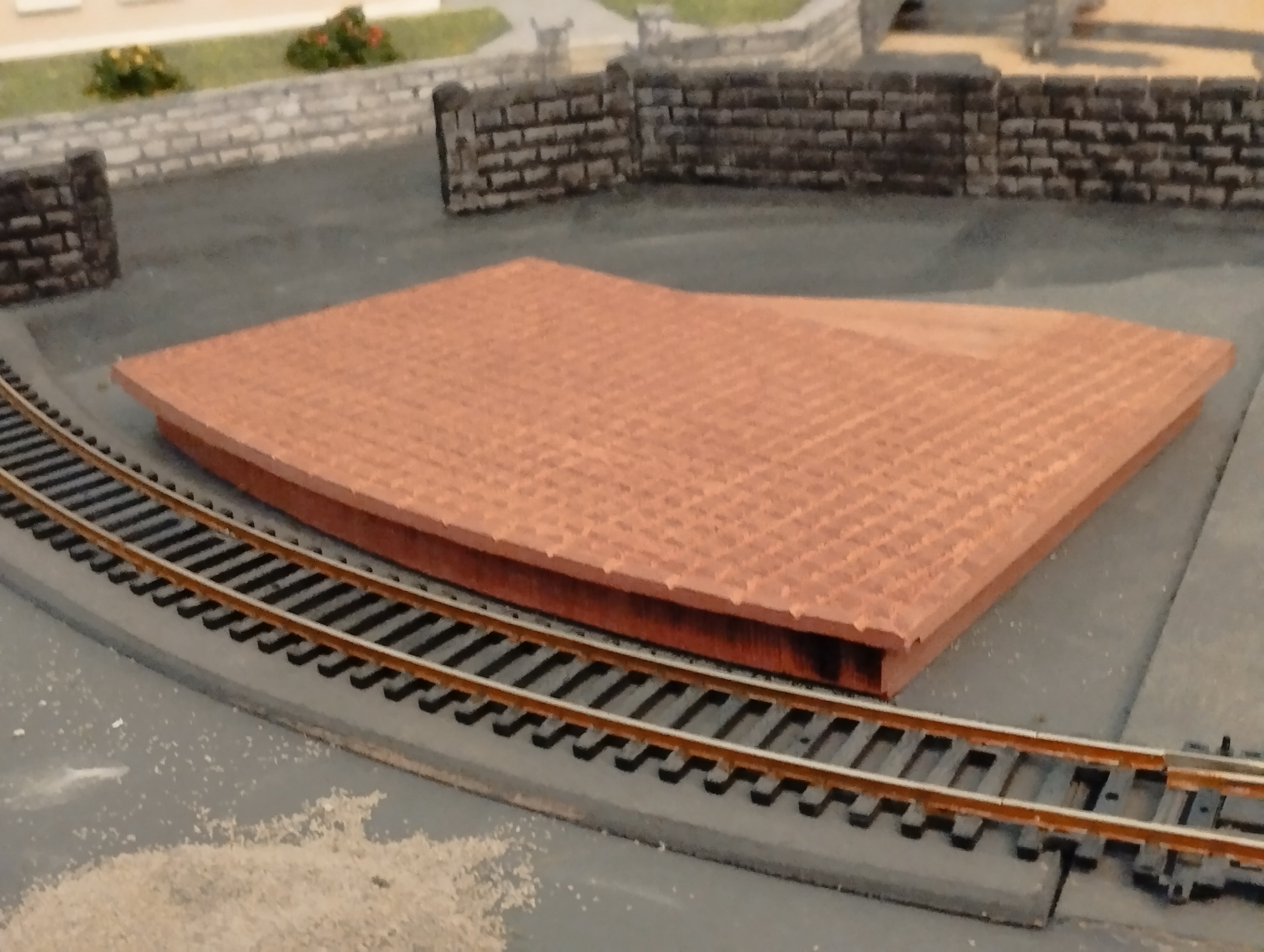

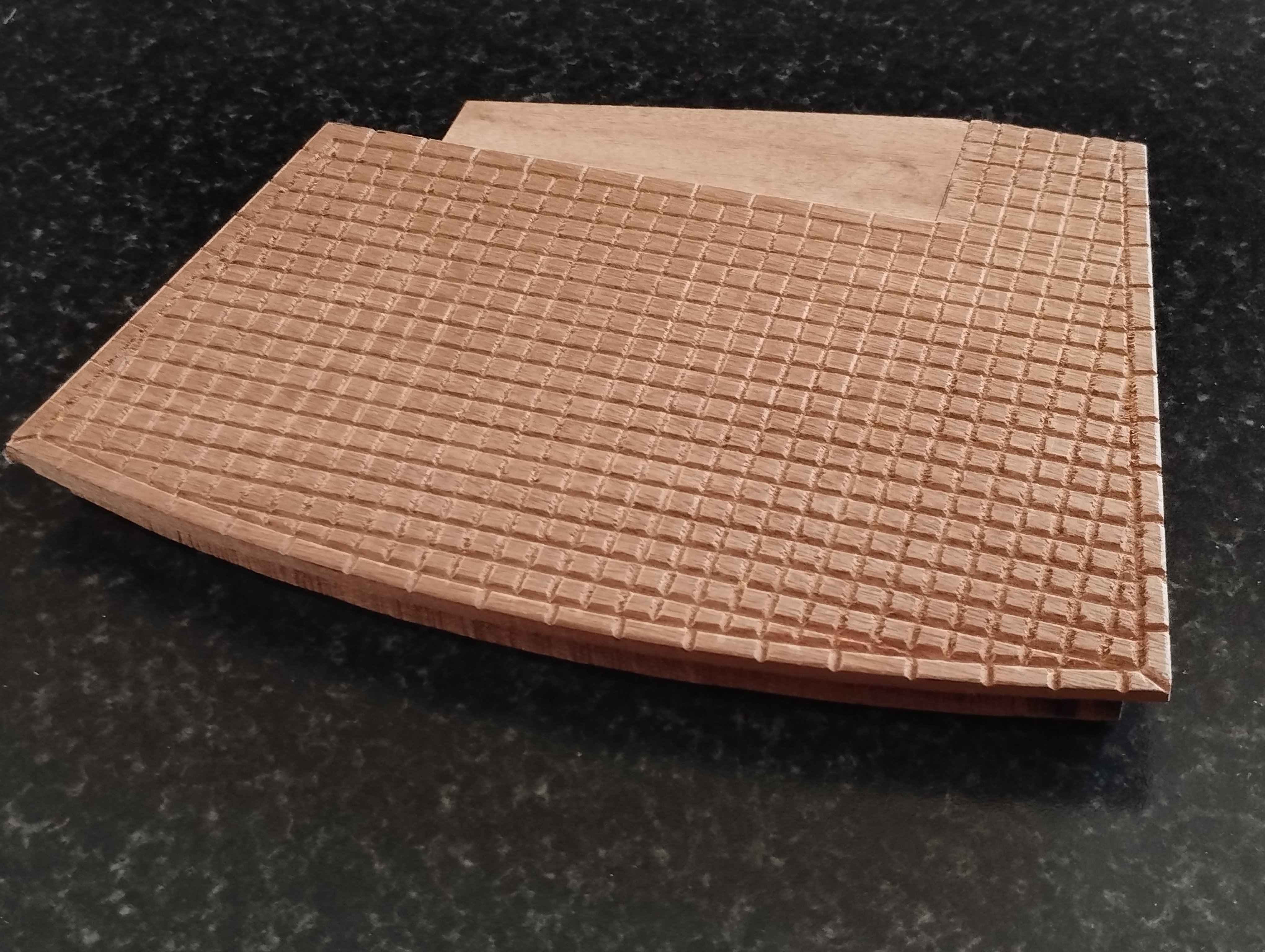

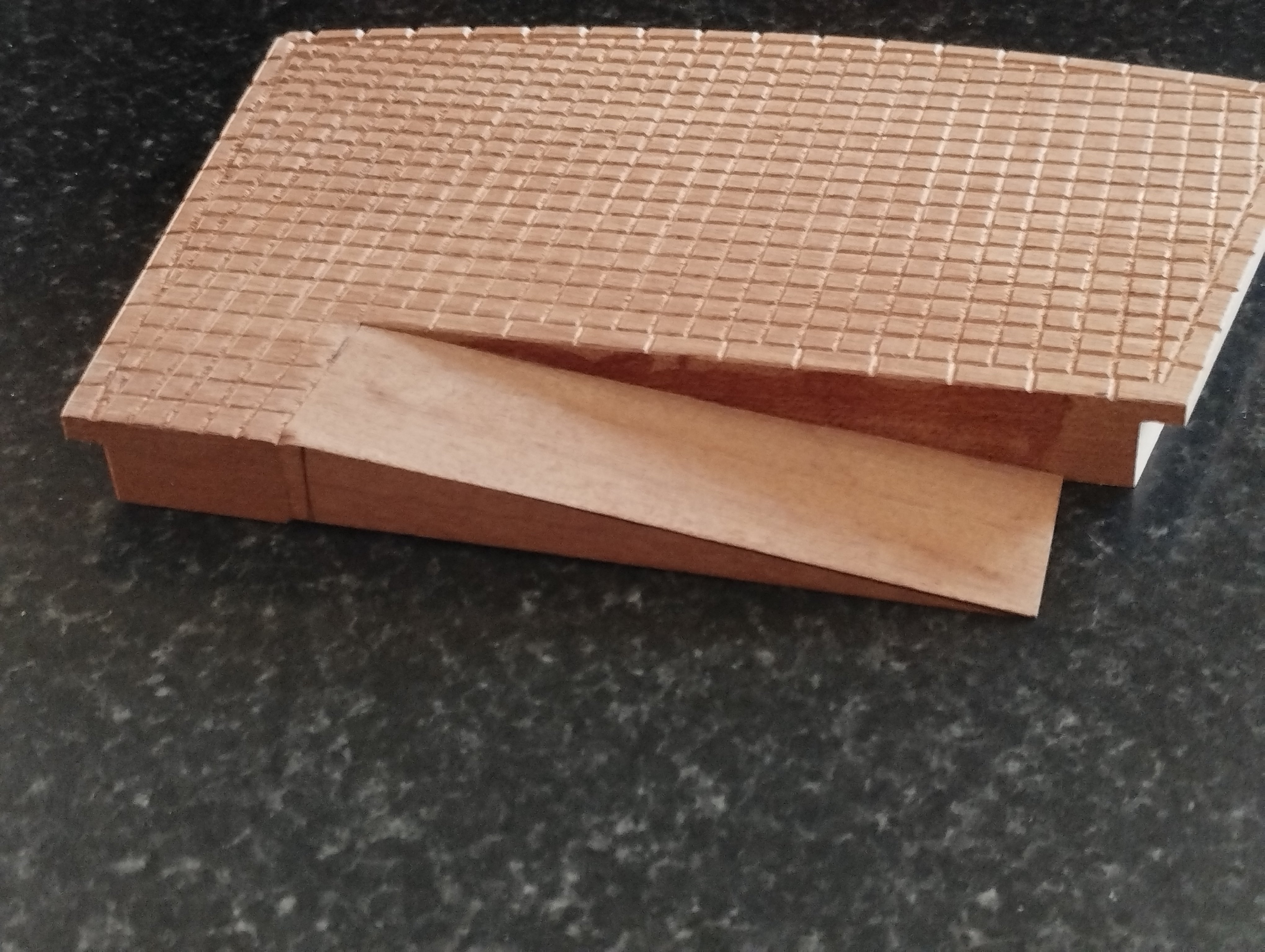

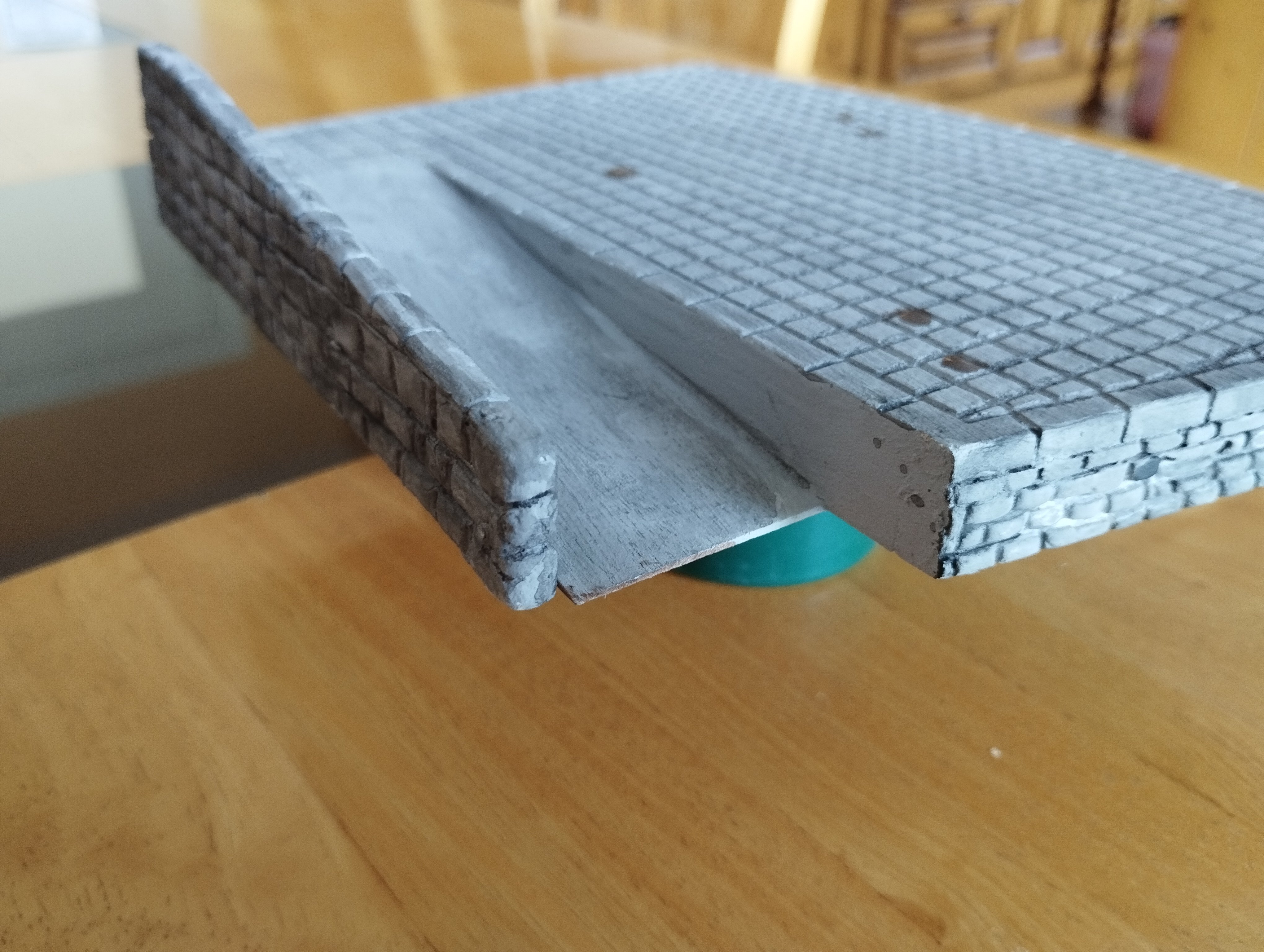

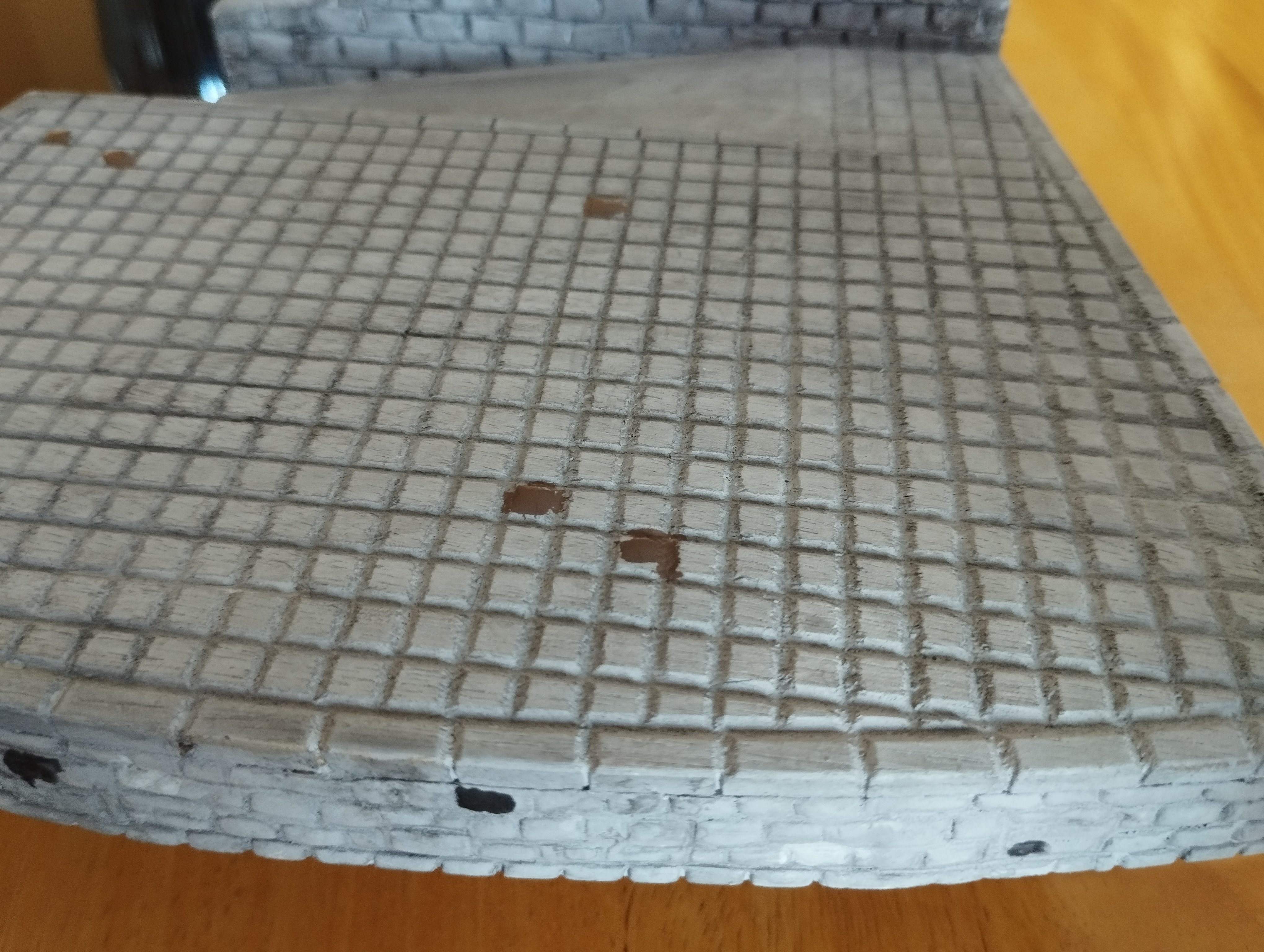

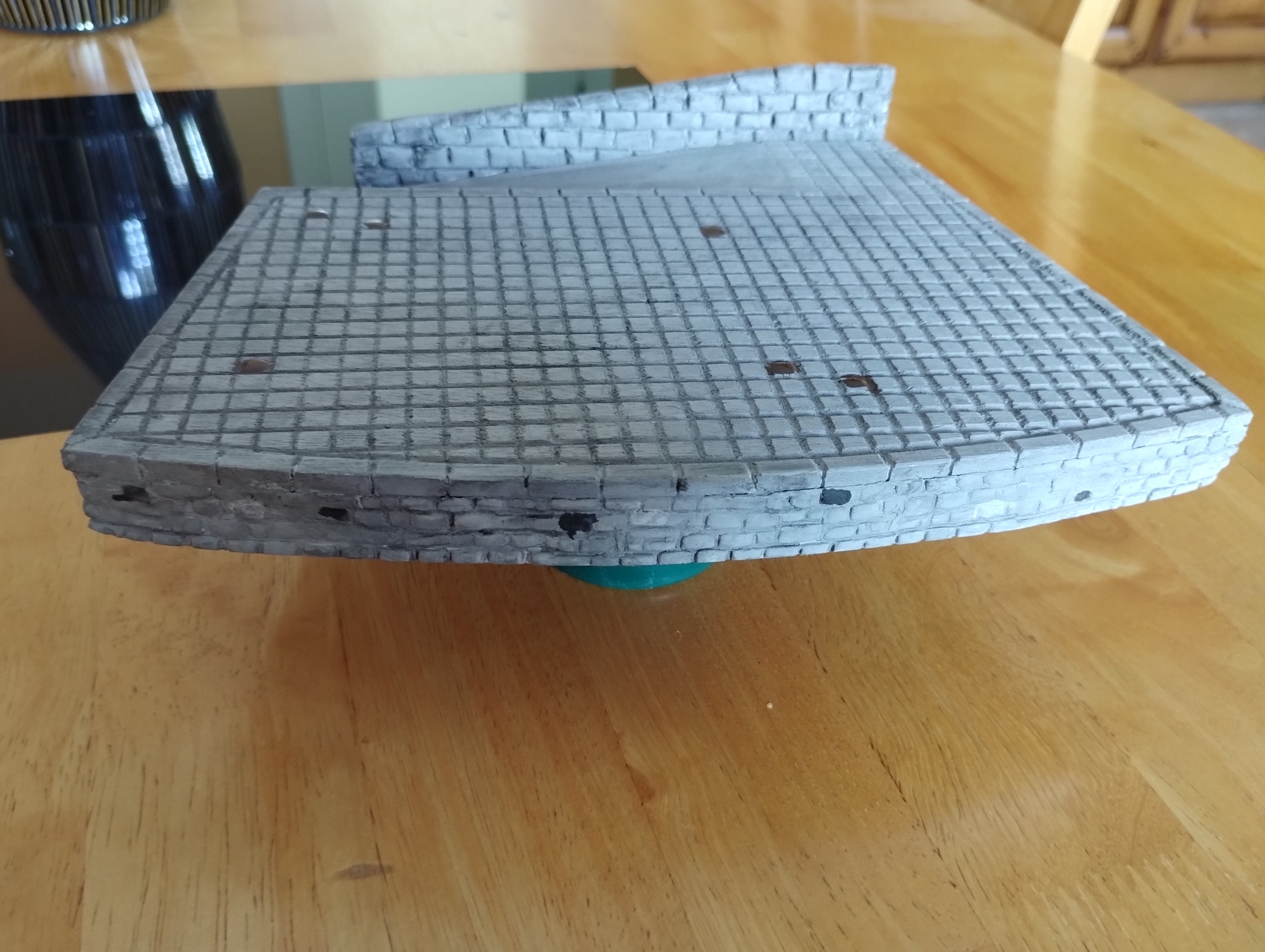

derek Posted May 8 Author Posted May 8 I have made a start on the cattle dock for the freight yard. Only early days with it . 10 2
Patrick Davey Posted May 10 Posted May 10 Superb Derek - I love the authentic cobbled surface created using Das clay I guess? Very nice build, really looks the part, especially how you have built it to fit the location. Looking forward to seeing the finished structure.
derek Posted May 10 Author Posted May 10 11 hours ago, Patrick Davey said: Superb Derek - I love the authentic cobbled surface created using Das clay I guess? Very nice build, really looks the part, especially how you have built it to fit the location. Looking forward to seeing the finished structure. Thanks Patrick. No, it is actually a piece of mahogany I used. The cobbled surface is actually grooved out with a CNC machine. (One advantage of my trade ha ha). Similar to the platforms at the station. I actually ran out of straight track and had a couple of curves left, so that is how I ended up with that set up. When God gives you lemons........... @Patrick Davey 2 1

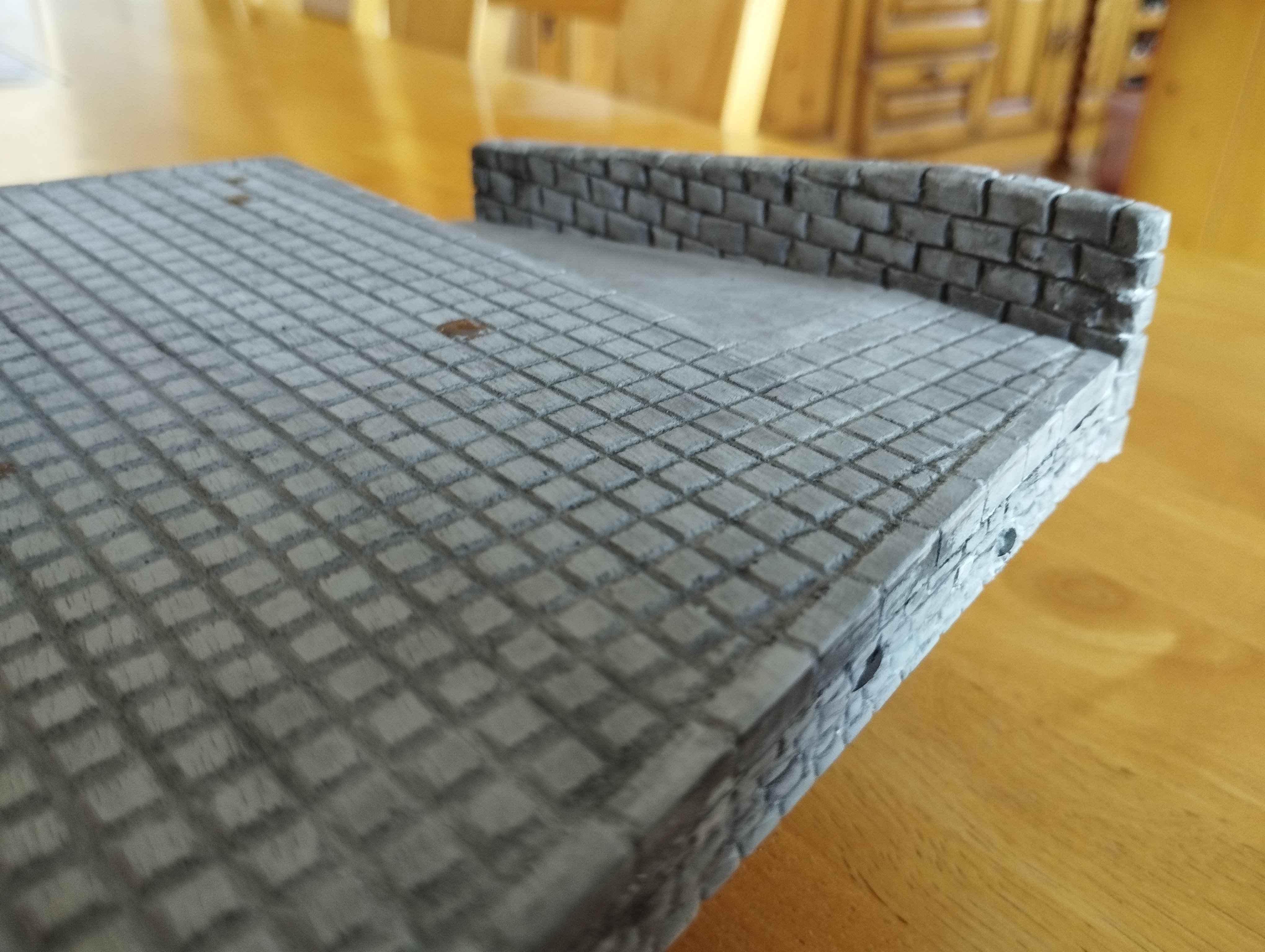

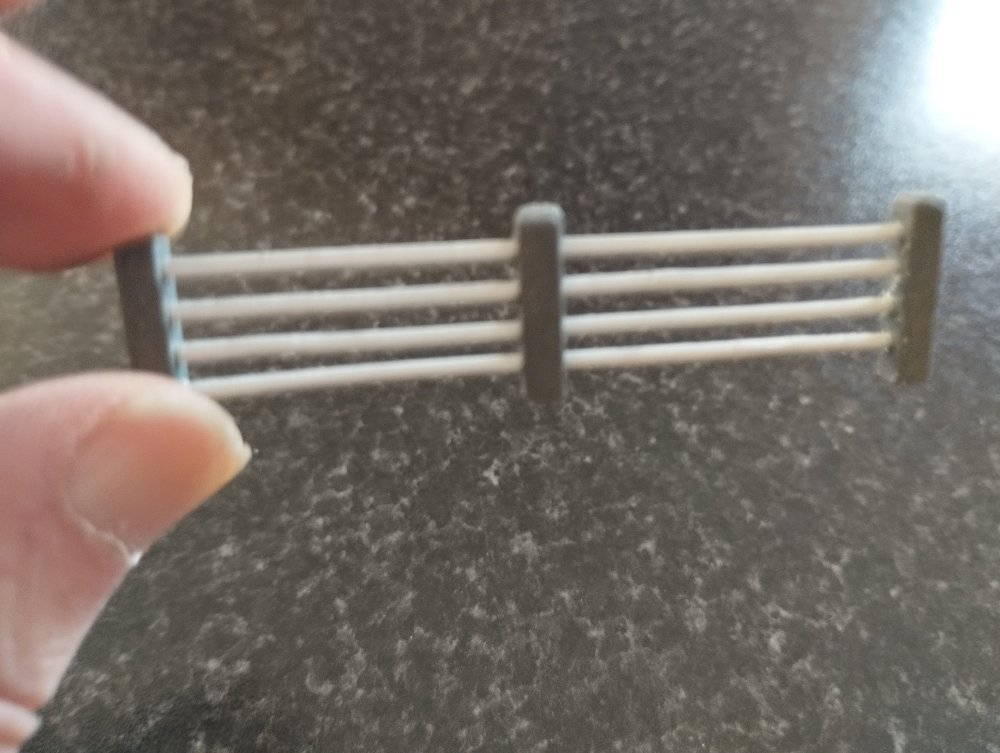

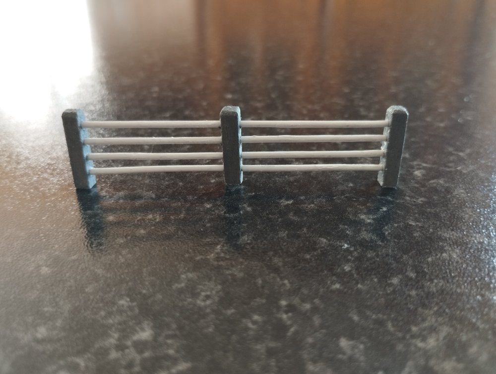

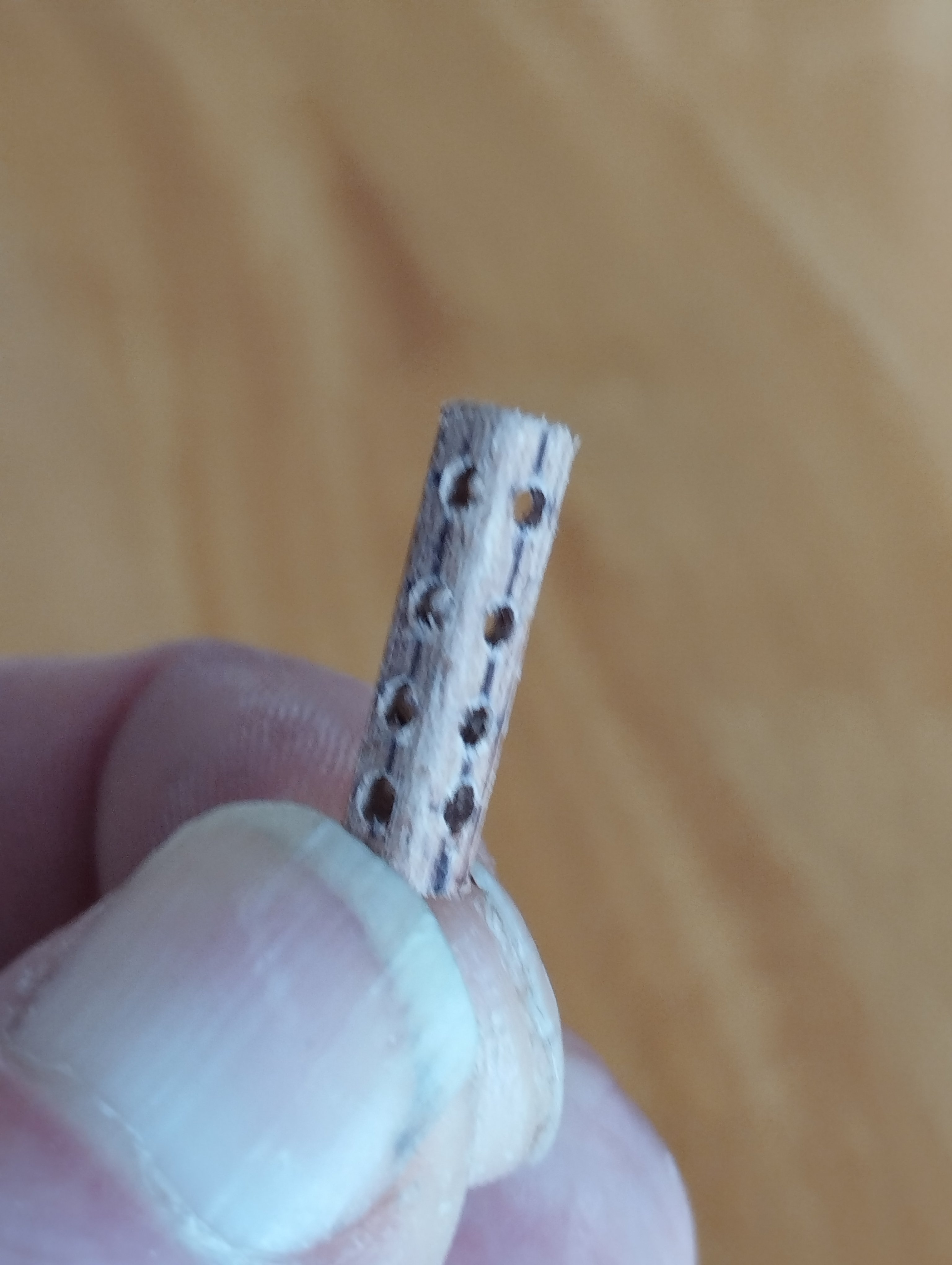

derek Posted June 1 Author Posted June 1 Bit more done to the cattle dock. Stone added and a back wall. And of course a few cow pats. Small bit of weathering too. Lighting is probably too bright in these pics, now that I see them properly. The sun was actually shining in the window behind me- who would have thought. Oh well, you get the idea.. Started on the railing work by making a couple dozen of these lads 11 2
Tullygrainey Posted June 1 Posted June 1 6 hours ago, derek said: Started on the railing work by making a couple dozen of these lads !! That's patience Derek! 1 1

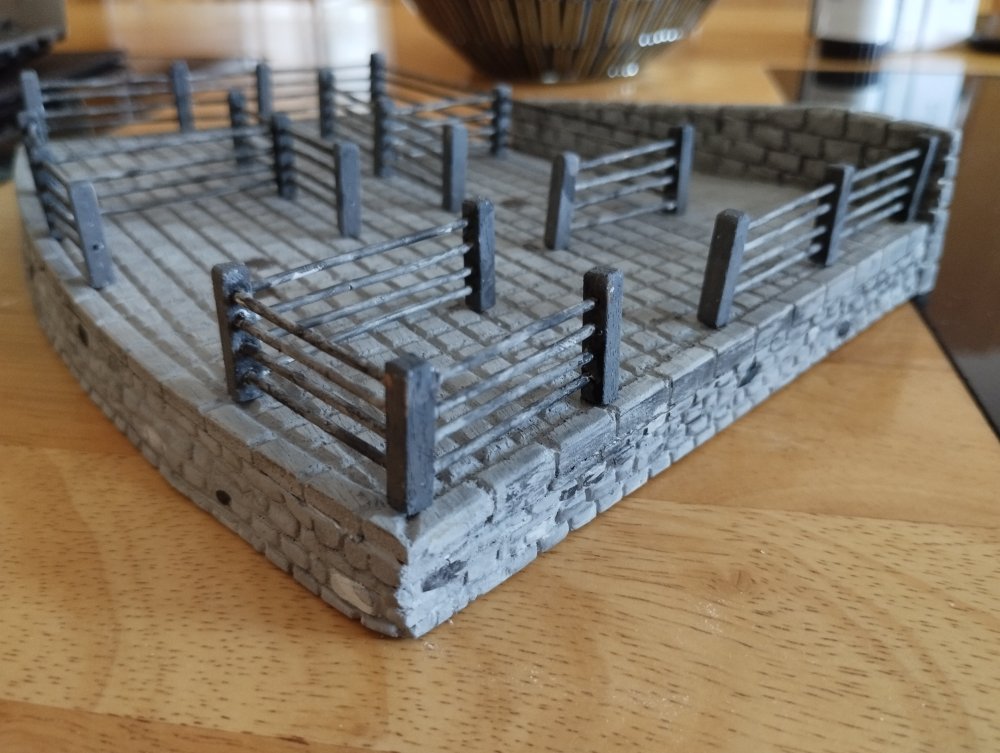

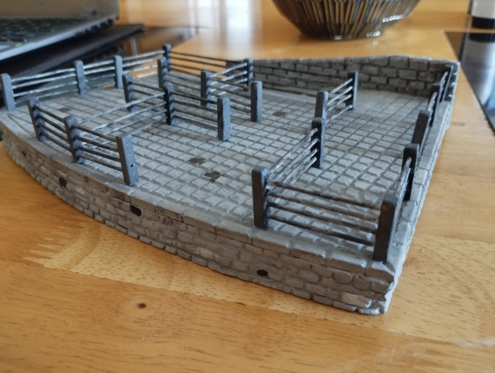

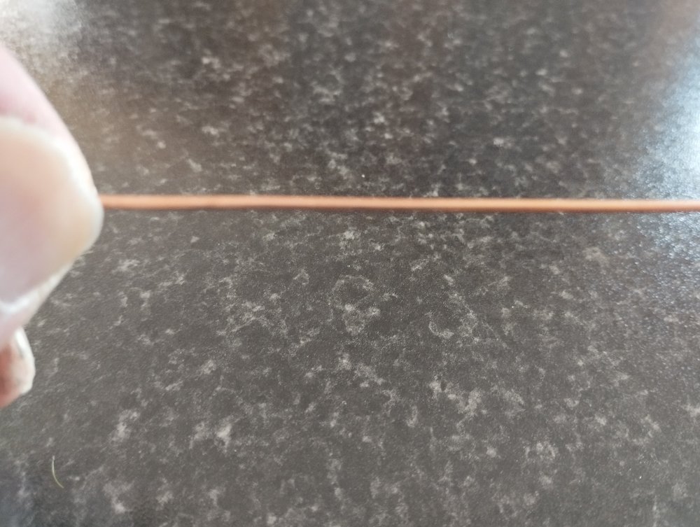

derek Posted June 19 Author Posted June 19 A little more progress on the pens for the cattle dock Posts were made from 3mm x 3mm mahogany, and drilled out individually (some dose). Railings or bars were made from copper wire stripped from electric cable. Some weathering next and then gates. Getting there slowly........... 9 1

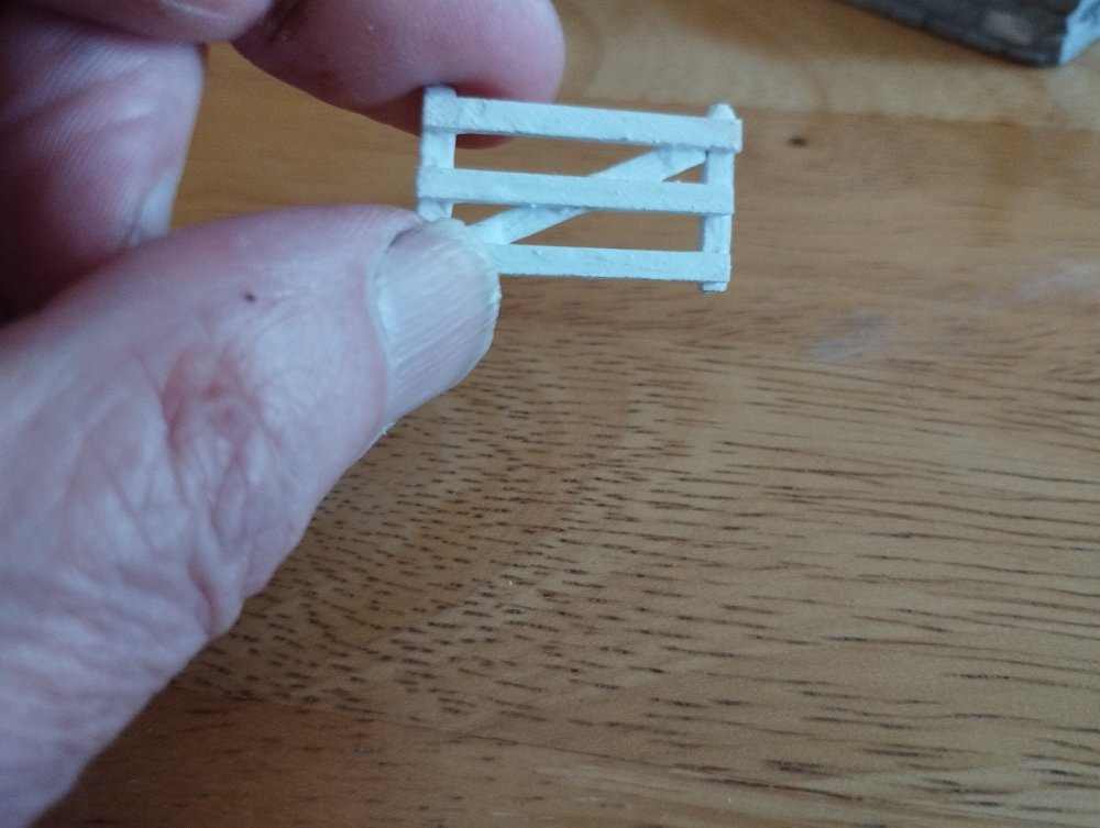

derek Posted July 8 Author Posted July 8 A little more progress......... And a dozen of these fellows...... 14 1
jhb171achill Posted July 9 Posted July 9 1 hour ago, Patrick Davey said: Looks first class! Cattle class, surely? 1 2
