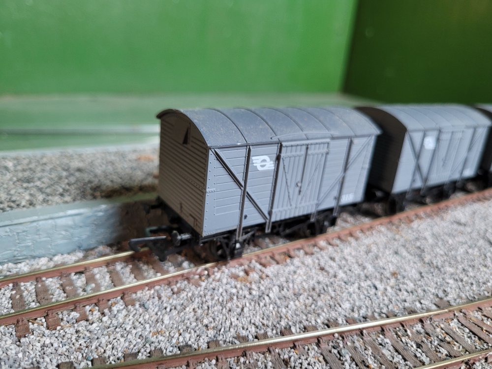

Noel Posted September 19, 2023 Posted September 19, 2023 They more than pass the 2ft rule for me. These unpainted dapol wagons are the mainstay of my CIE era layout along with repainted assorted Bachmann BR big 4 vans vans. Even got a flying snail in there. Kadee draft gear box couplings help with closer coupling and reliable uncoupling when shunting formations. I think the main difference is Irish wagons didn't have corrugated ends. 12 1
DJ Dangerous Posted September 19, 2023 Posted September 19, 2023 3 hours ago, Noel said: They more than pass the 2ft rule for me. These unpainted dapol wagons are the mainstay of my CIE era layout along with repainted assorted Bachmann BR big 4 vans vans. Even got a flying snail in there. Kadee draft gear box couplings help with closer coupling and reliable uncoupling when shunting formations. I think the main difference is Irish wagons didn't have corrugated ends. That's class! 1
derek Posted September 20, 2023 Posted September 20, 2023 On 19/9/2023 at 9:51 AM, Noel said: They more than pass the 2ft rule for me. These unpainted dapol wagons are the mainstay of my CIE era layout along with repainted assorted Bachmann BR big 4 vans vans. Even got a flying snail in there. Kadee draft gear box couplings help with closer coupling and reliable uncoupling when shunting formations. I think the main difference is Irish wagons didn't have corrugated ends. Beautiful wagons Noel
