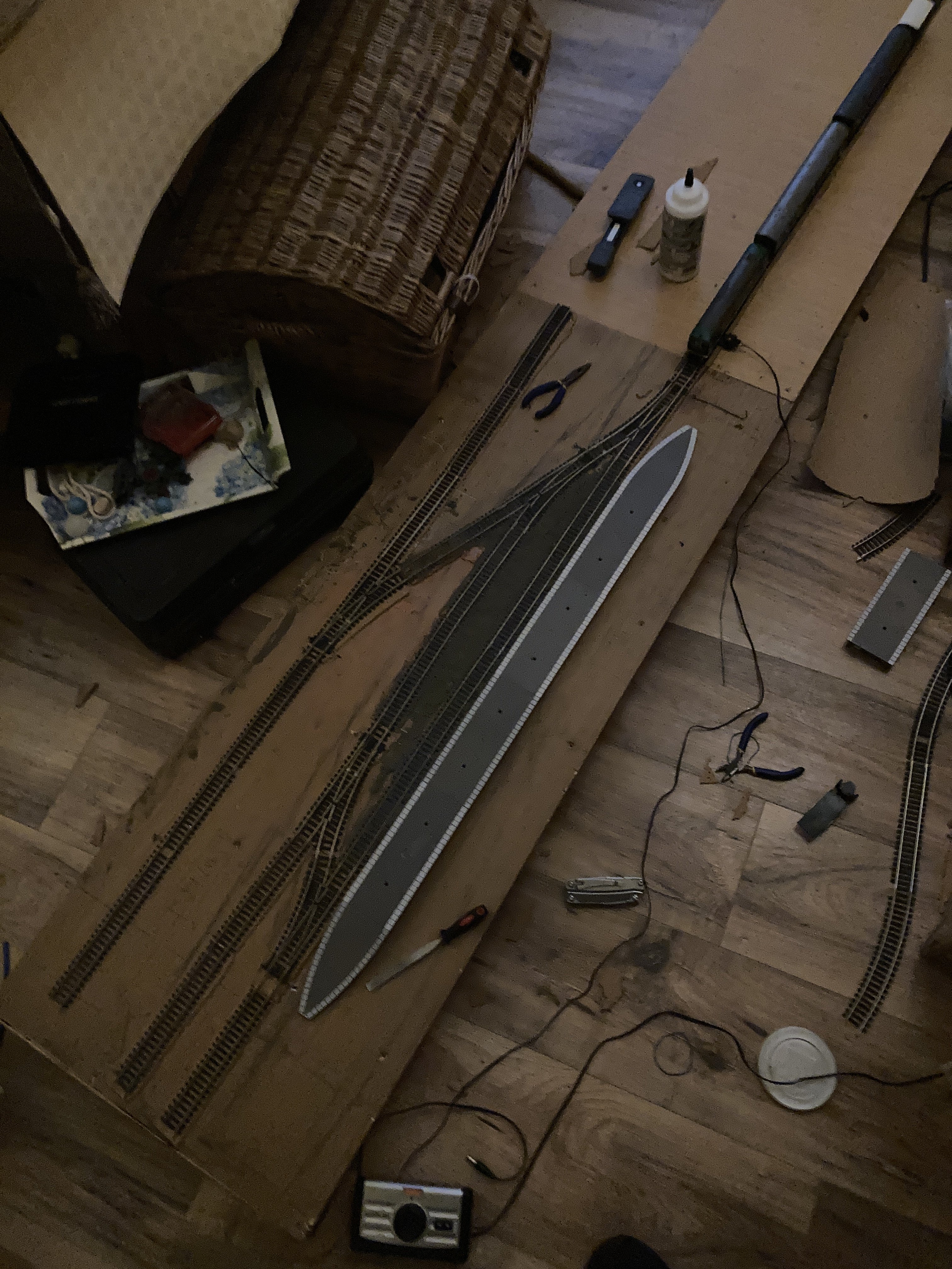

LNERW1 Posted April 29 Author Posted April 29 Progress report. Just a quick one really. The railway room has been rescued from a suffocating layer of random debris and Ardree Quay has risen. No work has actually been done but the next project is to improve the track- soldering the track joints, painting rail sides, completing ballasting and re-doing the inset rails and quay surface in DAS clay. This is a fairly defined and straightforward task, and can be done with materials and tools I already have to hand, so hopefully I can do a little bit of this in the coming weeks, maybe as a way to decompress after school. 4

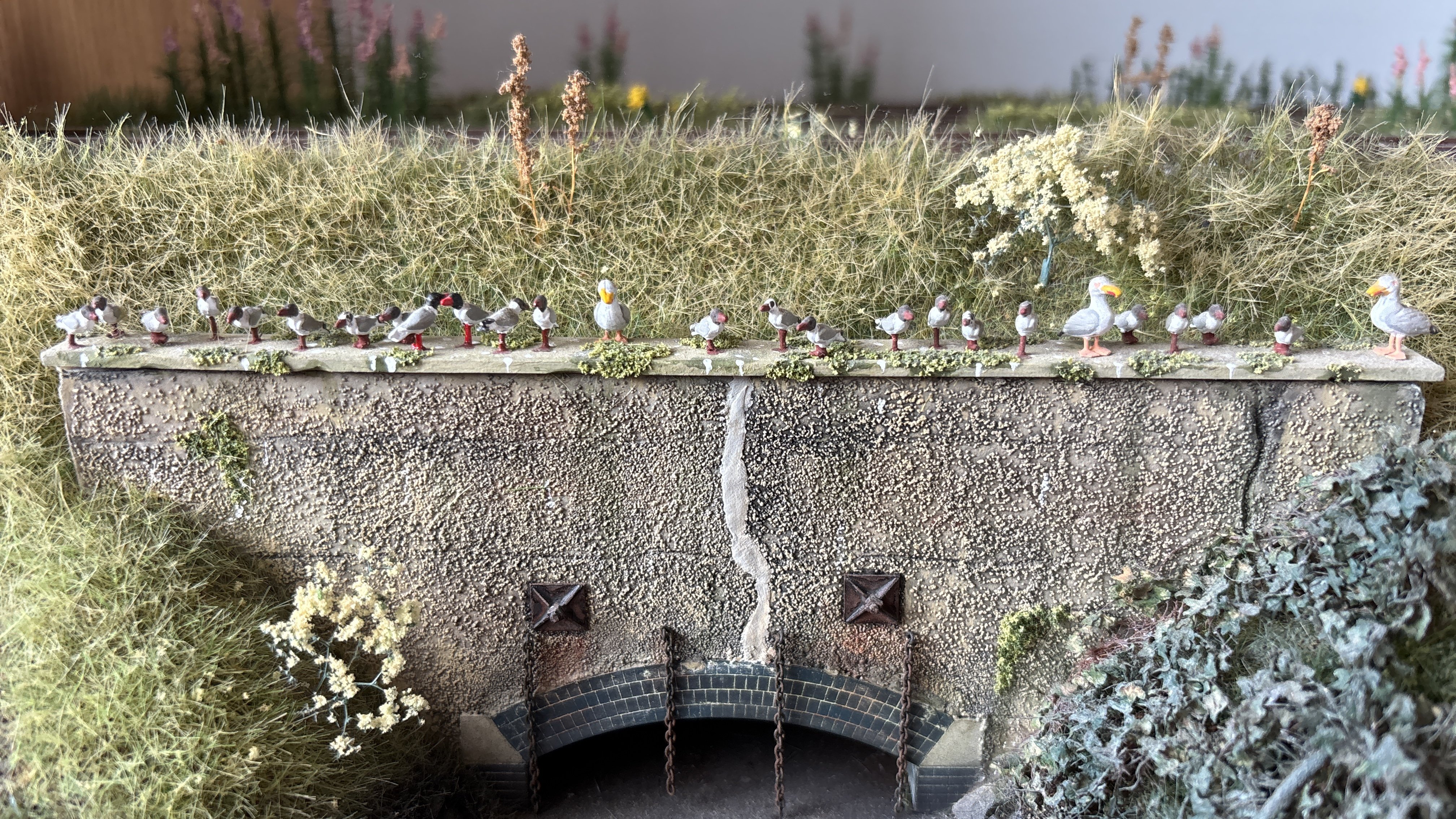

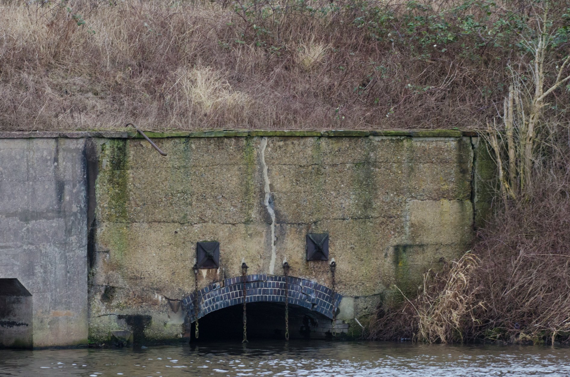

Mol_PMB Posted May 4 Posted May 4 On 1/5/2025 at 8:59 PM, LNERW1 said: When I woke up this morning, I liked birds. They are impressive creatures and make a lovely sound in the morning, and had never done anything to get on my bad side. A few minutes ago, I was sitting at a table in my back garden, soldering together the track pieces that made up the goods shed road. I was getting a little bit frustrated. I had only managed to solder 6 track joints, they were all messy and only 3 were holding. It was becoming apparent that I didn't know what I was doing. However, I was still enjoying it and was listening to a good podcast, so I decided to keep going. I was about to touch the tip of the soldering iron to the solder when a sound emanated from a spot about two inches from my hand. It was a mixture between a plop and a splat and came, more precisely, from the area between the loop and shed road I today scraped clean of clay. I looked up and saw a yellow-white sludge with a few black-brown nuclei sitting smack bang in the middle of my layout. I no longer like birds. Ah, realistic weathering, if a bit over-scale! On my O gauge layout based on the Manchester Ship Canal, I carefully added the seagull droppings below their perch: 9
LNERW1 Posted May 4 Author Posted May 4 Given I’m modelling a seaside location that would probably be a nice detail. Is it just a trickle of paint? Frankly if I was doing it more than likely I’d just use Tipp-ex.
Mol_PMB Posted May 4 Posted May 4 9 minutes ago, LNERW1 said: Given I’m modelling a seaside location that would probably be a nice detail. Is it just a trickle of paint? Frankly if I was doing it more than likely I’d just use Tipp-ex. Yes, little trickles of white paint on the coping stones and a few streaks on the front wall. They would need to be very fine in 4mm scale though, a very fine brush would be needed. I have five different species of gull on my Ship Canal layout and the row of dozens of them is quite prototypical for the present day but probably a bit excessive for the 1960s period I'm modelling, as there was more pollution back then. I enjoyed adding them to the layout though, and they help to set the canalside scene because I only have room for a tiny bit of water on the front of the layout. The bigger birds are sold for 7mm scale and are about the right size for large gulls (e.g. Herring Gull, Black Backed Gulls) but for the smaller gulls (e.g. Black Headed Gull, Mediterranean Gull) I used 4mm scale gulls. This is probably way more information than you wanted! I do like birds... 1
LNERW1 Posted May 4 Author Posted May 4 34 minutes ago, Mol_PMB said: Yes, little trickles of white paint on the coping stones and a few streaks on the front wall. They would need to be very fine in 4mm scale though, a very fine brush would be needed. I have five different species of gull on my Ship Canal layout and the row of dozens of them is quite prototypical for the present day but probably a bit excessive for the 1960s period I'm modelling, as there was more pollution back then. I enjoyed adding them to the layout though, and they help to set the canalside scene because I only have room for a tiny bit of water on the front of the layout. The bigger birds are sold for 7mm scale and are about the right size for large gulls (e.g. Herring Gull, Black Backed Gulls) but for the smaller gulls (e.g. Black Headed Gull, Mediterranean Gull) I used 4mm scale gulls. This is probably way more information than you wanted! I do like birds... This forum is basically solely info dumping so your explanations of gull species are very much welcome. I do find birds in general interesting, despite having only a very basic knowledge of them. And when they're not using my layout/soldering area as a public toilet I must admit I don't have much against them.

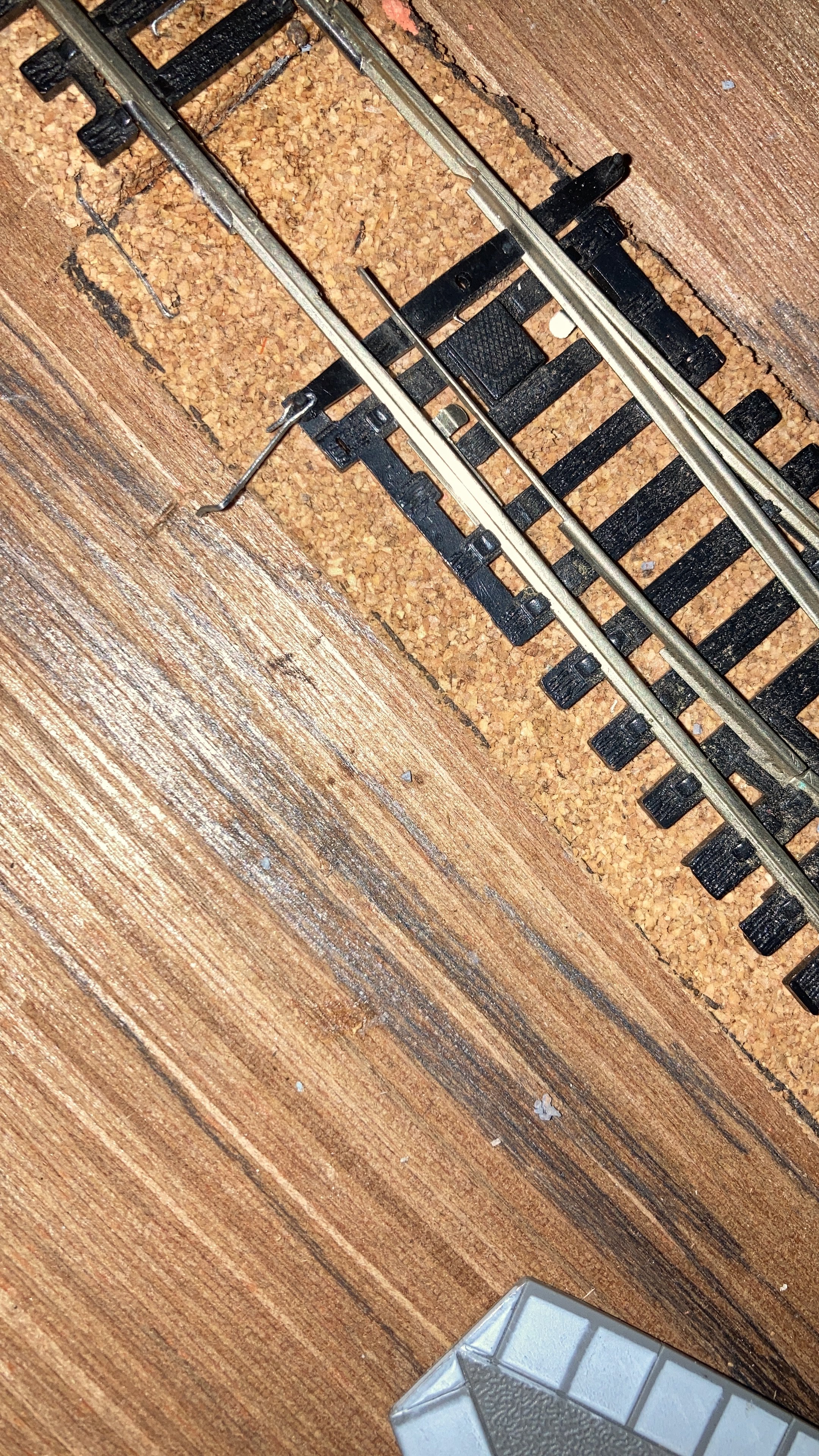

LNERW1 Posted September 29 Author Posted September 29 Ladies and gentlemen we are back! Ardree Quay has finally returned from the shed! In the short time I’ve had it back I’ve initiated possibly my worst decision so far- wire-in-tube point control. As you can see here I’ve twisted staples into shape to act as arms throwing the stretcher bar back and forth. Now, this one is quite rough- which is why it’s already been replaced with a tighter arm that will push and pull. I plan on creating small slots for the vertical arm to go through, connecting with thicker wire below, which will in turn be connected to some sort of switch to push and pull. This should allow for point control not requiring the intervention of the Hand of God. I’ve also been testing how stock runs over a track joint with a little too much solder on the inside of the rail. Between these two videos I filed it down a good bit but it’s still not perfect. IMG_1413.mov IMG_1414.mov So, not huge progress but my activity at the weekend’s Dunshaughlin show has given me a huge motivation boost and I really want to get some stuff done before it dries up. Hopefully one or two people are happy at the return. 4

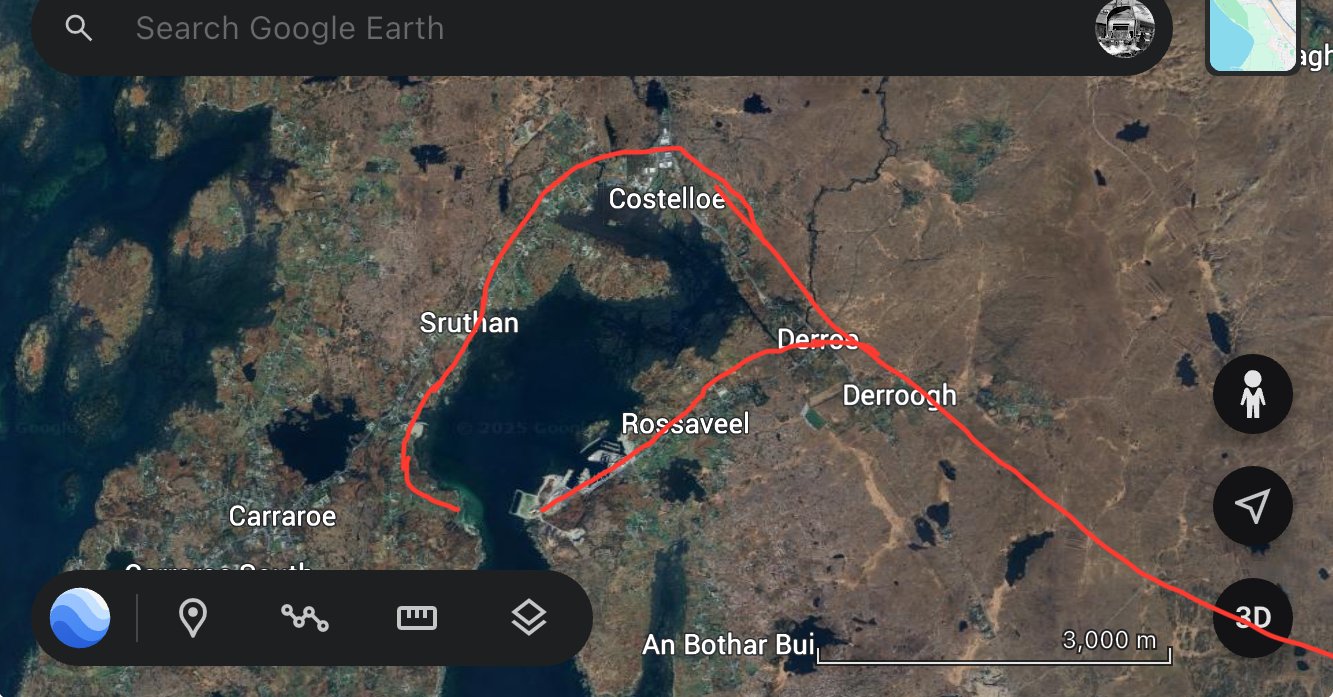

LNERW1 Posted September 30 Author Posted September 30 (edited) And you know what, a bit more content. Here’s a rough map of the area of Ardree Harbour (in real life Rossaveel). At the location of Derrough I have Ardree Town station. Until 1926 this was the junction for the Ardree Tramway heading round the west side of the bay to the old quay. This went slowly out of use for ferry services until only fish remained, and the branch closed to passengers in 1926. However it remained open for fish traffic until 1942. At the location of Rossaveel harbour is, in my universe, Ardree Quay, port for ferry services to the Aran Islands and Sheehaunmore, and port for many Atlantic trawlers. I think I’ve outlined pretty well the history here, but the area you can see in grey is roughly the area modelled. Edit: forgot to mention the siding at Costelloe is the tramway engine shed, later used as a shop for minor maintenance. The tramway this far remained until 1956. Edited September 30 by LNERW1 5
LNERW1 Posted October 2 Author Posted October 2 (edited) I appear to have gotten the points done quicker than I expected- out sick today so I decided to have at it and ended up with all 4 points wired up (wire in tube that is) and the second board with track laid. So, how did I bodge the “wire-in-tube” system, possibly one or two people are asking? Well, I did it with garden wire, staples and two pairs of pliers. It’s dodgy and bodgy and needs to be operated carefully otherwise the wire will get caught in the slot I dremelled through the board, or the staple ( connecting the wire and the stud on the outside of the stretcher bar) will bend or snap or come off, but I did it! And once I have the hang of it it all works really nicely, and as far as I can tell carries power. I cannot tell you how proud I am of this! But an update on mechanics is not complete without photos and videos, so here’s a few. First, all the points operating (you can see better here the wire-and-staple mechanism): eca0f00e-1c55-46cb-80aa-779004477db7.mov Some of the over-centre springs have been damaged or gummed up by my careless ballasting so there is some force needed on one or two points! Here’s a view of the wires going back and forth underneath: 8c07d3a9-bbdd-4819-9f9c-d9b2419e13a9.mov (Pretty poor quality but I was using my other hand to operate the levers) And a picture of the underside: If you squint you can see the wires! You’ll notice the point at the station throat is operated with a wire on top of the board; this will be hidden under a large bridge so I went for the easier option of having it on top. Anyway, I hope you enjoyed my brief lesson on how not to do point control, and look forward to me learning that the hard way. Happy modelling! Edited October 2 by LNERW1 6
Metrovik Posted October 2 Posted October 2 Well Done! Turned out great! Love some budget modelling! 1
Tullygrainey Posted October 2 Posted October 2 48 minutes ago, LNERW1 said: I appear to have gotten the points done quicker than I expected- out sick today so I decided to have at it and ended up with all 4 points wired up (wire in tube that is) and the second board with track laid. So, how did I bodge the “wire-in-tube” system, possibly one or two people are asking? Well, I did it with garden wire, staples and two pairs of pliers. It’s dodgy and bodgy and needs to be operated carefully otherwise the wire will get caught in the slot I dremelled through the board, or the staple ( connecting the wire and the stud on the outside of the stretcher bar) will bend or snap or come off, but I did it! And once I have the hang of it it all works really nicely, and as far as I can tell carries power. I cannot tell you how proud I am of this! But an update on mechanics is not complete without photos and videos, so here’s a few. First, all the points operating (you can see better here the wire-and-staple mechanism): eca0f00e-1c55-46cb-80aa-779004477db7.mov 4.76 MB · 1 download Some of the over-centre springs have been damaged or gummed up by my careless ballasting so there is some force needed on one or two points! Here’s a view of the wires going back and forth underneath: 8c07d3a9-bbdd-4819-9f9c-d9b2419e13a9.mov 2.37 MB · 0 downloads (Pretty poor quality but I was using my other hand to operate the levers) And a picture of the underside: If you squint you can see the wires! You’ll notice the point at the station throat is operated with a wire on top of the board; this will be hidden under a large bridge so I went for the easier option of having it on top. Anyway, I hope you enjoyed my brief lesson on how not to do point control, and look forward to me learning that the hard way. Happy modelling! Innovation and improvisation. Name of the game. And if it works, it ain’t wrong.

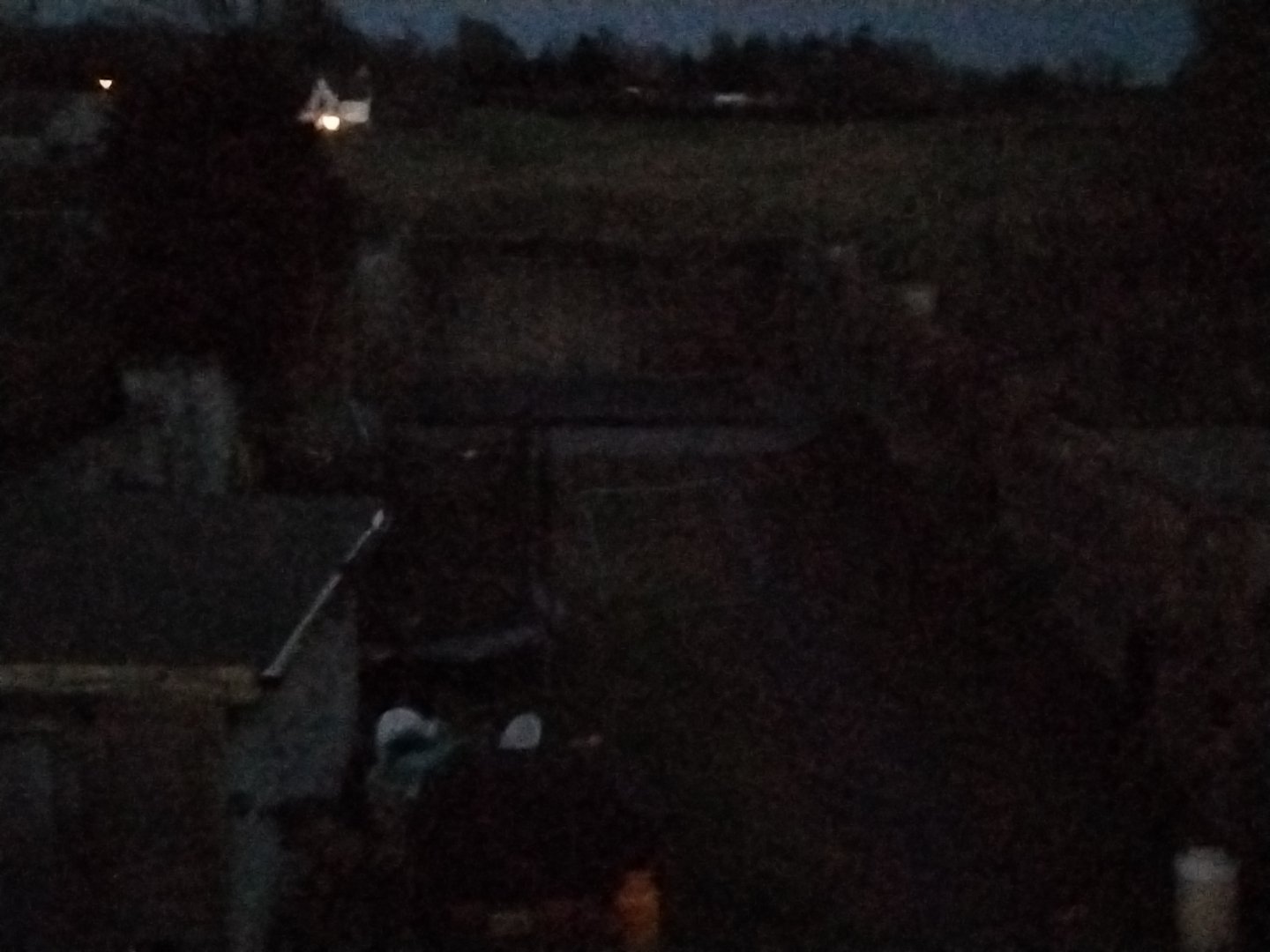

LNERW1 Posted November 13 Author Posted November 13 Something big due next Wednesday... (Shit photo for dramatical effect and mysteriosity) 2 1
DJ Dangerous Posted 5 hours ago Posted 5 hours ago On 13/11/2025 at 5:16 PM, LNERW1 said: Something big due next Wednesday... (Shit photo for dramatical effect and mysteriosity) Dun dun duuuunnnnnnnnn!
