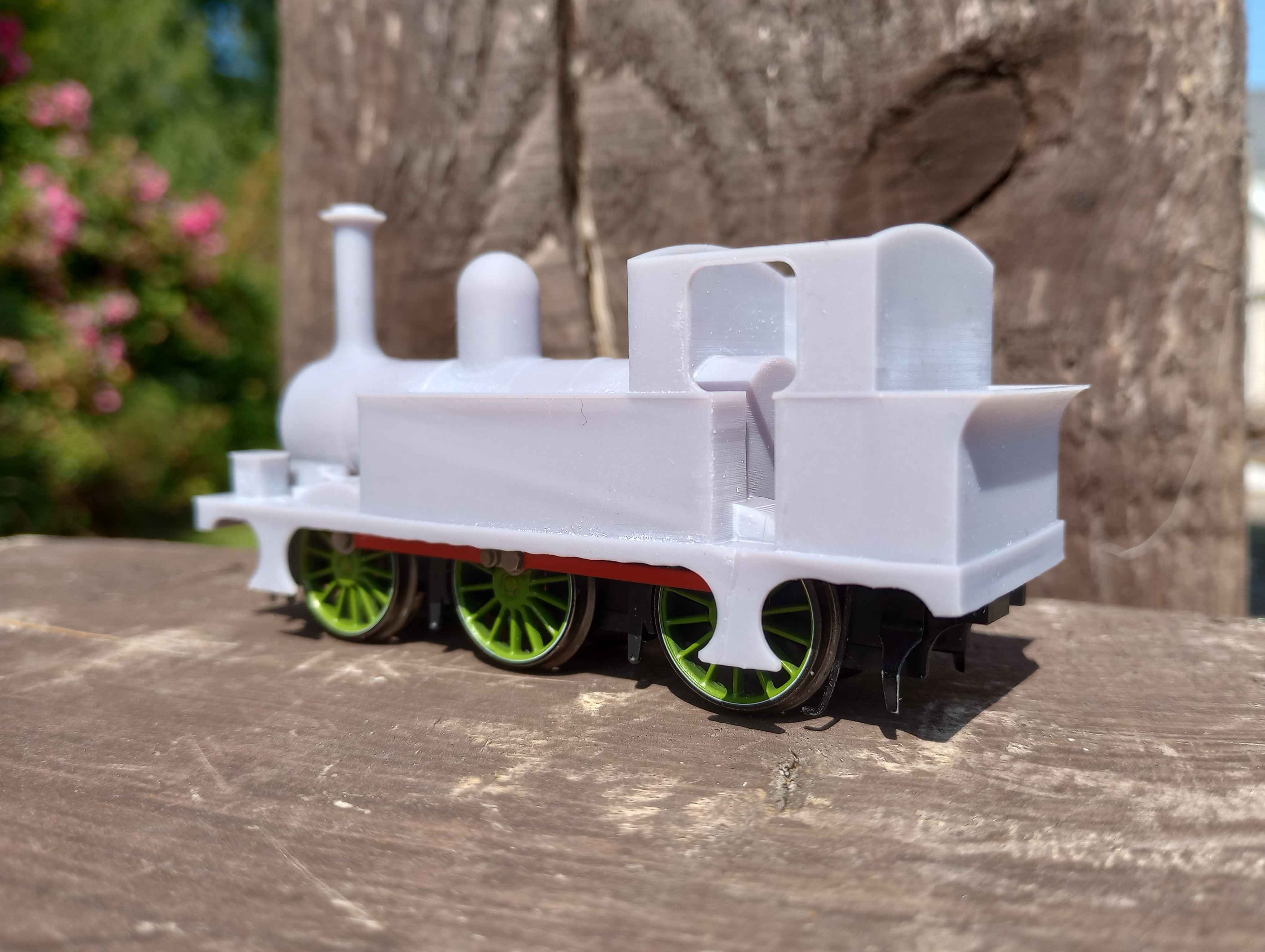

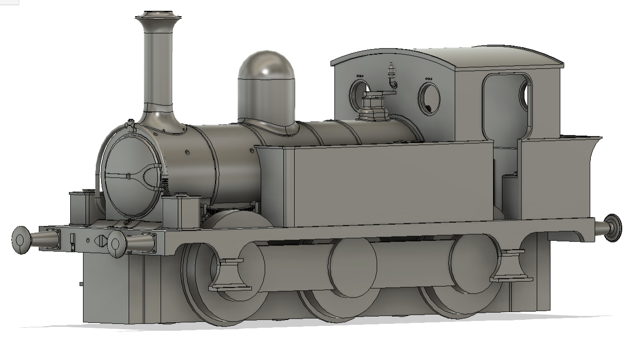

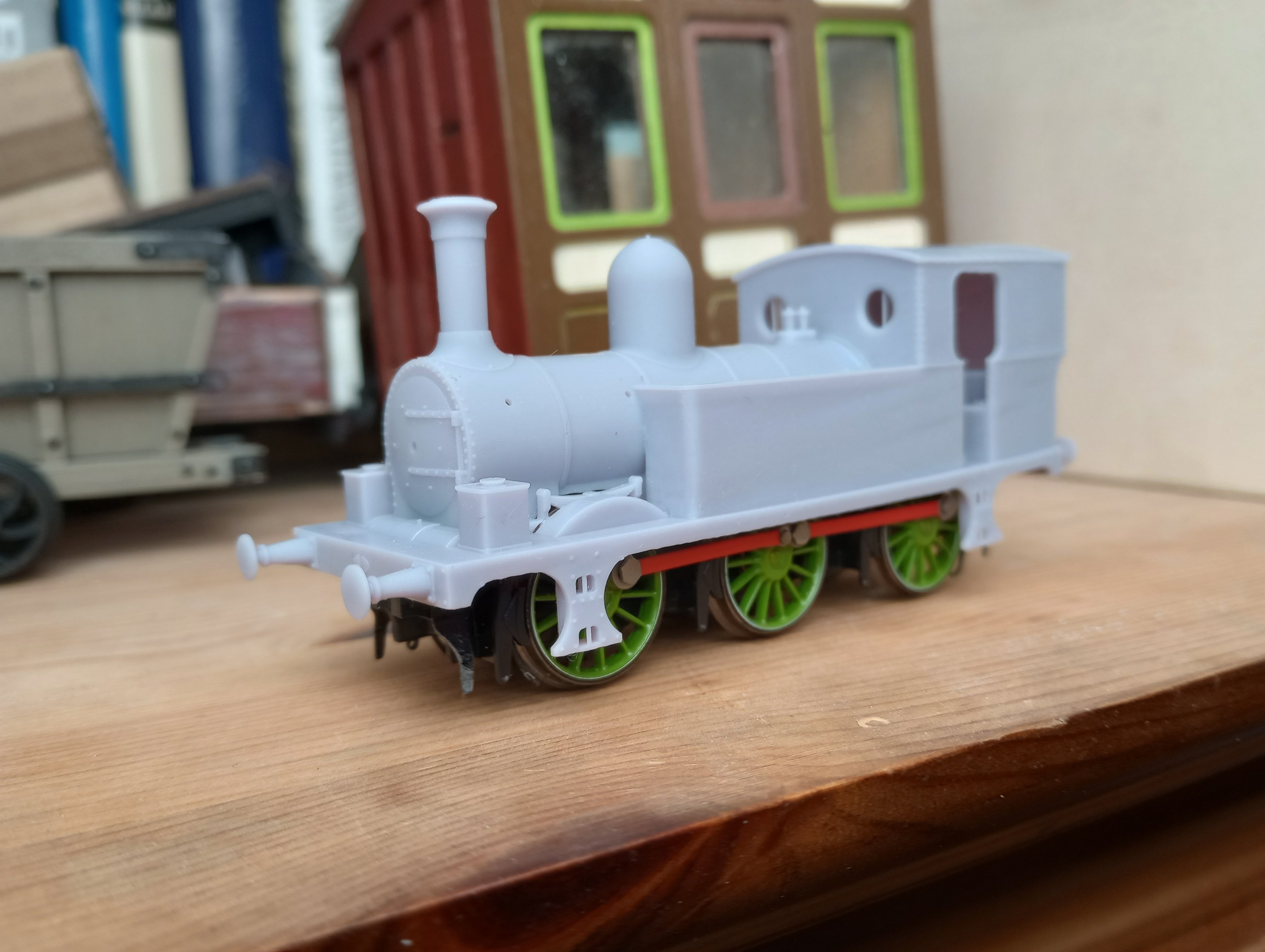

Killian Keane Posted July 17 Author Posted July 17 validation print carried out and it fits the chassis, now to get on and finish the detail 13 1 1
GSR 800 Posted July 17 Posted July 17 (edited) 6 minutes ago, Killian Keane said: validation print carried out and it fits the chassis, now to get on and finish the detail Oh yes she's looking very handsome indeed! Edited July 17 by GSR 800 1

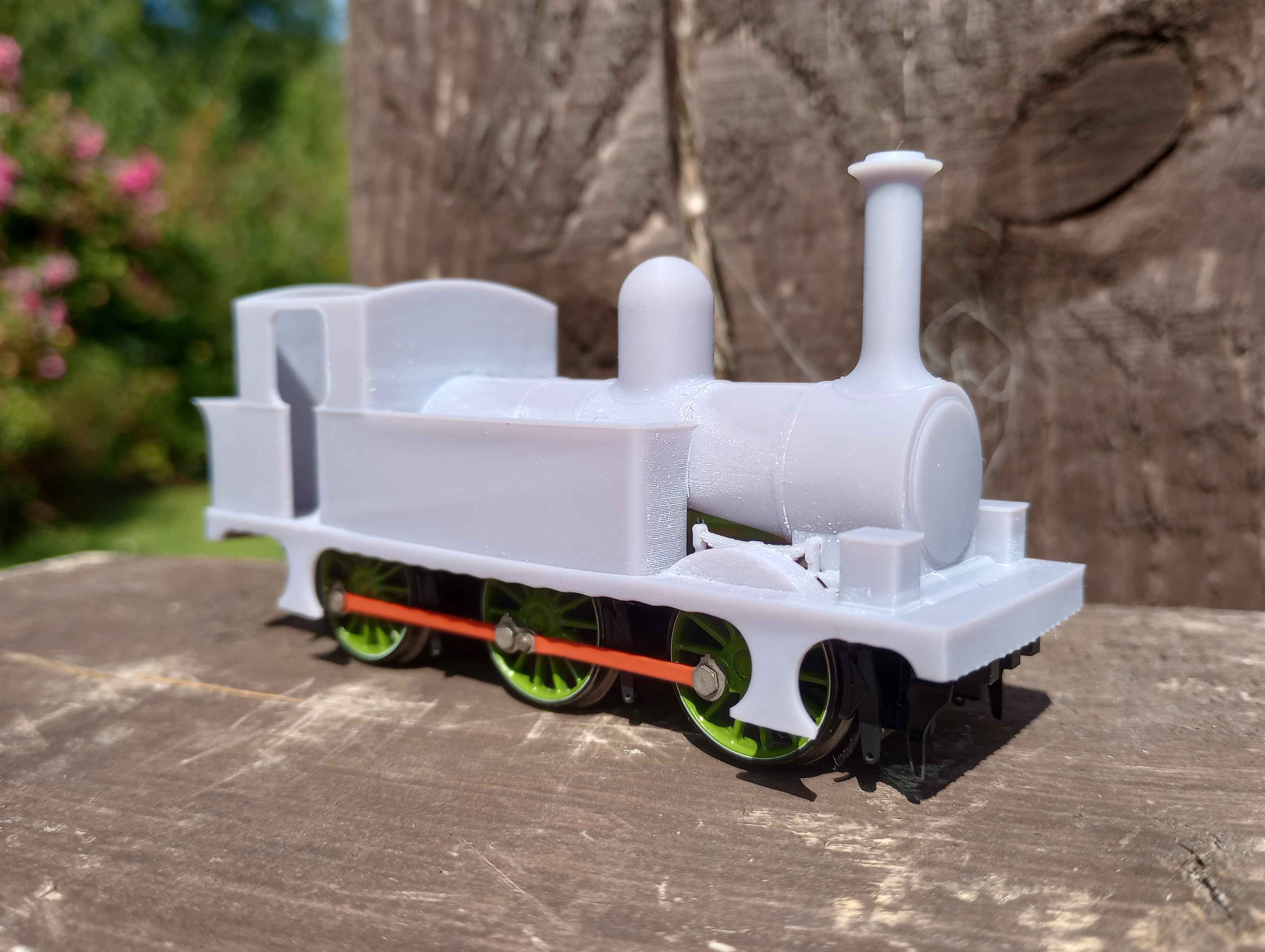

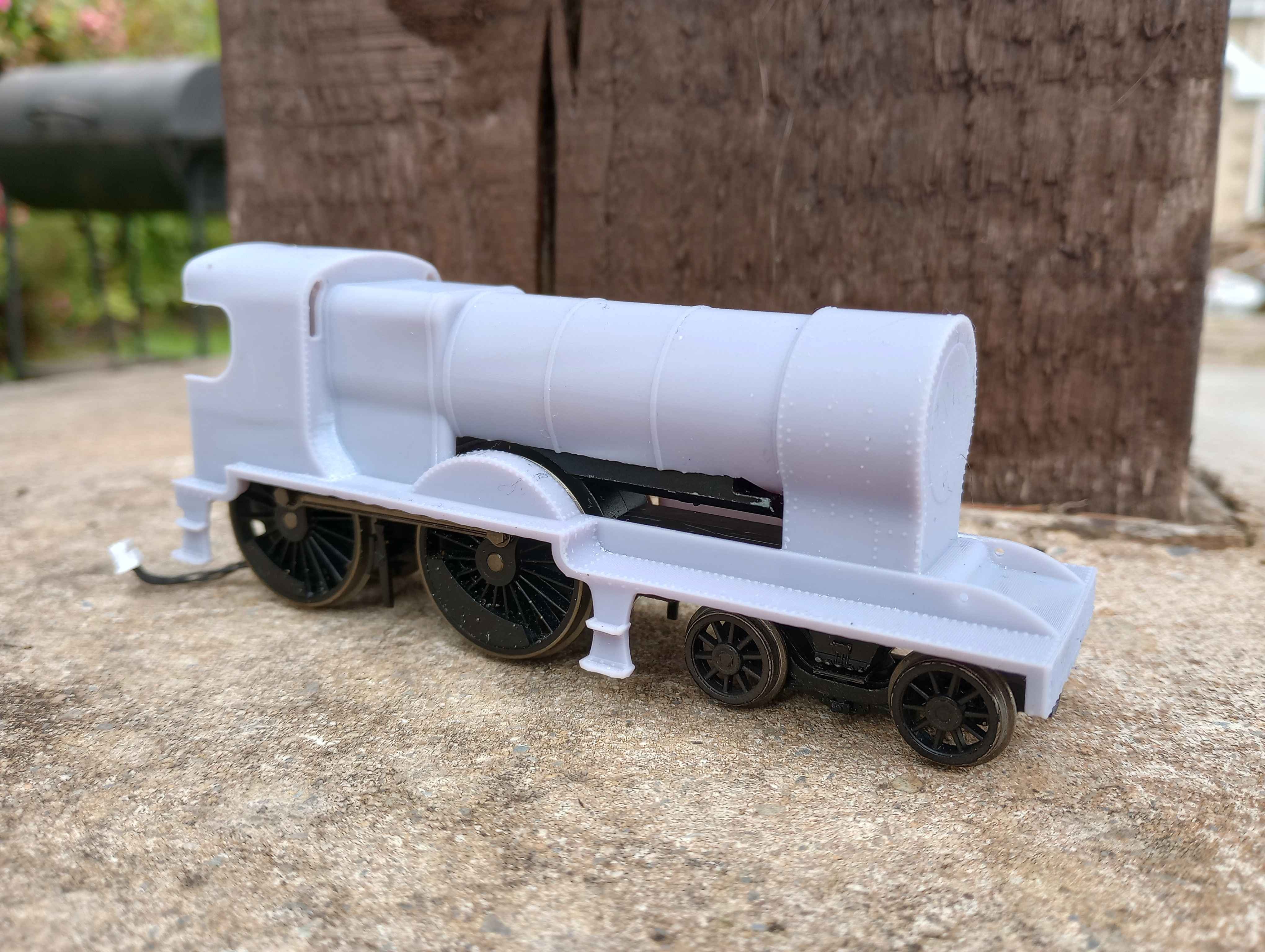

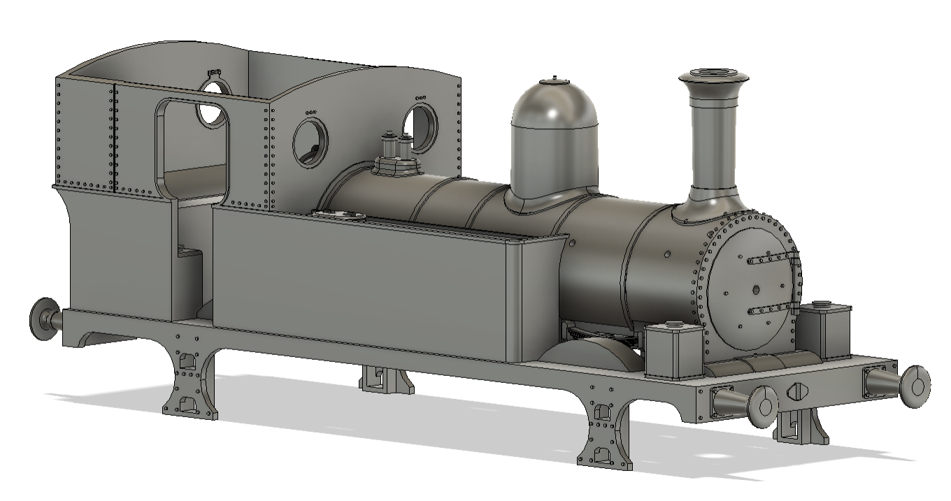

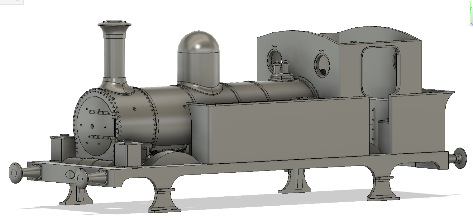

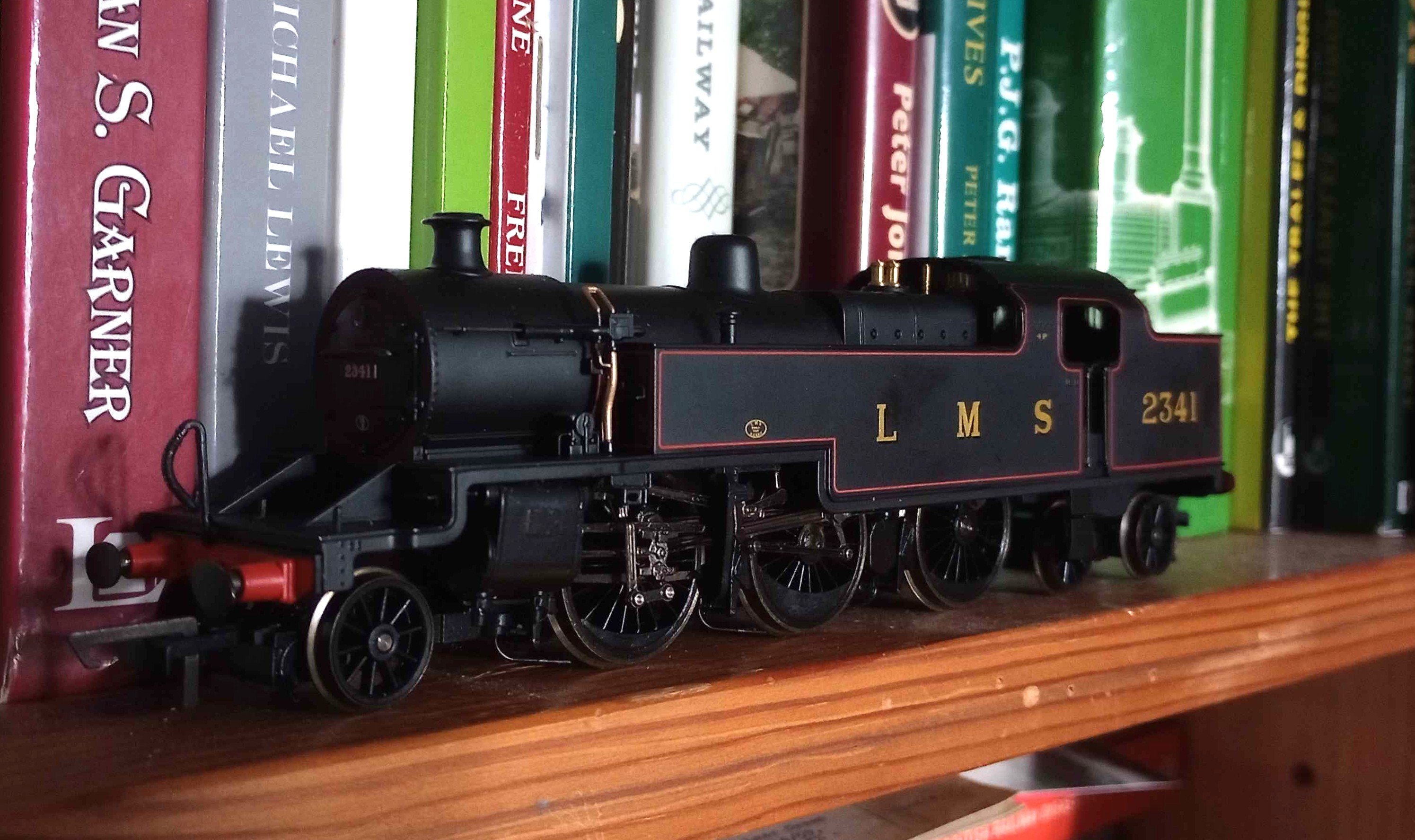

Killian Keane Posted July 25 Author Posted July 25 Hot on the heels of the E, the A is ready for its validation print 4
GSR 800 Posted July 25 Posted July 25 1 minute ago, Killian Keane said: Hot on the heels of the E, the A is ready for its validation print Bravo Killian, take a bow! How very handsome she looks! 2 1
Killian Keane Posted July 27 Author Posted July 27 A class Validation print successful, both MGWR locos now entering the final stages before proper production 14 1

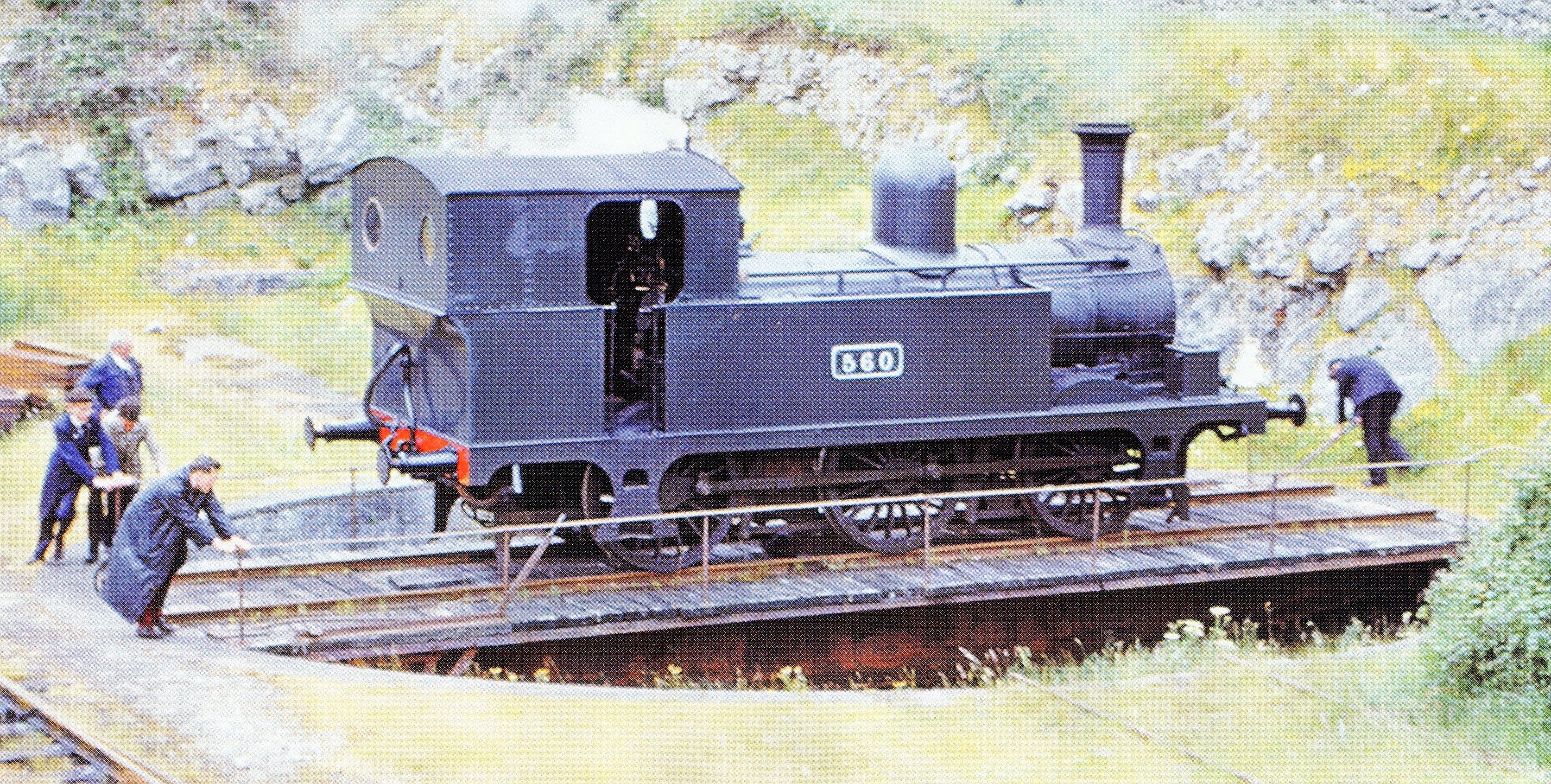

Killian Keane Posted July 27 Author Posted July 27 Its a big ask I know but would anyone have photos of the cab interior of the MGWR E/J26? I cant for the life of me establish whether they were screw or lever reverse and which side that was mounted on etc etc
GSR 800 Posted July 27 Posted July 27 5 minutes ago, Killian Keane said: Its a big ask I know but would anyone have photos of the cab interior of the MGWR E/J26? I cant for the life of me establish whether they were screw or lever reverse and which side that was mounted on etc etc had a 'solid reversing wheel' according to a Decade of Steam, along with a 'butterfly regulator' and the somewhat infamous (to GS men anyway) letterbox firehole door. Â 1 1
GSR 800 Posted July 27 Posted July 27 not brilliant but shows some of the backhead detail https://www.flickr.com/photos/irishrailwayarchive/53509091889/in/photolist-2pZhkzL-2qEc2KN-2pwDm6y-2pwq5MP-2pwiTJB-2pwDQTy-2pwDQTt https://www.flickr.com/photos/irishrailwayarchive/53510472622/in/photolist-2pqQxgM-2qUTuzP-2pwjBQF-2pwfAqs-2qUUdW9-2qUTecq-2qUTdXn-2qUUdWe-2qUTuNE-2pwDXuL-2pwiTHu-2pwxaey-2pwiTJG-2pwEwFR-2pvFPEL is the driver operating the wheel there by the looks of it?? 1

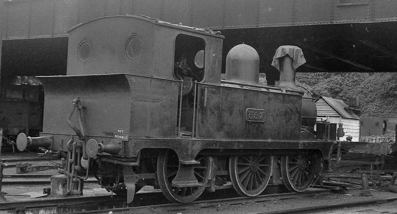

jhb171achill Posted July 28 Posted July 28 (edited) 10 hours ago, Mol_PMB said: Hope these help. Good to see the grey colour on 560 clean for once! Edited July 28 by jhb171achill 1
Horsetan Posted July 29 Posted July 29 On 28/7/2026 at 6:42 AM, Mol_PMB said: Â Â That's a view of 560 I hadn't seen before. Very useful. Also I thought the photo showed the engine as black but, when I looked closely, it was actually a very very very very very very very dark grey. 2

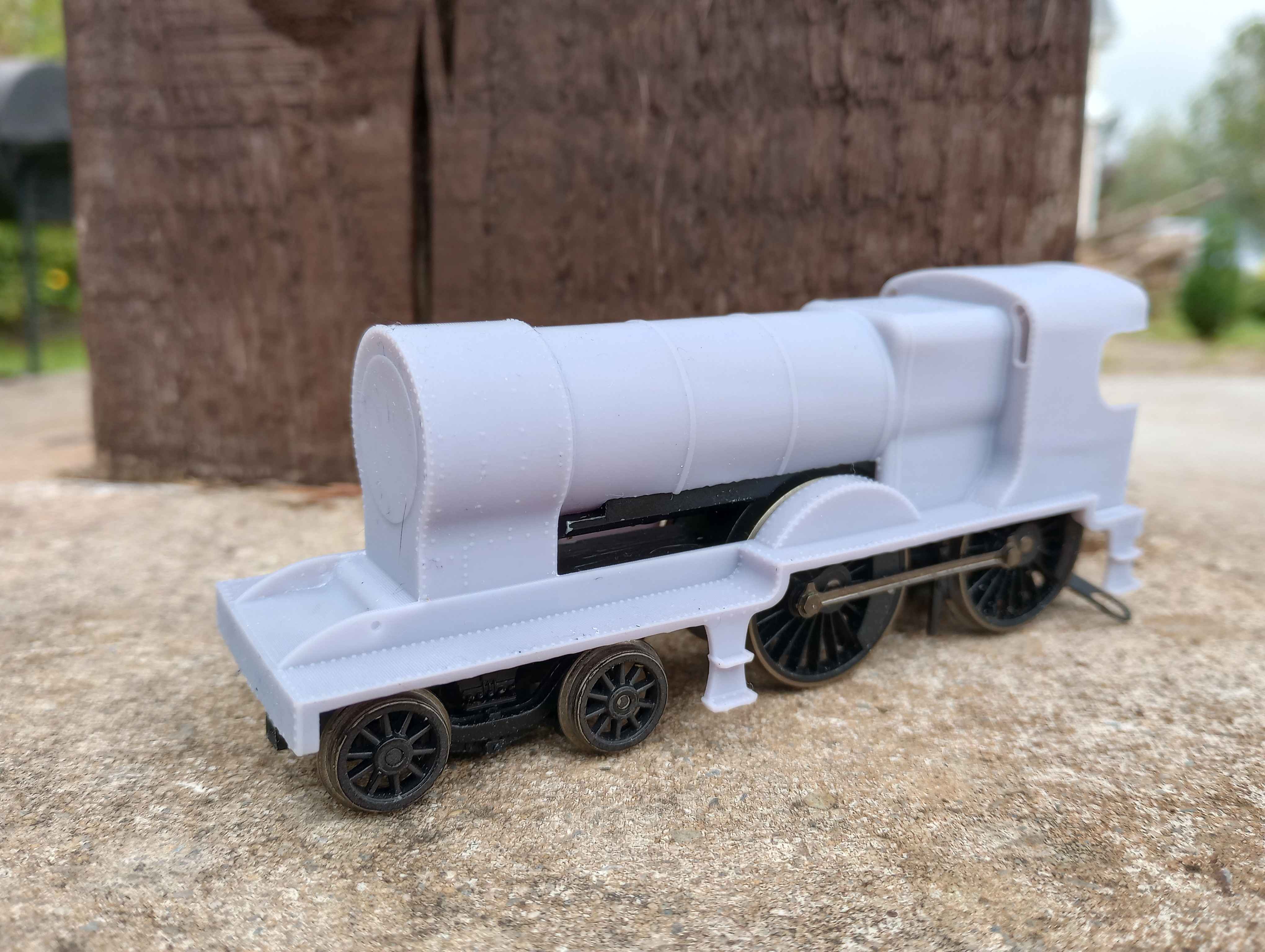

DoctorPan Posted July 29 Posted July 29 Looks very promising and I would be eager for some of these prints. Just curious, what's the donor chassis for the A?
GSR 800 Posted July 29 Posted July 29 15 minutes ago, DoctorPan said: Looks very promising and I would be eager for some of these prints. Just curious, what's the donor chassis for the A? Hornby D16/3 with driving wheels from a Princess Royal 2 2

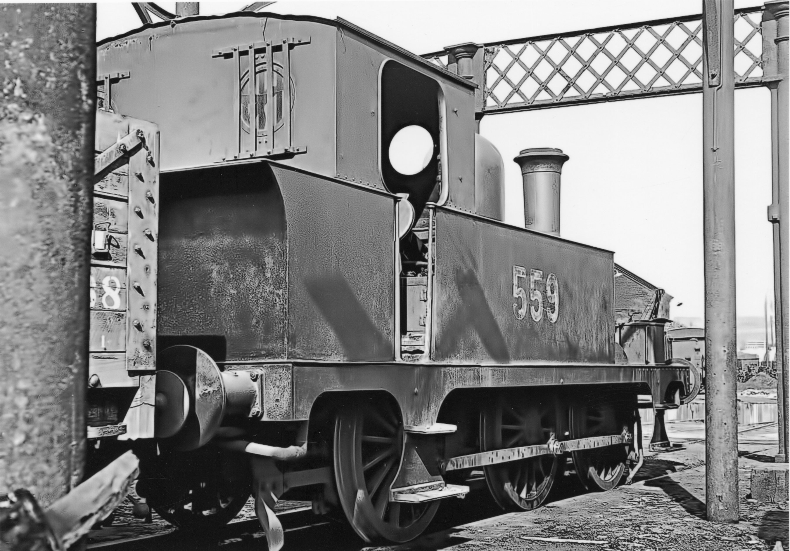

Killian Keane Posted August 19 Author Posted August 19 On 28/7/2026 at 6:42 AM, Mol_PMB said: Hope these help. Many thanks for those, theyll be very useful, one thing Ive just noticed about the photo of 557 is it still has lamp irons on the rear bufferbeam, a hangover from MGWR days, at least one of the Waterford and Tramore examples also appears to have kept them on the rear 1

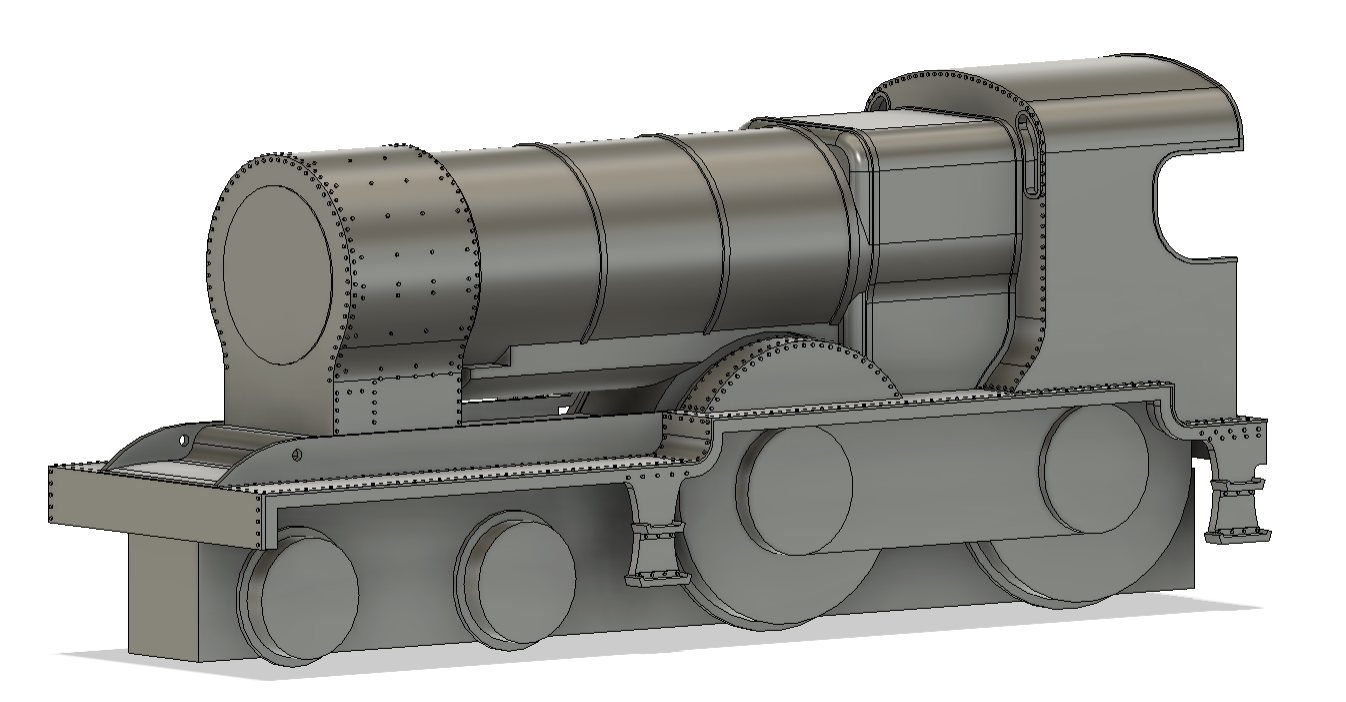

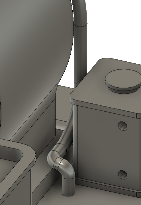

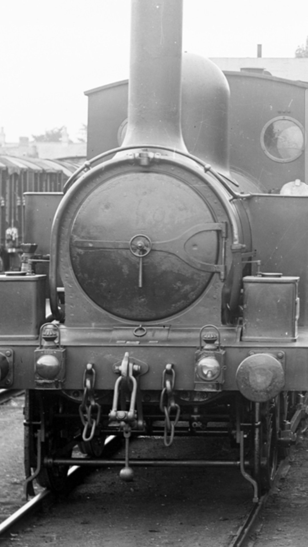

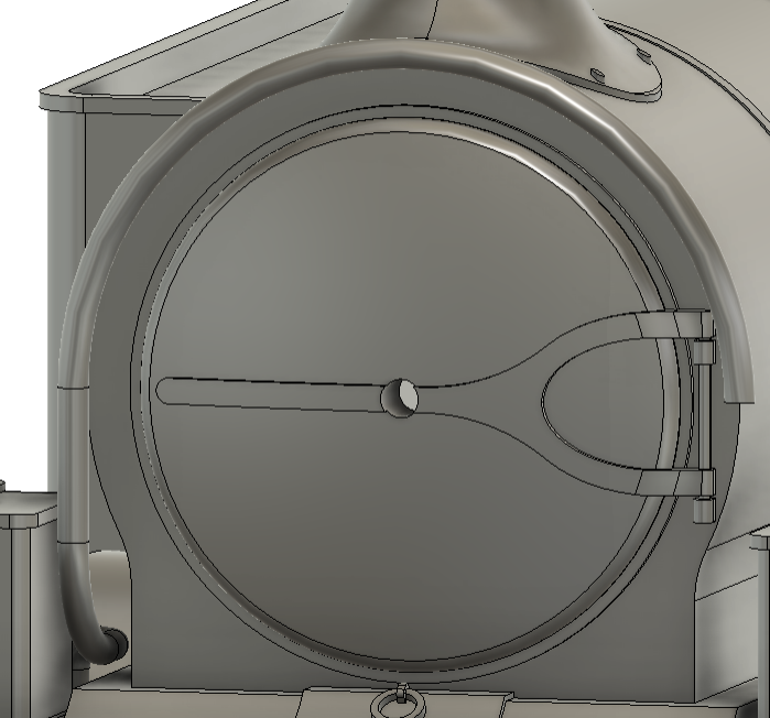

Killian Keane Posted August 20 Author Posted August 20 (edited) Ive started designing the Atock vacuum pipe, and Im debating whether itd be better to just have it as a piece (or two) of brass rod, this isnt supported anywhere other than where it meets the running board and at the apex of the smokebox where it hinges, itd also be very hard to paint (brass?) the way its routed between the sandbox and smokebox. I might have the hinge printed and have a brass rod meet it at each side, we shall see Edited August 20 by Killian Keane 4
GSR 800 Posted August 20 Posted August 20 3 hours ago, Killian Keane said: Ive started designing the Atock vacuum pipe, and Im debating whether itd be better to just have it as a piece (or two) of brass rod, this isnt supported anywhere other than where it meets the running board and at the apex of the smokebox where it hinges, itd also be very hard to paint (brass?) the way its routed between the sandbox and smokebox. I might have the hinge printed and have a brass rod meet it at each side, we shall see Killian, Zooming in on this photo gives probably the highest quality shot one can hope for. You could use the fitting for the brass pipe to the flexible as a support, printed to the smokebox door. There seems to be a kind of metal strap support from the flexi pipe to the tank also? I think the best bet could be printed as separate detail with plugs into the smokebox door? A discussion on the vaccum pipe can be found here  1 1

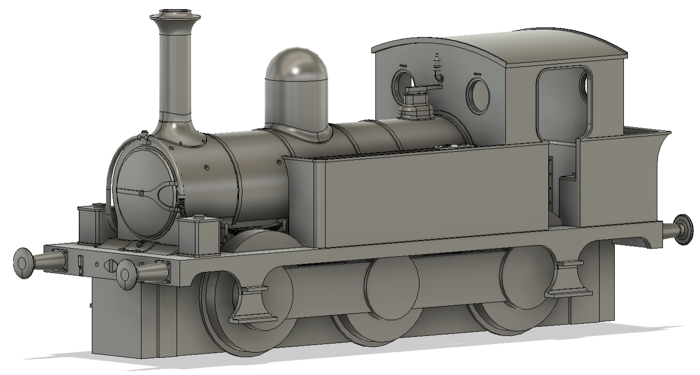

Killian Keane Posted September 17 Author Posted September 17 As-built version of class E almost finished, just to finish off the cab interior, and then its on to the various rebuilds 18 1
GSR 800 Posted September 17 Posted September 17 4 hours ago, Killian Keane said: As-built version of class E almost finished, just to finish off the cab interior, and then its on to the various rebuilds Wonderful! Â 1

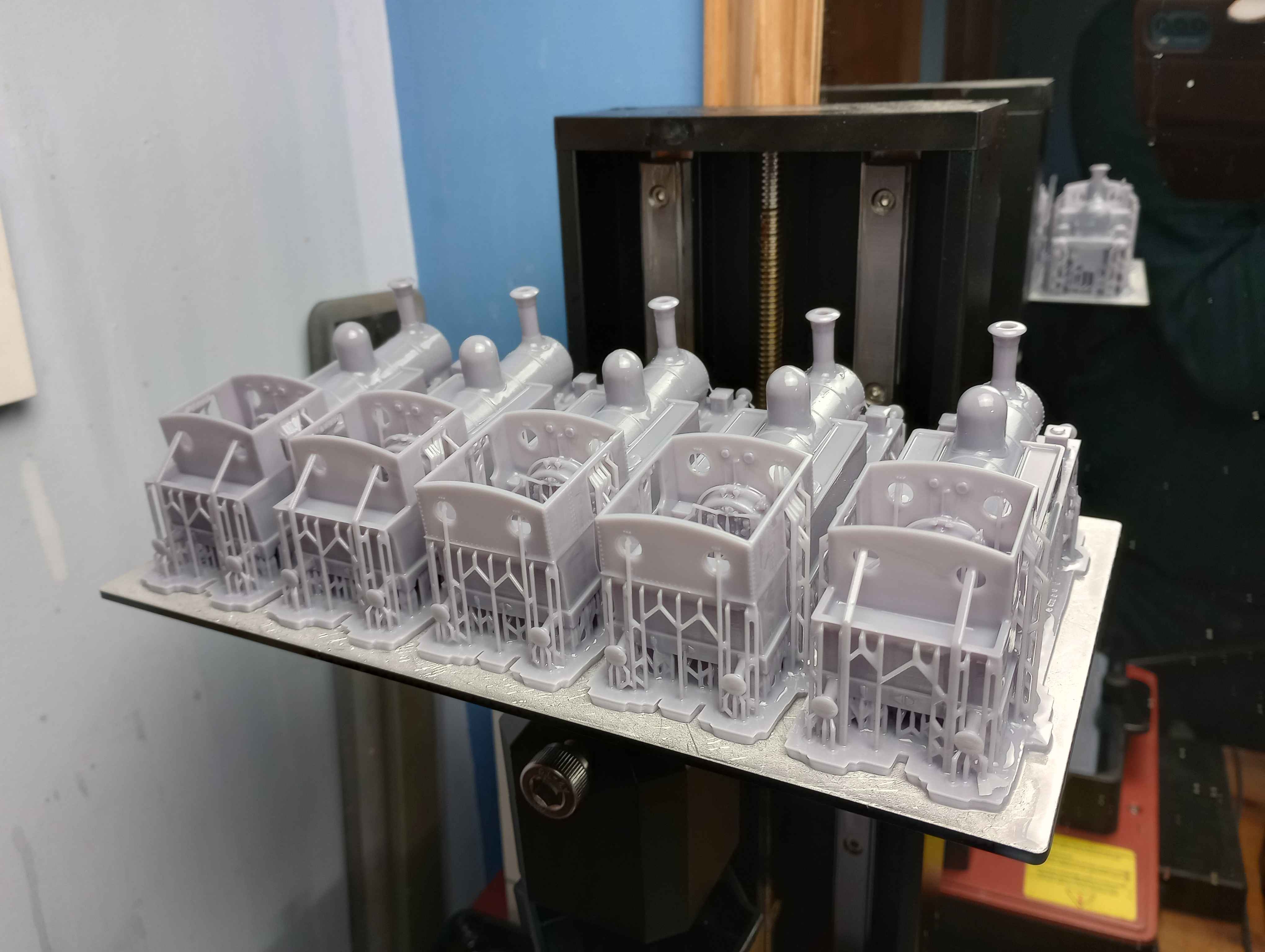

Killian Keane Posted October 5 Author Posted October 5 My latest victim, something uncharacteristically 'modern' 12

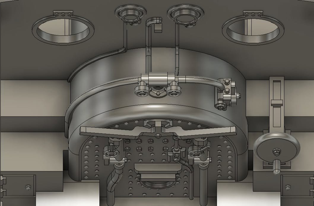

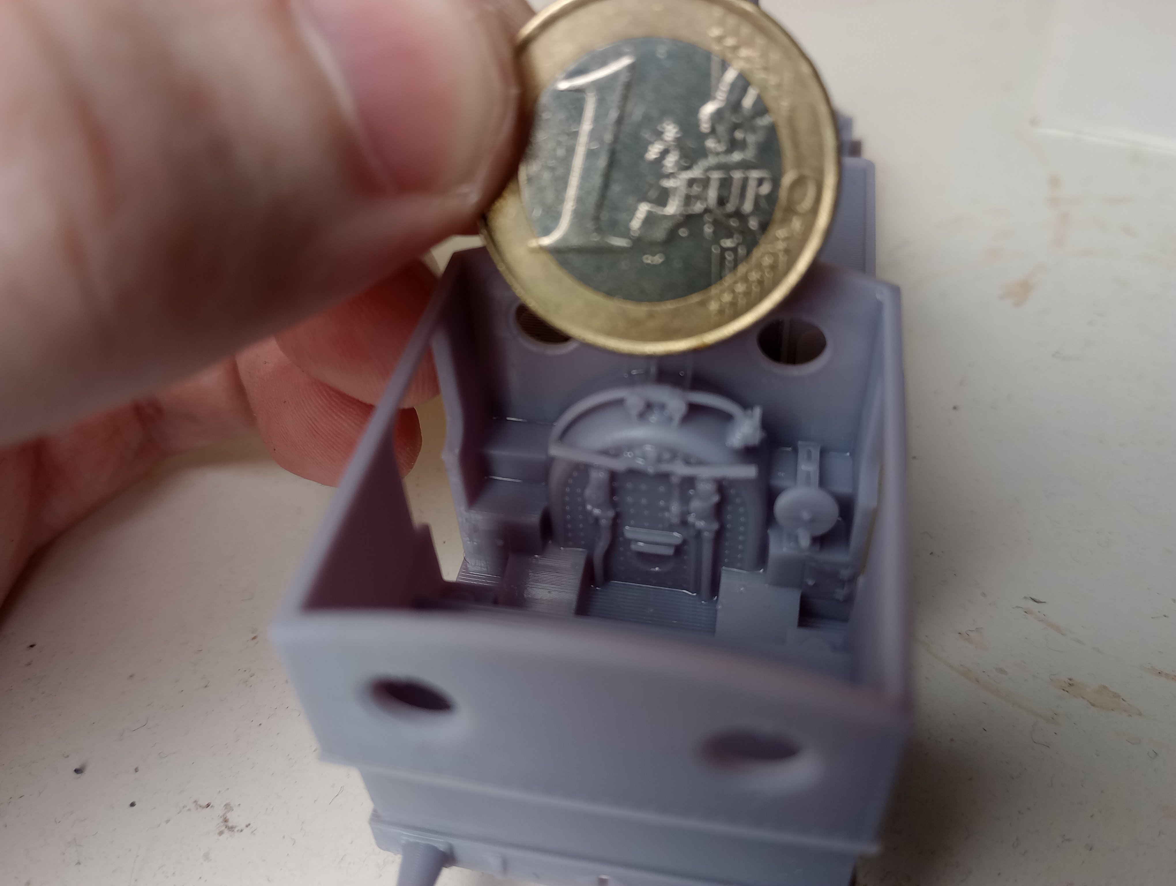

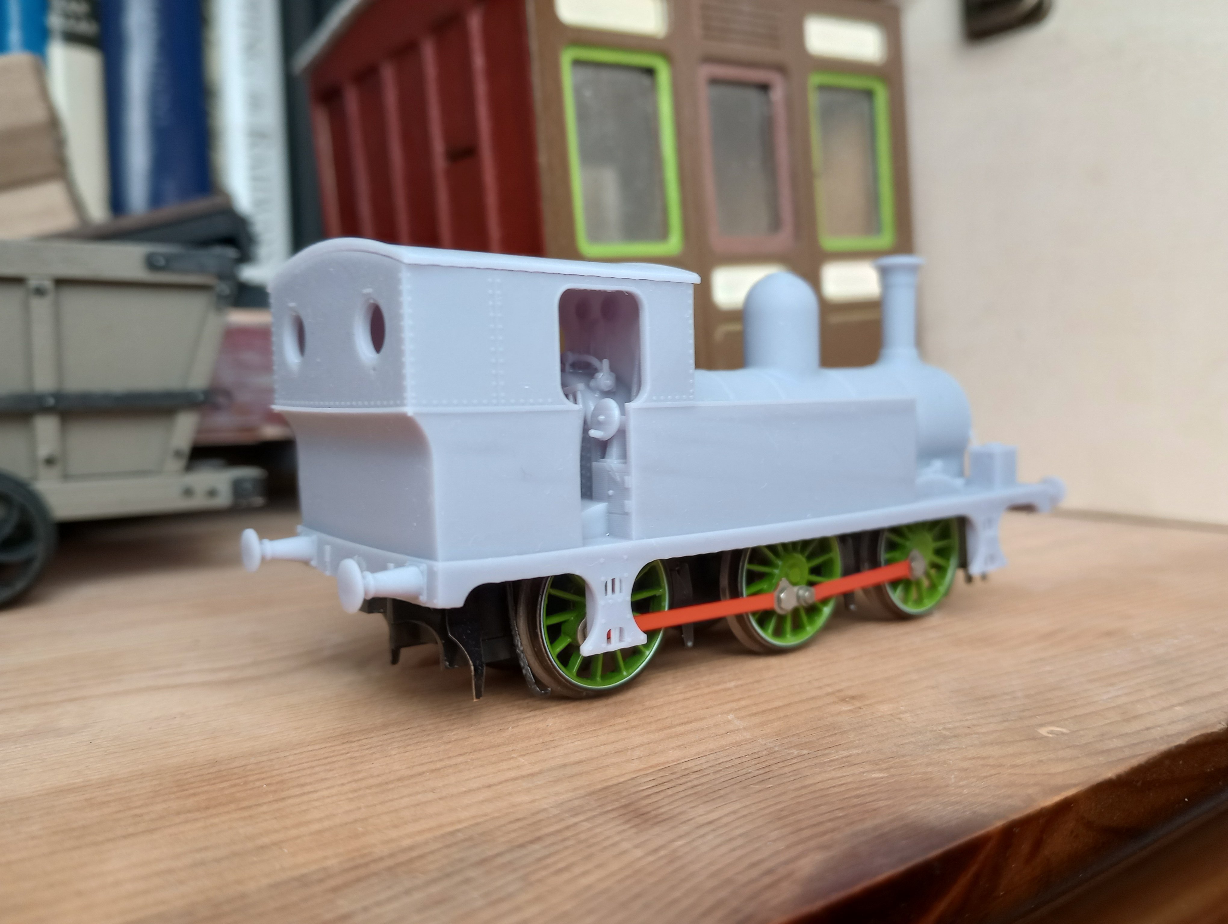

Killian Keane Posted October 15 Author Posted October 15 (edited) The first two variations are finished, the Waterford and Tramore extended cab version is next  The cab interior ended up looking like this; in my mind its adequate as its a closed cab loco, you wont see much of it Edited October 15 by Killian Keane 9 3
Mayner Posted October 15 Posted October 15 1 hour ago, Killian Keane said: The first two variations are finished, the Waterford and Tramore extended cab version is next  The cab interior ended up looking like this; in my mind its adequate as its a closed cab loco, you wont see much of it Nice touch modelling the classical Midland "butterfly' regulator and wooden reversing wheel. 1
GSR 800 Posted October 15 Posted October 15 2 hours ago, Killian Keane said: The first two variations are finished, the Waterford and Tramore extended cab version is next  The cab interior ended up looking like this; in my mind its adequate as its a closed cab loco, you wont see much of it Fabulous work Killian!  3 1
Colonel Posted October 15 Posted October 15 (edited) Amazing work - the detail inside the cab is remarkable. It would be a shame to lose that work and great if it could be painted. Any way of enabling the details to be added separately? Edited October 15 by Colonel 1
Killian Keane Posted October 15 Author Posted October 15 9 hours ago, Colonel said: Amazing work - the detail inside the cab is remarkable. It would be a shame to lose that work and great if it could be painted. Any way of enabling the details to be added separately? In my experience it should print ok as is, making things as separate components I find awkward, I like to minimise joins
Popular Post Killian Keane Posted October 16 Author Popular Post Posted October 16 My first born J26, I'm off to England to hand it over to its new owner now  15 5
Colonel Posted October 17 Posted October 17 (edited) Separate cab roof - nice to both see and get at that lovely detail. Very well done. Edited October 17 by Colonel 2 1
