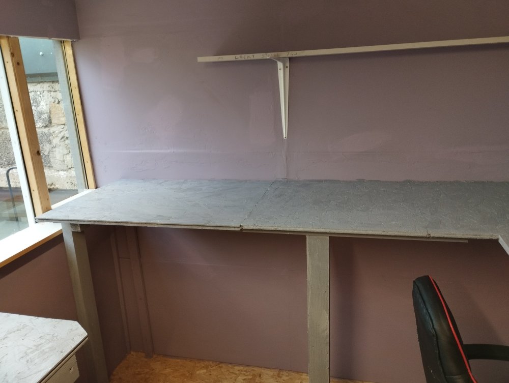

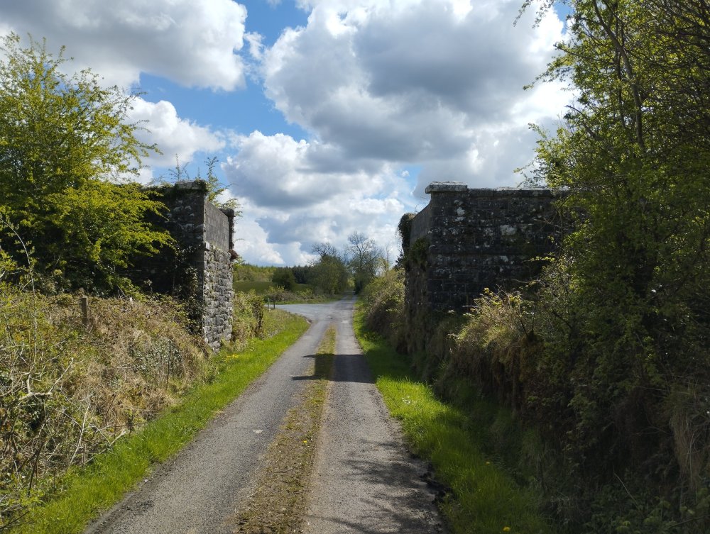

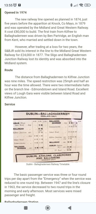

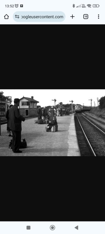

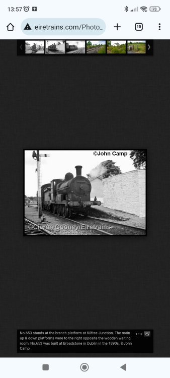

Gabhal Luimnigh Posted April 27, 2024 Posted April 27, 2024 Well why not! Thanks to Noel here, another Sligo man, I'm going to have a go at doing this, I am gathering information about it, took a trip over there today and met a local man who had lots of info, took a few pictures and found some more online, next thing is trying to find a track plan for the junction. I'm looking forward to this now. This is the board, 1800x600, plenty room. 6 Quote

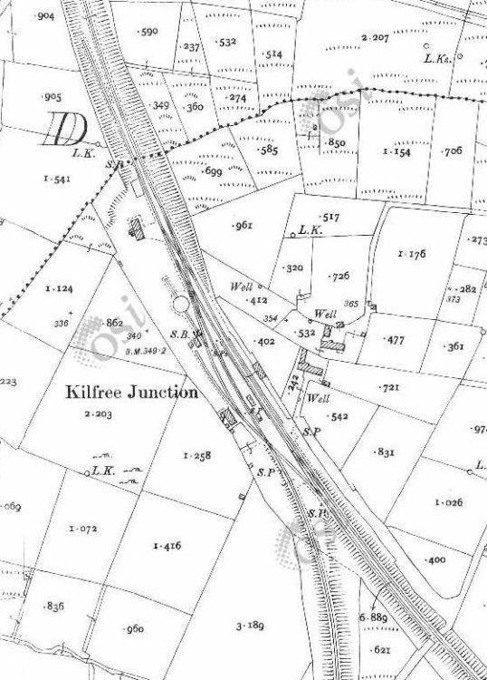

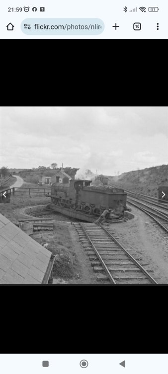

Irishswissernie Posted April 28, 2024 Posted April 28, 2024 (edited) This is the 25" plan copyrighht Geohive. I have about 16 photos on Ernie's Railway Archive mainly late 1950's This Link hopefully will bring up my Kilfree Junction images on flickr https://www.flickr.com/search/?user_id=45127721%40N05&sort=date-taken-desc&text=Kilfree+Junction&view_all=1 Edited April 28, 2024 by Irishswissernie 3 1 Quote

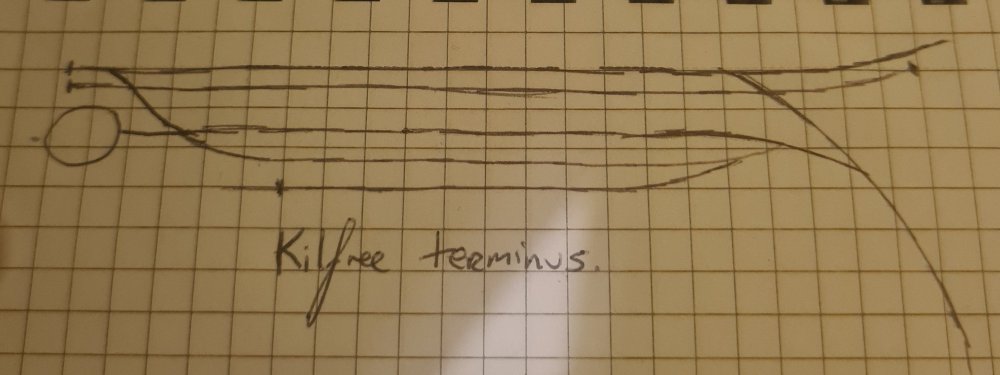

Gabhal Luimnigh Posted April 28, 2024 Author Posted April 28, 2024 Can the more learned among you lads tell me what points I need for the above layout? I'm going goggle eyed 1 Quote
NorthWallDocker Posted April 28, 2024 Posted April 28, 2024 (edited) Denis, before you get to buying points -- Have you already sketched on graph paper the compromise between your layout space and your desired scene of Kilfree Junction?. Also, maybe think about changes in gradients and how they might add scenery -- the OSI map shows a lot "going on" in a small place, which makes a small shelf layout easier to fill with shunting action. The turntable is a key attraction for a viewer. The late Carl Arendt used to design all sorts of realistic microlayouts and shelf layouts. You might also look for Iain Rice's books on the same. (I'll try to find them; I posted them somewhere recently.) Andy Cundick's layout Valencia Harbour was featured in Model Rail magazine No. 198 (August 2014), pp 90-96. Andy's layout is 12 feet by 2 feet with a sector plate. Finally, the layouts Dugort Harbour of @jhb171achill and Keadue by @Mayner featured elsewhere on this web board might help: ( I recently estimated that the MGWR and Cavan & Leitrim stations and yard at Dromod might be compressible into 18 linear feet (three 6-foot modules). Eighteen feet is a long stretch for a small home, which causes me to rethink what I want to depict and do. Edited May 4, 2024 by NorthWallDocker 3 Quote

Gabhal Luimnigh Posted April 28, 2024 Author Posted April 28, 2024 23 minutes ago, NorthWallDocker said: Denis, before you get to buying points -- Have you already sketched on graph paper the compromise between your layout space and your desired scene of Kilfree Junction?. Also, maybe think about changes in gradients and how they might add scenery -- the OSI map shows a lot "going on" in a small place, which makes a small shelf layout easier to fill with shunting action. The turntable is a key attraction for a viewer. The late Carl Arendt used to design all sorts of realistic microlayouts and shelf layouts. You might also look for Iain Rice's books on the same. (I'll try to find them; I posted them somewhere recently.) Andy Cundick's layout Valencia Harbour was featured in Model Rail magazine No. 198 (August 2014), pp 90-96. Andy's layout is 12 feet by 2 feet with a sector plate. Finally, the layouts Dugport Harbour of @jhb171achill and Keadue by @Mayner featured elsewhere on this web board might help: ( I recently estimated that the MGWR and Cavan & Leitrim stations and yard at Dromod might be compressible into 18 linear feet (three 6-foot modules). Eighteen feet is a long stretch for a small home, which causes me to rethink what I want to depict and do. Very valid thought there Martin, I will do that tomorrow. Quote

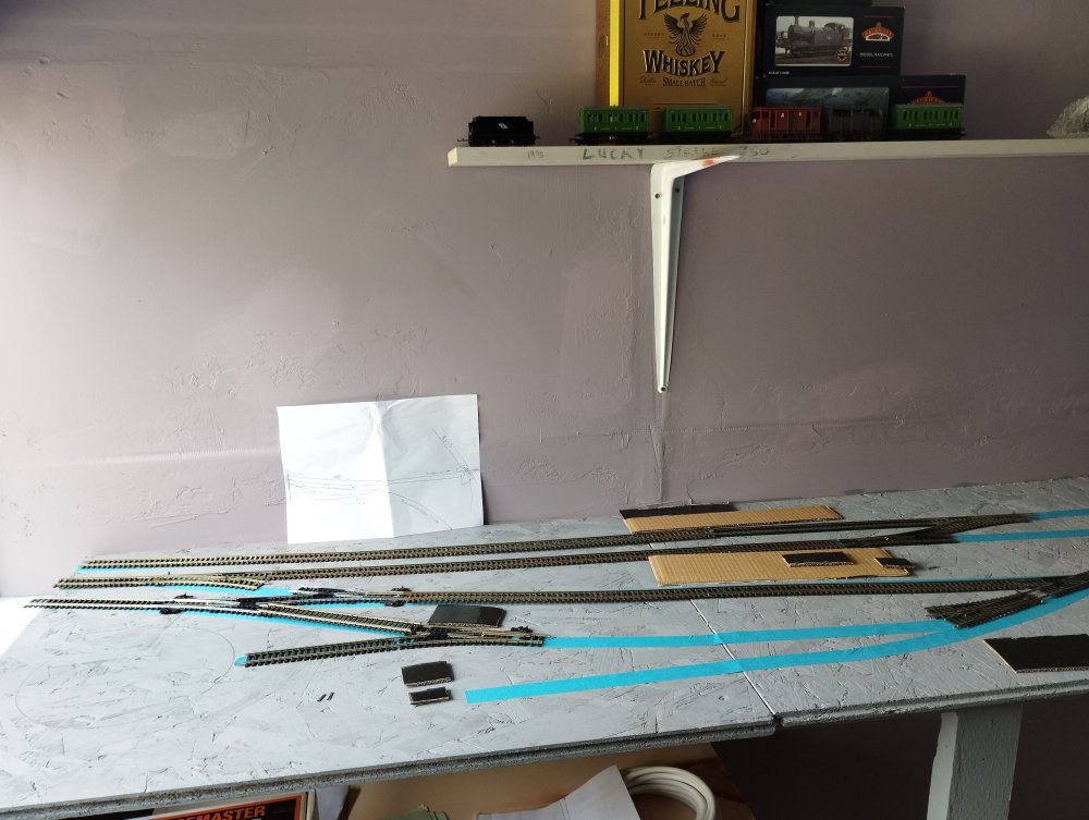

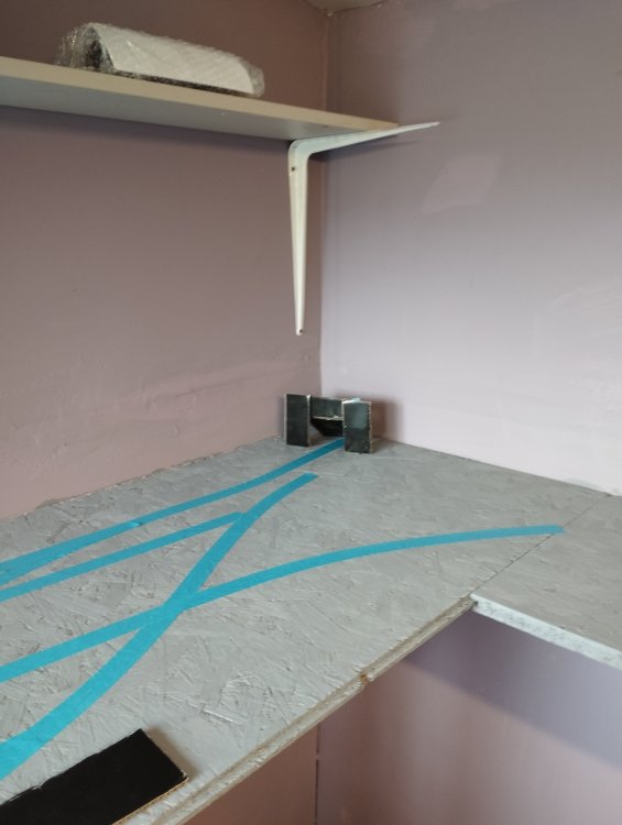

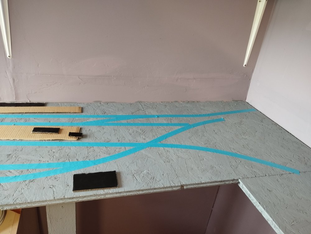

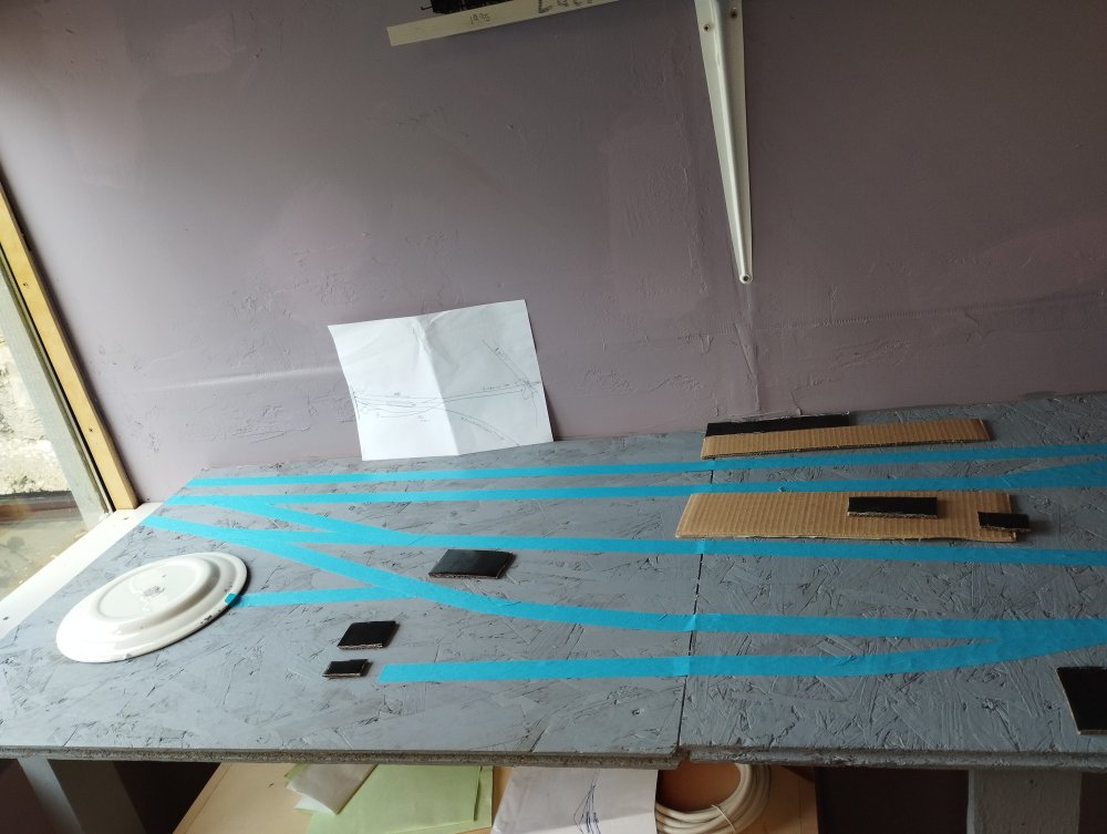

Gabhal Luimnigh Posted April 29, 2024 Author Posted April 29, 2024 Ta dah..... Blue tape is the track, black cardboard is building and brown cardboard is platform. 10 Quote
jhb171achill Posted April 29, 2024 Posted April 29, 2024 Will it have a fiddle yard either end? 1 Quote
Gabhal Luimnigh Posted April 29, 2024 Author Posted April 29, 2024 2 minutes ago, jhb171achill said: Will it have a fiddle yard either end? Nope, I don't really like them Jonathan. 1 Quote
Gabhal Luimnigh Posted April 29, 2024 Author Posted April 29, 2024 Almost forgot, there is a road bridge 3 Quote
ttc0169 Posted April 29, 2024 Posted April 29, 2024 (edited) 2 minutes ago, Gabhal Luimnigh said: Almost forgot, there is a road bridge And another over bridge at the Ballymote end…..near the “upside down plate”…!! Edited April 29, 2024 by ttc0169 1 Quote
Gabhal Luimnigh Posted April 29, 2024 Author Posted April 29, 2024 46 minutes ago, ttc0169 said: And another over bridge at the Ballymote end…..near the “upside down plate”…!! That's a turntable Noel I can't fit the second bridge 1 1 Quote
derek Posted April 30, 2024 Posted April 30, 2024 (edited) 19 hours ago, Gabhal Luimnigh said: Ta dah..... Blue tape is the track, black cardboard is building and brown cardboard is platform. Love the plate turntable Best of luck with this Denis Edited April 30, 2024 by derek 1 Quote
Gabhal Luimnigh Posted April 30, 2024 Author Posted April 30, 2024 1 hour ago, derek said: Love the plate turntable Best of luck with this Denis Haha it was the nearest thing to the size Derek, the jigsaw will take over soon 1 Quote

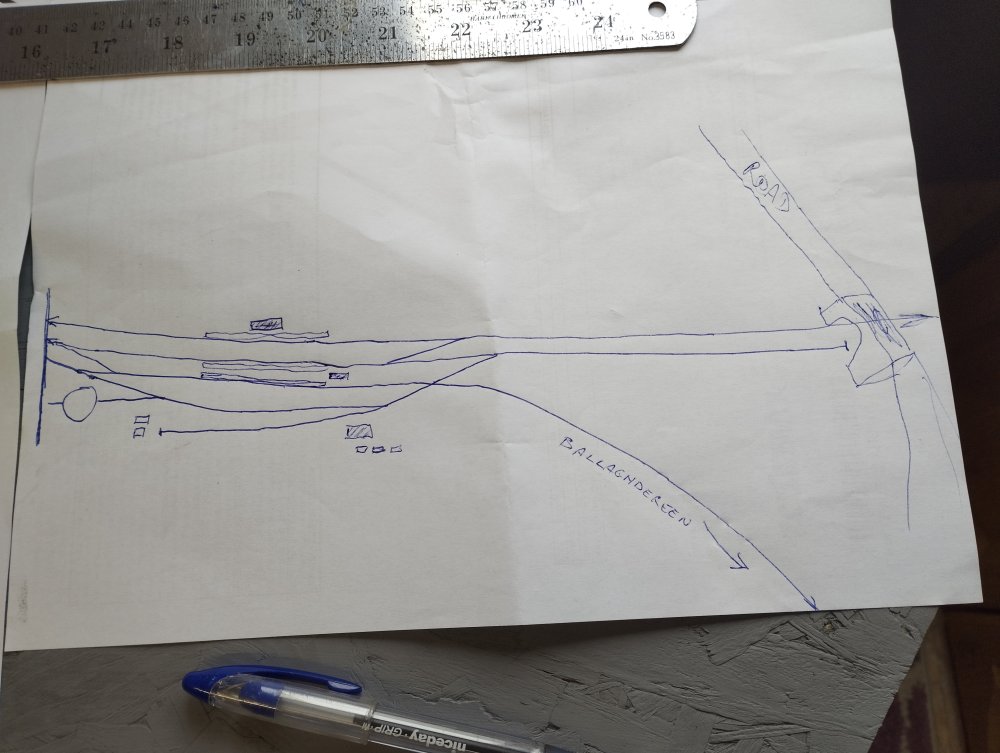

meathdane Posted April 30, 2024 Posted April 30, 2024 Hi Gabhal! The whole process of watching the shed has been brilliant! Can't wait to see how the layout progresses! But as a quick aside, the layout looks maybe a bit limited by the headshunt lengths and overall dimensions for operations, have you considered an "inspired by" rather than a "Based on" layout? Just my €0.02, I looked at your plans and done a quick sketch to aid operations (in my unlearned and green opinion). But wither way I can't wait to see how this all progresses! And by all means ignore this if you want as accurate to real life as you can get, happy modelling! 2 Quote
Gabhal Luimnigh Posted April 30, 2024 Author Posted April 30, 2024 1 hour ago, meathdane said: Hi Gabhal! The whole process of watching the shed has been brilliant! Can't wait to see how the layout progresses! But as a quick aside, the layout looks maybe a bit limited by the headshunt lengths and overall dimensions for operations, have you considered an "inspired by" rather than a "Based on" layout? Just my €0.02, I looked at your plans and done a quick sketch to aid operations (in my unlearned and green opinion). But wither way I can't wait to see how this all progresses! And by all means ignore this if you want as accurate to real life as you can get, happy modelling! Lad I have no intention of ignoring you, I will do a preliminary test after I lay down track, I was thinking of very small runs, a couple of wagons or a small coach and a wagon, I'm not concerned about accuracy, that's for unlimited space and funds 1 Quote

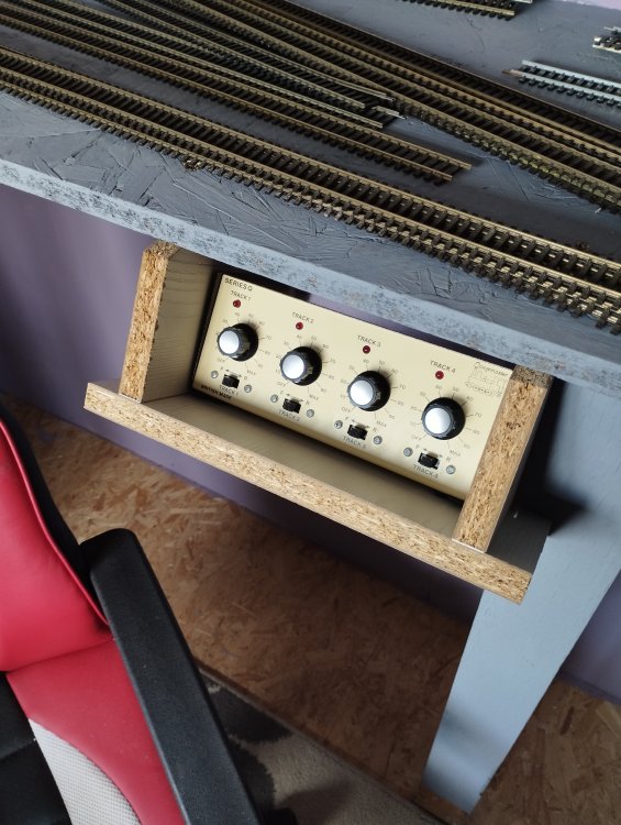

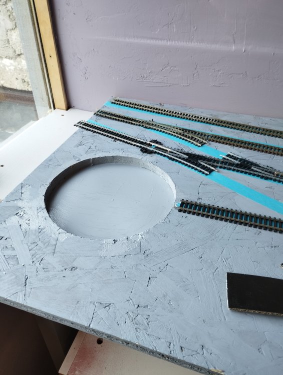

Gabhal Luimnigh Posted May 12, 2024 Author Posted May 12, 2024 Not much progress, too much fine weather means outside work, getting some of the track sorted and got the gaugemaster controller fitted in position. 9 Quote

Patrick Davey Posted May 12, 2024 Posted May 12, 2024 5 hours ago, Gabhal Luimnigh said: Not much progress, too much fine weather means outside work, getting some of the track sorted and got the gaugemaster controller fitted in position. Looks to be positioned a bit deep? 1 Quote
Gabhal Luimnigh Posted May 12, 2024 Author Posted May 12, 2024 You're correct Patrick, I am making two rubber packers for the back of it, I will do the wiring first. 1 Quote
Patrick Davey Posted May 13, 2024 Posted May 13, 2024 19 hours ago, Gabhal Luimnigh said: You're correct Patrick, I am making two rubber packers for the back of it, I will do the wiring first. Wiring - ugh..... not my favourite job. Give me ballasting any day....... 2 1 Quote

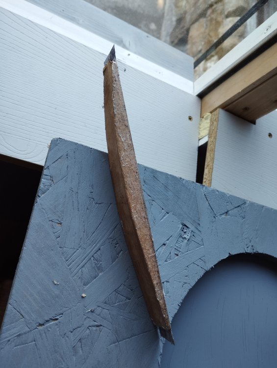

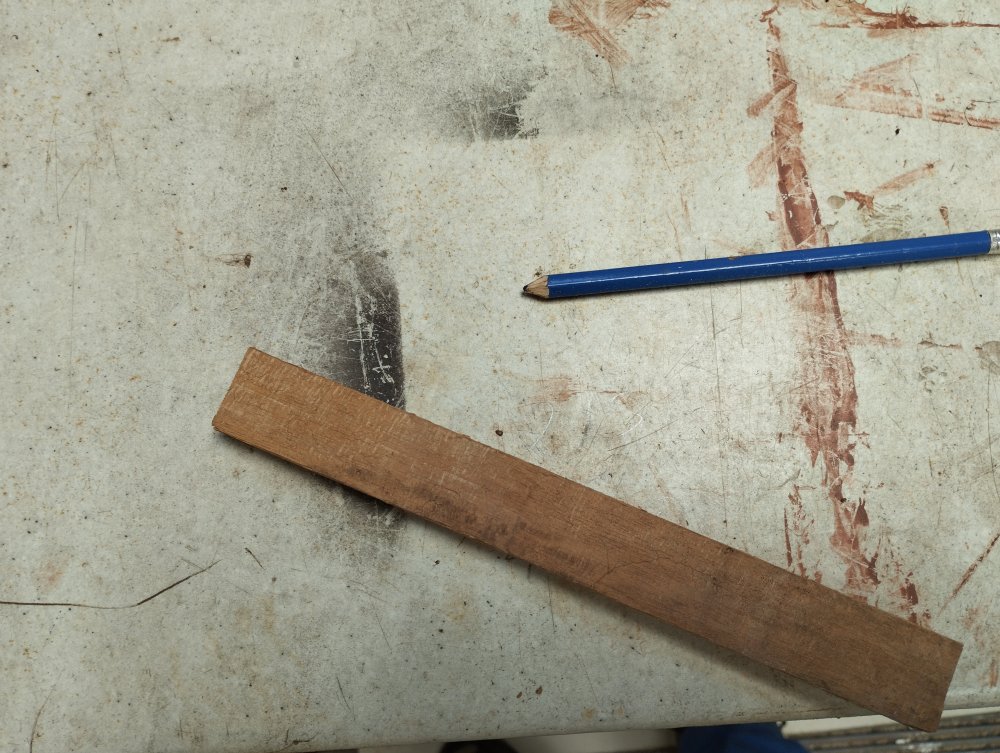

Gabhal Luimnigh Posted May 18, 2024 Author Posted May 18, 2024 Started on the turntable, just going to fabricate a manual version as the original was manual 10 Quote

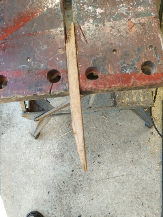

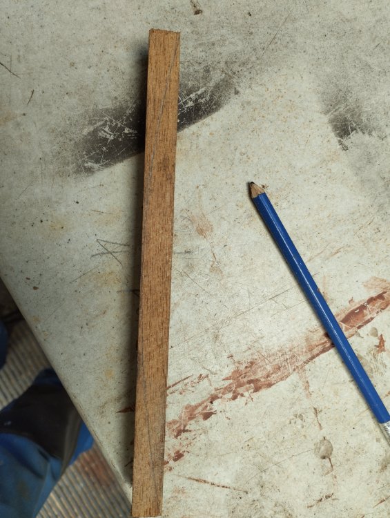

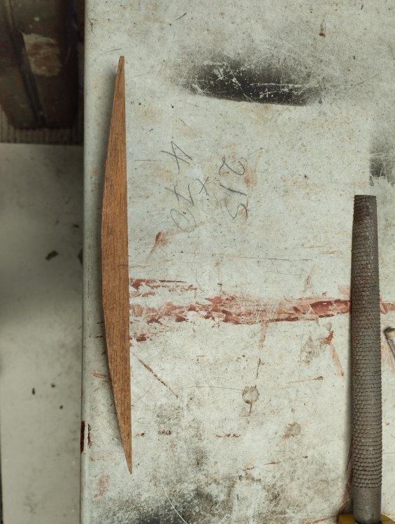

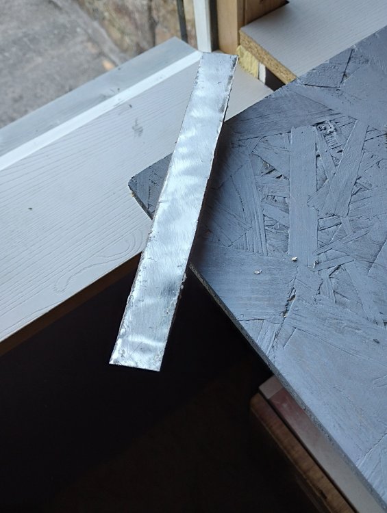

Gabhal Luimnigh Posted May 19, 2024 Author Posted May 19, 2024 Some recycling of a piece of teak and a Jacobs Elite tin lid and I have the initial stage of the locomotive rest for the turntable, I cut the piece of wood to size and shaped the underside by drawing an arc to the correct dimension by simply bowing a steel rule along the length of the wood, then I cut the tin lid to fit the wood and overhang each end to kinda replicate the original and glued it in place, it looks crude at the moment but it should work fine, to be continued.... 5 Quote
