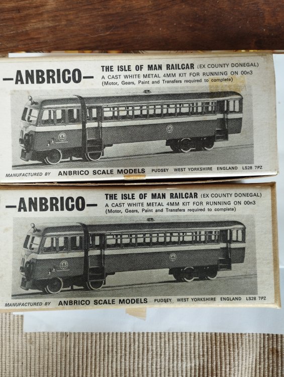

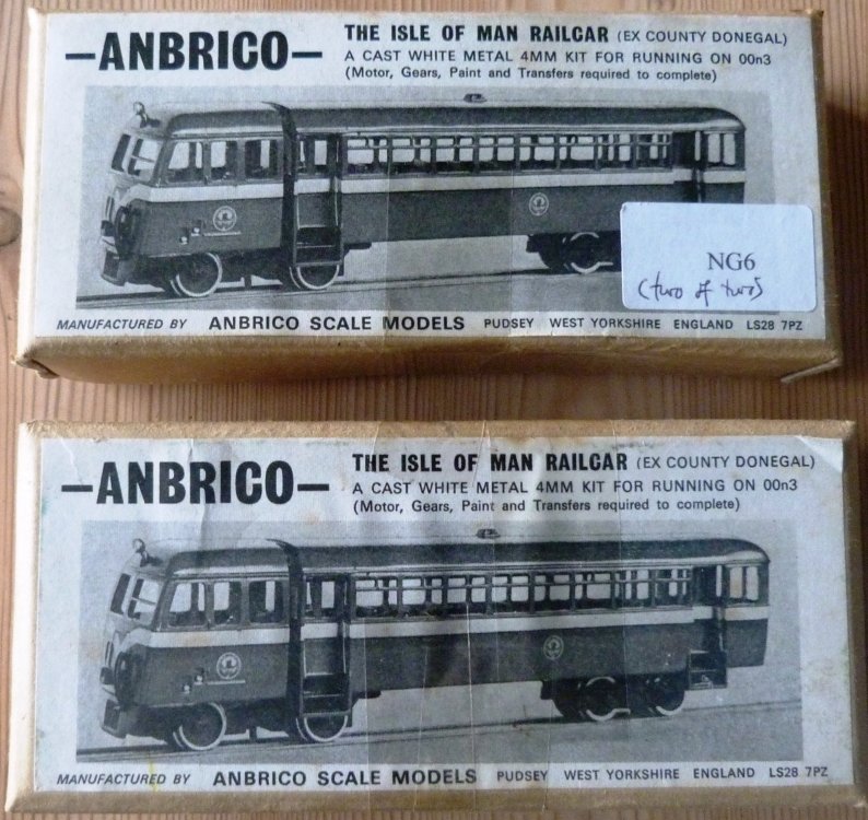

commerlad Posted September 7, 2024 Posted September 7, 2024 Hi Dennis, Are these to be County Donegal or West Clare. The 2 I'm doing are for the Isle of Man but I already have 1 for West Clare. Mark. 1 Quote
Gabhal Luimnigh Posted September 7, 2024 Author Posted September 7, 2024 One of each I plan Mark. Quote
NorthWallDocker Posted September 8, 2024 Posted September 8, 2024 Congratulations for your finds, Denis. Now, perhaps, some Halling motor bogies.... 1 Quote
Gabhal Luimnigh Posted September 8, 2024 Author Posted September 8, 2024 23 minutes ago, NorthWallDocker said: Congratulations for your finds, Denis. Now, perhaps, some Halling motor bogies.... Definitely Martin, I hope I can find a couple, I think Halling are going through some changes. Quote
airfixfan Posted September 8, 2024 Posted September 8, 2024 17 hours ago, Gabhal Luimnigh said: Couple of kits I picked up Lucky purchase and well done 1 Quote
Horsetan Posted September 24, 2024 Posted September 24, 2024 On 8/9/2024 at 1:25 AM, NorthWallDocker said: Congratulations for your finds, Denis. Now, perhaps, some Halling motor bogies.... ...and articulating them. If I recall correctly, the Anbrico arrangement between cab and passenger section was fixed, so the cab did not swing. Quote
jhb171achill Posted September 24, 2024 Posted September 24, 2024 1 minute ago, Horsetan said: ...and articulating them. If I recall correctly, the Anbrico arrangement between cab and passenger section was fixed, so the cab did not swing. They were separate and could thus be articulated... I had one of those kits for years (never got around to making it up, though, and I sold it a long time ago). Quote

WRENNEIRE Posted September 25, 2024 Posted September 25, 2024 (edited) Snap! The Backwoods kit Edited September 25, 2024 by WRENNEIRE 1 Quote
