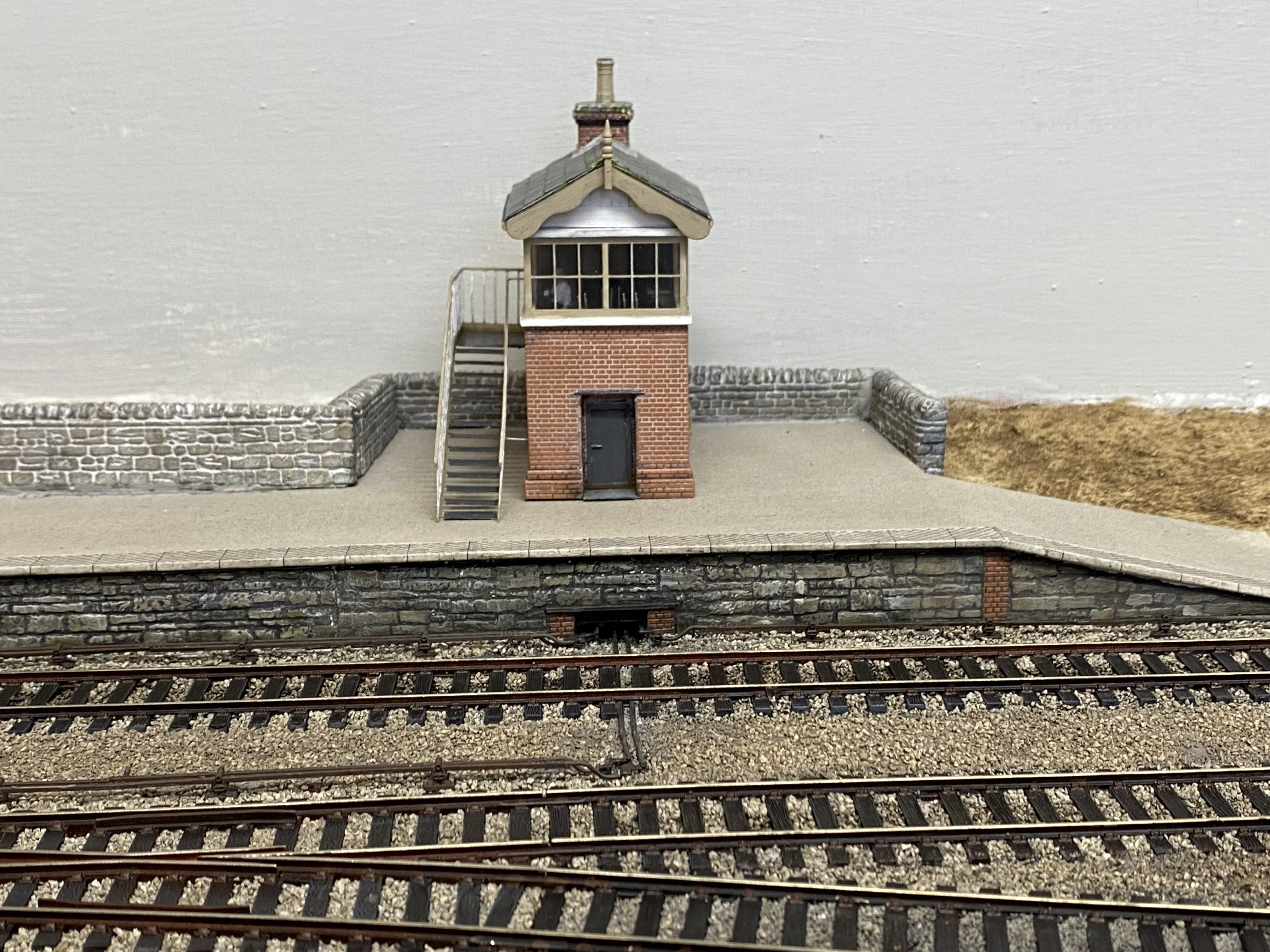

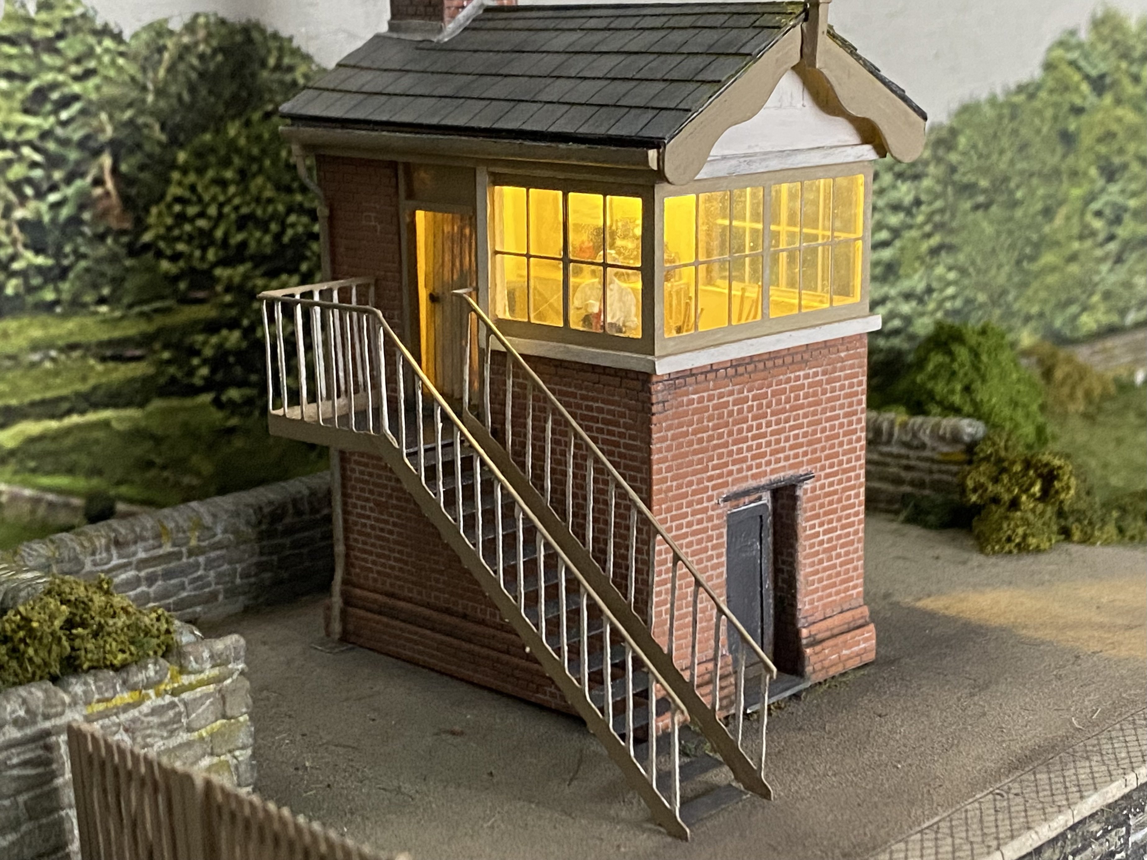

Patrick Davey Posted July 13 Posted July 13 (edited) Totally amazed by the steps Alan! Edited July 13 by Patrick Davey 1
Patrick Davey Posted July 13 Posted July 13 Just admiring this magnificent building again Alan. I definitely think it’s my favourite one of your many wonderful creations, probably because I know the prototype building so well. And bearing in mind your comment about the signalman’s tie, I can safely say this one Trumps all other signal cabin builds. 2

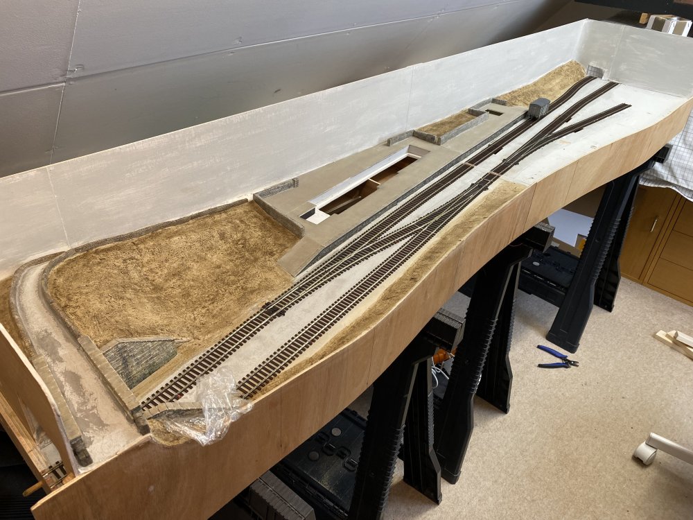

Tullygrainey Posted July 20 Author Posted July 20 Track is now laid, wired and tested on Kilmore's scenic boards. Droppers are 7/0.2 multicore wire. The bus wires are single core copper mains lighting cable. I used to lay the track then fit the droppers but now I solder these to the rails before they go down. Far fewer melted sleepers this way. Phono plugs and sockets take care of inter-board connections. Track on the scenic section is Peco OO Code 75. The non-scenic bits are a mix of Peco and Hornby Code 100. The whole layout footprint is now 11 ft by 6 ft. The only place I can set it up without throwing furniture into a skip is the garage. Putting it all together allowed all the connections to be tested and some tweaking of the track ends at board joins. Some of the locos needed a bit of encouragement too. Of the BCDR stock, diesel No.2 is finding the 4th radius curves on the linking sections a challenge and sits with its wheels spinning with more than two or three wagons in tow. More weight needed maybe. The 0-6-4T dock shunter No.29 derails on these sections and will need a bit of work to make it behave. The rest of the stable manages ok. 2-4-2T No.7 happily pulls 2 coaches, 12 wagons and a brake van. Video of some of the first runs... Kilmore first runs.mov A way to go yet but we're making progress. Alan 11 5

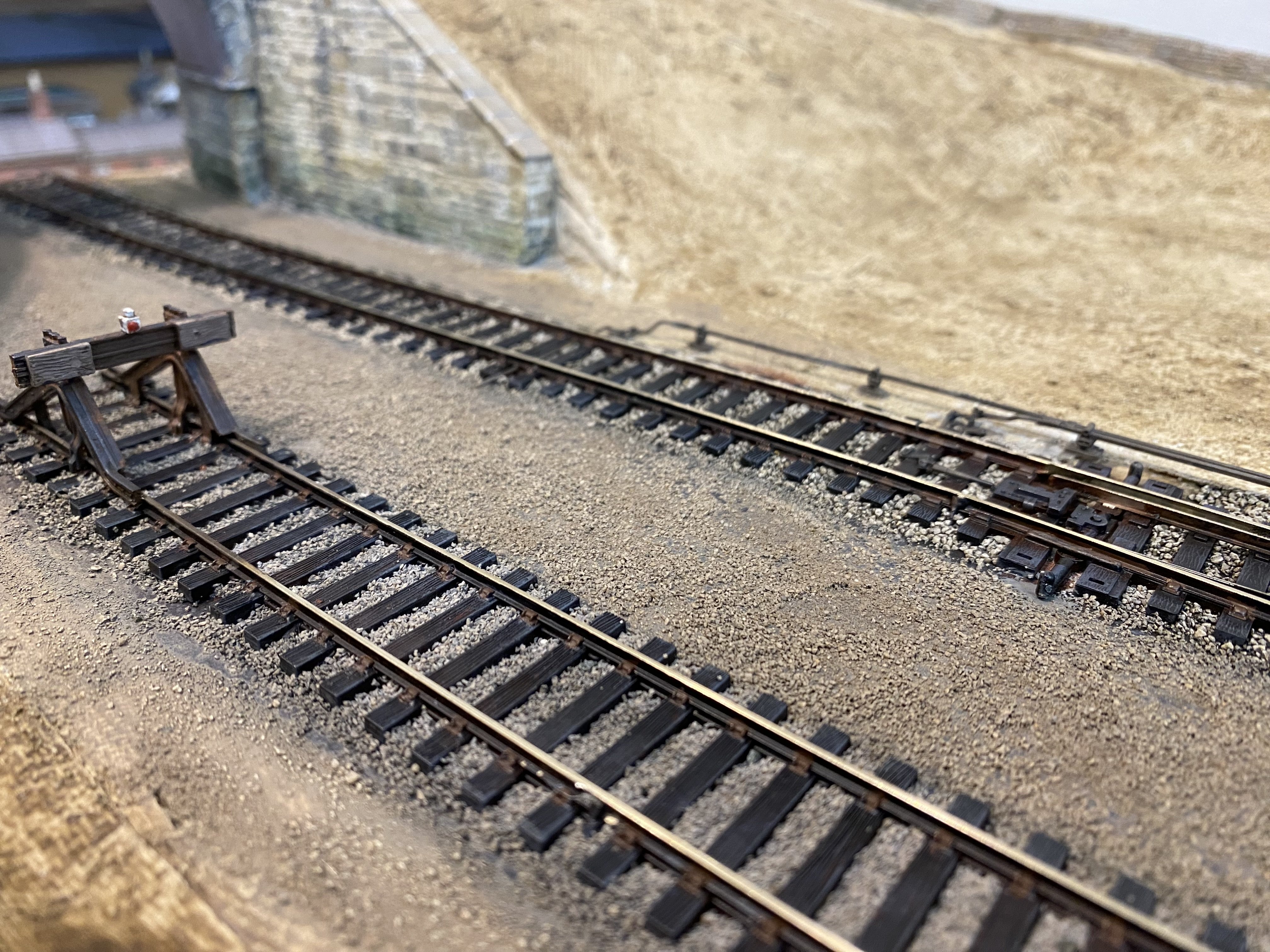

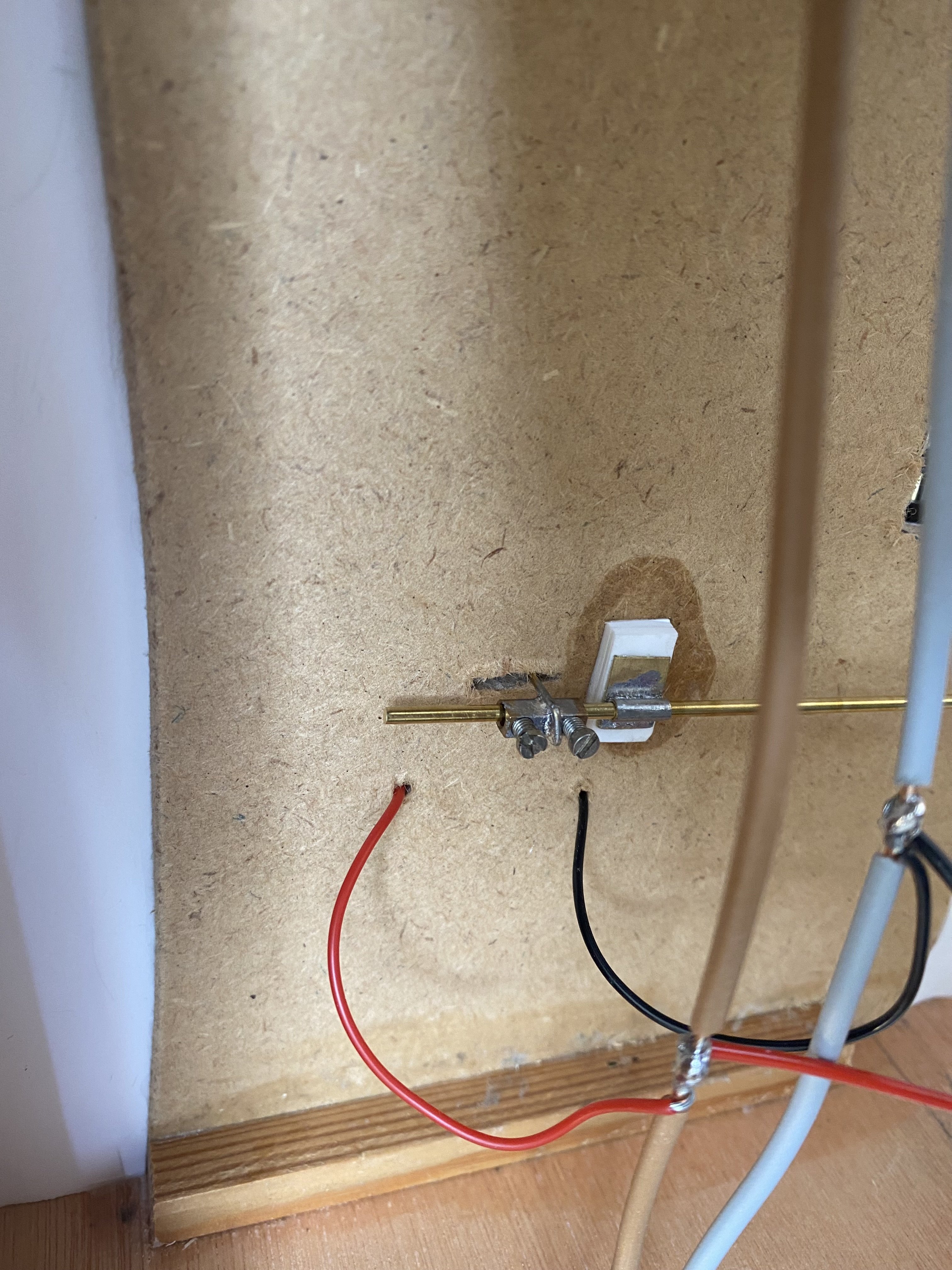

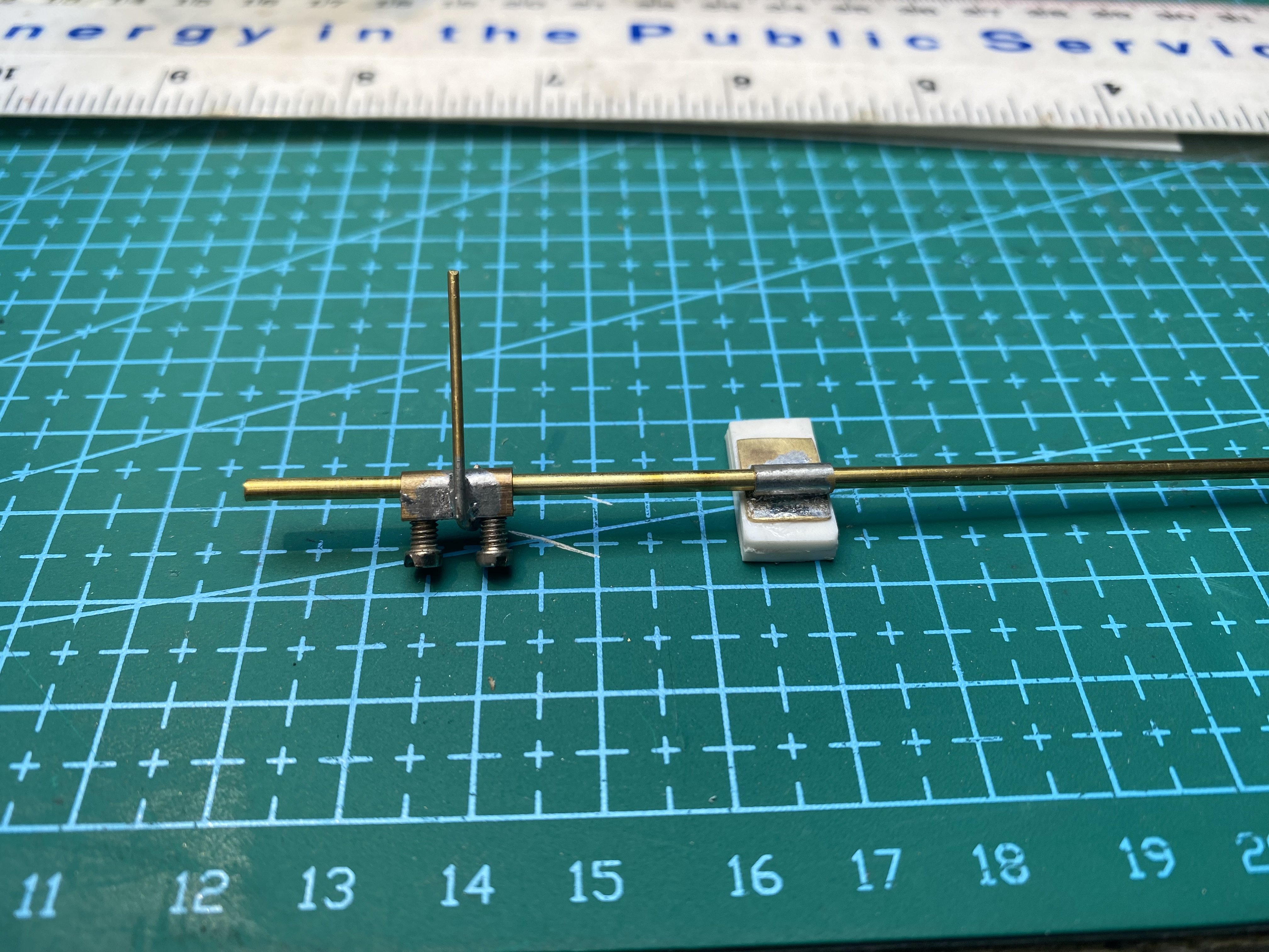

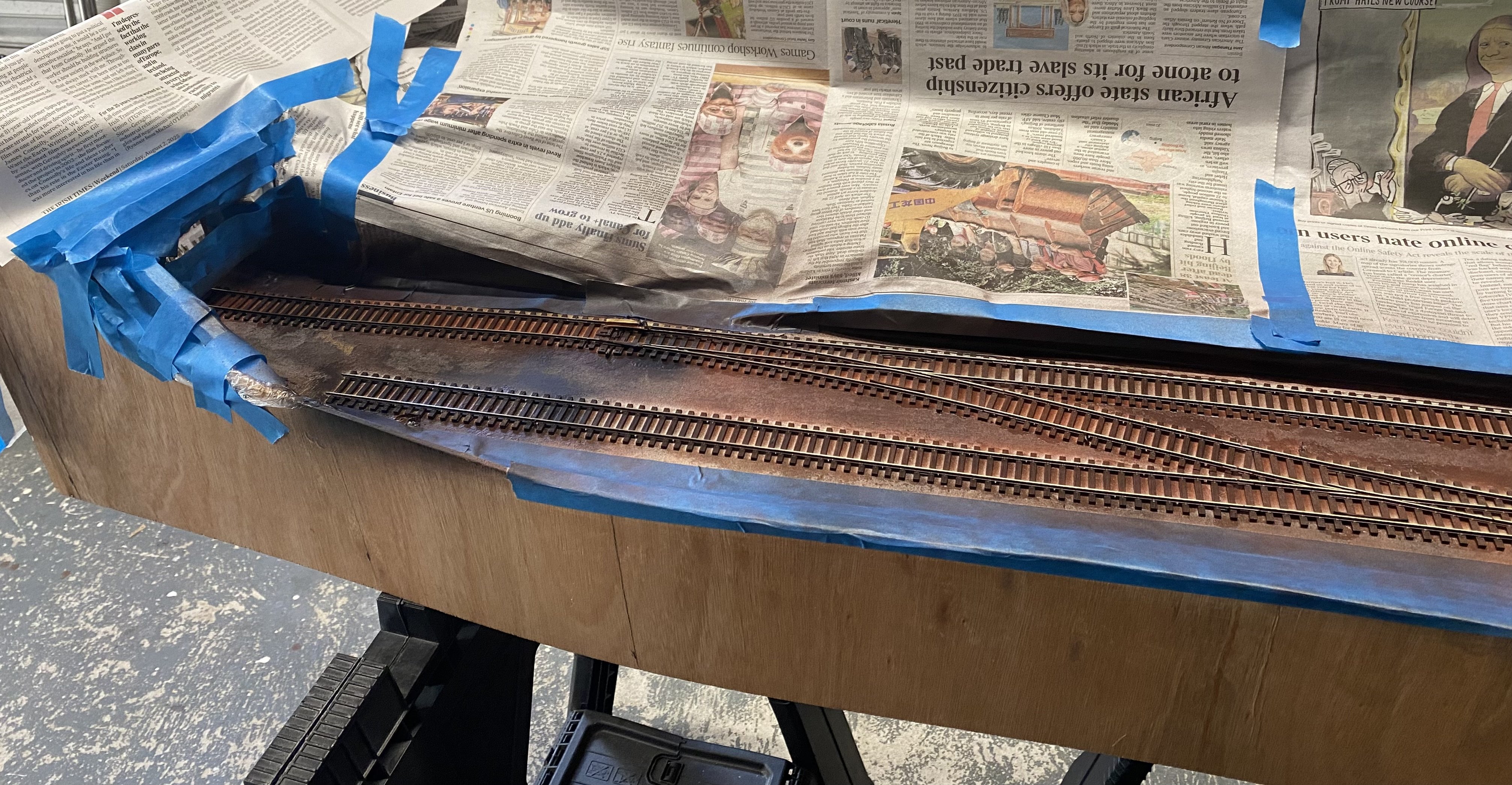

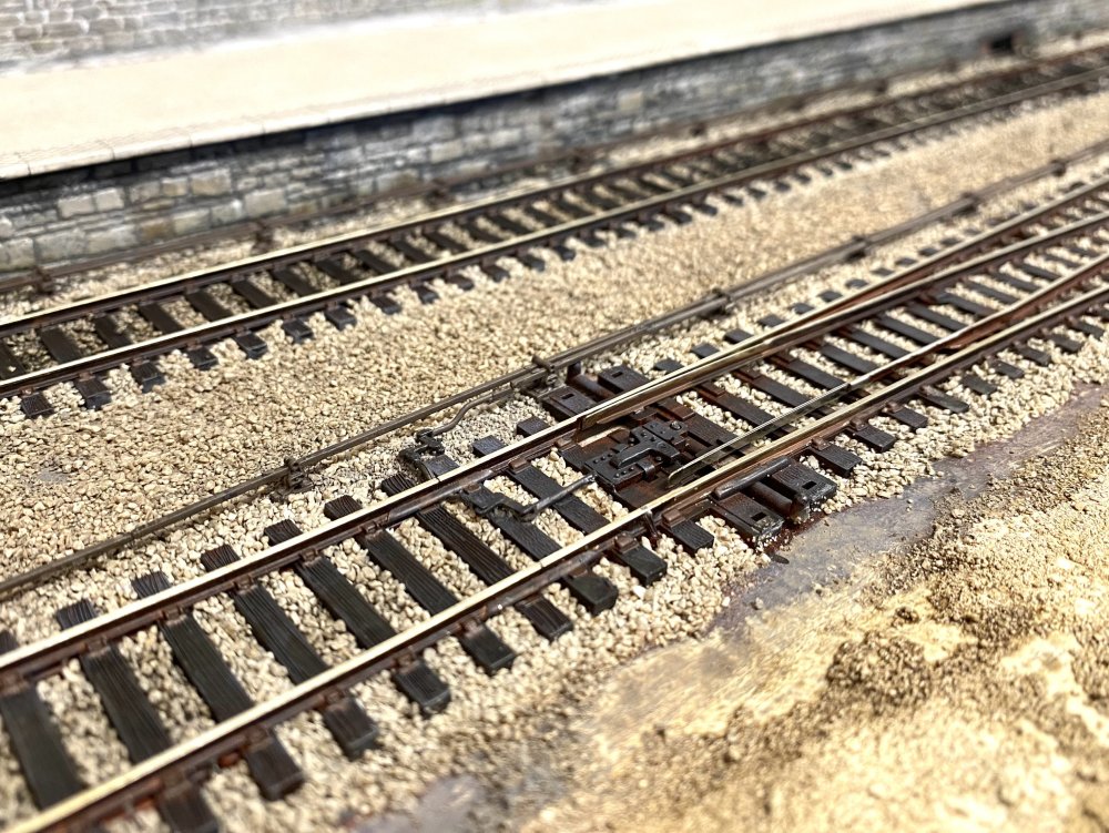

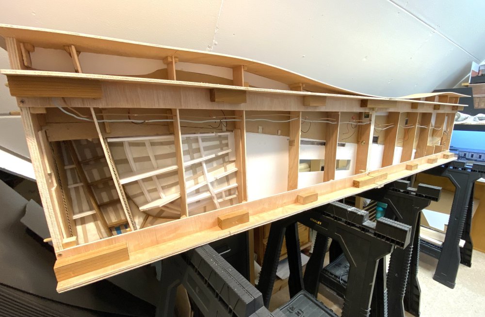

Tullygrainey Posted August 16 Author Posted August 16 (edited) Work on Kilmore over this last week or so has focused on the track - points rodding (2 sorts), ballast and paint. Points rodding 1: In the interest of keeping it simple, I've avoided points motors and opted for simple rod operation using 2mm brass rod and some bits from choc-bloc electrical connectors. It works well on The Stone Yard and I hope it will here too. This is the basic arrangement... ... and here it is installed under the board. The rod exits through the back board and terminates in a wooden knob. To paint the sides of the rails, I used a method described by Chris Nevard in Model Rail - Halfords matt black and red oxide from rattle cans, sprayed at a low angle across the track until a satisfactory colour is achieved. Shouldn't work but it does a remarkably convincing job of representing old rust. Points rodding 2: Cosmetic representations of the real thing using Wills plastic kits, laid before the ballast went down. This was the hardest thing I've done in a long time. Fragile and nightmarishly fiddly to assemble. I broke a lot of bits, lost others to the carpet monster and some of the finished results are a bit approximate. Give me an etched brass coach kit with no instructions any day! Ballasting: Not my favourite activity. Placing the ballast is fairly satisfying - all that dusting it into place with a little paint brush whilst humming quietly to oneself - but gluing it down and then picking grit out of flange ways and points mechanisms isn't. And vacuuming up the stray particles only to find great chunks coming adrift because it wasn't glued down properly or you didn't leave it to dry for long enough. Then there's weathering the stuff... Anyway, here's the state of play to date... Grassy hillsides next. Pastoral landscape has been noticeably absent from my previous layouts so new ground to be explored, new mistakes to make. Alan Edited August 16 by Tullygrainey 7 9
Mayner Posted August 17 Posted August 17 Very nice! the "Streamline" look of the Peco Code 75 track with its HO sleeper spacing helps to disguise the narrow gauge look of OO gauge, point rodding modelled complete with a facing point lock (fpl) seldom modelled adds to the overal impression of realism. 1 1
David Holman Posted August 17 Posted August 17 Got a lot of the necessary evils out of the way there, Alan and to very good effect as well. Love the rattle cans idea, and while really must try to embrace my air brush more, it is such a faff. Static grass machines much more fun. 2 1
Mol_PMB Posted August 17 Posted August 17 Super work in lots of areas there! I particularly like the use of the choc block parts to provide an adjustable connection between the point tiebar and operating rod. You did well to persevere with the point rodding and it looks superb. I hope it’s not so fragile now it’s fixed down. I wonder whether there’s a brass equivalent, for next time? I’m looking forward to seeing this develop and it is inspiring me to make some progress on a layout myself. 1 1
Tullygrainey Posted August 17 Author Posted August 17 Thanks everyone. 1 hour ago, David Holman said: Static grass machines much more fun. I'm hoping so David. I used a puffer bottle on The Stone Yard, which was perfectly adequate for the small amounts of grass in odd corners there but I've got a proper gadget for this one. Haven't tried it yet! 53 minutes ago, Mol_PMB said: Super work in lots of areas there! I particularly like the use of the choc block parts to provide an adjustable connection between the point tiebar and operating rod. You did well to persevere with the point rodding and it looks superb. I hope it’s not so fragile now it’s fixed down. I wonder whether there’s a brass equivalent, for next time? The arrangement for using choc blocs, I picked up from someone else on RM Web though I've adapted it a bit. As regards modelling the prototype points rodding, DCC Concepts marketed a system of working points rodding which I think was in metal. It still seems to be available from Rails of Sheffield but I can find no mention of it now on the DCC Concepts website so they may have discontinued it. Model Railway Journal 260 in 2018 carried an article by someone building points rodding in 2mm from self-designed etches! I suspect witchcraft was involved 3 1
Tullygrainey Posted August 17 Author Posted August 17 6 hours ago, Mayner said: Very nice! the "Streamline" look of the Peco Code 75 track with its HO sleeper spacing helps to disguise the narrow gauge look of OO gauge, point rodding modelled complete with a facing point lock (fpl) seldom modelled adds to the overal impression of realism. Yes John, the lower profile of Code 75 does give the impression of being wider, especially once the ballast goes down. This is the first time I've used it and I'd do so again. It's not any more fragile to work with than Code 100. The illustrated instruction sheet for the Wills points rodding gives a very clear indication of what all the bits do and how they connect together. Actually doing it is quite another story so there are a few fudges in there which no-one will notice I hope and suspect. 1 1
Mol_PMB Posted August 17 Posted August 17 2 minutes ago, Tullygrainey said: there are a few fudges in there which no-one will notice I hope and suspect. Just don’t tell anyone, or mention it on the internet… 3
David Holman Posted August 18 Posted August 18 (edited) In 7mm scale you get whitemetal castings for the stools and wire for the rodding = much more robust. One wonders what they do (if anything) in 2mm scale. Tame spiders maybe? Am sure you'll enjoy the static grass machine, though the puffer bottles are still useful for small areas and tight corners. A good tip is to put down a layer of scatter crumb first and then static over the top of that. Never use a single colour either. A blend of several works best and experimenting is very addictive! Edited August 18 by David Holman 1 2

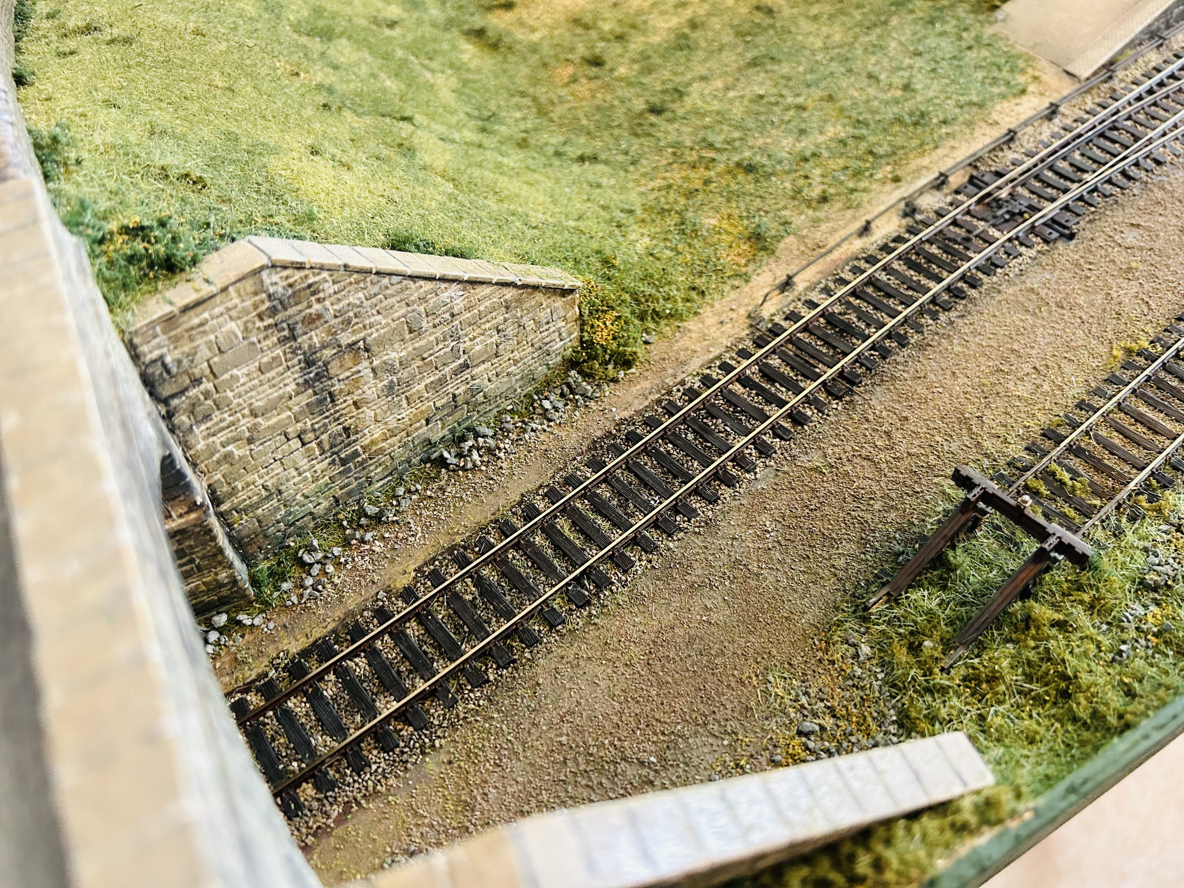

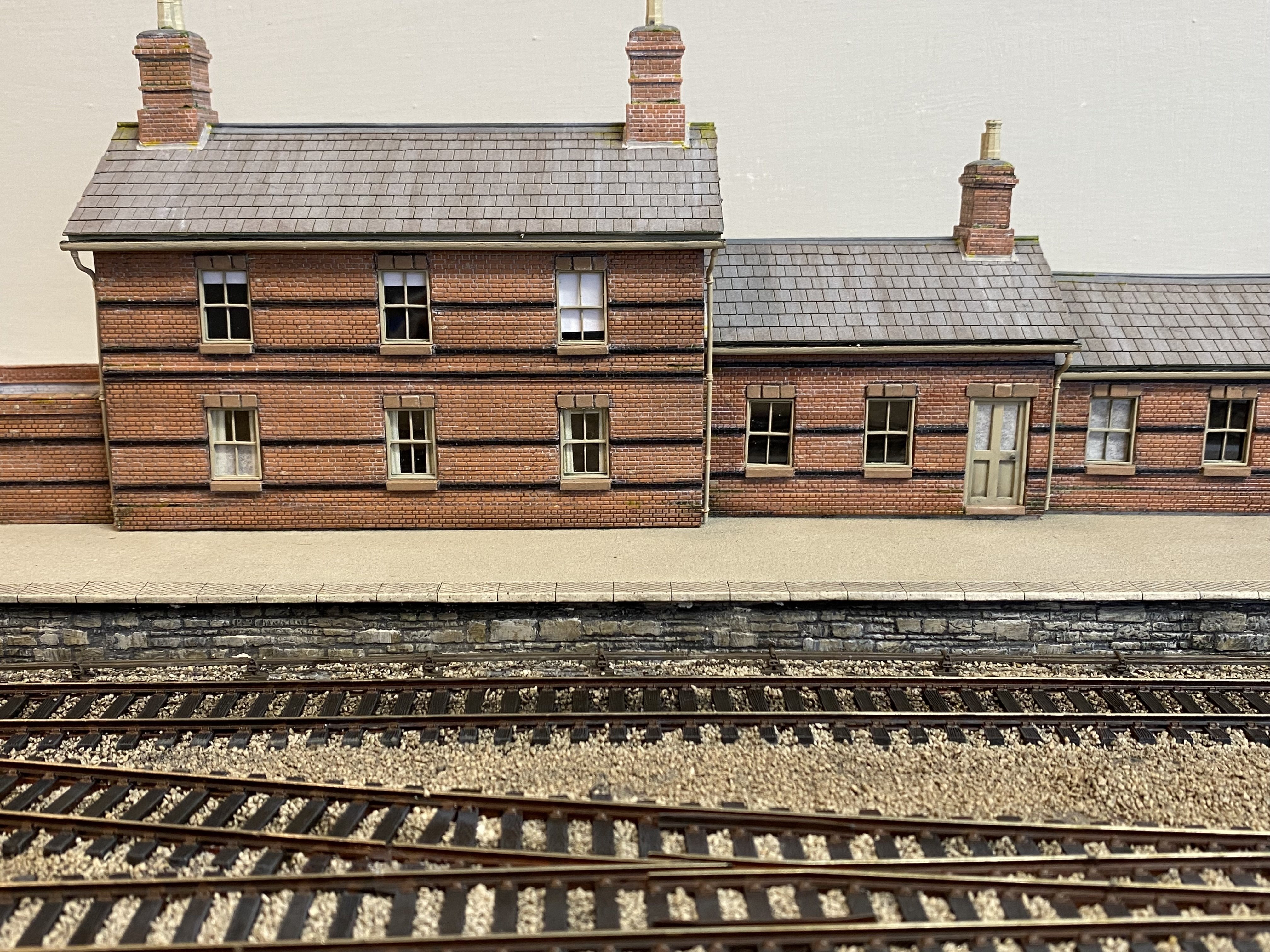

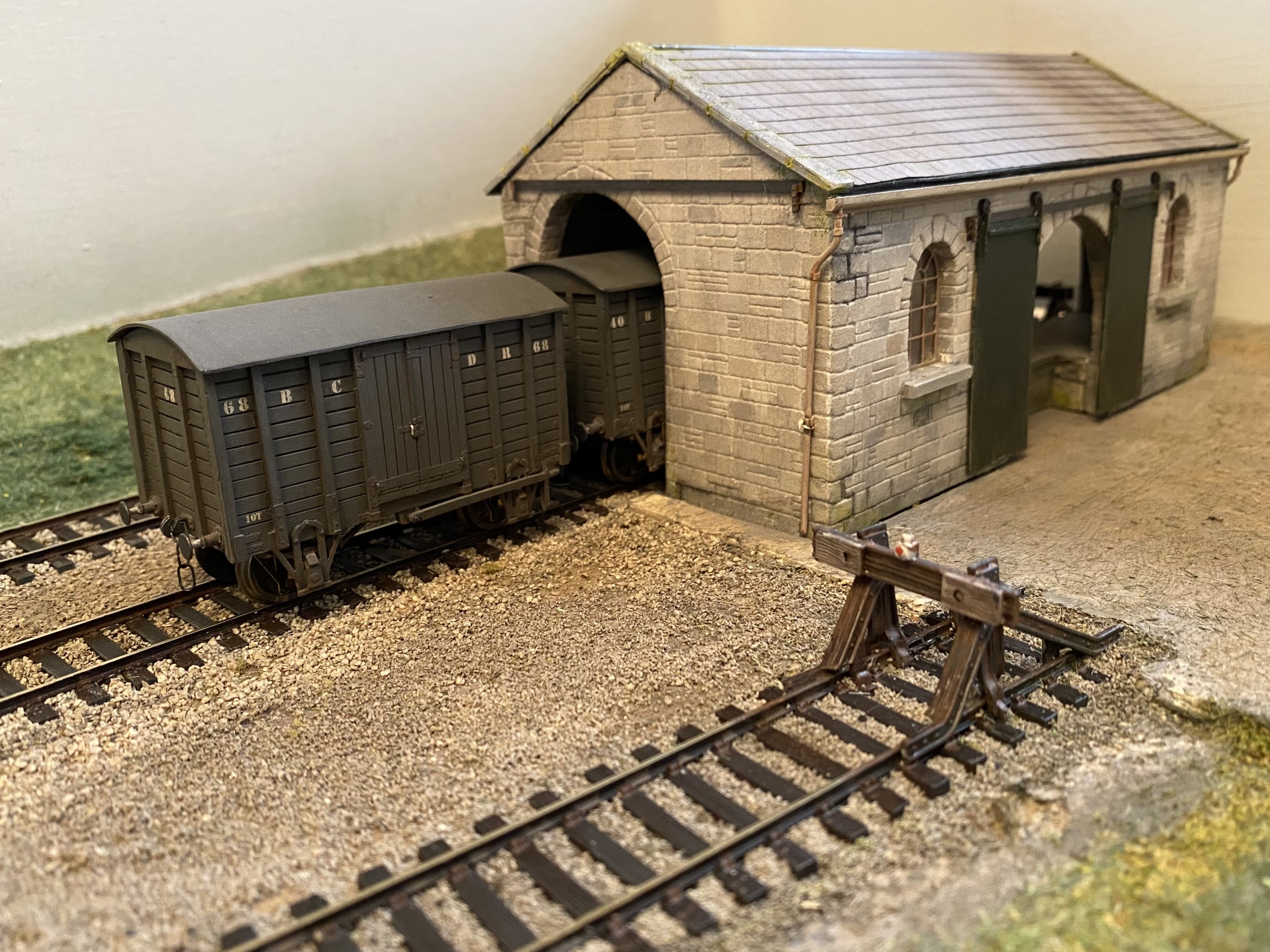

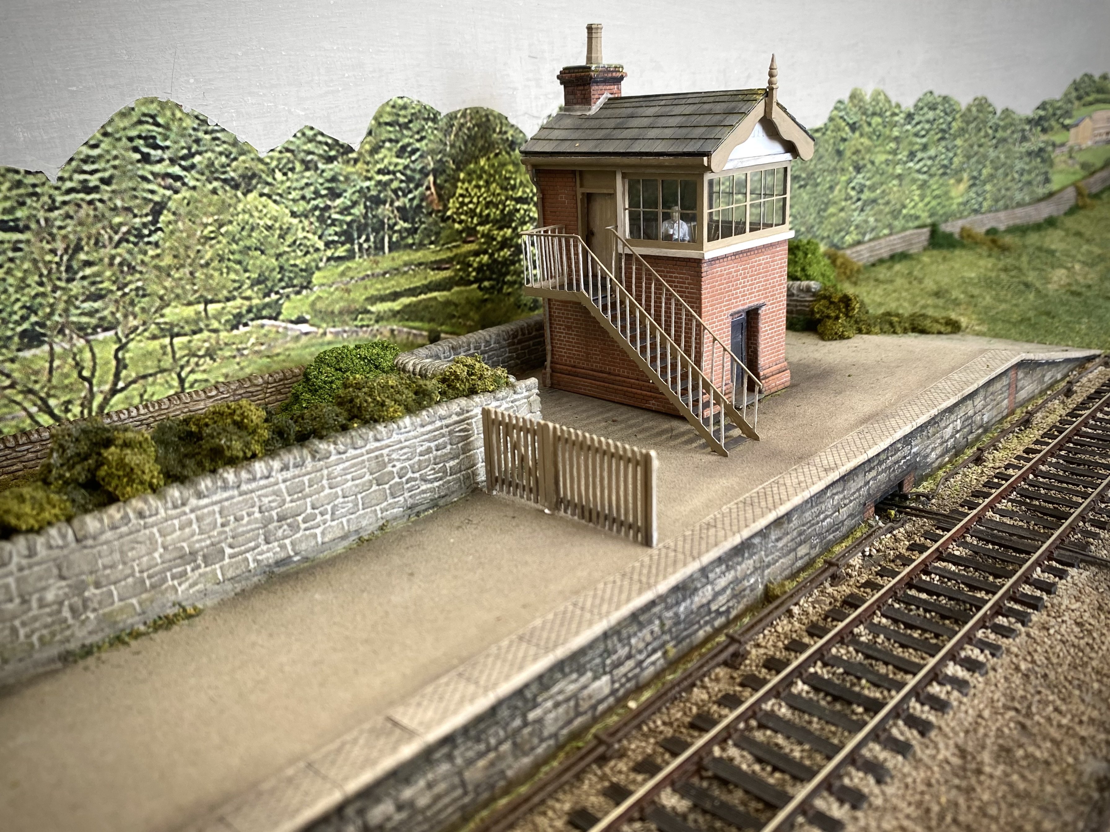

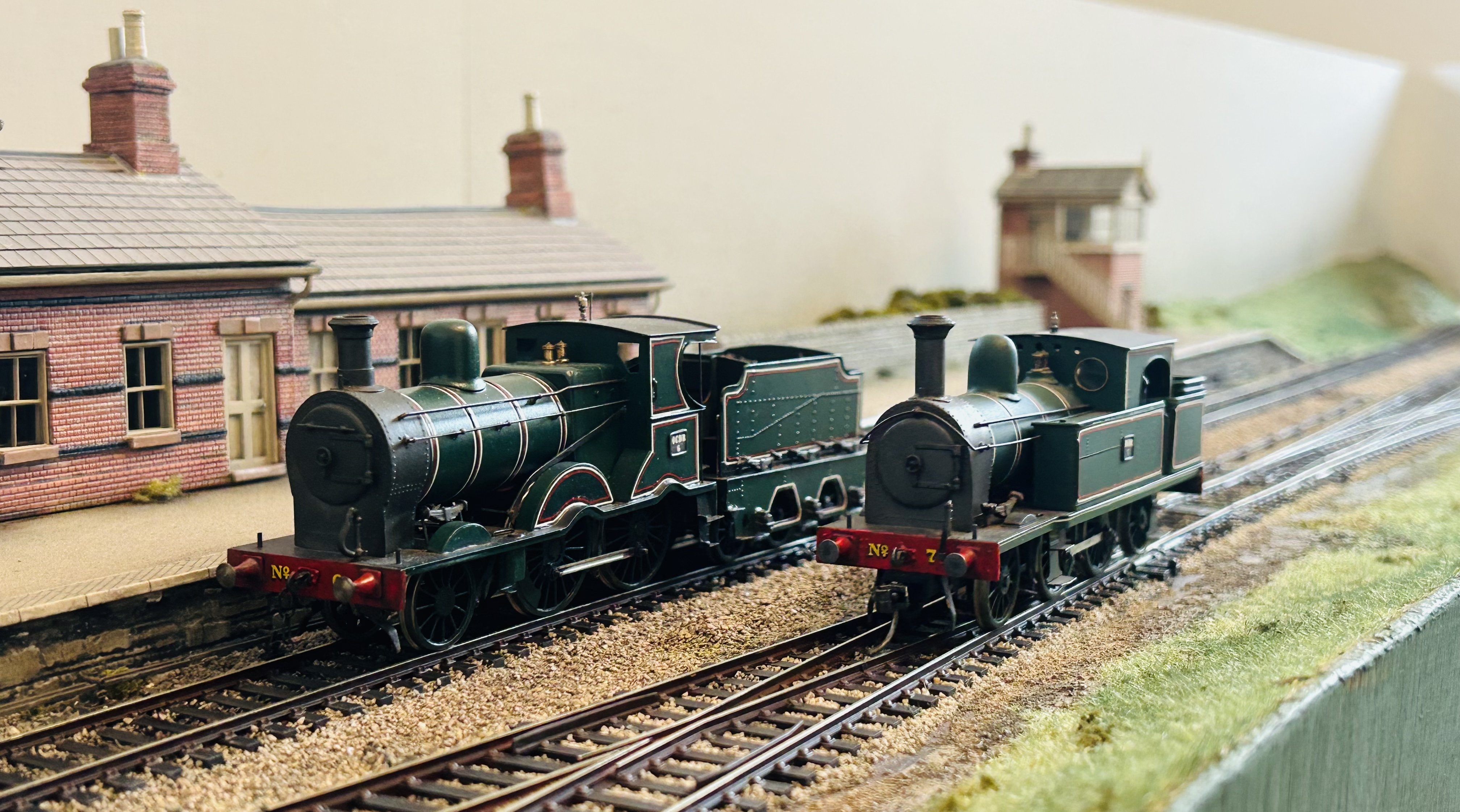

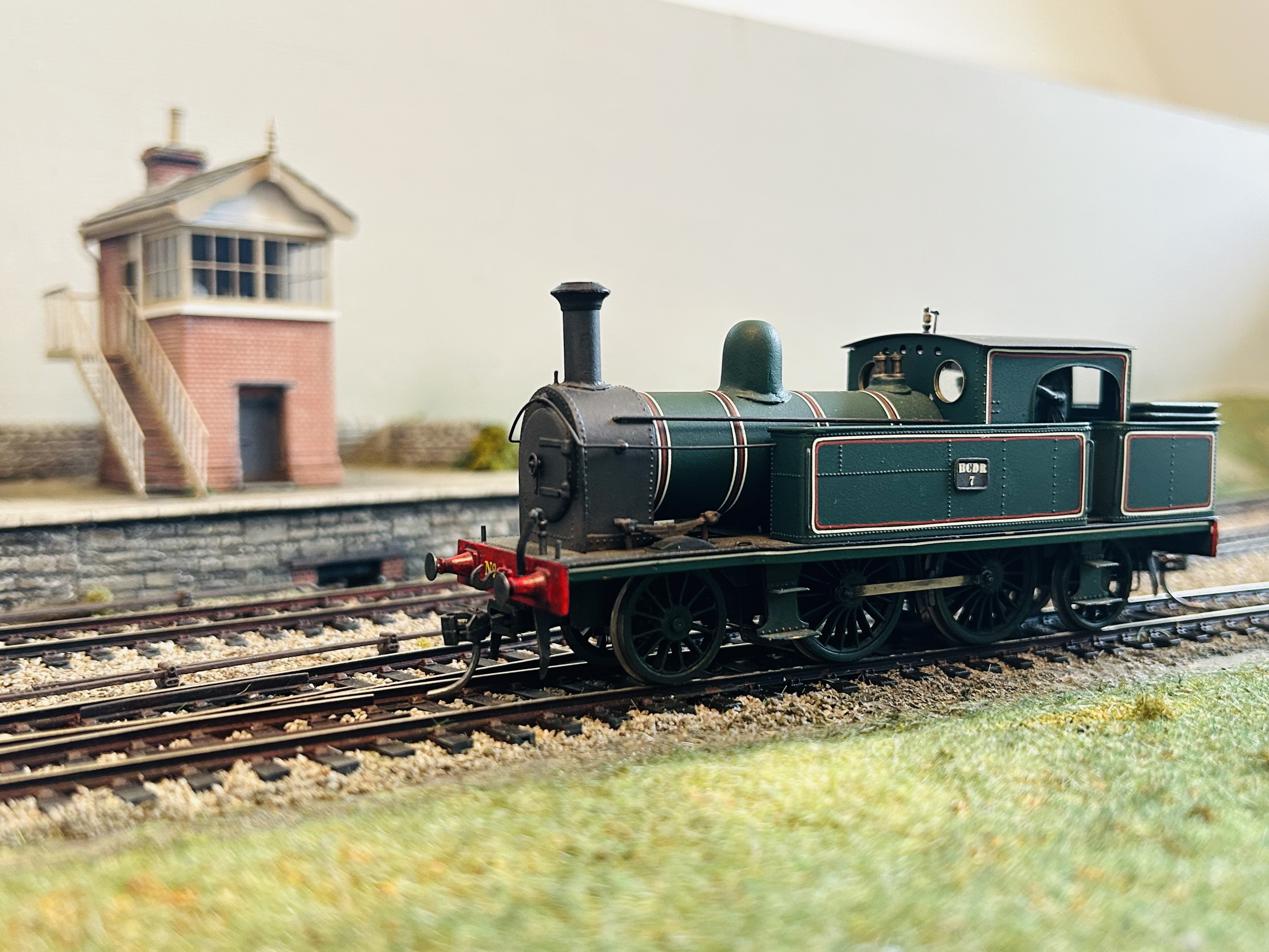

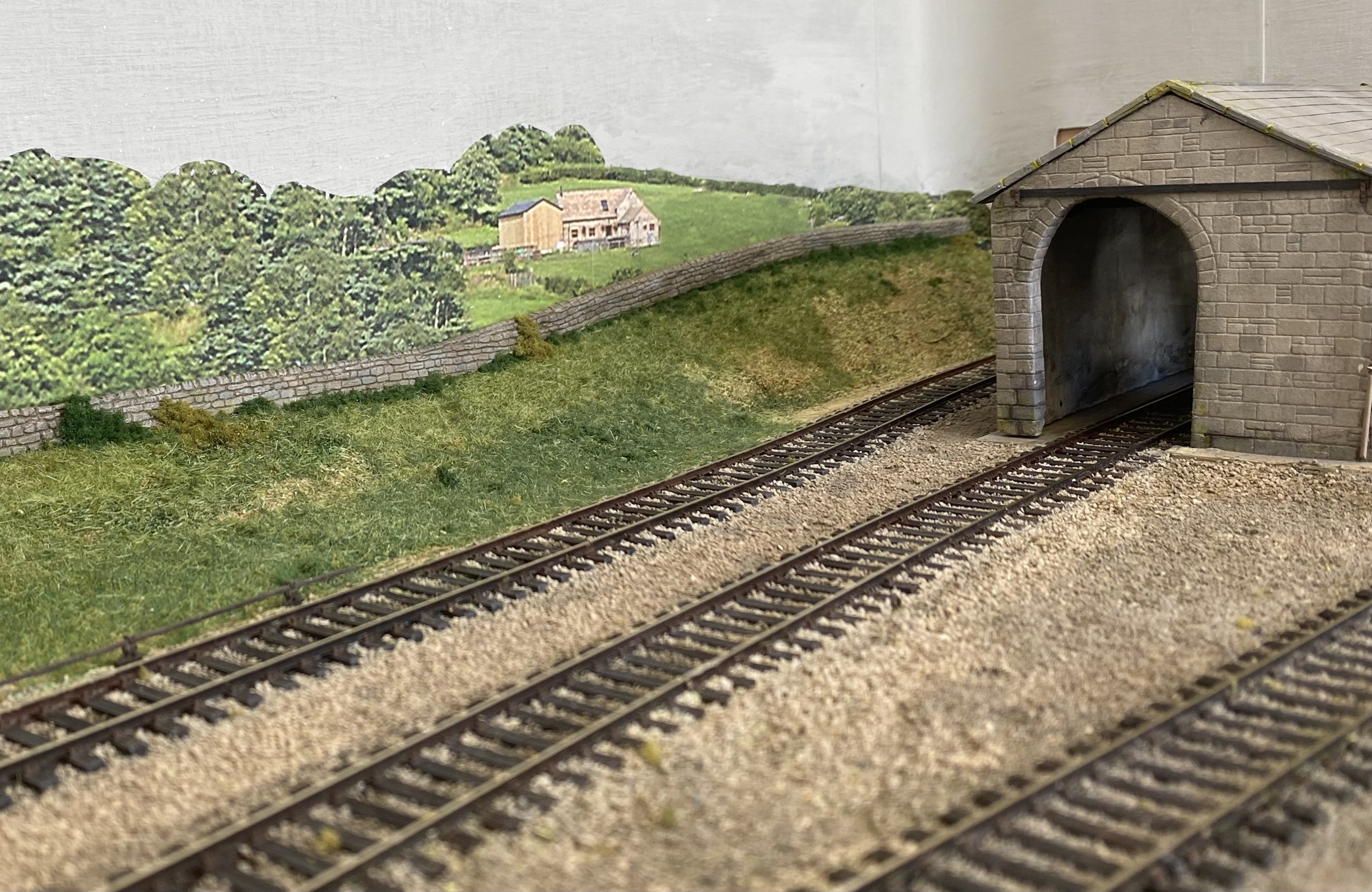

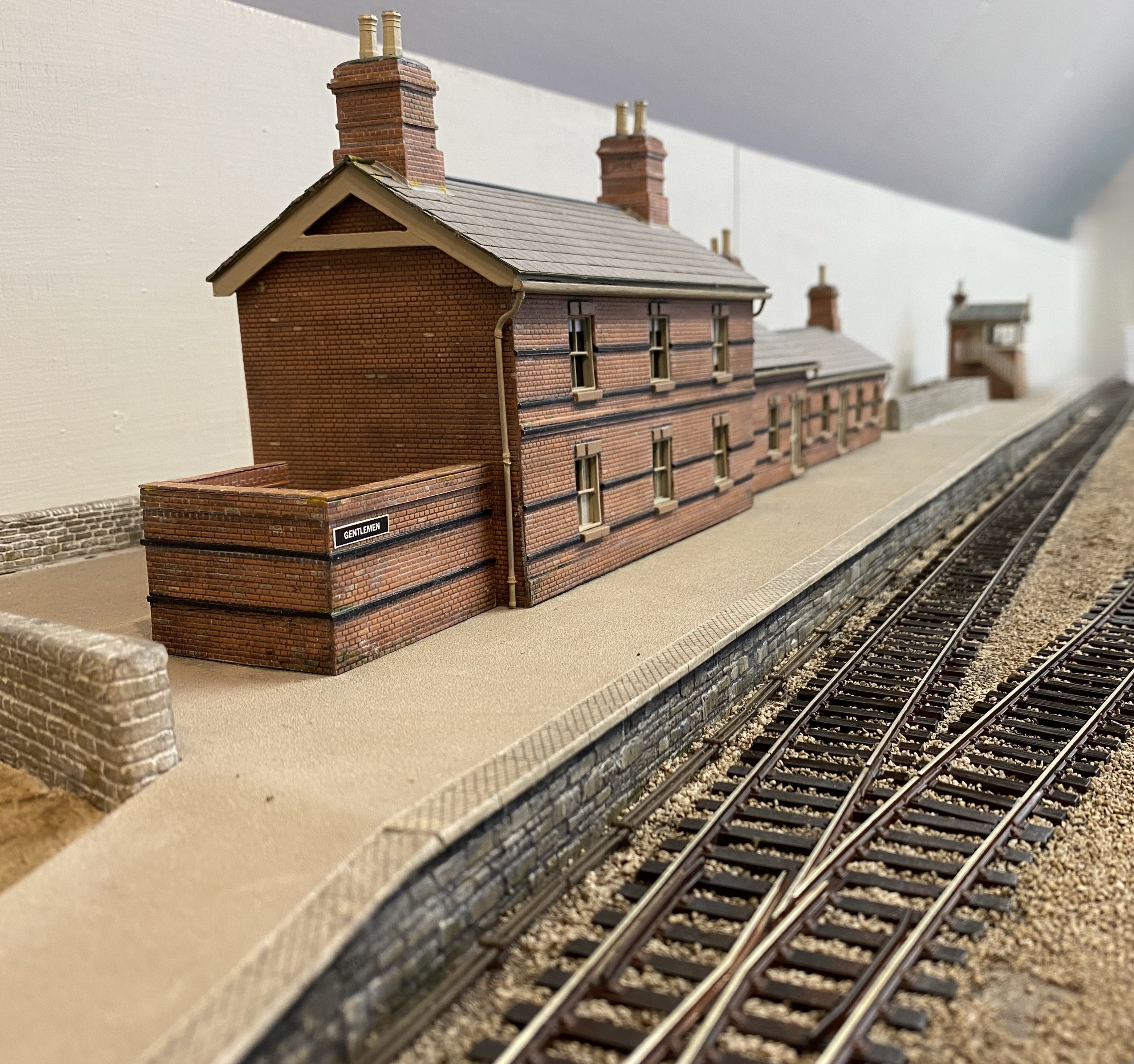

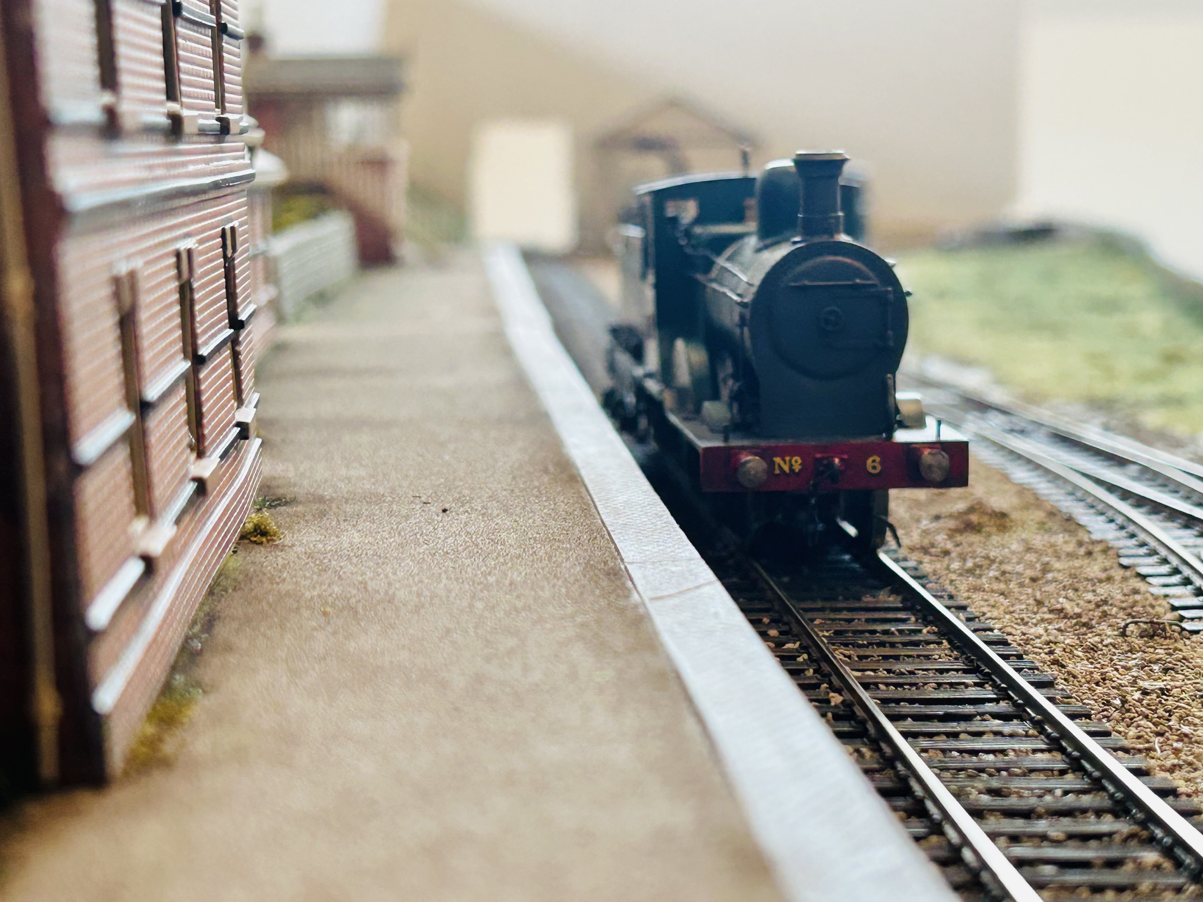

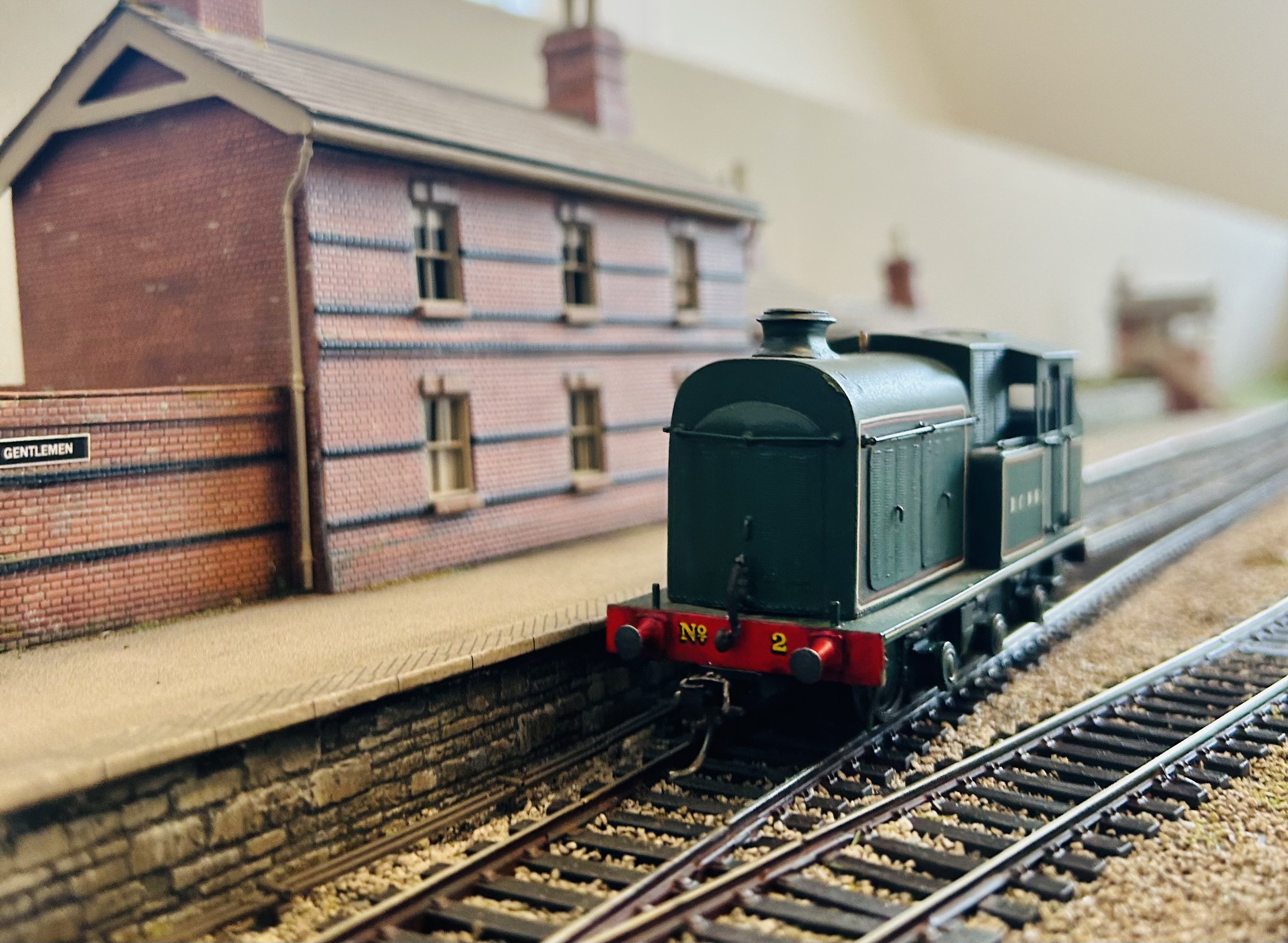

Popular Post Patrick Davey Posted August 20 Popular Post Posted August 20 Had a brief but excellent catch up with Alan this evening and he kindly permitted my taking of some photos of his current layout build ‘Kilmore’. No need for any descriptions for the photos - just incredible! 10 10
Patrick Davey Posted August 20 Posted August 20 4 minutes ago, Galteemore said: Front cover of MRJ beckons! Indeed, and worthy of being the main feature in a future edition of RM! 2 1
Tullygrainey Posted August 20 Author Posted August 20 53 minutes ago, Patrick Davey said: Had a brief but excellent catch up with Alan this evening and he kindly permitted my taking of some photos of his current layout build ‘Kilmore’. No need for any descriptions for the photos - just incredible! Thank you Patrick. Great pictures! You are hereby appointed official photographer at Kilmore. 1 1

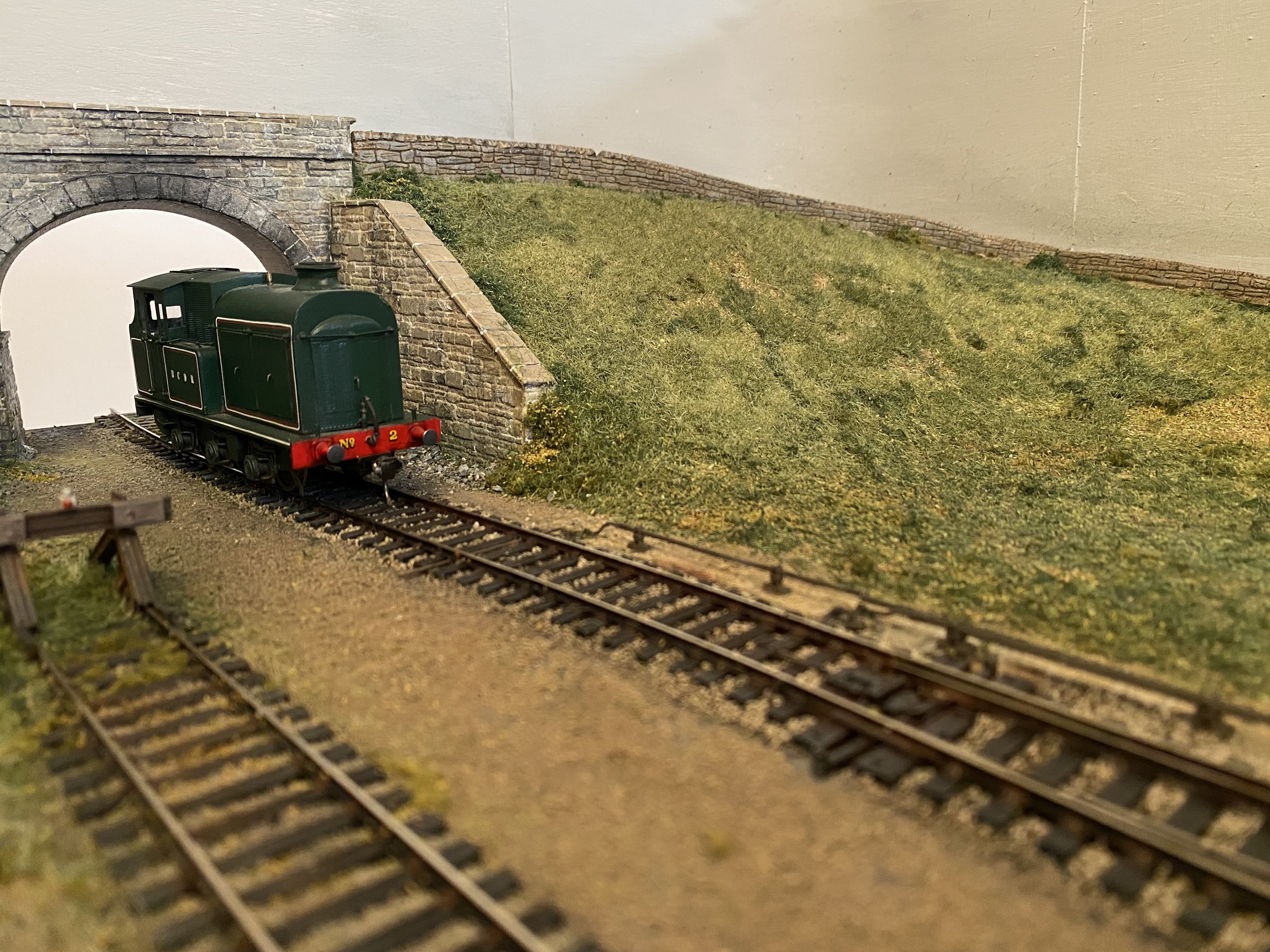

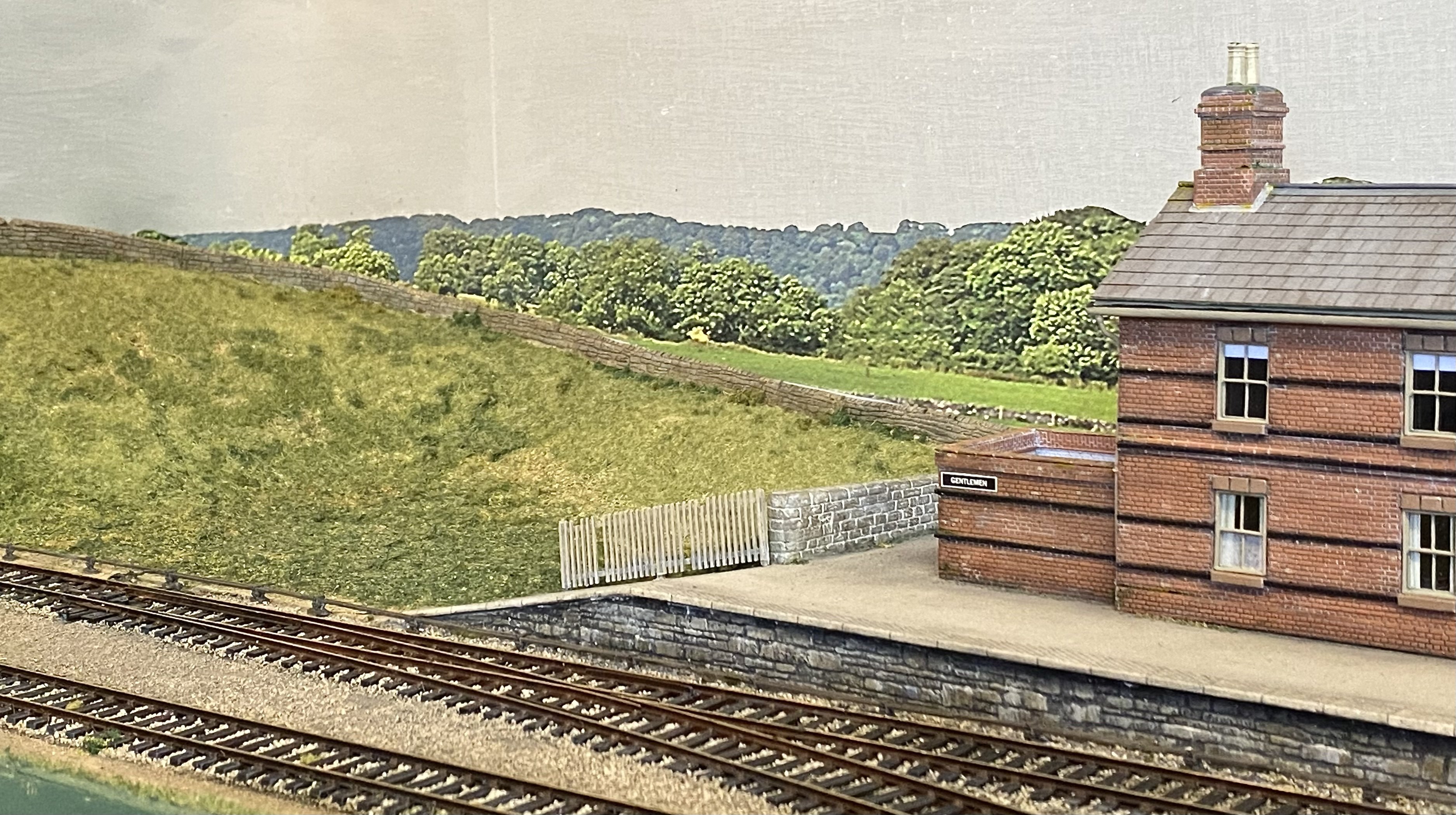

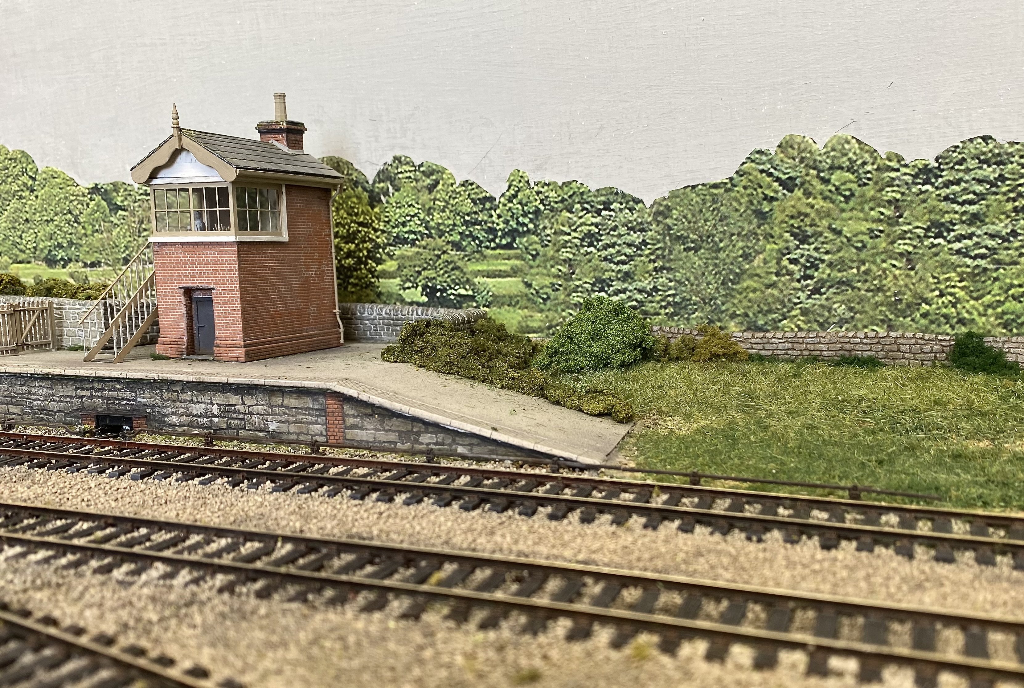

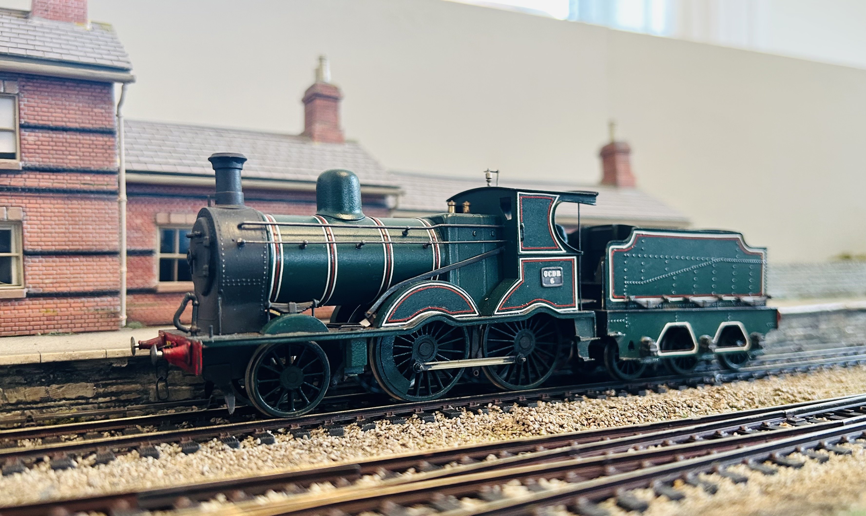

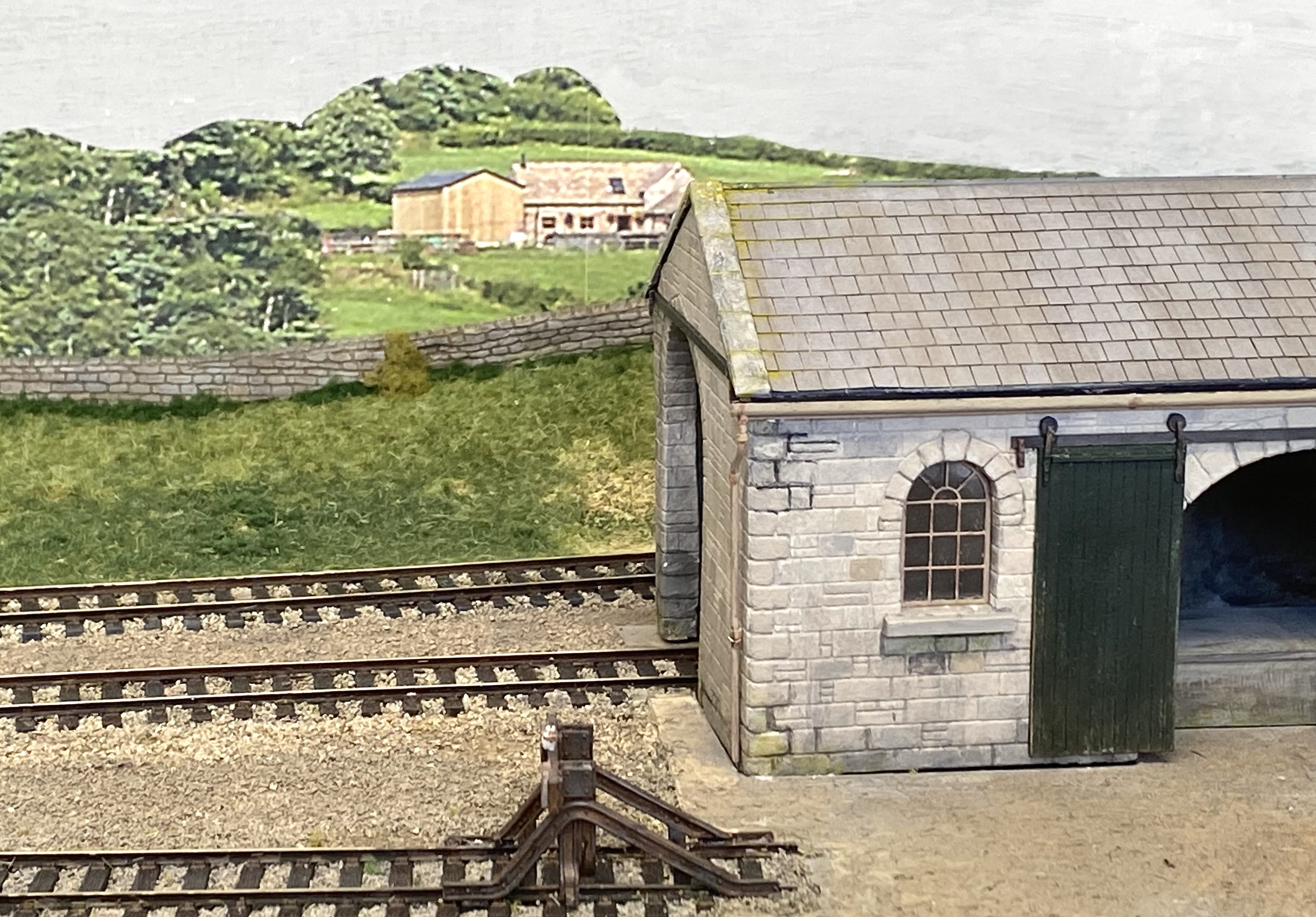

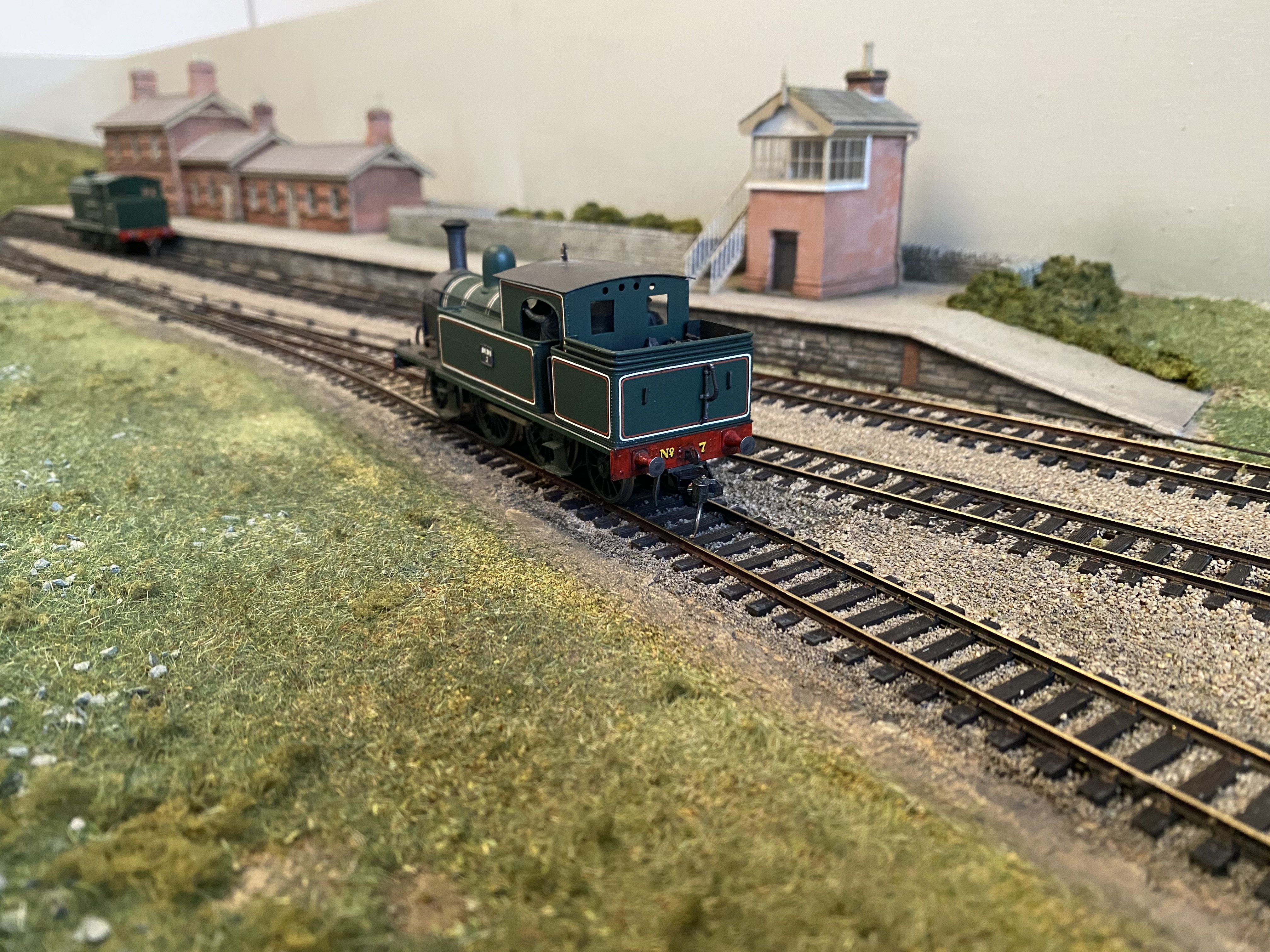

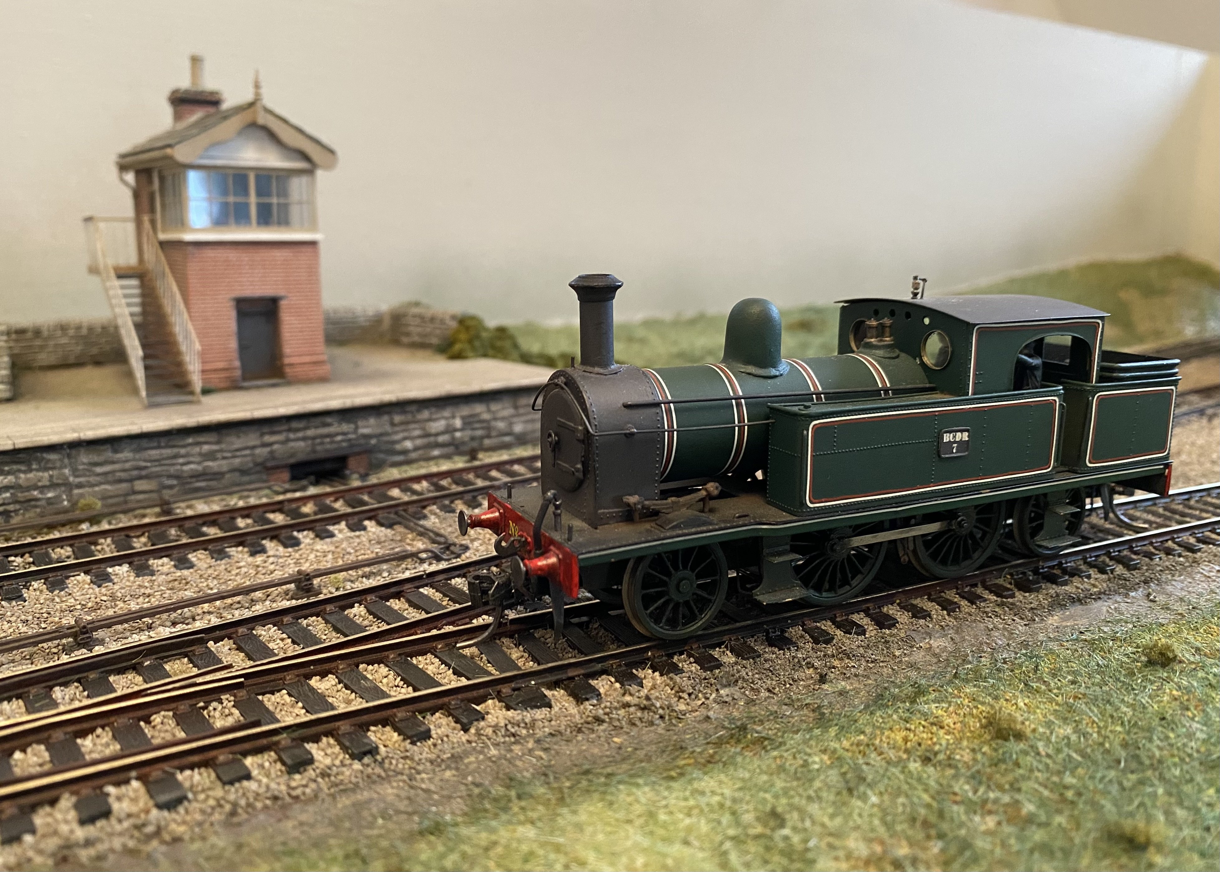

Tullygrainey Posted August 20 Author Posted August 20 The landscaping on Kilmore has come on by leaps and bounds over the last three days. A few of those leaps were in the wrong direction mind you, with static grass getting everywhere it shouldn't and scatter clogging up the points. And when I finally stopped for breath and looked at the result last night, I hated it. Far too bright - more toy town than County Down. This morning I mixed a thin dark green wash of acrylic paint (Tamiya XF11 green and XF1 black) and airbrushed the vegetation - the paint flow dialled right back to produce a barely visible mist. It did the trick, taking the technicolour edge off the landscape and toning the whole thing down a bit. I'm much happier with it now. A few more pics to supplement Patrick's portfolio... 10 6
Galteemore Posted August 20 Posted August 20 Fab Alan. I think Iain Rice used to employ such a wash over everything to blend it all together 1
Tullygrainey Posted August 20 Author Posted August 20 44 minutes ago, Galteemore said: Fab Alan. I think Iain Rice used to employ such a wash over everything to blend it all together I think you're right David. He was a remarkable innovator. So many of his ideas are now standard practice, though the one that probably doesn't have so many adherents is his recommended method for painting kit or scratch built chassis - clamp them in a vice, apply power to the motor and spray paint them while they run flat out, the logic being that the moving parts will free themselves of paint. Only the brave try that one. And I haven't. 1 3
David Holman Posted August 21 Posted August 21 Looking great, Alan. Not surprised, your colours have always been subtle and muted. Such things are very much in the eyes of the beholder, but certainly works for me. A range of textures too - really brings things to life. 1 1 1
Galteemore Posted August 21 Posted August 21 (edited) 1 hour ago, David Holman said: Looking great, Alan. Not surprised, your colours have always been subtle and muted. Such things are very much in the eyes of the beholder, but certainly works for me. A range of textures too - really brings things to life. What also helps, as with Peter Denny, John Ahern and indeed your own stuff David, is that everything on the layout from locos to buildings is painted by the same eye, so to speak. This gives a natural blending from the get go. Edited August 21 by Galteemore 1 2

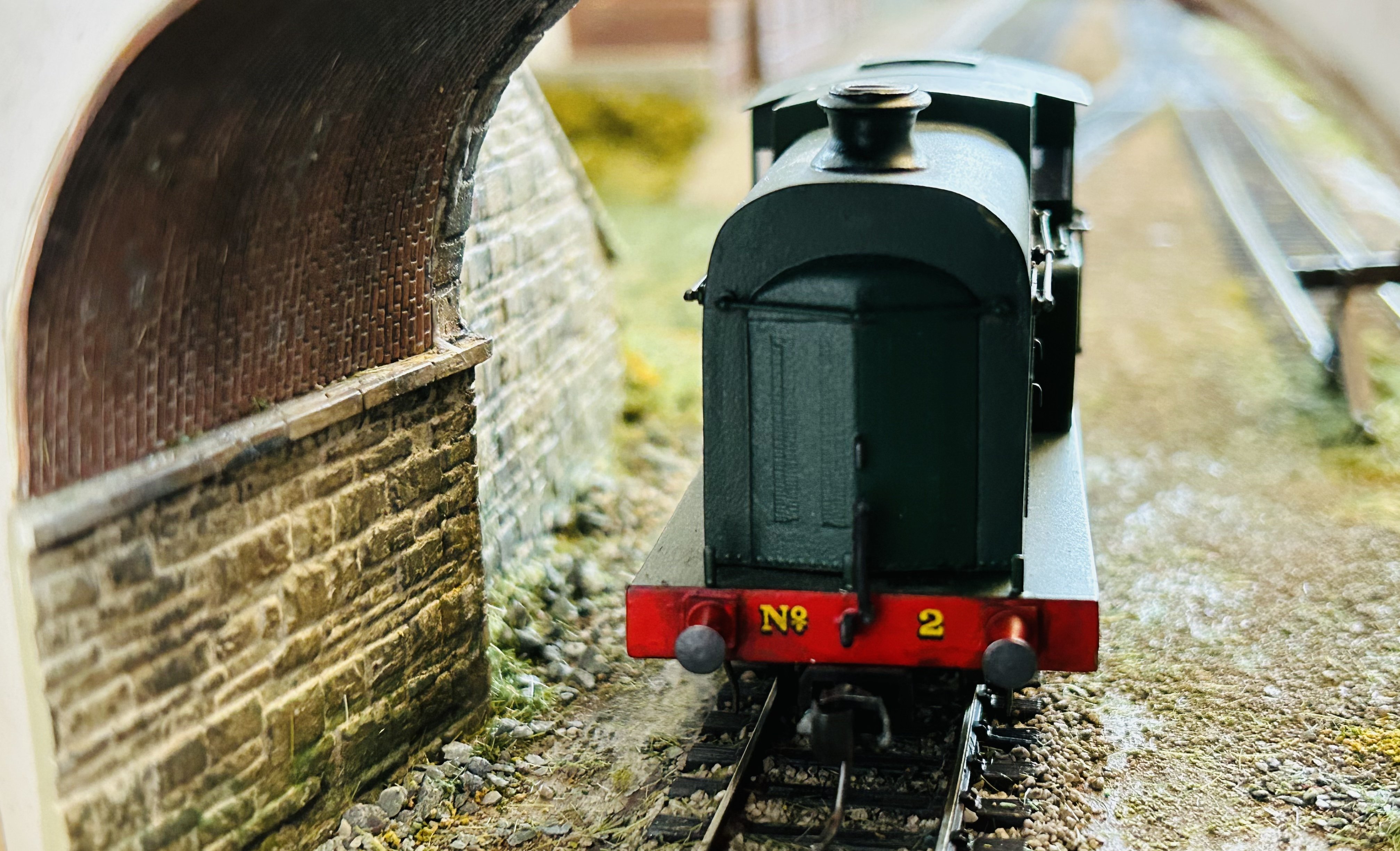

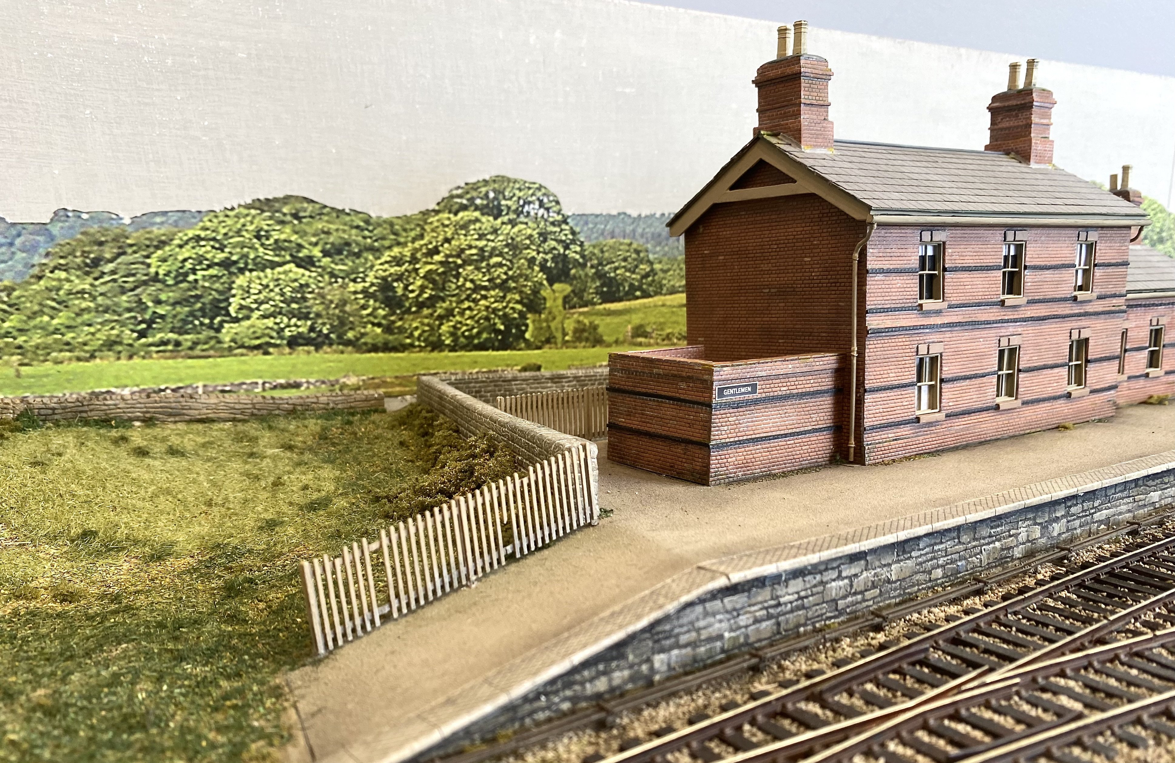

Popular Post Tullygrainey Posted August 29 Author Popular Post Posted August 29 We've had some heavy rain this week after a prolonged dry spell. It's had an amazing effect on the countryside around Kilmore. 18 5
skinner75 Posted August 29 Posted August 29 The stone wall really helps blend the backscene in with the layout! 3
Tullygrainey Posted August 29 Author Posted August 29 1 hour ago, skinner75 said: The stone wall really helps blend the backscene in with the layout! Yes, it's quite a good way to deal with that particular problem. A hedge would do the job too. I think it works best when there's a small gap between the physical barrier and the back scene board. 2 1

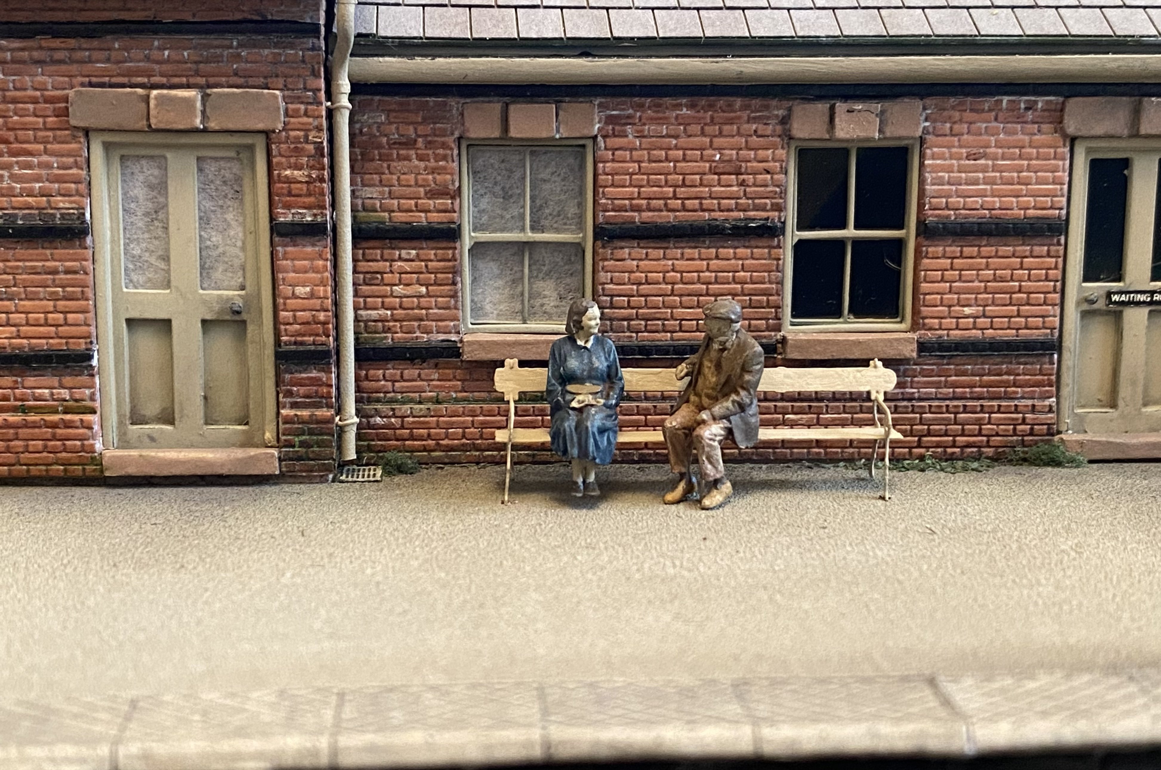

Tullygrainey Posted September 6 Author Posted September 6 Mr and Mrs McQuillan who patiently waited for the 7mm narrow gauge train at The Stone Yard recently decided to move house and now they wait for a different train on the platform at Kilmore. Yes..., they've downsized. I'll get my coat. 10 2 3

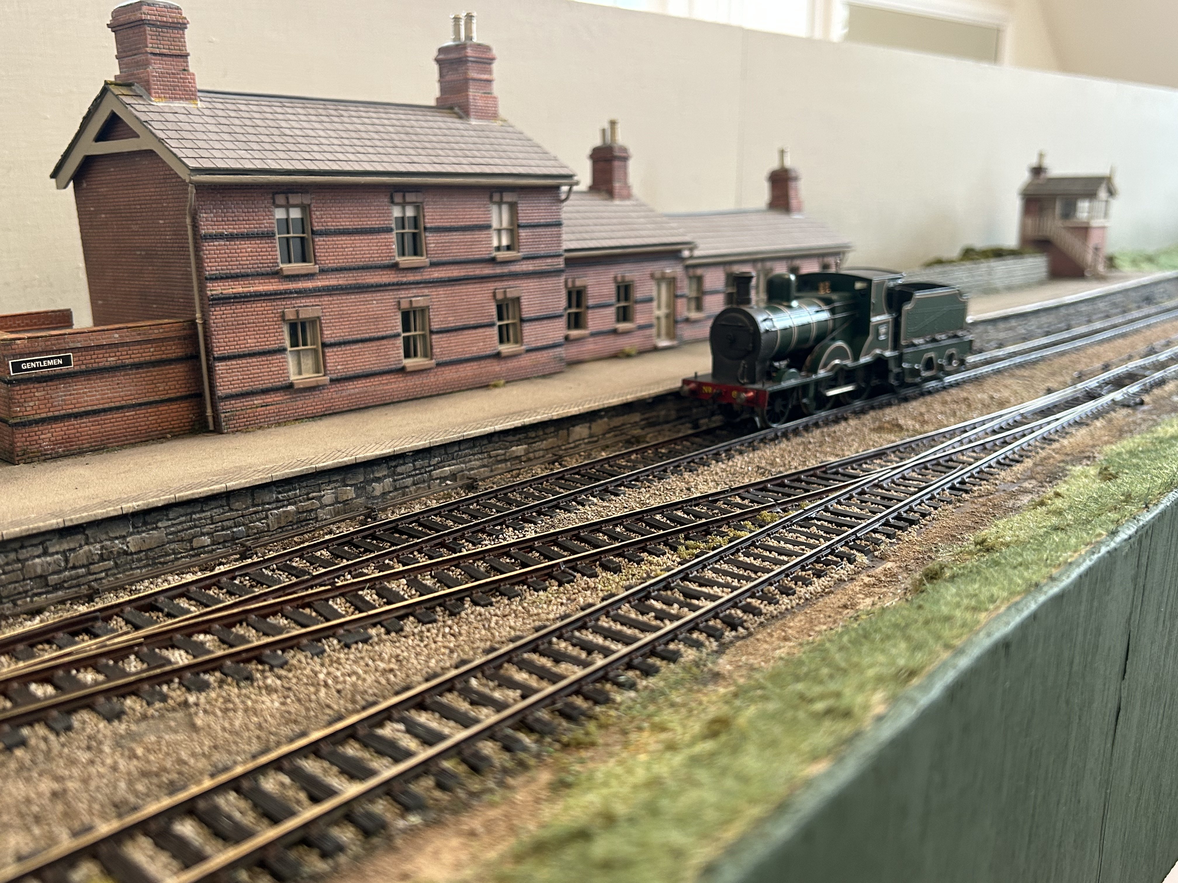

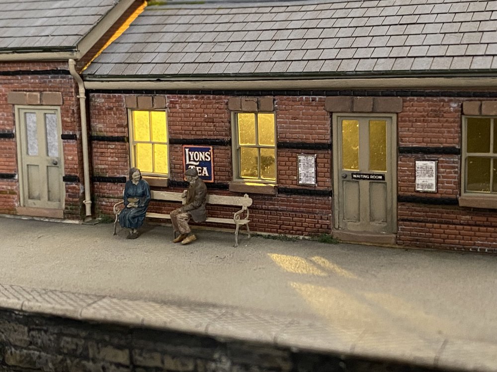

Tullygrainey Posted September 10 Author Posted September 10 Let there be light. Someone appears to have nicked the lead flashing from that roof. That needs seeing to. 11 3
derek Posted September 11 Posted September 11 21 hours ago, Tullygrainey said: Let there be light. Someone appears to have nicked the lead flashing from that roof. That needs seeing to. Photo of the station is just amazing, with light falling on to the platform. Blown away! (Apart from the missing flashing of course) Great stuff again Alan 1 1
