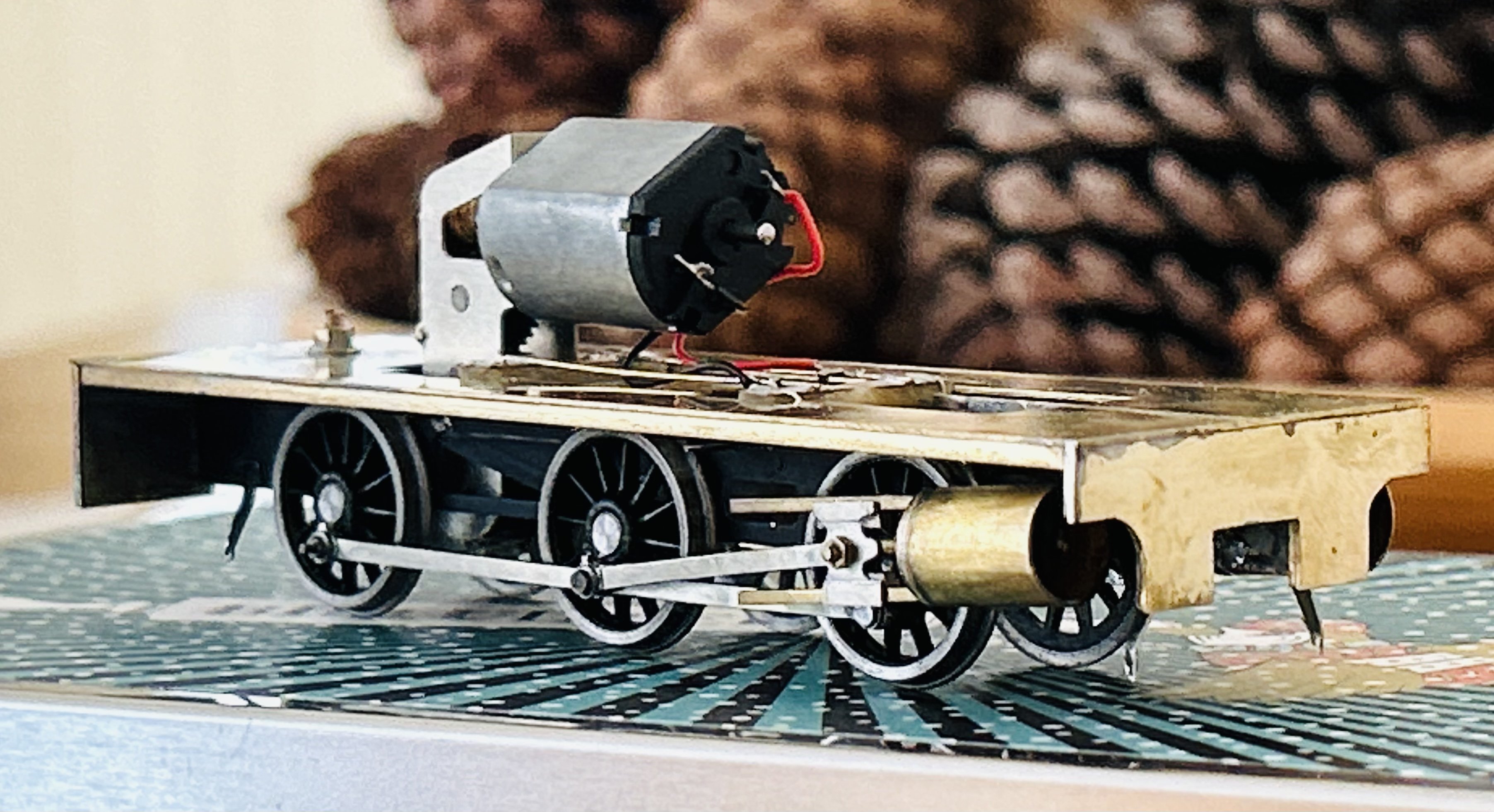

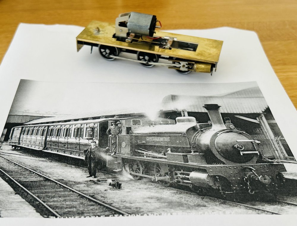

Patrick Davey Posted August 13 Author Posted August 13 (edited) Delighted to meet ‘The Countess’ tonight, or at least her chassis and running plate! @Tullygrainey Alan is making great progress with our joint project to build Ballycastle Railway loco No. 2 ‘Countess of Antrim’ for Capecastle 2. I’ll probably spoil it when I try building the rest of it Thanks Alan - your precision is, as always, remarkable! Edited August 13 by Patrick Davey 10
Tullygrainey Posted August 14 Posted August 14 I have every confidence in you Patrick. It'll be grand! 1

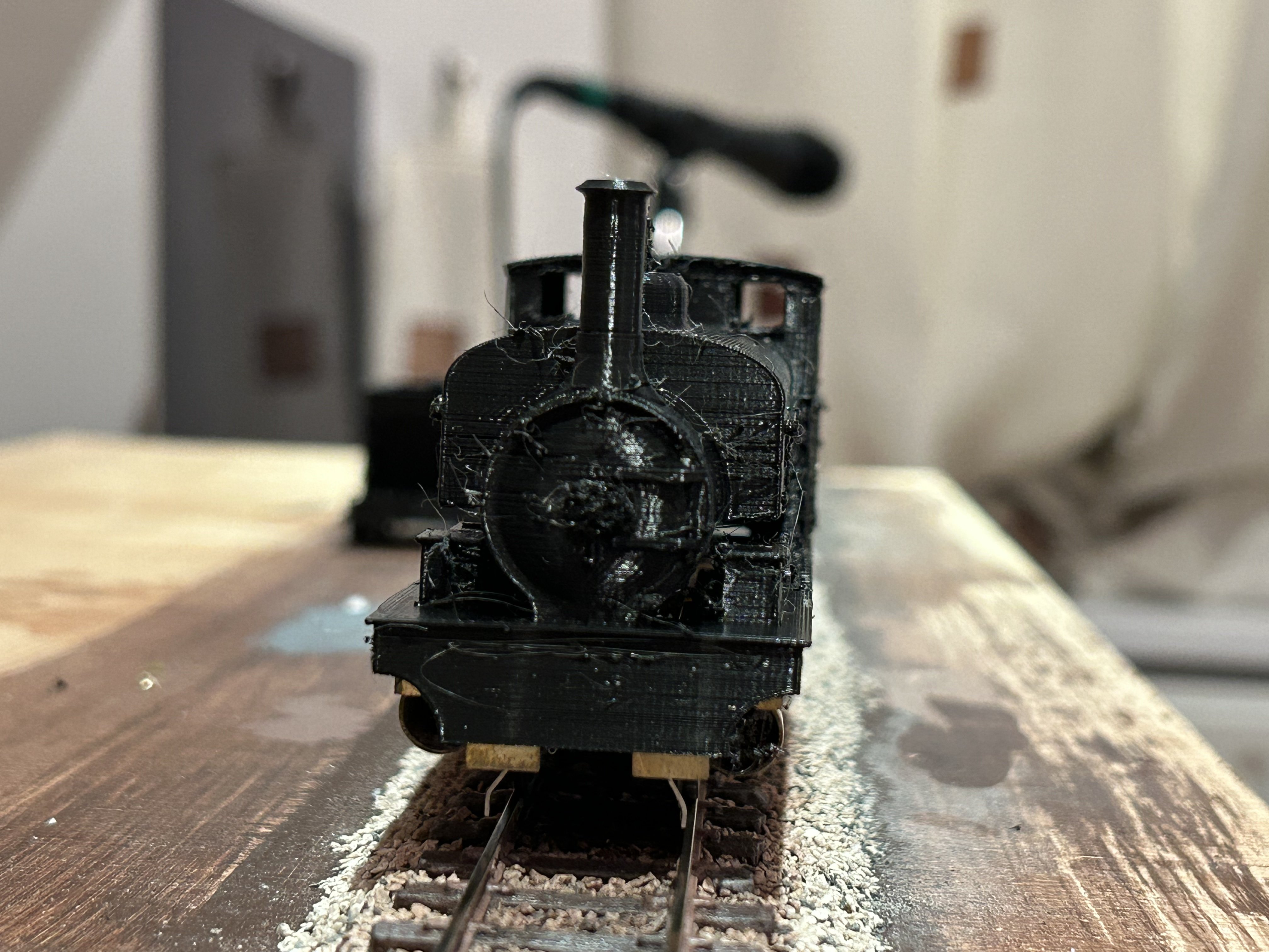

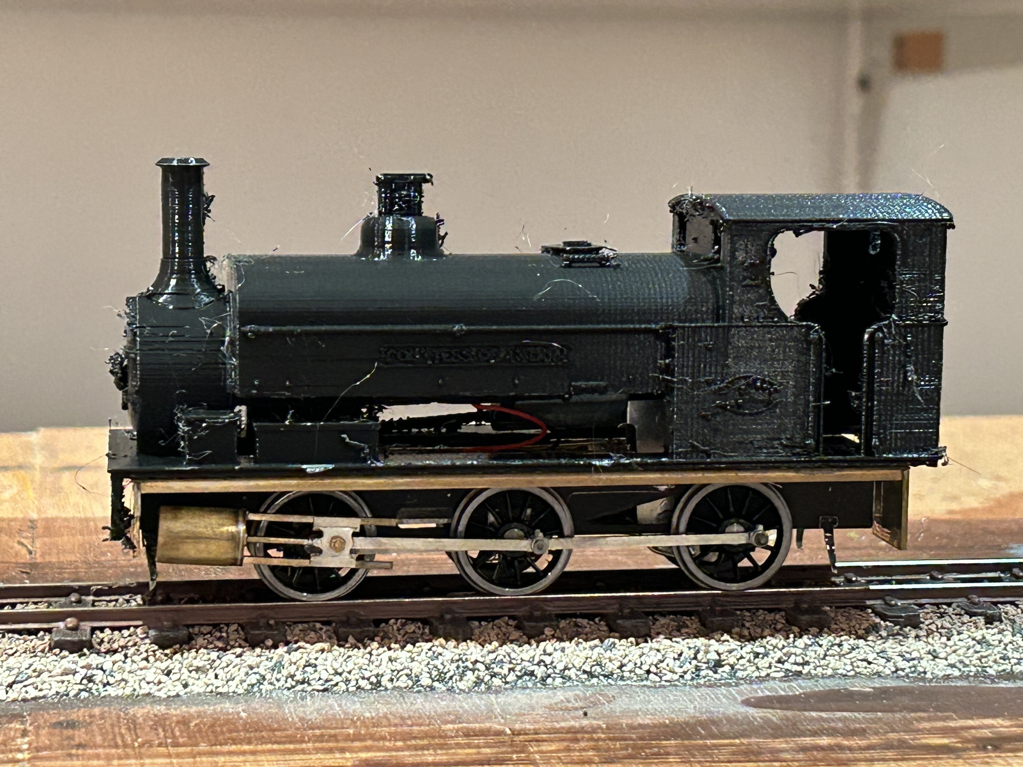

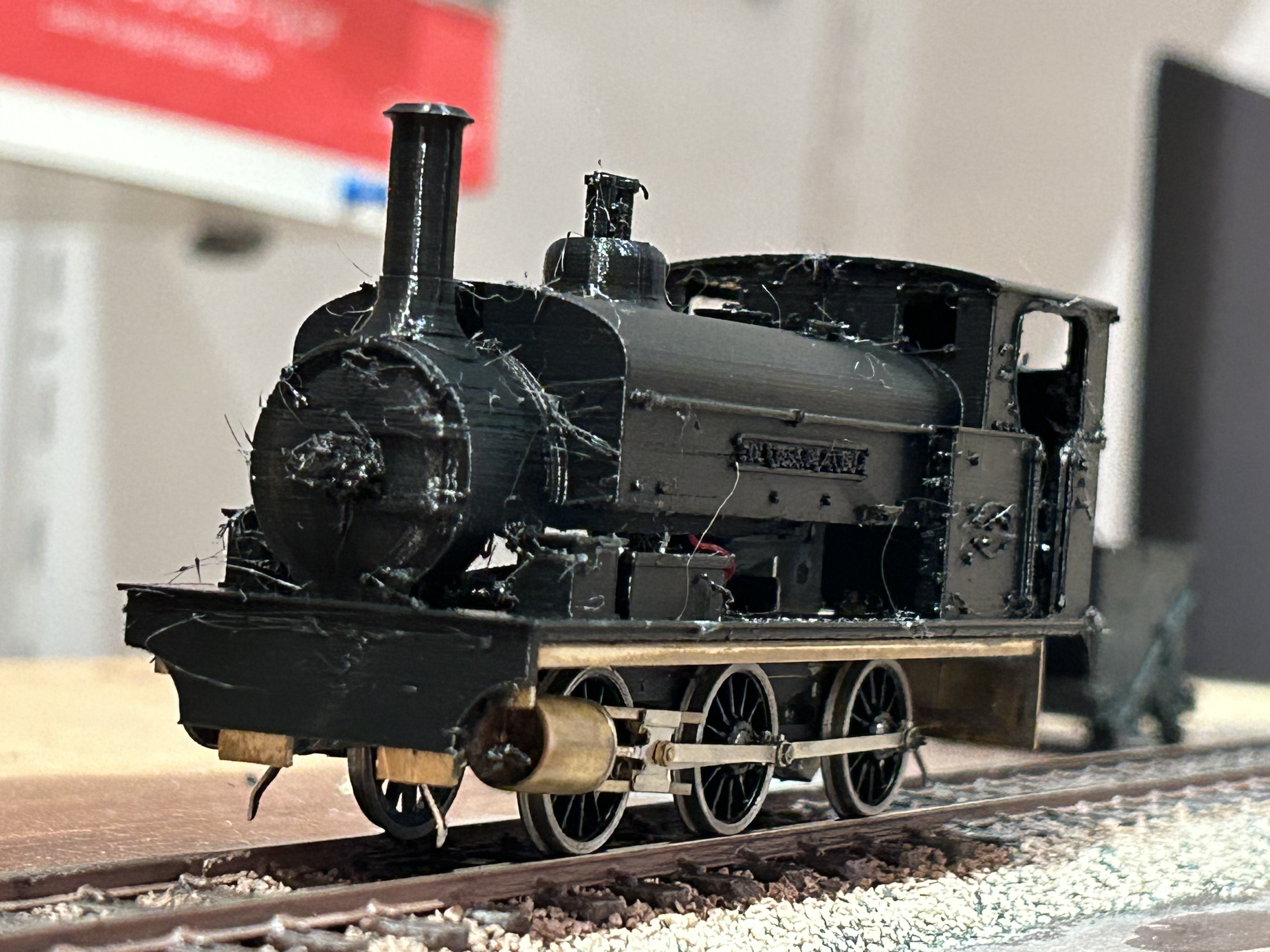

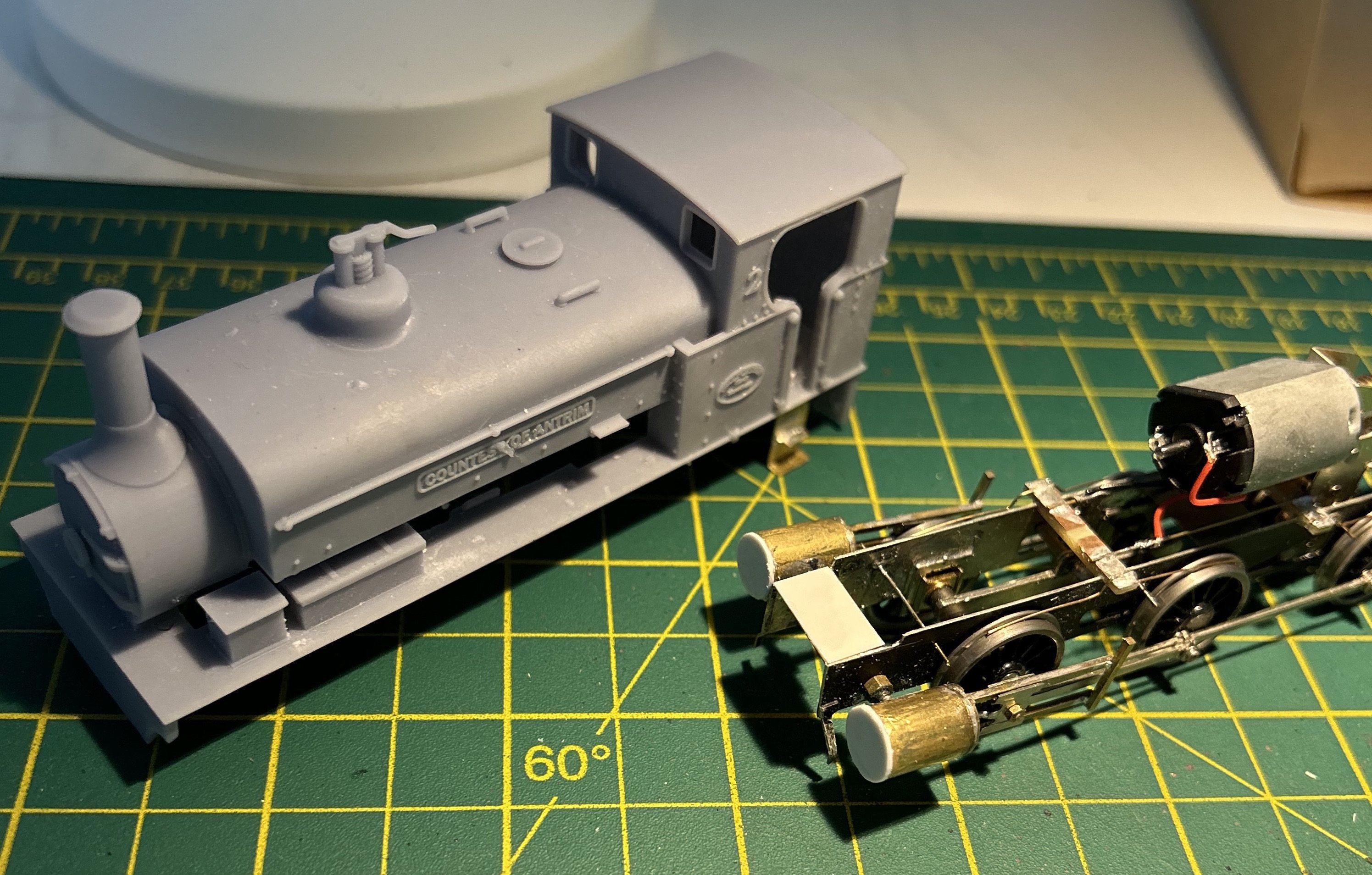

Patrick Davey Posted August 25 Author Posted August 25 (edited) SOMETHING EXCITING!!! A while back I noticed that @J-Mo Arts of this parish had done some amazing work creating a CAD image of the locomotive I’m hoping to have running on Capecastle, Ballycastle Railway No. 2 ‘Countess of Antrim’. He very kindly sent the CAD file to me and a friend had a go at printing it, and the results are very encouraging! The Countess has returned to Capecastle!! Alan and I are currently assessing the potential of this print as it was done using a mid-range printer, so it may not be fully useable as it is but it’s certainly a fantastic start!! With sincere thanks to @J-Mo Arts A short clip of The Countess running on Alan’s previously built brass chassis. I am being totally spoilt here, between @Tullygrainey Alan building the chassis and @J-Mo Arts providing the body! FullSizeRender.MOV Edited August 25 by Patrick Davey 7 2

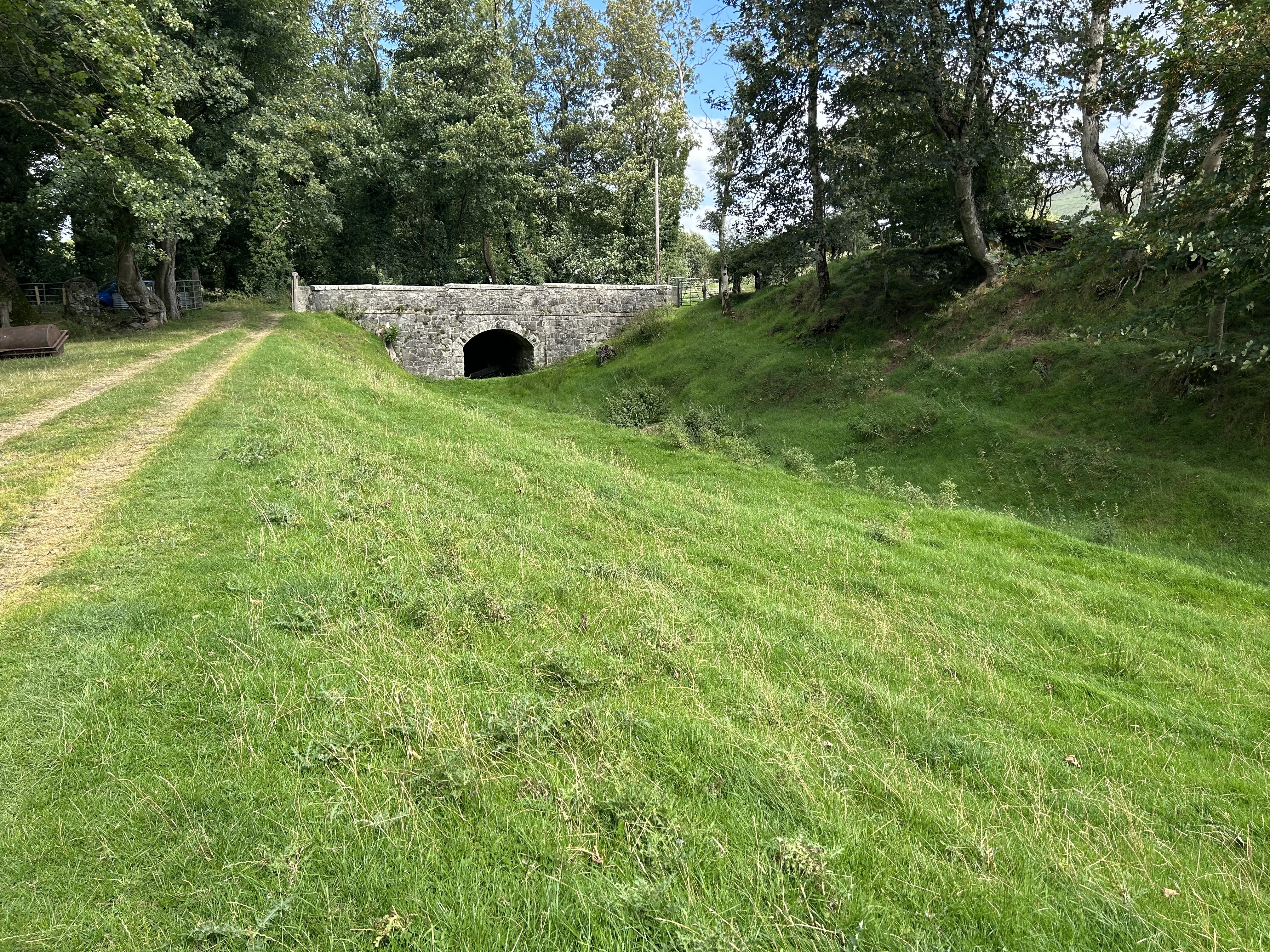

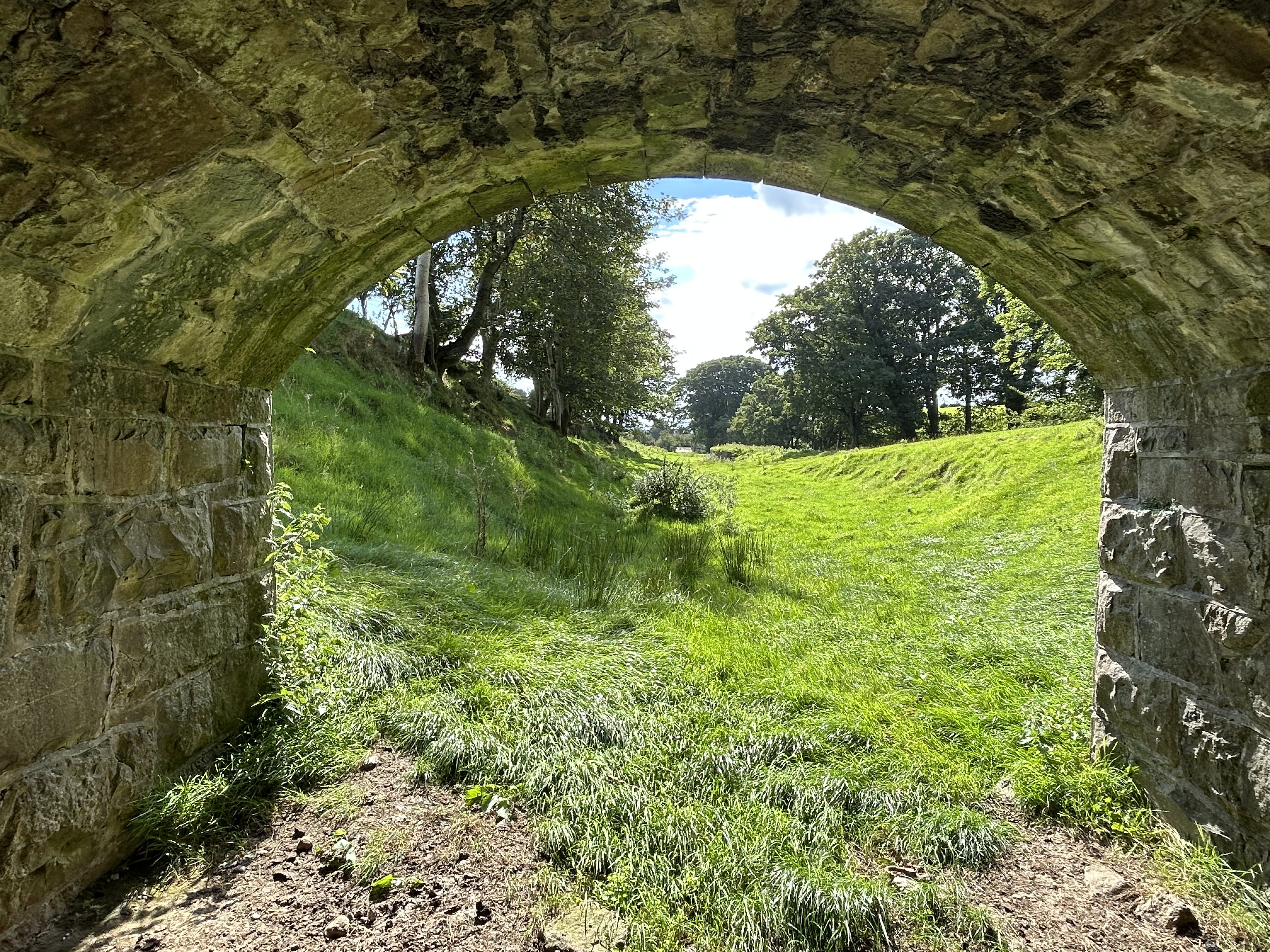

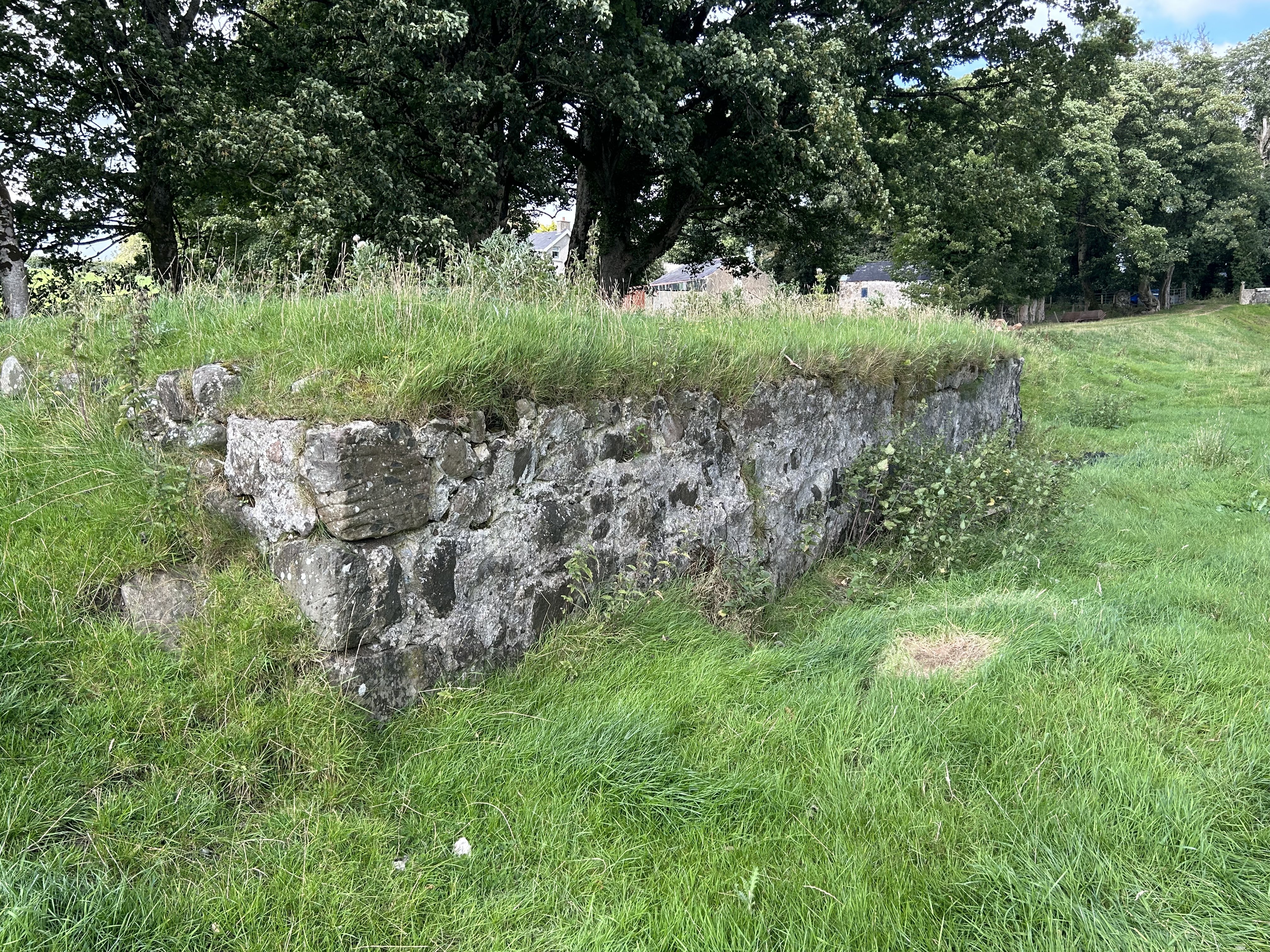

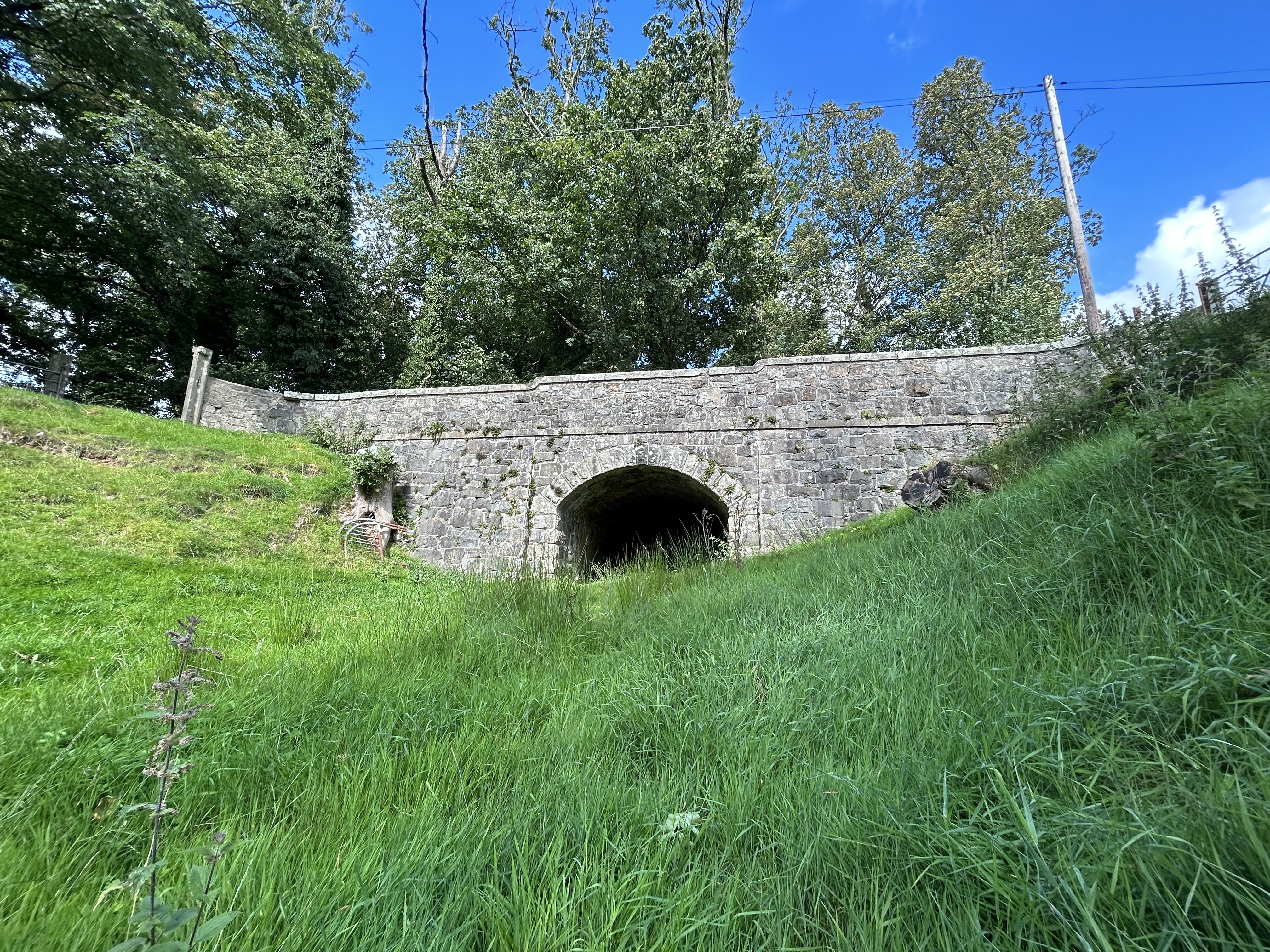

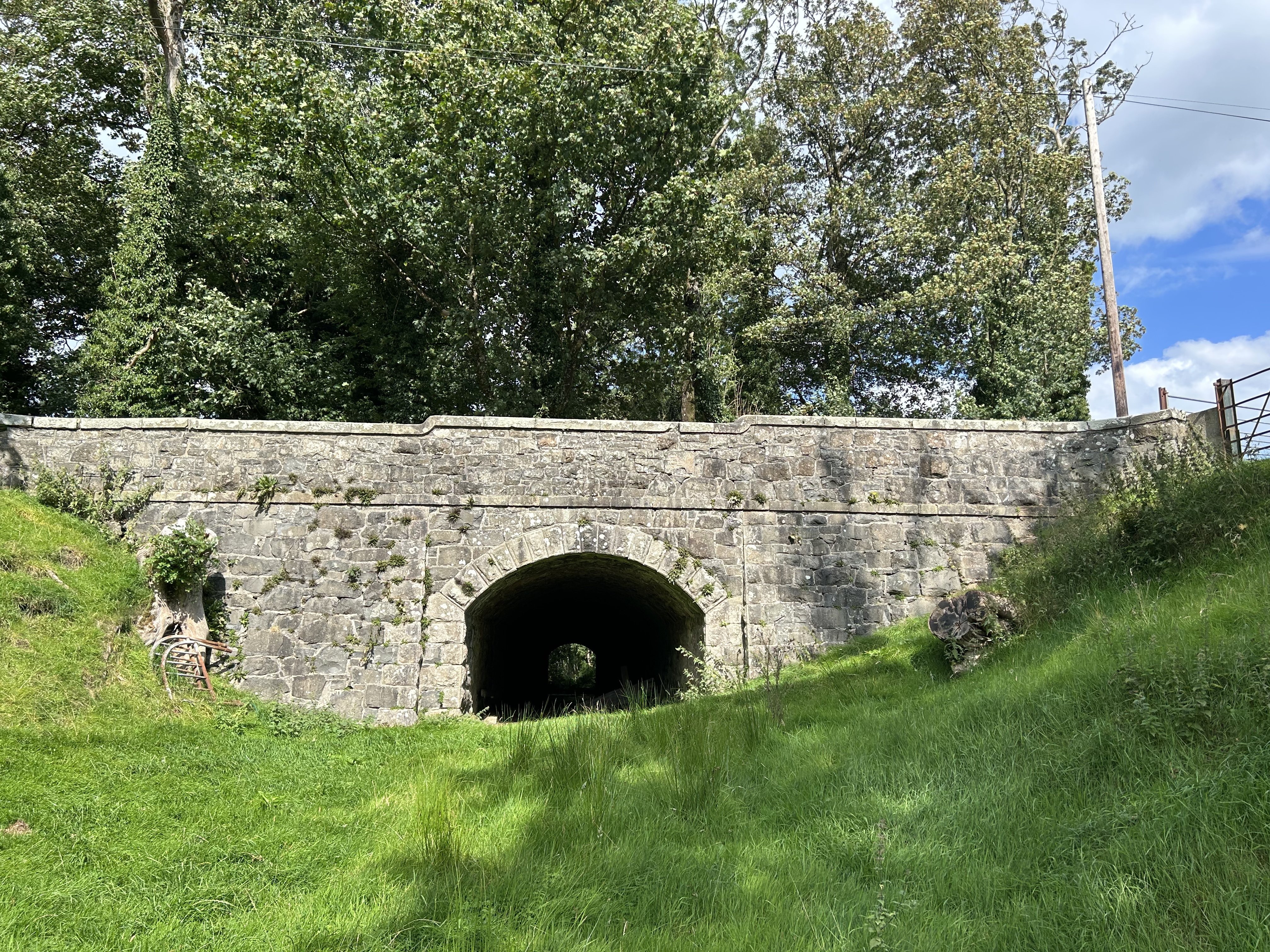

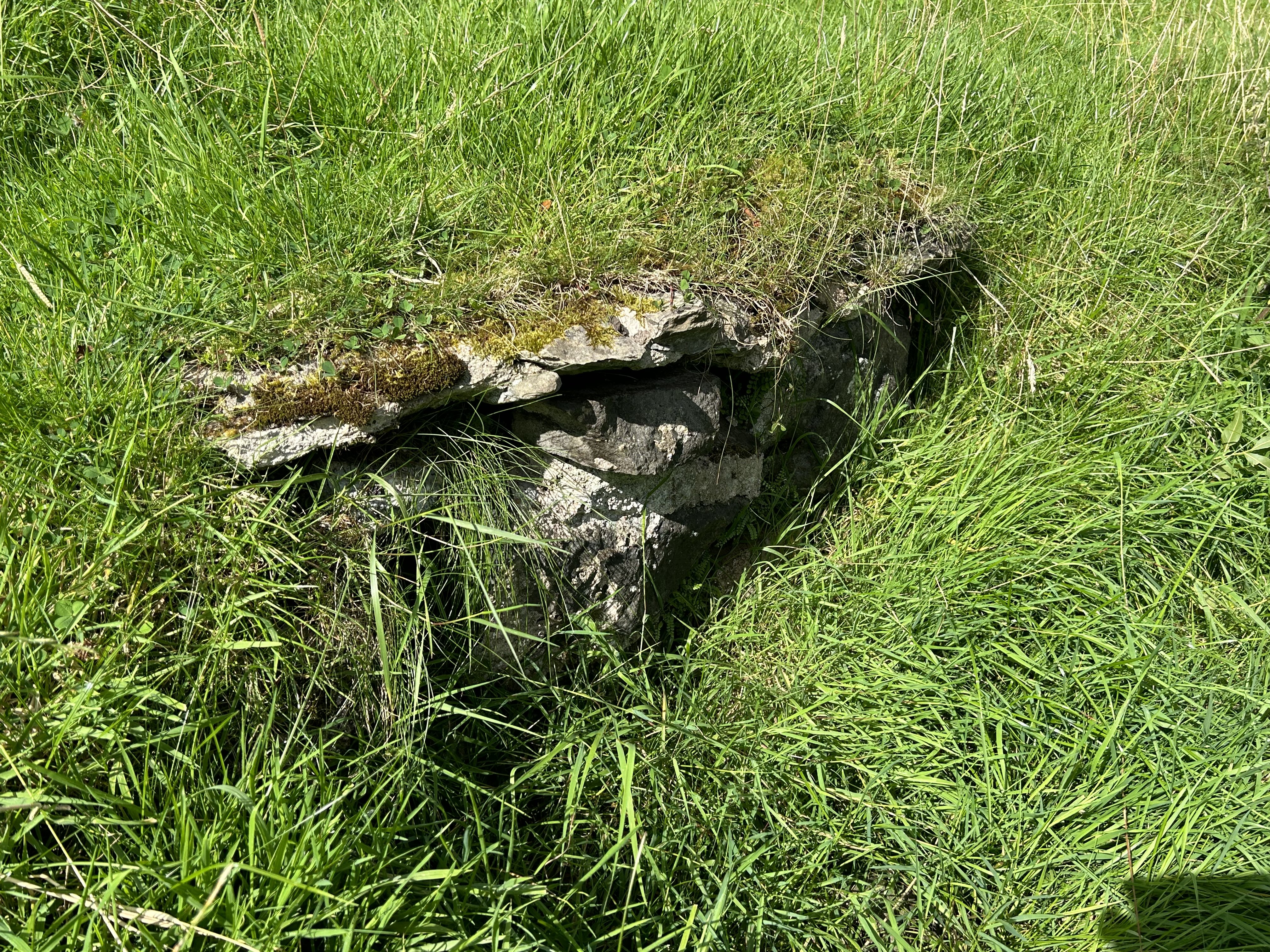

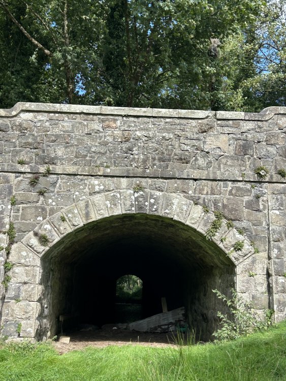

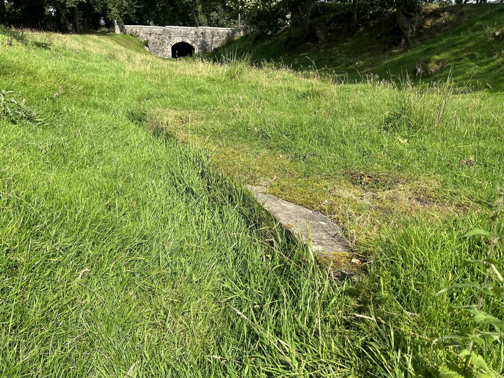

Patrick Davey Posted August 25 Author Posted August 25 Coincidentally, I happened to be at Capecastle today and with the owner’s kind permission, I took some more photographs. 9
Galteemore Posted August 25 Posted August 25 1 hour ago, Patrick Davey said: SOMETHING EXCITING!!! A while back I noticed that @J-Mo Arts of this parish had done some amazing work creating a CAD image of the locomotive I’m hoping to have running on Capecastle, Ballycastle Railway No. 2 ‘Countess of Antrim’. He very kindly sent the CAD file to me and a friend had a go at printing it, and the results are very encouraging! The Countess has returned to Capecastle!! Alan and I are currently assessing the potential of this print as it was done using a mid-range printer, so it may not be fully useable as it is but it’s certainly a fantastic start!! With sincere thanks to @J-Mo Arts A quick clip of The Countess running on Alan’s previously built brass chassis. I am being totally spoilt here, between @Tullygrainey Alan building the chassis and @J-Mo Arts providing the body! FullSizeRender.MOV 35.09 MB · 0 downloads 1 2
J-Mo Arts Posted August 26 Posted August 26 Very pleased to be able to contribute to what is shaping up to be a fantastic project. Capecastle is a very modellable scene, and in fact where I was planning on modelling to run my own No2! Very much enjoying watching this develop! 3 1
jhb171achill Posted August 26 Posted August 26 This is pure GOLD DUST!!! The Irish narrow gauge is awash with amazing potential for models. This just proves it! 1

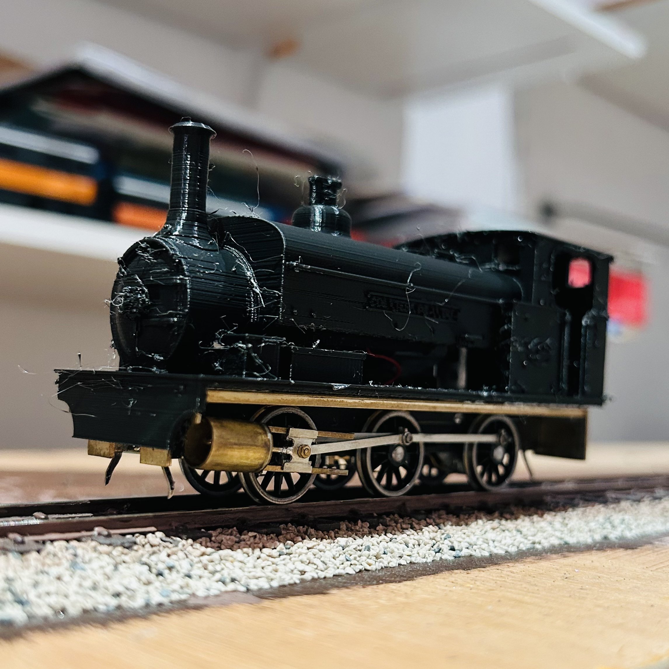

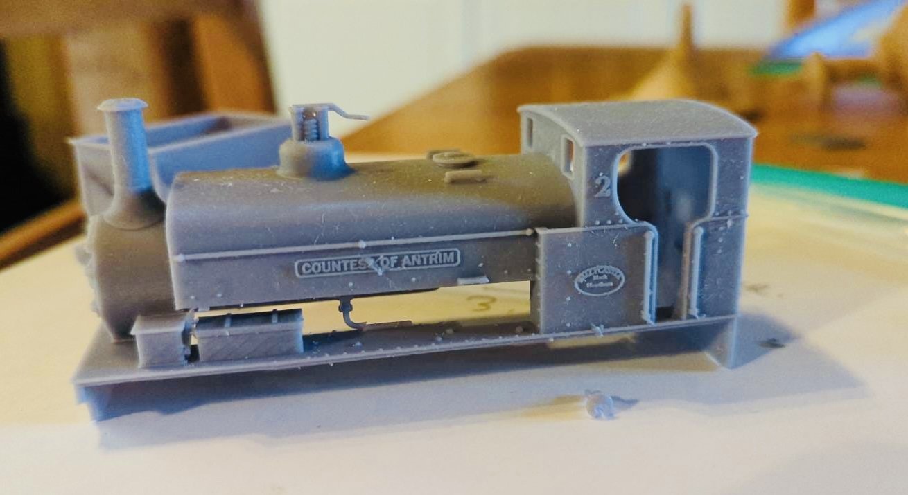

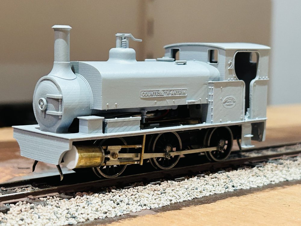

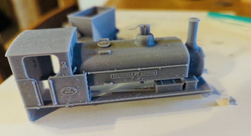

Patrick Davey Posted August 30 Author Posted August 30 Update on the 3D printing: The excellent file created by @J-Mo Arts has now been printed on a resin printer - quite an improvement from the previous print! 12 5
Galteemore Posted August 30 Posted August 30 That looks lovely. Great design and has turned out well. 2 2

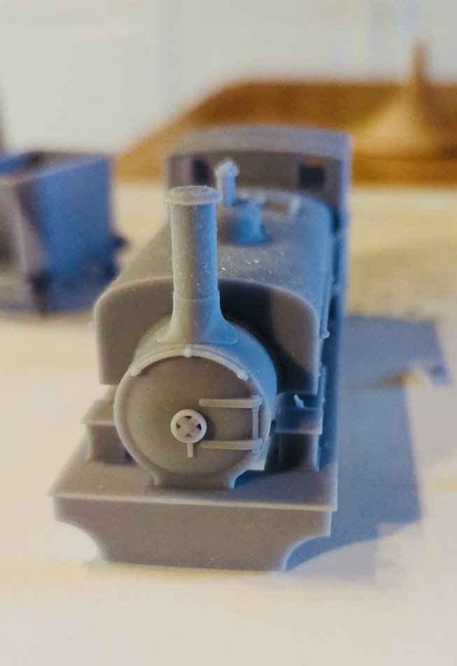

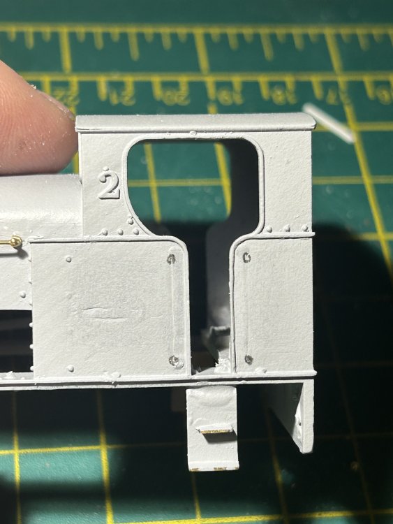

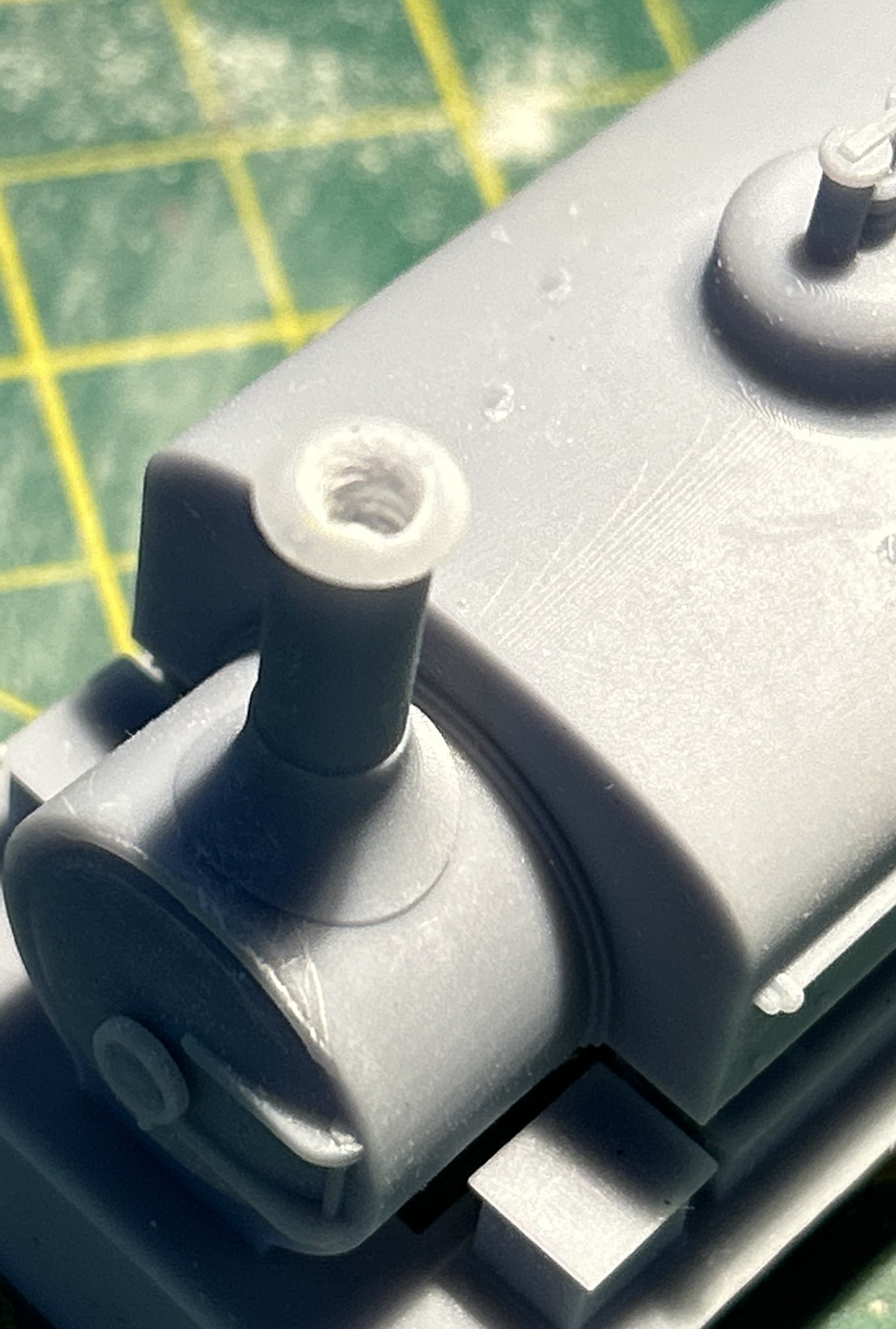

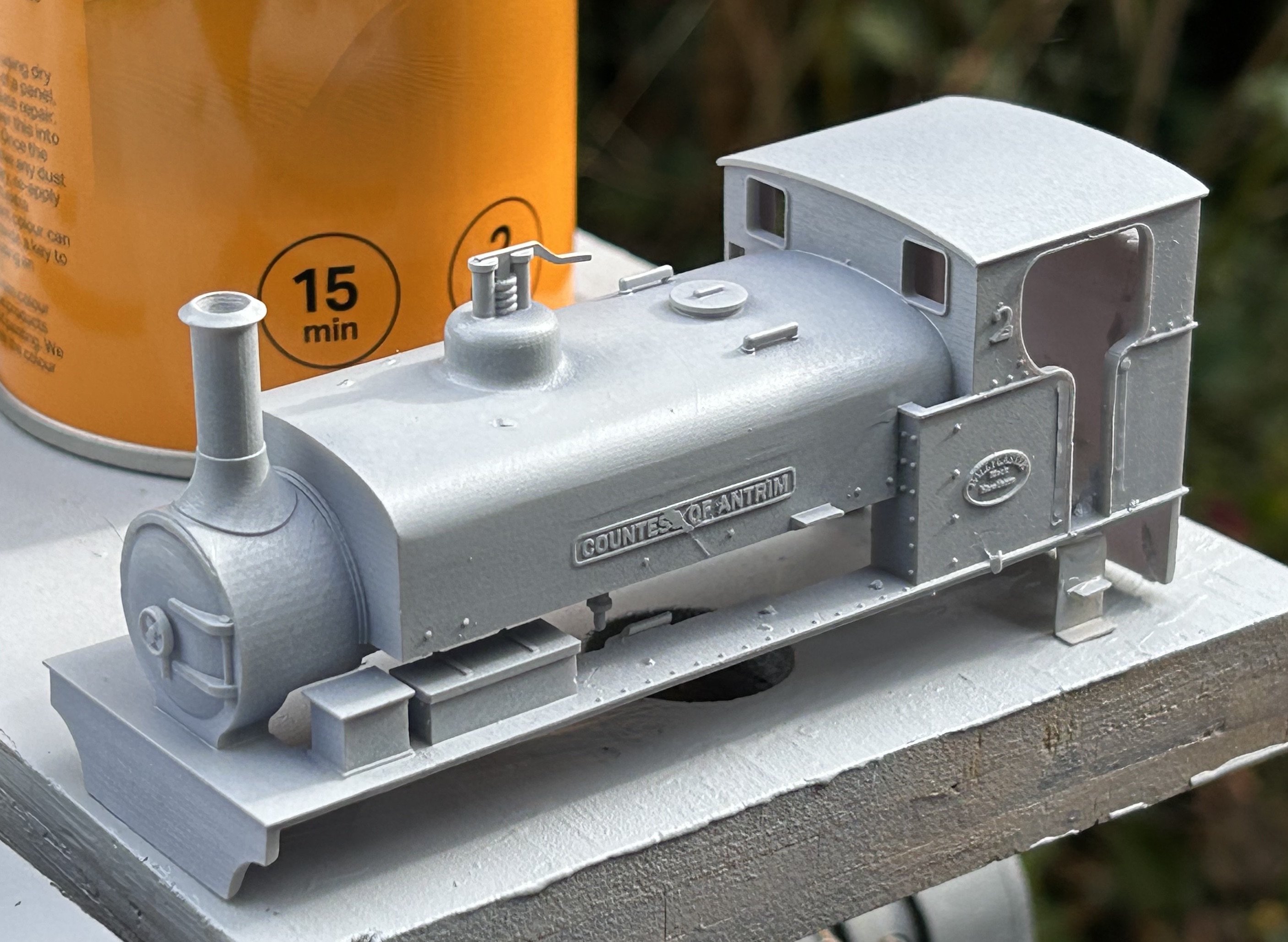

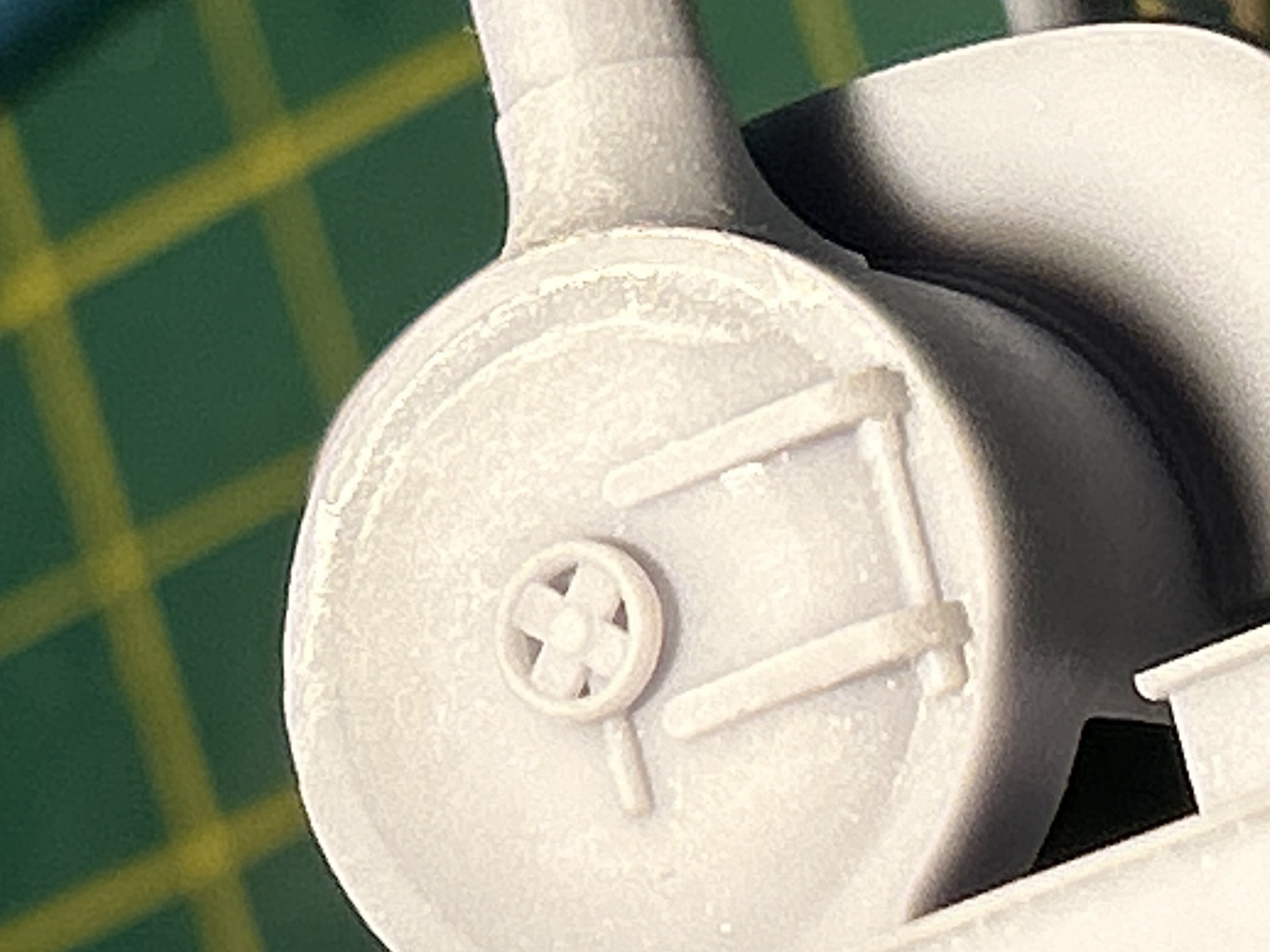

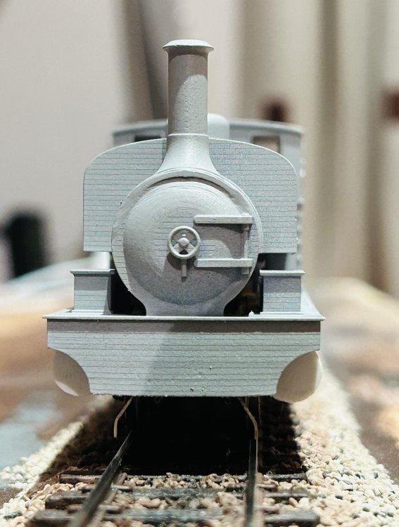

Patrick Davey Posted October 6 Author Posted October 6 (edited) Working now on the Ballycastle Railway's 'Countess of Antrim' - specifically preparing the superb 3D print from @J-Mo Arts for painting. I have decided to remove the moulded handrails and replace them with separate fittings, and there will also be etched nameplates added to finish off the locomotive. The chimney has also been filed out. The resin is quite brittle but files off easily. A spray of Halford's grey primer shows up areas that require further attention. As always, continued thanks to Alan @Tullygrainey for his ongoing assistance! Edited October 6 by Patrick Davey 13

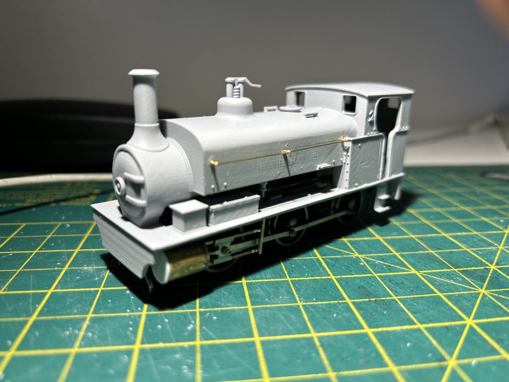

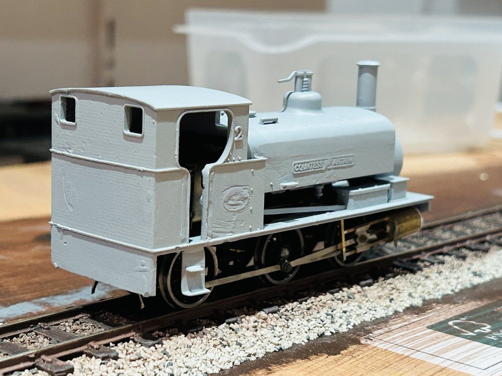

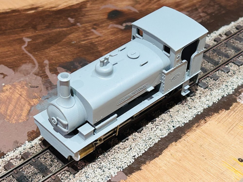

Patrick Davey Posted October 8 Author Posted October 8 (edited) Ballycastle Railway 0-6-0st No. 2 ‘Countess of Antrim’ looking very neat after a few light coats of primer. With light sanding in between coats, I’m taking this slowly, so I don’t remove any of the important detail from the superb 3D print which was generously provided by Jamie @J-Mo Arts. I am however gradually removing the name plates and builder’s plates to make way for etched replacements, which I have ordered. The handrails are also being replaced with separately fitted ones. She looks great, sitting on the chassis, which was also generously provided by Alan @Tullygrainey. I’m researching all available information about the locomotive and constantly studying all available photographs, so with a bit of luck, the final product will do justice to the prototype. With many thanks once again to Jamie and Alan for making this easy for me! Edited October 8 by Patrick Davey 7
Patrick Davey Posted October 8 Author Posted October 8 Oops - I have just noticed a few places where I was a bit heavy with the sanding…… more patience (and maybe a bit of filler) required!!!

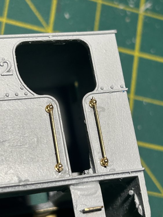

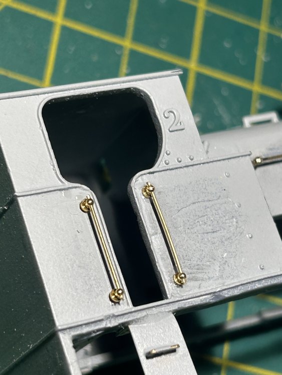

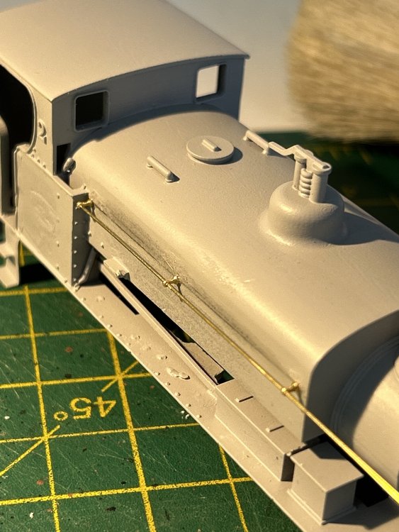

Patrick Davey Posted October 9 Author Posted October 9 I was totally out of my comfort zone today as I had a go at adding handrails to The Countess - it was definitely worth the effort to remove the moulded ones and add these, which were once again generously provided by Alan @Tullygrainey so thanks again to Alan for this and for his ongoing guidance! 11
Galteemore Posted October 9 Posted October 9 13 minutes ago, Patrick Davey said: I was totally out of my comfort zone today as I had a go at adding handrails to The Countess - it was definitely worth the effort to remove the moulded ones and add these, which were once again generously provided by Alan @Tullygrainey so thanks again to Alan for this and for his ongoing guidance! Yep, separate handrails are a game changer. Looks great - well done! 1 1
Tullygrainey Posted October 9 Posted October 9 19 minutes ago, Patrick Davey said: I was totally out of my comfort zone today as I had a go at adding handrails to The Countess - it was definitely worth the effort to remove the moulded ones and add these, which were once again generously provided by Alan @Tullygrainey so thanks again to Alan for this and for his ongoing guidance! Nice work Patrick! 1

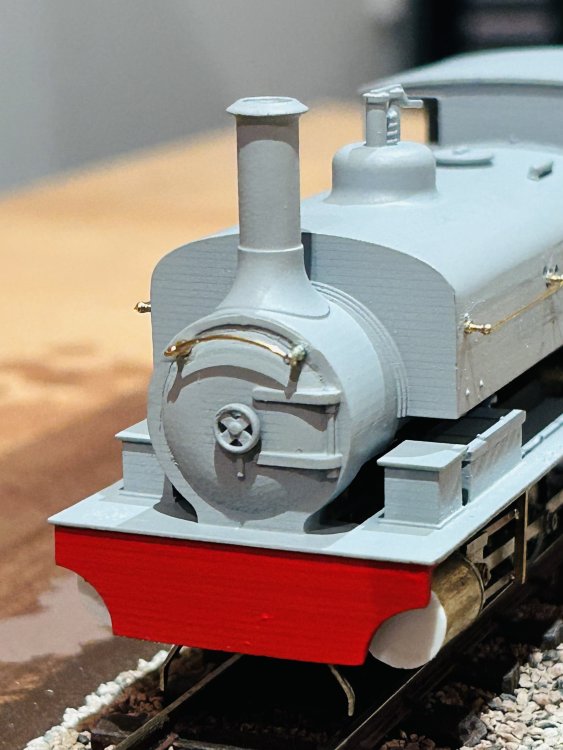

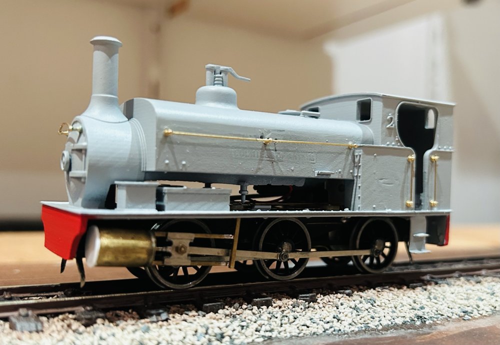

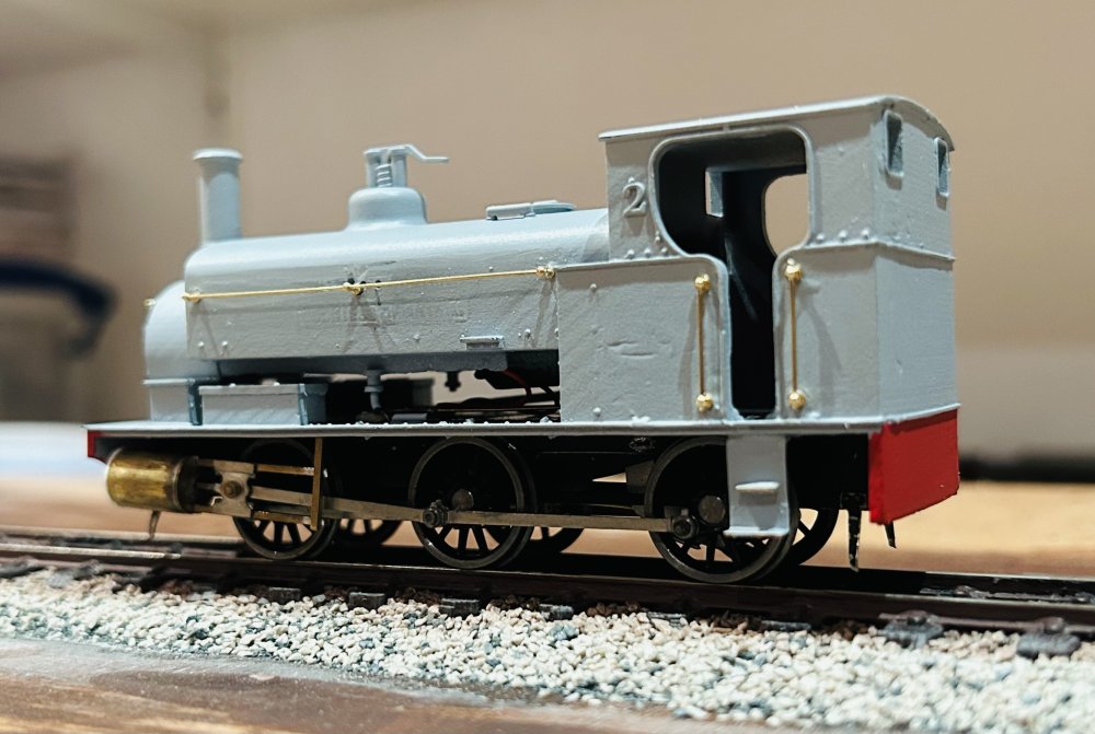

Patrick Davey Posted October 14 Author Posted October 14 The ‘Countess of Antrim’ now has all her separately fitted handrails. I knocked up a simple plasticard jig to try and make sure the handrail spacing was consistent….. this was reasonably successful! I have given the buffer beams an initial coat of red: this will be added to tomorrow, then masked, before I start spraying all over black. The handrails and other fittings will be picked out in gun metal, and the dome and window frames will eventually be brass. 12 2
Flying Snail Posted October 14 Posted October 14 She's looking well. The separately fitted handrails really top off whats already a very nice model. 2 1

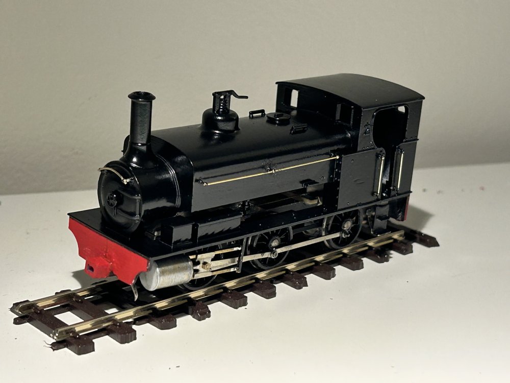

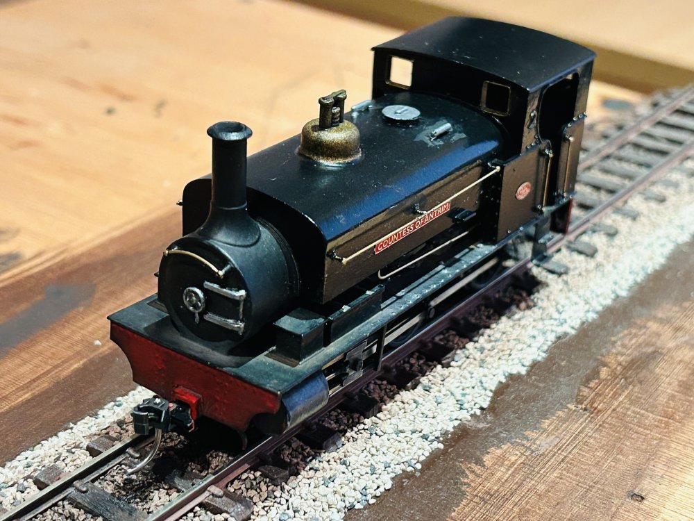

Patrick Davey Posted October 15 Author Posted October 15 I got a bit impatient today and couldn’t resist giving her ladyship some colours…. I have now put away the rattle can until the NEM pockets have been sorted. I have to admit though, the black looks pretty tasty!!! 7

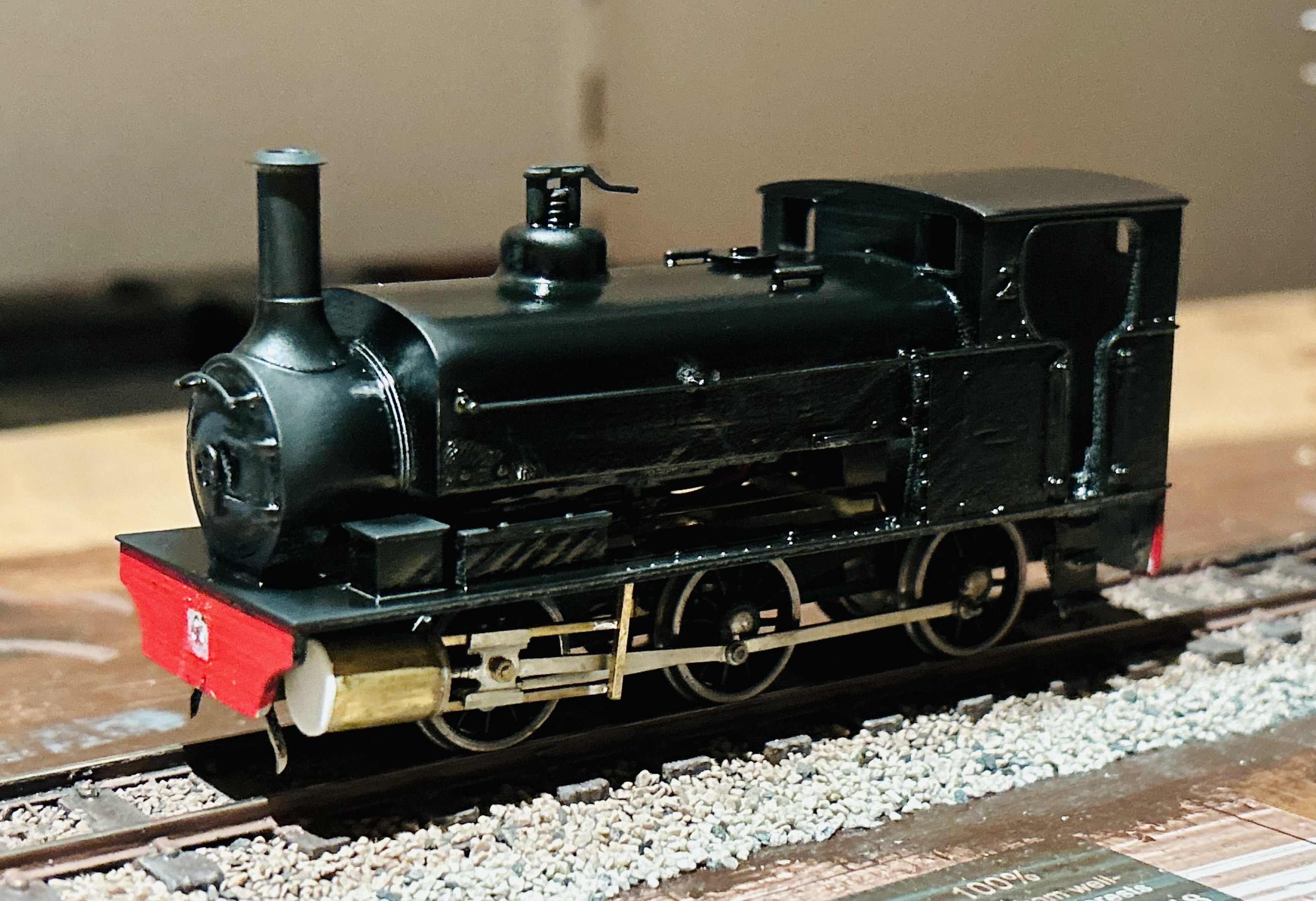

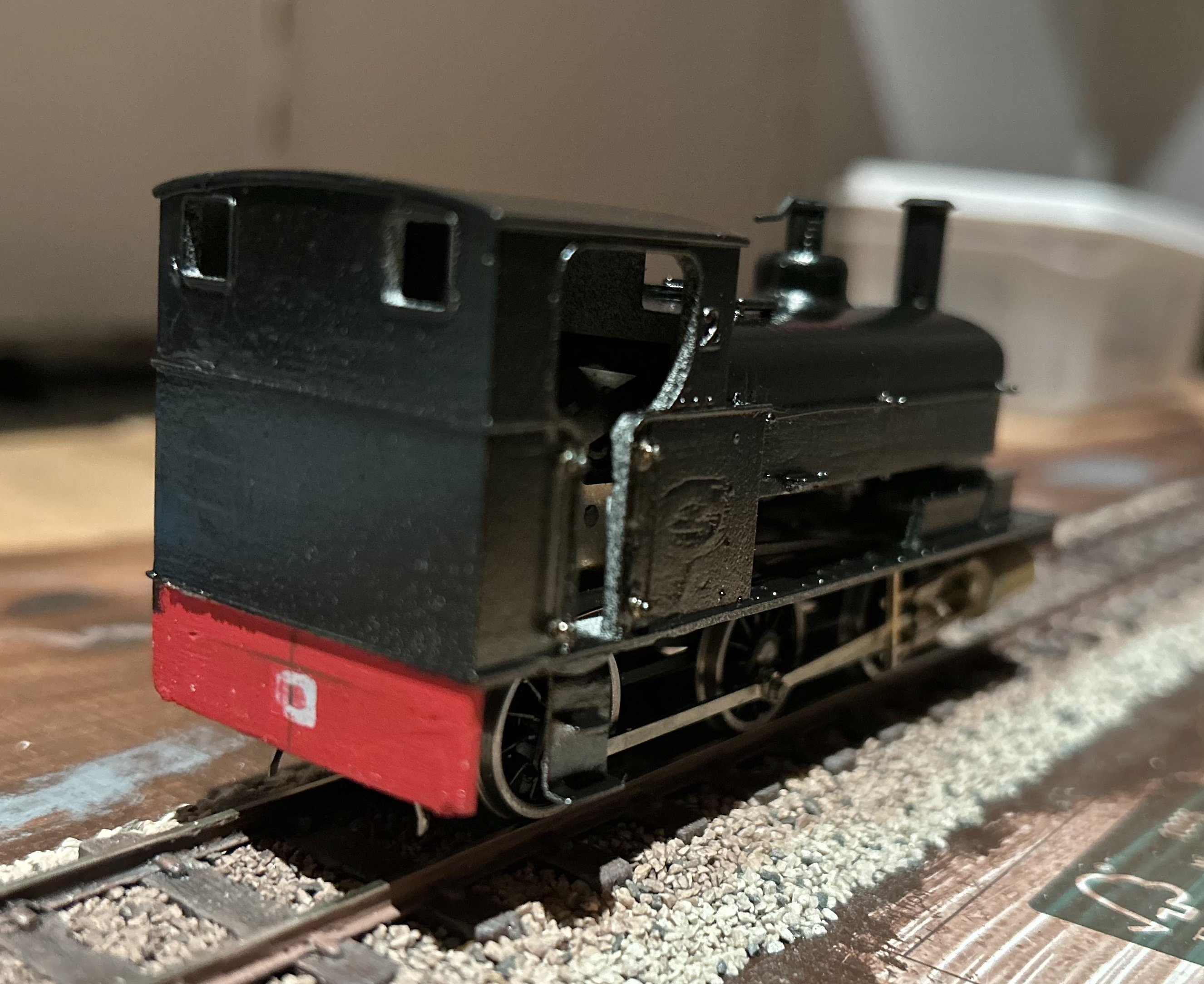

Patrick Davey Posted October 16 Author Posted October 16 Current status of the Countess - NEM pockets added, main painting complete, with just small details left. I was scraping the paint off the handrails prior to painting them, but I actually like them in brass so I might leave them? She hasn't been seen in over 100 years so who's to say they weren't brass Main black is Halford's Satin Black from a rattle can. 5 2
