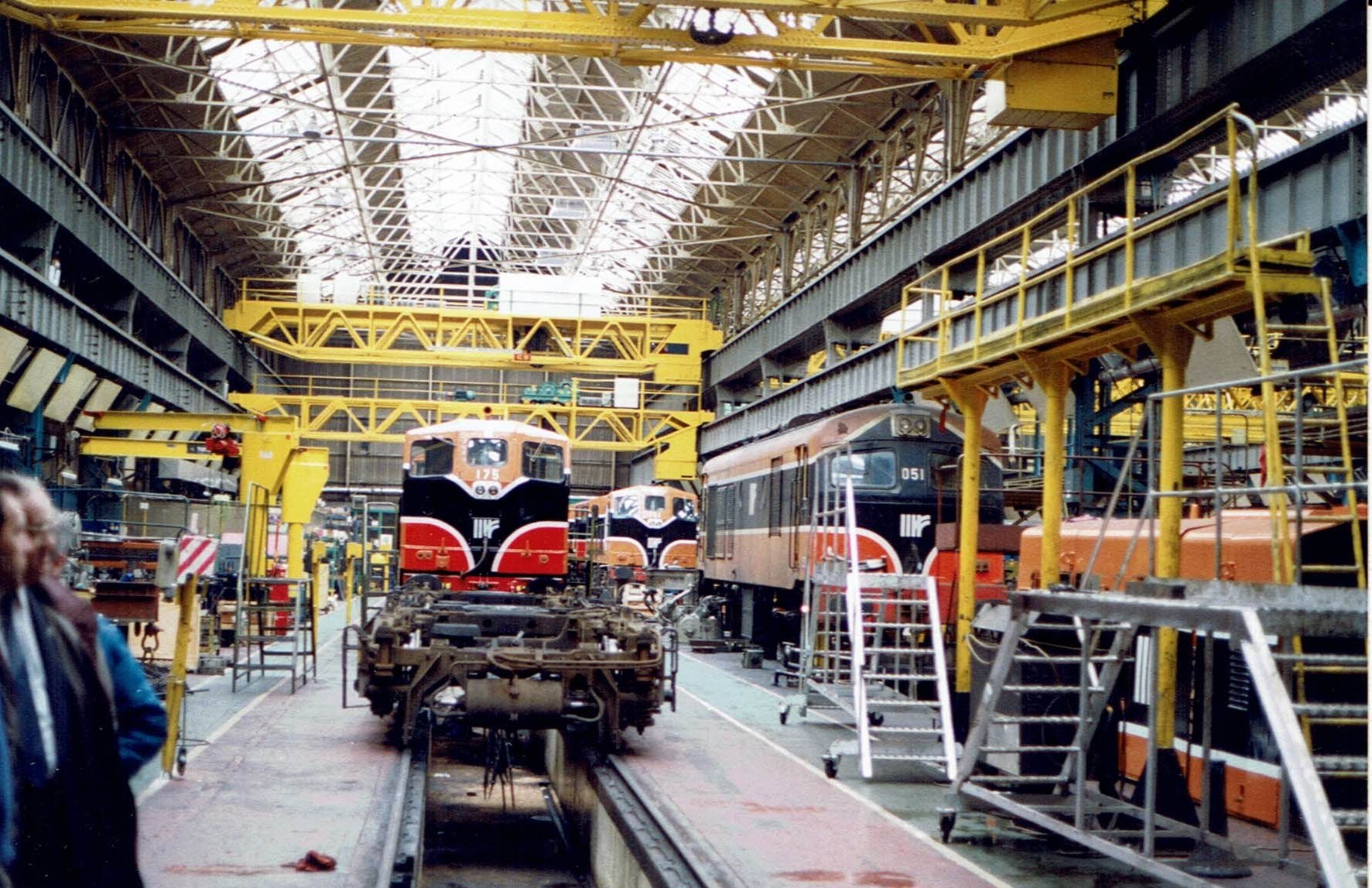

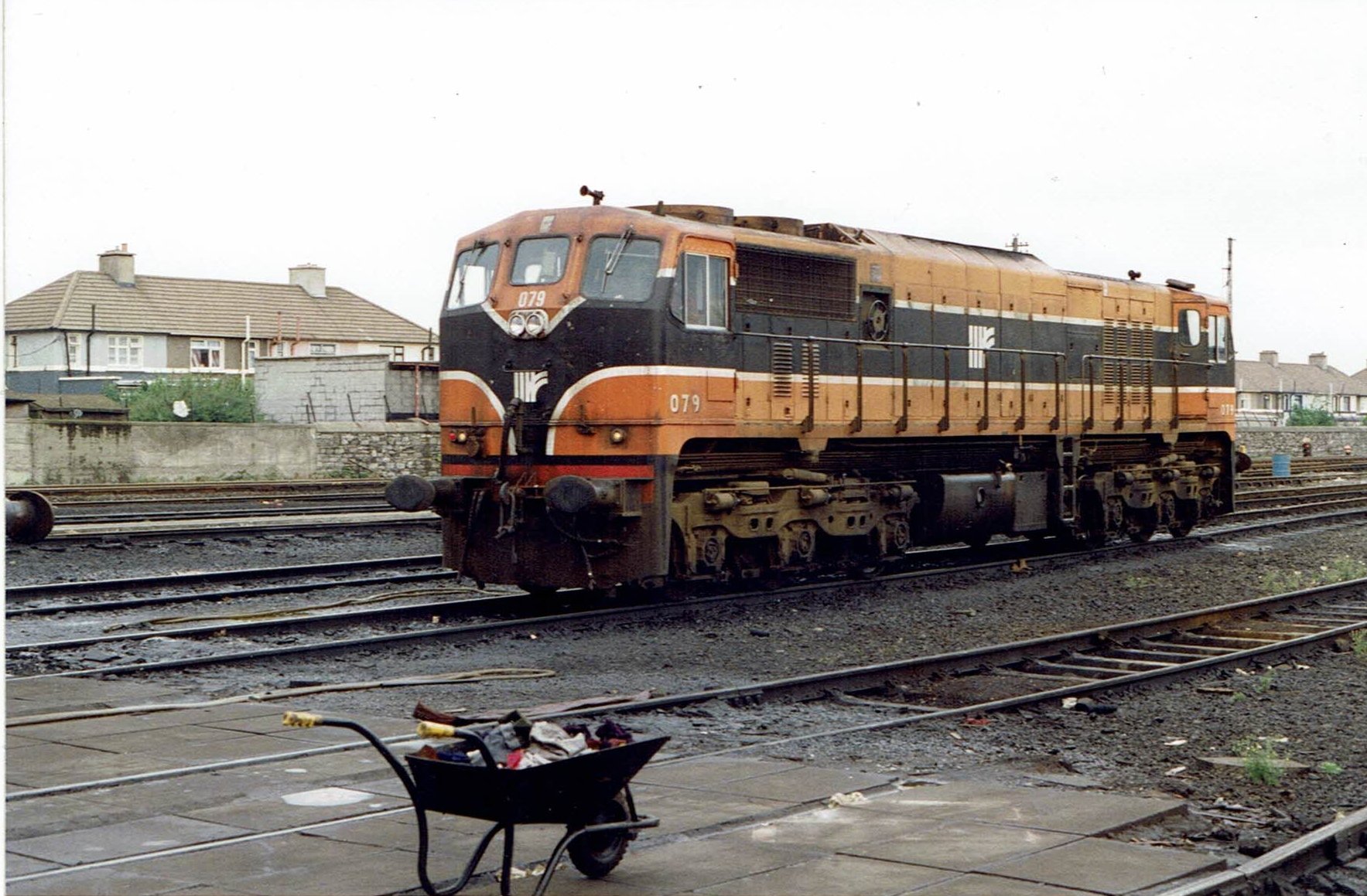

Mayner Posted November 22 Posted November 22 I was responsible for concrete paving on housing and commercial projects down the years! Concrete paving practice changed significantly down the years (a) originally concrete paving/hardstanding was laid in bays up to 6-8' square 6'' mixed and placed by hand. Concrete bays on roads/footpaths and large areas tended to be cast in alternate bays to counteract shrinkage. Rebates (gen 1'X1") were formed at joints in road paving and filled with bitumen to prevent water seeping through to the sub-base and damaging the road. (b) Bay width increased to a max of approx 12' from the 1920s onwards with longitudinal joints every 15-20', rebates again formed in joints in roads and filled with bitumen, typical Dublin Corporation road of the 20s-80s era. Roads had a tamped finish (improve traction/skid resistance), with a smooth (bullnosed) trowel finish at joint. In Ireland and the UK footpaths and paved areas where people were walking received a brush finish, joints barely noticeable in the smaller scales. The length of bay that could be physically be placed by a (4 man) gang in one day increased significantly 60'+ plus with the arrival of readymix concrete during the 1960s During the 90s we received a particular "brushed finish" spec for the floors in the Masonite Plant to overcome issues with wood dust and the adhesives used. (c) Significant change in practice occurred form the late 80s onwards with the widespread use of the power screed and the machine cutting of joints post placing. What does this mean to the modeller? Square/retangular bays up to 8' in bays placed up to the 1920s. Max 12' wide bays with longitudinal joints every 15-20' (bitumen filled joints in roads) concrete placed 20s-80s, barely noticeable joints concrete placed late 80s onwards. Relatively smooth non-slip finish in paved areas where people were walking/working, tamped finish on roadways. The main advantage over concrete over tarmac or stone/gravel paving is its duarbility & restistance to oils/chemicals and can be power washed Photos from Inchacore revealed some interesting points. 2'X2' paving slabs used on running shed apron during 80s/90s. Concrete paving with non-slip (oil/chemical resistant) floor paint finish inside Diesel No1 Mid 90s Deisel No2 /Ramps area tidied up with (fine) stone fill to rail level for Inchacore 150. Interestingly paving slabs apparrently in use of walking routes through Ramps area. Before the clean up! late 70s ballast/fines in in Ramps area filled rail level to allow access for maintence and repair work. Whenever visited the 'surface" in the Ramps area was very slippy with oil grease and water! It basically looks like anything goes in a loco yard from a concrete slab, to paving slabs or ballast brought up to rail level I seem to use 3-4mm mdf coated with fine dark grey scatter on the paved areas (roads and loading banks) of my 1950 ish rural Irish layout. 1 2

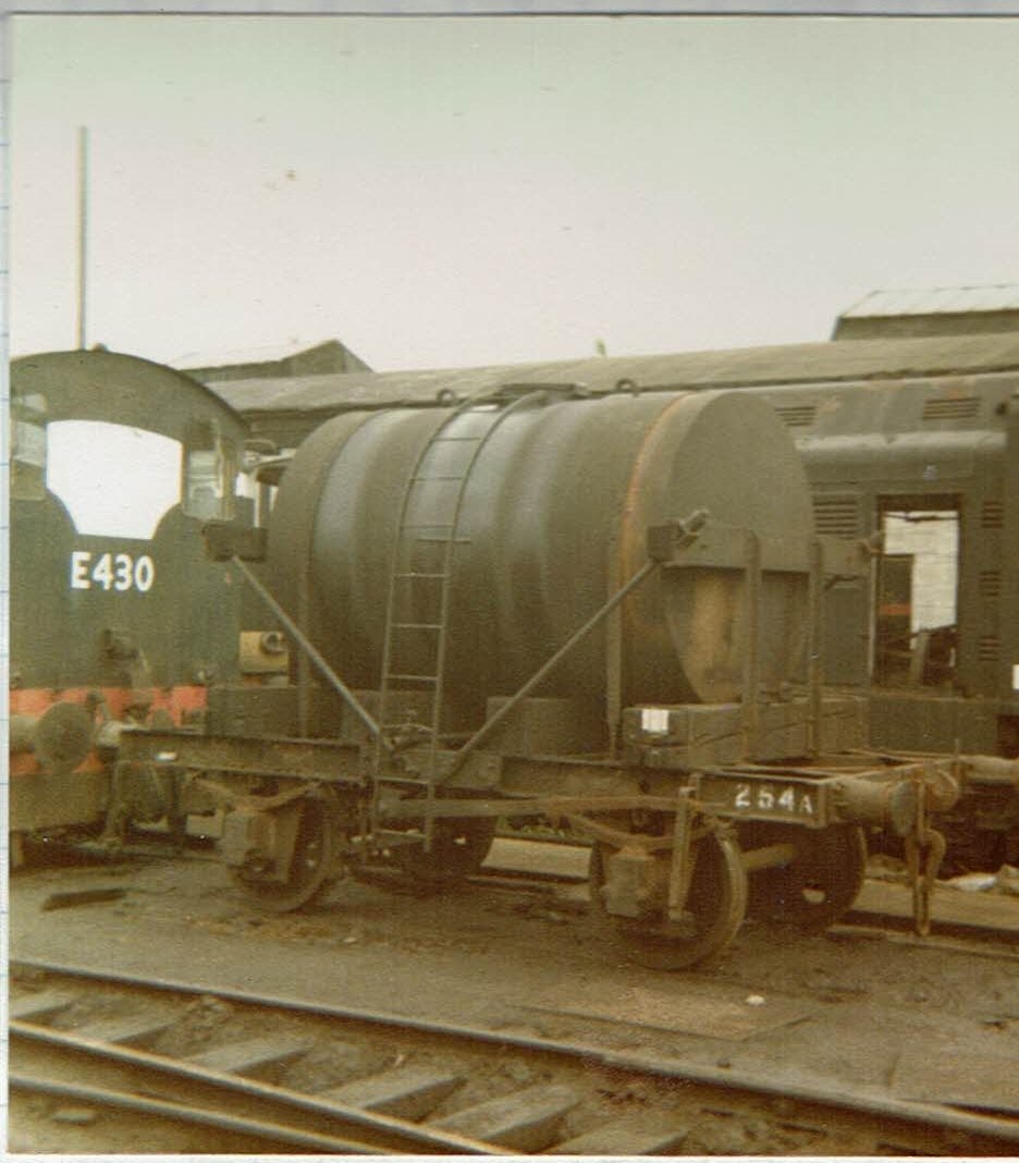

Mol_PMB Posted November 22 Posted November 22 Many thanks John, that’s very comprehensive and helpful. I shall joint my concrete panels accordingly. Going off at a tangent, do you know what that little tank wagon 254A carried?
