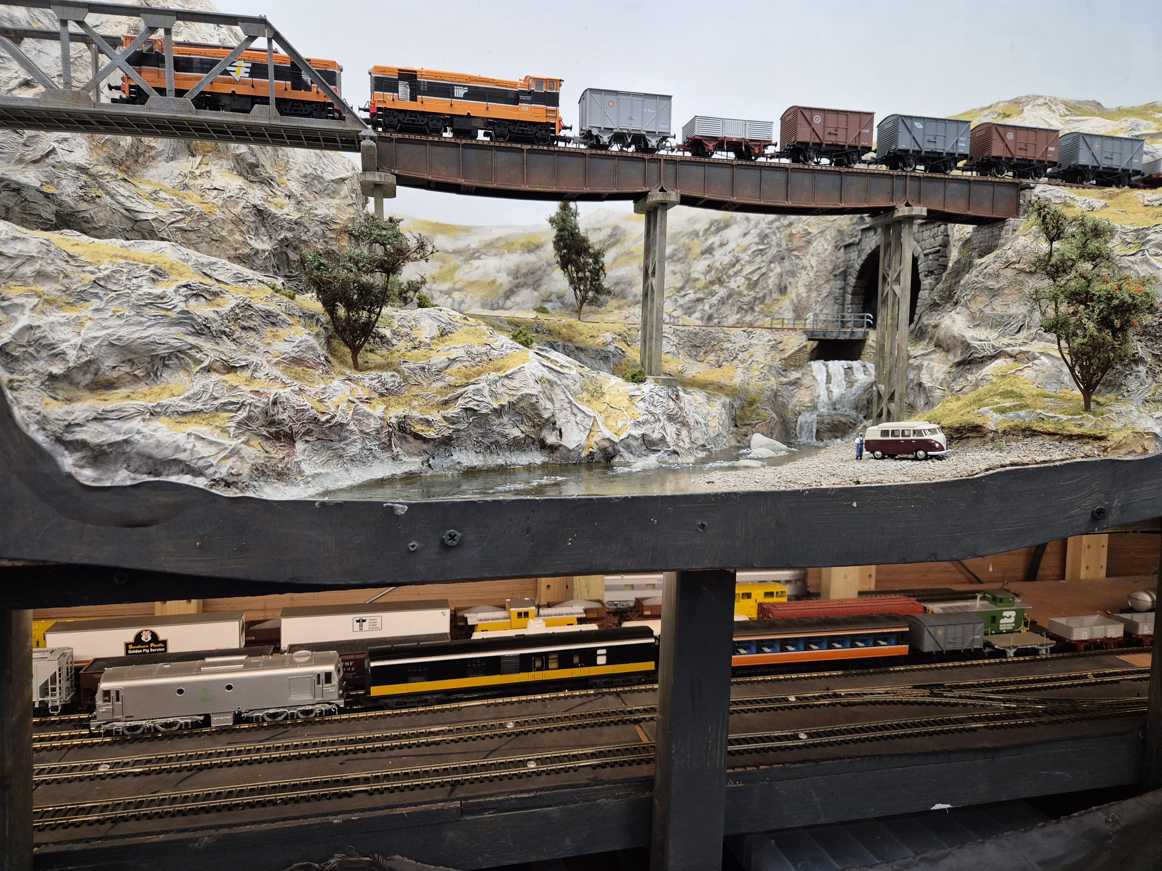

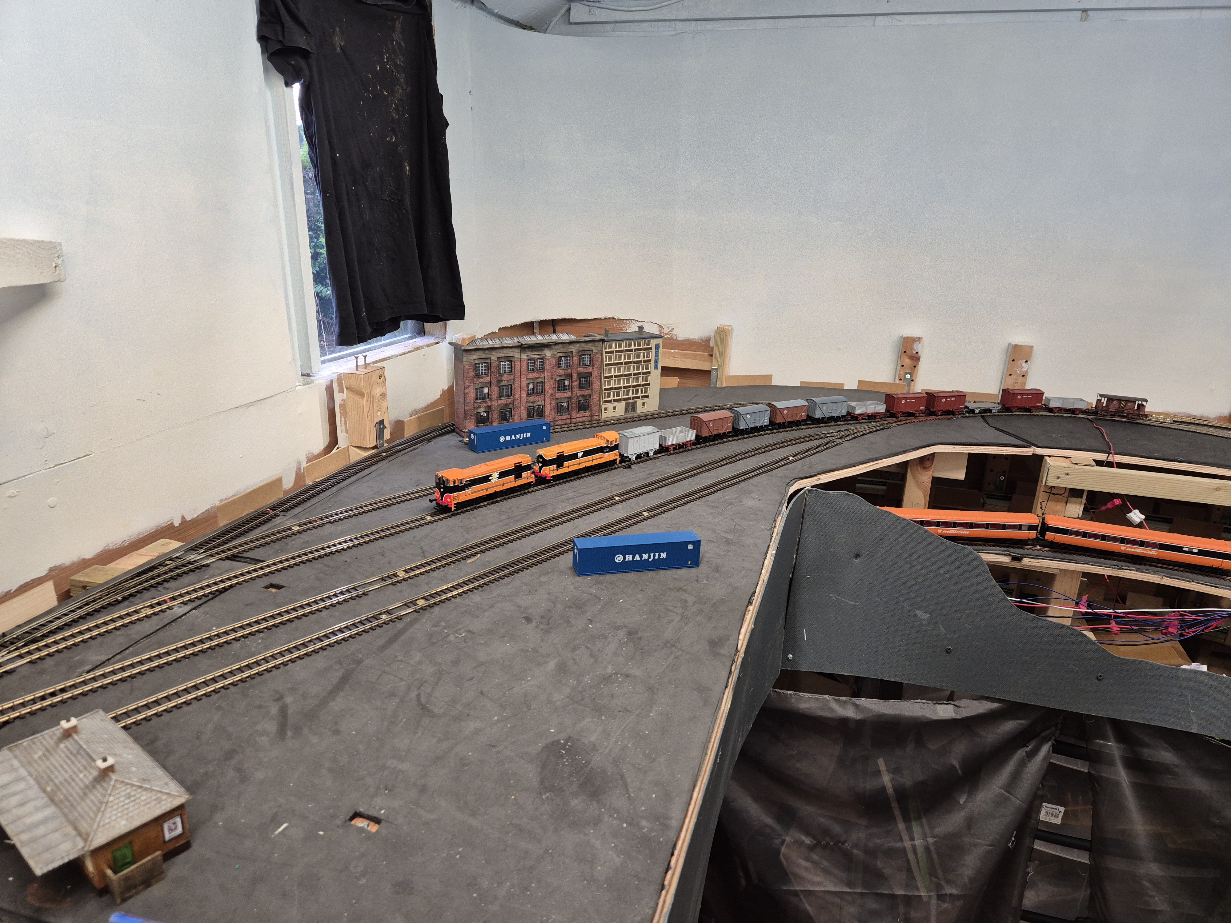

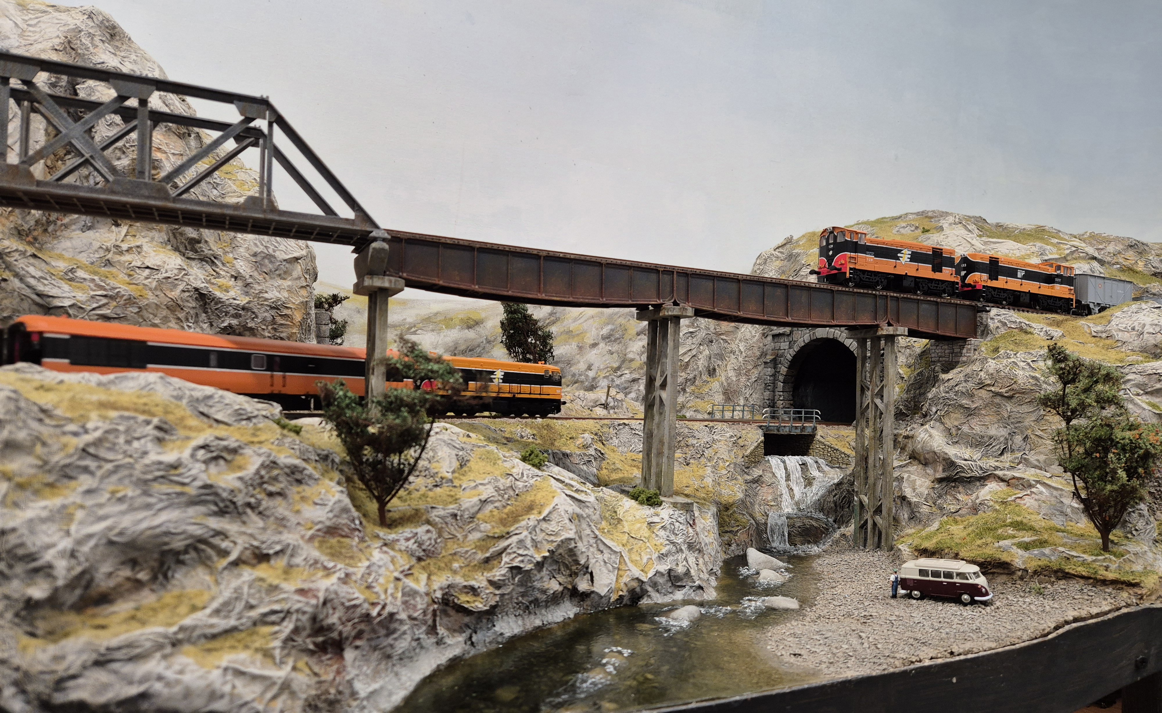

Popular Post raymurph Posted January 24 Popular Post Posted January 24 (edited) Hi All, I started this layout about 2 years ago and have decided to start sharing photos of it's progress going forward. I hope people will enjoy it. I run both CIE/IR and US trains but will only post Irish trains here. The layout is not an accurate representation of any one specific time or place. My aim is that the scenery and urban areas can reasonably pass as somewhere in Ireland when a CIE train runs through it . The layout is of a dead end branch line. My barna or shed measures about 4.5m by 2.5m internally. Minimum radius is 30 inches on the mainline. Lowest level is staging at 65cm off the floor. Trains follow a 1.7% gradient 2.5 times around the room to reach the main sceniced layout level at 100cm. Trains travel once around the room to reach the first station and yard. Then they climb a shorter gradient to reach the high line at 115cm where the mine and final terminus station and main industrial area are located. Locos must then perform a run around and retrace their steps back down to main level and staging. The barna is not wide enough to accommodate any return loops. My next steps will be to plant lots of trees around the river area. And also to start work on the first station and retaininging walls. Edited January 24 by raymurph 17 3
Mol_PMB Posted January 24 Posted January 24 Wow. Superb scenery and it looks like an interesting layout to operate. i look forward to seeing more developments. 1 1
Patrick Davey Posted January 24 Posted January 24 WOW - that very first photo is incredible, the bridges, the rocks, the river, the waterfall and the camper cameo!!! All amazing!!! 1
derek Posted January 24 Posted January 24 Unbelievably good! Agree about the first pic- superb. Looking forward to this one. One thing though- the ol t-shirt for a blind leaves something to be desired 1

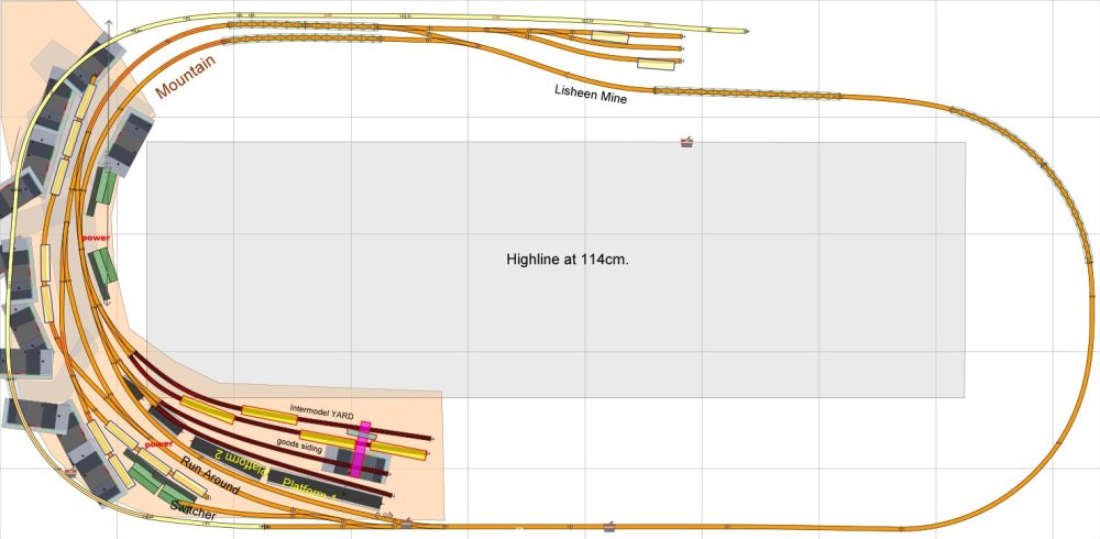

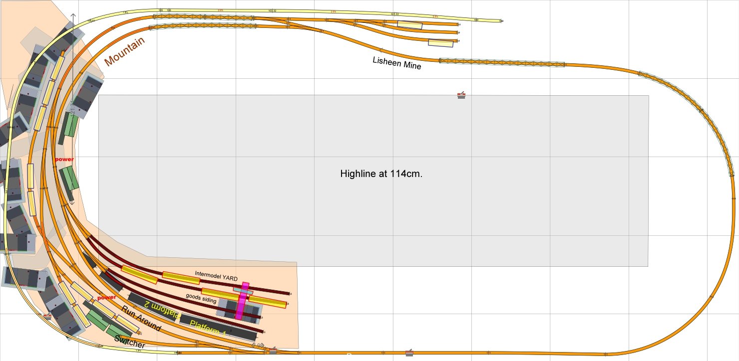

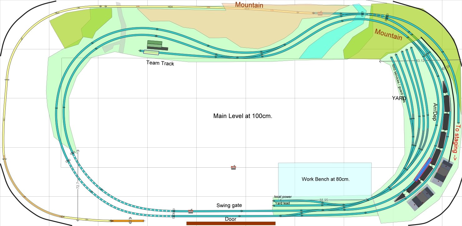

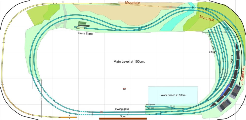

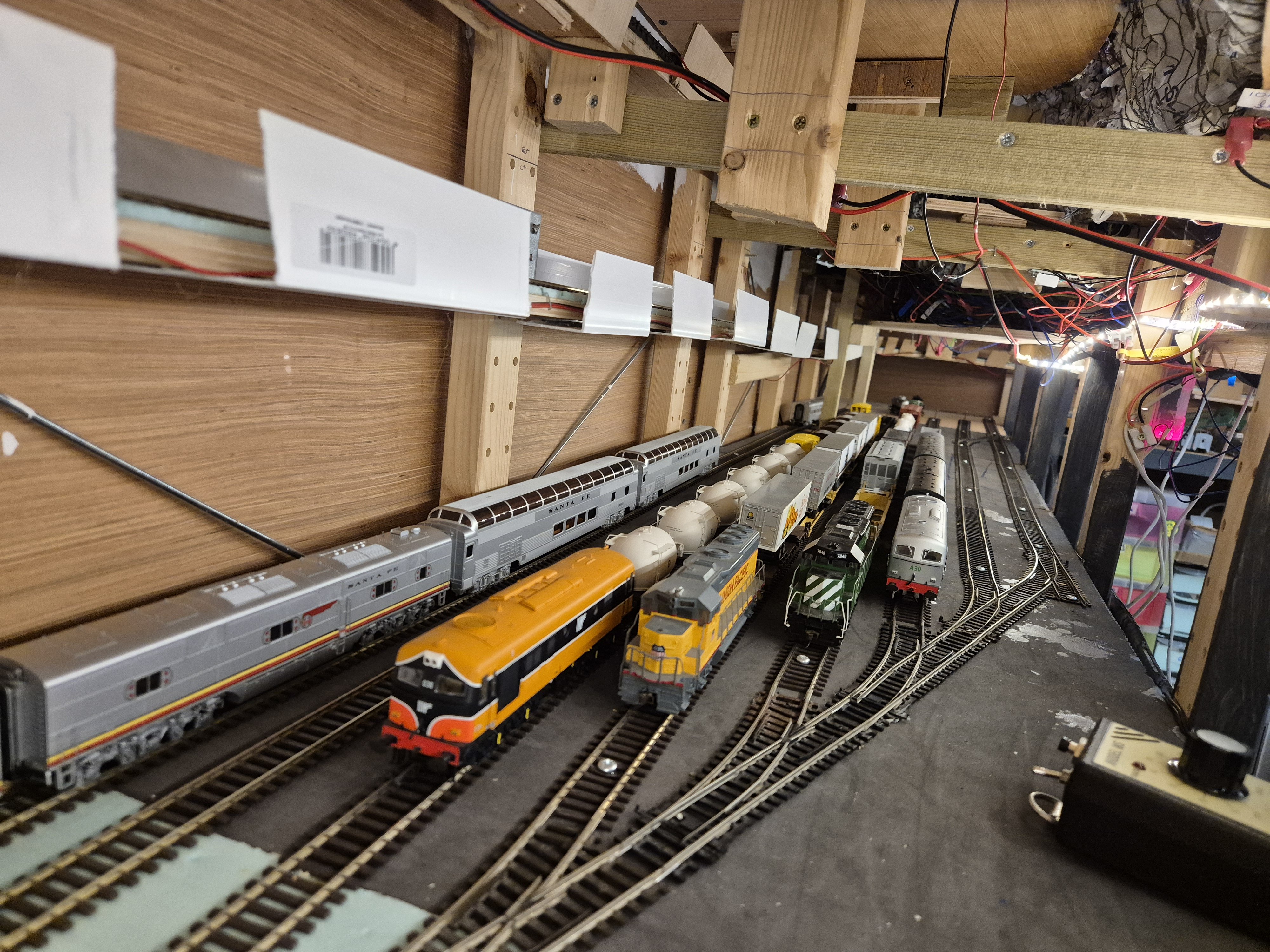

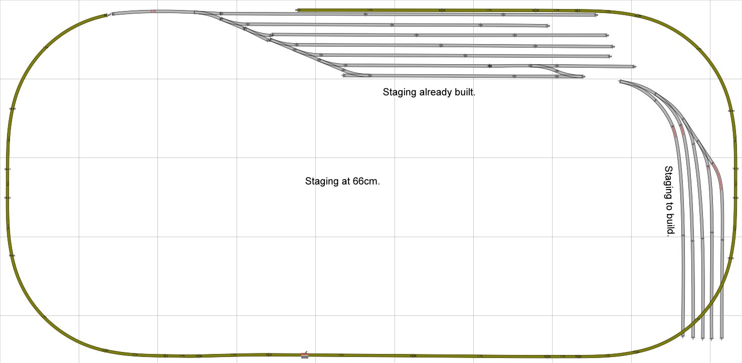

raymurph Posted February 26 Author Posted February 26 (edited) Here are the Anyrail track plans, above is staging, about half built so far. Above is the main level at 100cm, the top wall is the most finished scenically, with the camper van next to the river. The trains climb around the room twice to reach here on the right hand wall behind the through station, then go all around the room to reach the station. Then cross the river a second time and climb a shorter steeper hidden gradient to the Highline. Above is the Highline, trains enter bottom left, cross the swing gate for the umpteenth time, go behind the main level station and then cross the high metal girder bridge over the river, pass the mine on the top wall and enter the main industrial area and terminus station on the left wall. I've made a video of a train traveling this route and will upload it once I get a chance to annotate it. Edited February 27 by raymurph Images not displaying properly 4 1

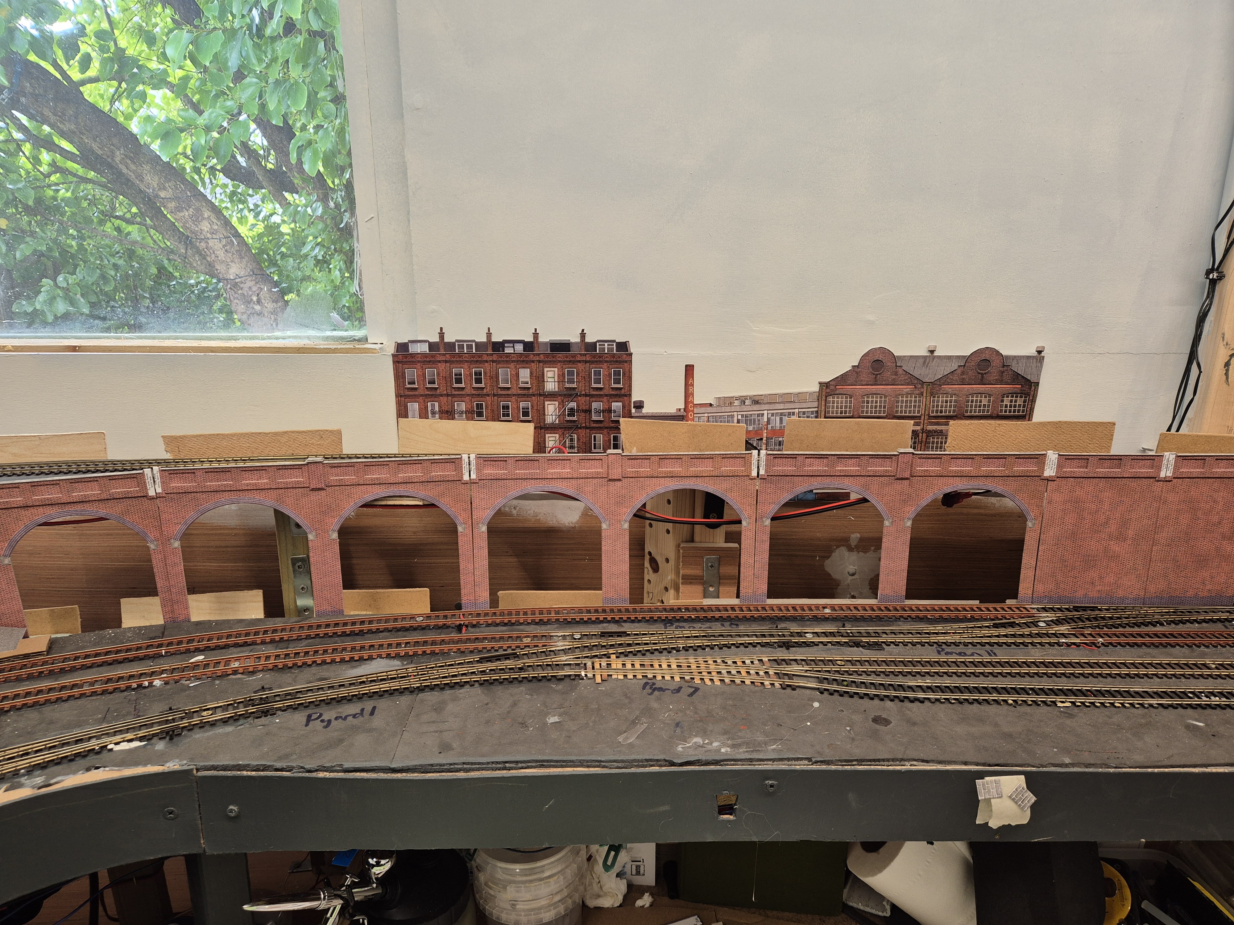

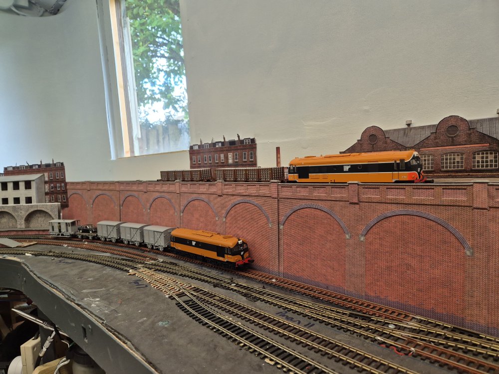

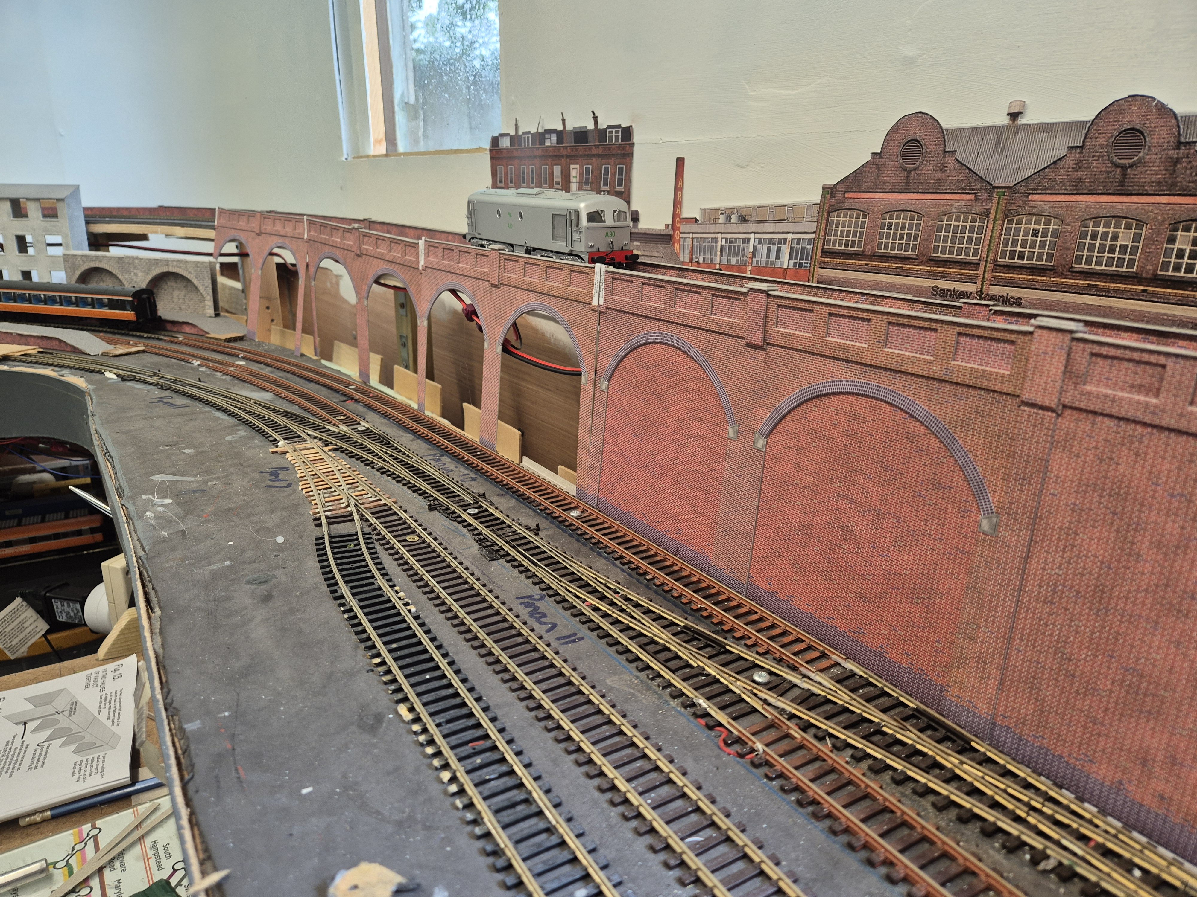

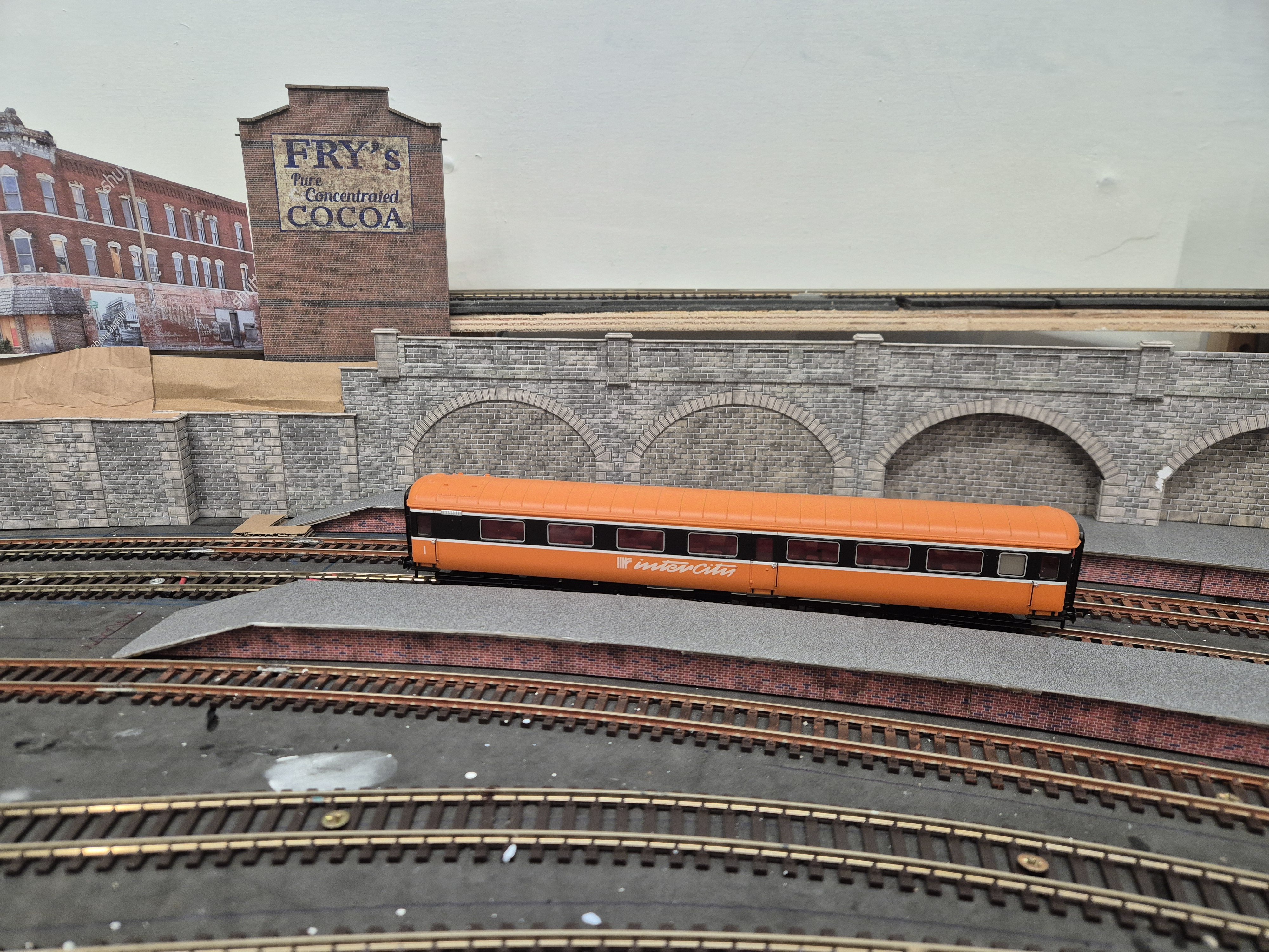

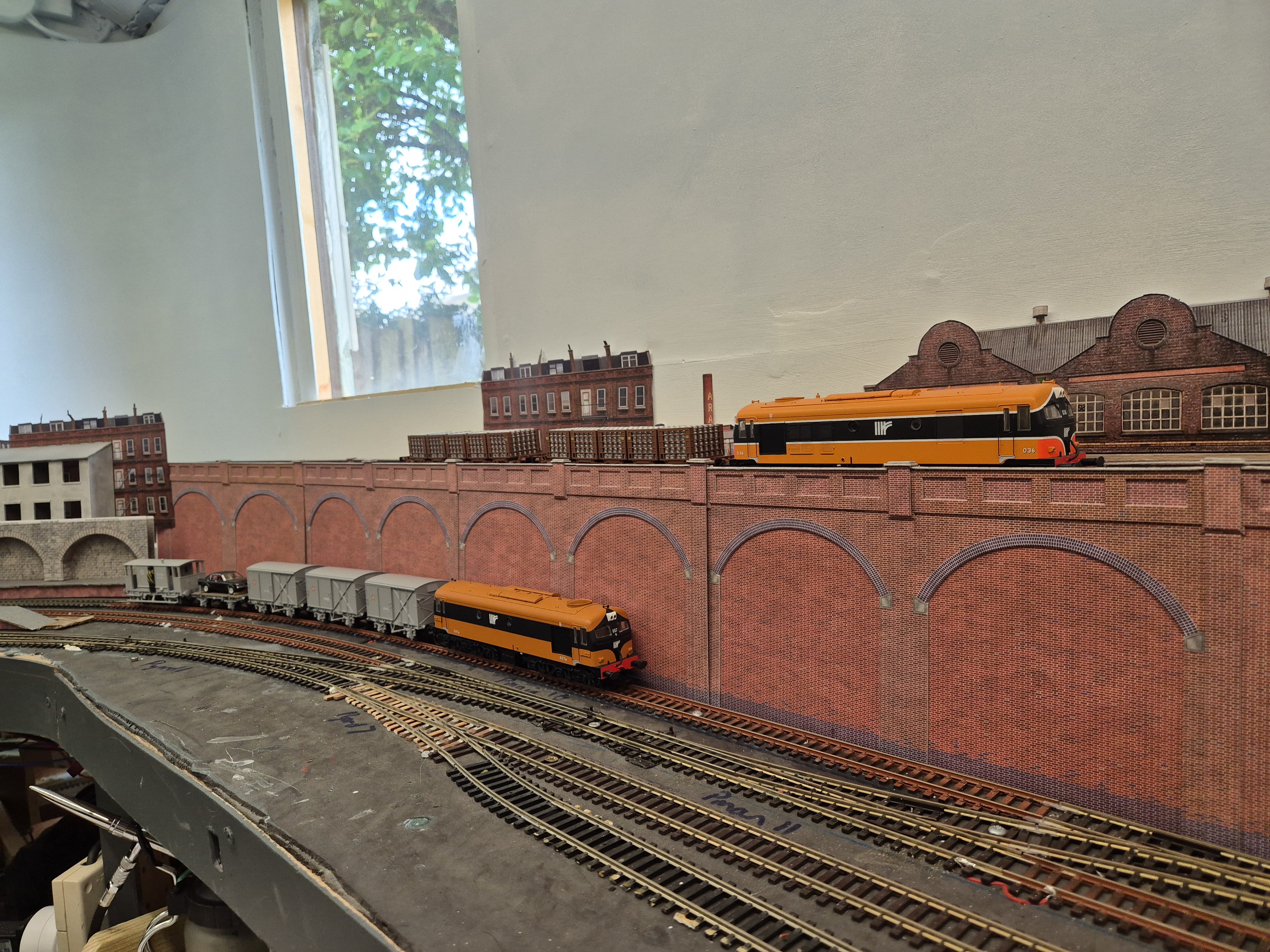

raymurph Posted April 2 Author Posted April 2 I've added retaining walls, by modifying the Metcalfe viaduct kit, to the approach to the main station. I'm also experimenting placing background buildings using test building prints from Sankey Secenics. I've added platforms and some more retaining walls to the station. 9 1

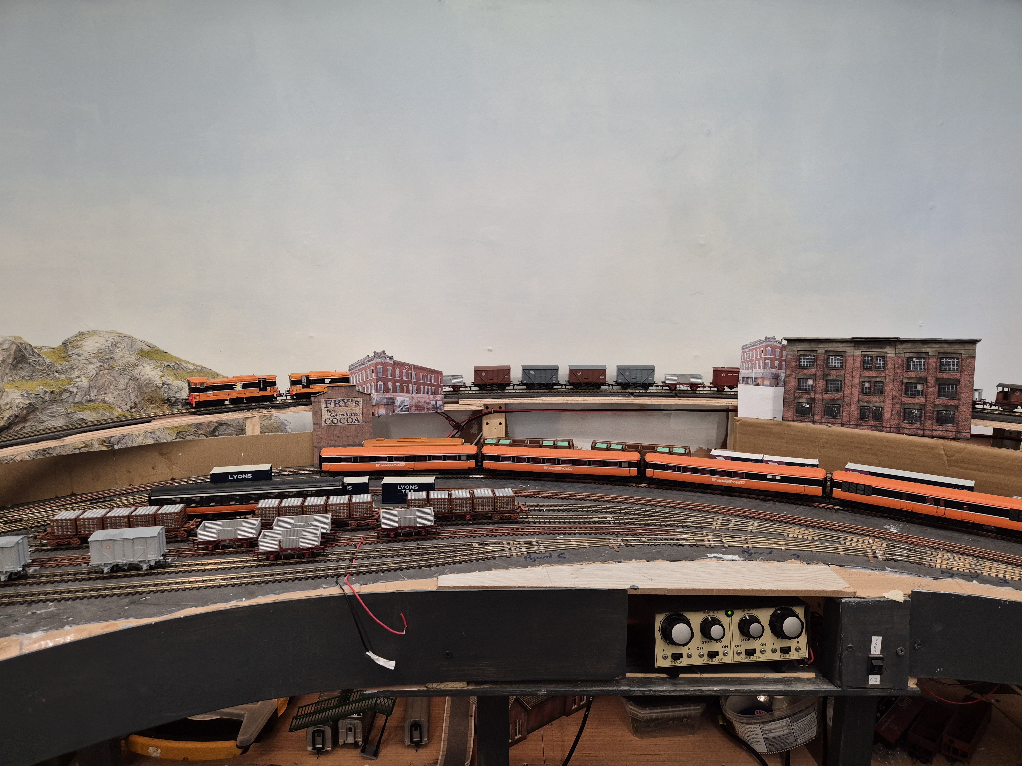

jhb171achill Posted April 3 Posted April 3 Very impressive - was it originally American outline? (Would explain "wrong-lione" operation on double track section?) Love the scenery, and a good collection of models....
raymurph Posted April 3 Author Posted April 3 6 hours ago, jhb171achill said: Very impressive - was it originally American outline? (Would explain "wrong-lione" operation on double track section?) Love the scenery, and a good collection of models.... Thanks JHB. It was planned to run both US and CIE outline, and for the scenery to be just about believable for either. This involves plenty of compromises of course. I opted for US style right hand running on the double main and Irish style high platforms for the station. I can only sleep at night by reminding myself that unstereotypical things exist on both rail systems like some rare high platform stations in the US. Actually is there someone on here more knowledgeable than me who can think of a right hand running section of double track in Ireland? Probably for some practical reason. 2
Mol_PMB Posted April 3 Posted April 3 I'm not aware of any true right-hand running sections of double track in Ireland. I think there are some sections of double track that are bi-directionally signalled - GNR line north of Dublin? - but would normally run on the left. There are some locations where there are two parallel bi-directional single tracks which later diverge (for example west of Waterford). At Mallow, trains for Kerry run wrong line for a mile or so giving the impression of right-hand running. 2
Galteemore Posted April 3 Posted April 3 At one time the line at Whitehead would also have given the partial impression of right hand running. The old tunnel line remained in situ for a while after the line had been operationally singled. So it looked as if the down trains were running RH. 2
jhb171achill Posted April 3 Posted April 3 8 hours ago, raymurph said: Thanks JHB. It was planned to run both US and CIE outline, and for the scenery to be just about believable for either. This involves plenty of compromises of course. I opted for US style right hand running on the double main and Irish style high platforms for the station. I can only sleep at night by reminding myself that unstereotypical things exist on both rail systems like some rare high platform stations in the US. Actually is there someone on here more knowledgeable than me who can think of a right hand running section of double track in Ireland? Probably for some practical reason. Right-hand running, per se, was never used on any Irish line and as far as I know not British either. However, many lines both in the past and today, especially passing loops, were / are signalled for bi-directional working, so there's your "link"! My own layout, Dugort Harbour, is imagined to be in an impossibly remote west Kerry area, because some genius came uop with the idea of making it into a major transatlantic port in 1888 or something. A cursory look at any map shows that had anything remotely resembling it ever been built, engineering works through impassable mountains west of Macroom would have been necessary, doubtless resembling the huge viaducts you have! 2
raymurph Posted April 3 Author Posted April 3 6 minutes ago, jhb171achill said: Right-hand running, per se, was never used on any Irish line and as far as I know not British either. However, many lines both in the past and today, especially passing loops, were / are signalled for bi-directional working, so there's your "link"! My own layout, Dugort Harbour, is imagined to be in an impossibly remote west Kerry area, because some genius came uop with the idea of making it into a major transatlantic port in 1888 or something. A cursory look at any map shows that had anything remotely resembling it ever been built, engineering works through impassable mountains west of Macroom would have been necessary, doubtless resembling the huge viaducts you have! There's always a reason to explain away our follies and whims! Here's a photo with my newly arrived palvans. Retaining wall mostly finished. I'll have to widen the gap between the wall and track though. It's removable so I can access the track to staging behind it and held in place by magnets. 3

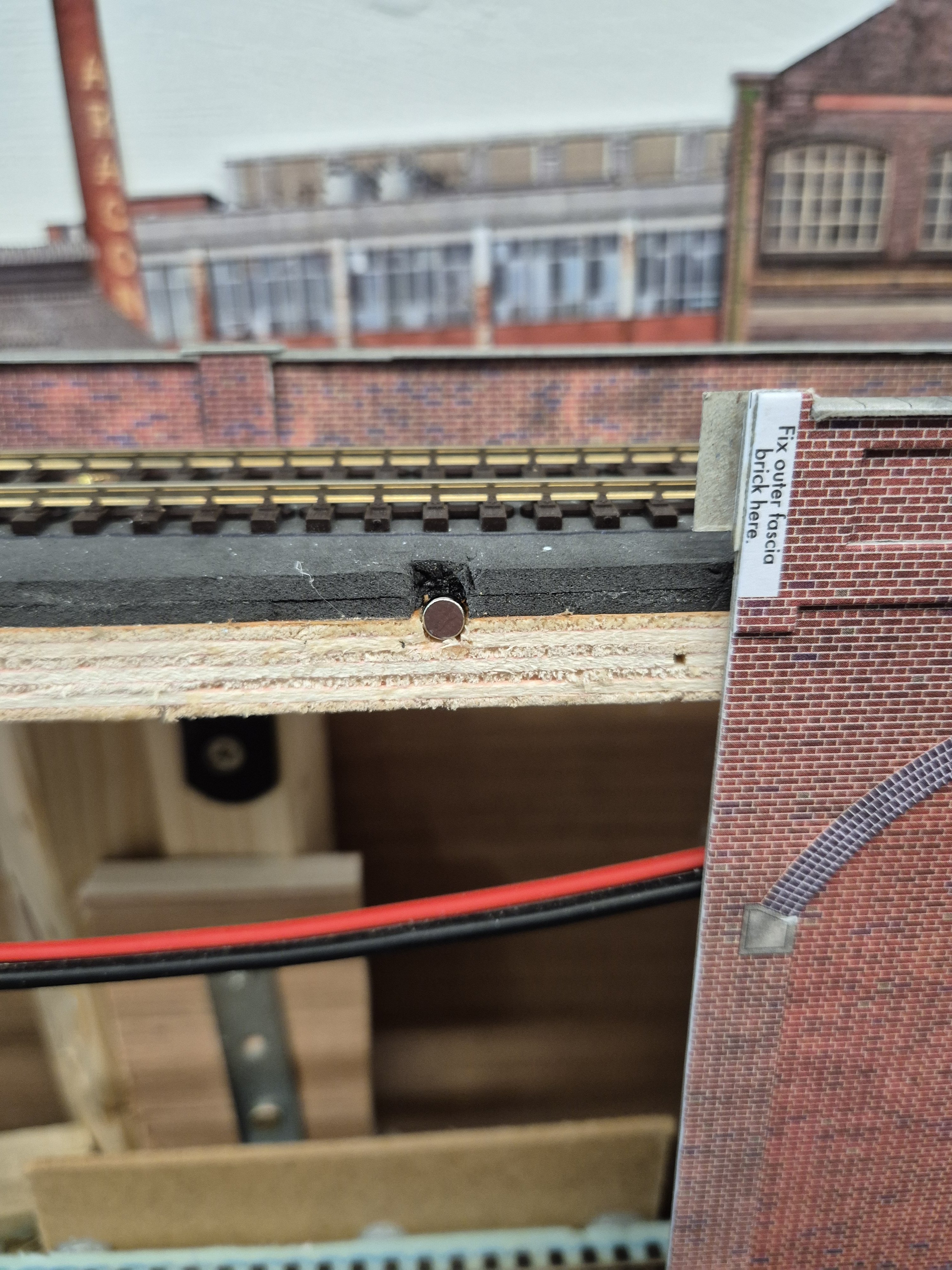

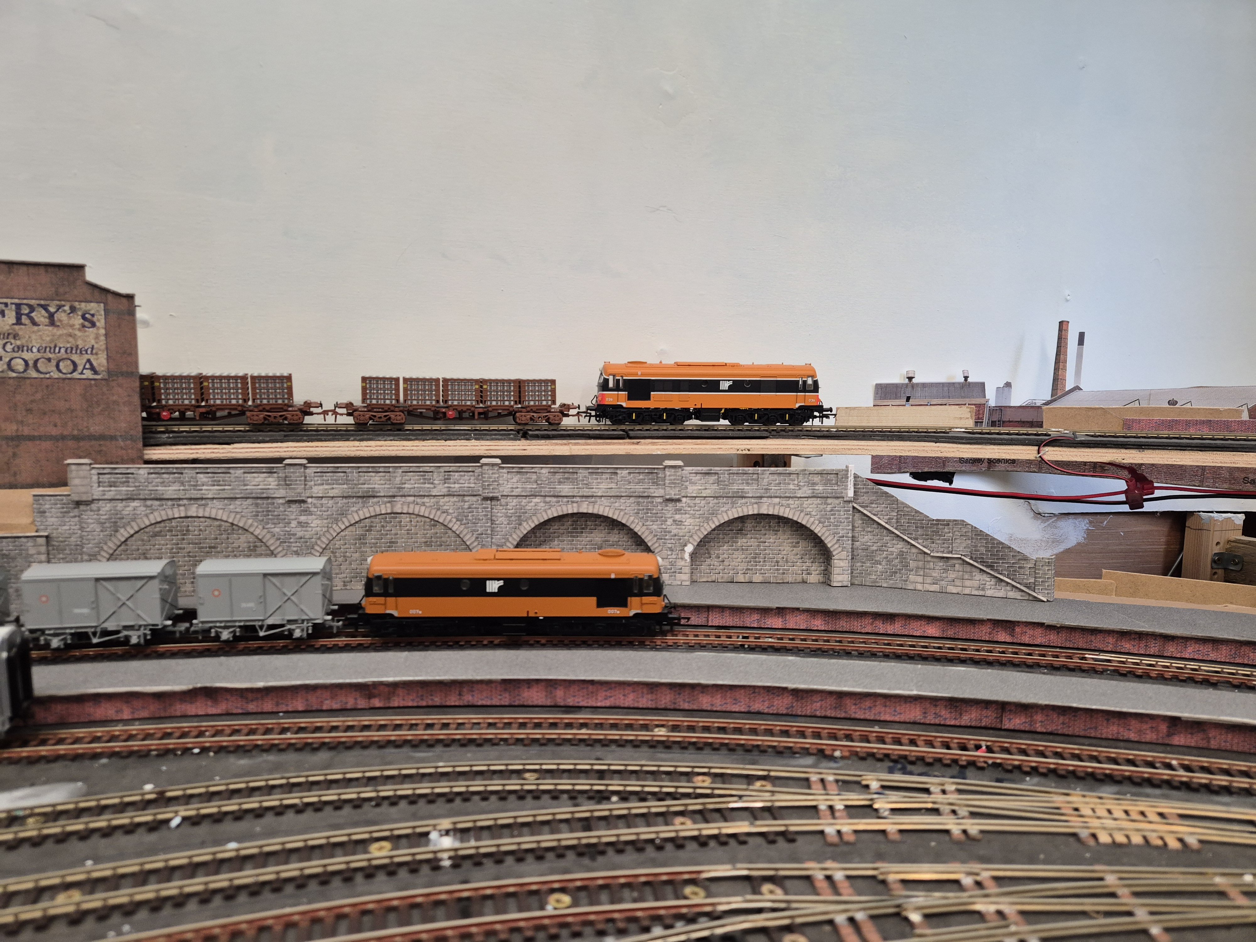

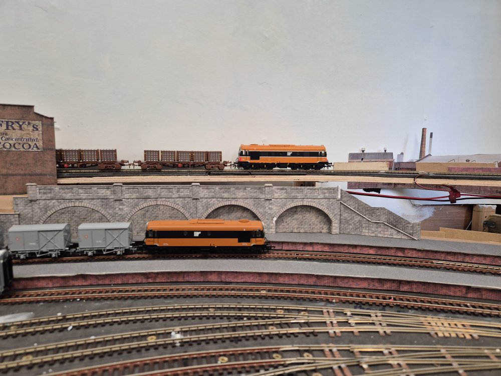

jhb171achill Posted April 3 Posted April 3 (edited) 6 hours ago, raymurph said: There's always a reason to explain away our follies and whims! Here's a photo with my newly arrived palvans. Retaining wall mostly finished. I'll have to widen the gap between the wall and track though. It's removable so I can access the track to staging behind it and held in place by magnets. Absolutely! I need to concoct a rationale for an IRM ICR appearing on a layout bnased in 1955-65......! Maybe if i put a "Tardis"-style "police box" in a corner in the goods yard.... The magnets are a very good idea. Edited April 3 by jhb171achill 1

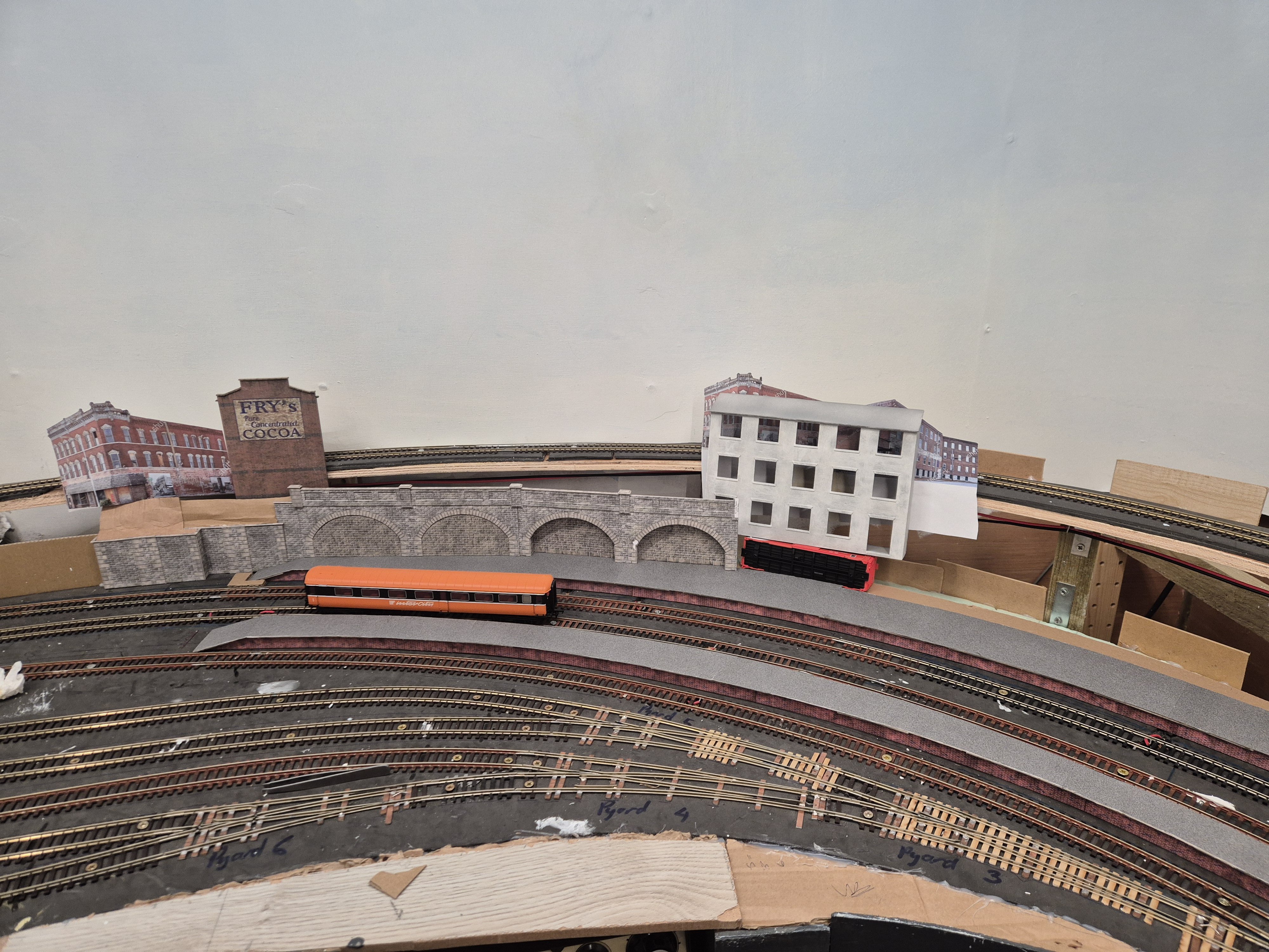

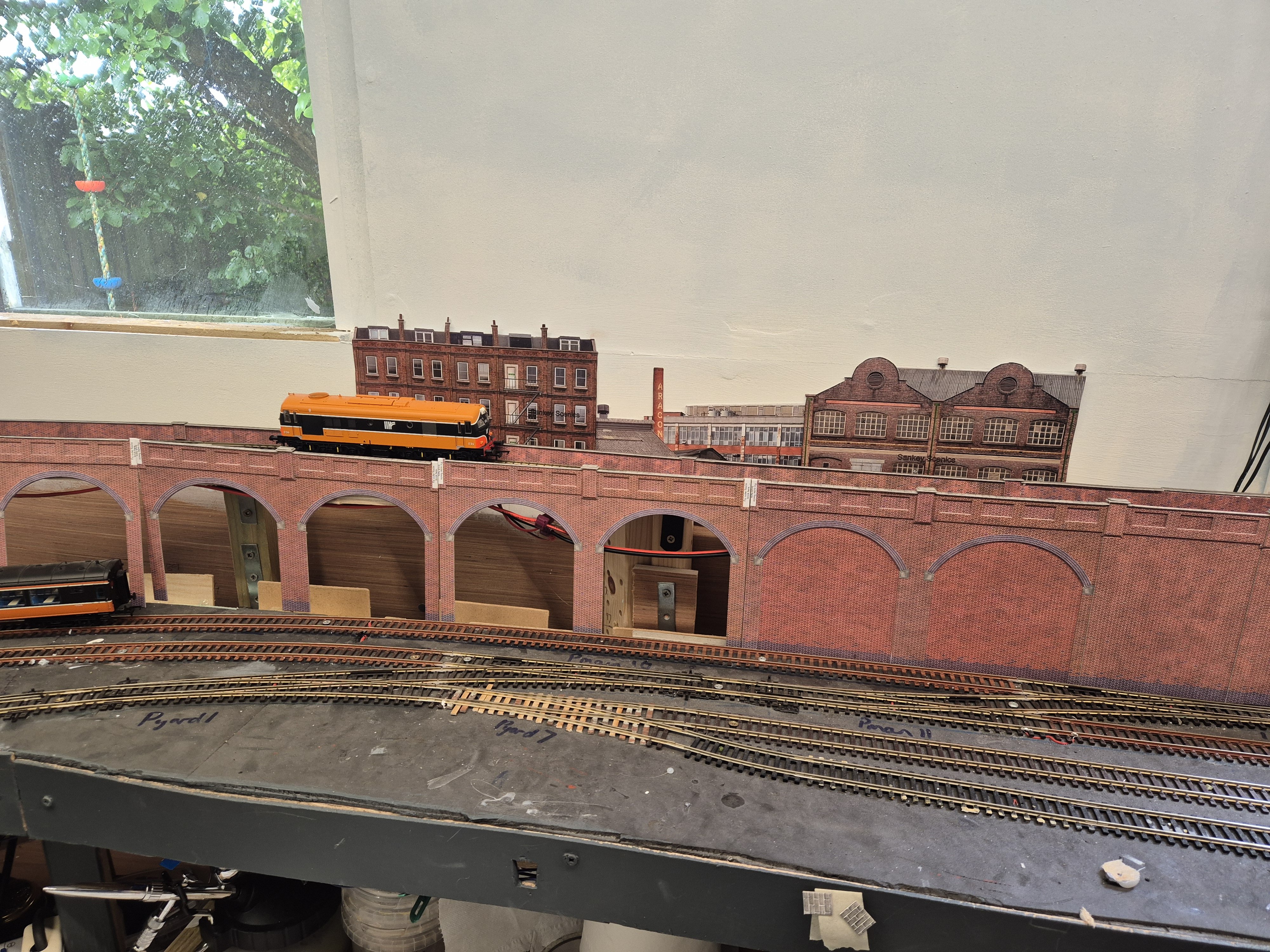

raymurph Posted April 10 Author Posted April 10 (edited) I'm having fun trying different arrangements for the buildings behind the red brick viaduct. And I've started a grey stone stairs down to the platform, definitely the most challenging structure I've attempted so far. Edited April 10 by raymurph 6
raymurph Posted April 10 Author Posted April 10 Sorry I uploaded a pic I stead of the video: 20260410_170233.mp4 5
Tullygrainey Posted April 10 Posted April 10 Looking really well. That's a great combination of industrial buildings in the background. Very convincing 1
raymurph Posted April 10 Author Posted April 10 Thanks Tully, I think I'll block up the bottom section of that window as well, too distracting and I don't need the light.

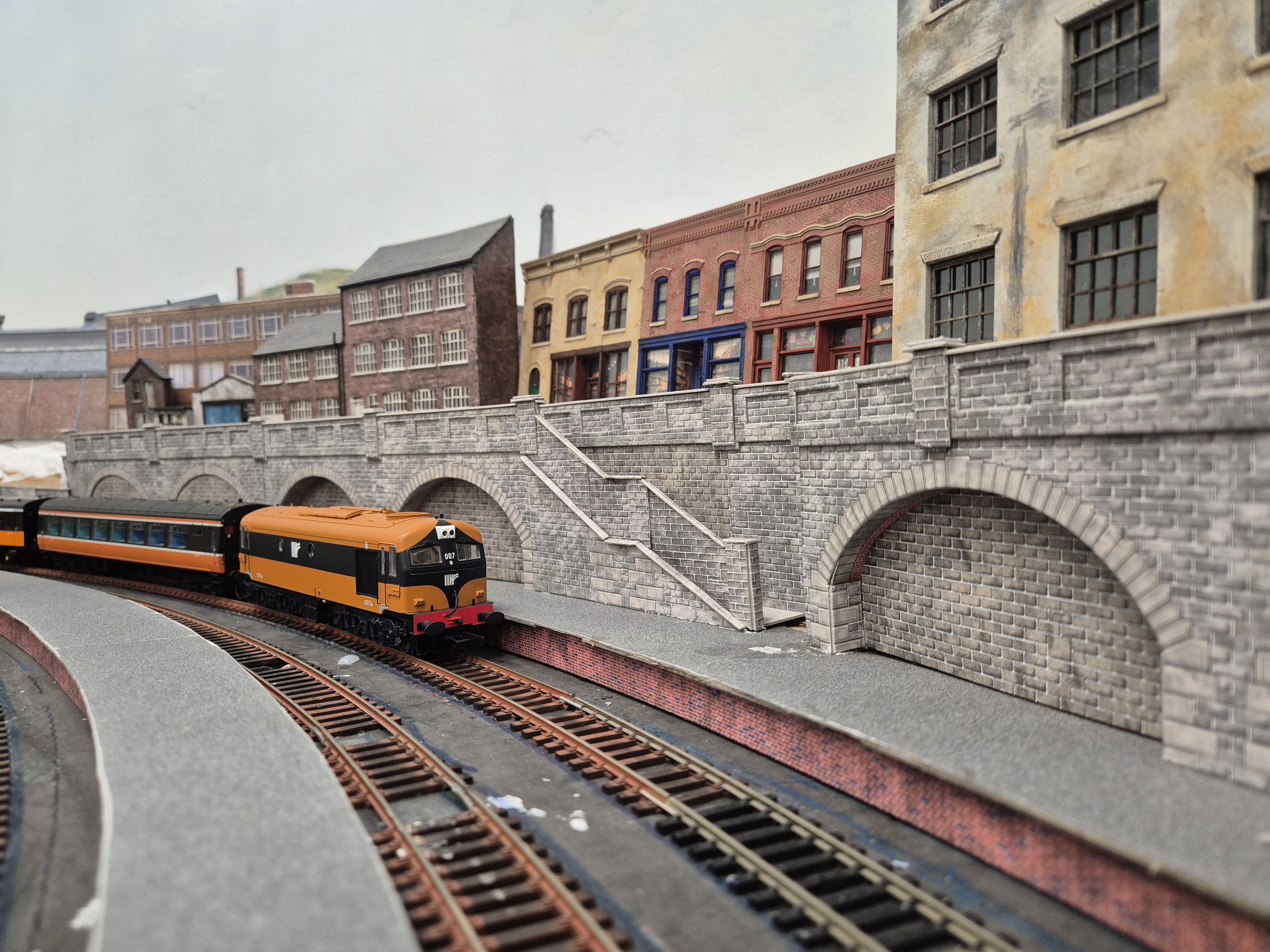

raymurph Posted September 28 Author Posted September 28 More progress on the town buildings. Pretty happy with this arrangement. Added far away hills as well. Next steps is to fix buildings in place and then do pavements and cobblestones around them. 20260928_211252_1.mp4 9
Colonel Posted September 29 Posted September 29 That first scene hangs together rather well. Is the track fixed down yet? If not a small element of superelevation, by lifting the outer edges a fraction might look good.
Mol_PMB Posted September 29 Posted September 29 4 minutes ago, Colonel said: That first scene hangs together rather well. Is the track fixed down yet? If not a small element of superelevation, by lifting the outer edges a fraction might look good. On the big railway, one would only apply cant through platforms if trains regularly run through at high speed without stopping. For stopping trains it's better without, and cant causes all sorts of problems with stepping distances and platform/train clearances. 1 1
raymurph Posted September 29 Author Posted September 29 1 hour ago, Colonel said: That first scene hangs together rather well. Is the track fixed down yet? If not a small element of superelevation, by lifting the outer edges a fraction might look good. I won't through the station. Elsewhere yes 1 1
derek Posted September 29 Posted September 29 Very nice Ray. The scene at the end of the video clip is the business 1
