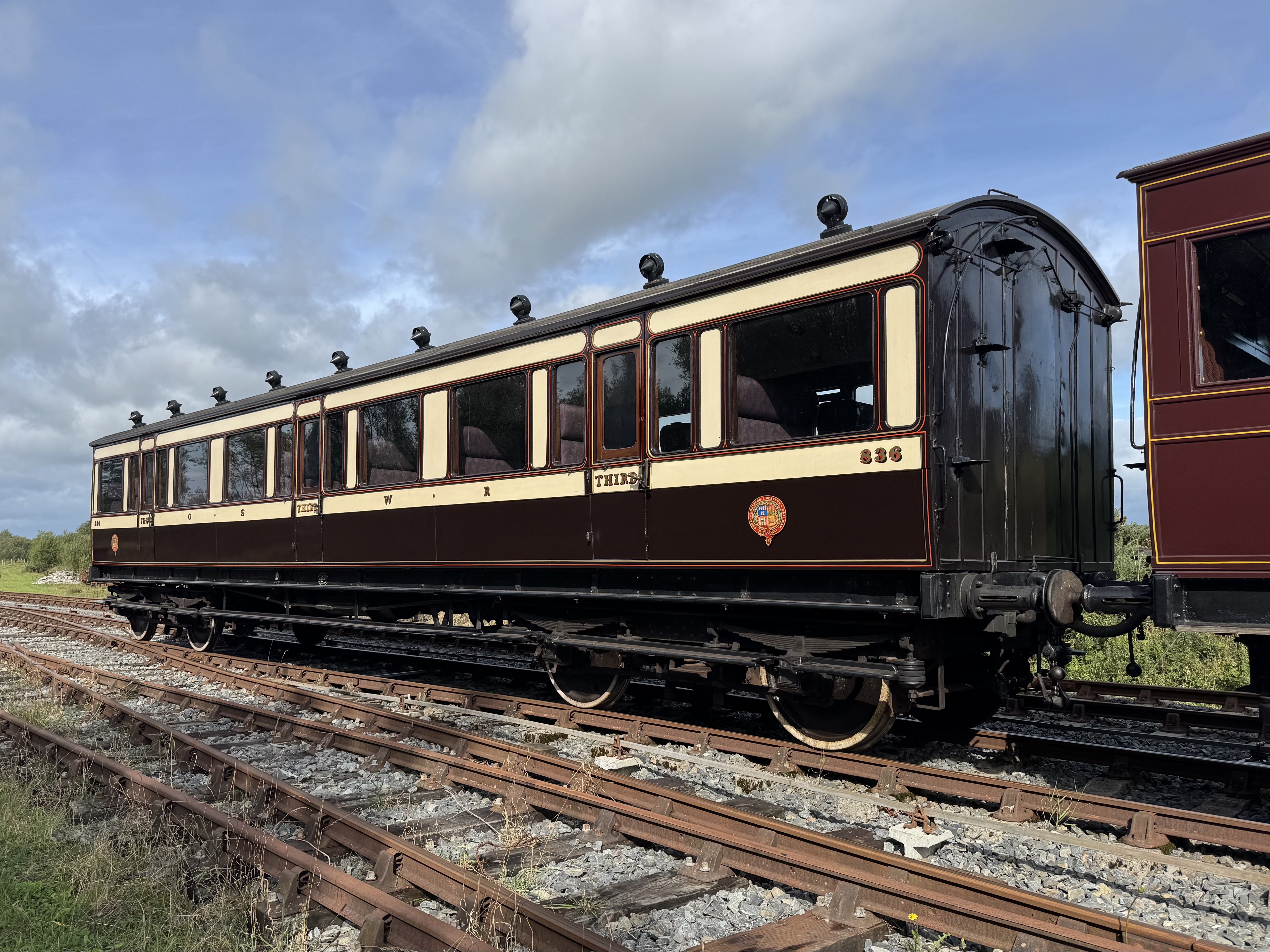

Colin R Posted September 21 Posted September 21 Just what is the liver for 836? It looks a bit like the Great Western Railway from the UK; it might be a while before I can afford one or two of these, having just purchased some stuff from Japan
jhb171achill Posted September 21 Author Posted September 21 1 hour ago, Colin R said: Just what is the liver for 836? It looks a bit like the Great Western Railway from the UK; it might be a while before I can afford one or two of these, having just purchased some stuff from Japan The livery on it now is GSWR, which is “crimson lake”, in reality an extremely dark brownish red, and off-white upper panels (which it may or may not have carried; carriages of that type were more often (lined) crimson lake all over, with the white mostly reserved for main line stock. GWR in Britain was mid brown and cream. Lining was completely different too. 1
Mol_PMB Posted September 22 Posted September 22 A summary of the liveries carried by some or all of this class are as follows (thanks to JB for the basis of this). 1. All-over dark "lake" (an extremely dark brownish red) with GSWR markings 1902-25 2. For any used on main lines after 1906, same with white upper panels. This is the livery 836 is preserved in. Being only a few years old in 1906, they were front line stock and it's likely that some of them received this scheme when repainted. 3. All-over dark lake but with GSR markings, 1925-early 30s. 4. Some of these did receive the short-lived GSR "main line" livery of chocolate brown and cream (late 1920s to mid 30s) - there is photographic evidence. 5. Standard GSR all-over maroon, same as LMS maroon in Britain (and for that matter NCC & BCDR here). 6. From around 1946, CIE dark green with elaborate lining, snails and 3 digits on the doors 7. From around 1951, CIE plain dark green with no lining, snails or class digits 8. From 1952, the tea cars used with railcars had CIE plain dark green with a single thin EdN waist line. No snails or class digits. 9. From 1954, CIE brilliant green with a single thin EdN waist line. No snails or class digits. 10. From 1956, CIE brilliant green with a single thin EdN waist line and 2 digits on the doors. No snails. 11. From 1959, some may have received snails on a livery similar to 10, but I haven't yet found a photo like this. I have not yet found a photo of any in 'black and tan'. It's possible; some other carriages of a similar era and shape did receive that livery. There were also some more liveries once they were withdrawn from passenger service: 837 was converted into a camping coach no.8 and was painted in a bright red and white/cream livery. Later it became departmental 530A and was painted red oxide (including ends), and later again dark red (including ends). 836 was also subsequently in departmental use (463A). Initially repainted in dark green, it was later very dark grey with red oxide ends. 835 became departmental 540A and may have had had another different livery but I'm not sure what it was. 2 3

Mol_PMB Posted September 22 Posted September 22 2 minutes ago, Colin R said: Thanks for the updates about the livery. Out of interest, did any of the other coaches you mentioned survive into preservation? The RPSI has 837, which is being restored to act as extra seating for the cafe at Whitehead: https://www.steamtrainsireland.com/rpsi-collection/66/837-open-third So 2 of the 10 have survived in good condition - not bad considering they were built in 1902! This was one of the reasons I chose this type of coach to model. 2
jhb171achill Posted September 22 Author Posted September 22 At some stage in departmental days, late 70s I think, 837 was also in what looked like standard wagon brown with black or dark grey roof. I have cine of it on a PW train.

jhb171achill Posted 48 minutes ago Author Posted 48 minutes ago On 22/9/2026 at 3:56 PM, Mol_PMB said: The RPSI has 837, which is being restored to act as extra seating for the cafe at Whitehead: https://www.steamtrainsireland.com/rpsi-collection/66/837-open-third So 2 of the 10 have survived in good condition - not bad considering they were built in 1902! This was one of the reasons I chose this type of coach to model. Apart from the welcome survival of two, it's a happy coincidence that carriages of this type could turn up just about anywhere. Older wooden-bodied carriages of most companies' origins are no different to modern stock in that you'd get certain types on certain lines, and while some types (ICRs) could be seen all over the place, others (DARTs) would only have worked in certain very specific places. Going back to the days of six-wheelers, and later bogie wooden stock, it was the same. Some types were main line only, so if you're modelling a branch, they never would have been there - and vice-versa. However, THESE coaches could turn up just about anywhere. Dublin suburban, Cork suburban, rural branch lines, main line stopping trains, main line expresses, and even railcar intermediates in AEC days. So to have this kit, with two variations as well (plus a third to come), is a major benefit, and the availability of some sort of credible GSR / CIE wooden-bodied bogie is crucially important to historic scenes, which so often have to rely on repainted British stock, which sometimes vaguely approximates to a "2ft rule" but is not at all like anything that ever ran here, in reality, under its applied Irish paintwork. 1
