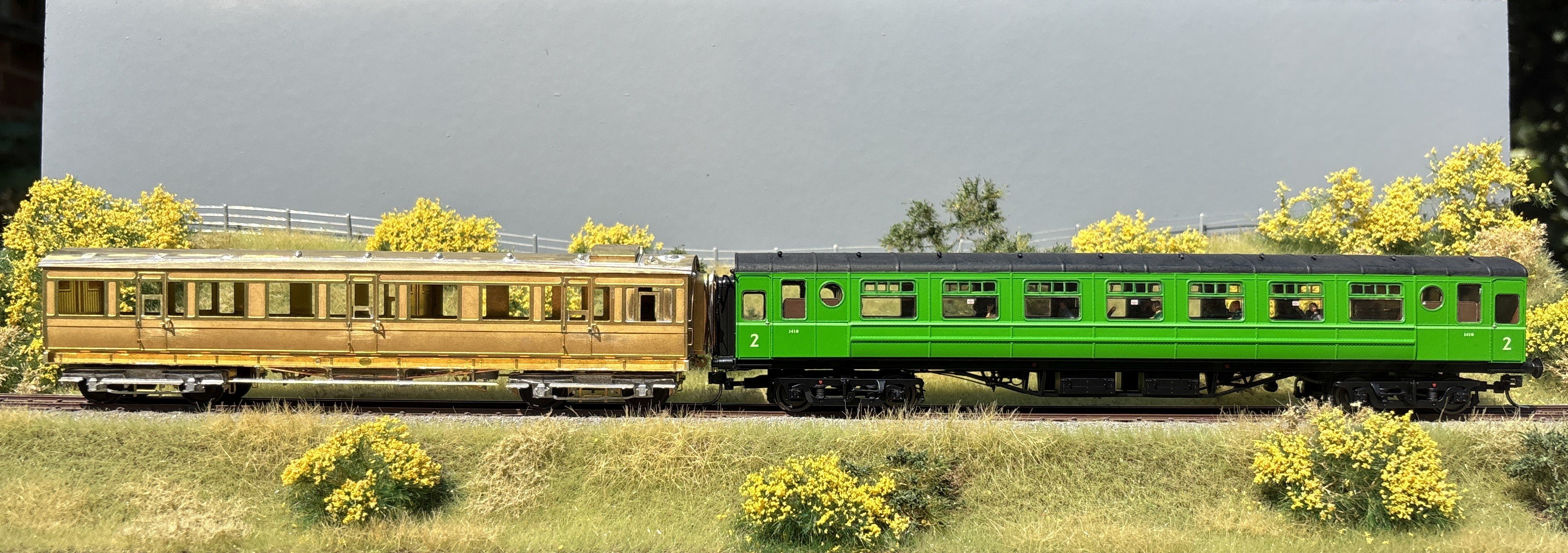

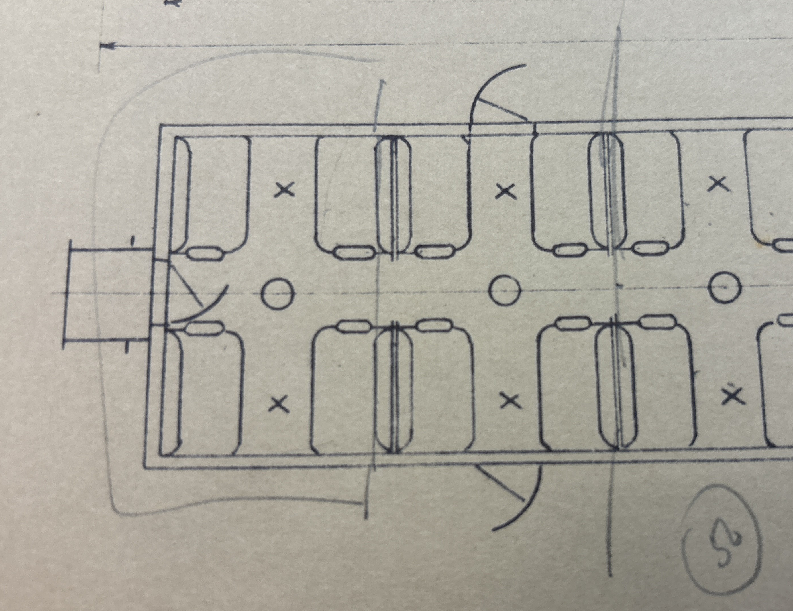

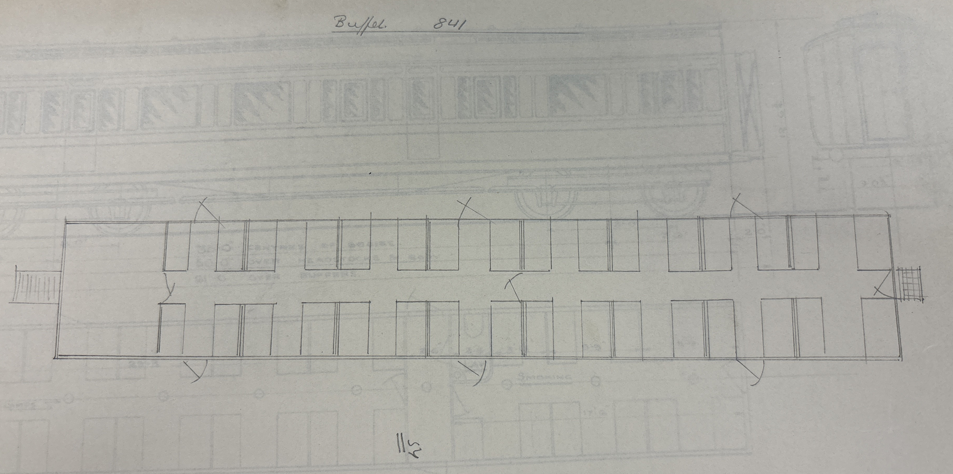

Mol_PMB Posted July 11 Author Posted July 11 You are all too kind. I said I'd write a bit about Tea Car 841, and this is a case where my research is struggling to get the full picture. The story starts in the same way as 843, and here's a reminder of part of the diagram 71 in the IRRS Archives which is formally labelled for both 841 and 843. It carries a CIE stamp dated 1950 but the drawing itself looks older. The circular items shown on the centreline of the coach are identified as Flettner ventilators - the rotating vents sometimes seen on the roofs of old buses and caravans. The side elevation on this diagram shows the side without the pantry, and does not indicate any external modifications compared to the original vehicle. The 1946 and 1953 CIE carriages listing have 841 as a tea car with 58 seats (same as 843) and this is consistent with the diagram. IRRS Journal 9, Summer 1951, included the following paragraph describing the redecoration of 841, including the replacements of the fancy cast iron seat frames with wooden ones (possibly more like those now in 836 at Downpatrick). There is also an implication that the vehicle was repainted in plain dark green: From the Catering Department file in the IRRS archives, I made the following notes on 841: 841 Tea Car 11/47 conversion to electric lighting authorised, but not done 841 Tea Car 31/10/1950 Hotels Dept proposed to release when new diners/buffets built 841 Tea Car 22/09/1952 Diesel buffet car, Waterford route, gas lighting, 18 seats, proposed for scrapping 841 Tea Car 25/02/1953 Already converted for diesel trains, in service Dublin-Waterford 841 Tea Car 17/08/1954 Has now been returned to traffic dept, no longer a catering car 841 Tea Car 04/10/1954 Already handed back to traffic dept 841 Tea Car 04/11/1954 Already handed back to traffic dept. Fitted for diesel rail cars Note that the third reference listed it has having 18 seats. It was the catering department practice to only count the 'covers', i.e. seats at tables served from the counter. The diagram shows 18 seats at tables which is consistent. Unlike 843 and 838 where 16 or 15 seats were listed. This suggests that 841 may have had a slightly different layout. I have not found any photos that clearly show 841 in its tea car guise. The early AEC railcar photos mostly show tea cars 838 or 343, occasionally 350 or 74D. This is frustrating! There is an intriguing hand-drawn sketch in the IRRS Archives headed 'Buffet 841' which appears to suggest a different layout utilising only one seating bay, and that being at the end of the car with a 5-bay saloon (the other drawings show the pantry at the 4-bay saloon end). The plan would indicate a total of 64 seats: Additionally, one copy of the diagram for the unmodified coaches of this series has hand annotations to the end with the 5-bay saloon, suggesting a similar modification. These two sketches are a bit of a mystery and may just represent schemes that didn't come to pass. As with the other two tea cars, 841 was used in the early railcar services but once the new-build buffet cars had entered service in 1954 it was handed back to the traffic department and was no longer used as a catering car. However, it was not scrapped (as had been proposed in 1952) and remained in use as a railcar intermediate. In the IRRS Archives is a report by Bulleid into a fire on AEC railcar 2612 whilst working a Sligo to Dublin service on 31st August 1957. The train formation was given as: 2609 - 841 - 2612 + 2665 - 1141 - 2618. (N.B. I have a suspicion that 1141 is a typo for 1411) So 841 had a lucky escape and continued in service. In the 1961 carriage register, 841 is listed as a 56-seat standard class carriage, which would suggest that the pantry had not been converted back into seating accommodation, and that a further 2 seats had been removed. Perhaps the space was useful for luggage? Irish Railfans News #7, April 1961, has this mention of 841: On the last day of operation, Good Friday, March 31, full services were operated. A three coach railcar (2660/1410/2641) worked the up 08:25 from Bantry. The same set with an additional coach (841) inserted was on the 12:15 Albert Quay to Bantry and its return at 15:00. On the Clonakilty branch C212 hauled the morning passenger train and, running light to Ballinascarthy, worked two wagons down the Courtmacsherry branch. The same loco later worked the 15:00 mixed Clonakilty - Clonakilty Junction, the last train on the branch as the 19:00 down was replaced by road transport. On the Skibbereen line C216 was in command of the 13:30 to Baltimore and its return working at 14:20 to Drimoleague, with a train comprising compo 2098, LV 2709 and 2nd 1349. The “last train” from the public point of view was the 18:00 Cork - Bantry and was made up of the 12:15 set (2641/841/1410/2660). There are lots of photos and some cine film that show this last train on the West Cork, but not many show 841 clearly. Here are a selection of unclear pictures! What can we learn from these muddy views? Well it looks like the normal roof vents are only over one of the two saloons in the coach, but the roof furniture in the middle of the roof is busy all along, and there seems to be a central water tank at the other end of the roof (adjacent to the Park Royal). Some of those features match what we saw the photo of tea car 843 (style and location of roof tank) and 843 also had extra 'Flettner' rotating vents on the centreline of the roof which are marked on the diagram and probably present on 841 too (especially with the normal vents being removed). The photo of 843 also showed extra vents on the sides above the windows at the pantry end, but none of the photos of 841 are clear enough to show whether these were fitted - my gut feel is that they were absent or had been removed by 1961. So whereas 843 appears to have been converted back to original condition after its spell as a tea car, 841 seems to have retained some of its tea car features and a reduced seating capacity. I think these 1959 images from the Cork Digital Archive show either 841 or 843: https://corkdigitalarchive.ie/items/show/1700, https://corkdigitalarchive.ie/items/show/1714, https://corkdigitalarchive.ie/items/show/1726, https://corkdigitalarchive.ie/items/show/1703 After 61 years in service, 841 was eventually withdrawn in 1963 and scrapped in 1964, displaced by the Cravens. Frustratingly, I haven't found quite enough information to be sure of its appearance in the 1950s and 1960s. I'd like to model it in this form, but I'm probably going to have to guess. Has anyone got a better photo of 841 stashed away somewhere? 1

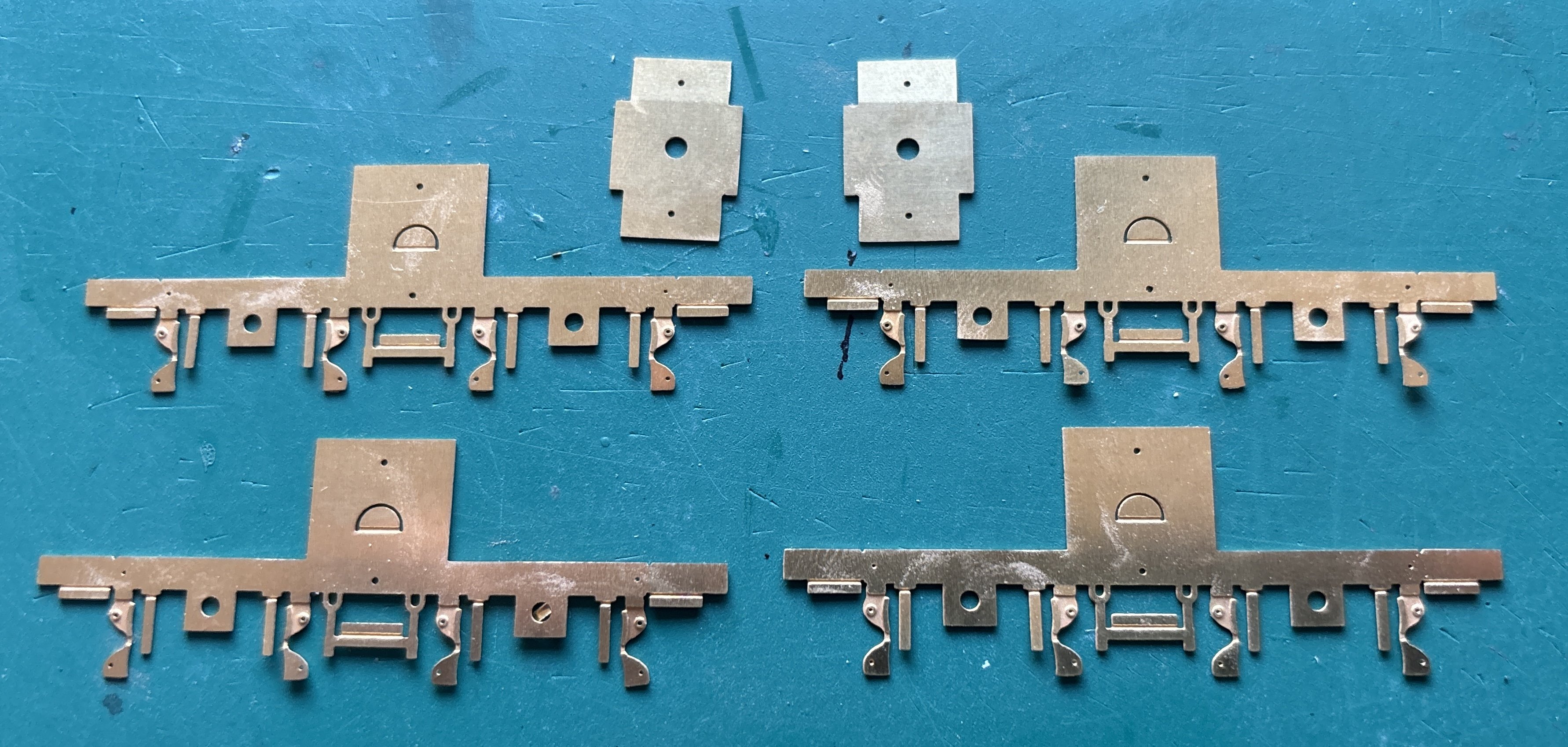

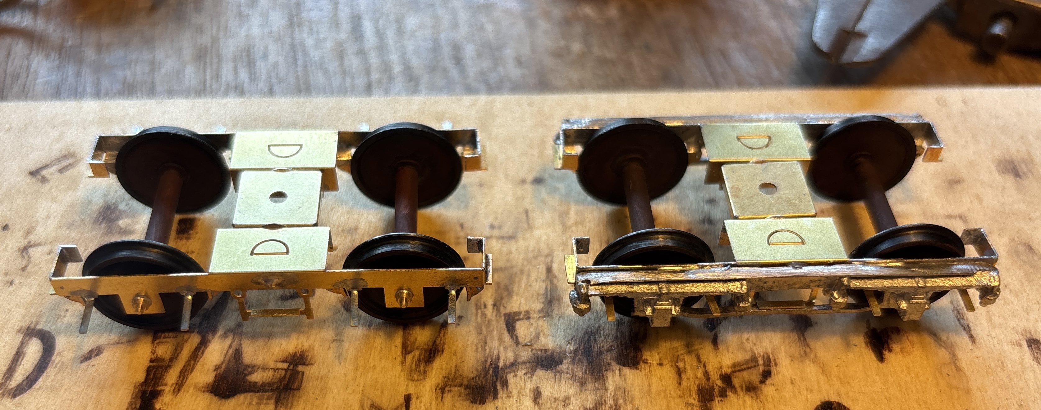

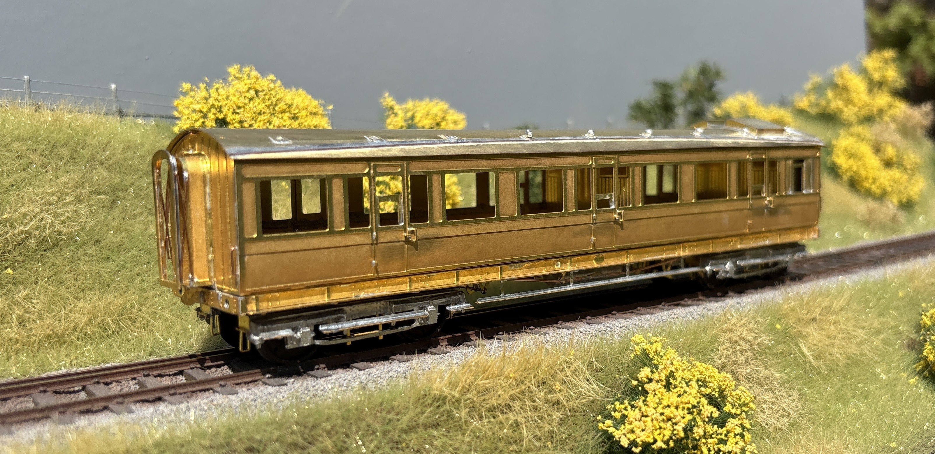

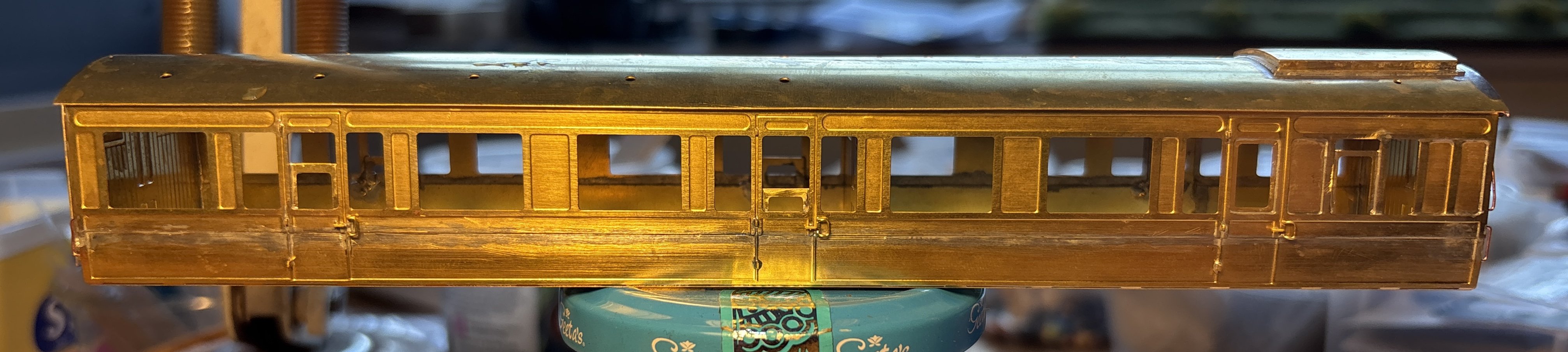

Mol_PMB Posted July 12 Author Posted July 12 While waiting for a delivery from Wizard to enable me to complete the roof, I have built the bogies. Fortunately the weather isn't quite so impossibly hot today (29C rather than 34C), so I could contemplate soldering. Here are a few photos during construction: These are compensated on the Brassmasters principle. I still need to add the springy wires across the ends to make them a bit less floppy, but I think I'll do that after completing the basic painting and putting in the wheels. After an ultrasonic bath, I did a trial assembly and took some photos. Looking OK I think though not quite complete: And a size comparison with a modified IRM Park Royal. The prototypes were built over 50 years apart, but provided very similar accommodation - a third class open saloon in two parts, and gangways. The older coaches were built with 72 seats (compared to 82 for the Park Royal). Some later had 2 toilets added, reducing the seating to 64 (compared to 70 for the Park Royal with 2 toilets). There are some 1950s and 1960s photos around Cork showing these two types of coach coupled up in a train, and the relative sizes and heights of the models look about right. The length difference between a 50' coach and a 61'6" coach is quite significant. The older coach is much narrower as well, of course. 10 5

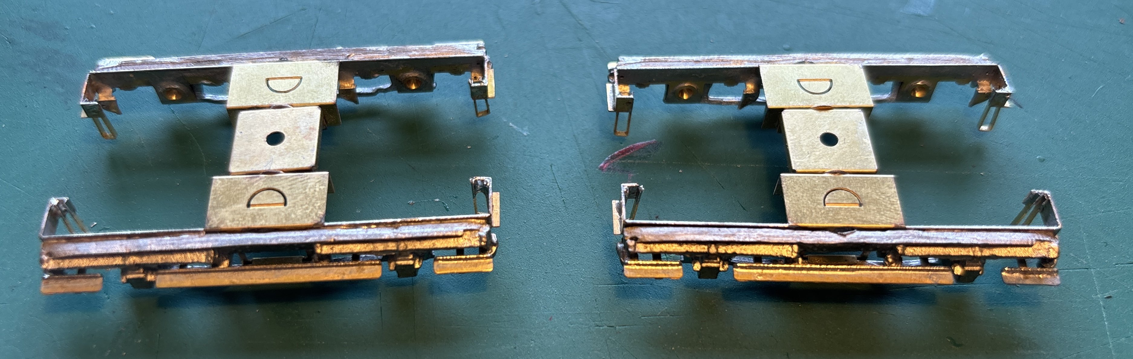

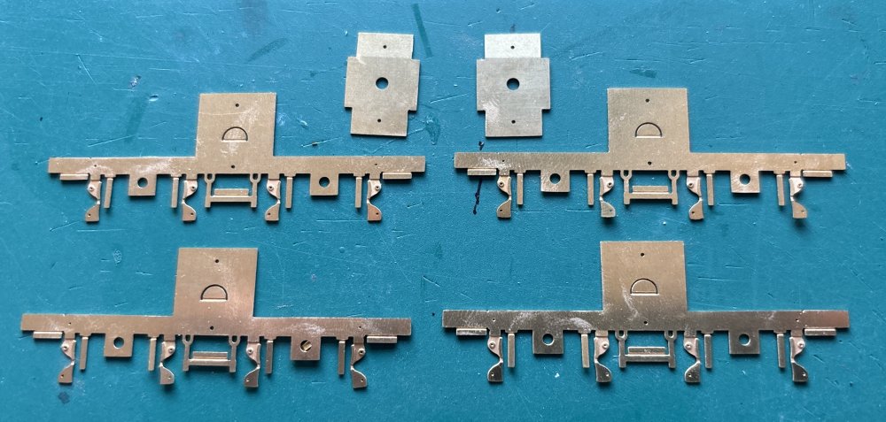

Mol_PMB Posted July 26 Author Posted July 26 @Horsetan asked about suspension on the bogies for P4, a few weeks ago. So I just thought I’d show these photos now that I’ve completed the bogies assembly. The sideframes are free to pivot in pitch relative to the bolster, so they can accommodate track twist. To stop the whole assembly being too floppy, fine springy wire is soldered across each end. This principle is used in the Brassmasters bogie compensation units, though I have adapted the dimensions and details to suit these broad gauge GSWR bogies. I painted the bogies and wheelsets separately, then assembled them before soldering the springy wires in place. These photos show that last stage, just before I touched up the paintwork. underside: End view showing how the wire flexes when the bogie is twisted: Hopefully this will suit P4. The bogies can also be built for 16.5mm gauge (with 28mm axles) or you could fit RTR 8’ wheelbase bogies. 3 1
Mike 84C Posted July 26 Posted July 26 Very nice work Mol, I like the idea of the springy wire disguised to look like a brake pull rod. 2
jhb171achill Posted July 26 Posted July 26 This really is a masterclass, the likes of which is RARELY seen, either here or anywhere else. Absolutely stunning work. After today, one painted green and red on a Mayo branch line has to be a must................ 1

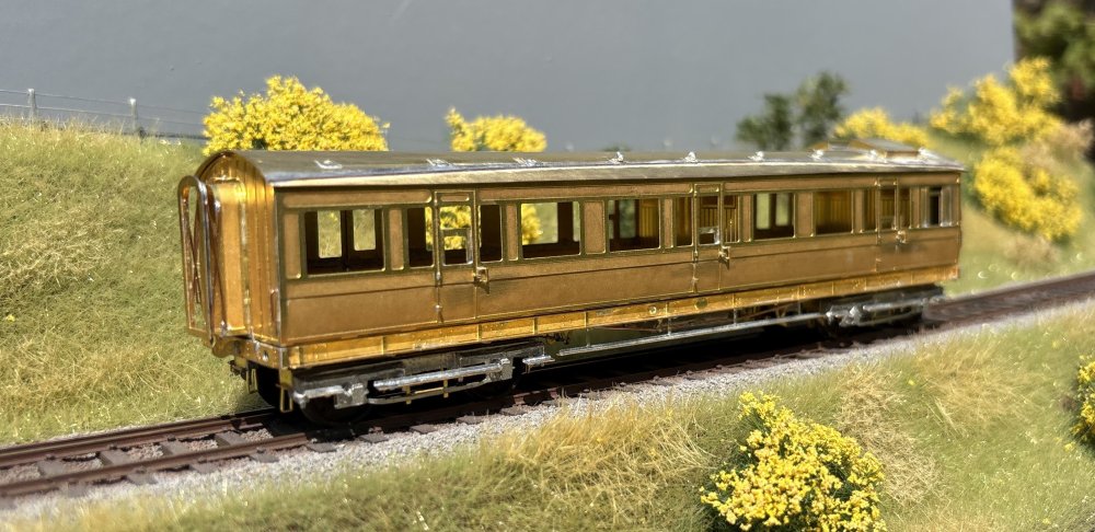

Mol_PMB Posted July 27 Author Posted July 27 Many thanks JB! Apart from passengers, I'm going to declare this finished. Otherwise I'll spend ages fretting over little things that are barely visible. I do plan to add passengers, but I've only just started painting the crowd of families going on a summer excursion to the seaside. There are a few minor changes I want to make to the body artwork before getting any more etched. And I'm only half-way through writing the instructions. But in due course you'll be able to order these etches from Arch60 and make your own, if you fancy it. It can be built in original condition (no toilets), or with the lavatories as shown here, or as tea cars 841 / 843 (though you'll need to improvise some of the interior on those). 6 1

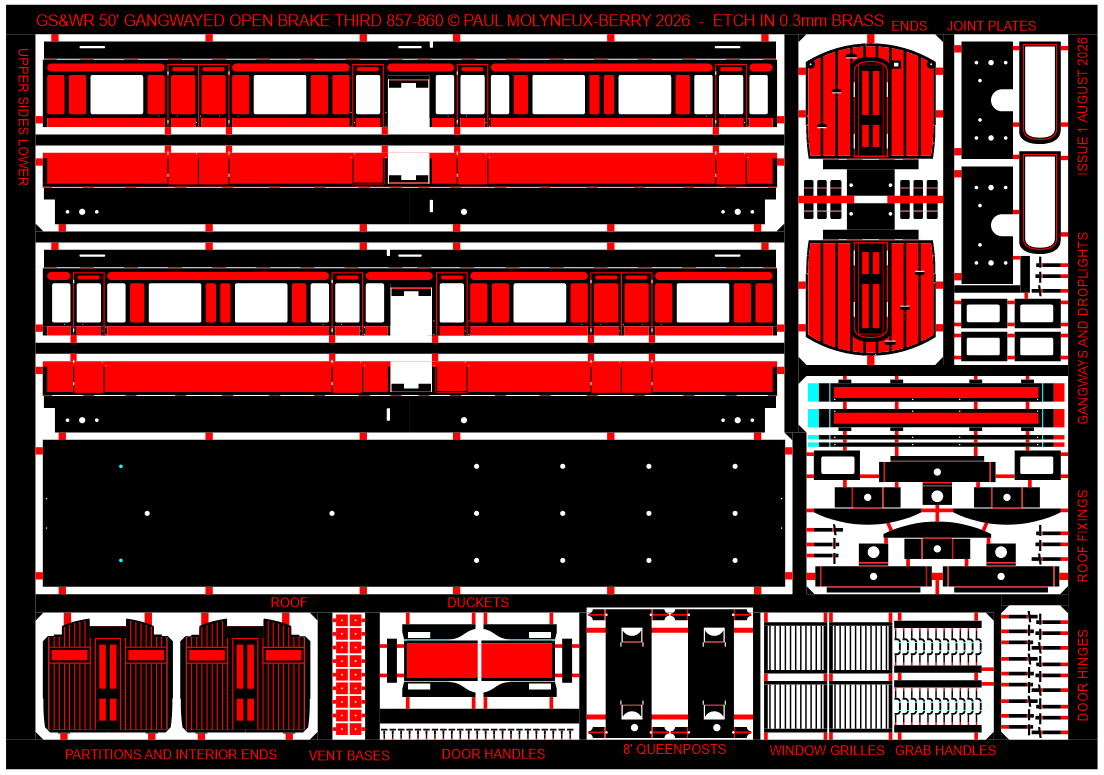

Mol_PMB Posted August 8 Author Posted August 8 A progress update on the GSWR 50' coach project. I have made some minor updates to the body etch artwork to improve a few matters found during the trial build. I've sent that off to get a second set of etches made. When I was in the Isle of Man last week I was lucky to find some old Irish photos including this nice one taken at Roscrea, probably late 1950s: It shows one of the open brake thirds 857 - 860 which matched the open third I've modelled already: This has encouraged me to produce an alternative body etch representing the brake thirds. I don't have a detailed drawing for them, but I do have both GSWR and GSR diagrams with key dimensions, plus some other good photos from Ernie and the IRRS. So I'm fairly confident I can accurately modify the all-third artwork into a brake third. I can also borrow the ducket artwork from my 30' brake etch. It should be a fairly 'quick win' and will fit the same underframe. Again, Ernie has a lovely colour photo of one of these, arriving at Cork in September 1960 - with a C class this is probably a train from Tralee: 5 1

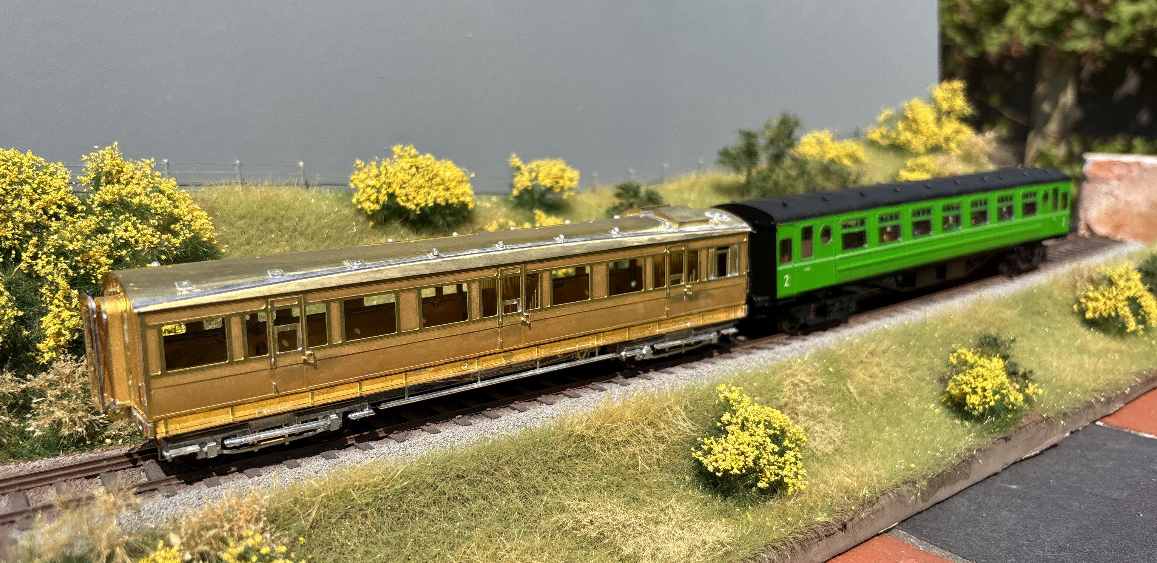

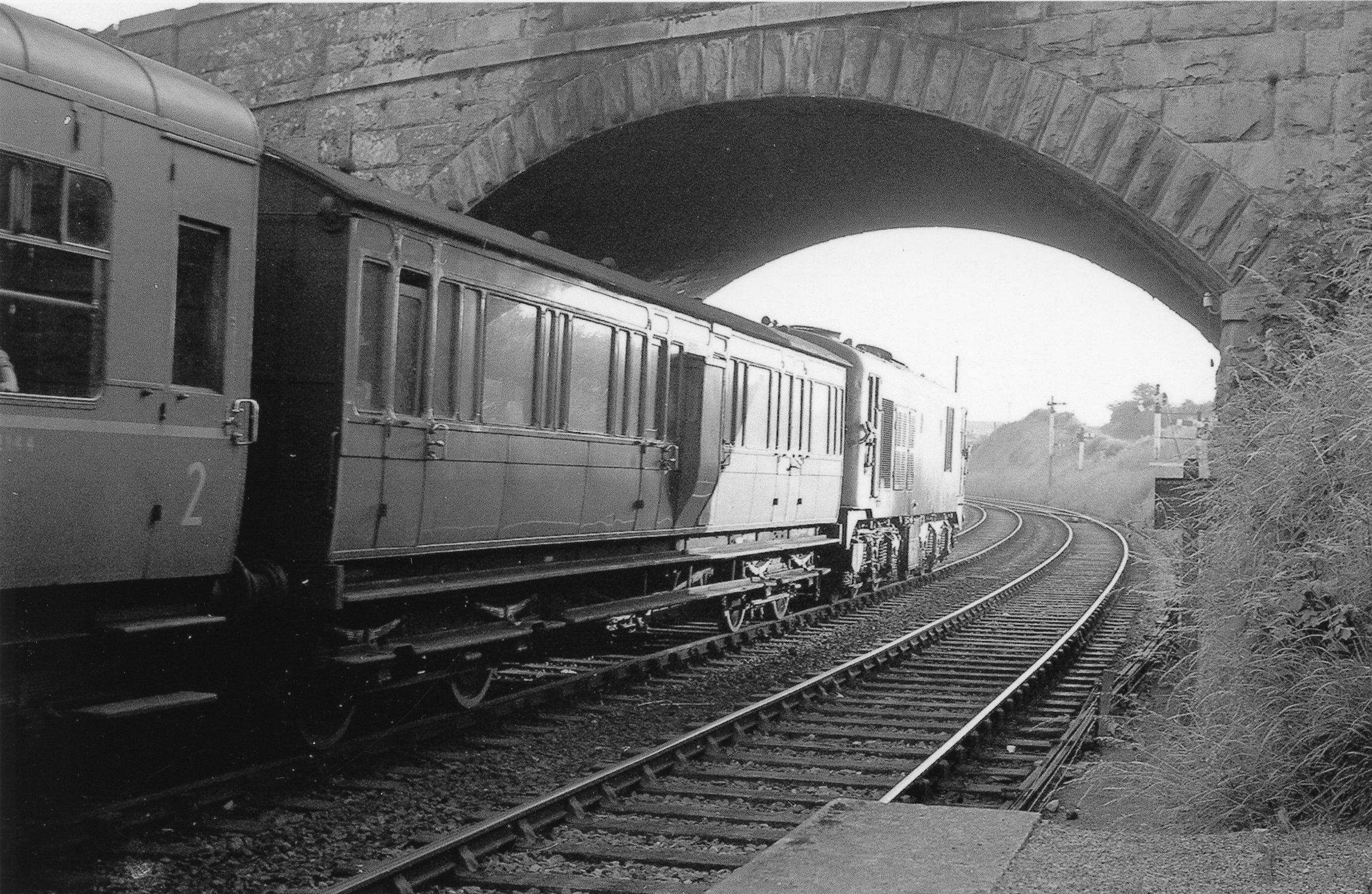

Mol_PMB Posted August 8 Author Posted August 8 Draft artwork for the brake third: Incidentally, while in the IoM I got a photo of another type of 50' coach, also a gangwayed open third but with clerestory: The print had '6185 Kingsbridge' written on the back, and must be post-1956 because of the '2' digit on the adjacent coach. It's clearly not 6185 as GSWR coach numbers didn't get that high, and there wasn't a 618s, I think it might be 816s, 818s or 819s but the print isn't clear enough to be sure - all three survived until 1960. There were 17 of these built, 815 to 832, but many were withdrawn in the 1940s and 1950s. The peculiar thing is that the left-hand door is in the 'wrong' place compared to the original drawings (available from the IRRS) and the GSWR and GSR diagrams - it ought to be one bay to the left (swapping places with a big window). Here's an IRRS photo of 815 with the door position matching the drawings: https://www.flickr.com/photos/irishrailwayarchive/53508744106 I haven't found any other coach types that are an exact match. A mystery. I'm not sure I'm quite ready to tackle a clerestory coach, and if I did it would probably be something other than this type. 2 1
jhb171achill Posted August 8 Posted August 8 37 minutes ago, Mol_PMB said: Draft artwork for the brake third: Incidentally, while in the IoM I got a photo of another type of 50' coach, also a gangwayed open third but with clerestory: The print had '6185 Kingsbridge' written on the back, and must be post-1956 because of the '2' digit on the adjacent coach. It's clearly not 6185 as GSWR coach numbers didn't get that high, and there wasn't a 618s, I think it might be 816s, 818s or 819s but the print isn't clear enough to be sure - all three survived until 1960. There were 17 of these built, 815 to 832, but many were withdrawn in the 1940s and 1950s. The peculiar thing is that the left-hand door is in the 'wrong' place compared to the original drawings (available from the IRRS) and the GSWR and GSR diagrams - it ought to be one bay to the left (swapping places with a big window). Here's an IRRS photo of 815 with the door position matching the drawings: https://www.flickr.com/photos/irishrailwayarchive/53508744106 I haven't found any other coach types that are an exact match. A mystery. I'm not sure I'm quite ready to tackle a clerestory coach, and if I did it would probably be something other than this type. There were more than a few “one-off” alterations. I suspect you’re seeing opposite sides of that coach and for some reason they’ve altered one end of one side from original….

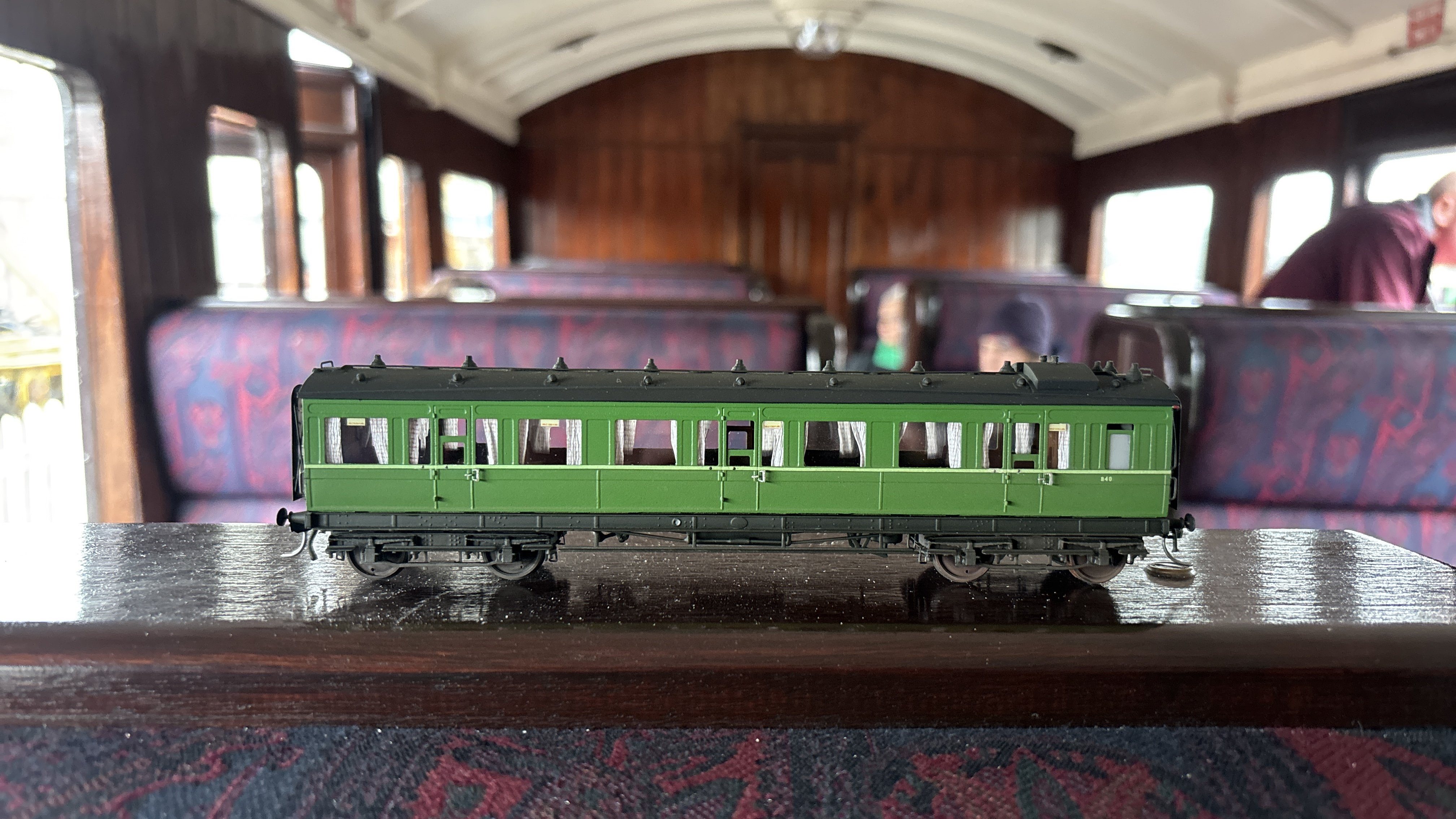

Mol_PMB Posted August 29 Author Posted August 29 Here’s the model 840 inside the real 836 at Downpatrick: We have all 3 flavours of baby GMs and 2 thumpers in action today. 18

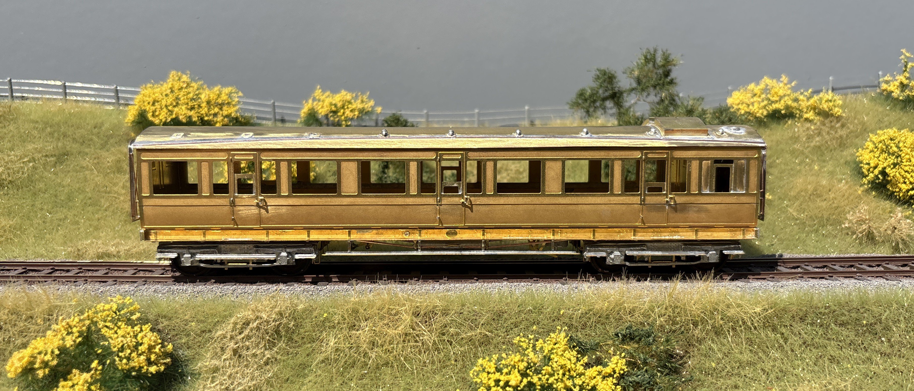

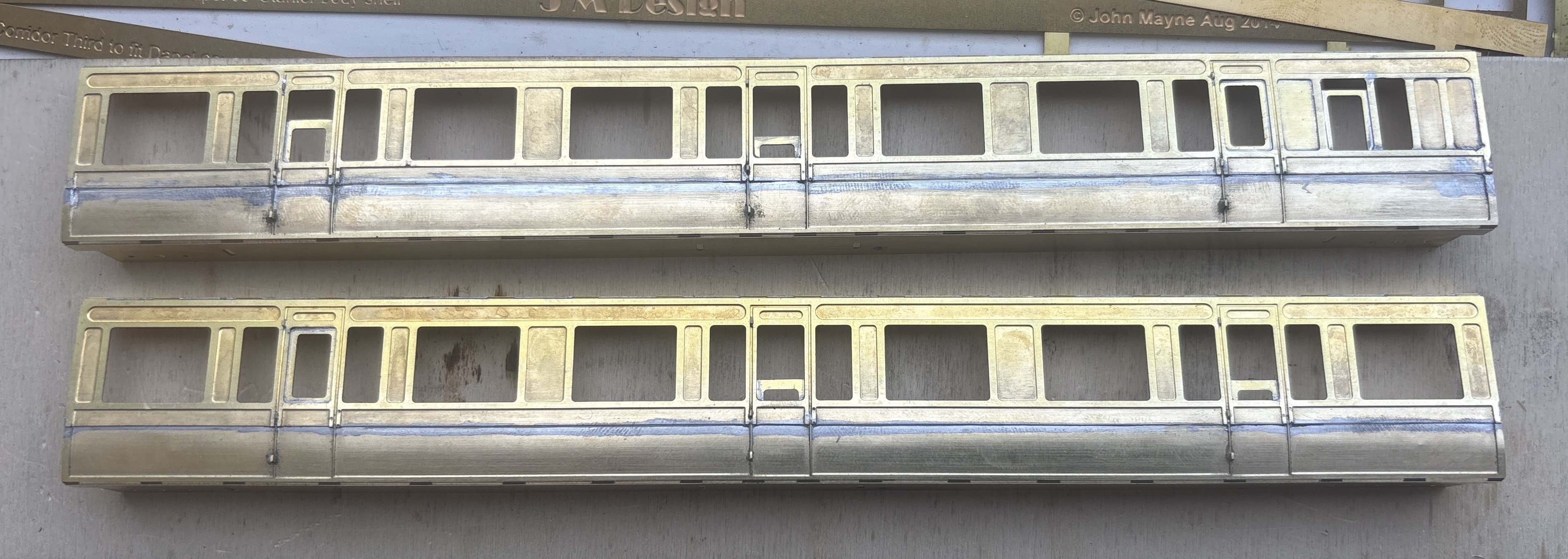

Mol_PMB Posted September 5 Author Posted September 5 I have started building the body of a second coach, and at the same time completing the instructions. The two tasks have to be done in parallel as I describe and photograph each stage. This is also giving me the opportunity to check that the changes I made to the body etch are resolving the issues I found during the first build. It's slow progress - taking the photos and writing the instructions takes longer than actually building the thing. But I've now done the sides - this will be tea car 841, in the condition when it ran as a railcar intermediate from 1952 until the early 1960s. I still need to do the ends and roof, hopefully I'll get them mostly done by the end of tomorrow. I have another underframe etch for this vehicle which I will build in due course, but that doesn't need to be done for the instructions as I've completed writing that bit already. Some improvisation will be needed for the interior of this car, especially at the pantry end. Once I have the instructions finished and have checked the design tweaks on the etch, then I'll be comfortable with other people ordering their own copies of the etch from Ian at Arch60. I will add the instructions to this thread. @jhb171achill will hopefully be pleased eventually. 3
jhb171achill Posted September 5 Posted September 5 6 minutes ago, Mol_PMB said: I have started building the body of a second coach, and at the same time completing the instructions. The two tasks have to be done in parallel as I describe and photograph each stage. This is also giving me the opportunity to check that the changes I made to the body etch are resolving the issues I found during the first build. It's slow progress - taking the photos and writing the instructions takes longer than actually building the thing. But I've now done the sides - this will be tea car 841, in the condition when it ran as a railcar intermediate from 1952 until the early 1960s. I still need to do the ends and roof, hopefully I'll get them mostly done by the end of tomorrow. I have another underframe etch for this vehicle which I will build in due course, but that doesn't need to be done for the instructions as I've completed writing that bit already. Some improvisation will be needed for the interior of this car, especially at the pantry end. Once I have the instructions finished and have checked the design tweaks on the etch, then I'll be comfortable with other people ordering their own copies of the etch from Ian at Arch60. I will add the instructions to this thread. @jhb171achill will hopefully be pleased eventually. Awaiting with anticipation! 1
Mol_PMB Posted September 6 Author Posted September 6 (edited) Ordering Instructions If anyone else wants to build one of these GSWR 50' gangwayed open third coaches, this is what you need to do to get the etches. They are made by Arch60 https://arch60.co.uk/ - this firm was formerly 4Dmodelshop. Their service is fairly quick - normally about 1 week from order to delivery, though Ireland may take a bit longer. Iain is the man in charge of the etching workshop. He usually responds promptly to emails: artwork@modelshop.co.uk If you want to call then it's a London number: (+44) 020 7264 1295 You will need to mention that this is Paul Molyneux-Berry's artwork for the GSWR 50' gangwayed open third coach. You can say that I have given permission for you to use my artwork - but Iain may check with me anyway. For 1 coach you will need two A4 size etches in 0.3mm brass: 1 of the underframe 1 of the body, issue 2 Please note that the body etch can build 3 variants: the basic open third, the type with lavatories, or the tea car. Don't confuse Iain by asking for particular types - the etch is the same for all of them. Expect to pay about £110 including VAT for the two etches, plus postage. If several Irish modellers want these then it might make sense to make a combined order for several sets of etches - but please arrange this amongst yourselves. Please let me know if you have any questions. Edited September 6 by Mol_PMB material thickness added 2 1

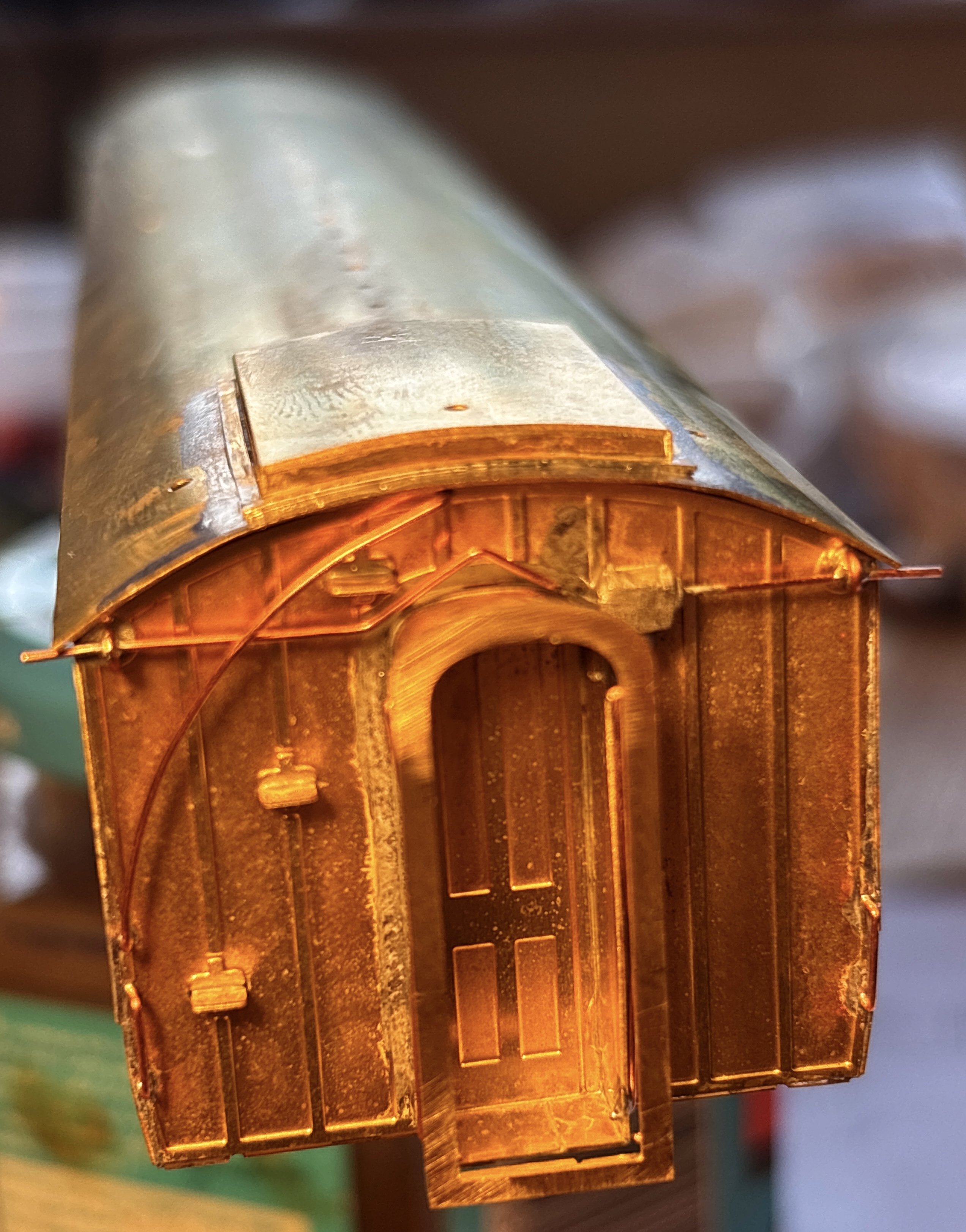

Mol_PMB Posted September 6 Author Posted September 6 I have not yet finished writing the instructions, but I'm about 70% of the way there. The attached pdf document is how far I've got so far, which will give you an idea of what to expect. GSWR_50'_Instructions.pdf Here's the current progress with the second build. Issue 2 of the body etch has resolved the minor fit issues and has gone together pretty well. I still need to detail the roof and I haven't started the underframe yet. This is tea car 841: I have a very busy few weeks ahead, so please be patient with me. 3 2

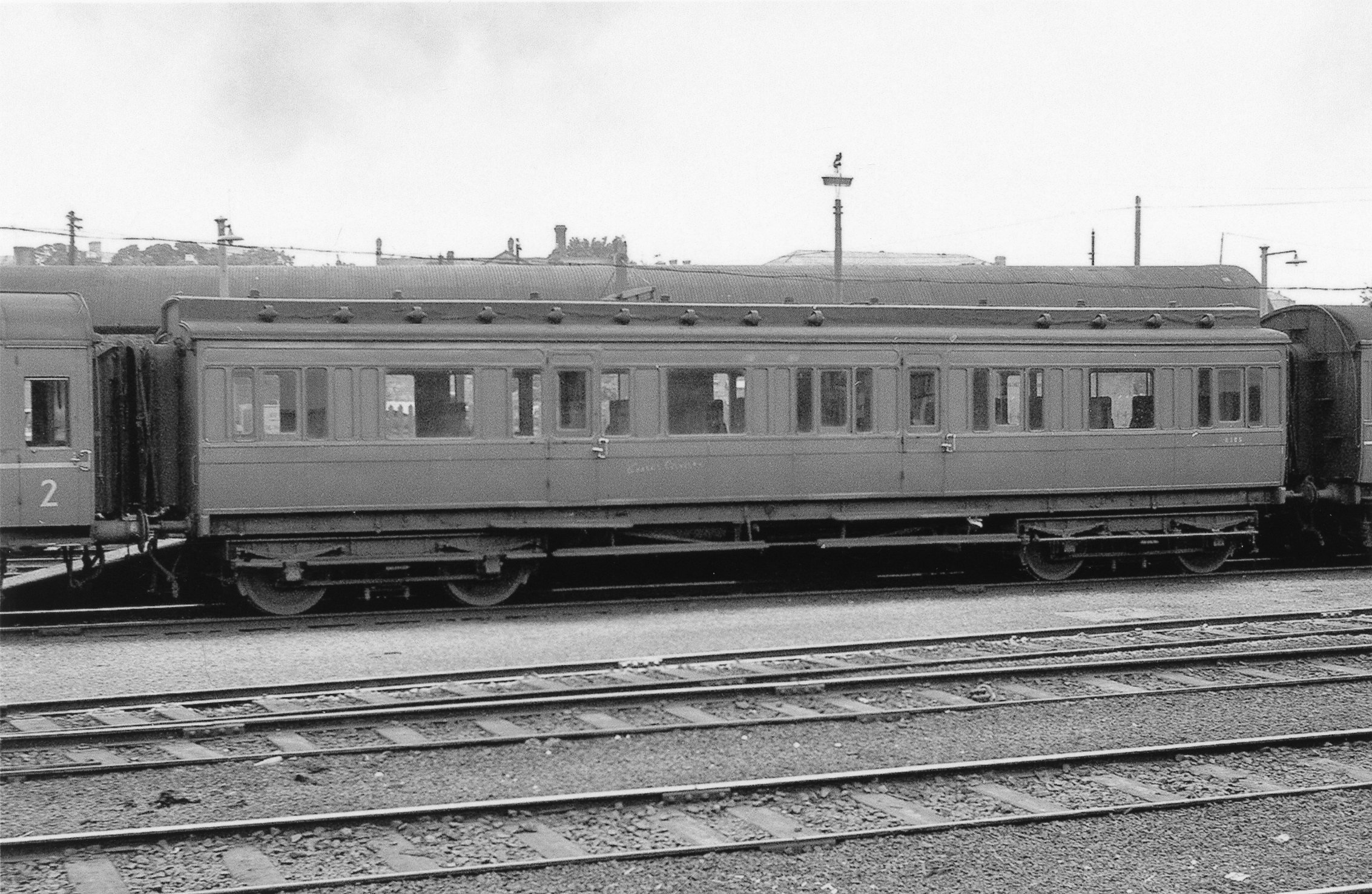

Mol_PMB Posted October 2 Author Posted October 2 Here's a nice view of one of these coaches at Broadstone, looking newly-painted in 1930s maroon livery. This images appears in Ernie Shepherd's book on the MGWR and is credited to J Coughlan. The caption says that the loco was rebuilt into this form in May 1926, and withdrawn in December 1935, so the date must be in that range. This has the very large torpedo ventilators typical of these vehicles as-built. The communication cord is in the early position running along the outer edge of the roof, rather than inside. The number appears to be 843, and this would be before it was converted to a tea car. Here's another photo of one of these coaches in the GSR maroon: https://www.flickr.com/photos/irishrailwayarchive/53508875601 At least one carried the GSR two-colour livery of chocolate and cream, as seen here: https://www.flickr.com/photos/irishrailwayarchive/53508723596/ Like the photo at Broadstone above, the train is a mix of the maroon and chocolate/cream liveries. I posted this summary of liveries applied to these coaches on another thread but it is probably a good idea to repeat it here. 1. All-over dark "lake" (an extremely dark brownish red) with GSWR markings 1902-25 2. For any used on main lines after 1906, same with white upper panels. This is the livery 836 is preserved in. Being only a few years old in 1906, they were front line stock and it's likely that some of them received this scheme when repainted. 3. All-over dark lake but with GSR markings, 1925-early 30s. 4. Some of these did receive the short-lived GSR "main line" livery of chocolate brown and cream (late 1920s to mid 30s) - there is photographic evidence. 5. Standard GSR all-over maroon, same as LMS maroon in Britain (and for that matter NCC & BCDR here). 6. From around 1946, CIE dark green with elaborate lining, snails and 3 digits on the doors 7. From around 1951, CIE plain dark green with no lining, snails or class digits 8. From 1952, the tea cars used with railcars had CIE plain dark green with a single thin EdN waist line. No snails or class digits. 9. From 1954, CIE brilliant green with a single thin EdN waist line. No snails or class digits. 10. From 1956, CIE brilliant green with a single thin EdN waist line and 2 digits on the doors. No snails. 11. From 1959, some may have received snails on a livery similar to 10, but I haven't yet found a photo like this. I have not yet found a photo of any in 'black and tan'. It's possible; some other carriages of a similar era and shape did receive that livery. There were also some more liveries once they were withdrawn from passenger service: 837 was converted into a camping coach no.8 and was painted in a bright red and white/cream livery. Later it became departmental 530A and was painted red/brown (including ends, possibly freight wagon brown), and later again dark red (including ends). 836 was also subsequently in departmental use (463A). Initially repainted in dark green, it was later very dark grey with red oxide ends. 835 became departmental 540A and may have had had another different livery but I'm not sure what it was. 3
jhb171achill Posted October 2 Posted October 2 (edited) 3 hours ago, Mol_PMB said: Here's a nice view of one of these coaches at Broadstone, looking newly-painted in 1930s maroon livery. This images appears in Ernie Shepherd's book on the MGWR and is credited to J Coughlan. The caption says that the loco was rebuilt into this form in May 1926, and withdrawn in December 1935, so the date must be in that range. This has the very large torpedo ventilators typical of these vehicles as-built. The communication cord is in the early position running along the outer edge of the roof, rather than inside. The number appears to be 843, and this would be before it was converted to a tea car. Here's another photo of one of these coaches in the GSR maroon: https://www.flickr.com/photos/irishrailwayarchive/53508875601 At least one carried the GSR two-colour livery of chocolate and cream, as seen here: https://www.flickr.com/photos/irishrailwayarchive/53508723596/ Like the photo at Broadstone above, the train is a mix of the maroon and chocolate/cream liveries. I posted this summary of liveries applied to these coaches on another thread but it is probably a good idea to repeat it here. 1. All-over dark "lake" (an extremely dark brownish red) with GSWR markings 1902-25 2. For any used on main lines after 1906, same with white upper panels. This is the livery 836 is preserved in. Being only a few years old in 1906, they were front line stock and it's likely that some of them received this scheme when repainted. 3. All-over dark lake but with GSR markings, 1925-early 30s. 4. Some of these did receive the short-lived GSR "main line" livery of chocolate brown and cream (late 1920s to mid 30s) - there is photographic evidence. 5. Standard GSR all-over maroon, same as LMS maroon in Britain (and for that matter NCC & BCDR here). 6. From around 1946, CIE dark green with elaborate lining, snails and 3 digits on the doors 7. From around 1951, CIE plain dark green with no lining, snails or class digits 8. From 1952, the tea cars used with railcars had CIE plain dark green with a single thin EdN waist line. No snails or class digits. 9. From 1954, CIE brilliant green with a single thin EdN waist line. No snails or class digits. 10. From 1956, CIE brilliant green with a single thin EdN waist line and 2 digits on the doors. No snails. 11. From 1959, some may have received snails on a livery similar to 10, but I haven't yet found a photo like this. I have not yet found a photo of any in 'black and tan'. It's possible; some other carriages of a similar era and shape did receive that livery. There were also some more liveries once they were withdrawn from passenger service: 837 was converted into a camping coach no.8 and was painted in a bright red and white/cream livery. Later it became departmental 530A and was painted red/brown (including ends, possibly freight wagon brown), and later again dark red (including ends). 836 was also subsequently in departmental use (463A). Initially repainted in dark green, it was later very dark grey with red oxide ends. 835 became departmental 540A and may have had had another different livery but I'm not sure what it was. I think the last of them worked into the mid-60s, so a black and tan one is certainly possible. However, green was still about as late as 1967, albeit few and far between - and there was even one coach still in GNR brown that late! Straight from that to black'n'tan - no intermediate green.... Edited October 2 by jhb171achill
